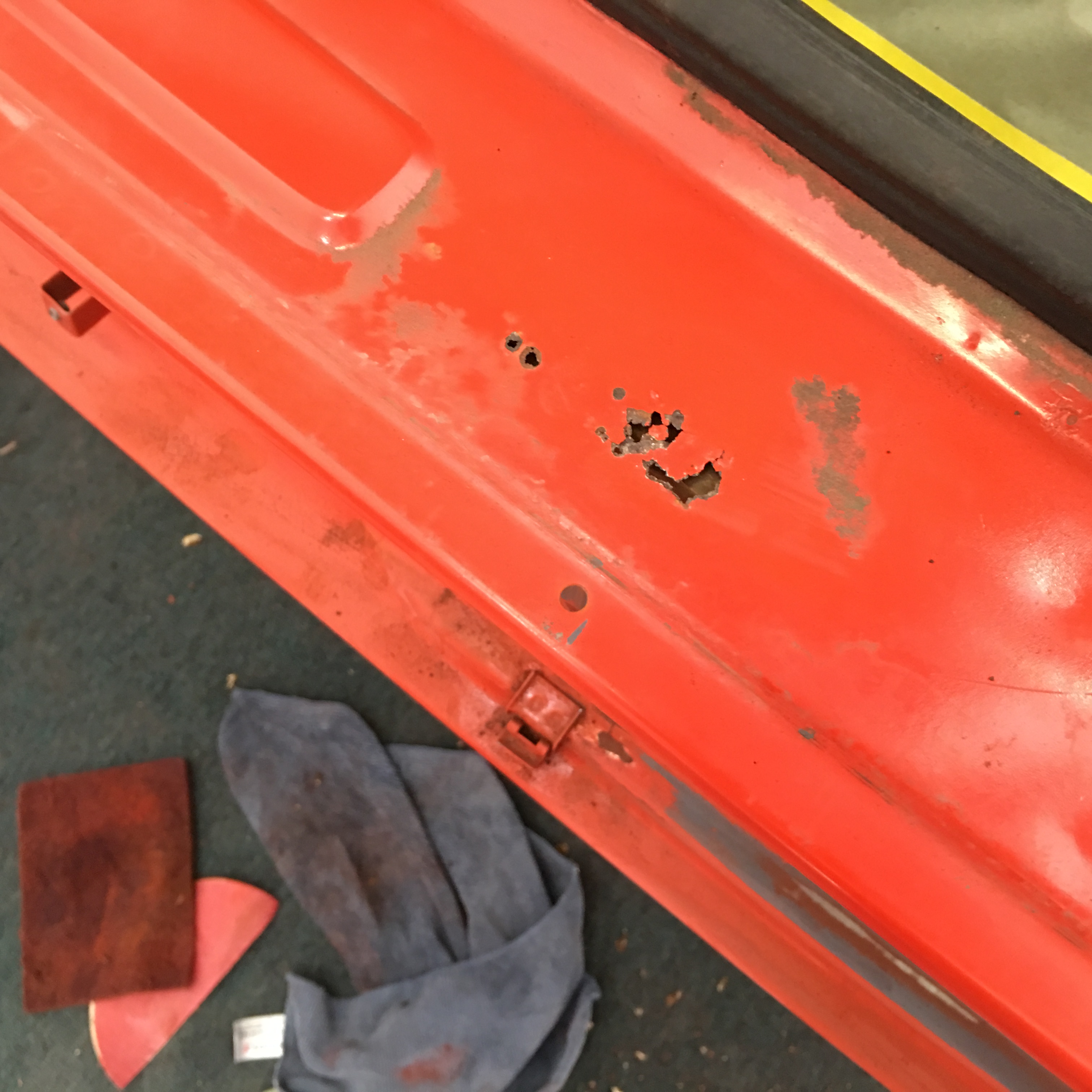

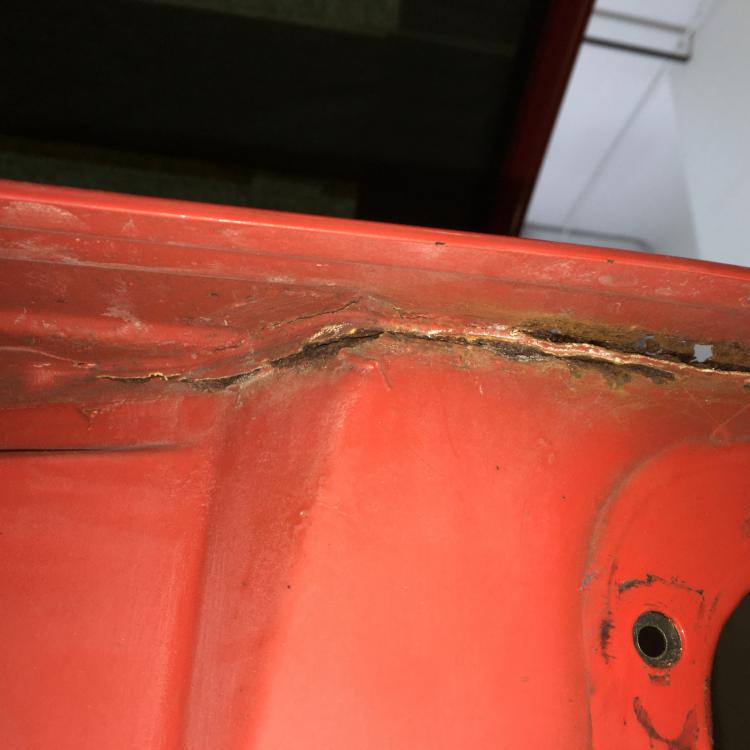

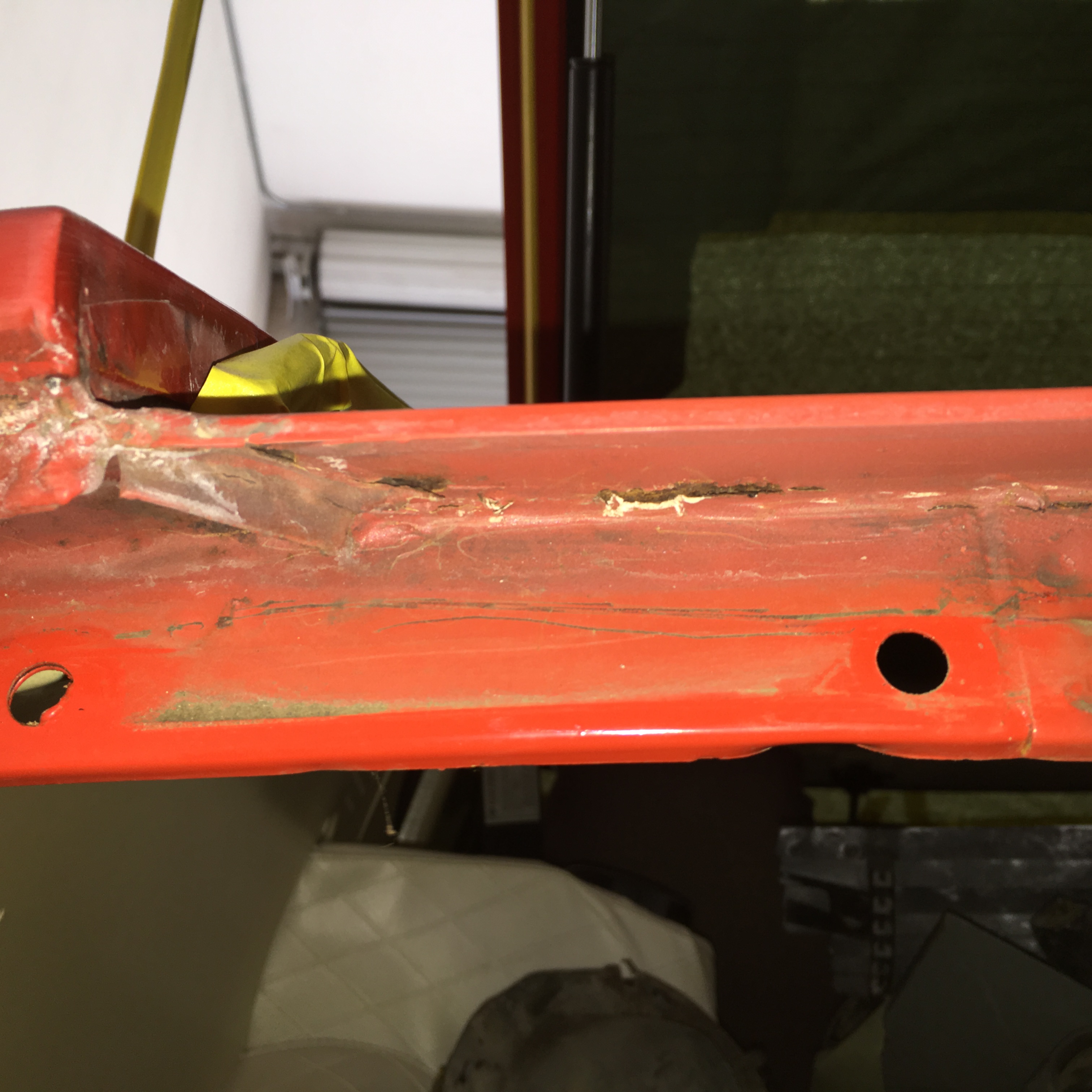

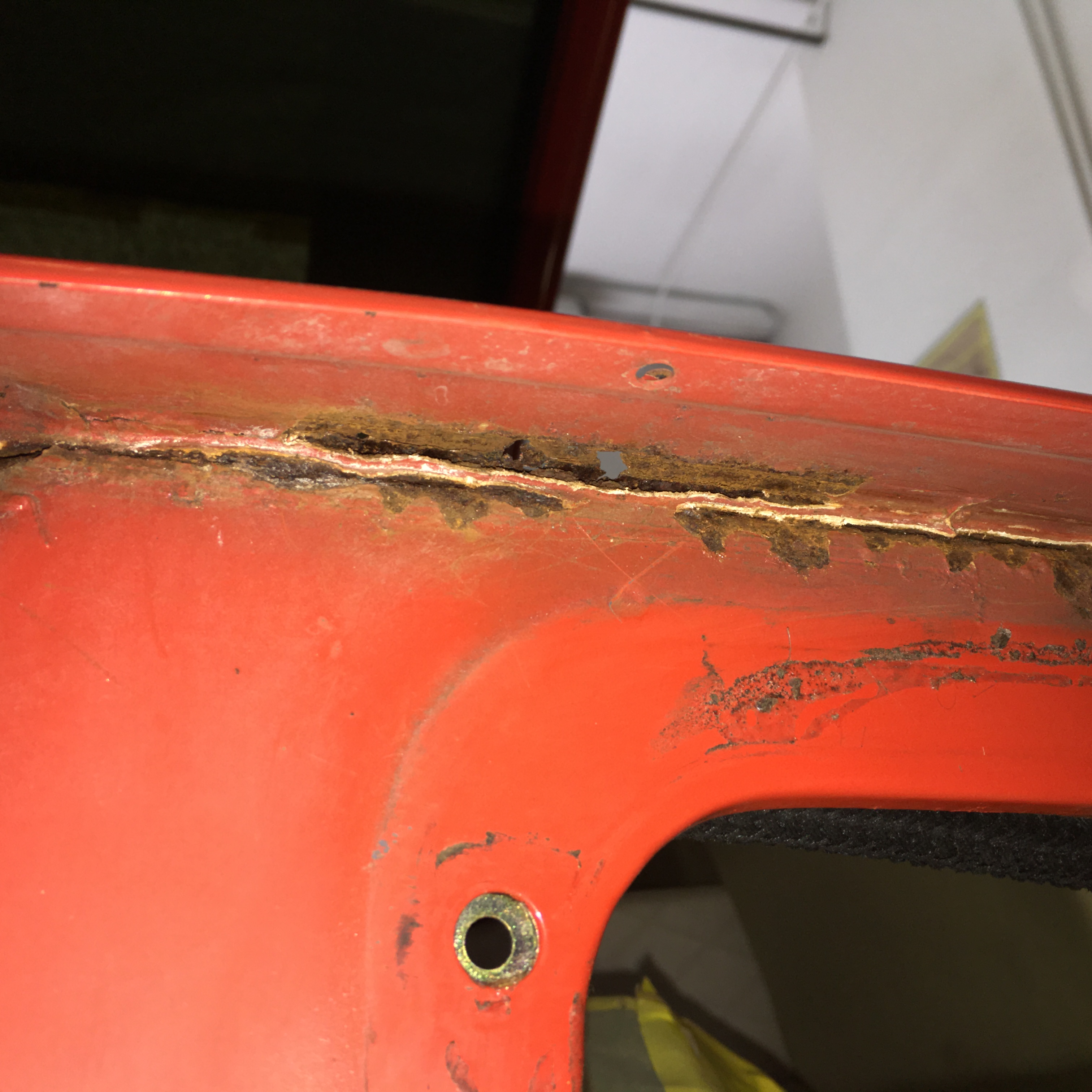

Found a little cancer on my girl! The first time! Most of the damage around the upper right tail light, as seen in pictures. When sanded and removed, Had a small break through in the deck top. Left side had just a tad bit of corrosion, so  removed factory caulking and sanded and sealing that area as well.
1st photo: Left side corrosion on deck lid.
2nd photo: Right side deck lid after cleaning. Showed small break through in sheet metal. :( That's the worst of it.
3rd photo and 4th photo: Right side rust above right tail light, extends towards the license plate.
Body man spent the day removing and making proper repair.
