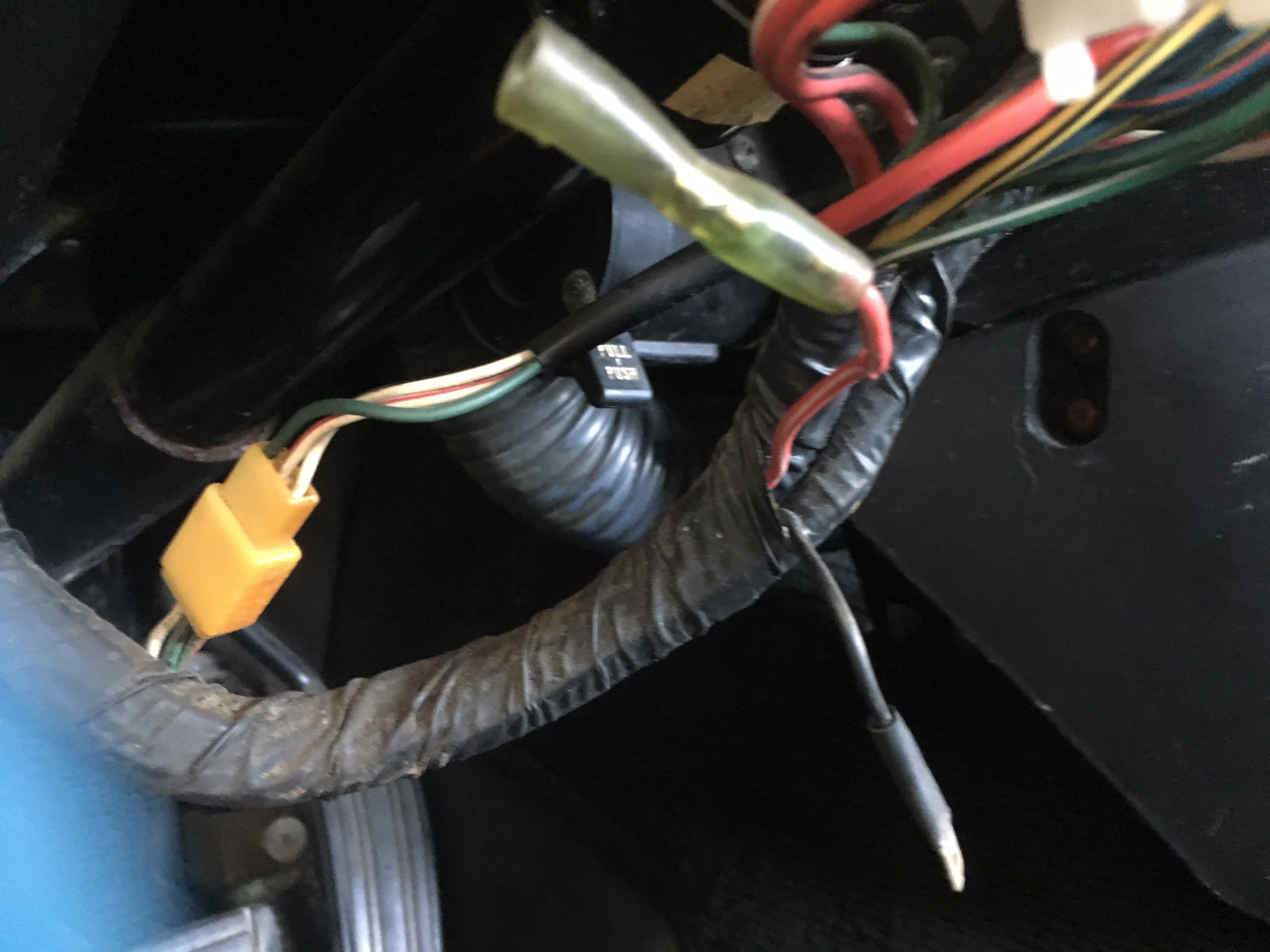

April 14, 20186 yr comment_547311 My new-to-me 1975 280Z didn’t have working turn signals when I bought it a few days ago. So, this morning I set out to get them operational. When I measured voltage on the common pin of the turn signal switch (Green) with the switch in the neutral position, I saw normal battery voltage. Then, when I moved the switch to either the left or right position, the common pin ‘s voltage dropped to near zero. I next unplugged the 3-pin connector for the turn signal (the connector towards the left-center part of the attached photo) and ran a jumper wire to the common pin on each side of that connector, thus isolating the circuit load (turn signals) and associated wiring. When I then operated the switch, the common pin’s voltage remained at normal battery voltage, and normal battery voltage also showed up at the pin for the left or right turn signals, corresponding to the position of the turn signal switch. I unplugged connector C-7 and saw the the pin associated with the ground (Black) was completely green with corrosion. I cleaned that up and tested my turn signals. They worked! While I was feeling good about my accomplishment, I check all the exterior lights to make sure they were working. The right parking light wouldn’t come on. When I removed the lens and unscrewed the bulb, it was also corroded. A little fine grit sandpaper cleaned that up and now all of my exterior lights work. On to the next project... Link to comment https://www.classiczcars.com/forums/topic/55346-280z-turn-signal-issue/?&page=2#findComment-547311 Share on other sites More sharing options...
April 14, 20186 yr comment_547314 That's good that you easily found your culprits. I would suggest that since you've found corrosion in some of the connections there is a probability that there are more in other connections. When you get the chance I would suggest going through every electrical connection on the harnesses and check just for preventive measure. I recently did this and found some potential problems. I replaced quite a few with new connectors and cleaned up the rest with DeOxit. Glad I did. Link to comment https://www.classiczcars.com/forums/topic/55346-280z-turn-signal-issue/?&page=2#findComment-547314 Share on other sites More sharing options...
