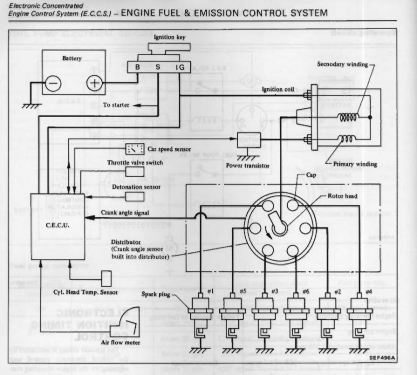

1983 turbo systems use a CAS to the ECU and the ECU controls the coil.  The universal magnetic trigger implies that you don't have the 1983 turbo system.  What's controlling the EFI on your engine?
What is CAS? I dont know as of yet. I just figured out ign. system wasnt working right before I knocked off for day.PO added so many aftermarket parts that Ime going to have a difficult time with this not being well versed and uncomfortable with electrical issues. I have figured out brake light-taillight-blower motor and fuel pump elect. and wiring issues, so Ime not a completly lost cause, just mostly.As for where EFI gets input from, I dont know yet. PO went z31 ecu with hybrid T3/T4 turbo-intercooler-turbo boost controller-turbo timer-in cockpit crane retard control-cobra MAF/AFM-420cc injectors-Crane ign. system.He went through Jim Wolf tech. for all this building up to a possible 450hp. I bought her for 3500.00 a moth ago not running, and I would like to hear it run soon. Its going to take me a bit to figure this out, but hopefully,with some advice from others better versed in elect. issues, I will get this figured out,and get this sweet little ZX on the road and out of my garage,so I can work on my other Zs andZXs.Thanks again.

You have a completely different animal than a 1983 280ZX turbo engine management system.  Better be careful, these engines blow head gaskets or break rings easily when turbo'ed.
The Z31 ECU uses a CAS also.  Open a 1984-87 FSM EFEC chapter to see the details.  Your Crane ignition box might be wired for universal trigger, but that's probably not what's under the distributor cap.  The ECU triggers the ignition.

He'd be using the 5 volt square wave from the Z31 ECU, if anything.  He has a lot more to think about than just the Crane box.  Better understand all of it before taking it out on the road.

Not sure what you mean by "CPS".  You really need to browse through the Z31 EFEC chapter to see how the ignition power transistor is triggered.  Your Crane box is taking the place of the power transistor.  It doesn't get power all the time when the key is On (if that's what you meant by CPS).  No offense, but you are way behind where you should be to safely get that engine running.  And I mean safe for the engine.  You thought you had a magnetic trigger in the distributor because you have a magnetic trigger Crane box, and now you're checking for power at the Crane box with the key on.  You have enough information to figure it out but I don't think it's going to happen on an XBOX.
