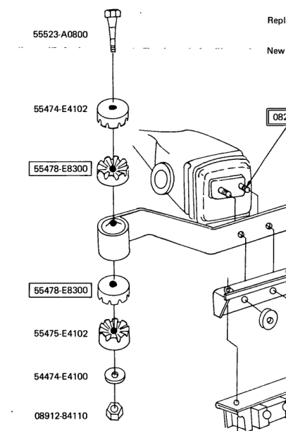

March 11, 20187 yr comment_544330 So earlier there was a question about the crenelated rubber washers for the moustache bar. Anyone have any input into this? Anybody have an idea where the solid ones came from? Some different application? On ‎2‎/‎4‎/‎2018 at 8:17 PM, Patcon said: Also I two different styles of mustache bar washers. Which is correct for a 240z? The upper ones with the crenelated rubbers on the bolts are the ones I suspect are correct. If so what are the other ones for? Link to comment https://www.classiczcars.com/forums/topic/55369-1971-hls30-14938-lily-build/?&page=10#findComment-544330 Share on other sites More sharing options...

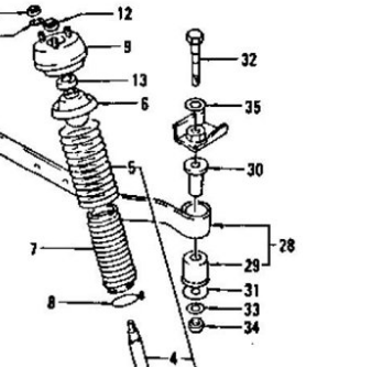

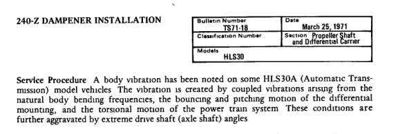

March 11, 20187 yr comment_544344 The 1969 - 1972 TSB book shows crennulations in a drawing for a March 25, 1971 TSB, "Dampener Installation". Carpartsmanual shows a few changes. Assuming that #30 and #31 is the part. The drawing looks screwed up, but the change dates match for the pair, and the label of "stopper" seems right. http://www.carpartsmanual.com/datsun/Z-1969-1978/axle/rear-suspension Link to comment https://www.classiczcars.com/forums/topic/55369-1971-hls30-14938-lily-build/?&page=10#findComment-544344 Share on other sites More sharing options...
March 11, 20187 yr comment_544346 Also, I'm pretty pretty pretty sure that I've seen the flat ones on a very early 240Z or two. In the wrecking yards and maybe illustrated somewhere. We both misspelled crenulation. Not sure it's quite the right word anyway. Not irregular. https://www.merriam-webster.com/dictionary/crenulated Link to comment https://www.classiczcars.com/forums/topic/55369-1971-hls30-14938-lily-build/?&page=10#findComment-544346 Share on other sites More sharing options...
March 11, 20187 yr comment_544352 Â How about castellated. Similar to wheel bearing nuts. Link to comment https://www.classiczcars.com/forums/topic/55369-1971-hls30-14938-lily-build/?&page=10#findComment-544352 Share on other sites More sharing options...
March 11, 20187 yr comment_544355 'wavy' 'rippled' 'serrated' Link to comment https://www.classiczcars.com/forums/topic/55369-1971-hls30-14938-lily-build/?&page=10#findComment-544355 Share on other sites More sharing options...
March 11, 20187 yr comment_544357 3 hours ago, Captain Obvious said: So earlier there was a question about the crenelated rubber washers for the moustache bar. Anyone have any input into this? When I dismantled my 04/70 240z it had the crenulated rubber washers on it but I don't know if I was the first guy to remove the mustache bar. Link to comment https://www.classiczcars.com/forums/topic/55369-1971-hls30-14938-lily-build/?&page=10#findComment-544357 Share on other sites More sharing options...
March 11, 20187 yr Author comment_544359 51 minutes ago, grannyknot said: When I dismantled my 04/70 240z it had the crenulated rubber washers on it but I don't know if I was the first guy to remove the mustache bar. Crenelated as in the style on the studs or the style on the string? Link to comment https://www.classiczcars.com/forums/topic/55369-1971-hls30-14938-lily-build/?&page=10#findComment-544359 Share on other sites More sharing options...
March 11, 20187 yr comment_544362 2 hours ago, Mark Maras said:  How about castellated. Similar to wheel bearing nuts. Wick Humble calls them castellated. The Google shows shapes that fit. Works. Link to comment https://www.classiczcars.com/forums/topic/55369-1971-hls30-14938-lily-build/?&page=10#findComment-544362 Share on other sites More sharing options...
