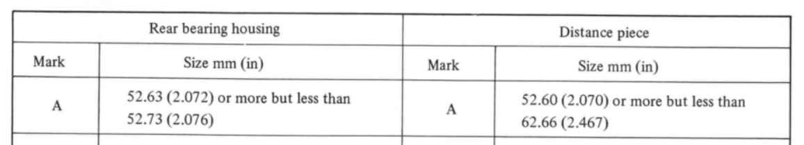

Sometimes we get too caught up in having a number.  The tables show the parts are supposed to be about the same dimension.  The tables are actually kind of nonsensical when you really look at them.  The ranges overlap.
p.s.  funny also that they have a huge error that they even converted to inches.

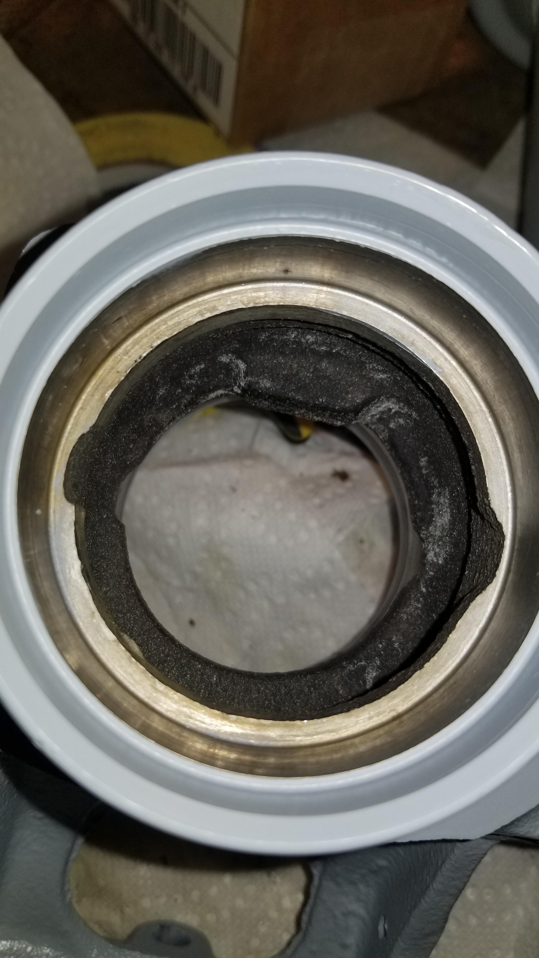

Ok. So I received a package today and headed down to the shop.
The bearings seats all look good except for a little overspray

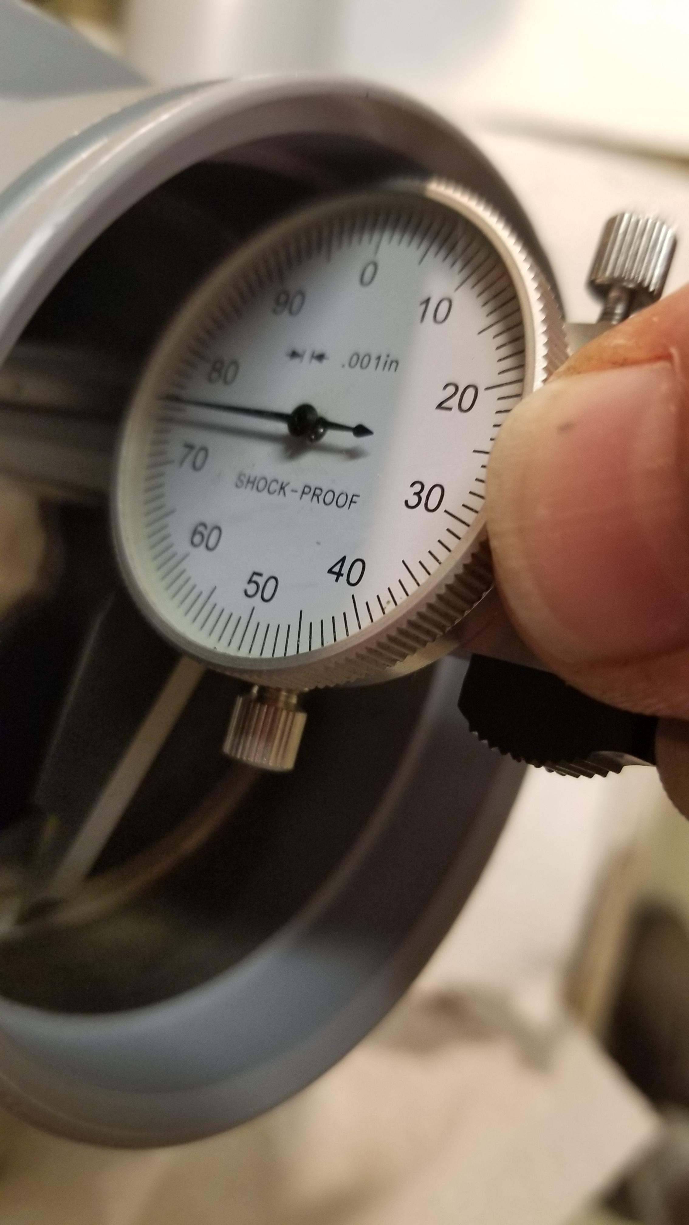

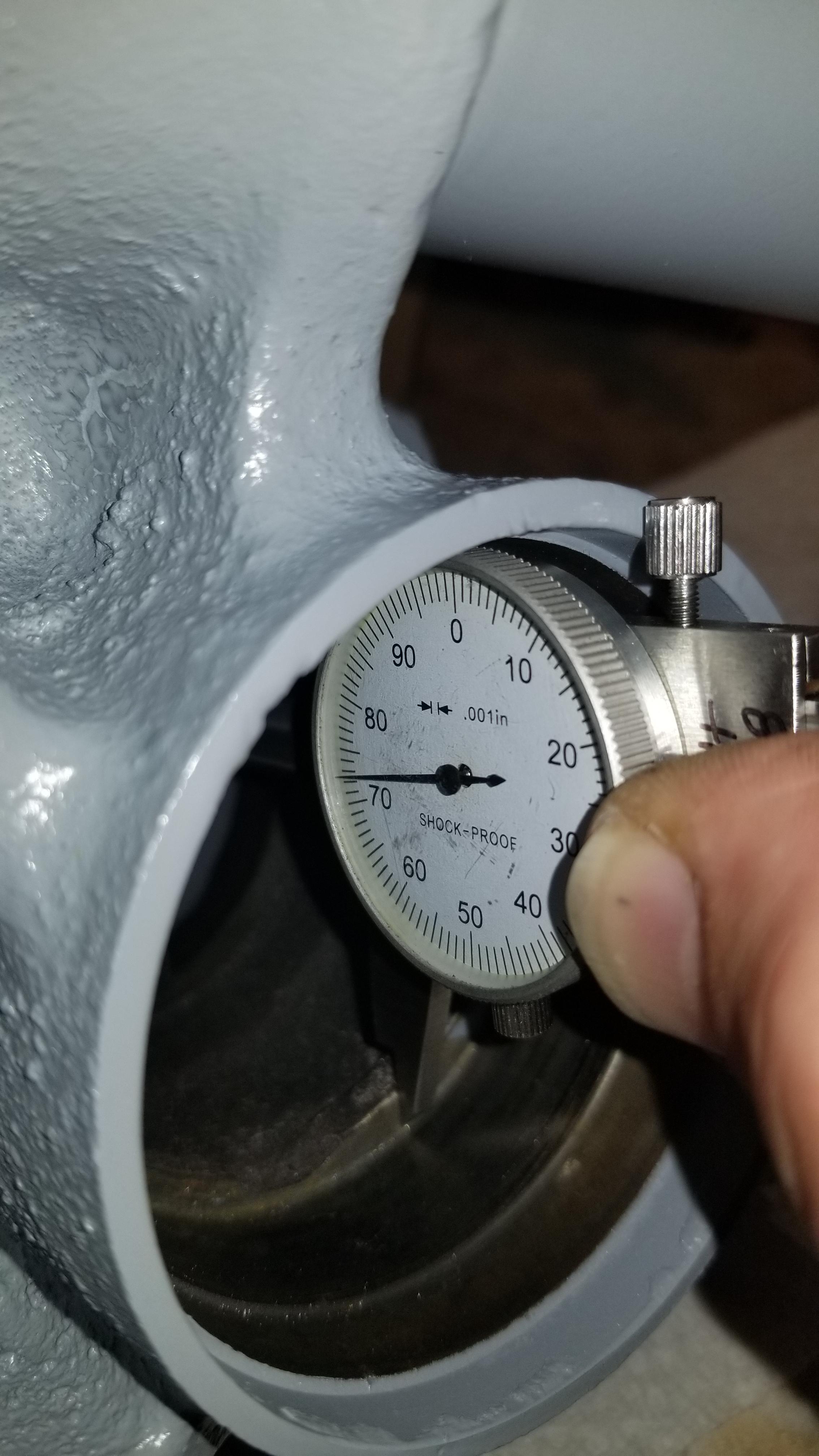

Initially I measured in the scalloped areas. That allowed me to back up against two points and set the heel of the caliper against both sides of the opposing scallop

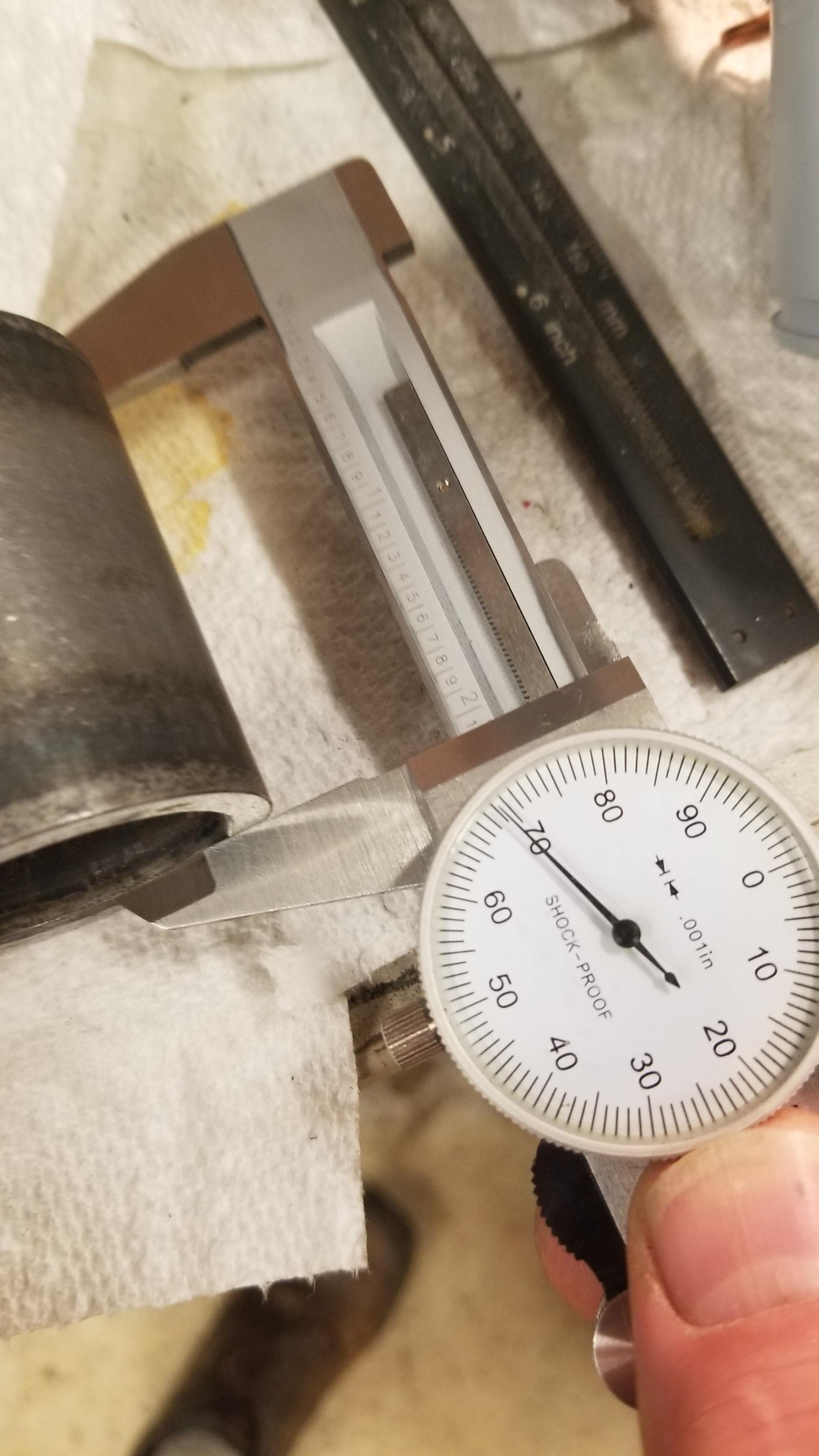

Distance piece

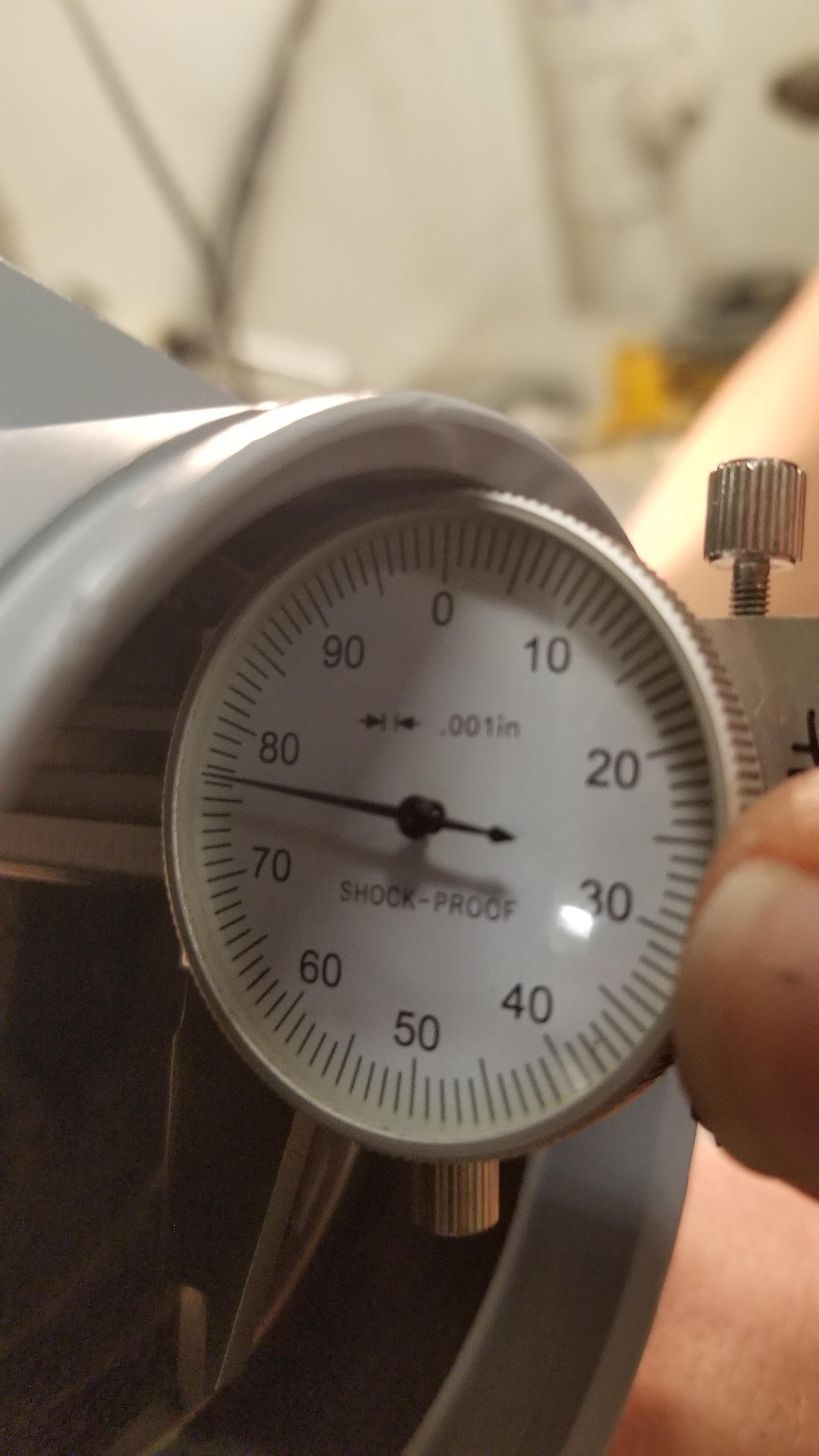

I have another question, how firmly do you hold the caliper? I can easily move the needle 0.005" with finger pressure. I have also found you have to swing the caliper back and forth looking for the smallest dimension to be sure you are square to the bore...
Off of these dimensions, it would appear the bearings are being crushed by roughly 0.007" That seems like a lot of the bearings don't have any slop...?

You are correct the dimensions are much better. Some of that may be because I can use some pressure when measuring as opposed to the way I was measuring. The distance piece is stamped "B". I am assuming it is original. The distance piece from the first side was also a "B" piece. I don't know what these pieces are made out of but they are very hard and dense and tend not to rust.
Yes, you have to wiggle the calipers around a little and look for the minimum dimension. This is because you are looking for the shortest distance between two points and unless you have the calipers perfectly square to the faces which you are measuring, you will be seeing the hypotenuse of a triangle instead of the shorter side.
Problem is, in an application like this, down in a hole trying to register on small surfaces, it's difficult. If you have larger flat surfaces and better access, you could use the wider, flat part of the jaws to make the measurement (like you are doing on the distance piece). But down in that hole on those small surfaces, you are unfortunately limited to using the narrow ground tips portion of the jaws.  So you have to "finagle it".
And yes, the more pressure you apply, the lower the reading. And that phenomenon becomes more pronounced the longer the piece you are checking because you are actually bending springy things a little and the farther apart the jaws, the easier it is to bend the beam between the two of them. So you have to "just get a feel for it".
But on the good side, look at it this way. You have already reduced your hub measurements by at least twelve thousandths. Only a couple more to go!
Try doing things like this... First, the bore where the bearing sits does not have a perfectly square corner at the outside. There is a little rounded fillet down there at the bottom of the holes. Make sure you stay away from that as it will increase your measurement.
Second, wiggle the caliper around while applying a small amount of pressure until you get the absolute minimum you can find. Let the jaws slip around a little on the hub until you get the smallest distance. That should help position the jaws directly opposite eachother and reduce the hypotenuse effect.
Third, move your thumb off the dial, and use the little wheel below the dial to hold the caliper in place, And try to apply the same amount of force every time you take a measurement. See where my thumb is when I'm taking that internal measurement:
I'm completely confident in the external measurement you are making on the distance piece. Try to use the "same amount" of force when making the internal measurement on the hub faces? All of this stuff is where "the knack" comes into play.
From what I see above, my opinion is that last couple thousandths is "the knack" and you have the correct parts.
