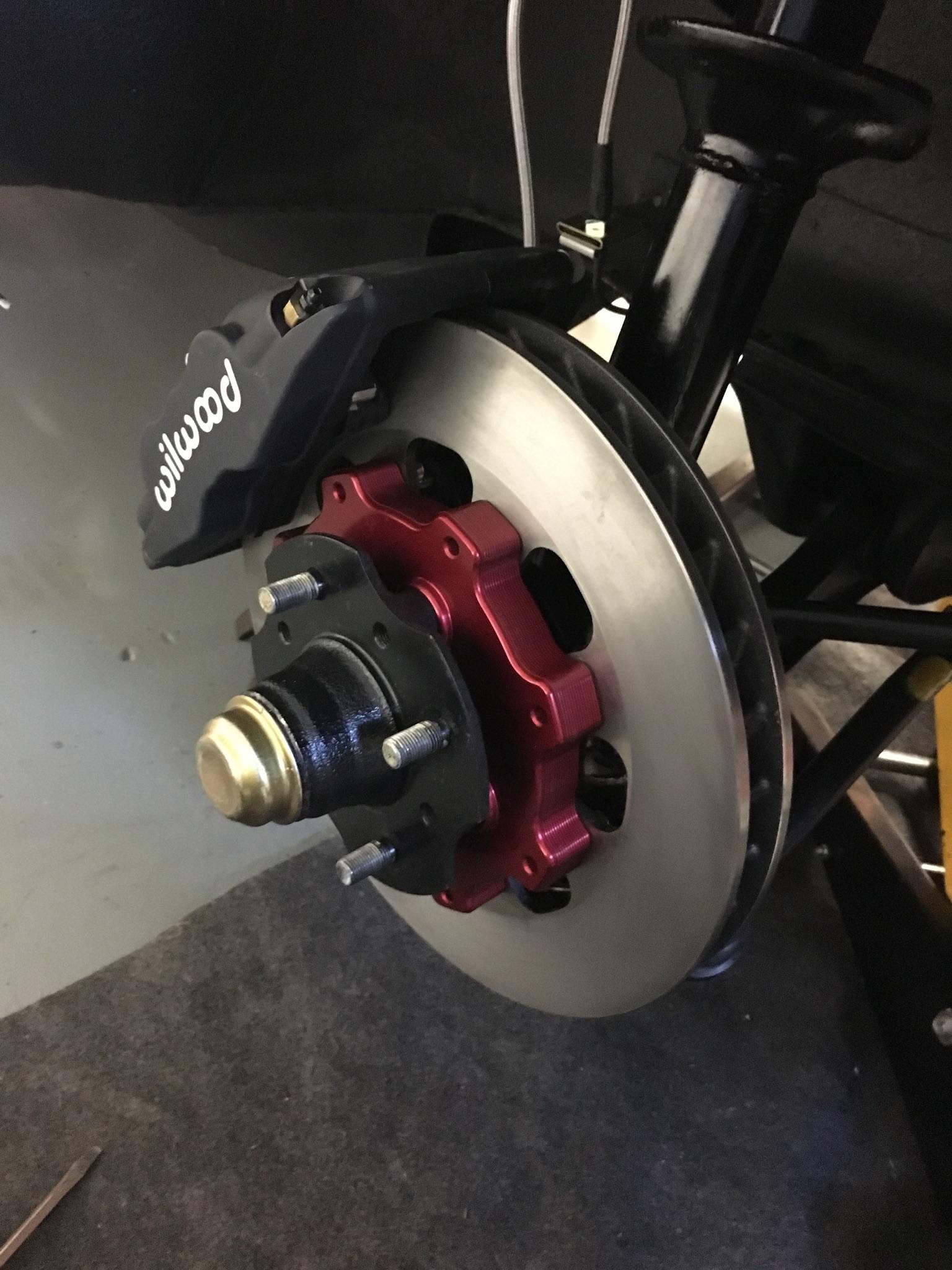

July 29, 20186 yr comment_554075 Charles.....Xmas is coming up soon.....these are an easy install. Link to comment https://www.classiczcars.com/forums/topic/55369-1971-hls30-14938-lily-build/?&page=19#findComment-554075 Share on other sites More sharing options...
July 29, 20186 yr Author comment_554079 22 minutes ago, Diseazd said: Charles.....Xmas is coming up soon.....these are an easy install. You're bad!! I love those thick vented rotors though Link to comment https://www.classiczcars.com/forums/topic/55369-1971-hls30-14938-lily-build/?&page=19#findComment-554079 Share on other sites More sharing options...

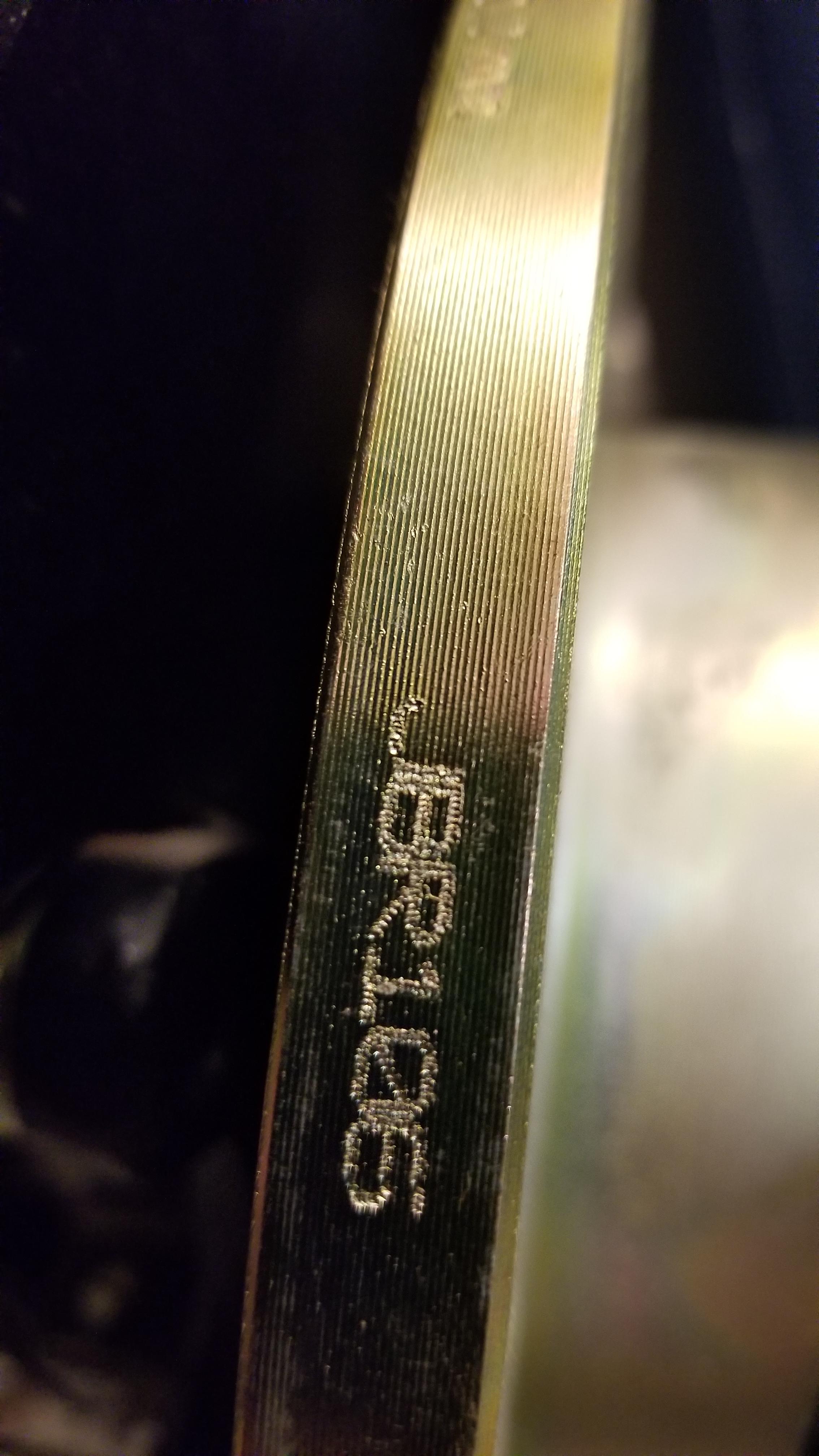

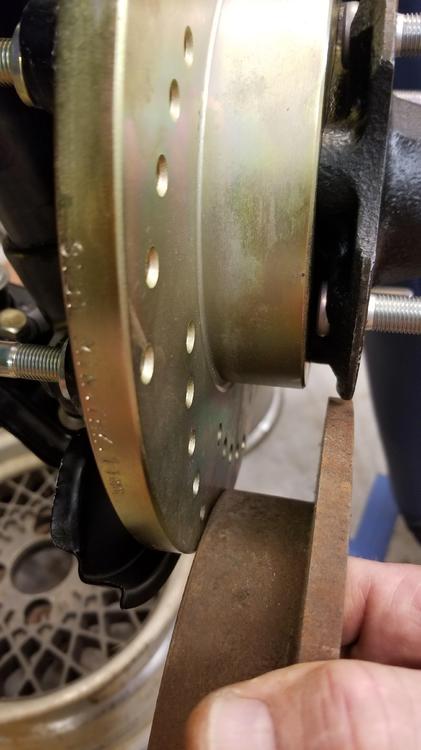

July 29, 20186 yr Author comment_554117 Ok so tinkered with the brakes some more. Really frustrating!!! So the rear calipers won't go on over the rotors I have. The rotors are too large. I am pretty sure I ordered the right ones (82-83 280ZX rears) to work with the 85-86 maxima rear calipers. The ones I have a re 84-85 300ZX rears. I have had them for years so if anyone needs them let me know. They are CTEK 121.42021 drilled On the front the Power stops or Stop Tech ( I can't locate the box) have this number on the edge of the rotor. Doesn't lead any where in Google... The hat height is the wrong height. Here is a stock front disc against the new disc. There is about 0.27" difference in height. That looks like enough to make the calipers work on the front So I ordered some discs today from Rockauto. Fortunately they were on sale. I don't know how to cross reference the front disc to figure out what they actually are Link to comment https://www.classiczcars.com/forums/topic/55369-1971-hls30-14938-lily-build/?&page=19#findComment-554117 Share on other sites More sharing options...
