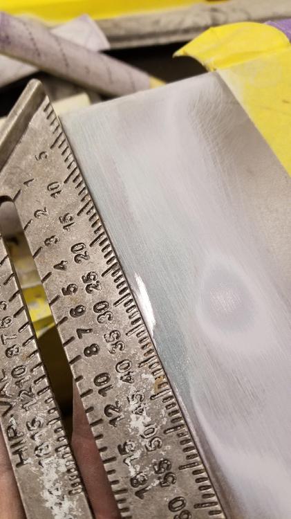

November 5, 20186 yr Author comment_561031 So I think I made progress on the hatch. I rigged up a slide hammer with a wire loop . I had Cody hold the hatch down while I did the hammering. I did some shrinking with the shrinking disc and I over did it. I ended up with divots and had to dolly them back up some Blocked it all down again. The circled spots are low now. I also used the same technique to lift the vent areas on the hatch. It's pretty thin now. It also looks like the lock will work now. I now have to do some filling and reprime the hatch and block it again with guide coat. Link to comment https://www.classiczcars.com/forums/topic/55369-1971-hls30-14938-lily-build/?&page=24#findComment-561031 Share on other sites More sharing options...

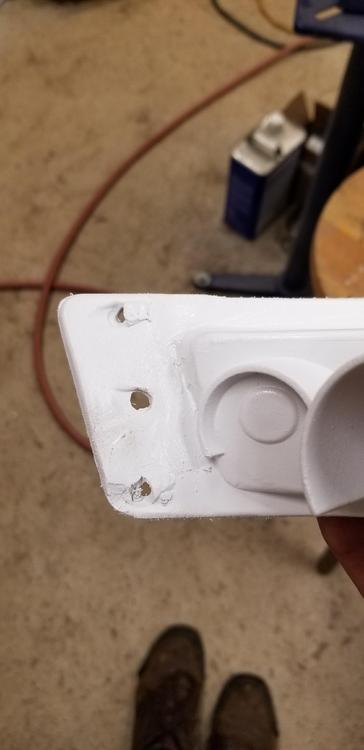

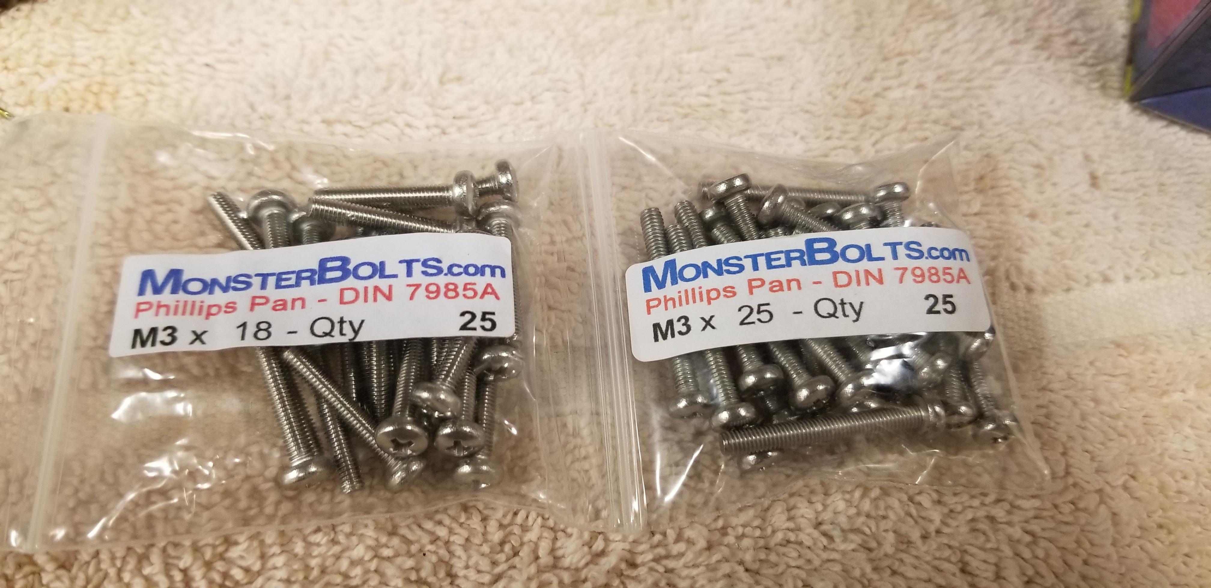

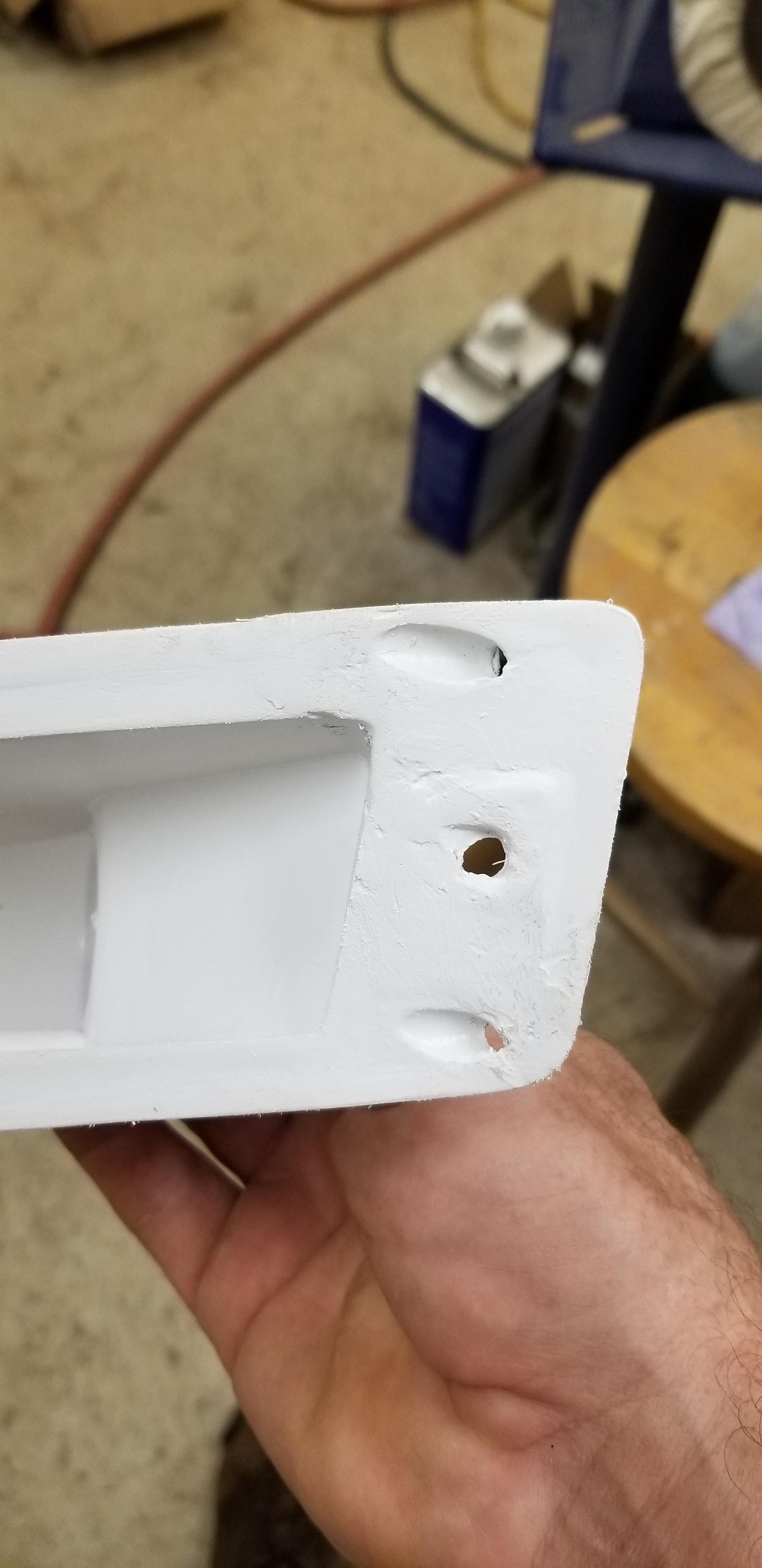

November 27, 20186 yr Author comment_562483 I ordered these screws for the turn signal lenses Here is the finished repair on the one signal body The screws had a small plastic washer on them. I thought I would use a small rubber O ring unless there is a better idea Link to comment https://www.classiczcars.com/forums/topic/55369-1971-hls30-14938-lily-build/?&page=24#findComment-562483 Share on other sites More sharing options...

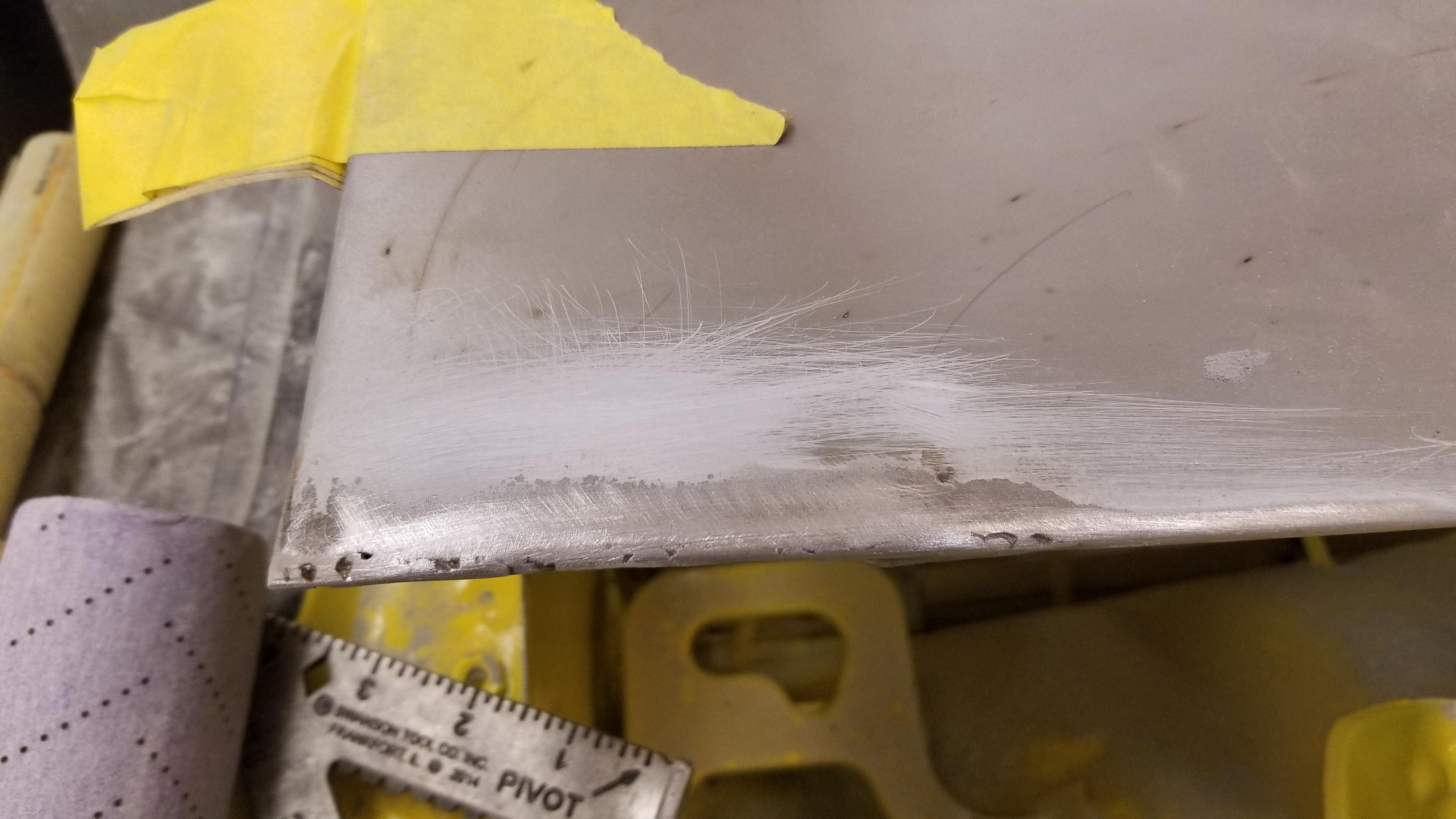

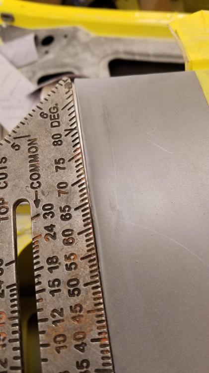

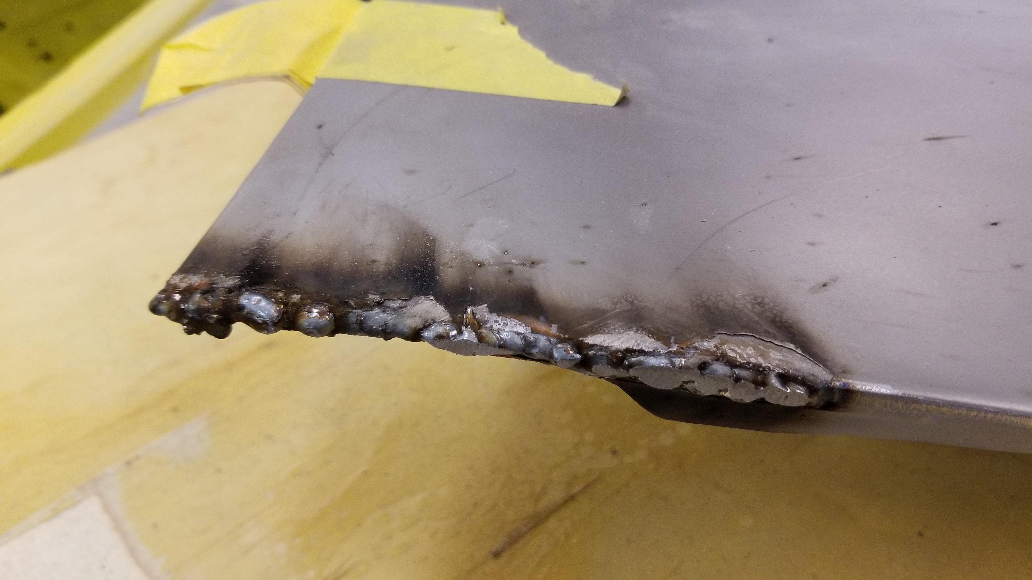

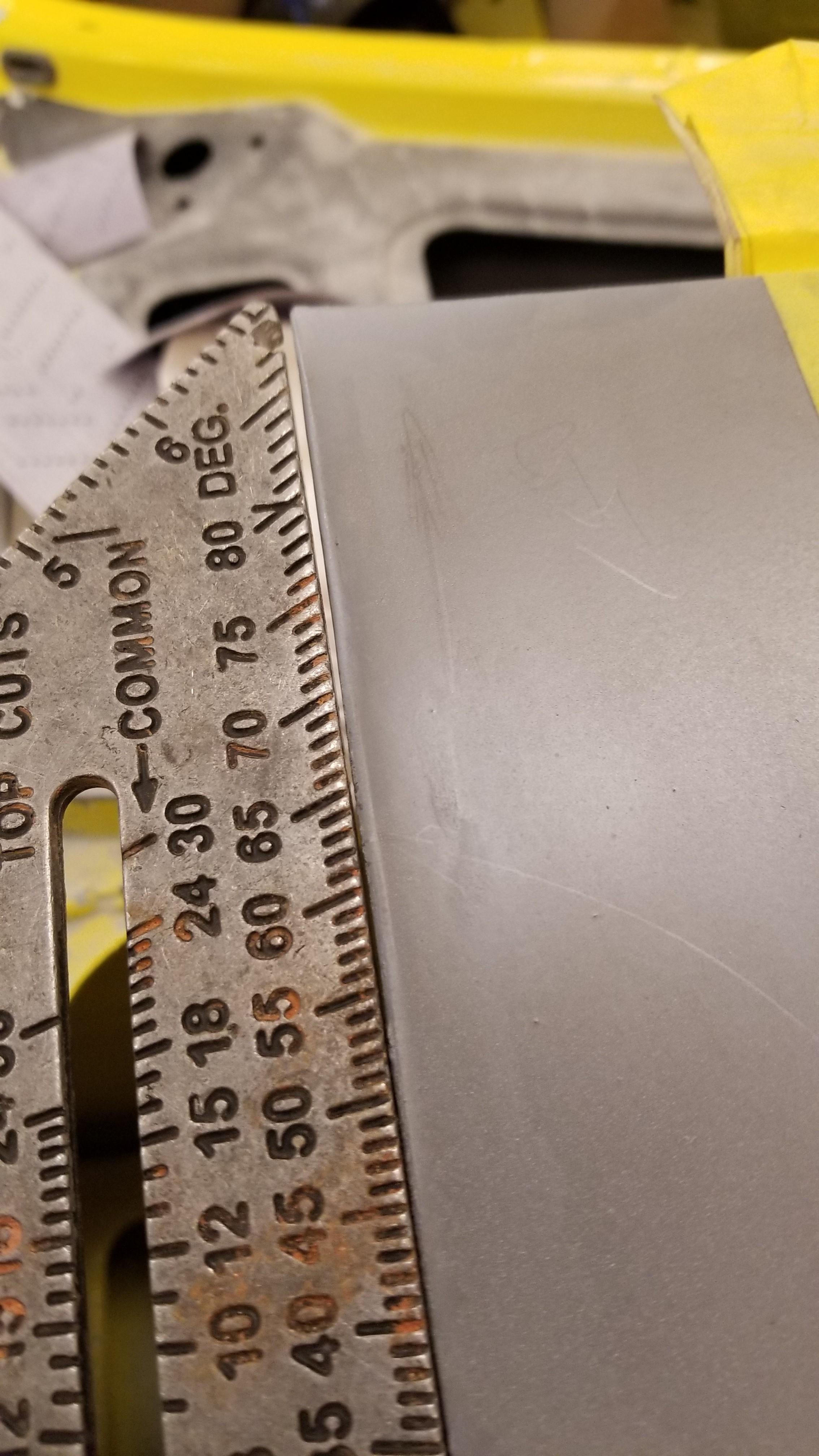

November 27, 20186 yr Author comment_562484 I am in the midst of blocking the whole car and doing the fine filler work. There is always another spot you missed. I am still waiting on my Australian help to arrive! I also had a problem spot on one side of my hood. My hood is a 25 year old after market hood so it has some issues. One was at the upper left corner, it turned in significantly and showed badly against the inspection door. So I added to the edge with the welder. It wouldn't looked so bad if I had stripped the primer back further Shaped it down A little short strand fiberglass to seal it up. It might need a touch of filler, but it is much straighter Edited November 27, 20186 yr by Patcon Link to comment https://www.classiczcars.com/forums/topic/55369-1971-hls30-14938-lily-build/?&page=24#findComment-562484 Share on other sites More sharing options...

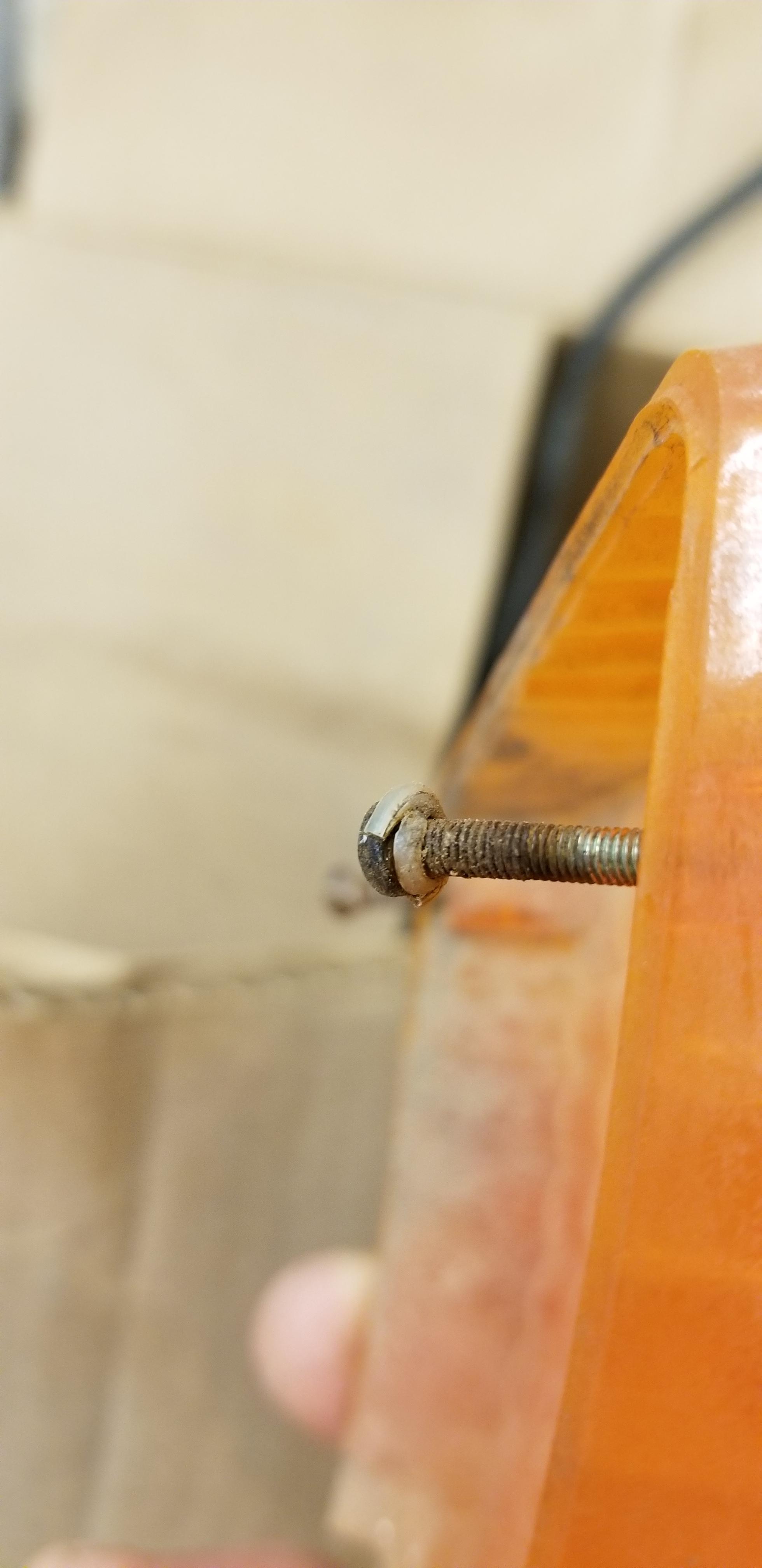

November 27, 20186 yr comment_562491 At least you had screws! Link to comment https://www.classiczcars.com/forums/topic/55369-1971-hls30-14938-lily-build/?&page=24#findComment-562491 Share on other sites More sharing options...
November 27, 20186 yr Author comment_562510 10 hours ago, 240260280 said: At least you had screws! Wow! Those don't look too good. Is that just a rusty glob or something else? It looks like the lense is cracked and all gobbed up Link to comment https://www.classiczcars.com/forums/topic/55369-1971-hls30-14938-lily-build/?&page=24#findComment-562510 Share on other sites More sharing options...
