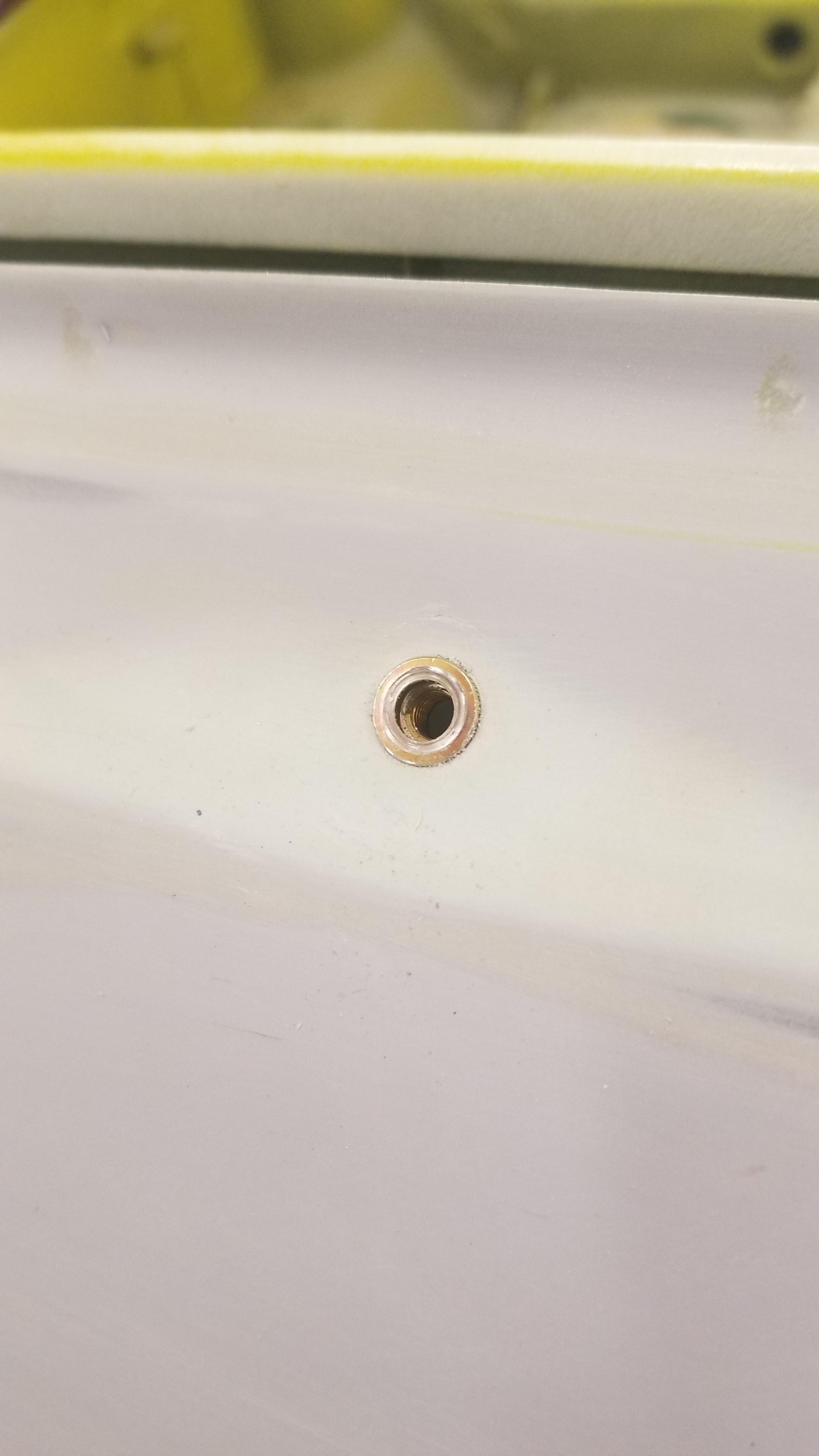

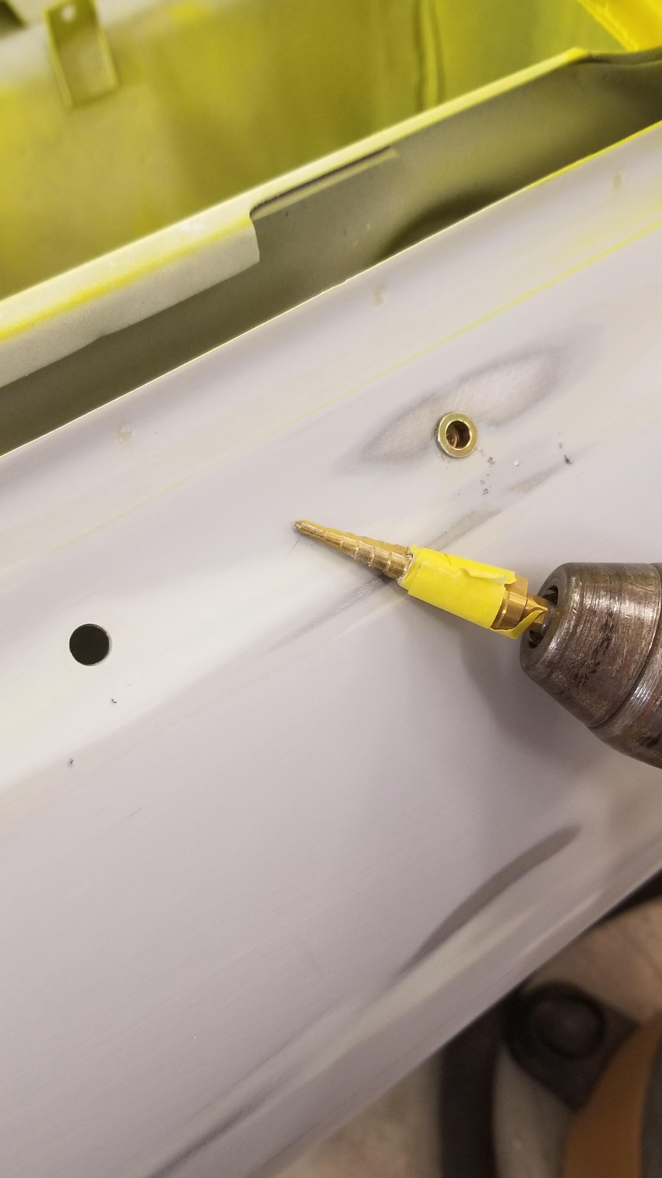

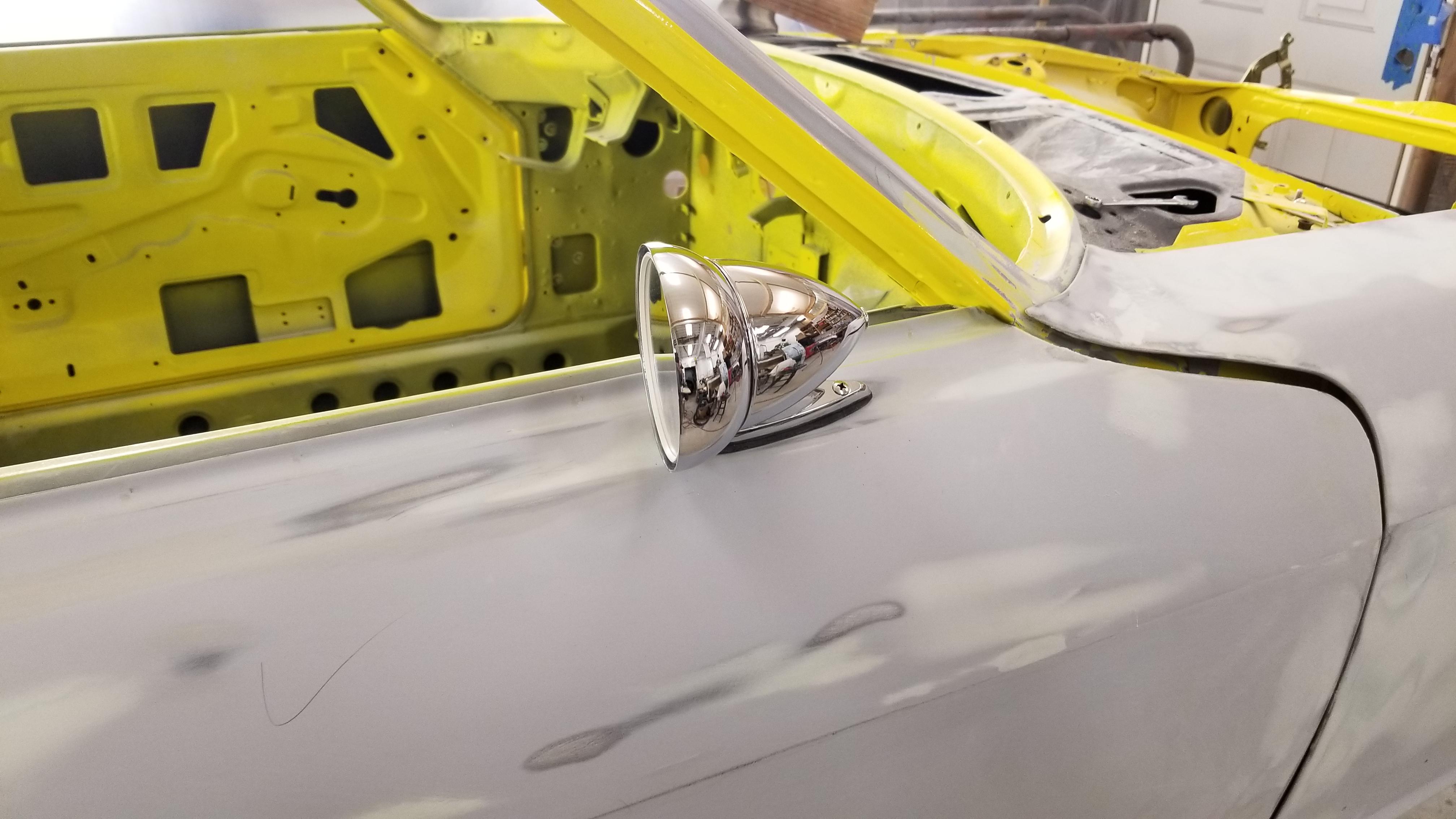

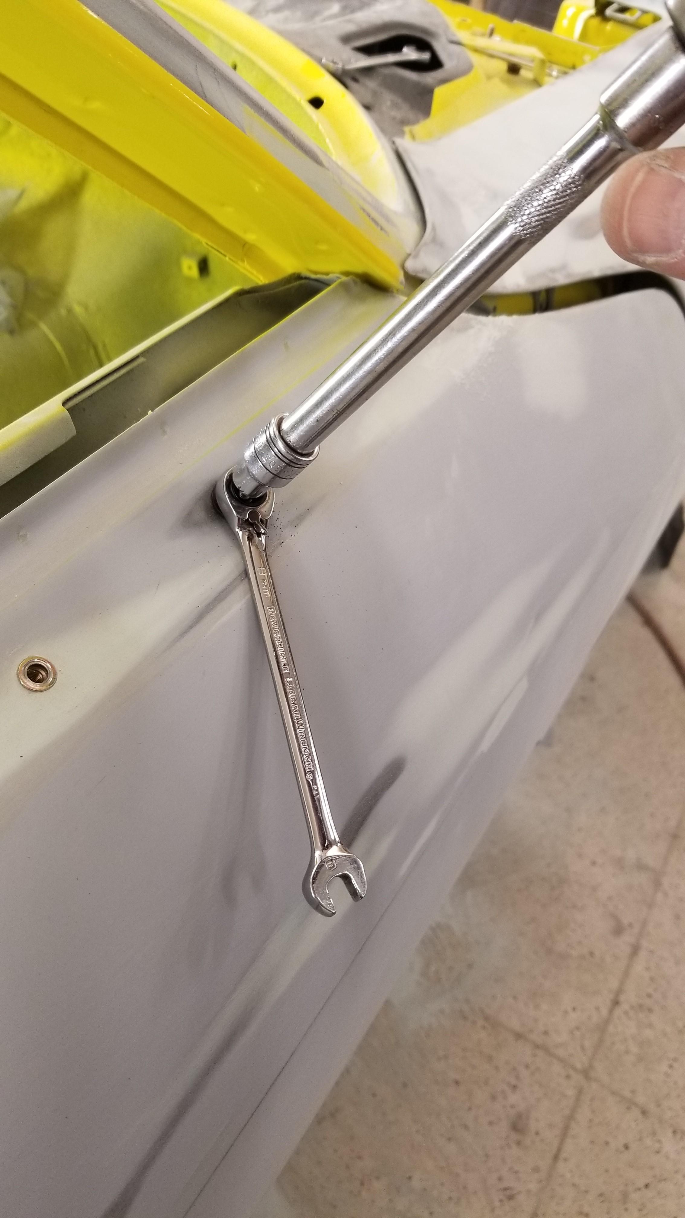

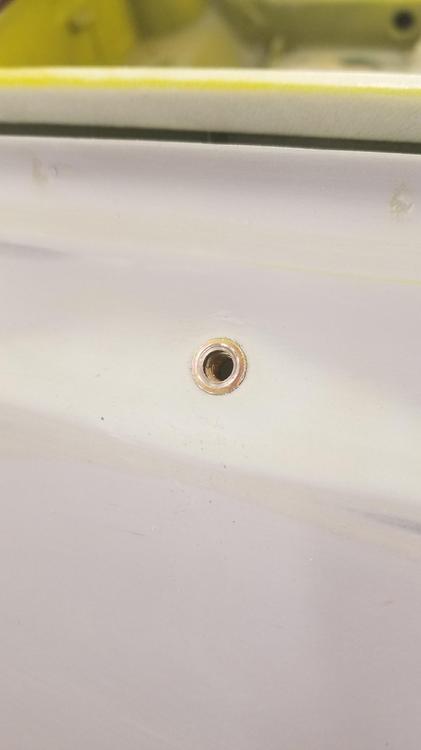

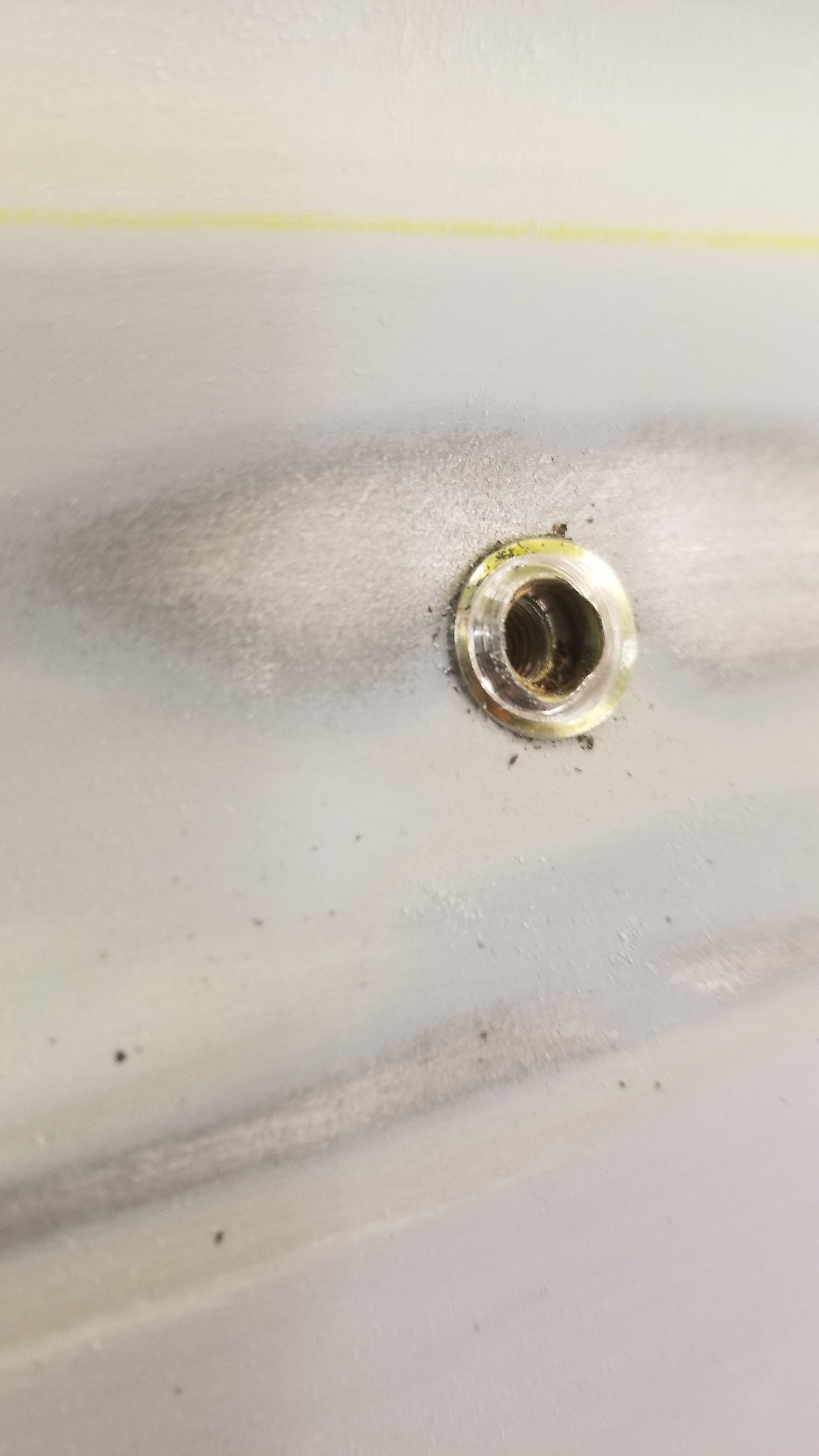

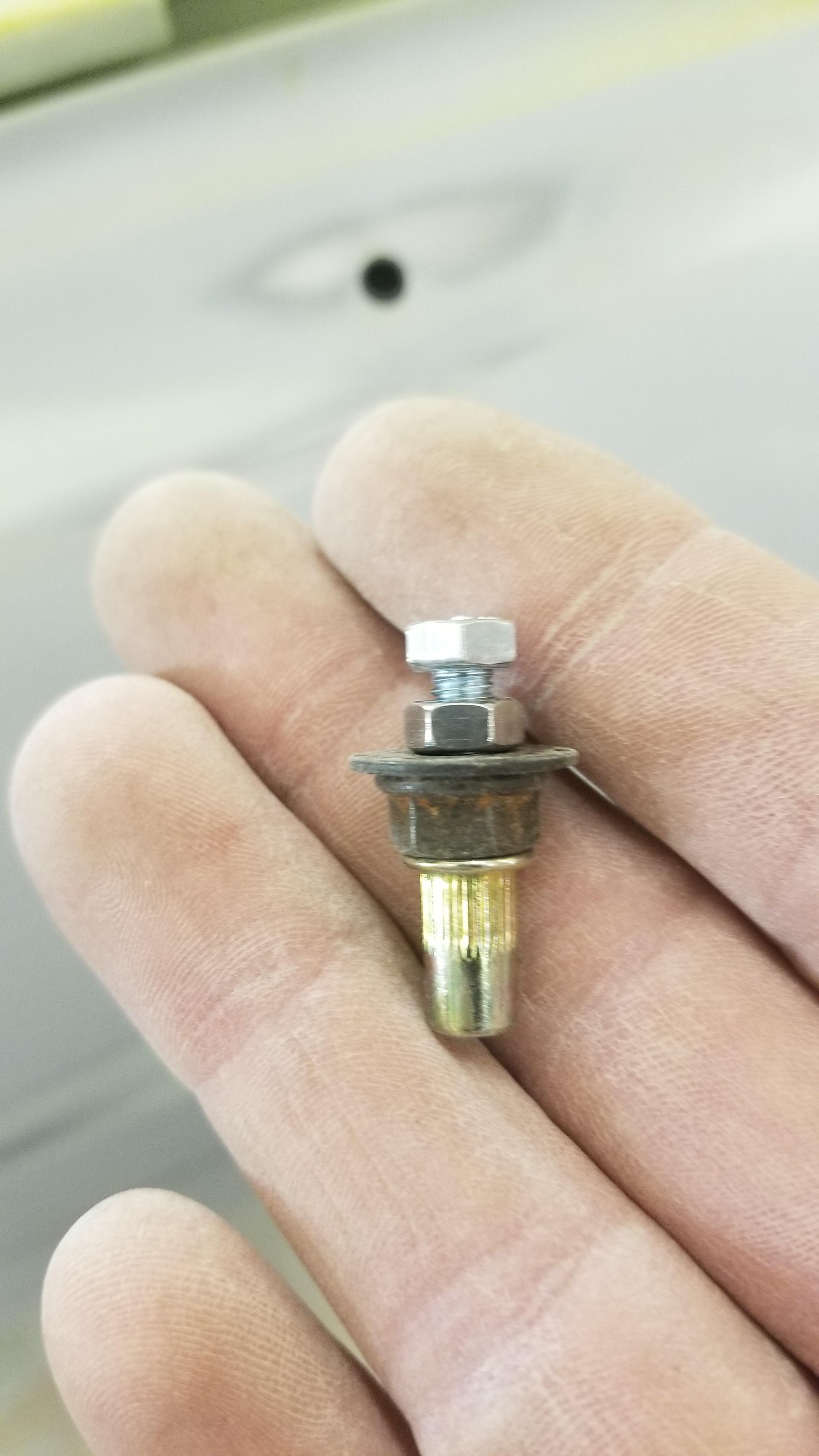

December 10, 20186 yr Author comment_563485 So I did some more blocking tonight. Also worked on getting the new mirrors mounted. I bought a kit with an assortment of metric rivnuts. I also ordered some oval head 5mm SS screws from Ebay. Matched up the rivnut diameter to a step drill and enlarged the holes in the door. Then made an attempt with a self made tool, and the result The nut I had on the bottom was a different diameter and pulled some of the threads up. So I drilled that one out and redid it. I used a small washer with a larger one on top to make it easier to tighten down the 5mm nut. So I ended up with this, by using a ratcheting wrench and a socket You need to apply a good bit of downward force to keep the rivnut from spinning in the door. Once it starts to expand it gets easier. A new door mirror mounted up  I like these mirrors. I sourced them off Ebay a number of years ago, but what I like about them is the passenger mirror is a wide view mirror and the drivers side is normal. I haven't seen them again Link to comment https://www.classiczcars.com/forums/topic/55369-1971-hls30-14938-lily-build/?&page=27#findComment-563485 Share on other sites More sharing options...
