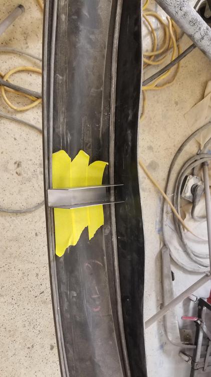

I am planning on using Fusor 411 (?) for skimming the ends of the air dam where I reworked the ends for the bumper slots. The bars I made fit inside the front lip and behind the front crease. So I was planning on using the Fusor to glue the bars to the inside of the air dam. That's the plan, I don't know if it will work or not.

Fusor 401, Yeah, something like that. I did a lot of research for products that I could use for filling a urethane air dam. A pretty specific task. Fusor was one of the products and I have used them in the past. That's probably what I'll use...

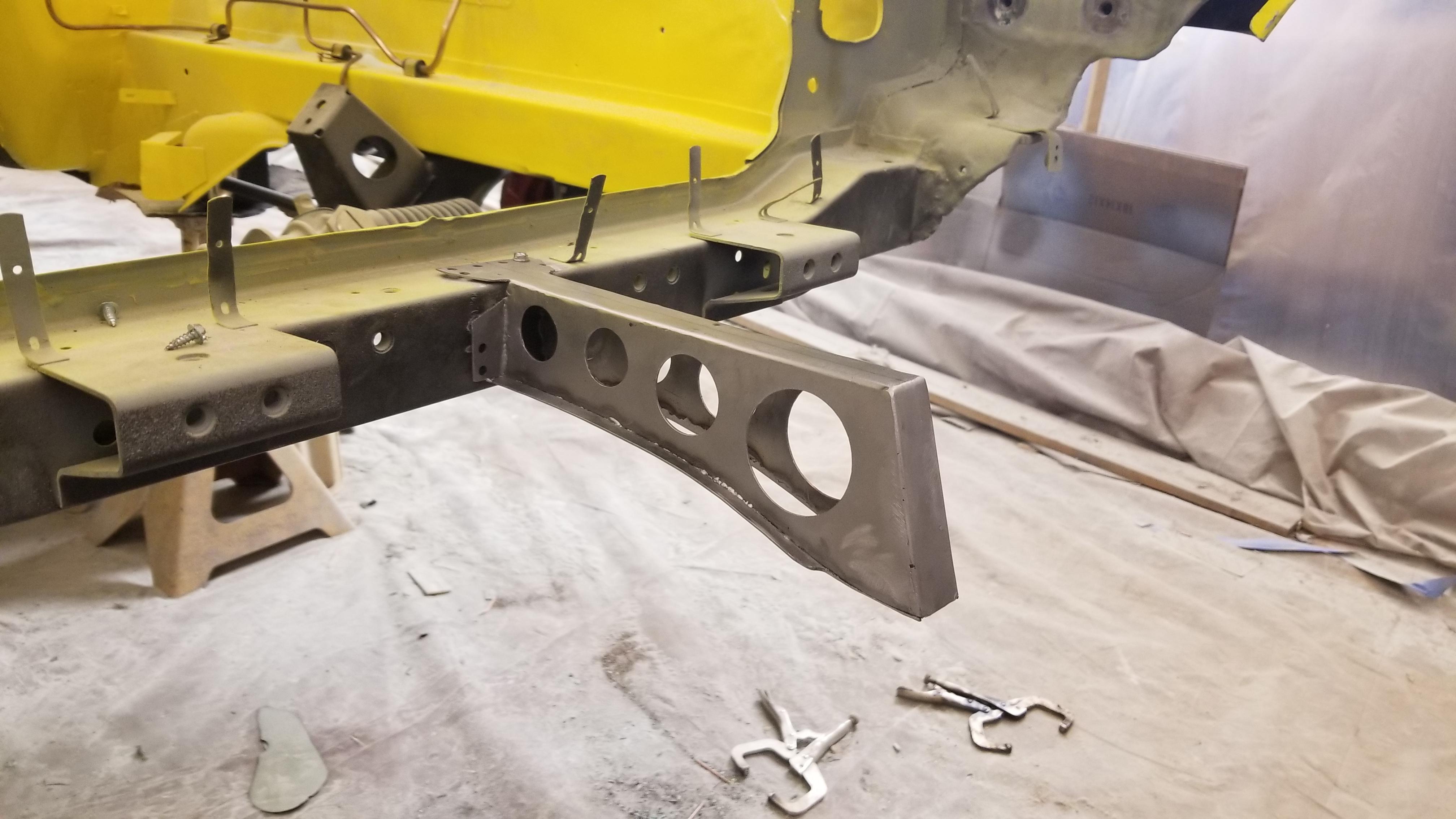

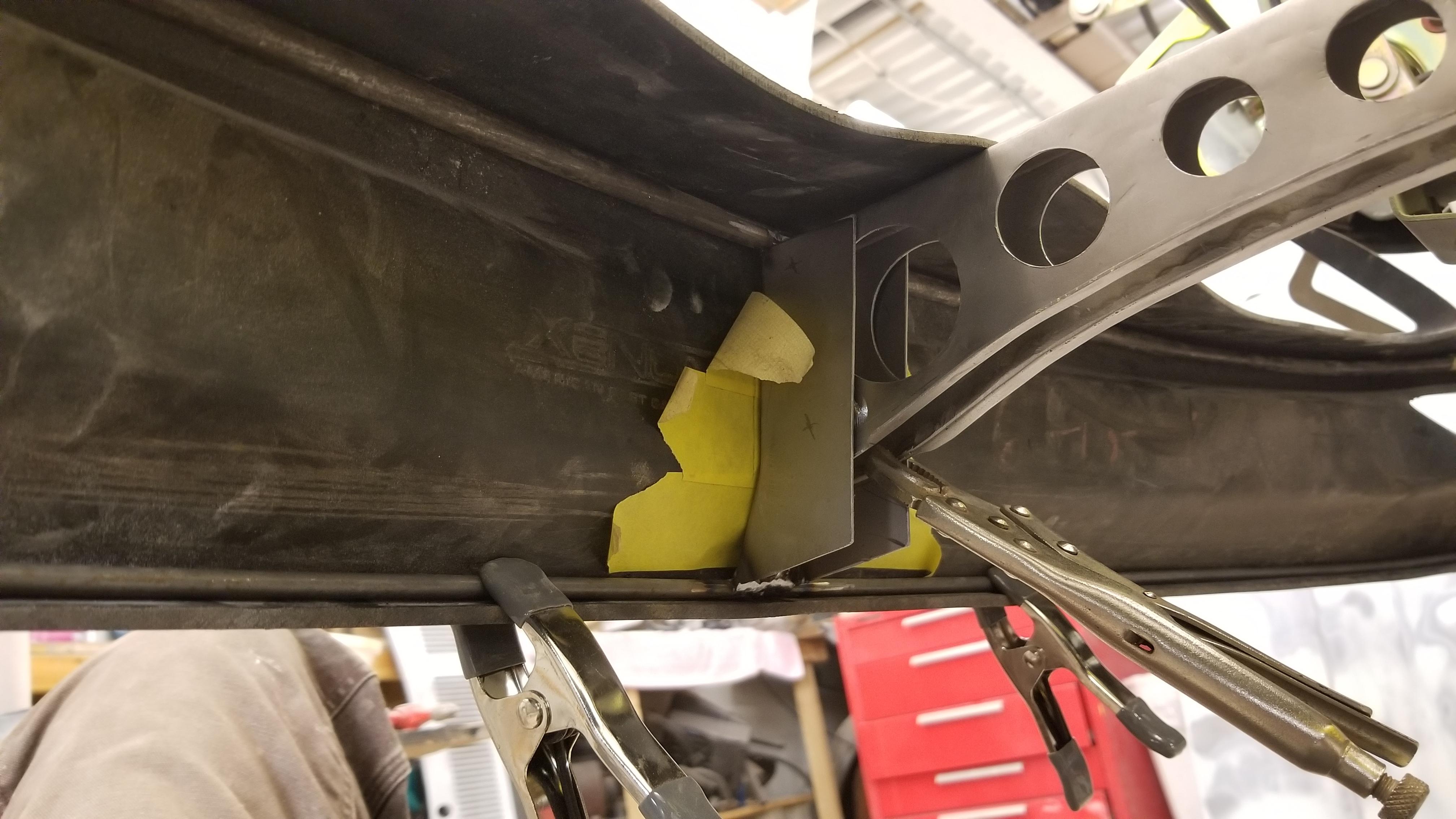

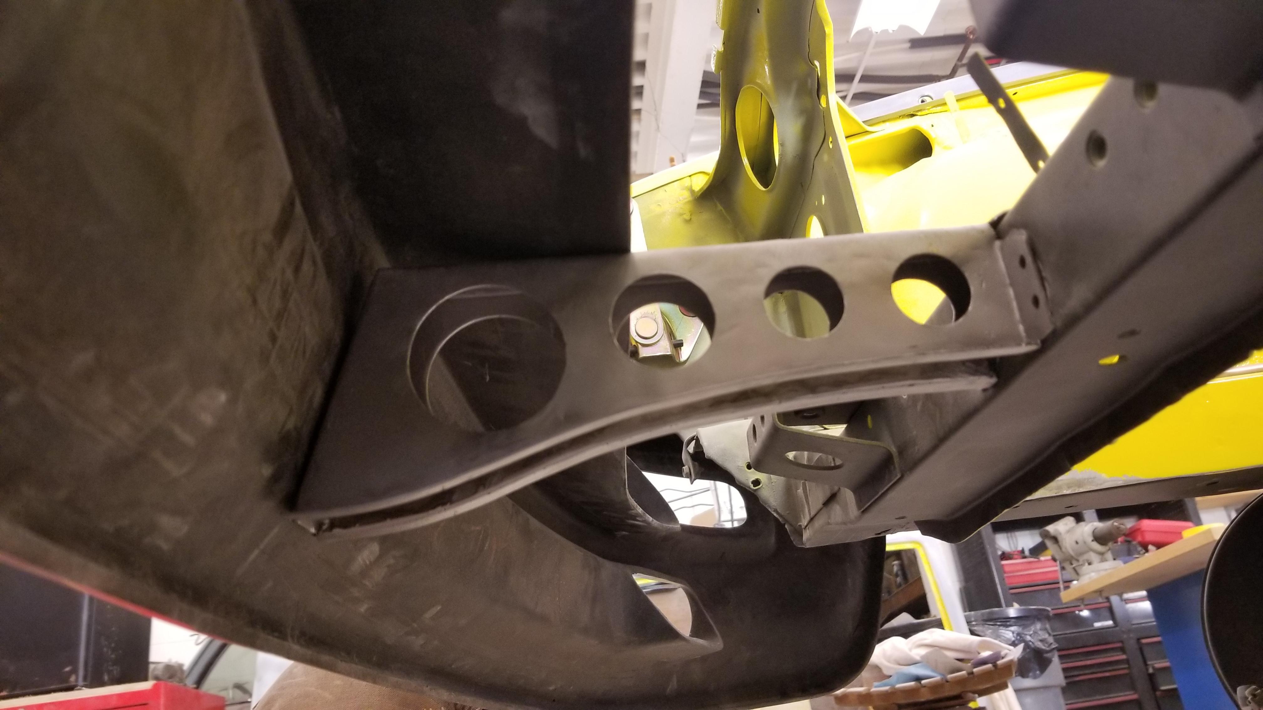

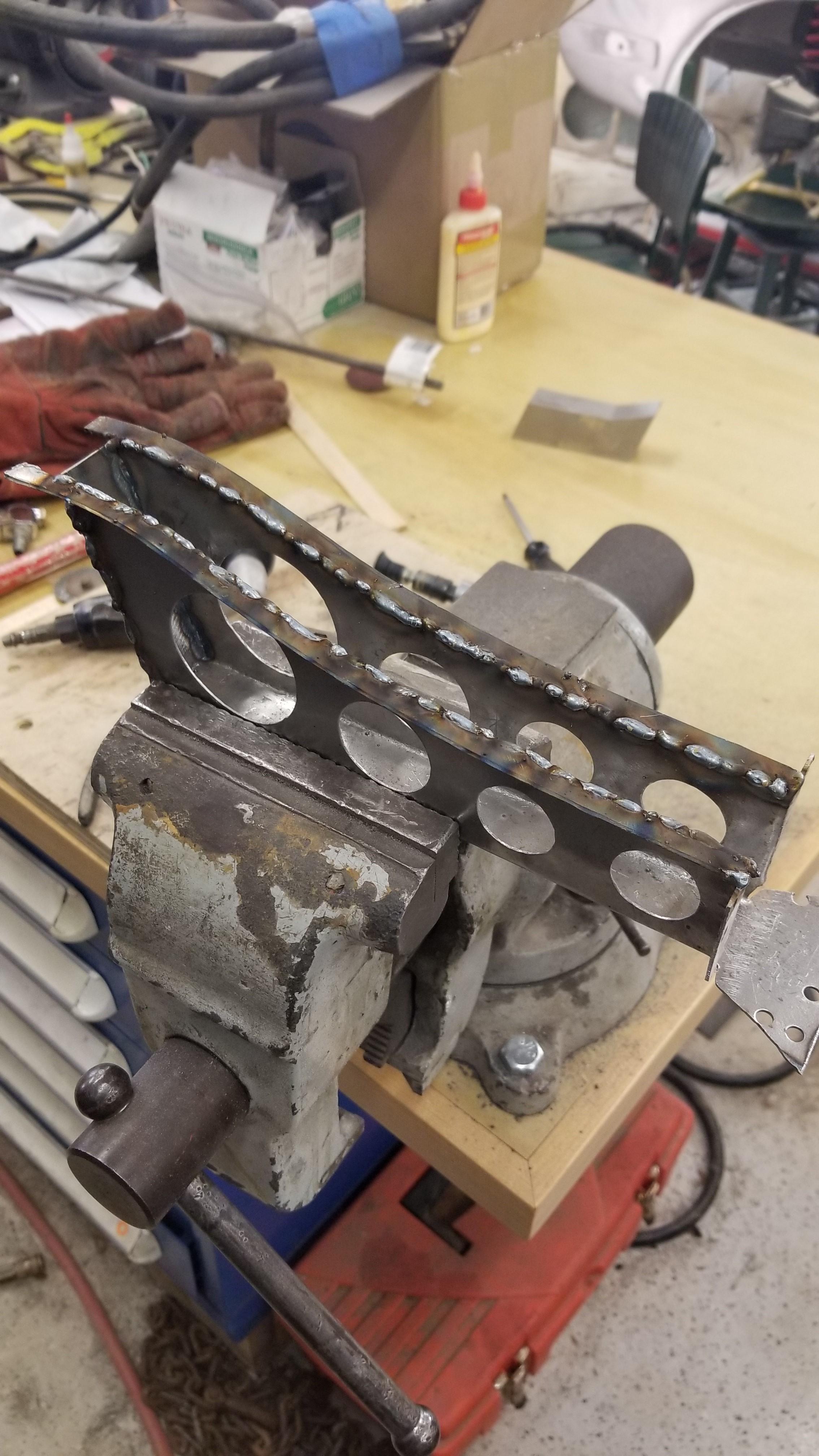

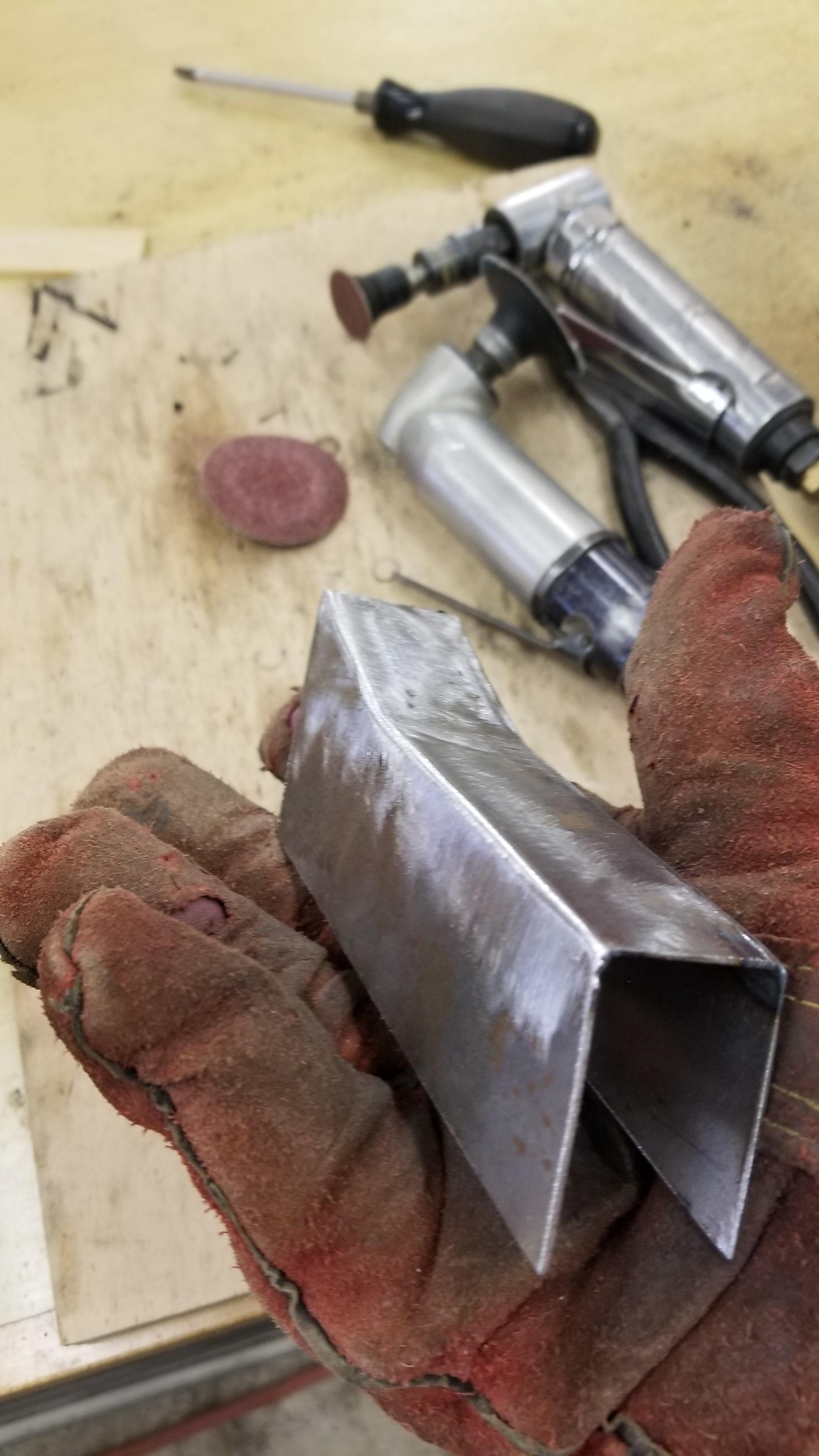

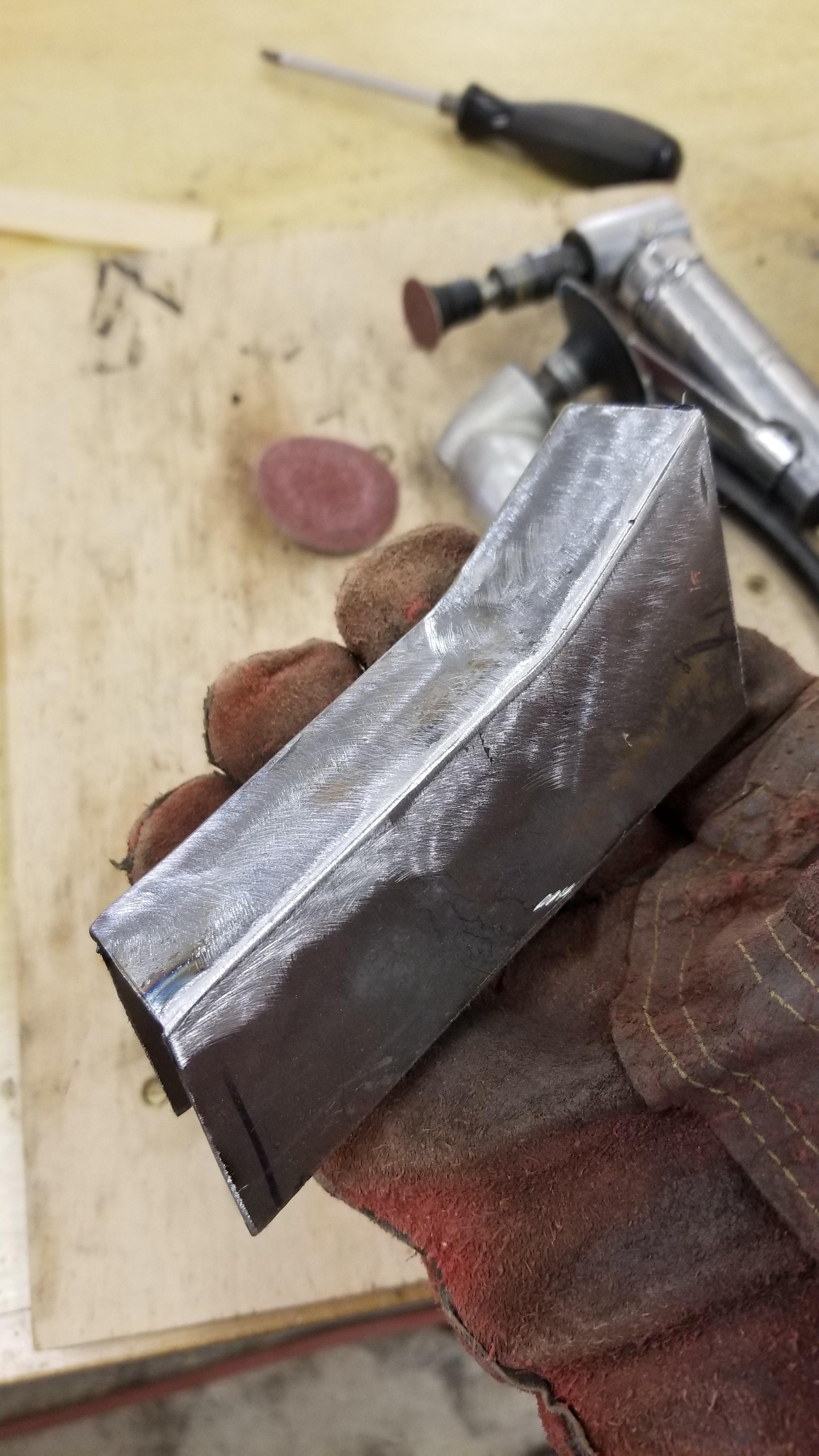

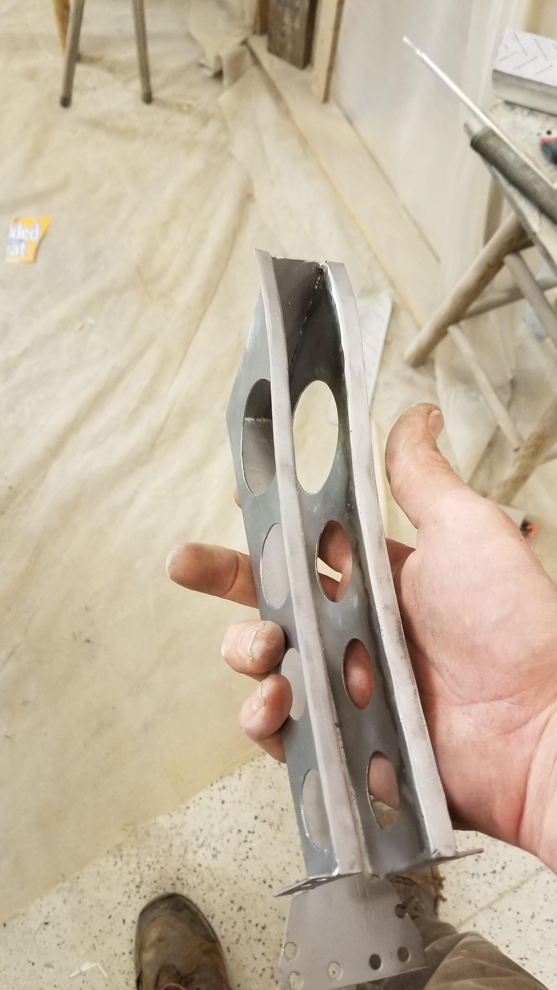

Did some more work on the air dam support

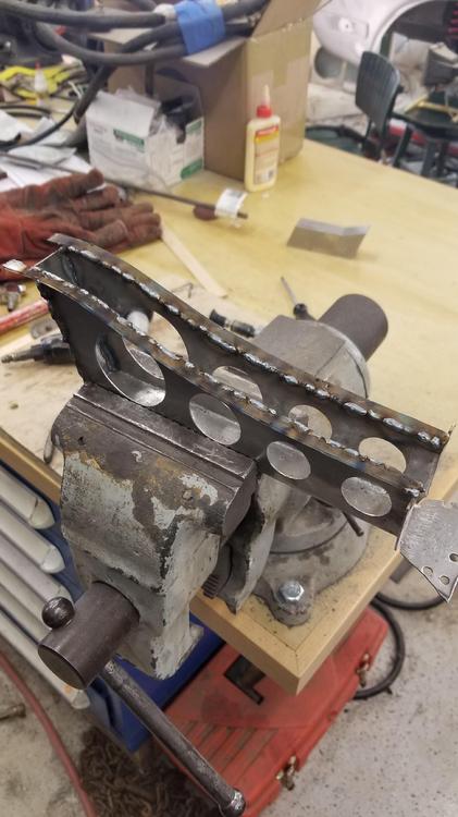

Here is the air dam side bracket
Added some flanges
20181222_151935.jpg20181222_160709.jpg20181222_162119.jpg20181222_165508.jpg20181222_170427.jpg20181222_171154.jpg
I will drill some through bolts for final mounting.

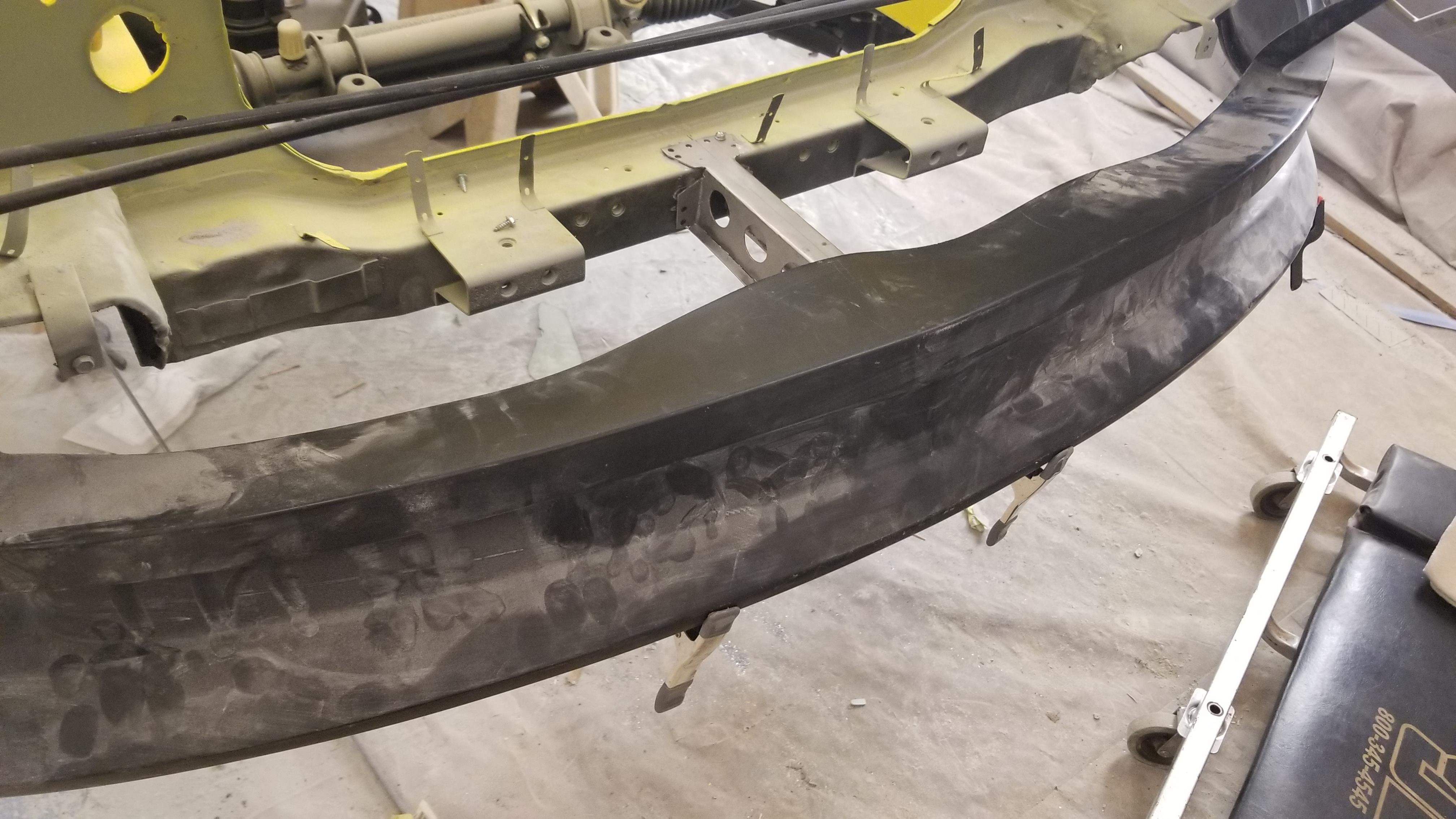

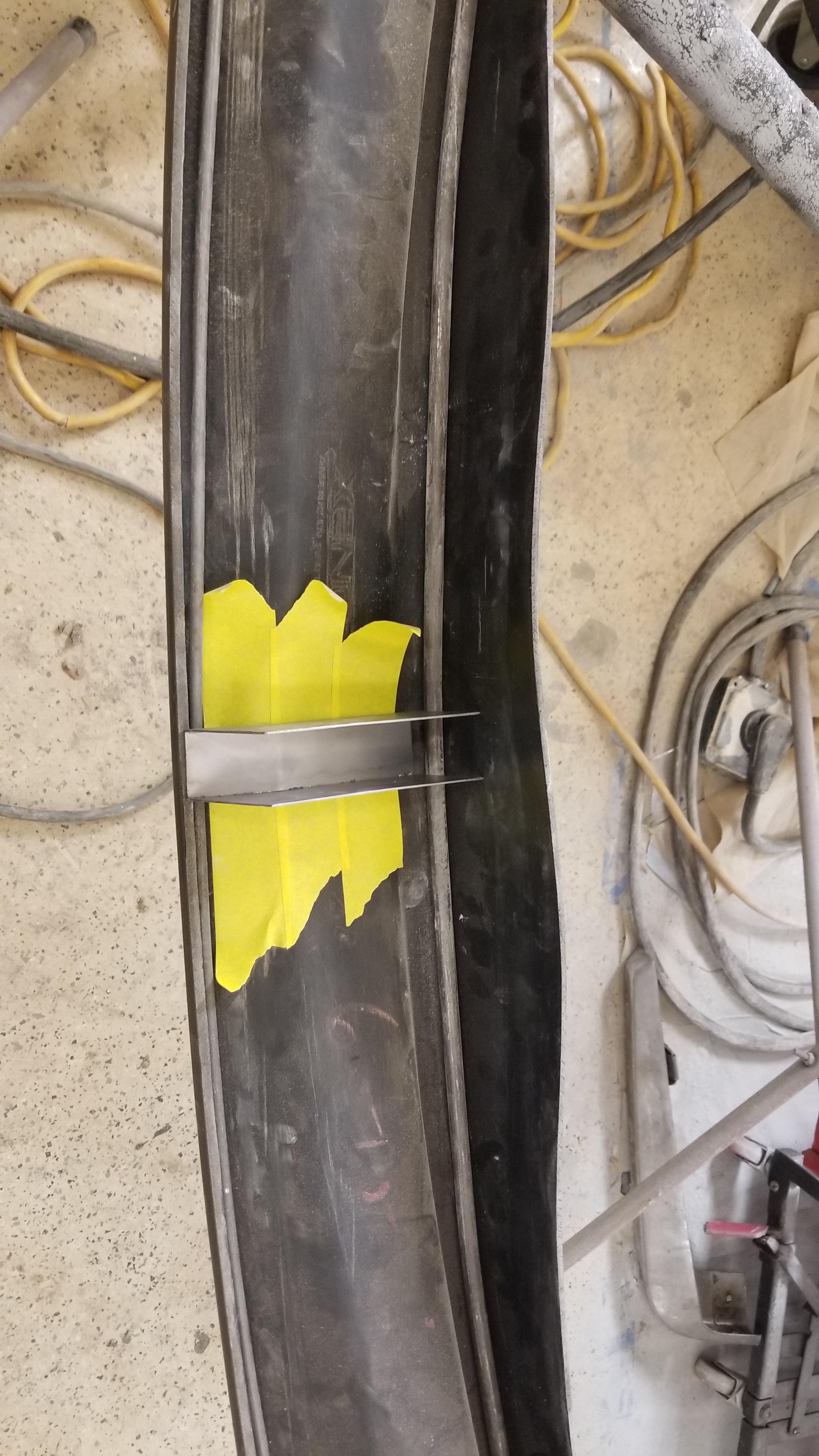

For those others that have used the Xenon air dam. Do they have this waviness on your install? I used a heat gun on it some today. It got better but I can't get rid of all of it.
If I push the upper bar forward it reduces this waviness but it is sort of frustrating. If it was a TPO bumper and not urethane I would cut it and take the waves out. But that won't work on urethane

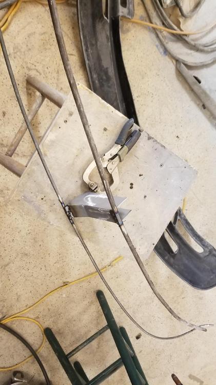

Very slick, I like the frame. I can't believe I didn't take any pics but I made a template of the top wavy part out the same aluminum sheet I used for the splitter and cemented and bolted it in underneath with decorative smooth heads on them.

Yeah, I was a little disappointed that I needed to do this much tweaking. The waviness comes from the sugar scoops being further apart than the xenon mold expects. I don't know if this is always a problem but so far the two of us have had to deal with it.
I am hoping the Fusor will bond the frame tight enough to the air dam that if I want to tweak the shape near the wheel wells I can reshape the bars slightly to change the shape.
