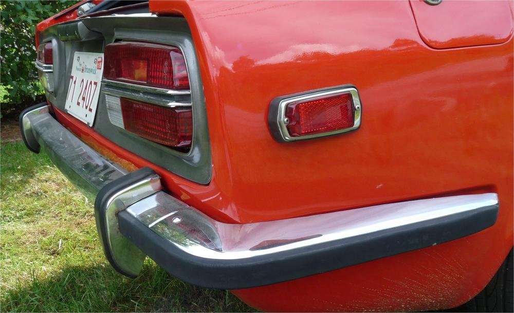

13 minutes ago, w3wilkes said:
If you still want the bumper installed picks here's 3 shots of the bumper/valance spacing on my series 1 car, both sides and center. Looks like it's about 3/8's all the way across.
Thank you for that! It's nice to see it's consistent with the bumper curve. I had roughly 3/8" on the ends and 3/4" in the middle. I suspected it was 3/8" all the way across.
Merry Christmas

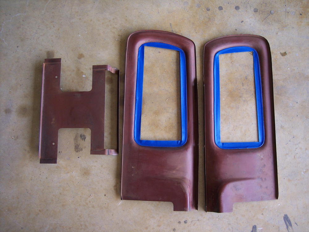

I also worked on the rear finisher trim. I wanted to get the trim off so I could strip the panels and paint them. I did manage to get it off. So I can clean it and polish it. Then I will reinstall it, I hope.
My two big concerns are, can I get it back on and will it scrape the paint off when it goes back on. We'll see...
Edited by Patcon
That rear valance is looking a bit like FrankenZ with all that stitching! LOL  I've always been too chicken to try and remove the stainless trim on the rear finisher.  I choose to blue tape it for my refinish work.  Two sets completed and on the shelf now.
Edited by jfa.series1
I thought about that, but they was some rust near by and I was concerned it was underneath the trim. Hoping if I go this route and remove all the rust. What did you use for refinishing the panels?
Also, as an aside, these panels are EASILY bent. They can also be straightened by hand if needed.
