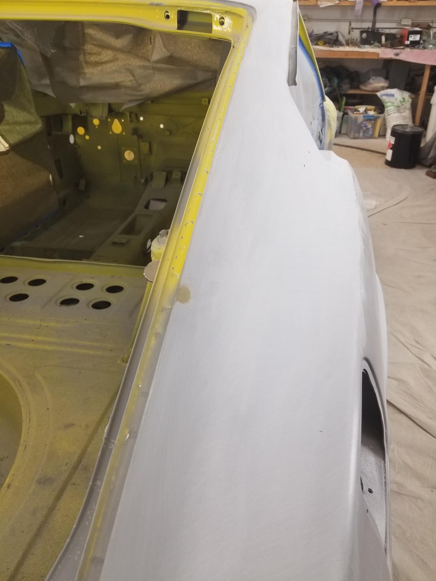

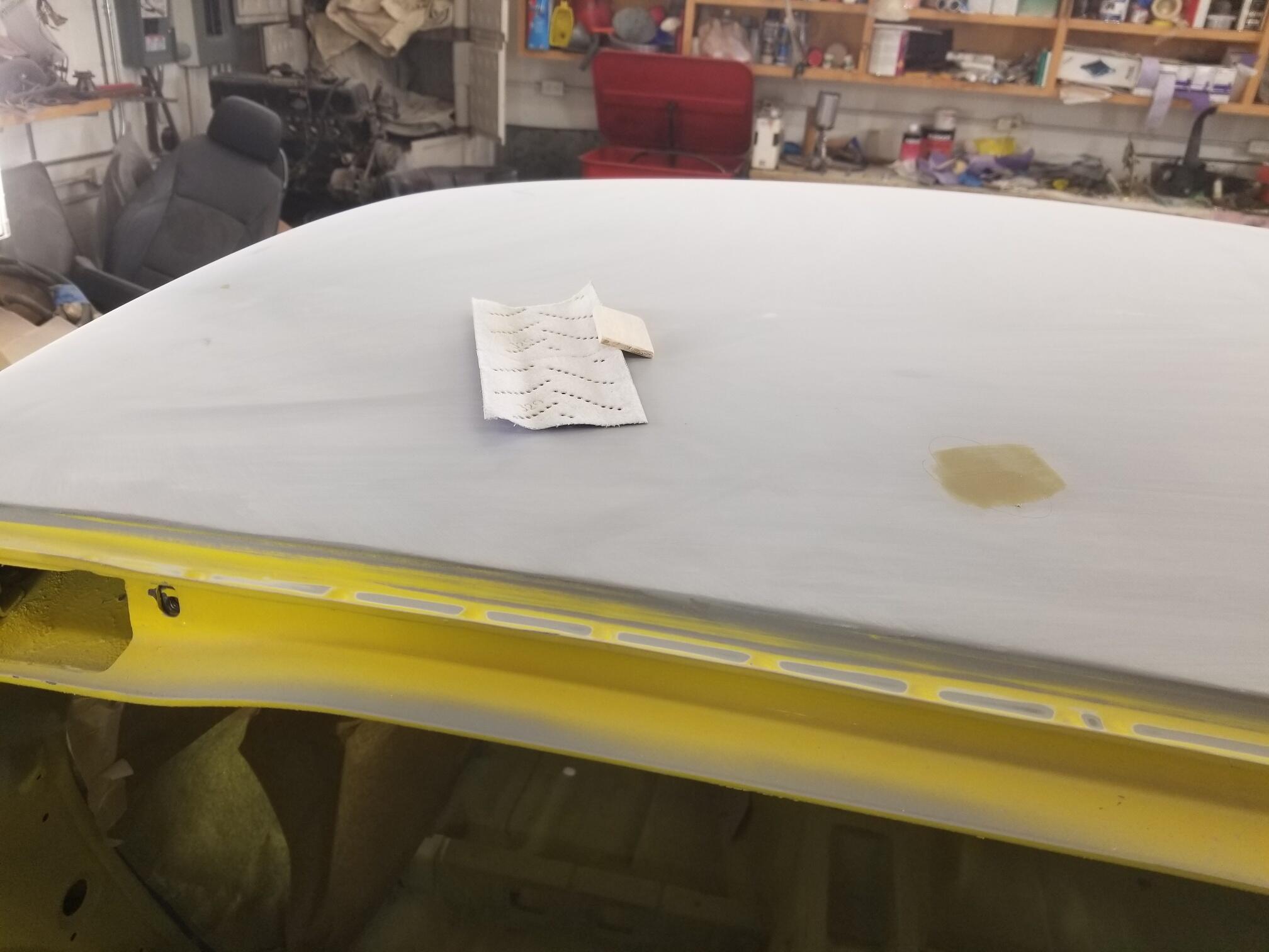

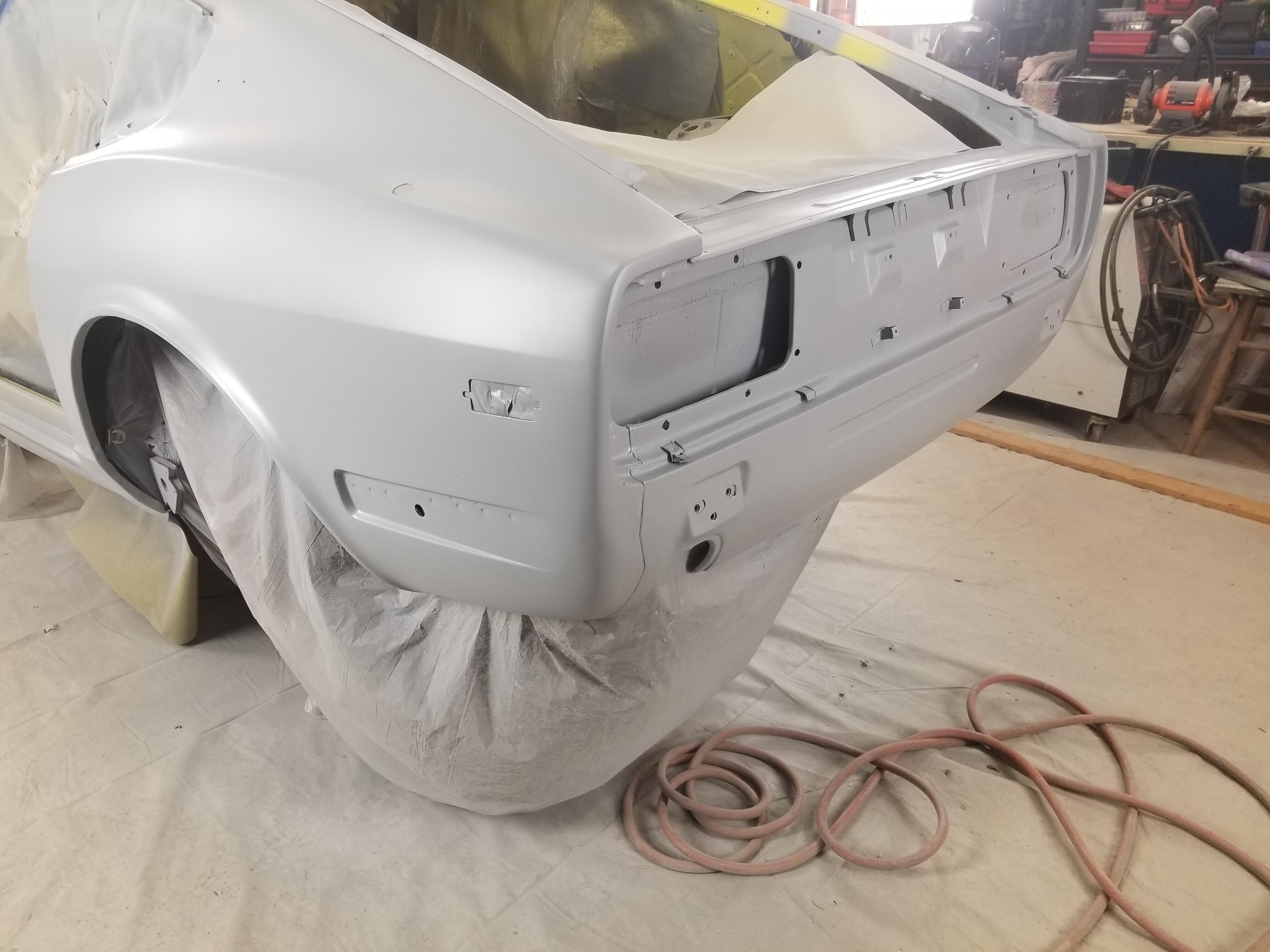

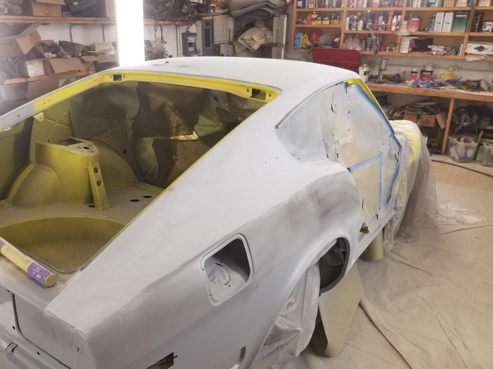

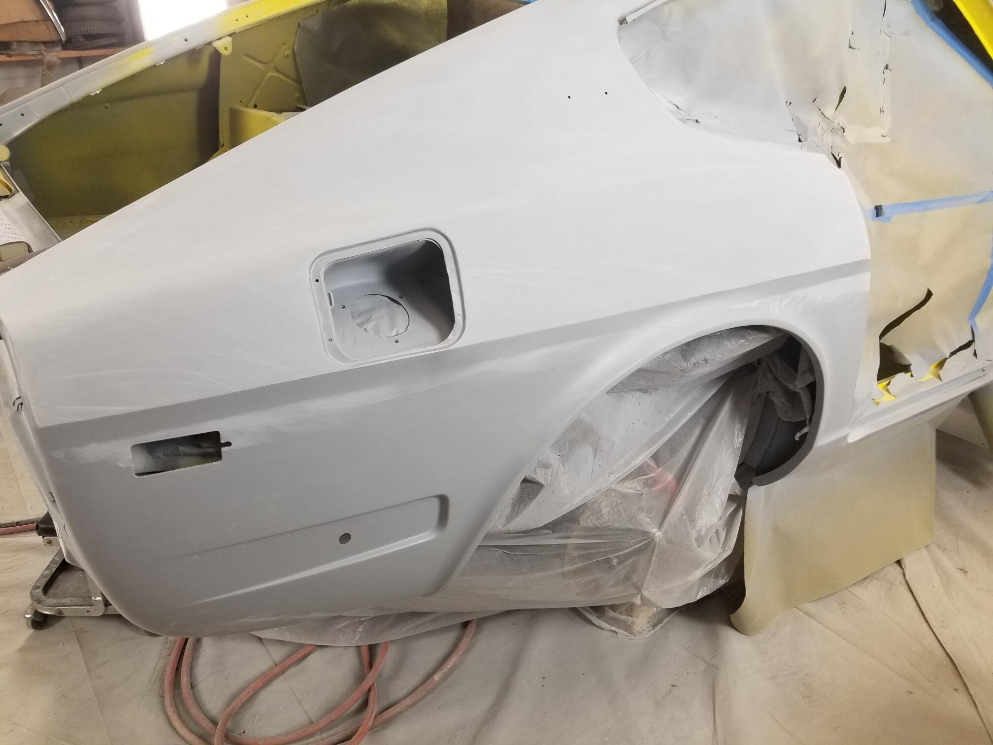

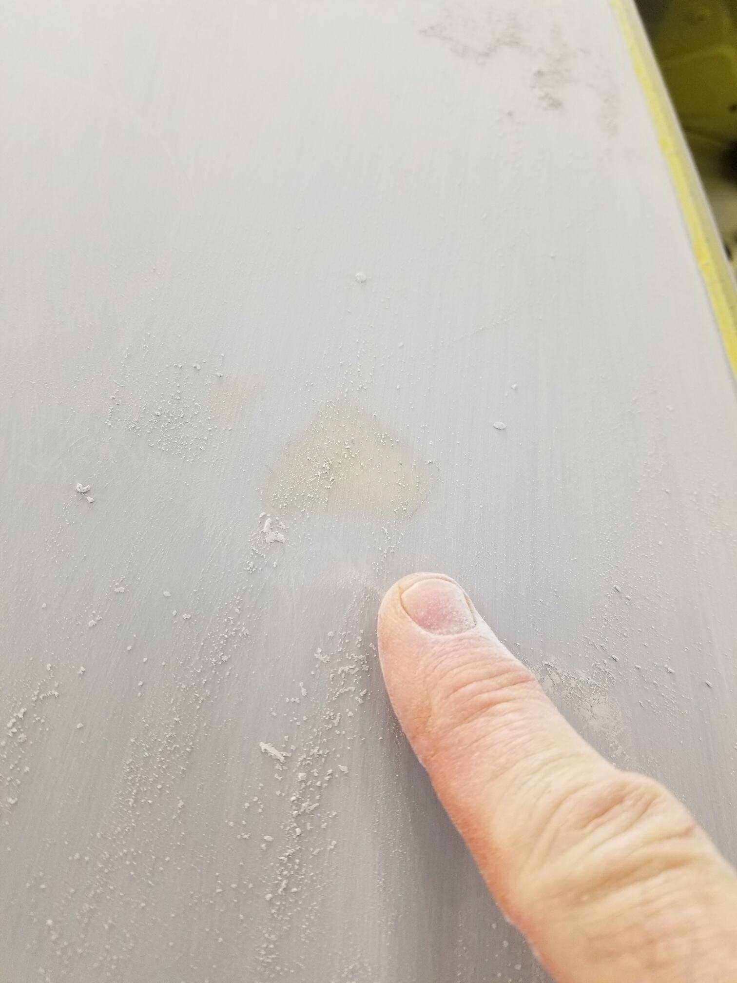

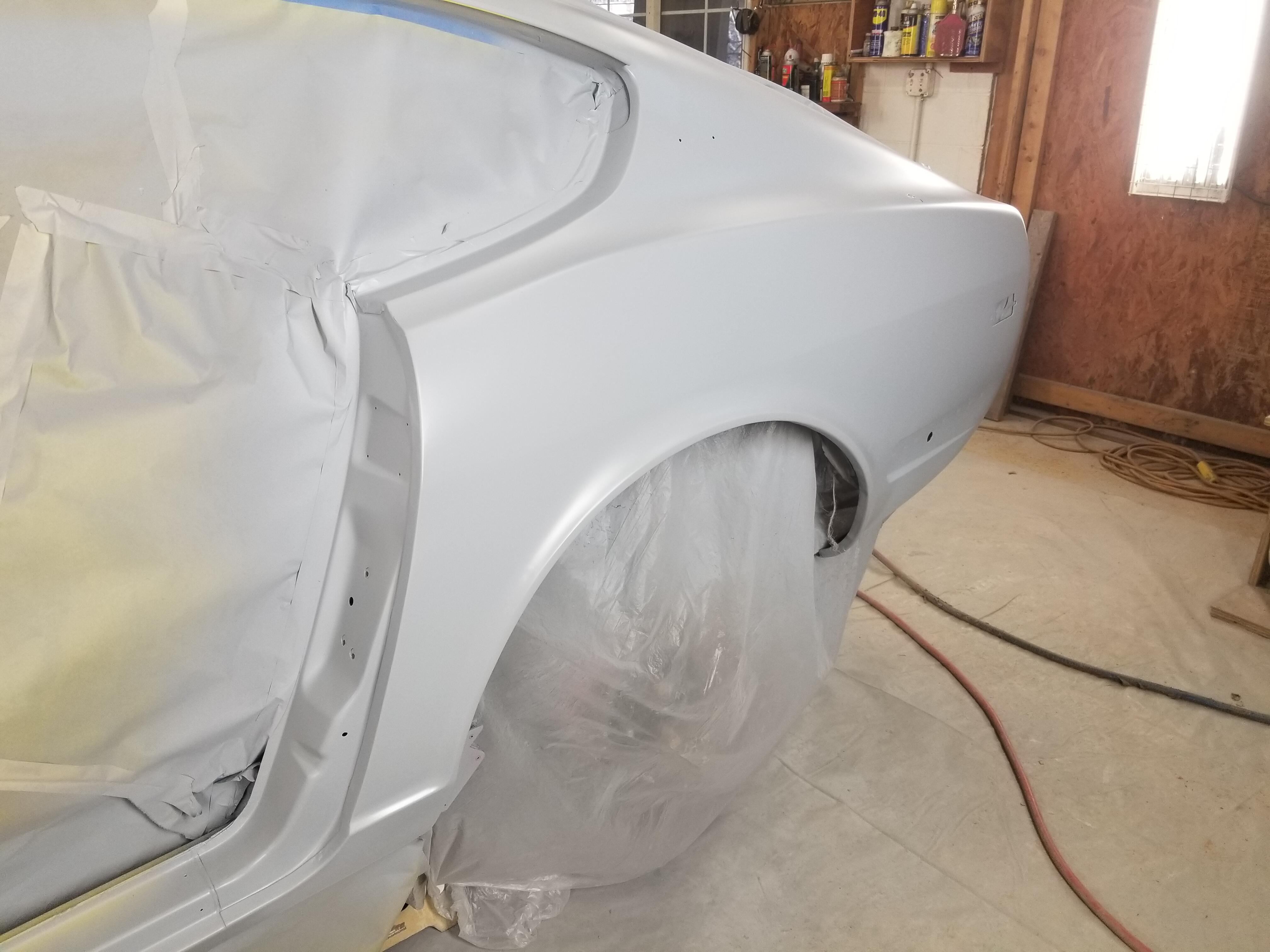

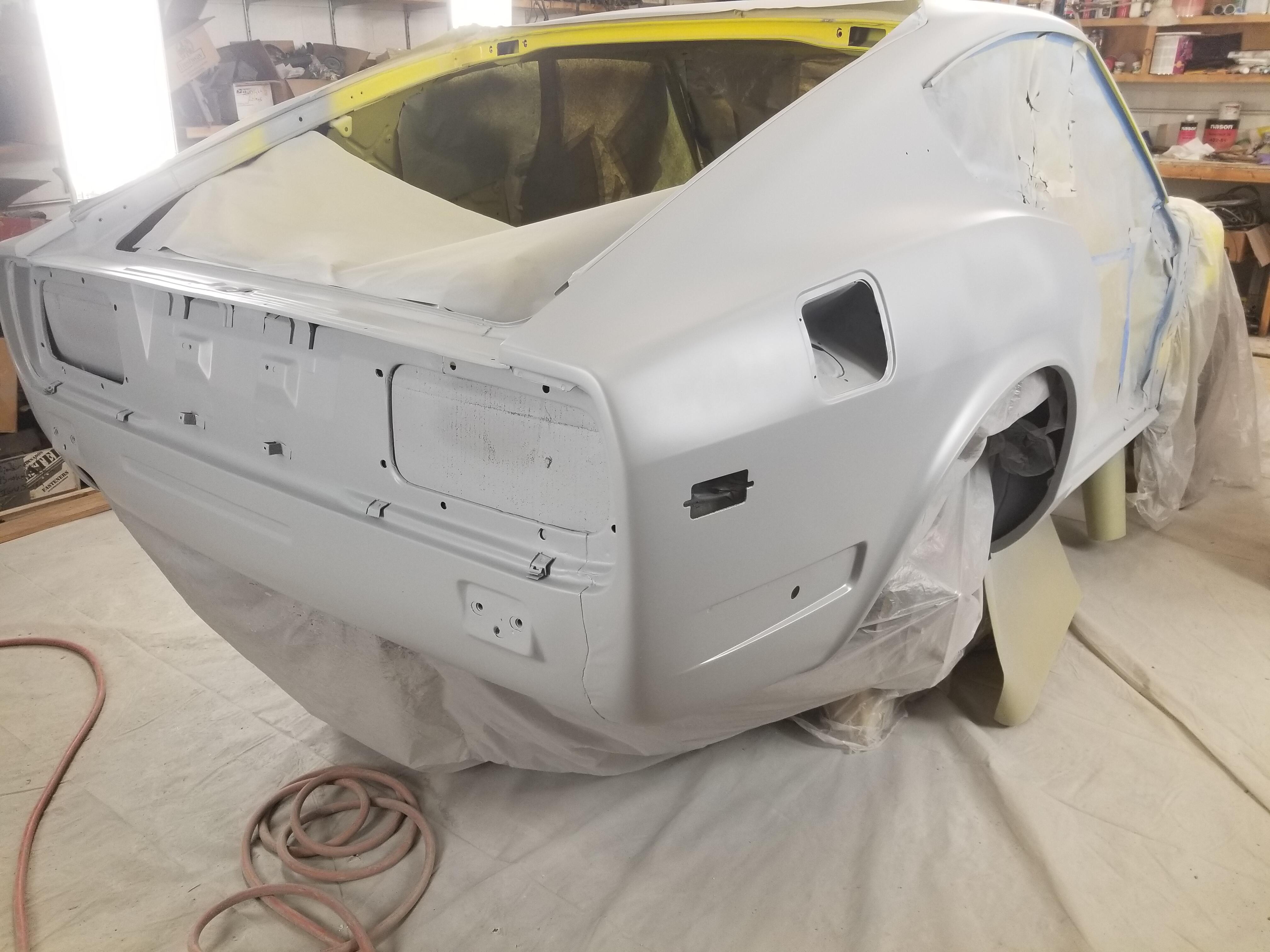

Blocked some more tonight
The little flaws on the roof after they're spot filled

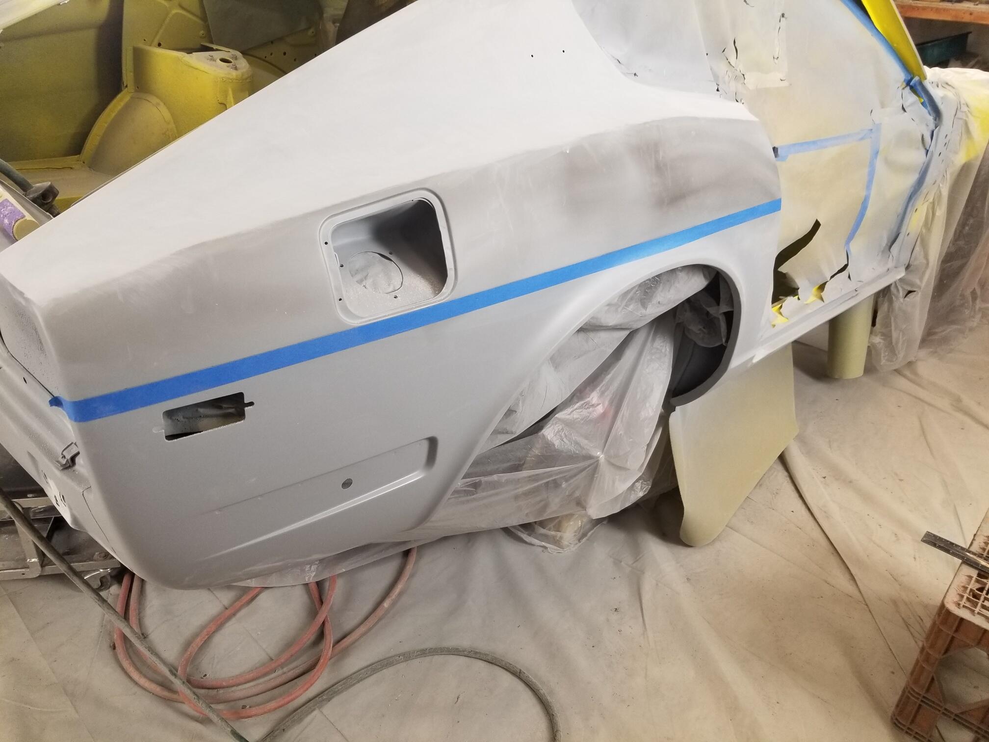

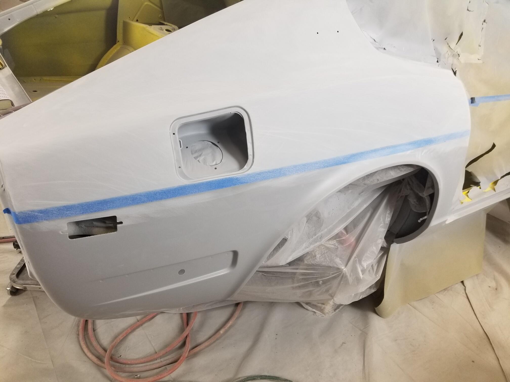

I use blue tape to help crispen the body lines. You sand up to the tape. Then move it to the other side of the line and do it again
Below the body lines tomorrow hopefully. I probably won't color this weekend because it's supposed to rain and I don't want to fight the moisture. So I will get set up and ready for color. Might color over the Christmas holiday with my new Xmas present paint gun 😉
