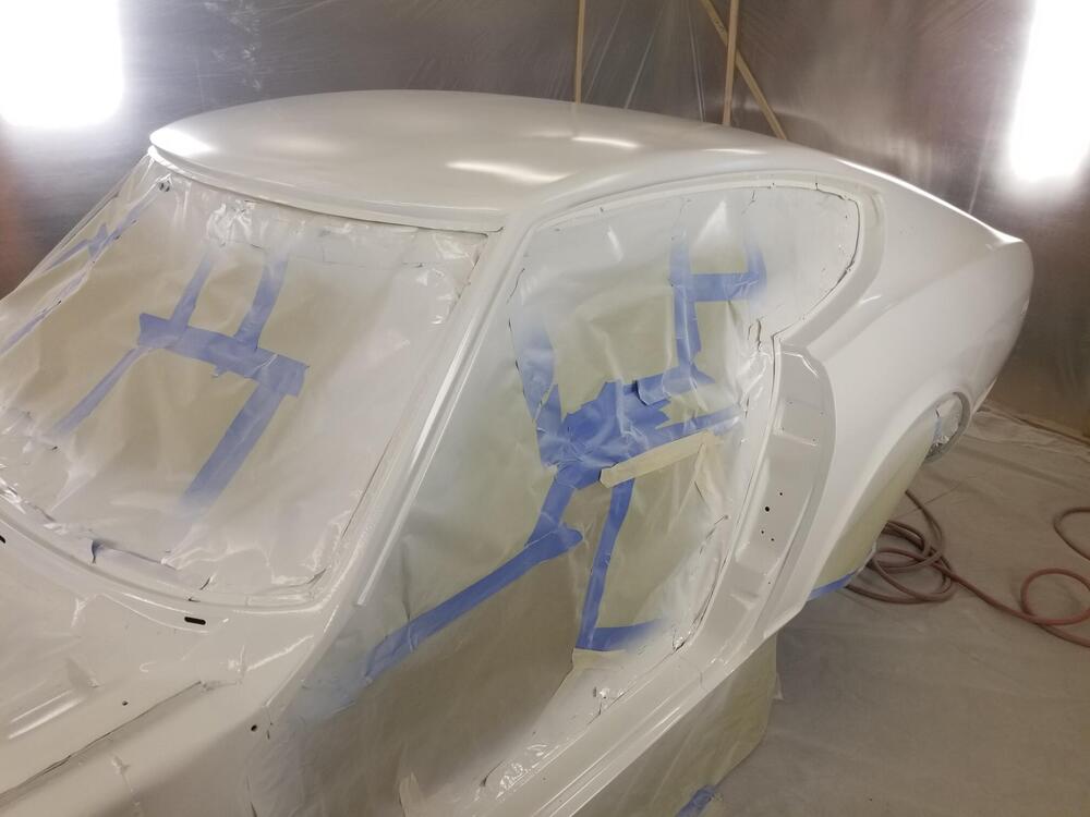

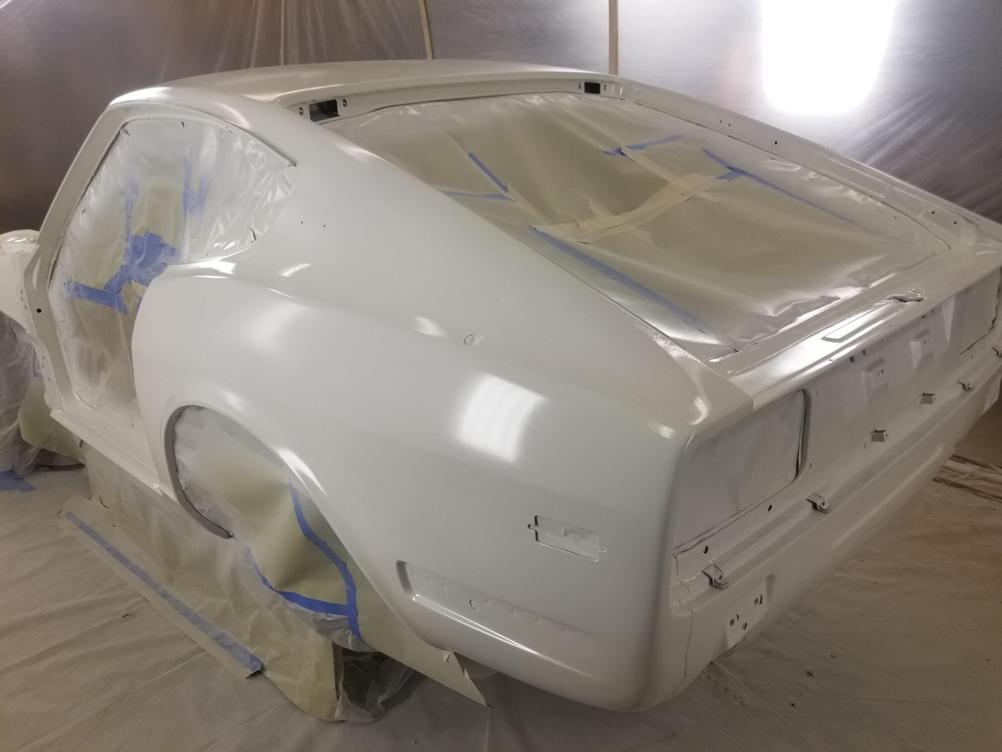

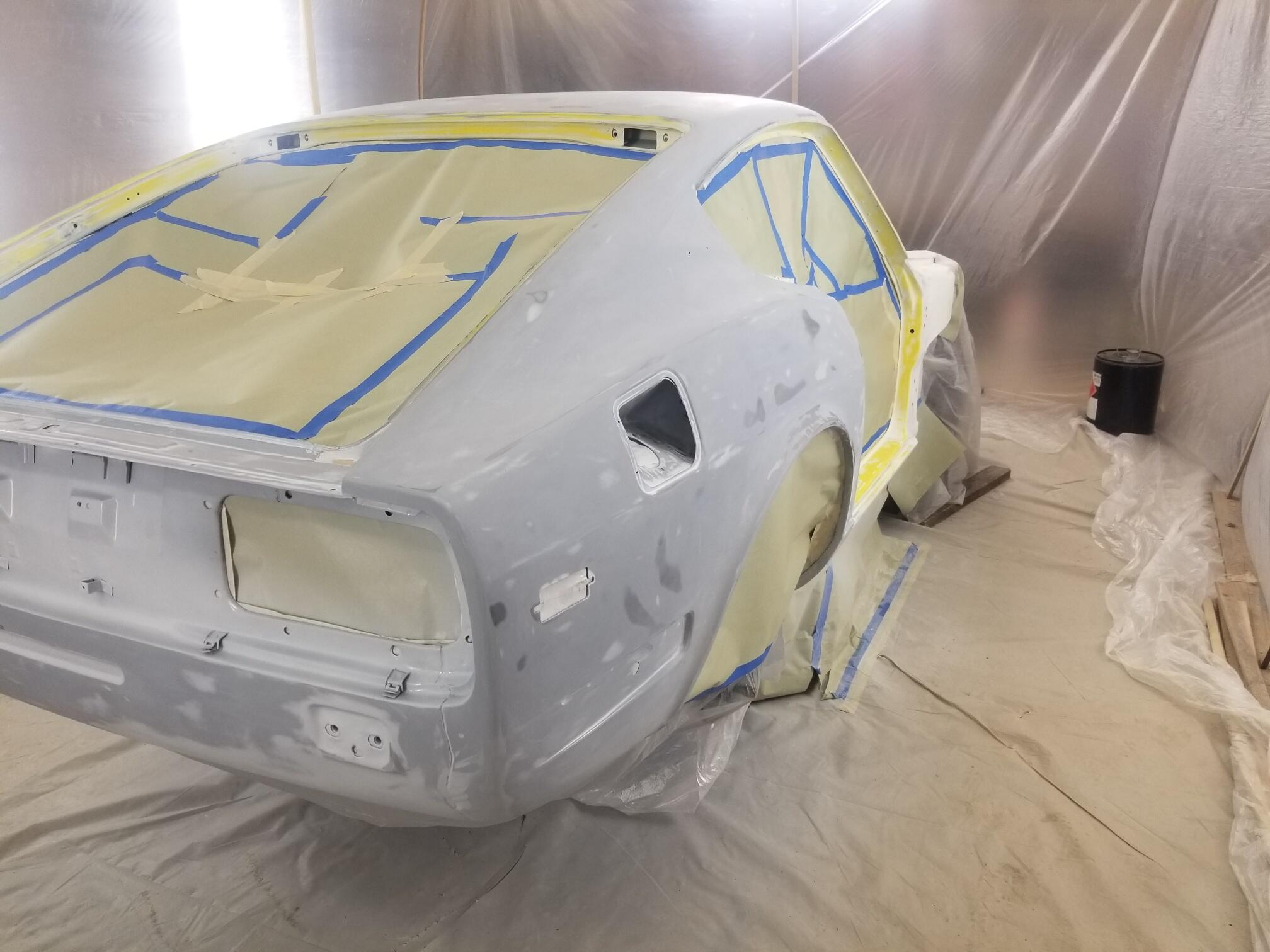

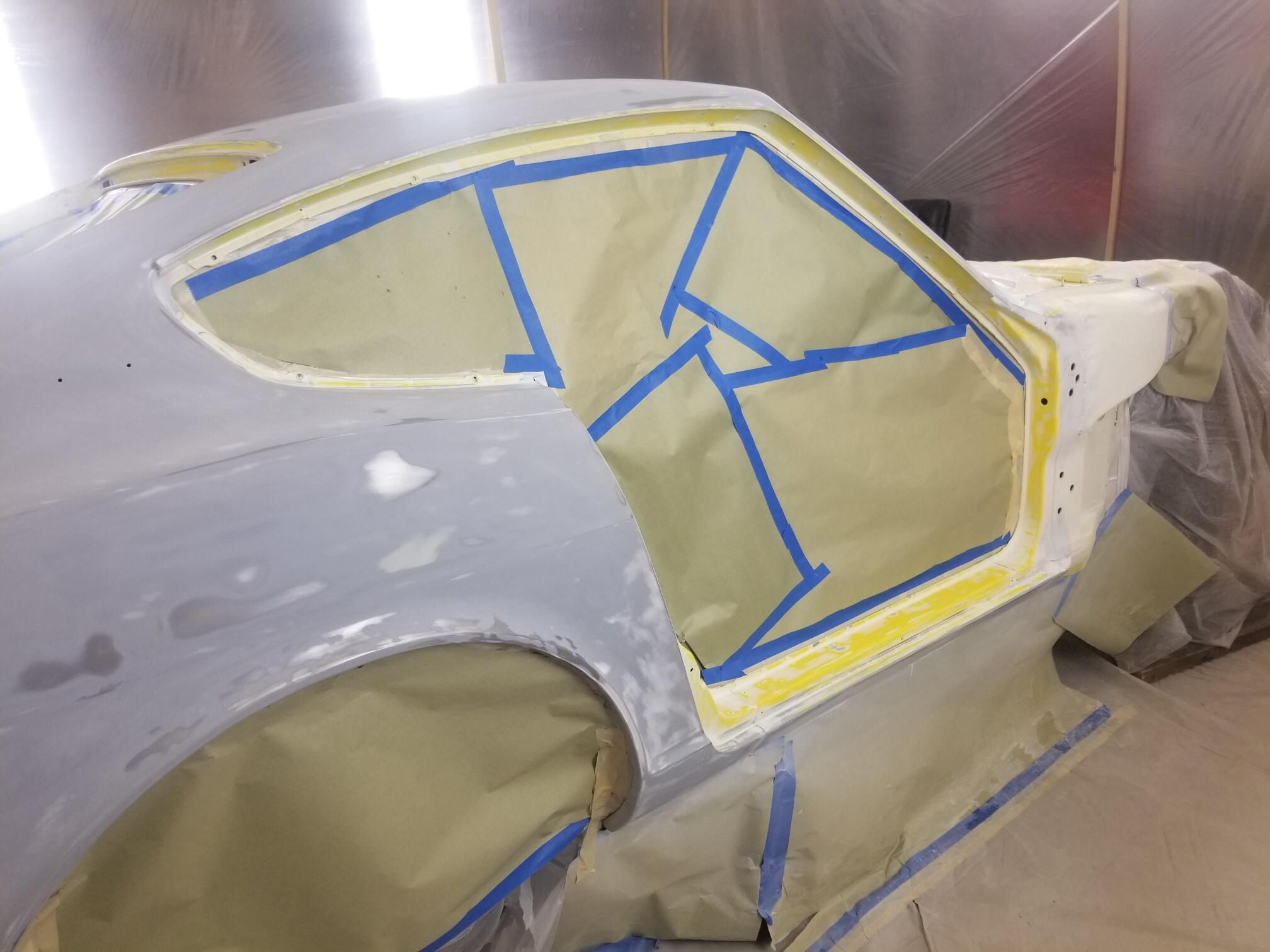

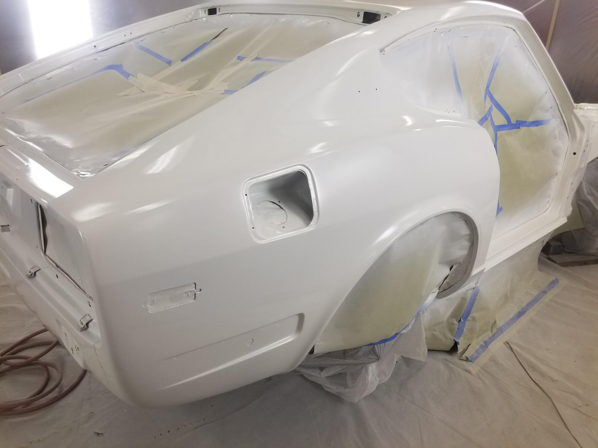

June 25, 20222 yr Author Popular Post comment_641799 So I finally got the car sanded down as far as I was willing to go. I taped it all up over the last week or so and reset the booth. Then shot some SPI white epoxy over that. It's a little different than what I am familiar with. It will fish eye if you lay the first coat on too heavy. Being white it can be hard to get full hiding coverage. I may stack some high build tomorrow. I've got 7 days to coat. We'll see... Link to comment https://www.classiczcars.com/forums/topic/55369-1971-hls30-14938-lily-build/?&page=43#findComment-641799 Share on other sites More sharing options...

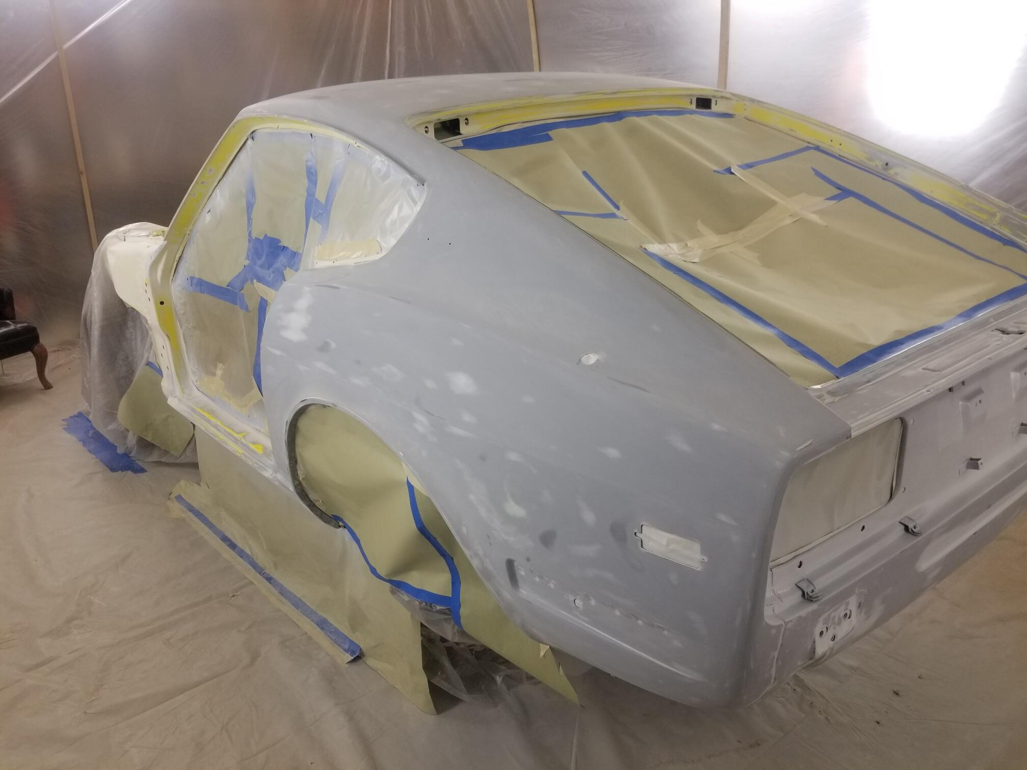

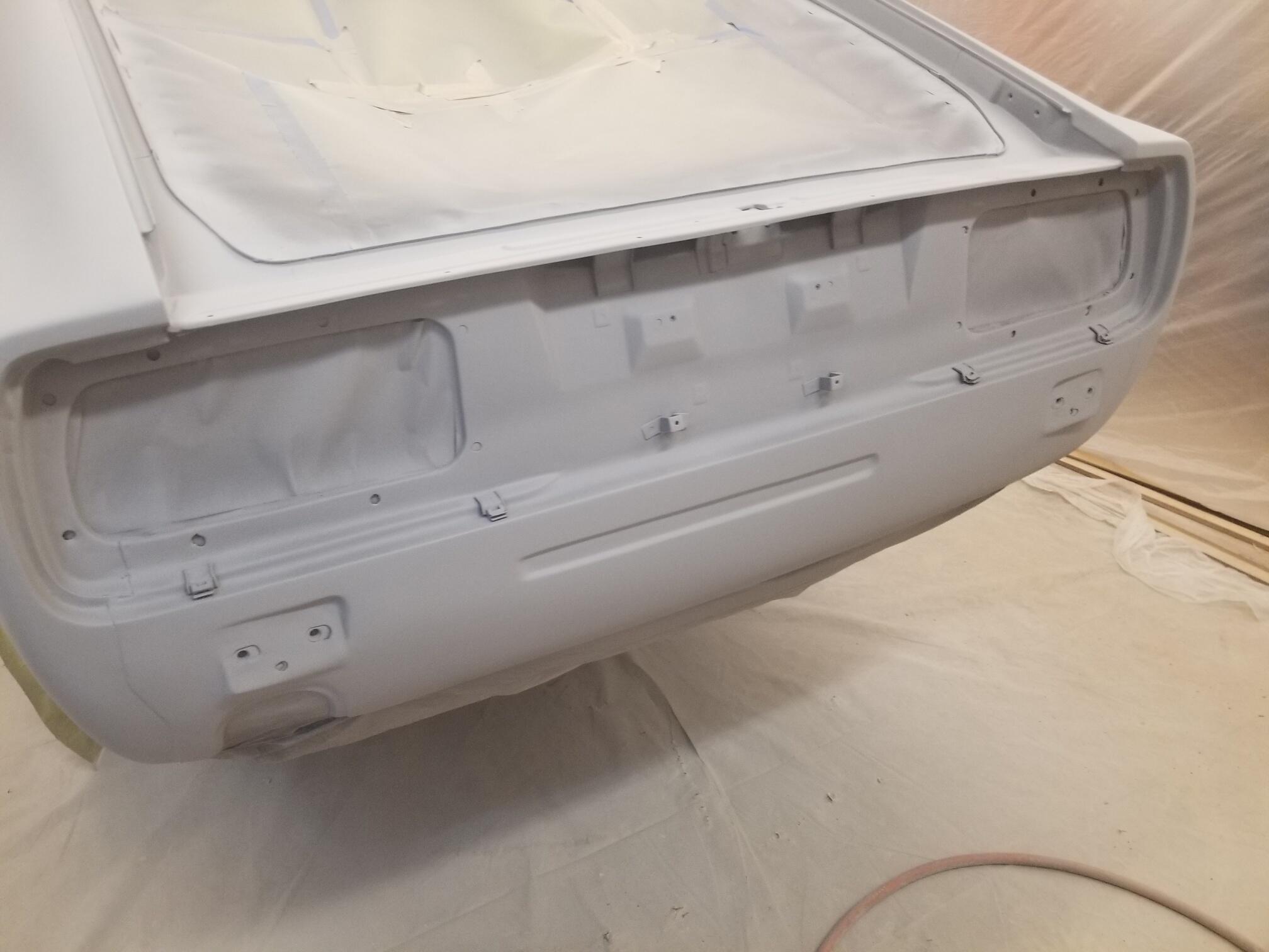

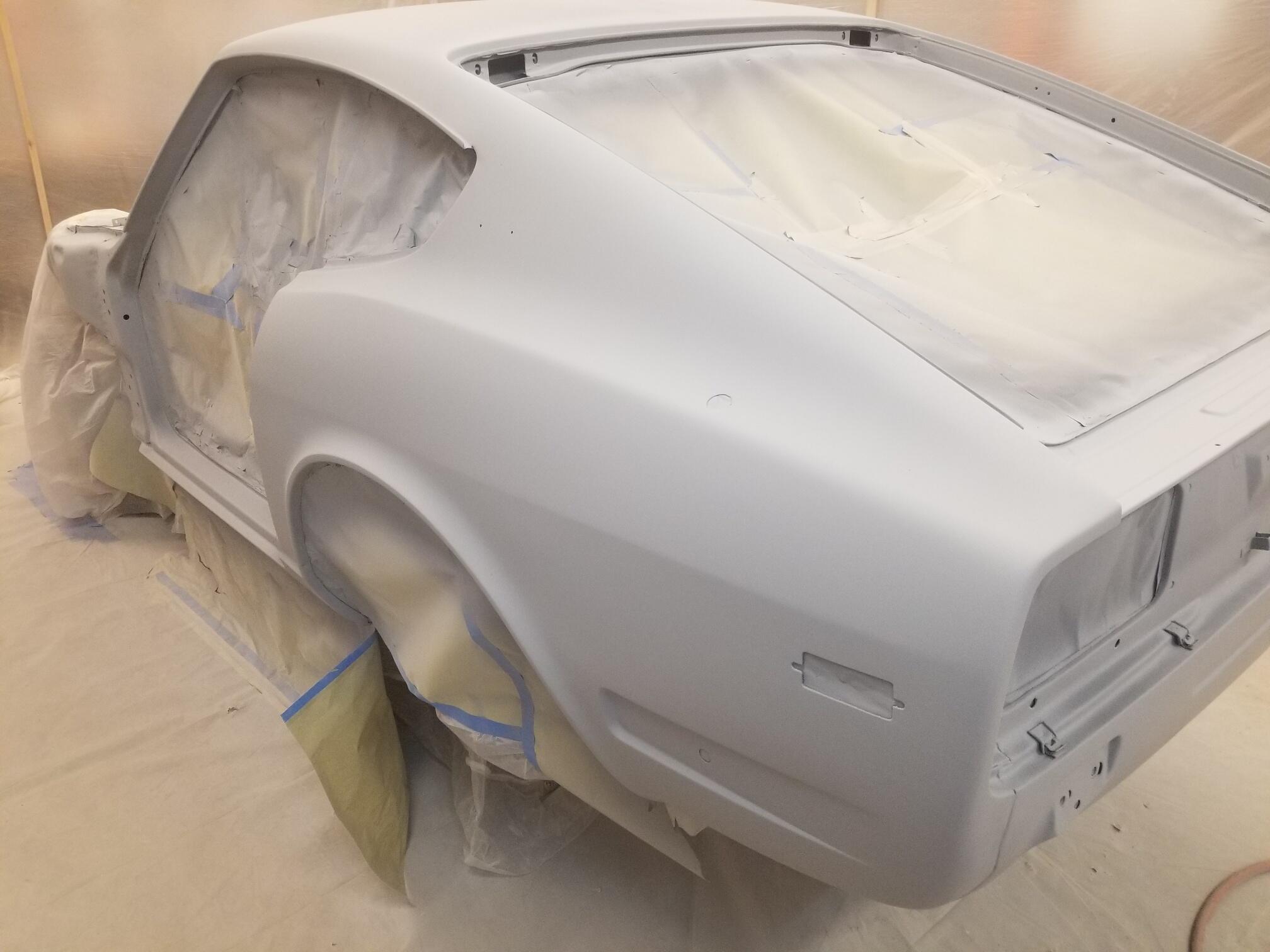

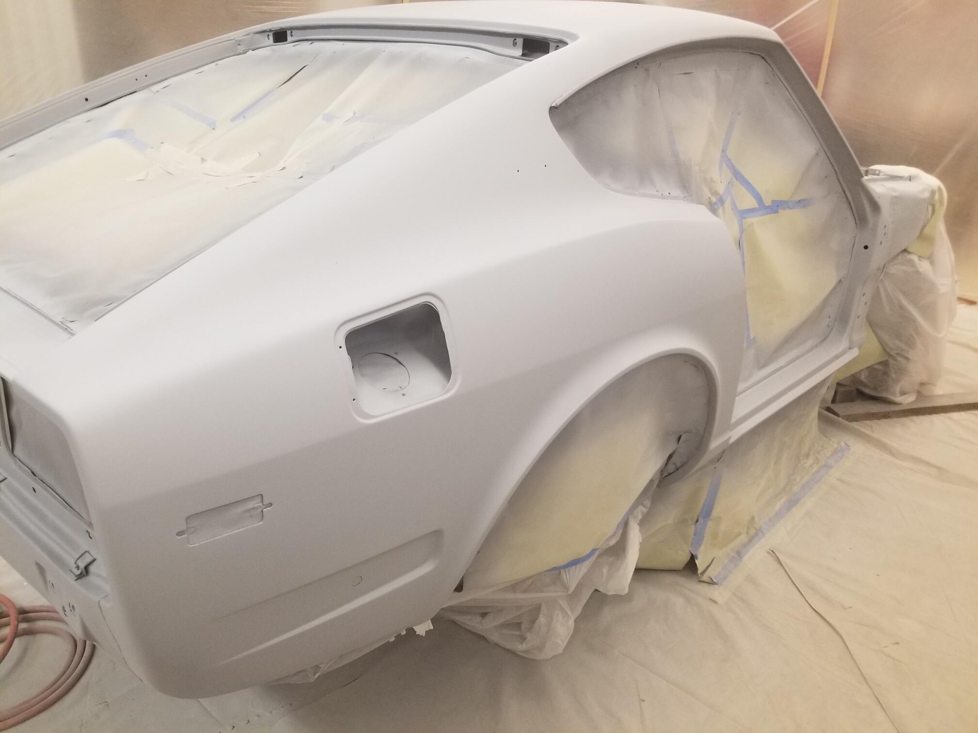

June 26, 20222 yr Author Popular Post comment_641809 Stacked some high build right before supper. Hopefully it will block out pretty close without needing too much more work Link to comment https://www.classiczcars.com/forums/topic/55369-1971-hls30-14938-lily-build/?&page=43#findComment-641809 Share on other sites More sharing options...
June 26, 20222 yr comment_641810 32 minutes ago, Patcon said: Stacked some high build right before supper. Hopefully it will block out pretty close without needing too much more work Great to see. Link to comment https://www.classiczcars.com/forums/topic/55369-1971-hls30-14938-lily-build/?&page=43#findComment-641810 Share on other sites More sharing options...
June 26, 20222 yr Author comment_641811 Thanks, trying to get motivated Link to comment https://www.classiczcars.com/forums/topic/55369-1971-hls30-14938-lily-build/?&page=43#findComment-641811 Share on other sites More sharing options...
June 26, 20222 yr comment_641813 11 hours ago, Patcon said: It's a little different than what I am familiar with. And did you first make a test (painting) on your wheelbarrel? (Or on a piece of cardboard) SO this time it went well i see! Is the car going to be green again or?? Link to comment https://www.classiczcars.com/forums/topic/55369-1971-hls30-14938-lily-build/?&page=43#findComment-641813 Share on other sites More sharing options...
June 26, 20222 yr Author Popular Post comment_641815 This epoxy is a sandable primer so I wasn't too worried about the fisheyes. I mostly filled them in on subsequent passes but no I didn't shoot a test panel. The car will be bright yellow when done Link to comment https://www.classiczcars.com/forums/topic/55369-1971-hls30-14938-lily-build/?&page=43#findComment-641815 Share on other sites More sharing options...

June 28, 20222 yr Author comment_641853 I'll try to start blocking this weekend. We'll see how it blocks out. If it blocks out ok, it could be yellow in 3 weeks or so probably Link to comment https://www.classiczcars.com/forums/topic/55369-1971-hls30-14938-lily-build/?&page=43#findComment-641853 Share on other sites More sharing options...
