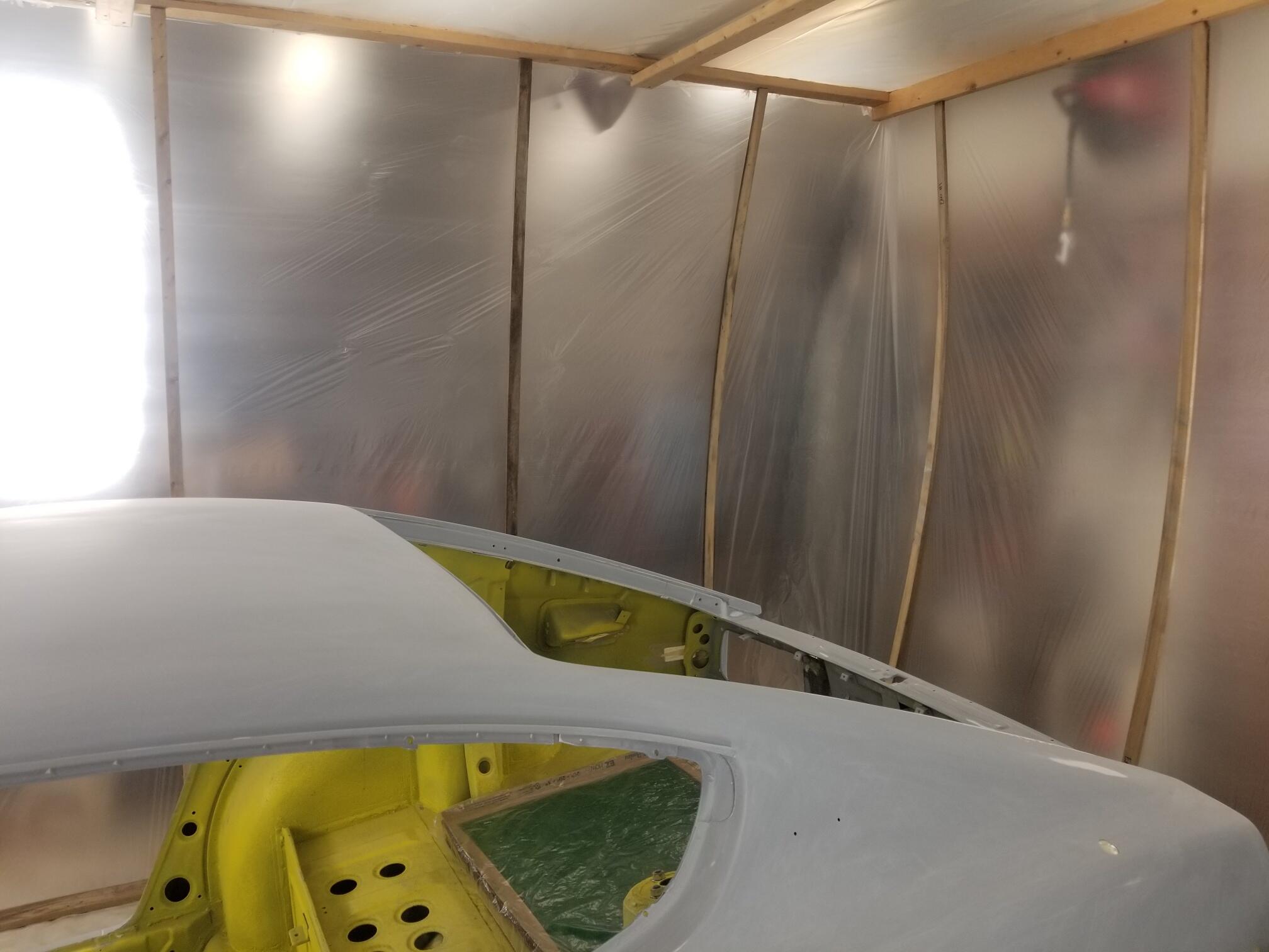

So I was gonna try and spray color this weekend but that's not gonna happen.

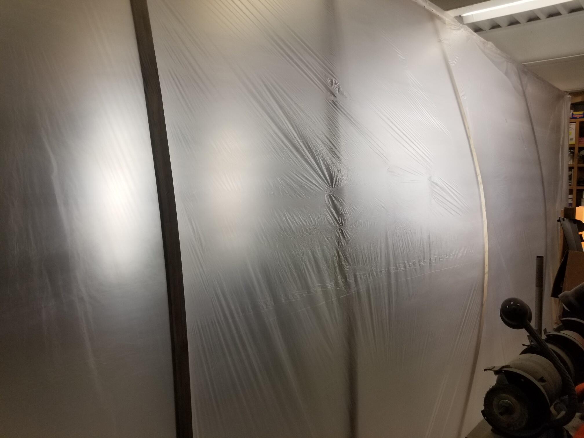

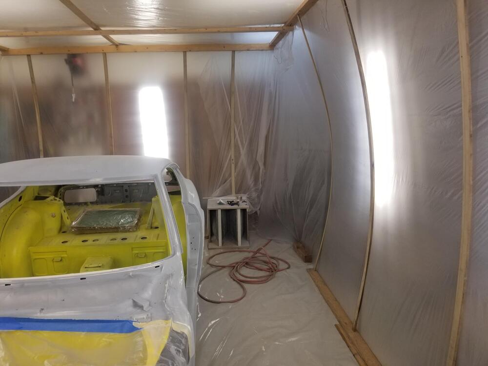

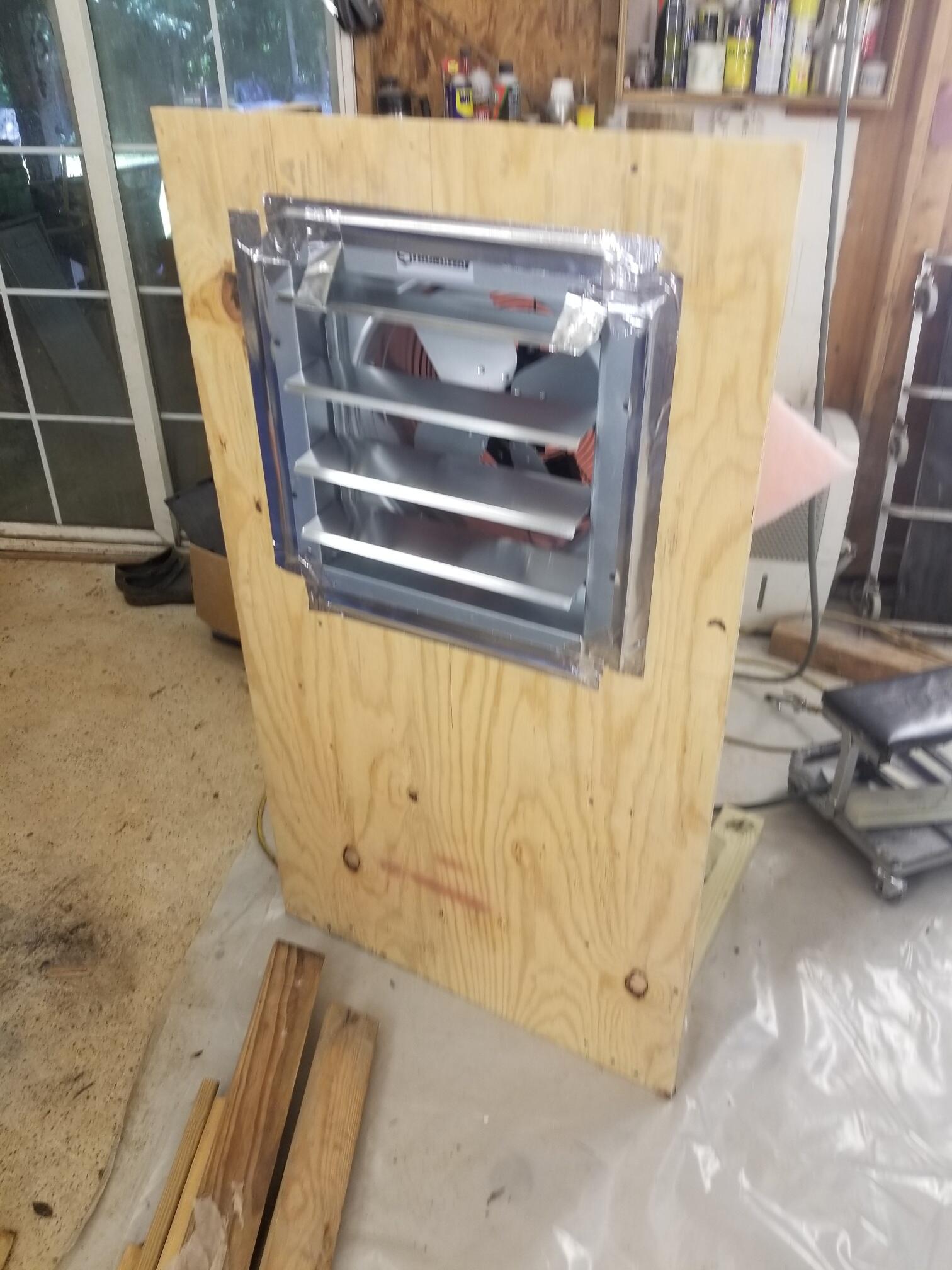

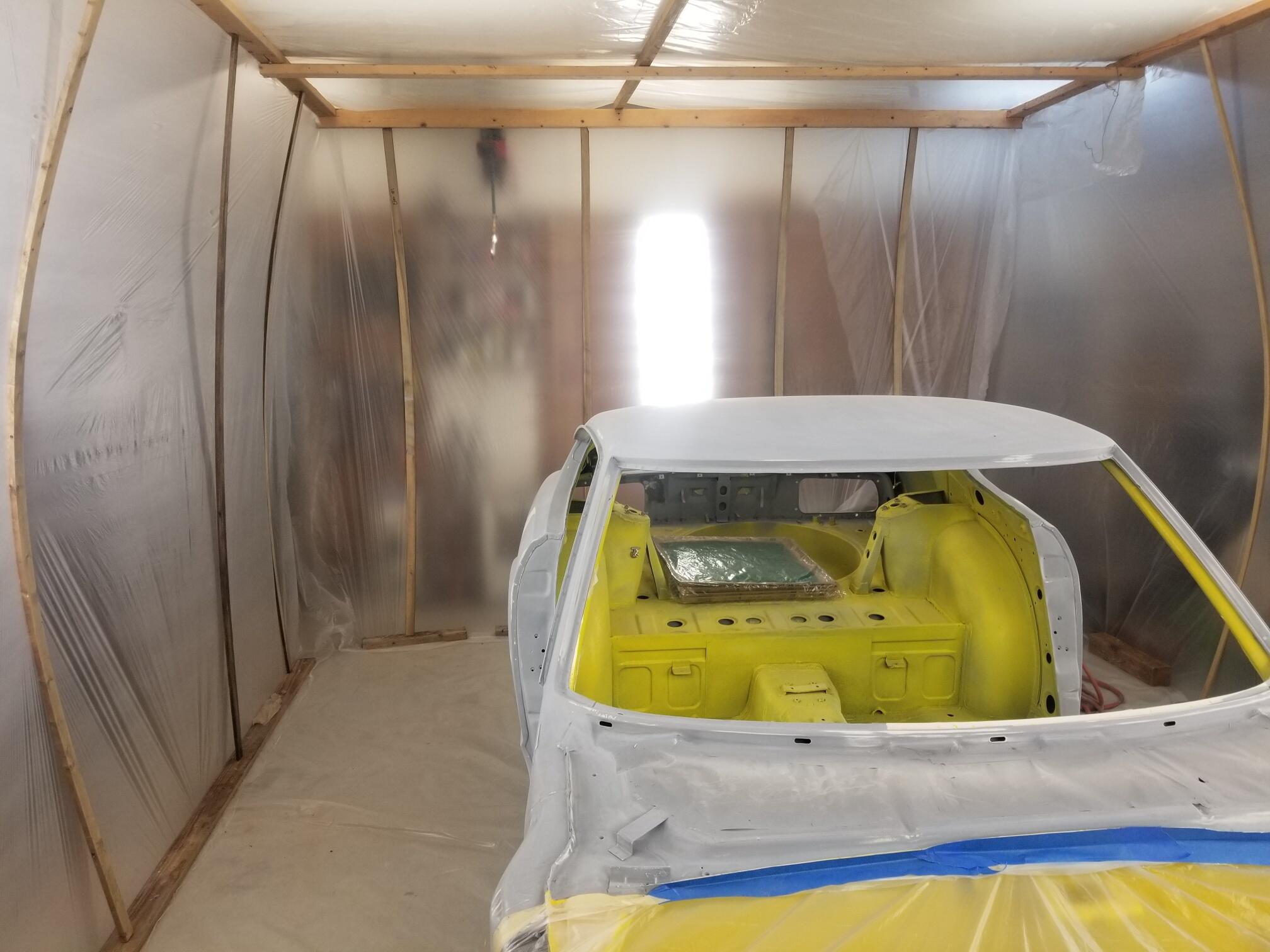

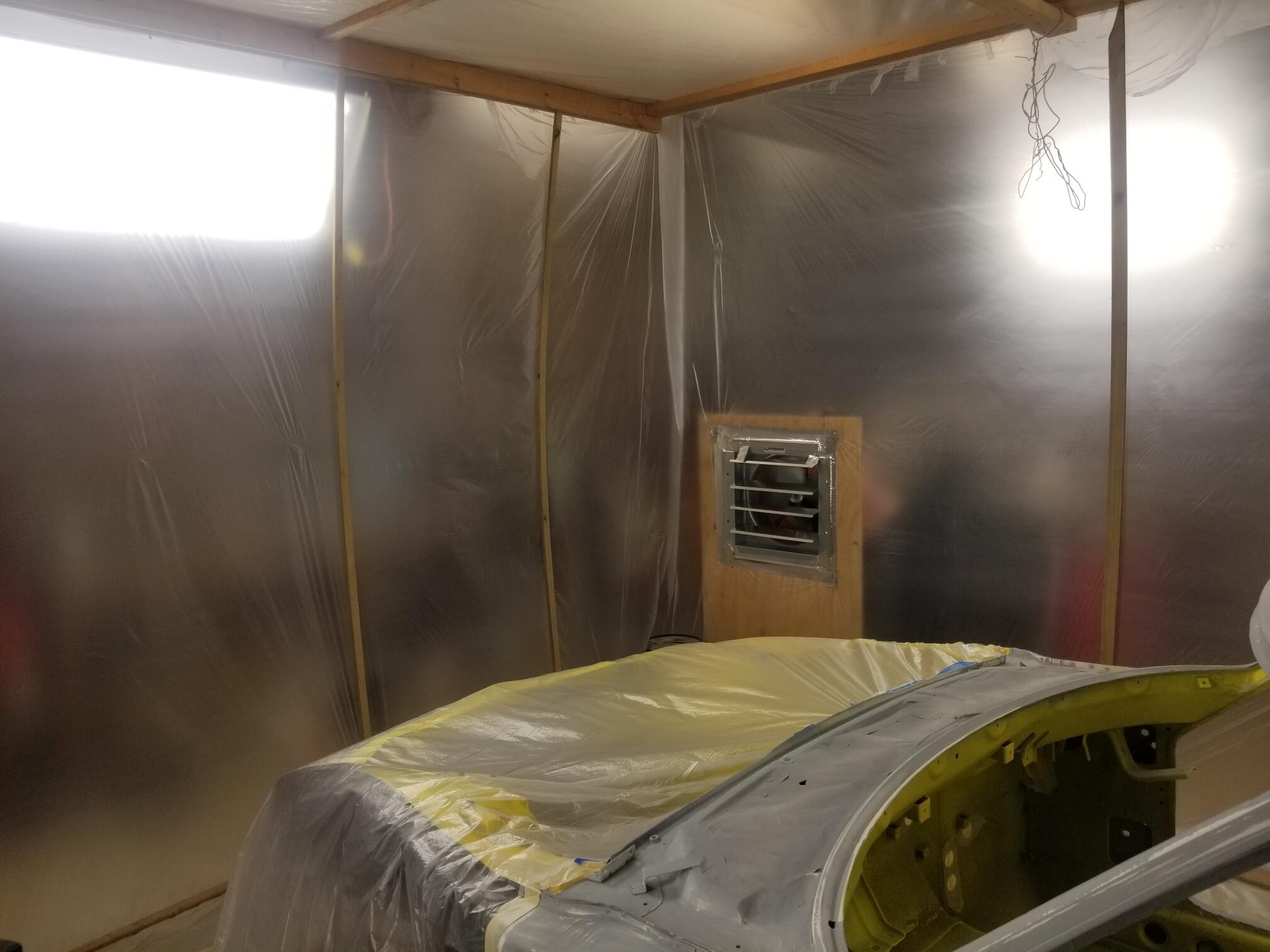

I reset the booth and added an inflow fan like Homebuilt by Jeff had.
The problem came about when building the fan. I stabbed my thumb nail with a philips bit in an impact and tore about half the nail loose! 🤬
Shelley helped me get the booth all back set
The weather this weekend is also pretty rainy and humid. So I will try again next weekend. May try a test panel with the new spray gun tomorrow.

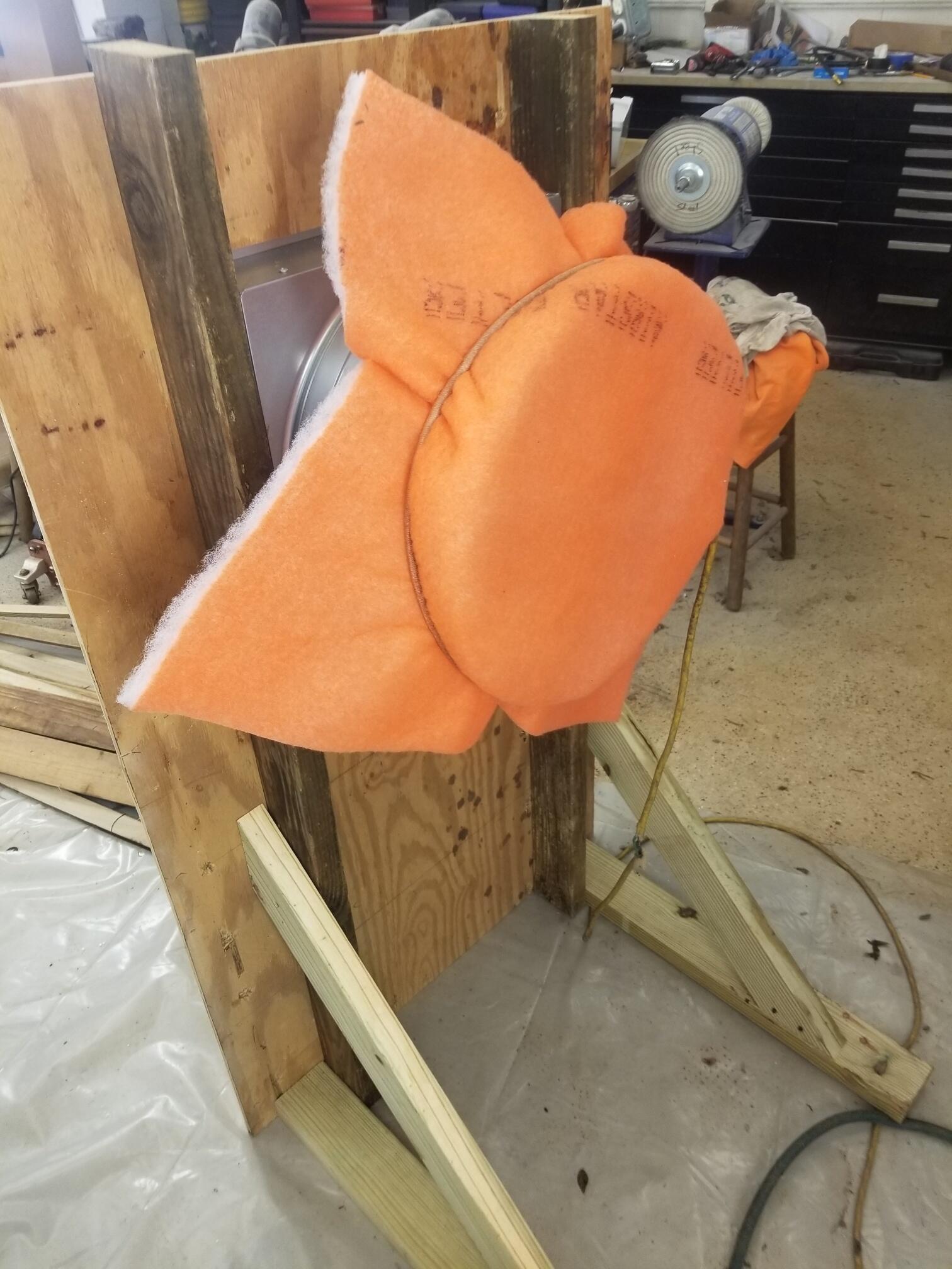

Maybe you can make a (metall strip) bow or 2-3 inside the filter then you have a bigger filter were the air go's through much faster? just a tip.. the filter itself you use is big enough for that.
Take your time for paintwork, get to know your (new) paintgun.

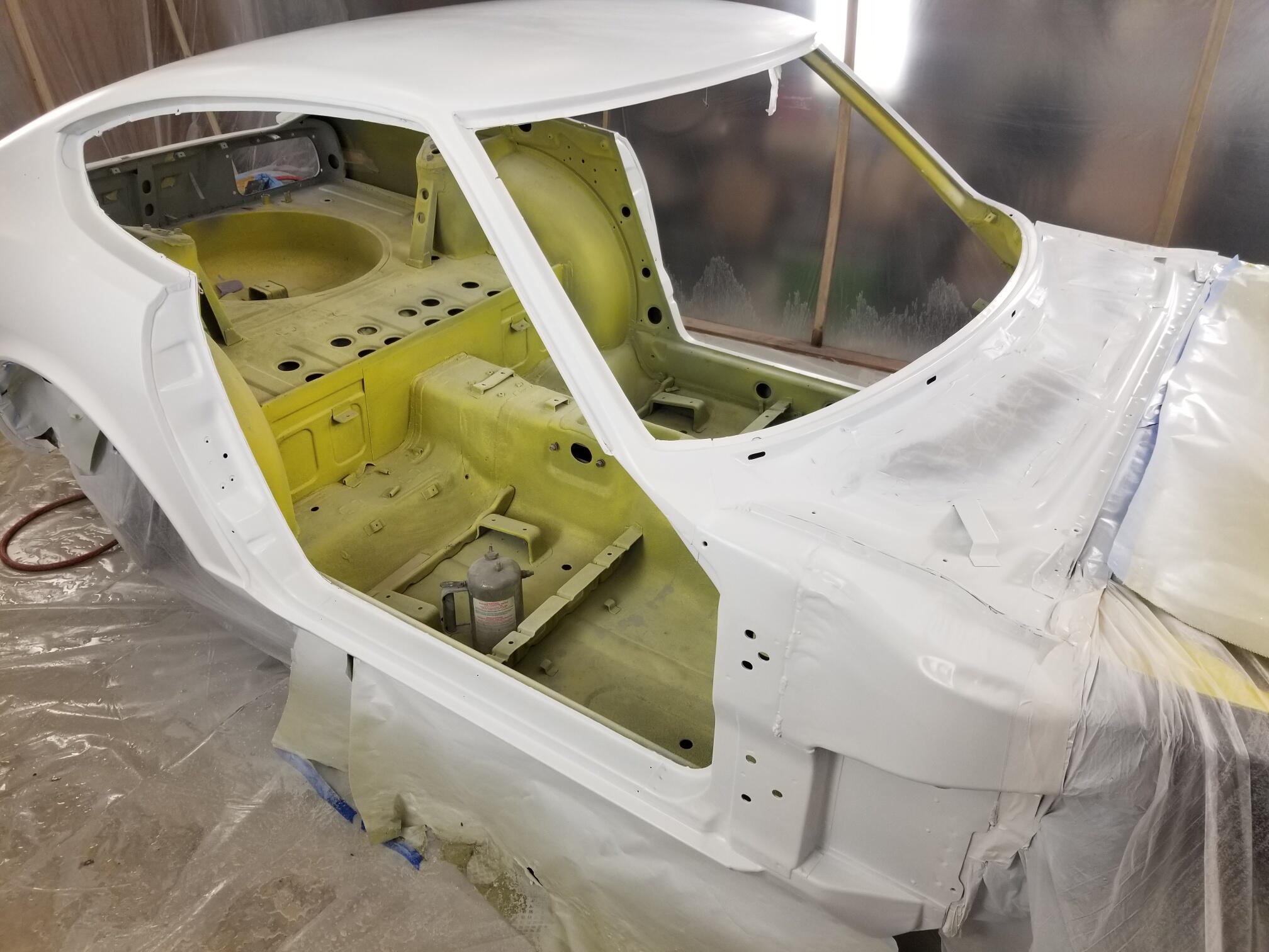

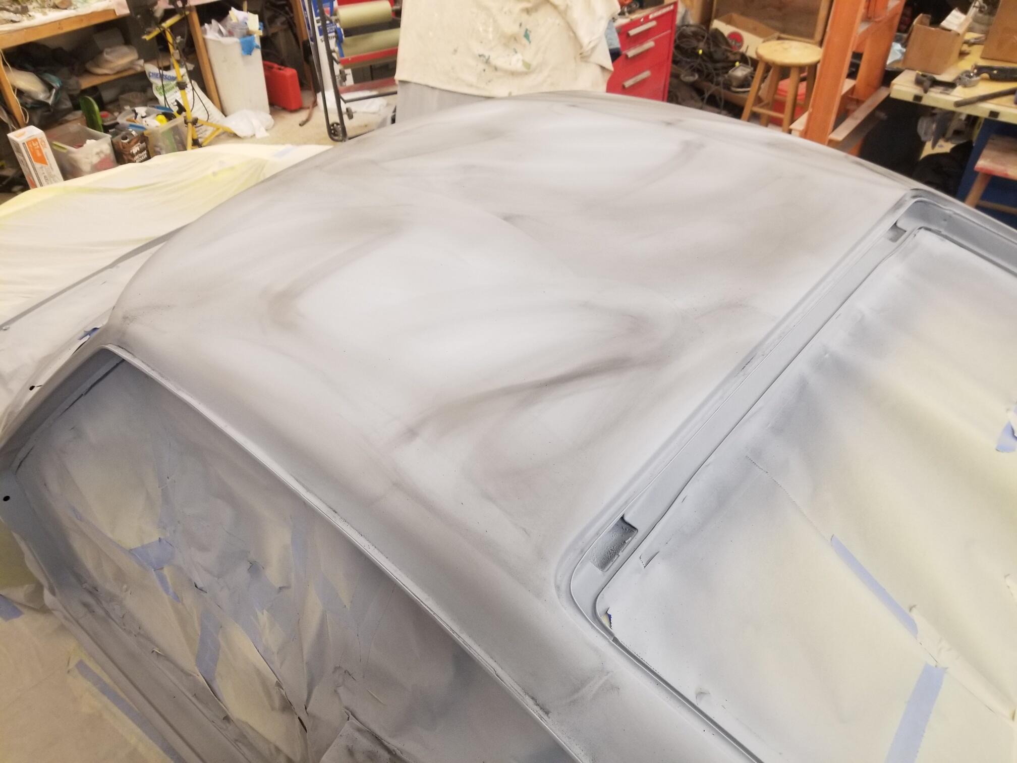

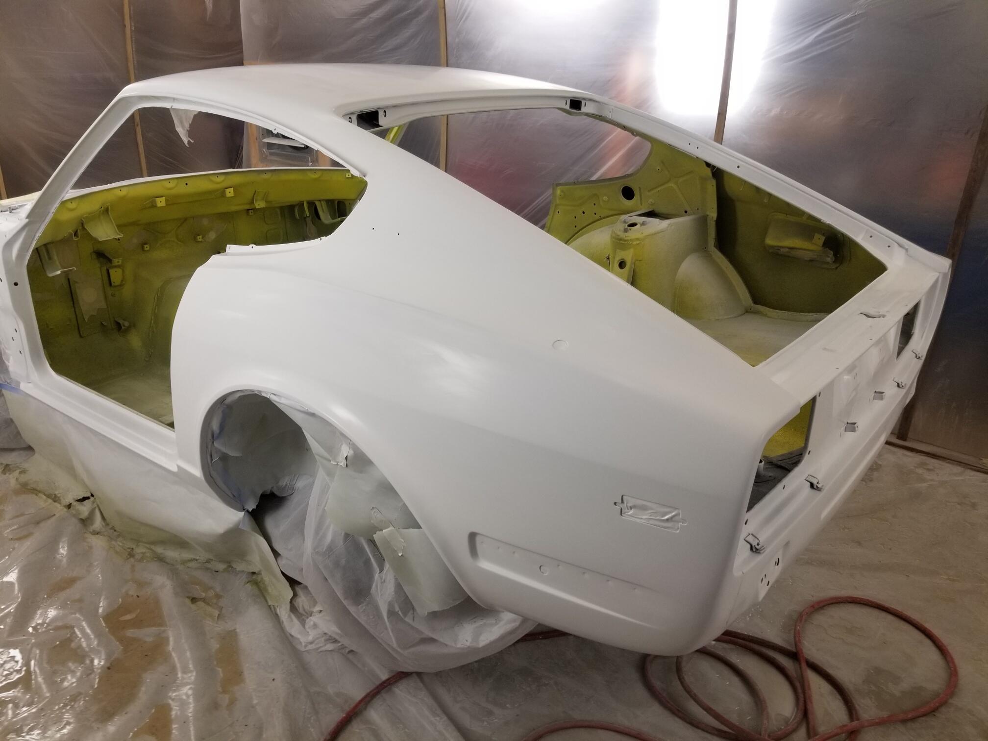

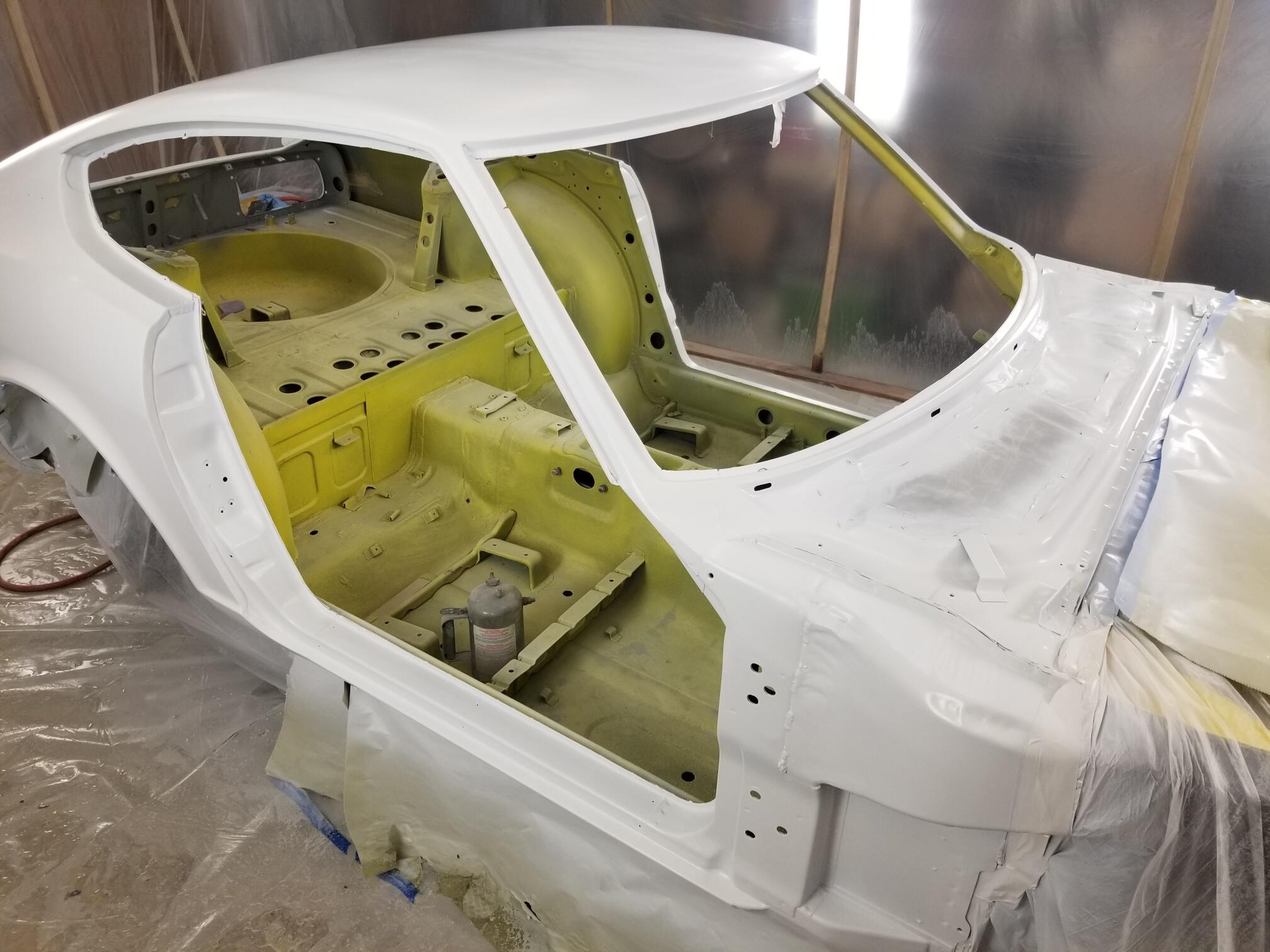

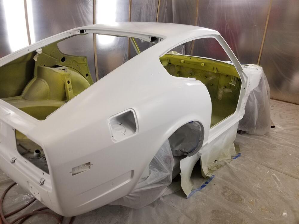

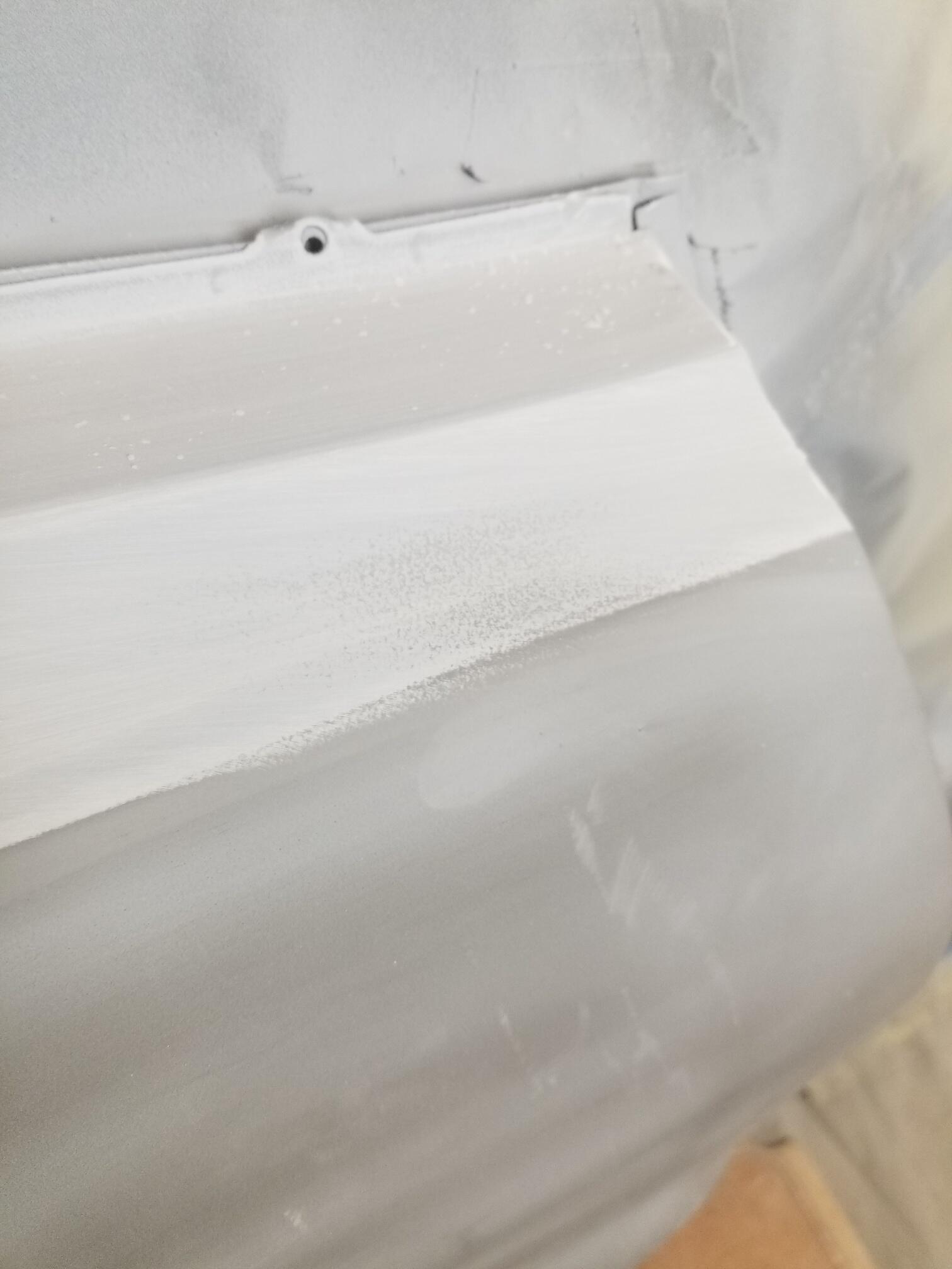

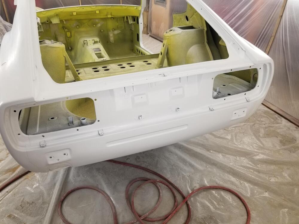

So yesterday
Shot some white basecoat

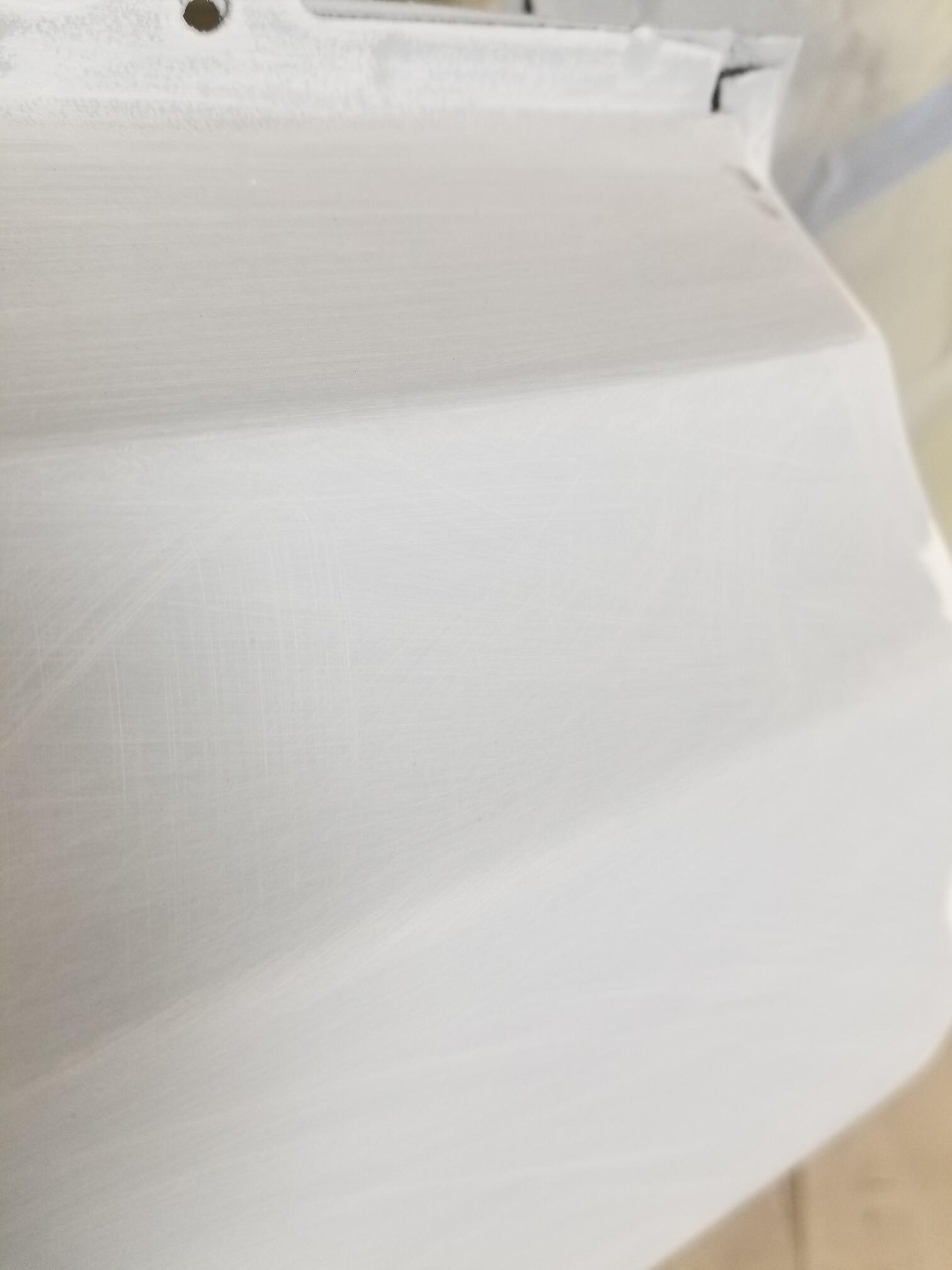

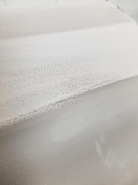

There was still a little trash in the paint. No idea where it's coming from. So I worked those areas with a little 600 grit and then degreased again and tacked the car
