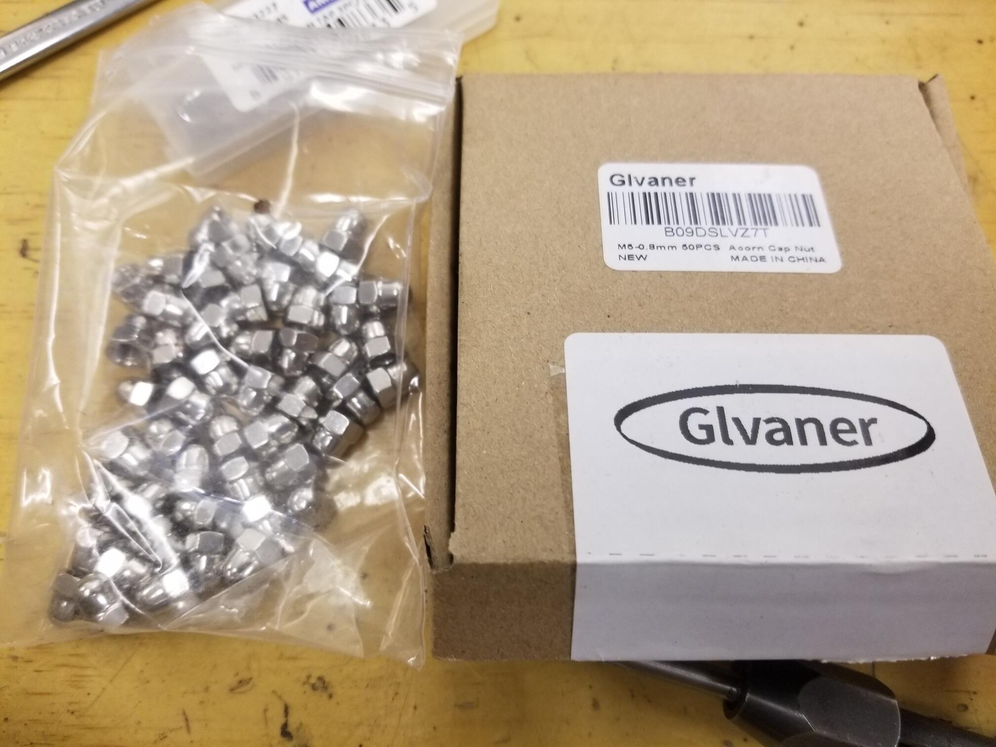

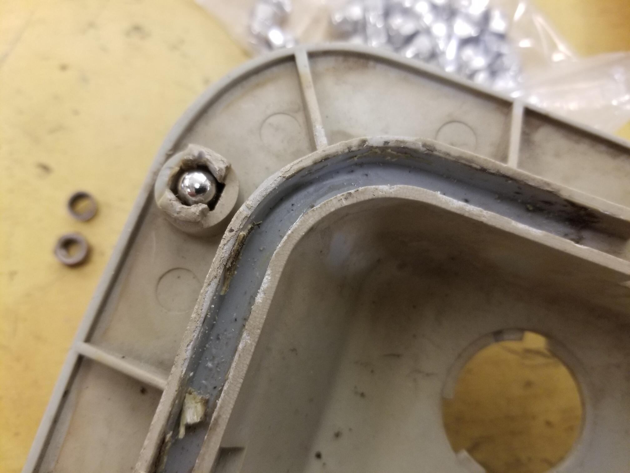

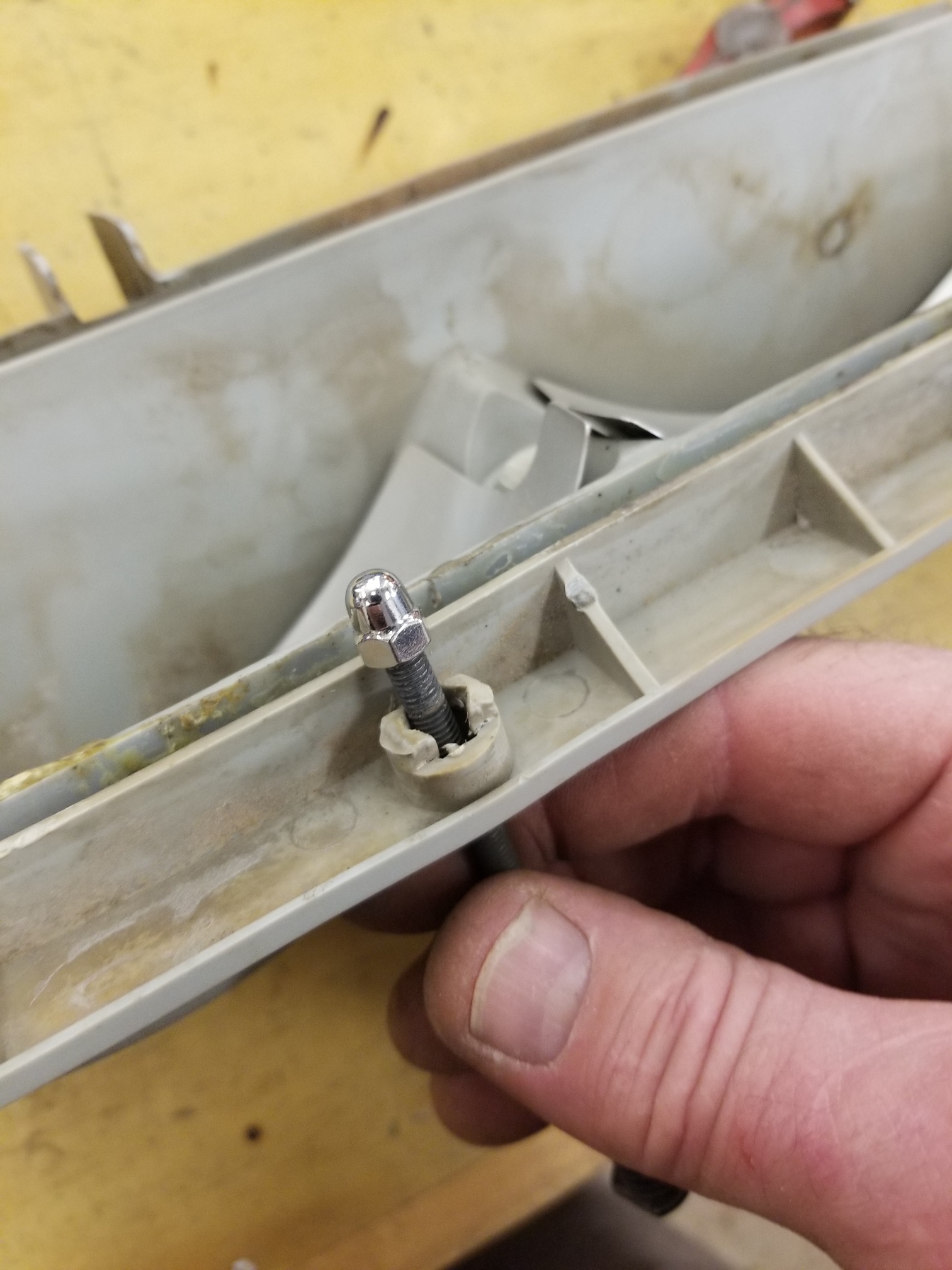

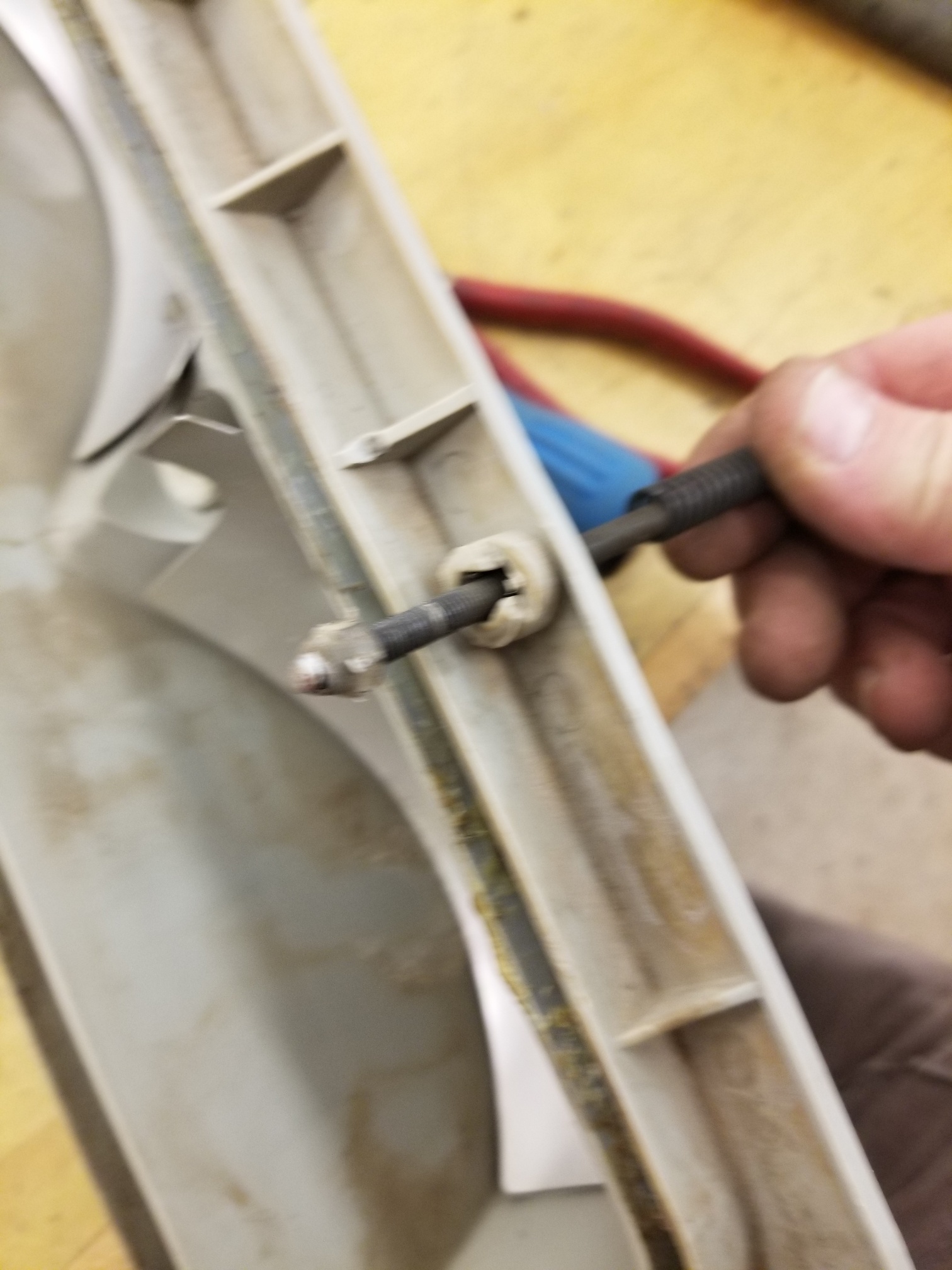

I have been working on the mounting cap screws. Some are missing and some are damaged. I bought a bottom tap so I could chase the threads. Then I forced some of the damaged caps out and pulled new SS acorn nuts using a bolt I found in the random bolt drawer

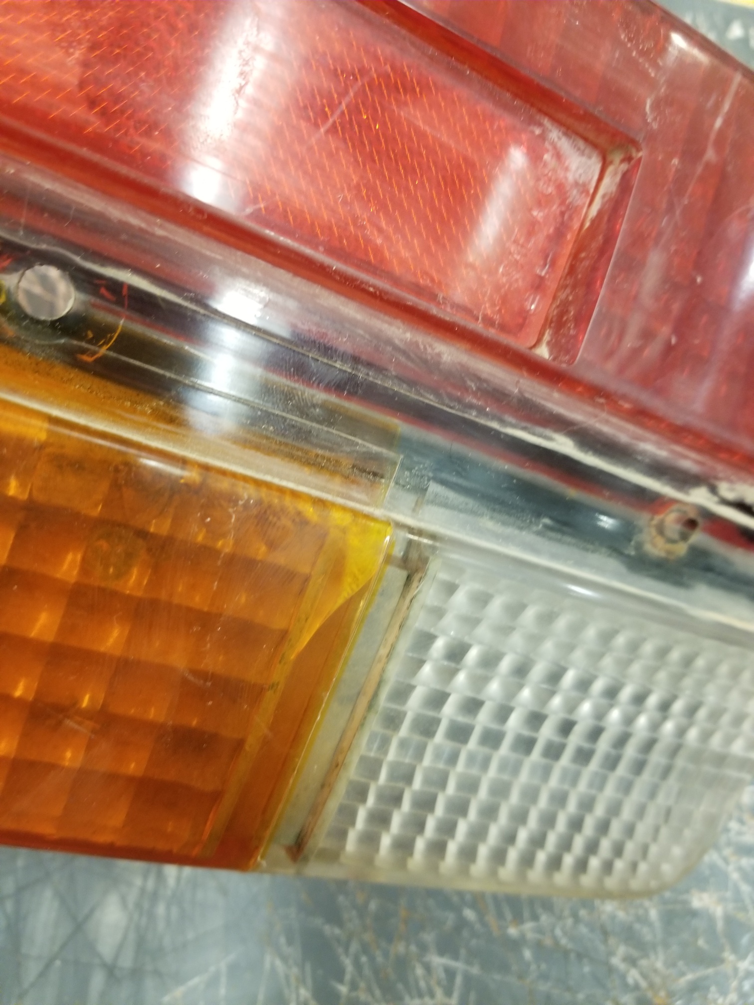

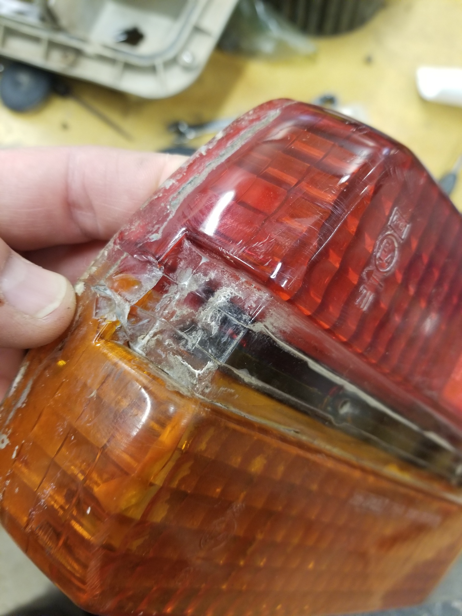

 So I have an issue with one of the JDM tail lights!

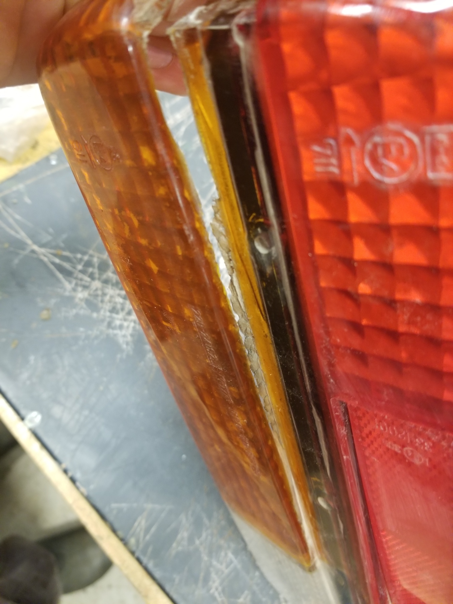

I was trying to figure out why there was grunge in the turn signal section of the lens. Well this might do it!

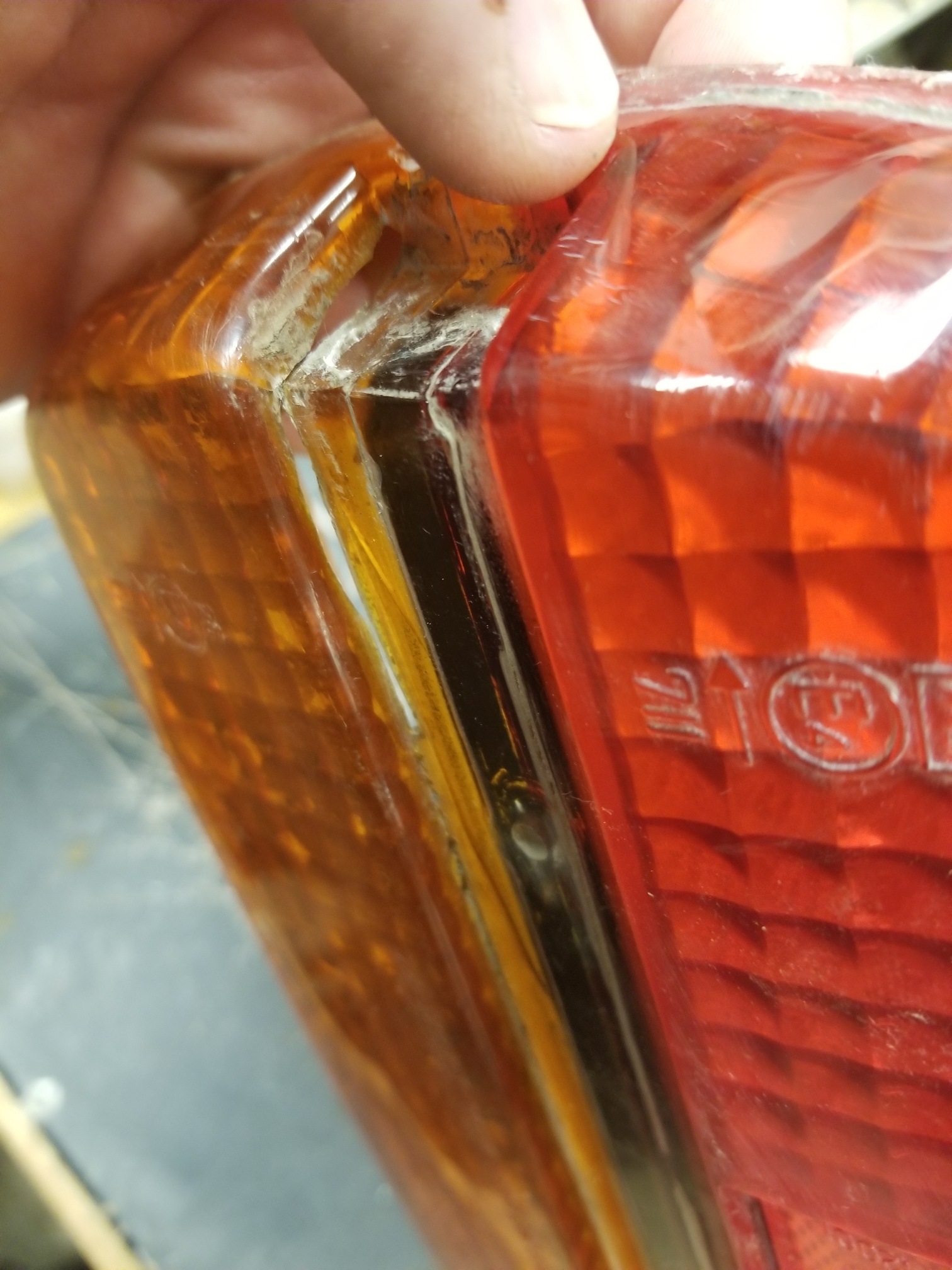

So I need to figure out what to do. I thought about just snapping the yellow section of the lens off and re-epoxying it. My concern is I don't want to end up with 5 or 6 pieces. I am not sure I can get the seam clean enough to glue with breaking it off. I thought about trying to cut a seam at the clear lens but don't want to lose the blade thickness. I have a commercial plastic welder but I think that will just make a mess. I would hate to have to scrap these tail lights and start over. I don't think the horizontal joint will be very noticeable because of the chrome trim bar.
Ideas??
9 minutes ago, Patcon said:
Ideas??
For your resto?  i would sell some spare parts and buy some new (copy's) of the rear lights.  They are a bit lighter i think then the new originals but a very nice solution..  you can always restore the old ones and sell 'm sheap.. (with some polyester.)
47 minutes ago, Mark Maras said:
I'd break it off and super glue it.
Somebody posted this stuff a day or so ago. It's close to what my dentist uses on my teeth. Amazing how it works at the dentist and now that I can jb weld my teeth myself no more white coat anxiety and a lot less money. LOL
