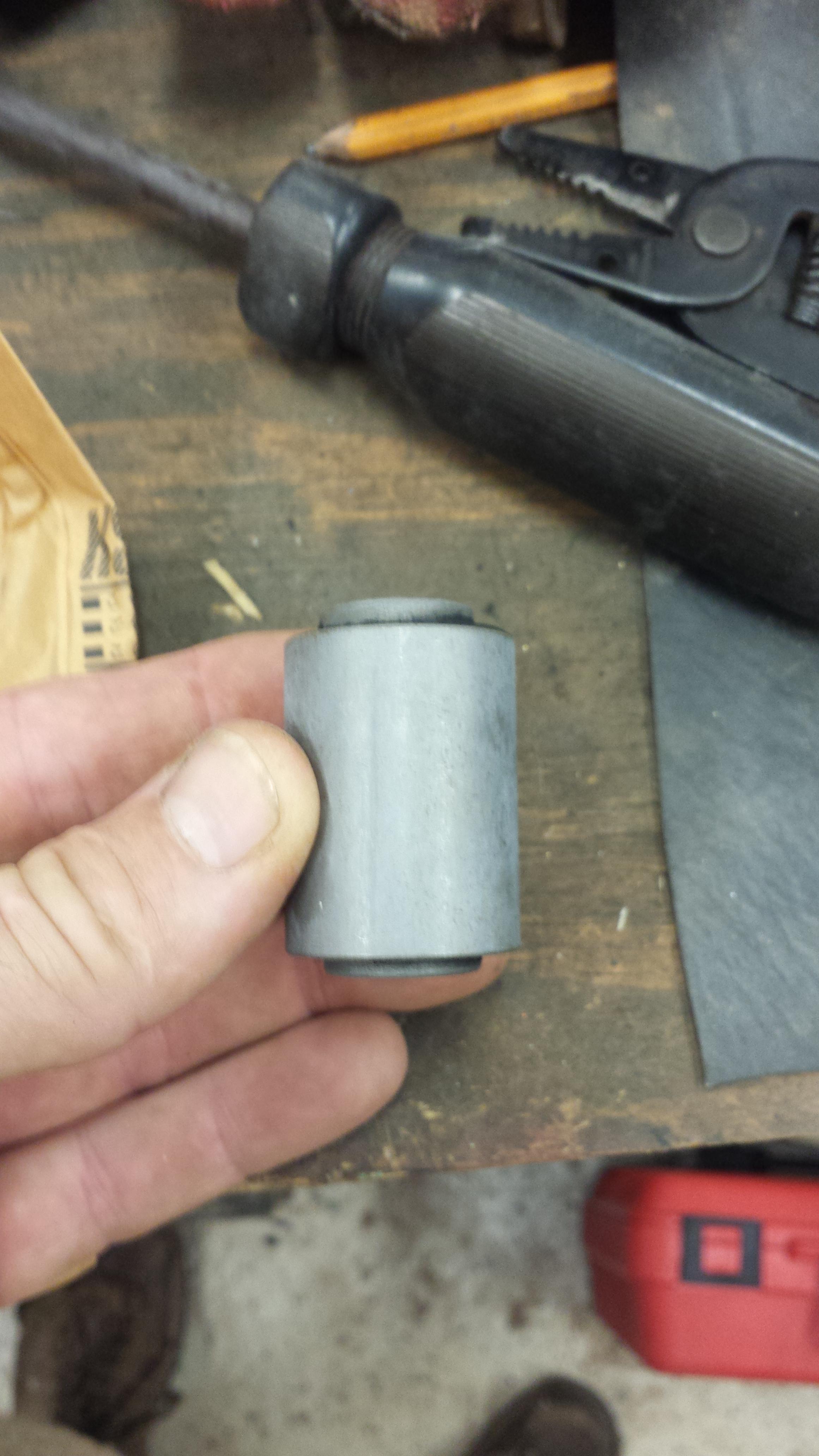

So as CO has mentioned there is a longer side to the rear swing arm bushings.
The longer side goes out away from the strut...
I suspect this is why some people have had a hard time reassembling the rear suspension in the past. If you were to orient these incorrectly the space would be about .008" too small for the rear strut to fit into.

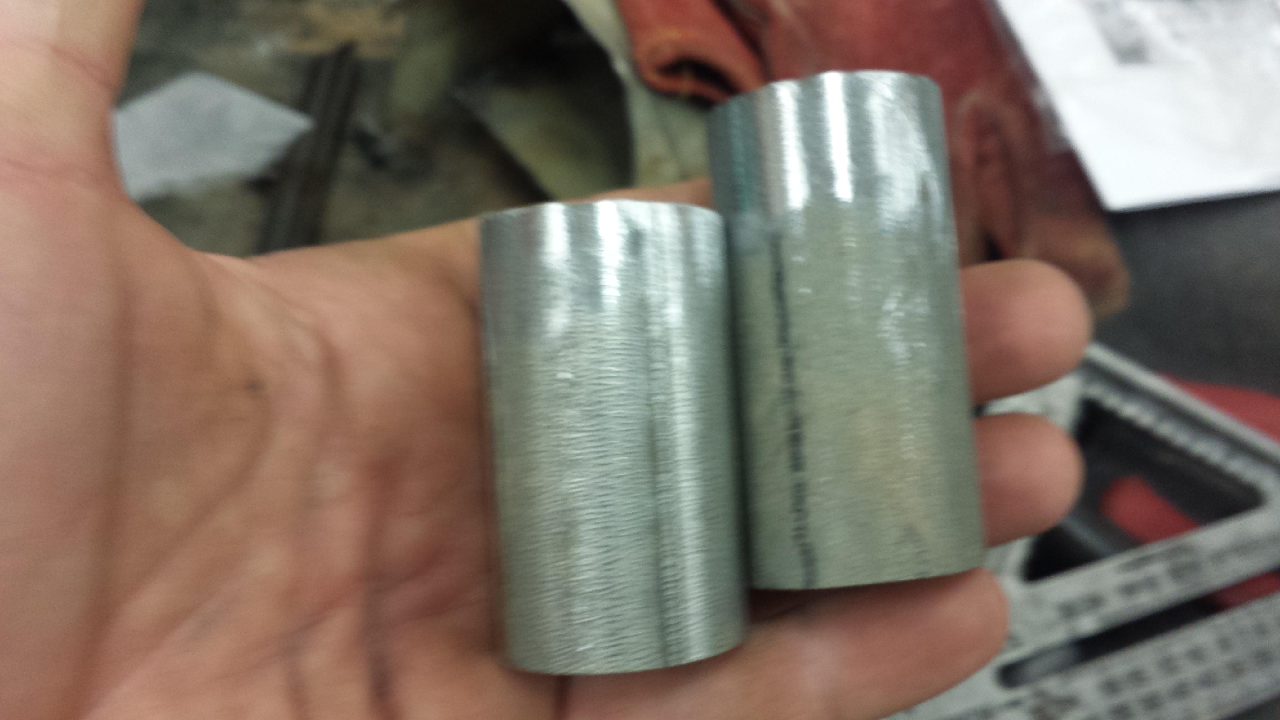

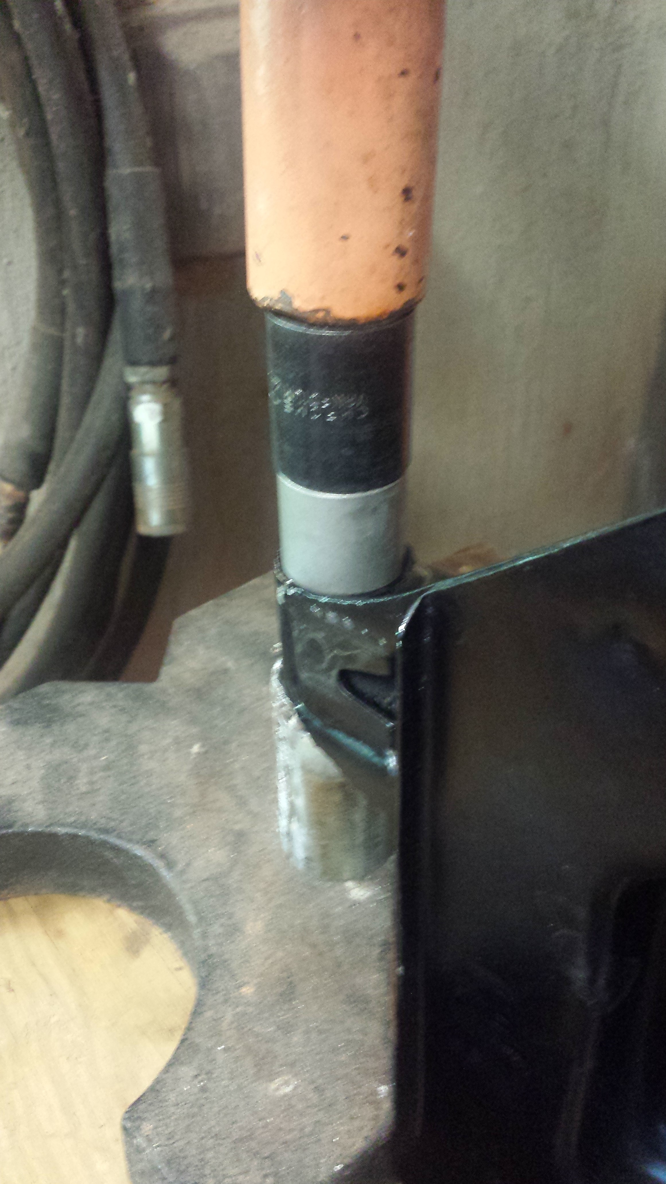

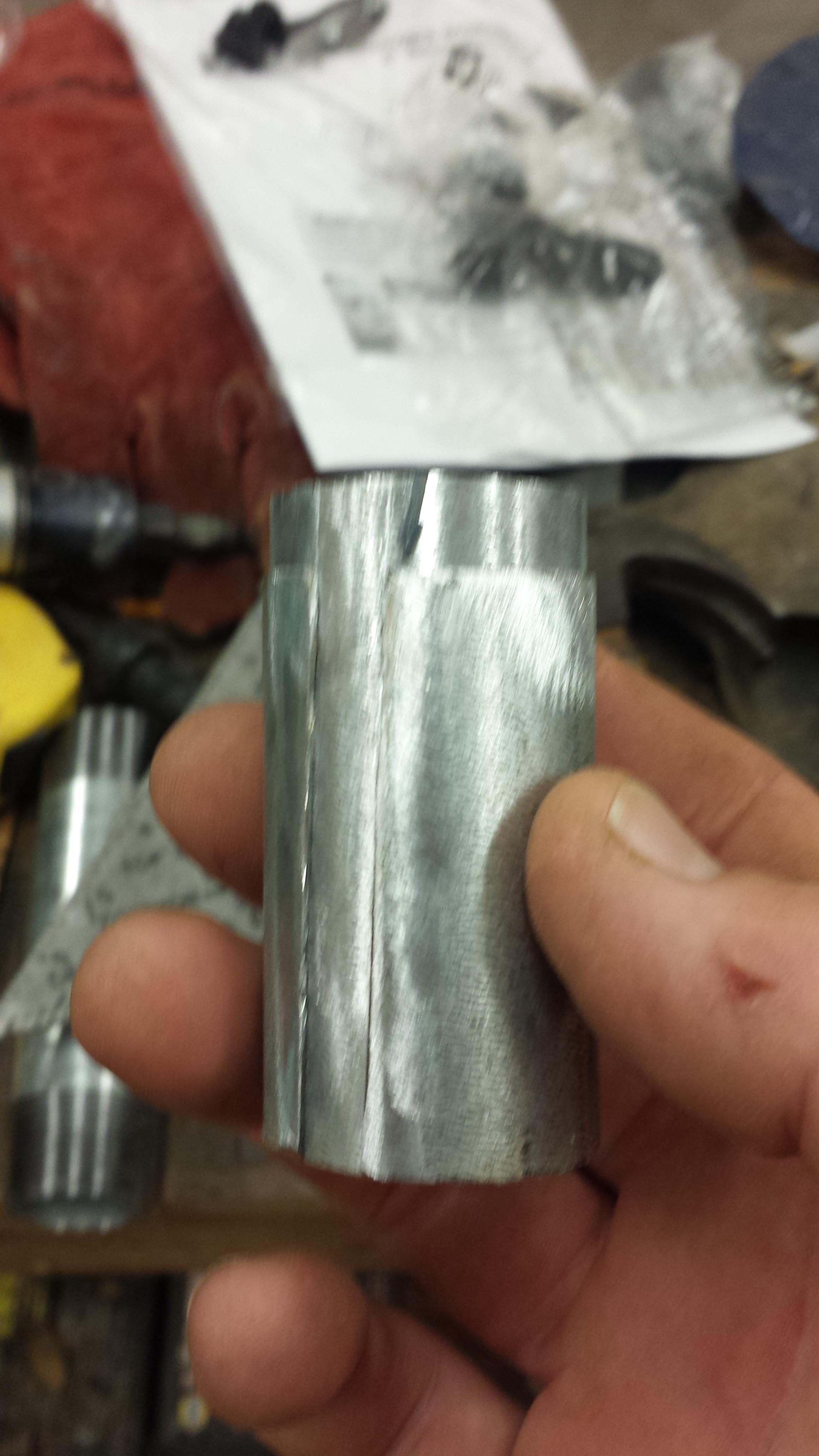

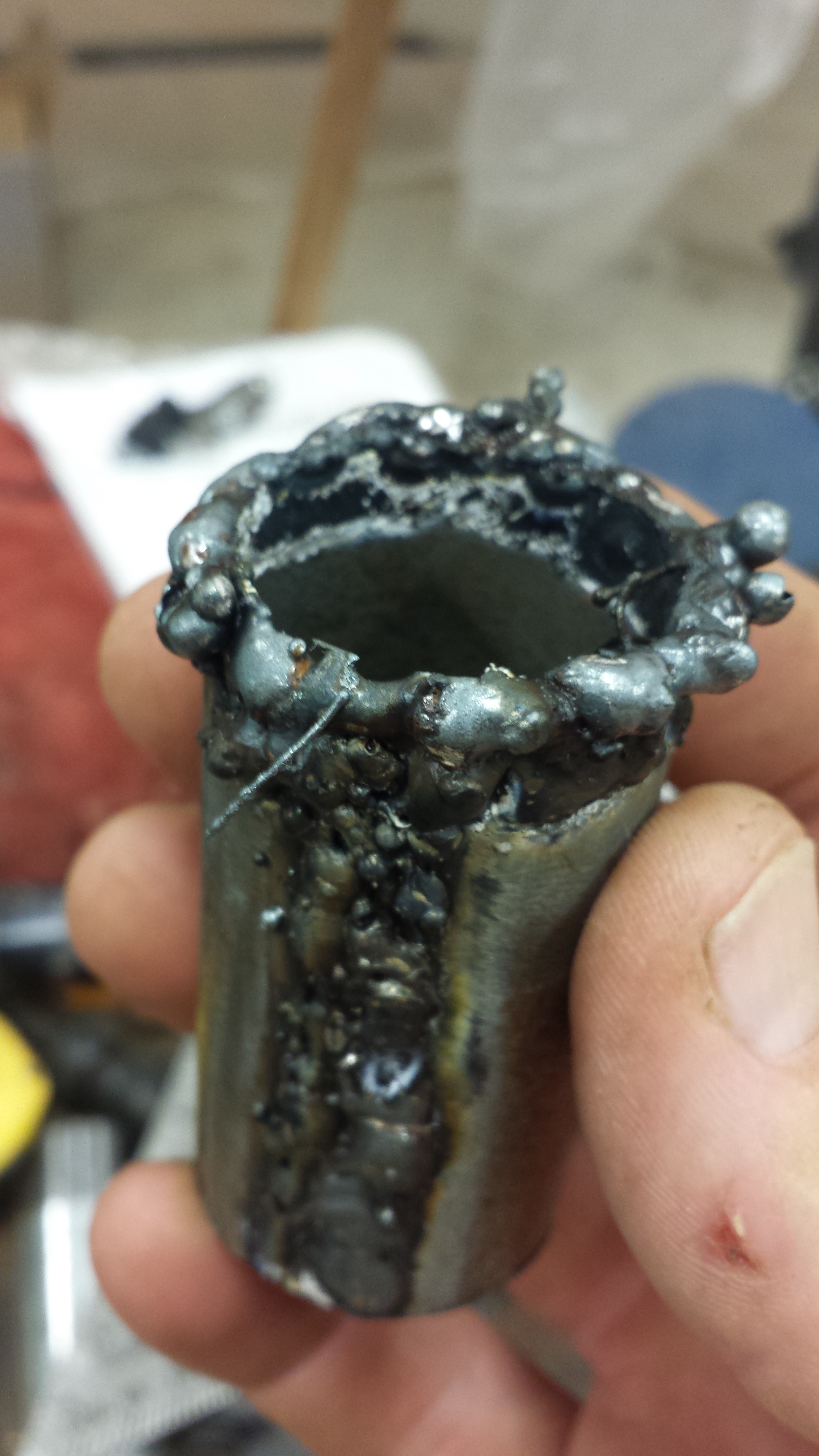

I found a pipe laying around in my stuff that was very close in ID to the bushing but it was thin wall stuff

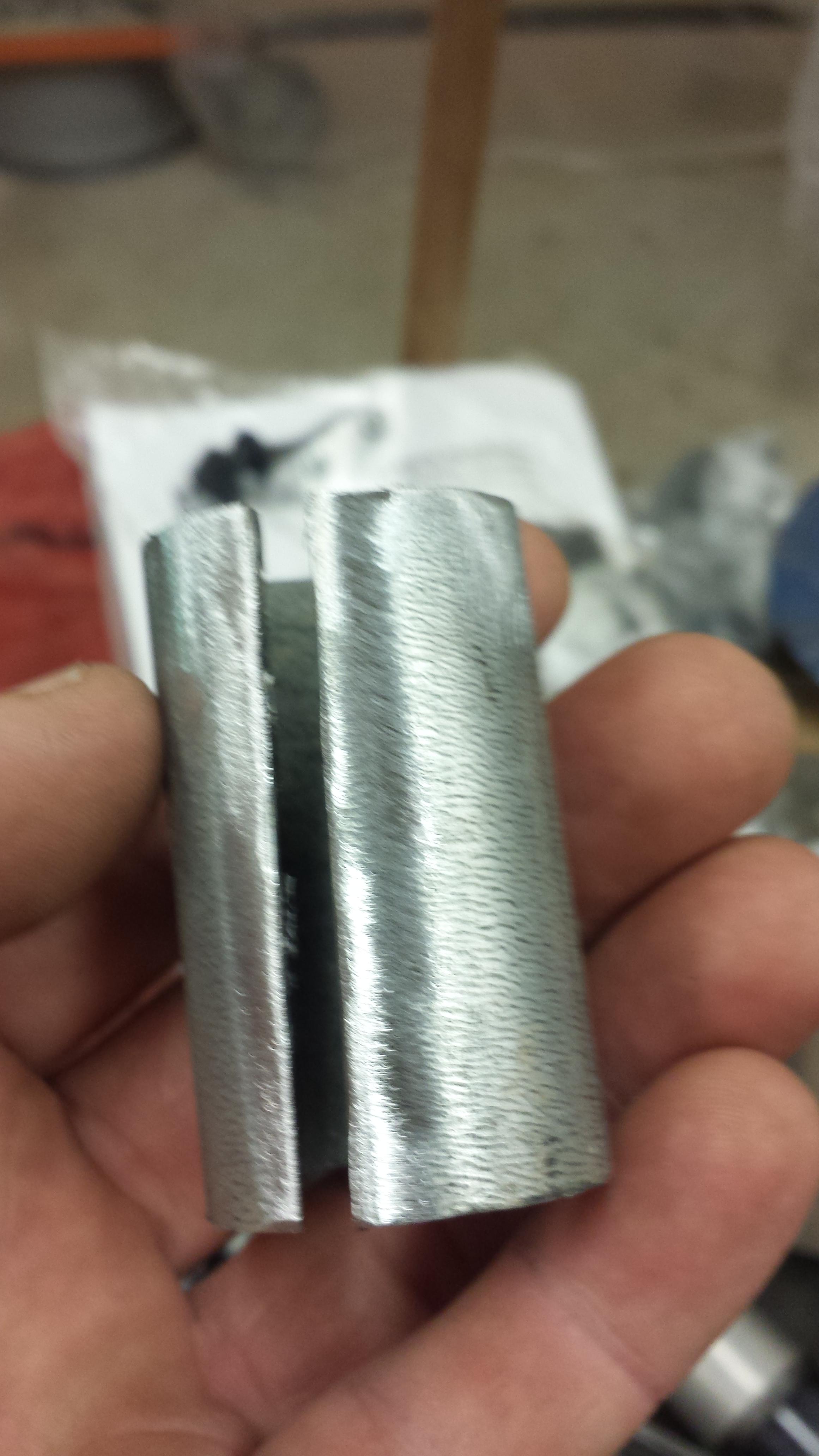

So I cut two pieces of it and split one down length wise

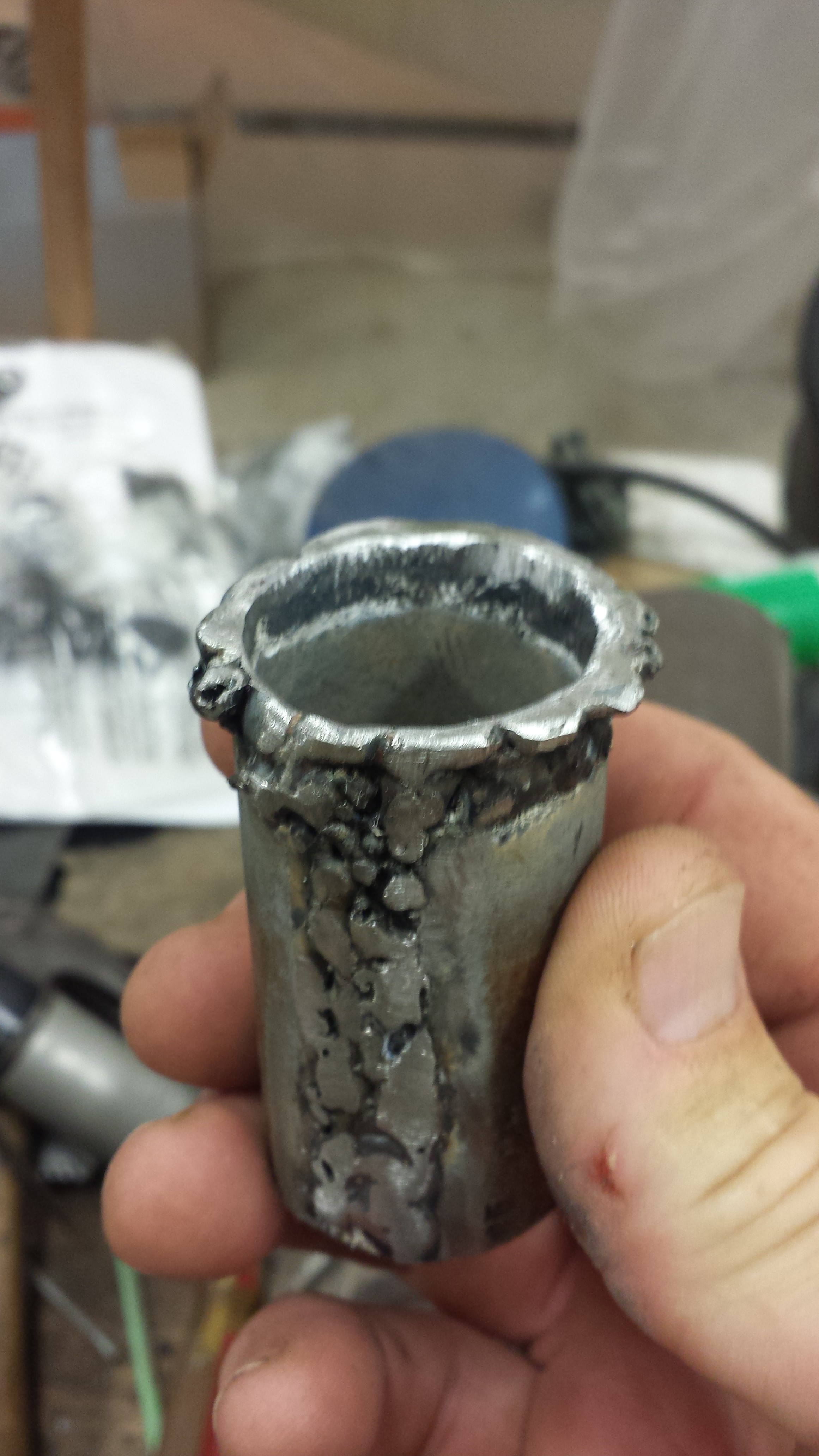

I then sleeved one inside the other and welded them together and welded around the lip for additional thickness
My apologies to the other welders here @grannyknot @disepyon these welds are pretty ugly. I assume I didn't get all the galvanize off, oh well :blush:
Dressed them down a little bit and tried them as an anvil...

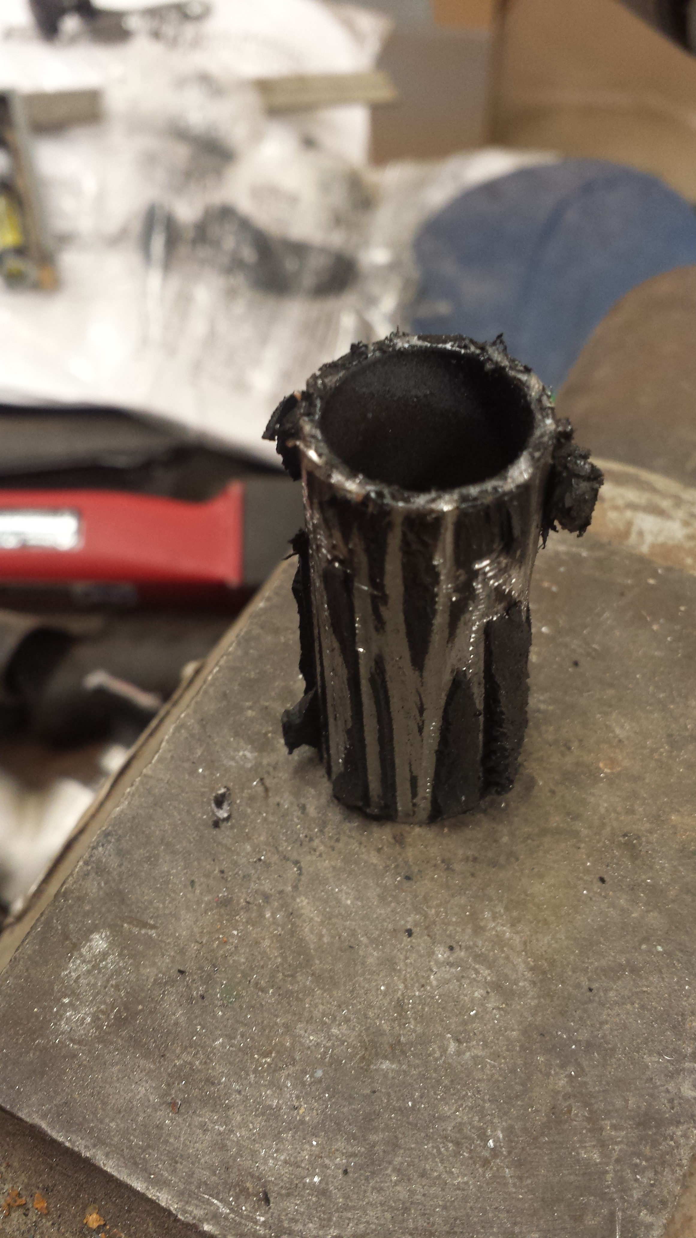

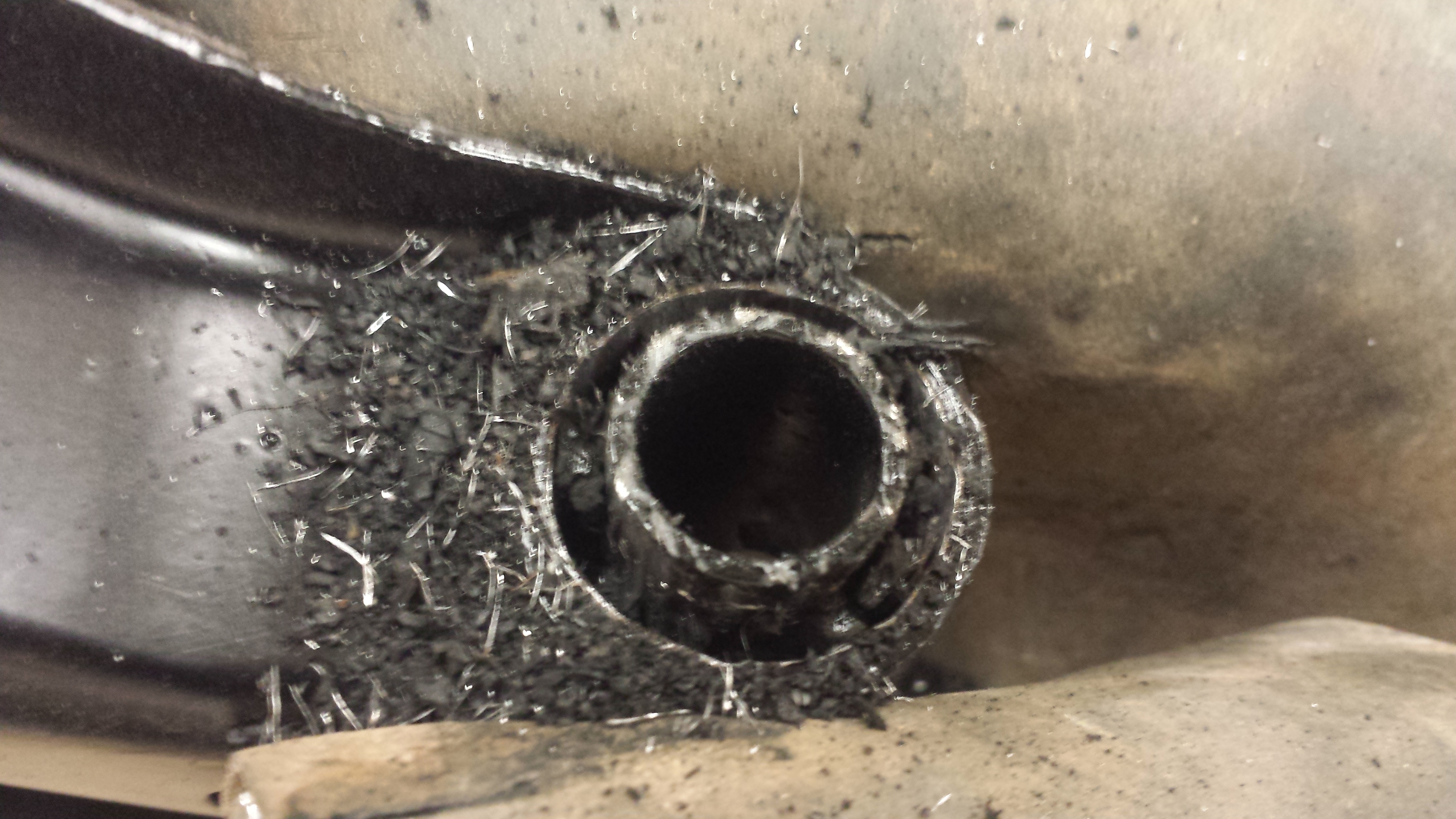

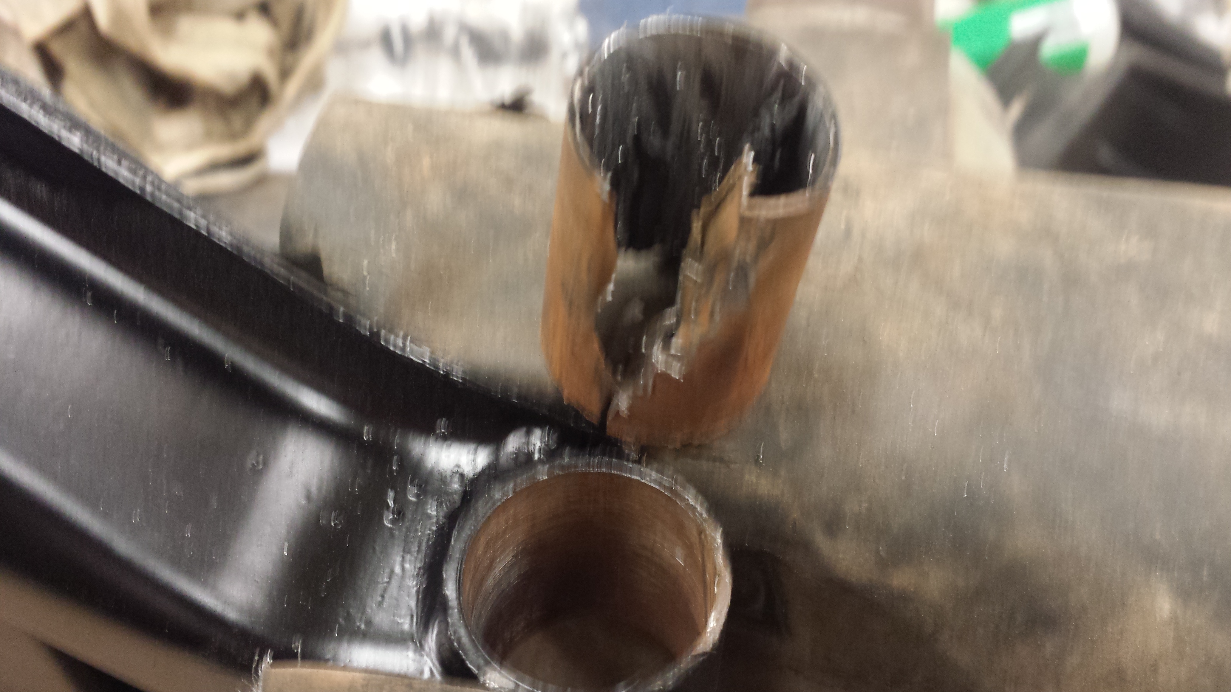

Not happening! I couldn't get the anvil to line up well enough to receive the old bushing. So I resorted to less elegant methods. I didn't want to burn them out because the pieces are already painted. So I took a drill bit and drilled all around them...

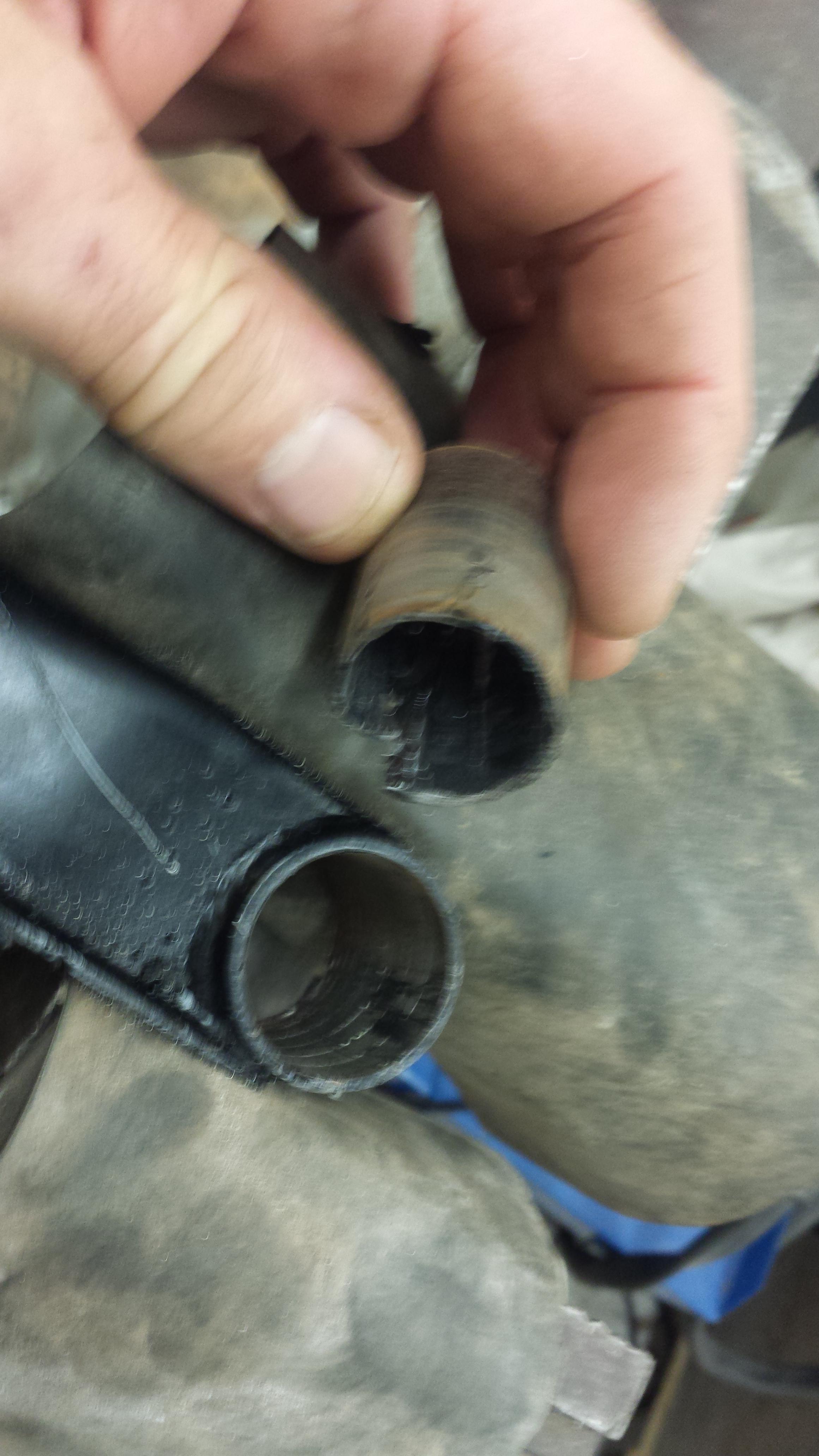

Then I tore the center out with pliers
Then I took my body saw and made some cuts through the remaining bushing shell and collapsed it on itself

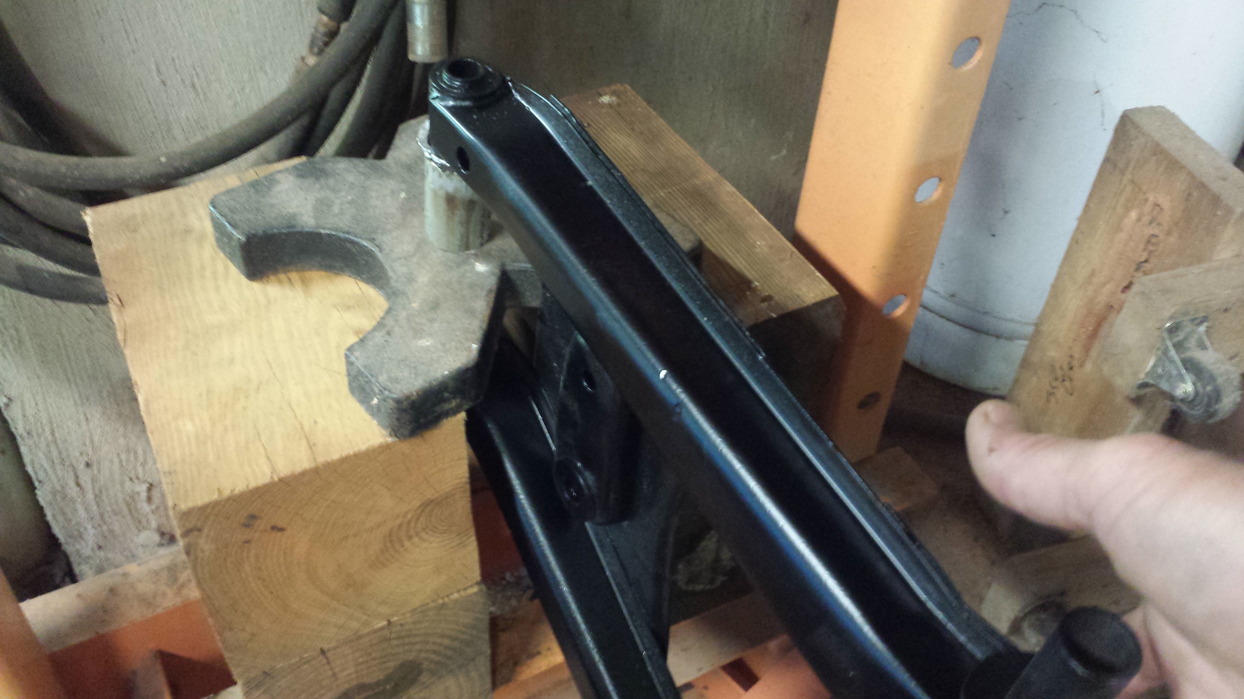

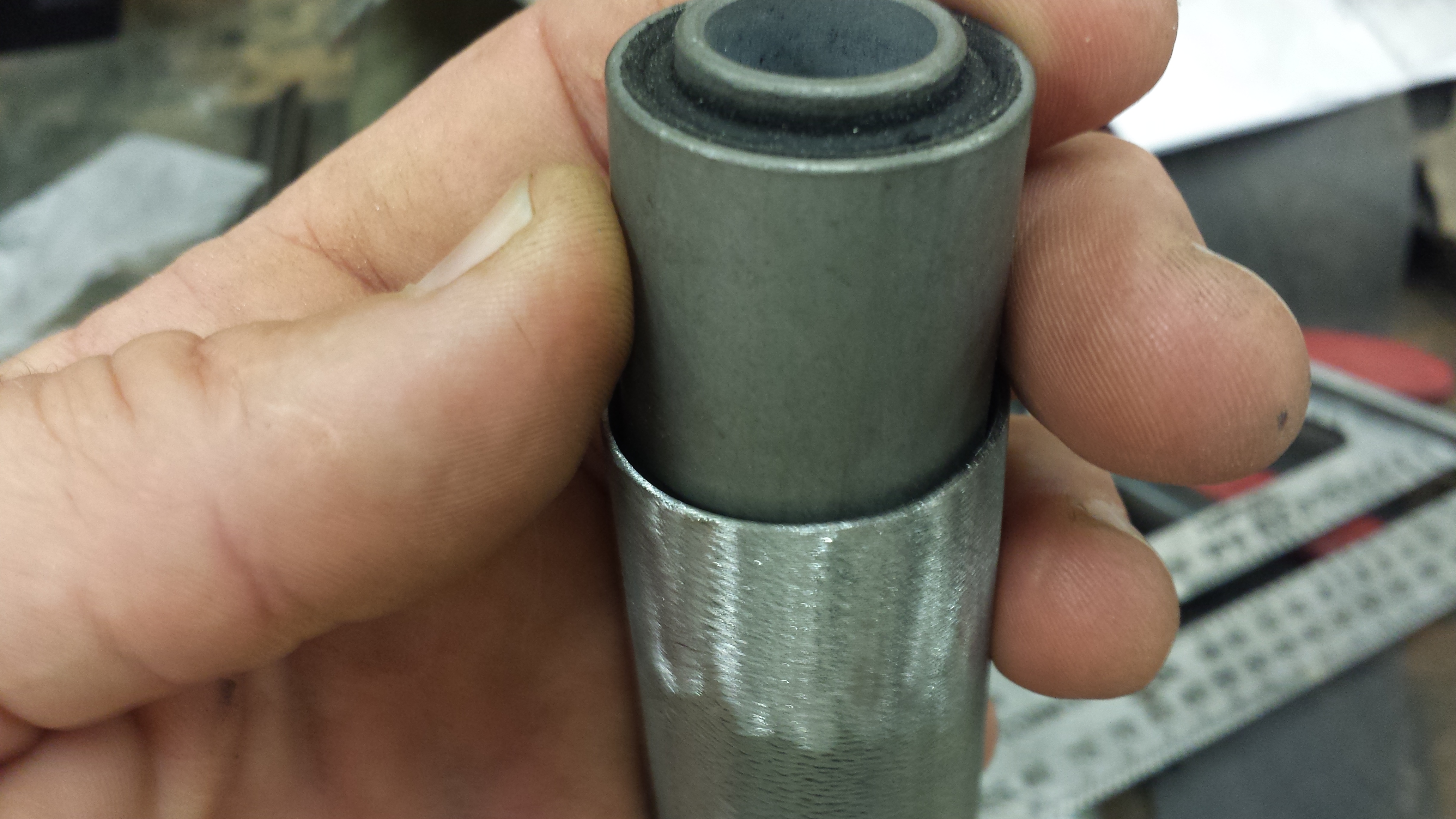

Pressing them in after that was a piece of cake
Even though I couldn't use the fabbed anvil for removal it worked great for the reinstall.
