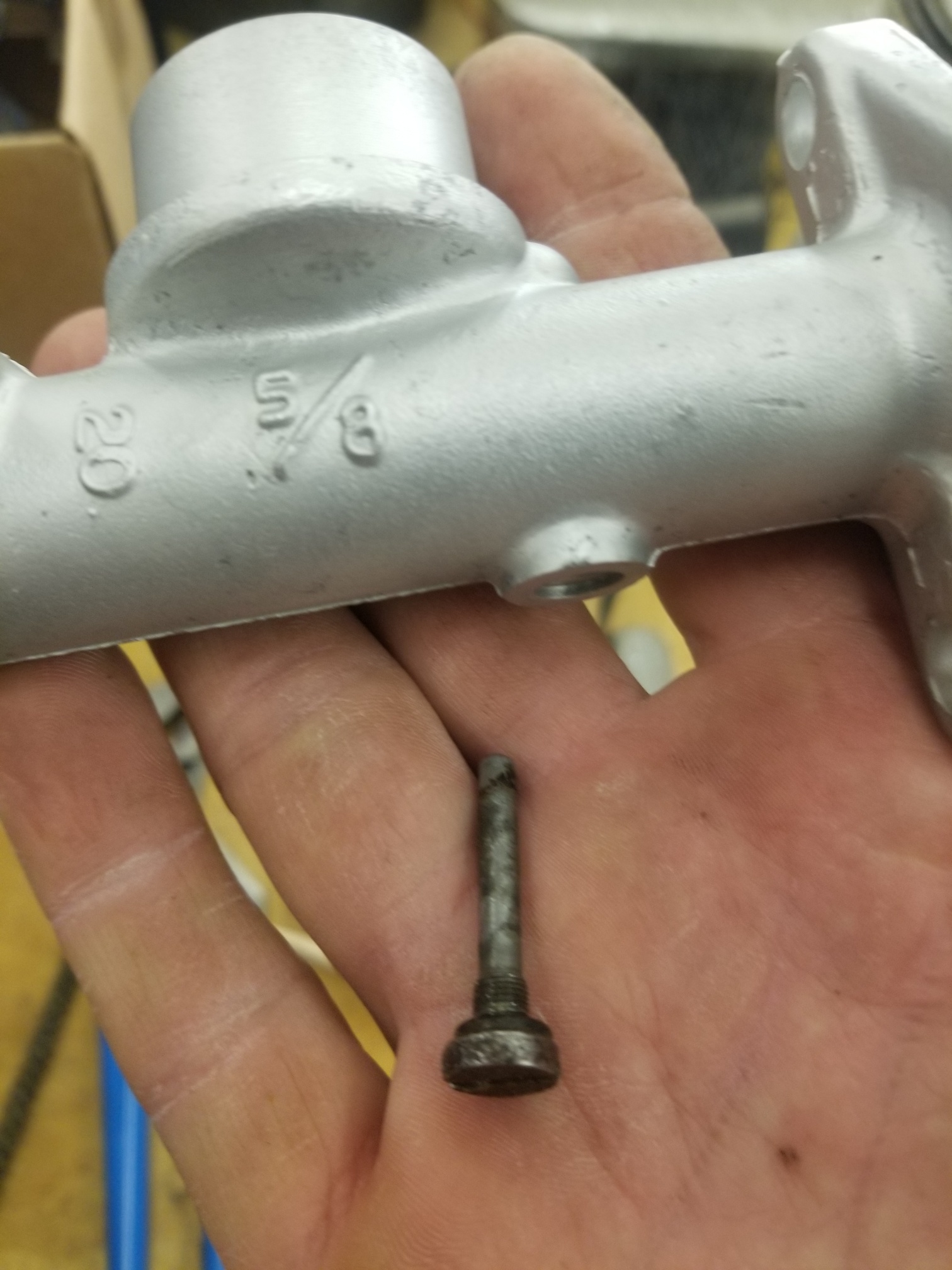

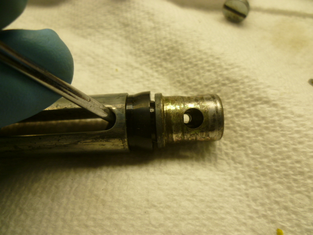

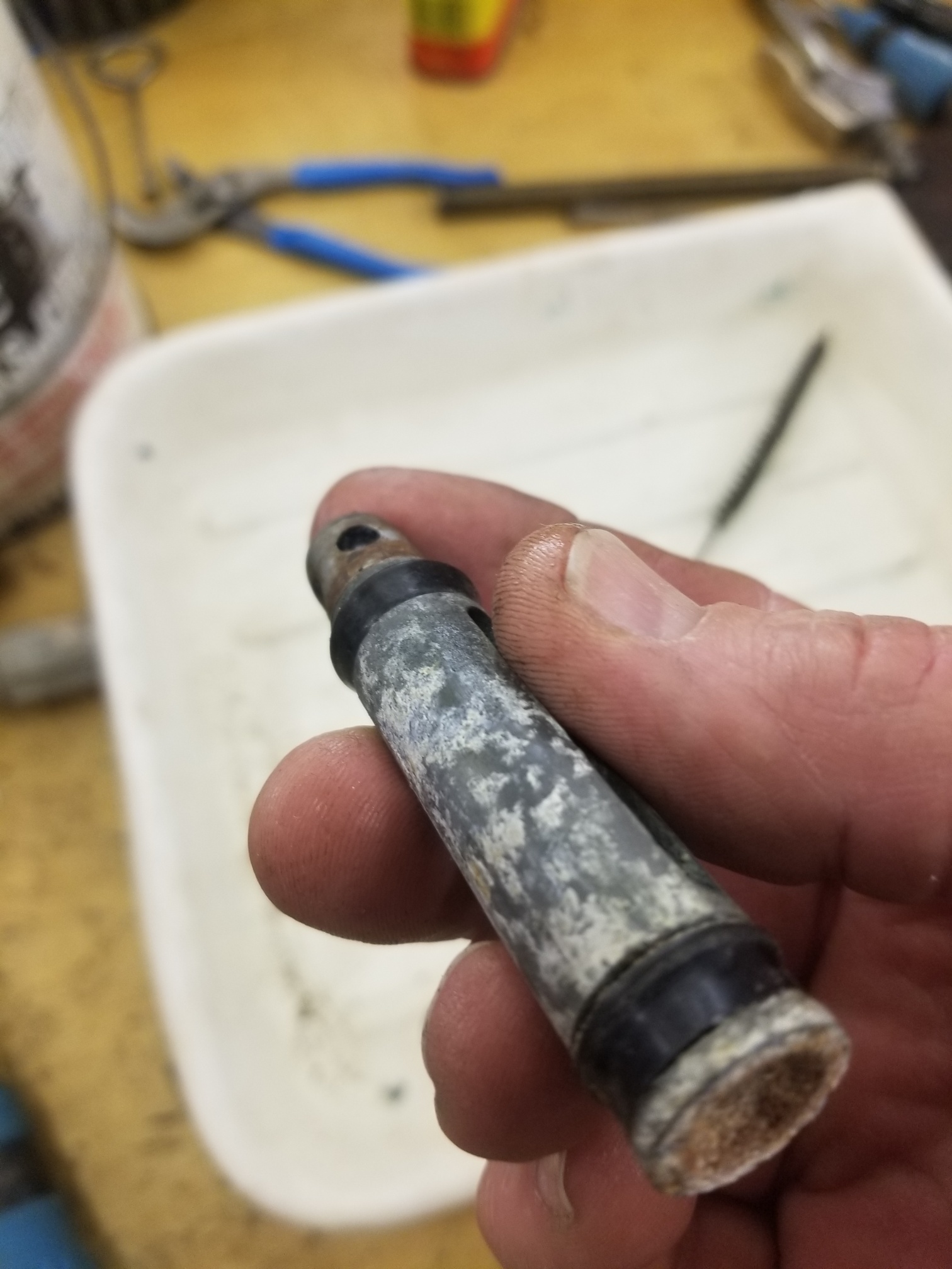

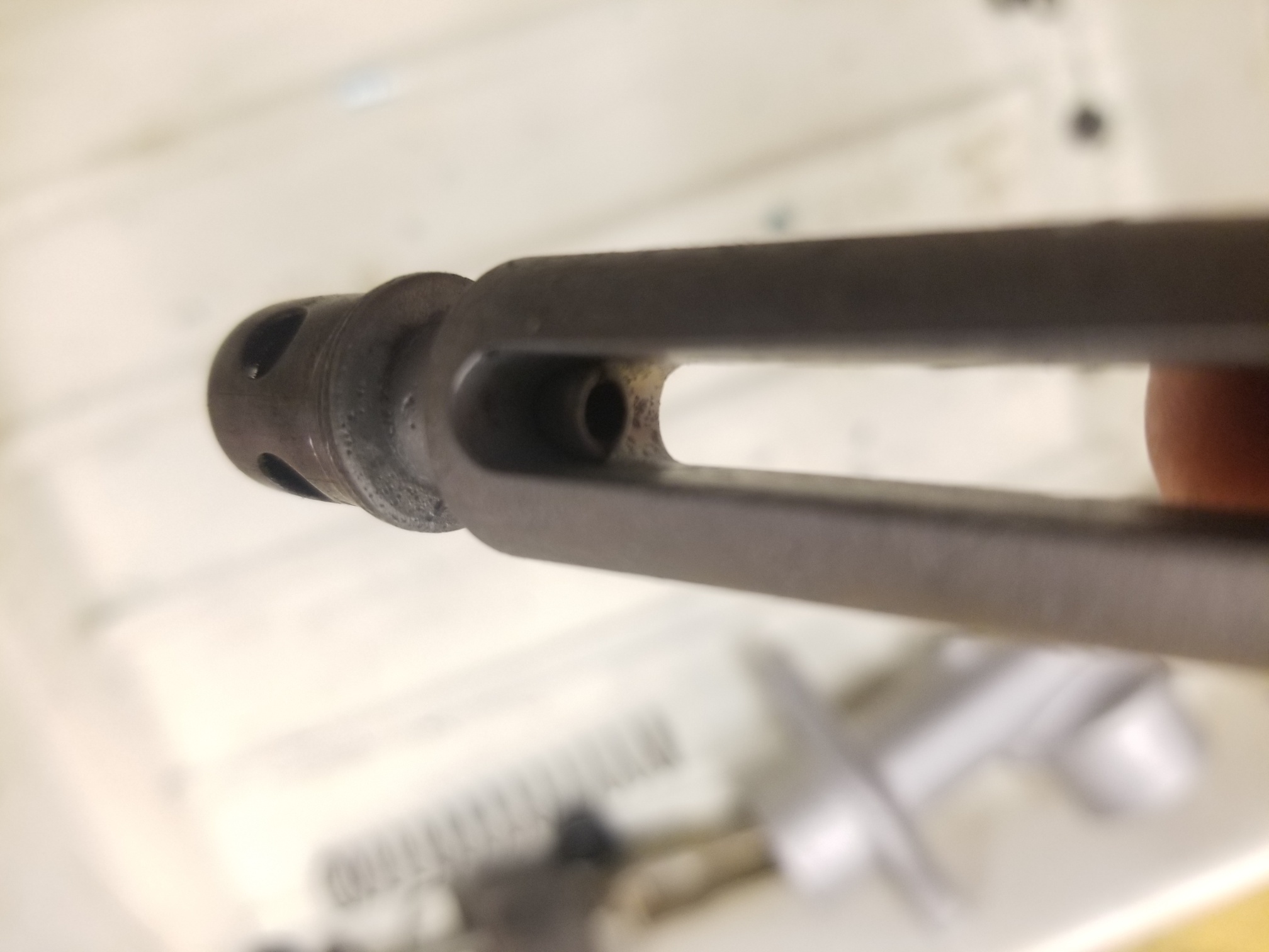

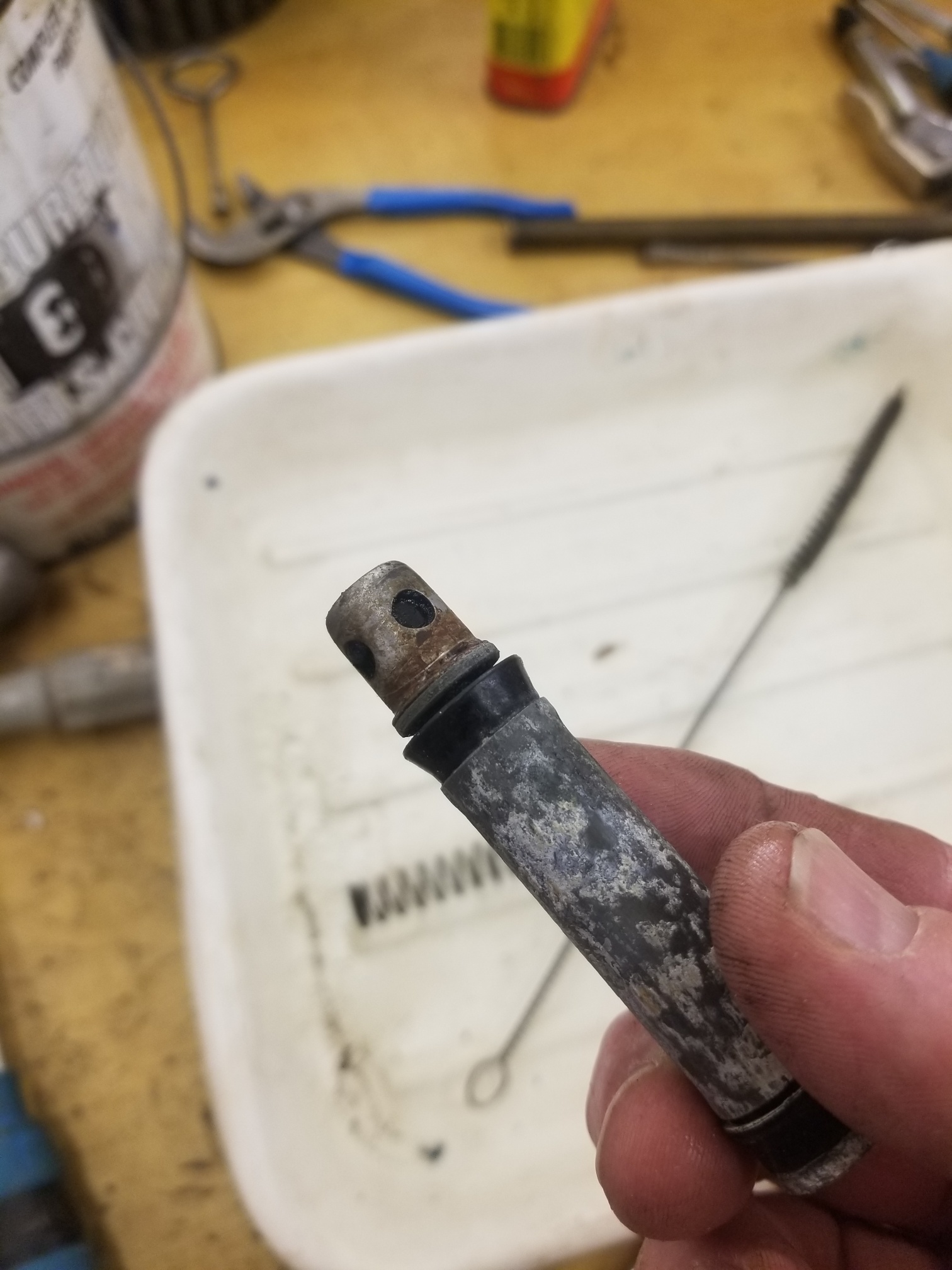

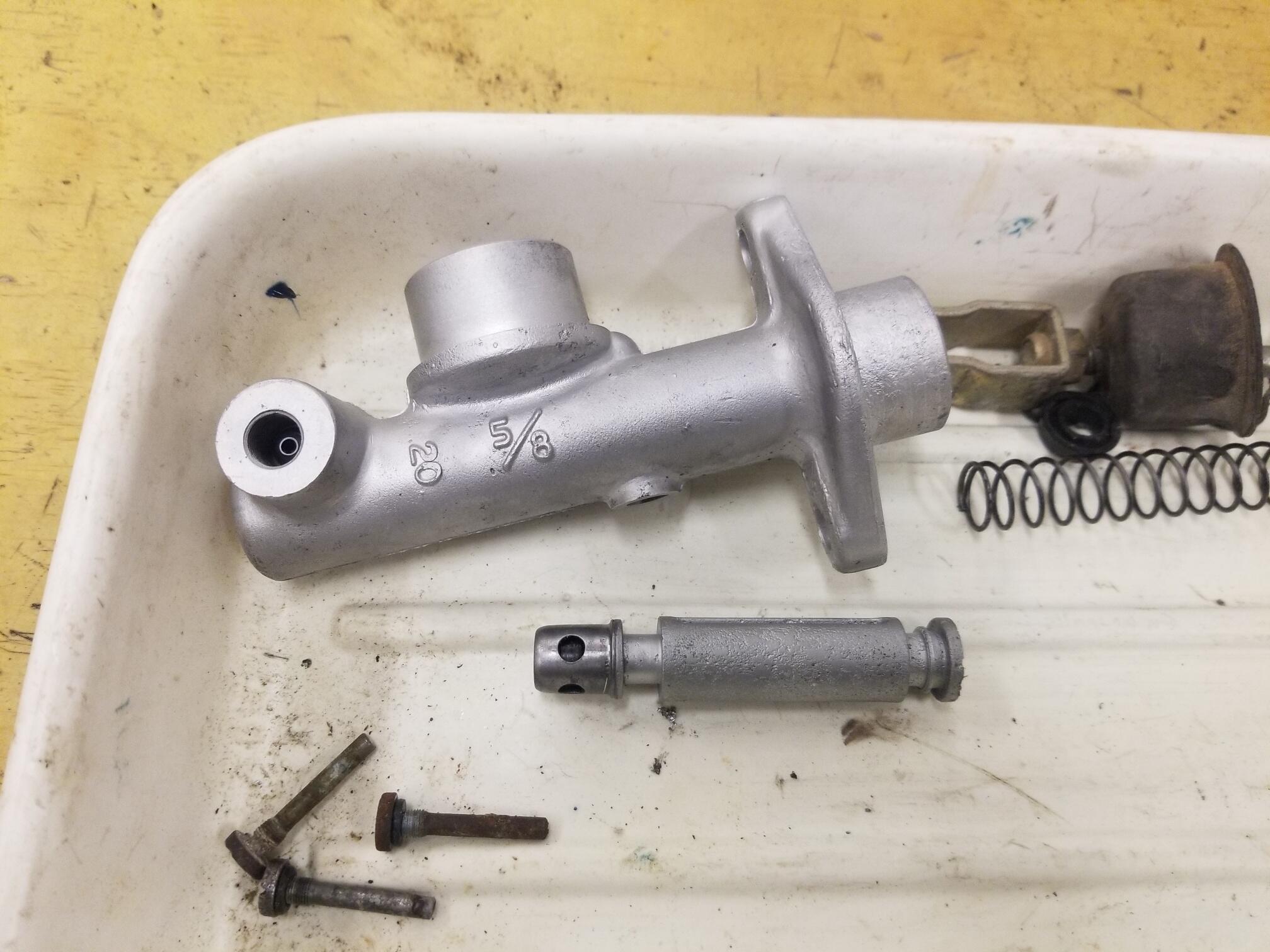

January 20, 20232 yr Author comment_649509 Worked on a couple of clutch masters a little more Got the grease cleaned out of one. That is actually one pf the harder parts. Polished the bore with some 1000 grit. Bead blasted the aluminum parts What is the valving at the end of the piston? How does it work? I have this vintage rebuild kit Does anyone know what the finish was on this screw? Yellow zinc or clear? Â Link to comment https://www.classiczcars.com/forums/topic/55369-1971-hls30-14938-lily-build/?&page=52#findComment-649509 Share on other sites More sharing options...

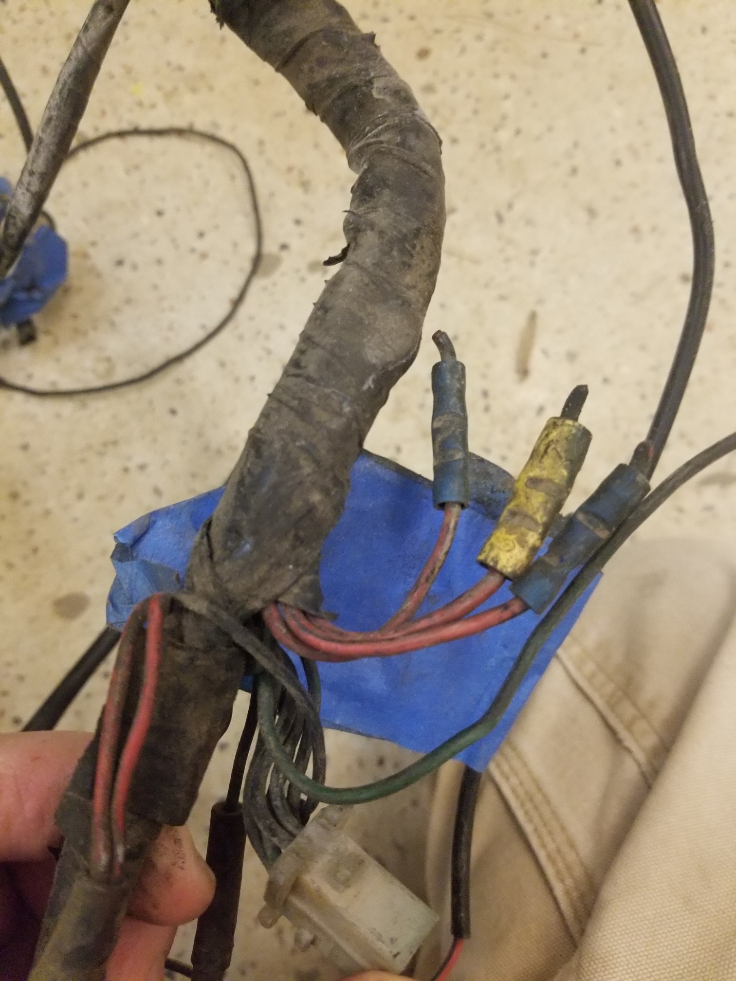

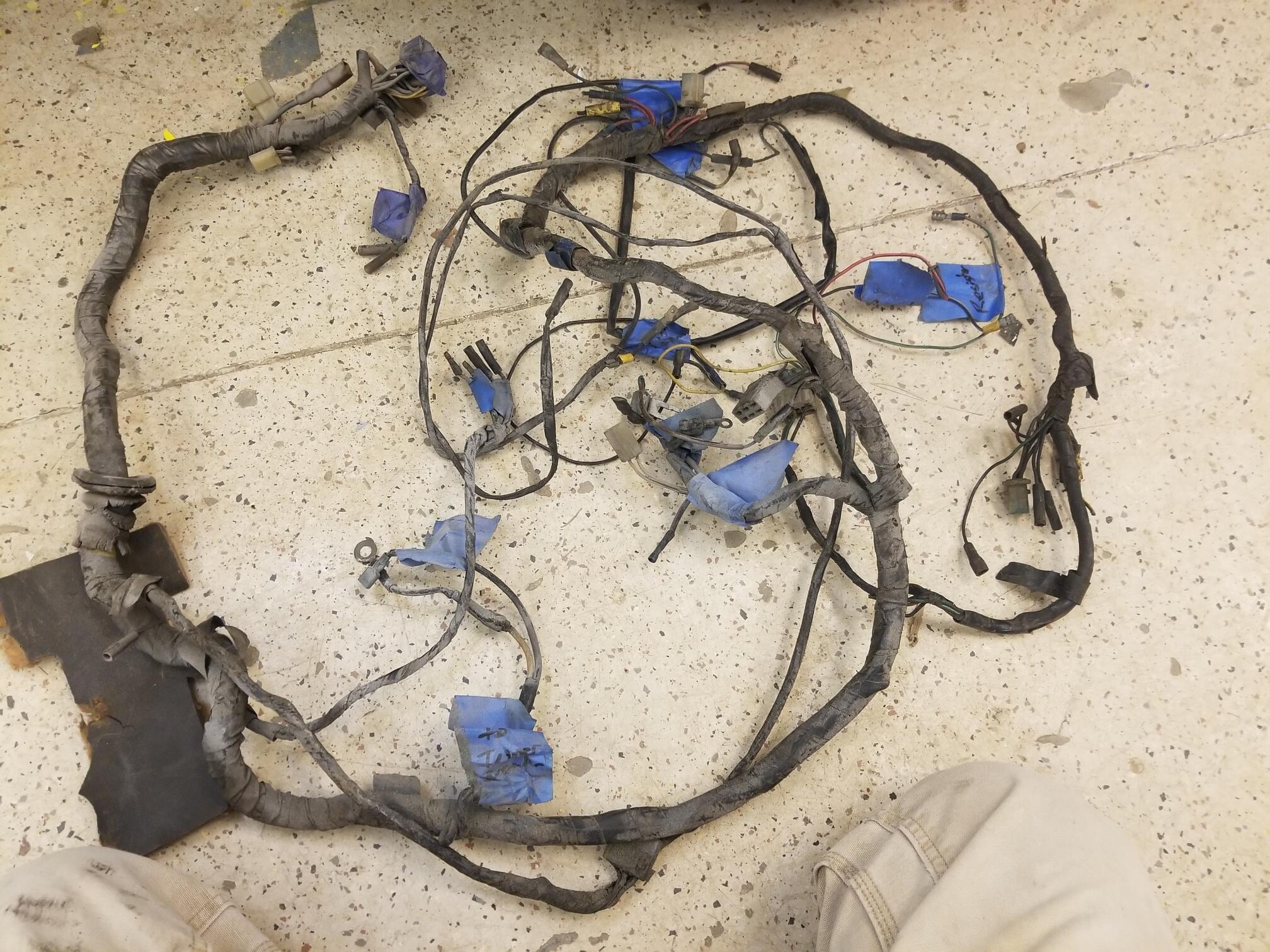

January 20, 20232 yr Author comment_649510 On 1/19/2023 at 6:13 AM, SteveJ said: D'oh! I missed the hint. Â You know I'll help. It's more a matter of scheduling than anything else. Are those the headlight plugs they cut off? Link to comment https://www.classiczcars.com/forums/topic/55369-1971-hls30-14938-lily-build/?&page=52#findComment-649510 Share on other sites More sharing options...
January 20, 20232 yr comment_649515 11 minutes ago, Patcon said: Are those the headlight plugs they cut off? You lost me on that one. Is there a picture I should be looking at? Link to comment https://www.classiczcars.com/forums/topic/55369-1971-hls30-14938-lily-build/?&page=52#findComment-649515 Share on other sites More sharing options...
January 21, 20232 yr Author comment_649520 Huh! I guess I didn't post them... Â Link to comment https://www.classiczcars.com/forums/topic/55369-1971-hls30-14938-lily-build/?&page=52#findComment-649520 Share on other sites More sharing options...
January 21, 20232 yr Author comment_649521 Link to comment https://www.classiczcars.com/forums/topic/55369-1971-hls30-14938-lily-build/?&page=52#findComment-649521 Share on other sites More sharing options...

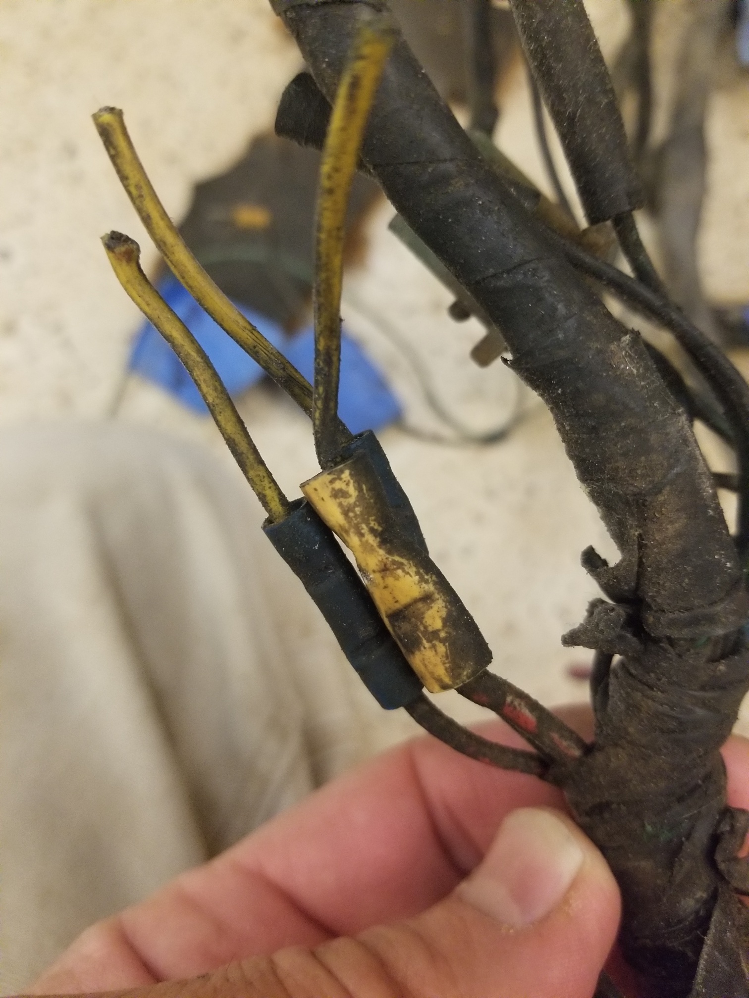

January 21, 20232 yr comment_649525 Yep, the headlight harness connections have been hacked off. *Sigh* Link to comment https://www.classiczcars.com/forums/topic/55369-1971-hls30-14938-lily-build/?&page=52#findComment-649525 Share on other sites More sharing options...

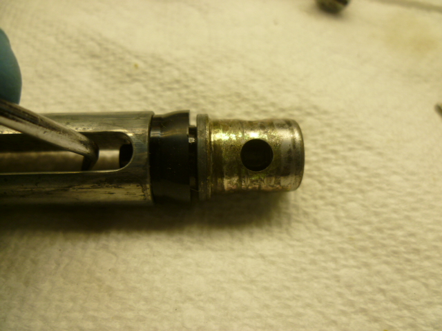

January 21, 20232 yr comment_649534 3 hours ago, Patcon said: What is the valving at the end of the piston? How does it work? That valve is supposed to be open when the piston is at rest (not pushed in) and closed when the piston is pushed in. In other words... When your foot is pushing the clutch pedal in, that valve is closed. It opens by catching on the little retaining pin you were questioning about the color. The function of that valve is allows fluid to fill the plunger area if necessary, but then close off when the piston starts to move so hydraulic pressure can build. The tip of the pin rides in that long groove, and when the piston is at rest, that pin pushes against a small weak spring and opens the valve. Valve closed: Valve open: Easy-peasy. Link to comment https://www.classiczcars.com/forums/topic/55369-1971-hls30-14938-lily-build/?&page=52#findComment-649534 Share on other sites More sharing options...
January 22, 20232 yr comment_649573 On 1/21/2023 at 3:49 AM, Captain Obvious said: That valve is supposed to be open when the piston is at rest (not pushed in) and closed when the piston is pushed in. In other words... When your foot is pushing the clutch pedal in, that valve is closed. It opens by catching on the little retaining pin you were questioning about the color. The function of that valve is allows fluid to fill the plunger area if necessary, but then close off when the piston starts to move so hydraulic pressure can build. The tip of the pin rides in that long groove, and when the piston is at rest, that pin pushes against a small weak spring and opens the valve. Valve closed: Valve open: Easy-peasy. That is why it is very important to adjust pedal travel correctly. That valve has a necessary job when initially installing new components, clutch disc wear and eventual minor leaks. Poor adjustment leads to reduced clutch travel, which leads to poeple adjusting the pedal more to "compensate" for the reduced travel and the cry for help "my clutch won't disengage." Link to comment https://www.classiczcars.com/forums/topic/55369-1971-hls30-14938-lily-build/?&page=52#findComment-649573 Share on other sites More sharing options...
January 22, 20232 yr Author comment_649586 So I'm thinking I'm going to replace the headlight wires in this harness. I will weave new wires in the harness while I rewrap it. What colors do I need? (R/W, R/Y, R, R/B?) What gauge wire matches the factory gauge? Also does the Vintage Connections kit have the correct headlight plugs in it? Thanks C Link to comment https://www.classiczcars.com/forums/topic/55369-1971-hls30-14938-lily-build/?&page=52#findComment-649586 Share on other sites More sharing options...
