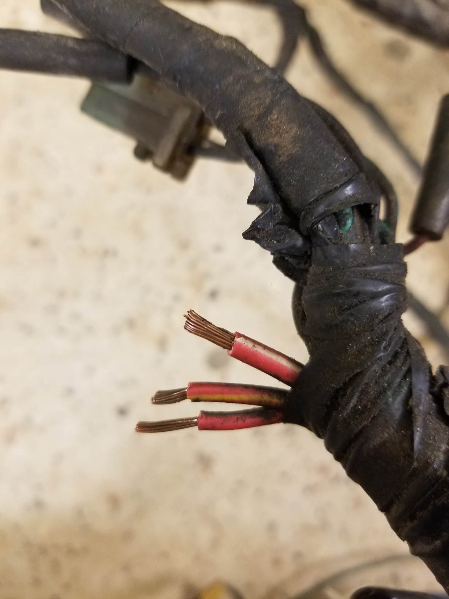

Also one of the ones to the headlights in the harness looks to be a red 10ga. All the rest of the cut wires appear to be 14ga. There is a plain red 14 ga too apparently

So is there a crimp in the harness somewhere?
I'm not sure we're at the same place here. If you are talking about in the engine harness, I can see in the FSM, it shows a red for the headlights and a red for the fog lights. I do not know if the fog lights were run as 10AWG. The headlights were 14 AWG.

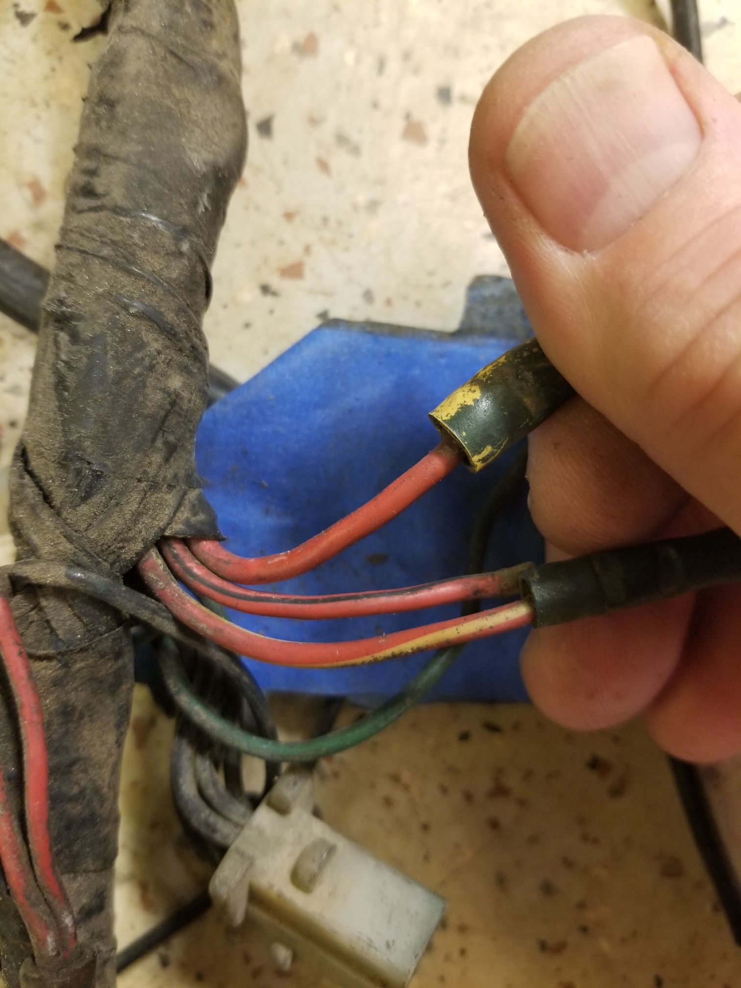

So I'm thinking I'm going to replace the headlight wires in this harness. I will weave new wires in the harness while I rewrap it. What colors do I need? (R/W, R/Y, R, R/B?) What gauge wire matches the factory gauge?
I think these Japanese cars have the metric system on wiring.. so you need 2,5 mm2 wires for the headlights, actually 2 mm2 would be sufficient but i think they are 2,5mm2  (house wiring over here is often 2,5mm2.. good for 16 amps)
If you are gonna use the H4 lamps of 65 watt a piece then you have no trouble at all.

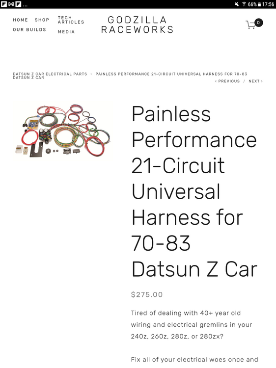

The one in the link covers a lot of models. S30 and the S130. Bold statement they are making.Screenshot_20230123-175630.png
