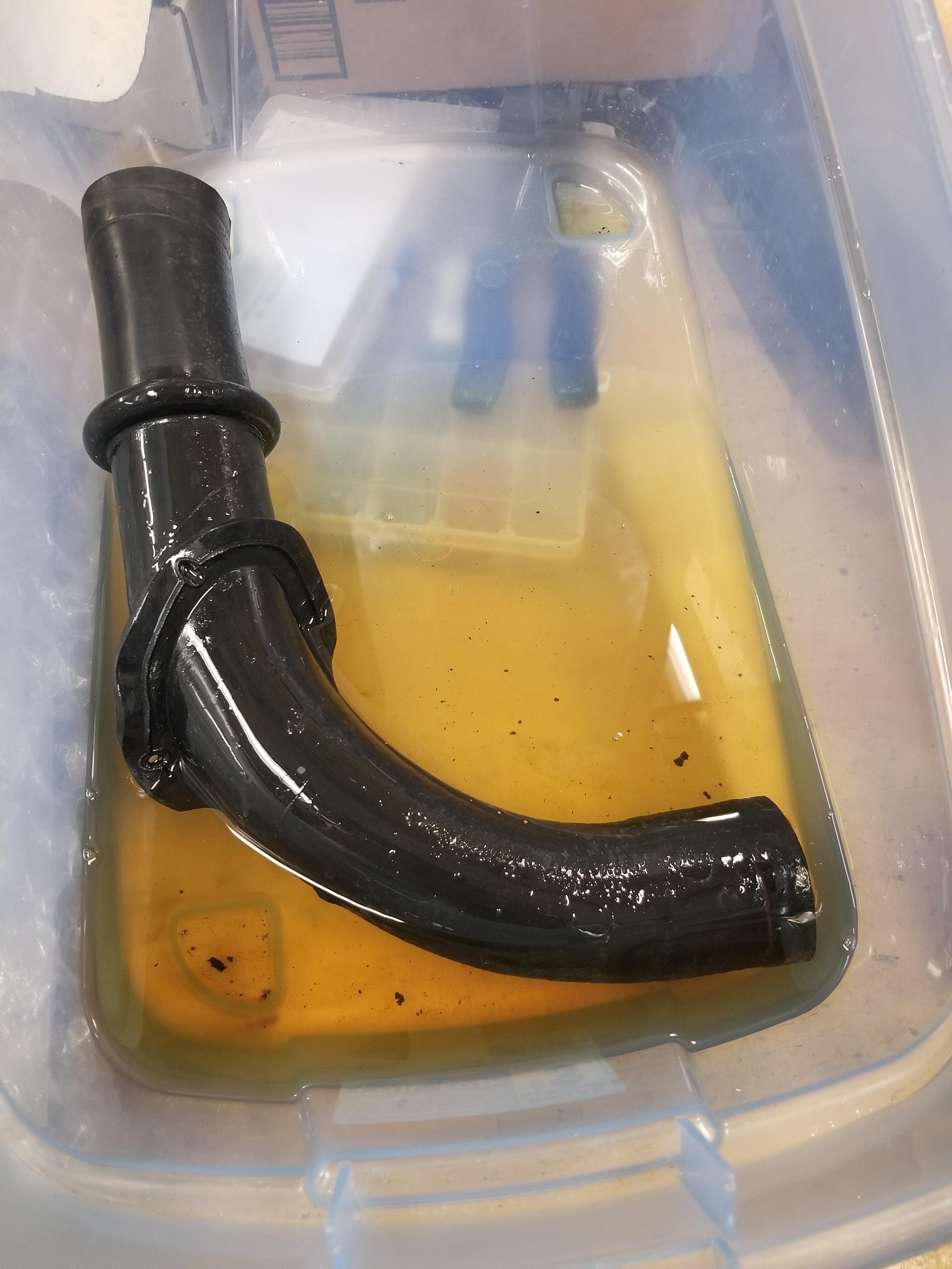

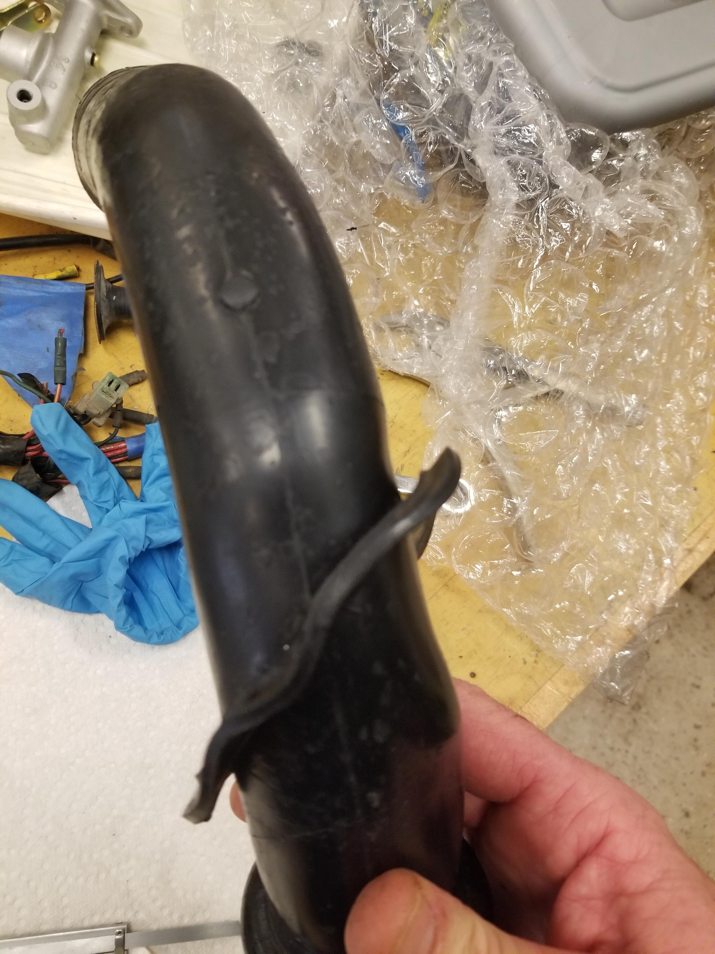

February 9, 20232 yr Author Popular Post comment_650118 So as an update. I tried softening the rubber caps that go to the fuel sender. I tried silicone spray like Mark suggested. Nothing... Now these were rock hard, we were afraid to flex them for fear of breaking them. I wish I had made a video... So I tried Wintergreen oil but instead of water and heating them I used denatured alcohol 1:1. I heated the rubber parts slightly with a heat gun. Let soak overnight. AMAZING!! They were tremendously soft. I mean really good. It has been a week since I pulled them out and they are still nice and soft. I ordered some more oil because I needed more volume. I am going to try it on Cody's Goon's filler neck. Sort of an unobtainium piece... Link to comment https://www.classiczcars.com/forums/topic/55369-1971-hls30-14938-lily-build/?&page=54#findComment-650118 Share on other sites More sharing options...

February 10, 20232 yr Author comment_650128 There are a couple of challenges with this method. Wintergreen oil is expensive! Buy the commercial version not the essential oil version. Also you have to use a lidded container to prevent tthe alcohol from flashing off. The rubber boots are marginally larger than the petrified version. It's possible they're swollen or maybe they were originally that size and shrunken with age. Difficult to know... But so far so good. Link to comment https://www.classiczcars.com/forums/topic/55369-1971-hls30-14938-lily-build/?&page=54#findComment-650128 Share on other sites More sharing options...

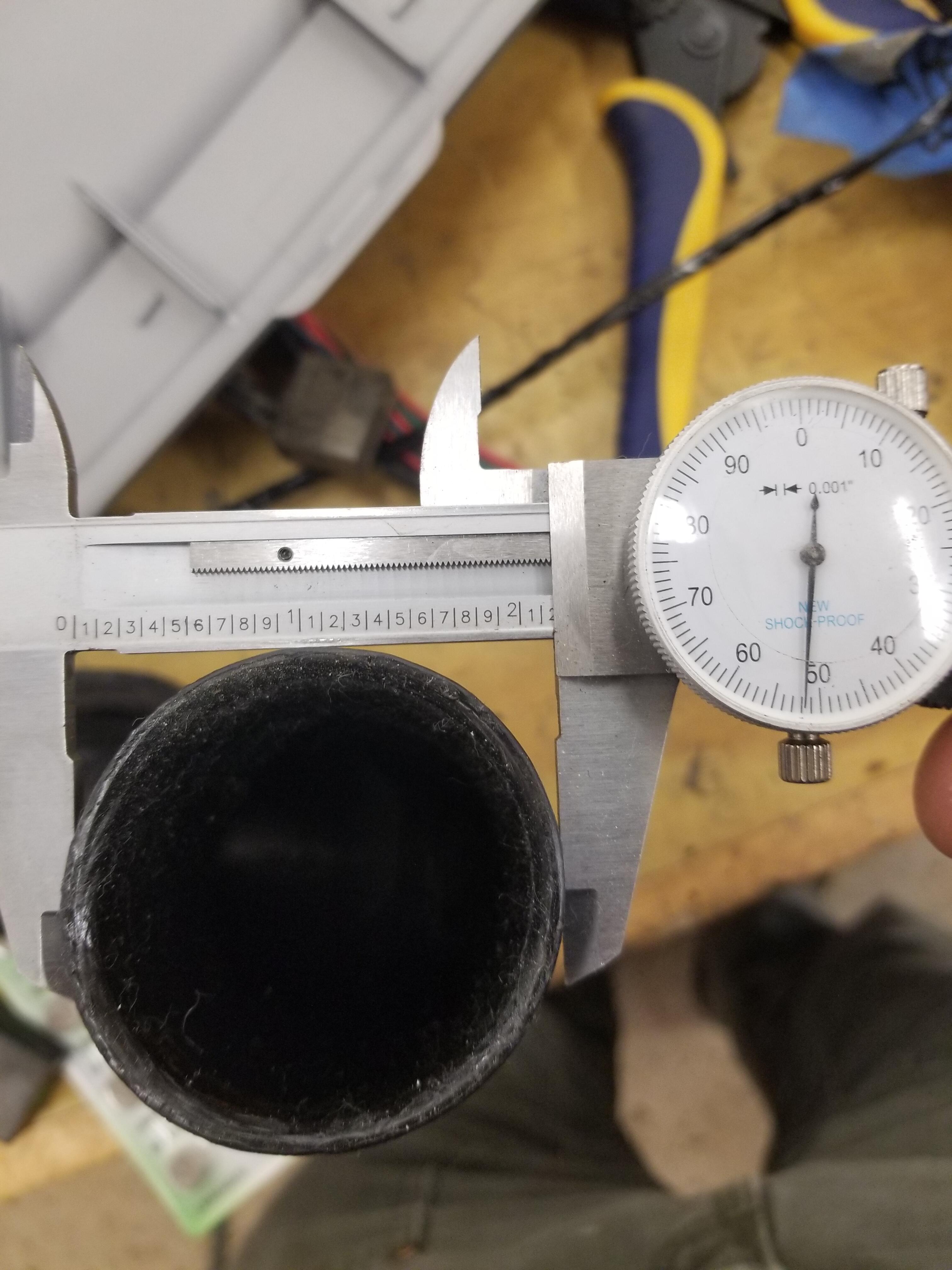

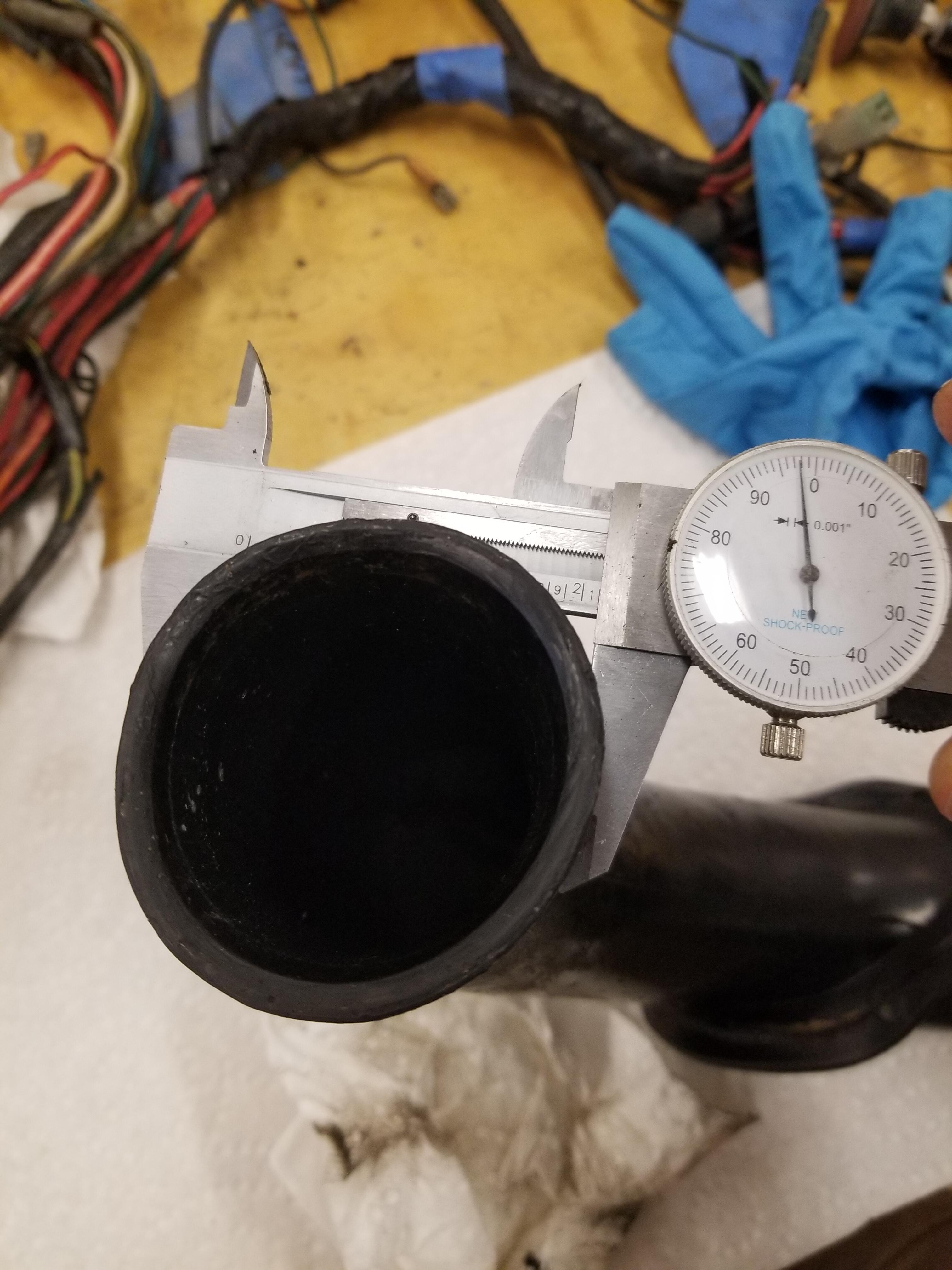

February 20, 20232 yr Author comment_650458 Here is some more info I believe this is the before measurement This is my setup to soak it. I had a lid with a weight on it to keep the alcohol from flashing off. I turned it morning and night every day for about 9 days. It takes four rotations to get the whole part soaked. That is why it isn't totally even. Would have taken a good bit more wintergreen to have enough to fully immerse. This part was rock hard and is pretty thick. I think that is part of why it took so long. This is the after measurement It does swell it some and when it's not fully immersed it will distort the part some Before video After video Link to comment https://www.classiczcars.com/forums/topic/55369-1971-hls30-14938-lily-build/?&page=54#findComment-650458 Share on other sites More sharing options...

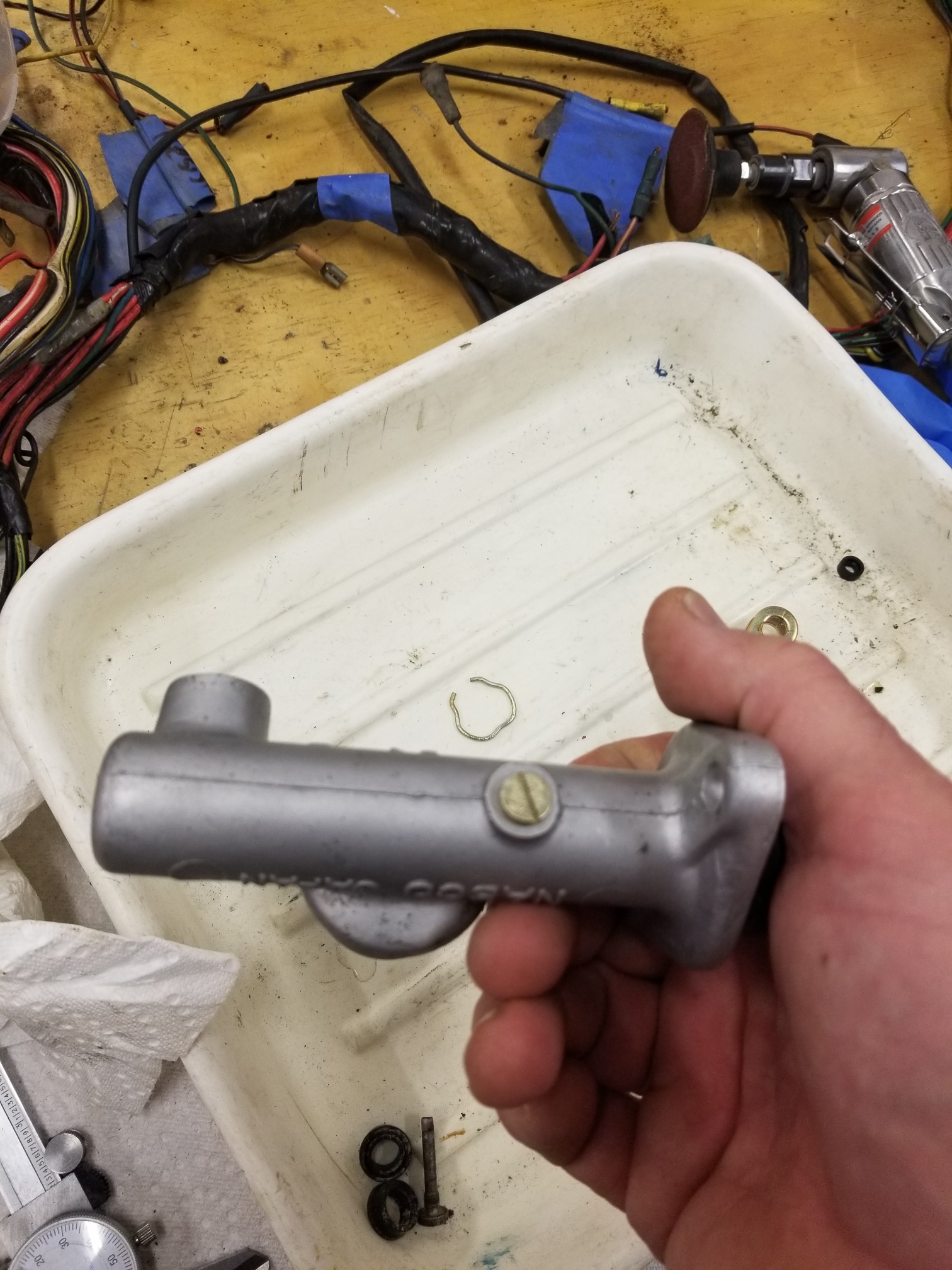

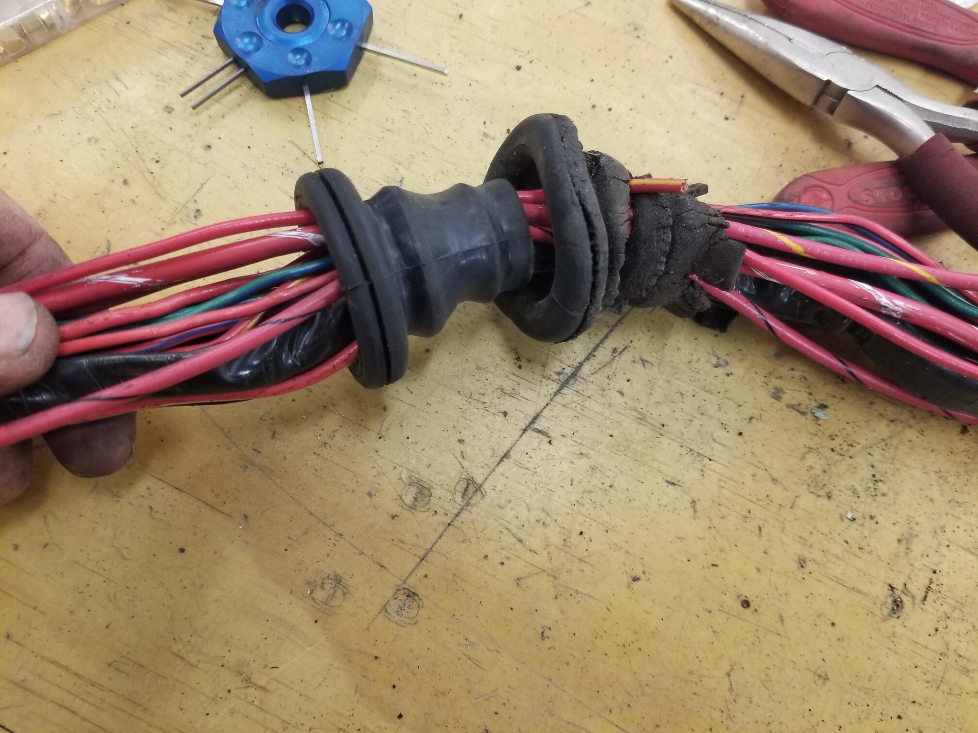

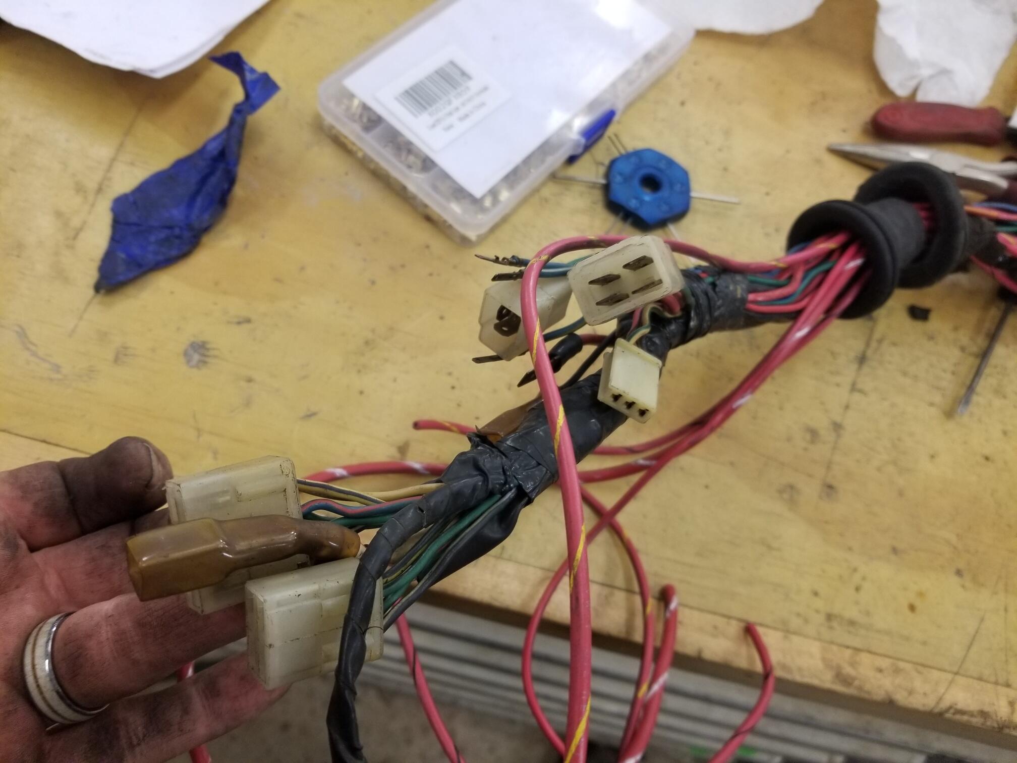

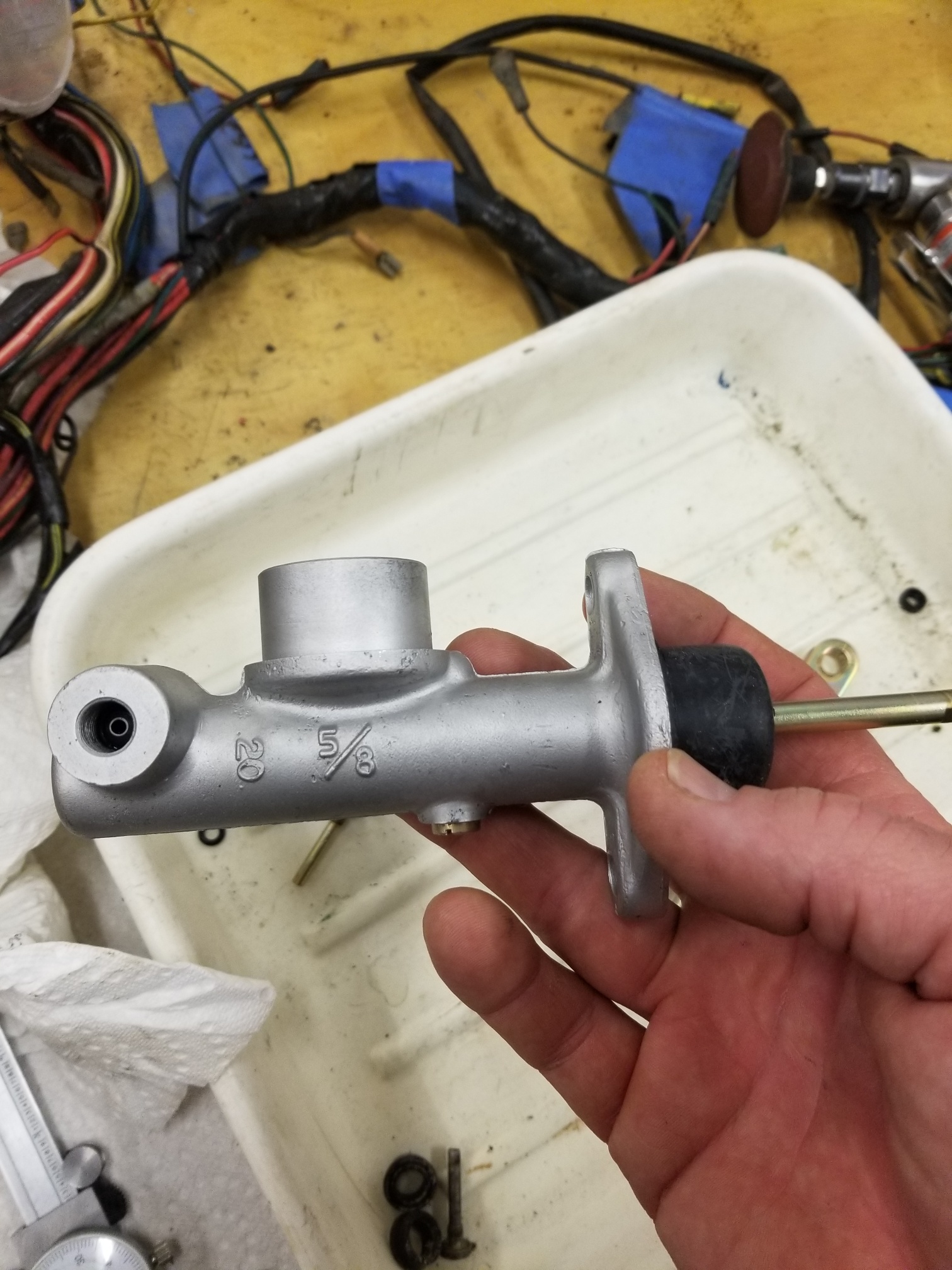

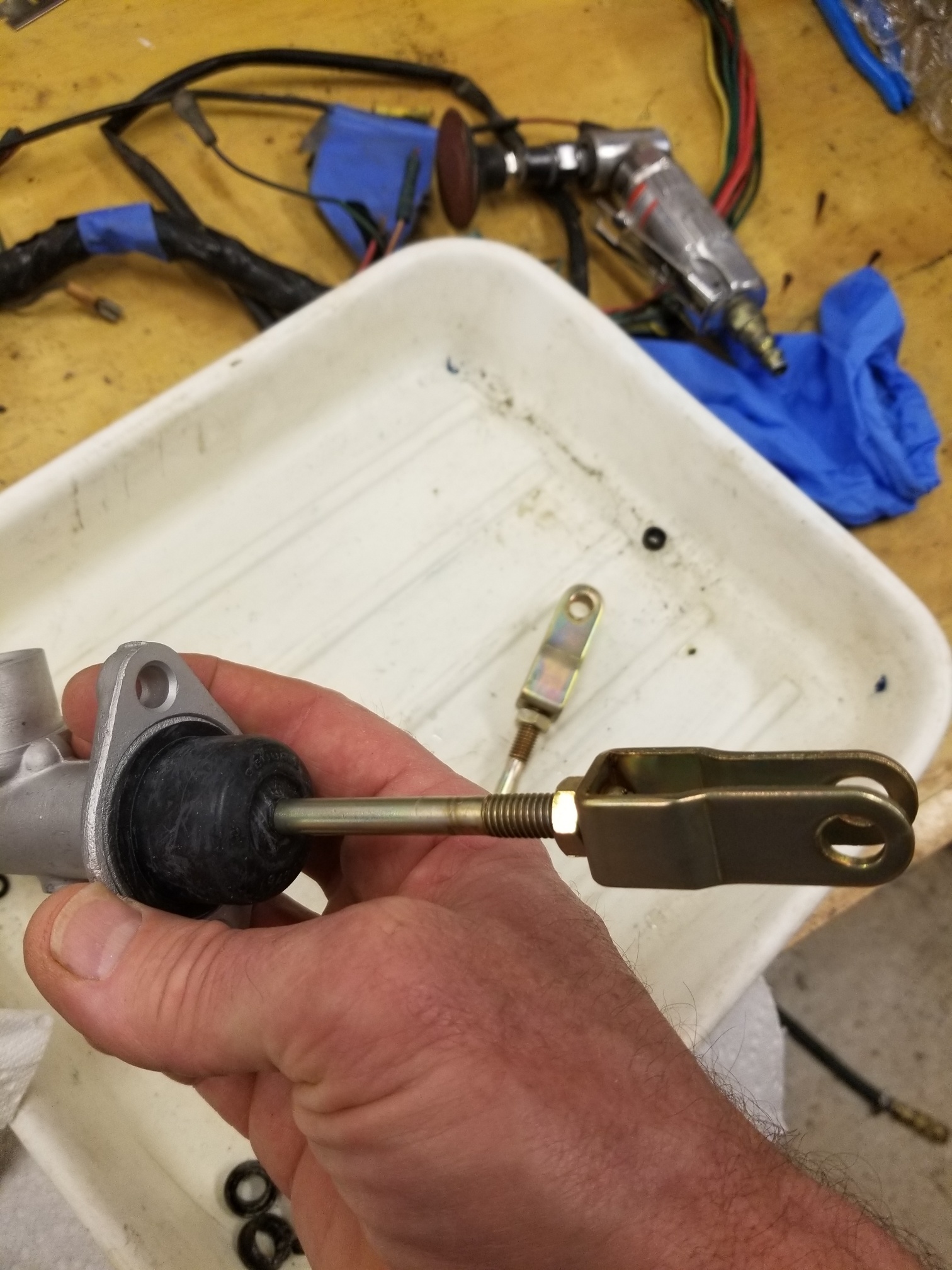

February 20, 20232 yr Author comment_650491 I did a little work on the car today. Finished assembling the rejuvenated clutch master. I also worked on the engine bay harness. I laid new wires into it and replace the firewall grommet. What a pain in the ...!!! You have to depin most of this to get it on. And some of those wires don't want to depin, even with the correct tools. I did finally get it. Hopefully I got them all back in the right spots. Otherwise SteveJ is gonna have a fit finding it! Link to comment https://www.classiczcars.com/forums/topic/55369-1971-hls30-14938-lily-build/?&page=54#findComment-650491 Share on other sites More sharing options...
February 20, 20232 yr comment_650492 10 minutes ago, Patcon said: I did a little work on the car today. Finished assembling the rejuvenated clutch master. I also worked on the engine bay harness. I laid new wires into it and replace the firewall grommet. What a pain in the ...!!! You have to depin most of this to get it on. And some of those wires don't want to depin, even with the correct tools. I did finally get it. Hopefully I got them all back in the right spots. Otherwise SteveJ is gonna have a fit finding it! Plug and pray Link to comment https://www.classiczcars.com/forums/topic/55369-1971-hls30-14938-lily-build/?&page=54#findComment-650492 Share on other sites More sharing options...
February 21, 20232 yr Author comment_650494 !!!!!! Link to comment https://www.classiczcars.com/forums/topic/55369-1971-hls30-14938-lily-build/?&page=54#findComment-650494 Share on other sites More sharing options...
February 21, 20232 yr comment_650513 I wonder whether they were able to install the wiring harness at the factory with the firewall grommet and end connectors already in place? If so, I'd like to know how they did it. Link to comment https://www.classiczcars.com/forums/topic/55369-1971-hls30-14938-lily-build/?&page=54#findComment-650513 Share on other sites More sharing options...
February 21, 20232 yr comment_650524 I believe the grommet was installed on the harness when the harness was built. At least on my 12/70 240 I have removed and installed the harness with all the connectors installed. You have to feed the connectors through the fire wall one at a time twisting the connectors to fit. The firewall hole is pretty tight with them all in. You can then seat the sealing lip of the grommet if your grommet if it is soft. Link to comment https://www.classiczcars.com/forums/topic/55369-1971-hls30-14938-lily-build/?&page=54#findComment-650524 Share on other sites More sharing options...
February 21, 20232 yr Author comment_650526 I'm confident it was put on before the plugs when new. Just makes replacement challenging Link to comment https://www.classiczcars.com/forums/topic/55369-1971-hls30-14938-lily-build/?&page=54#findComment-650526 Share on other sites More sharing options...
February 22, 20232 yr comment_650558 When I did my installation, I first tried with the grommet installed on the harness. I could not get the grommet to seat in the firewall. I then went to Plan B: I removed the grommet from the harness and then detached all of the engine bay connectors from their wires. With this done, it was easy to install the grommet in the firewall then thread the wiring out into the engine bay, working from the cabin side. Then I reinstalled the individual wire-end terminals into their connectors. You need a good-quality terminal-removing tool to make this strategy work (two different sizes required). I got mine from Vintage. Link to comment https://www.classiczcars.com/forums/topic/55369-1971-hls30-14938-lily-build/?&page=54#findComment-650558 Share on other sites More sharing options...
