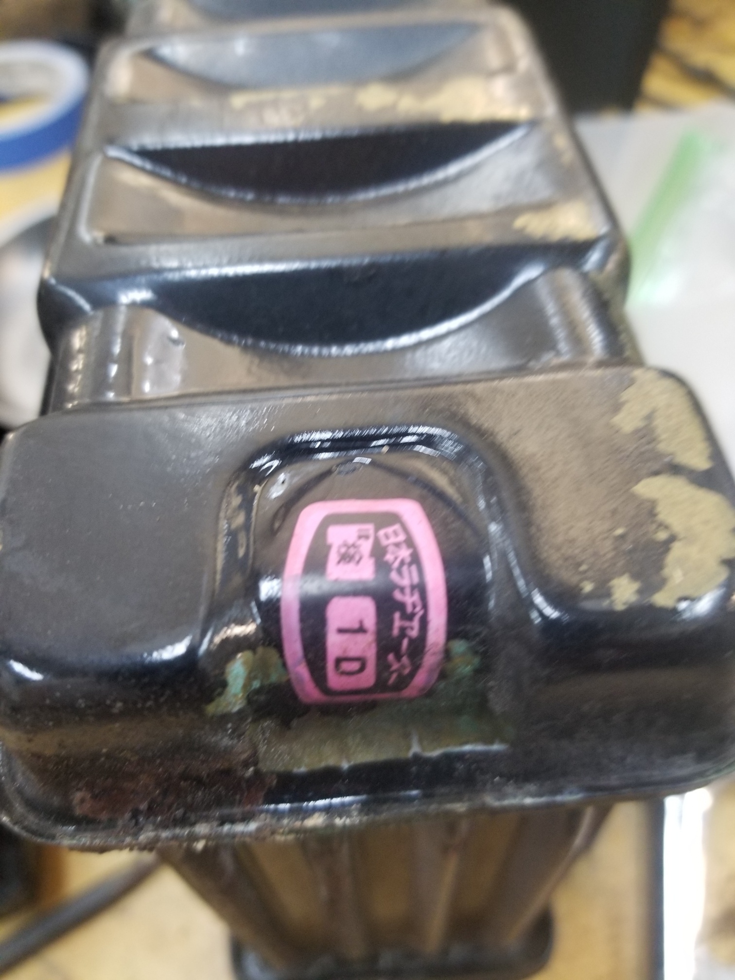

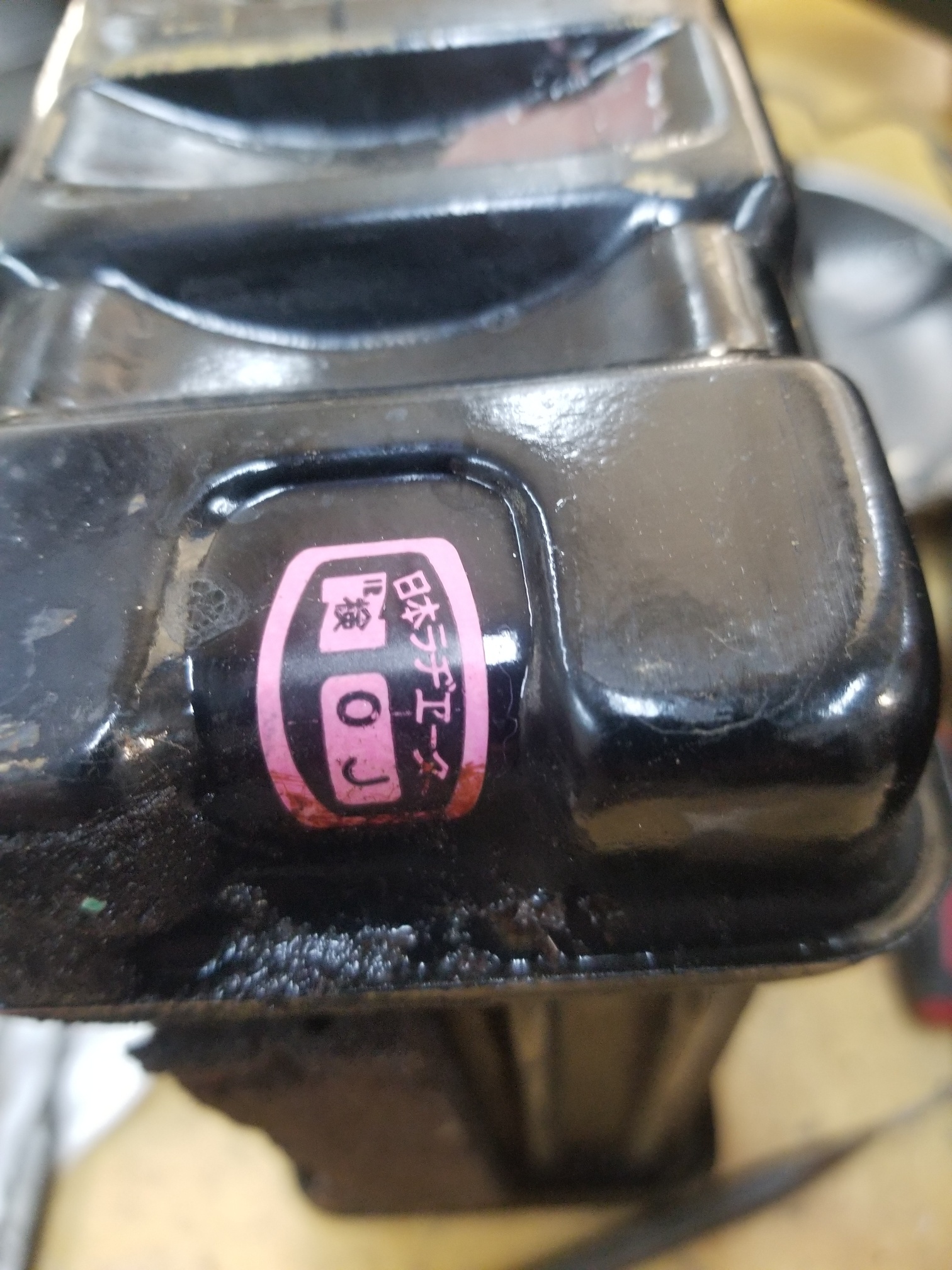

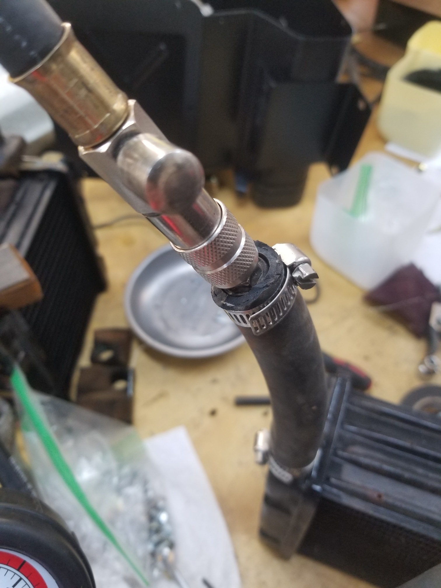

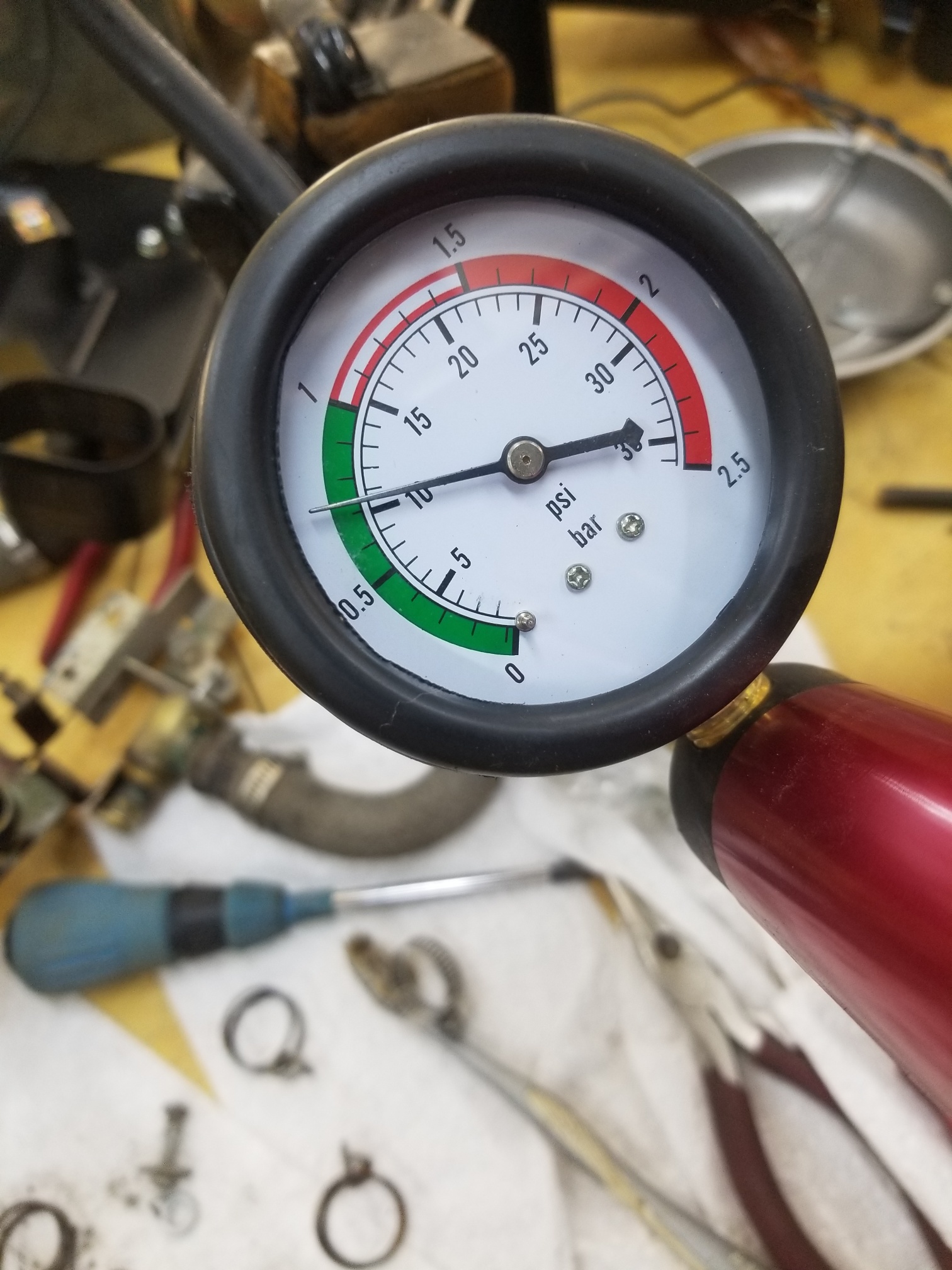

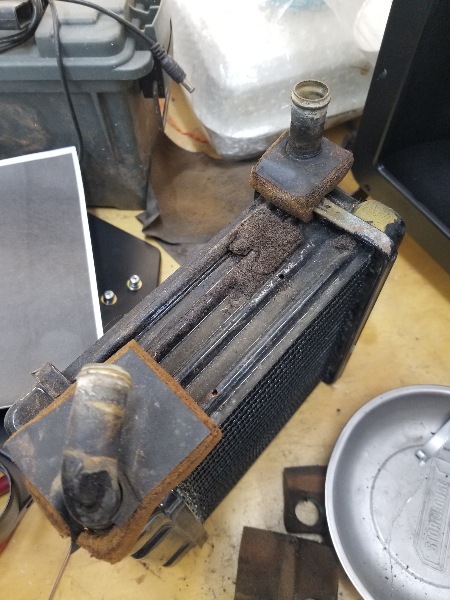

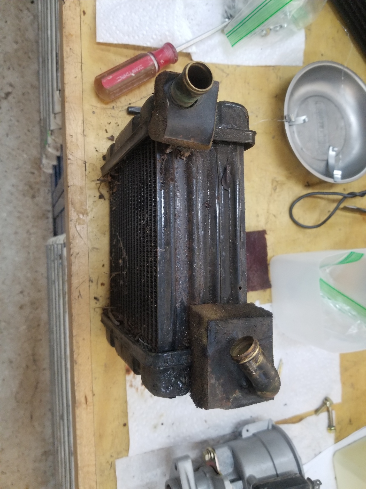

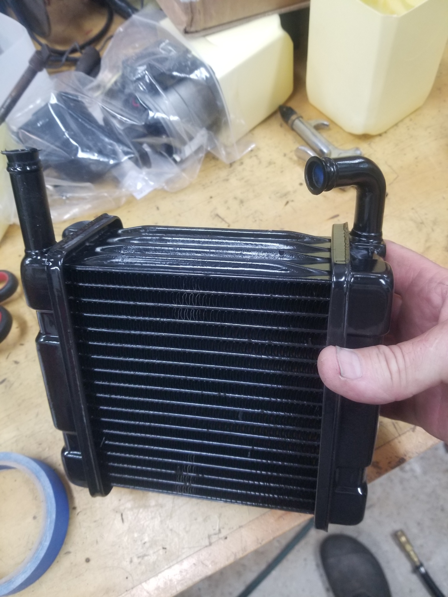

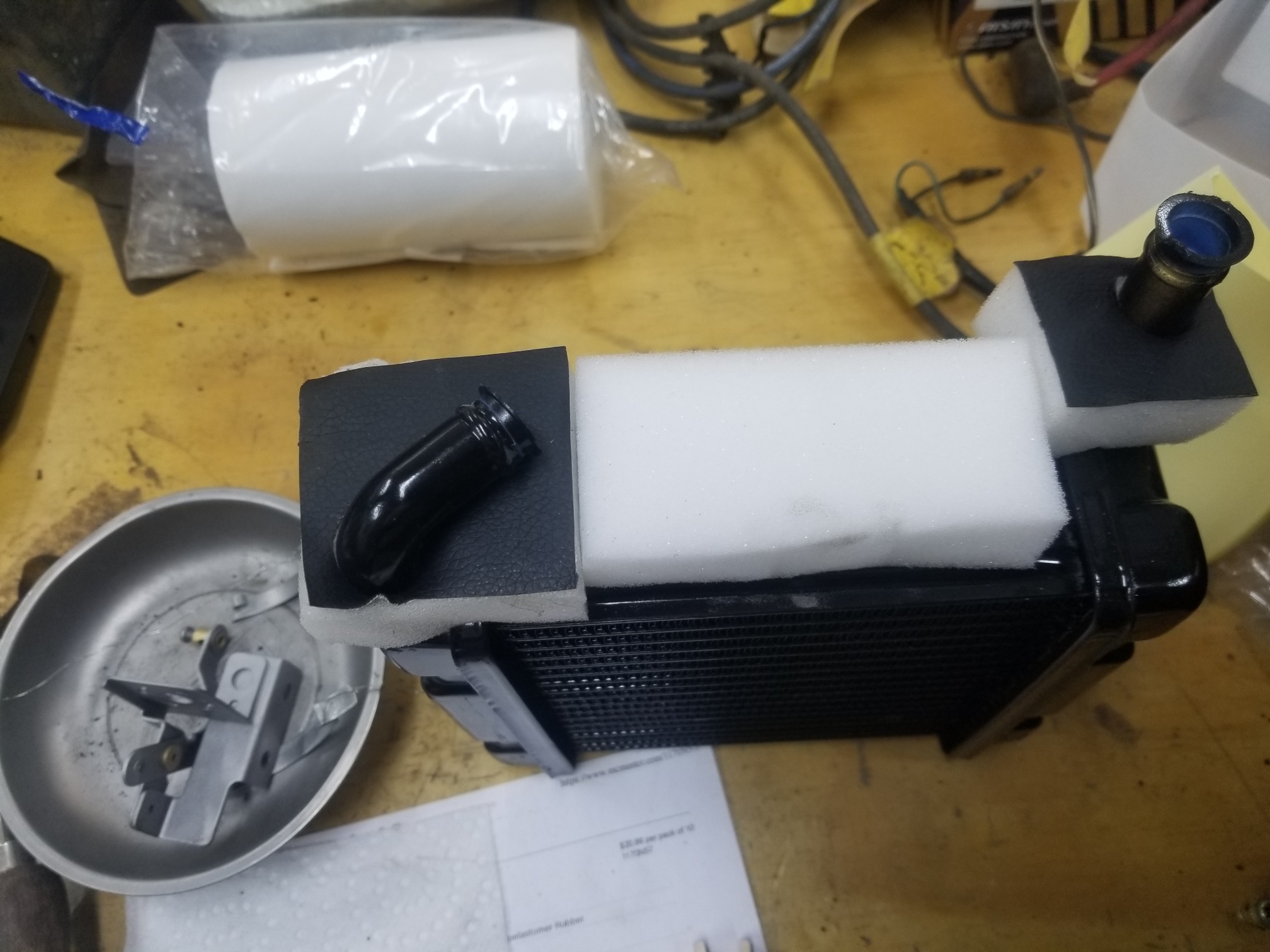

I was working on the heater box some today.

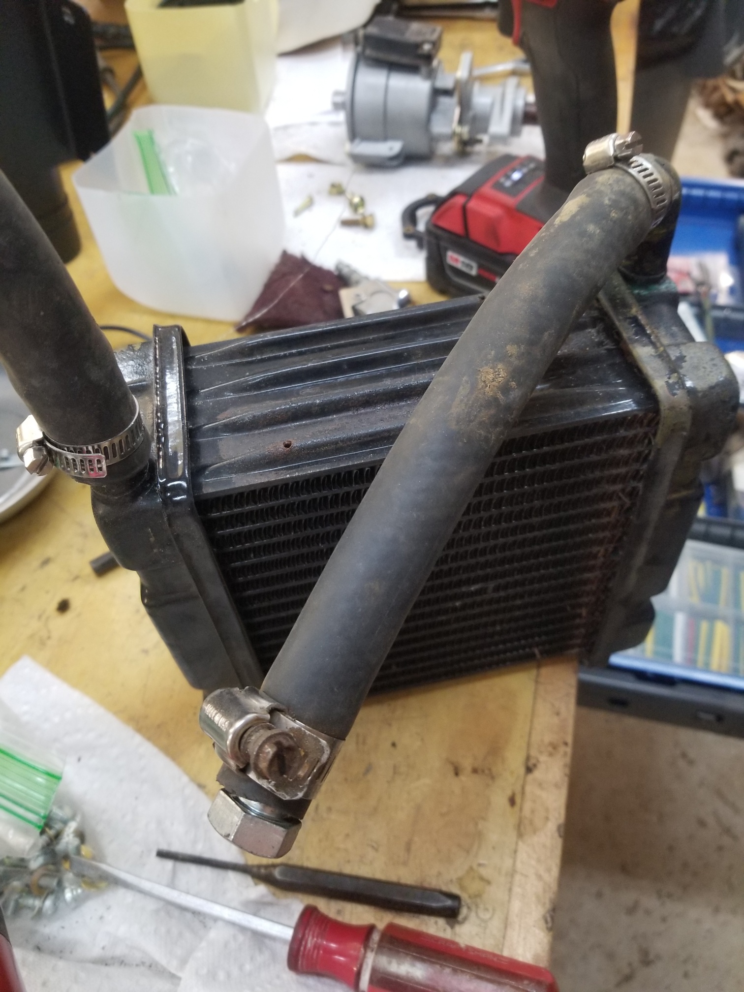

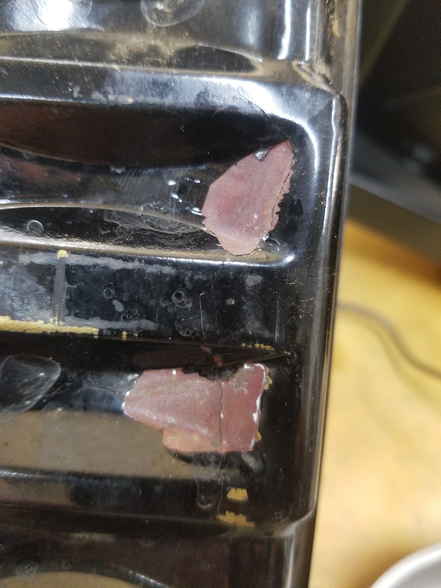

Tested the heater core that came in Lily, it's cracked! 😞
They are evidently, not readily available. "Brassworks" will custom make you one for $425! :blink:
So I dug around in the shop and found another one. It tested good.
They both appear to be factory units.
29 minutes ago, SteveJ said:
I wonder if a radiator repair shop could fix that crack?
We have one shop locally that would probably do it. I thought I might take a shot at it myself. If not I'll have them do it. So I have a spare for me or someone else

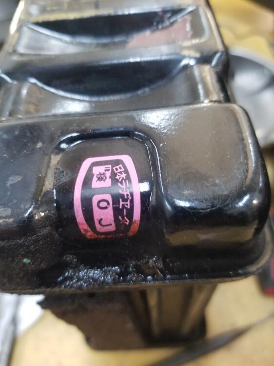

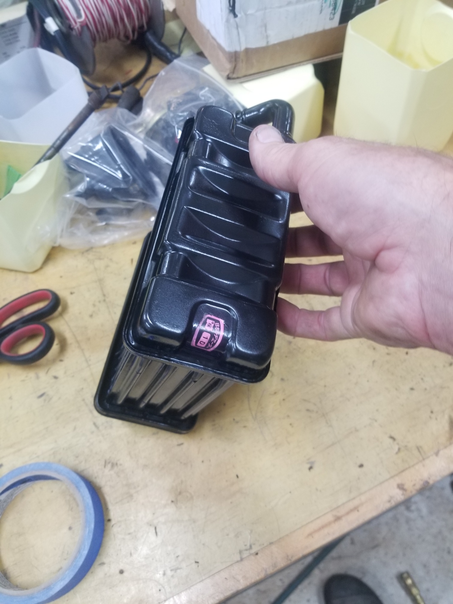

Great work, I am going to do the same thing for my 240Z. This will be very helpful for me as a guide book.
The decal caught my eyes, I didn’t know it is there!
「日本ラヂエーター」Nihon radiator Co.,ltd. (NICHIRA)
 I will check my blue 240Z if it still has the decal on it.

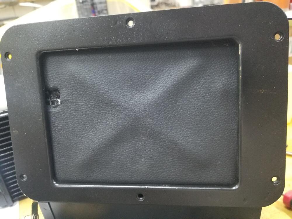

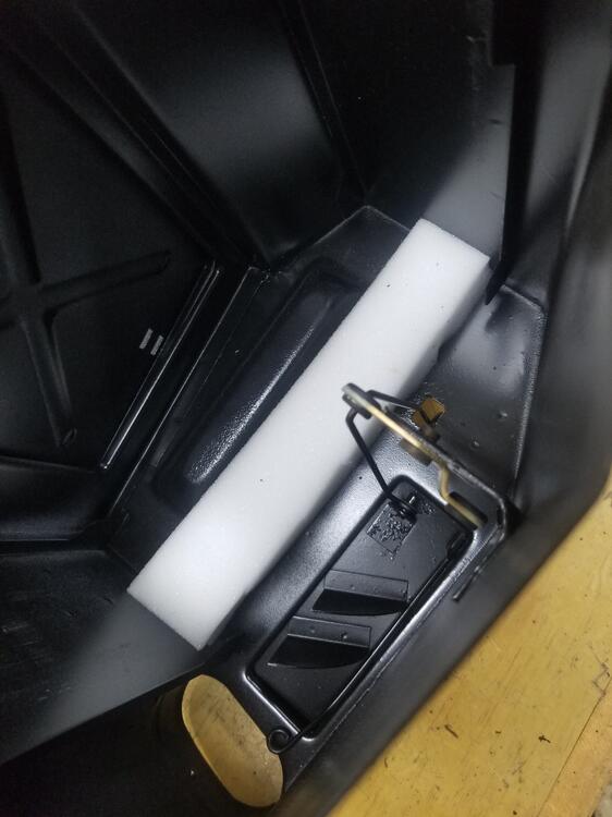

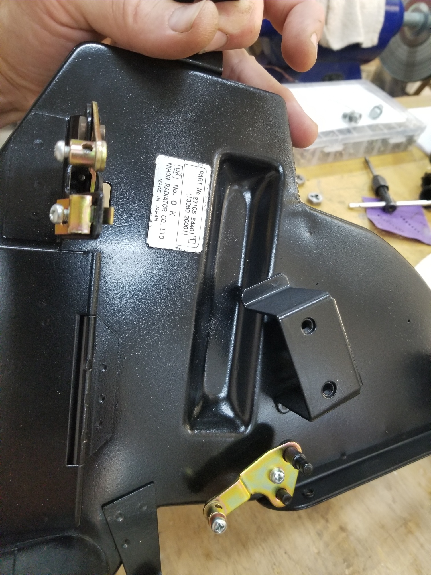

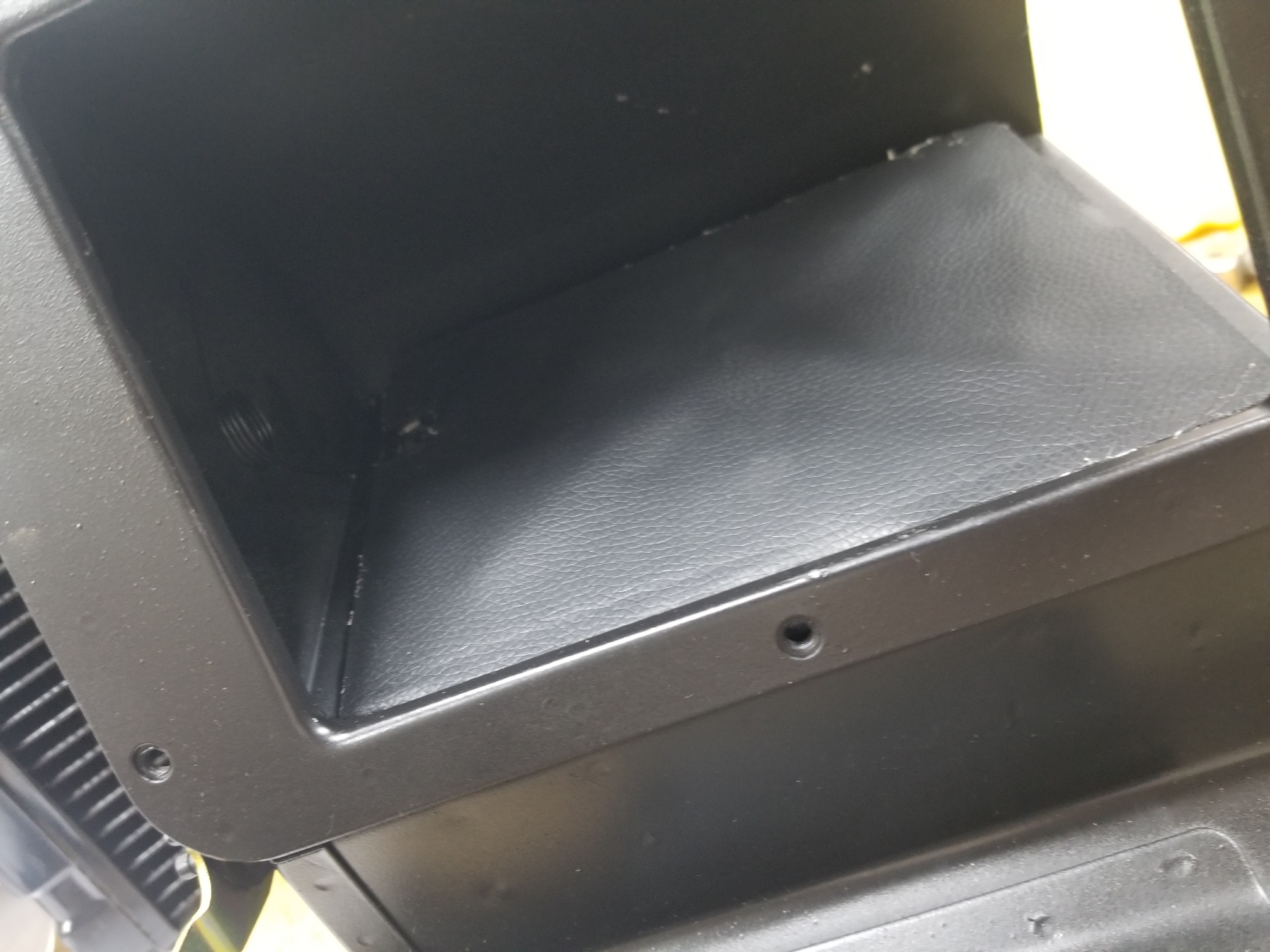

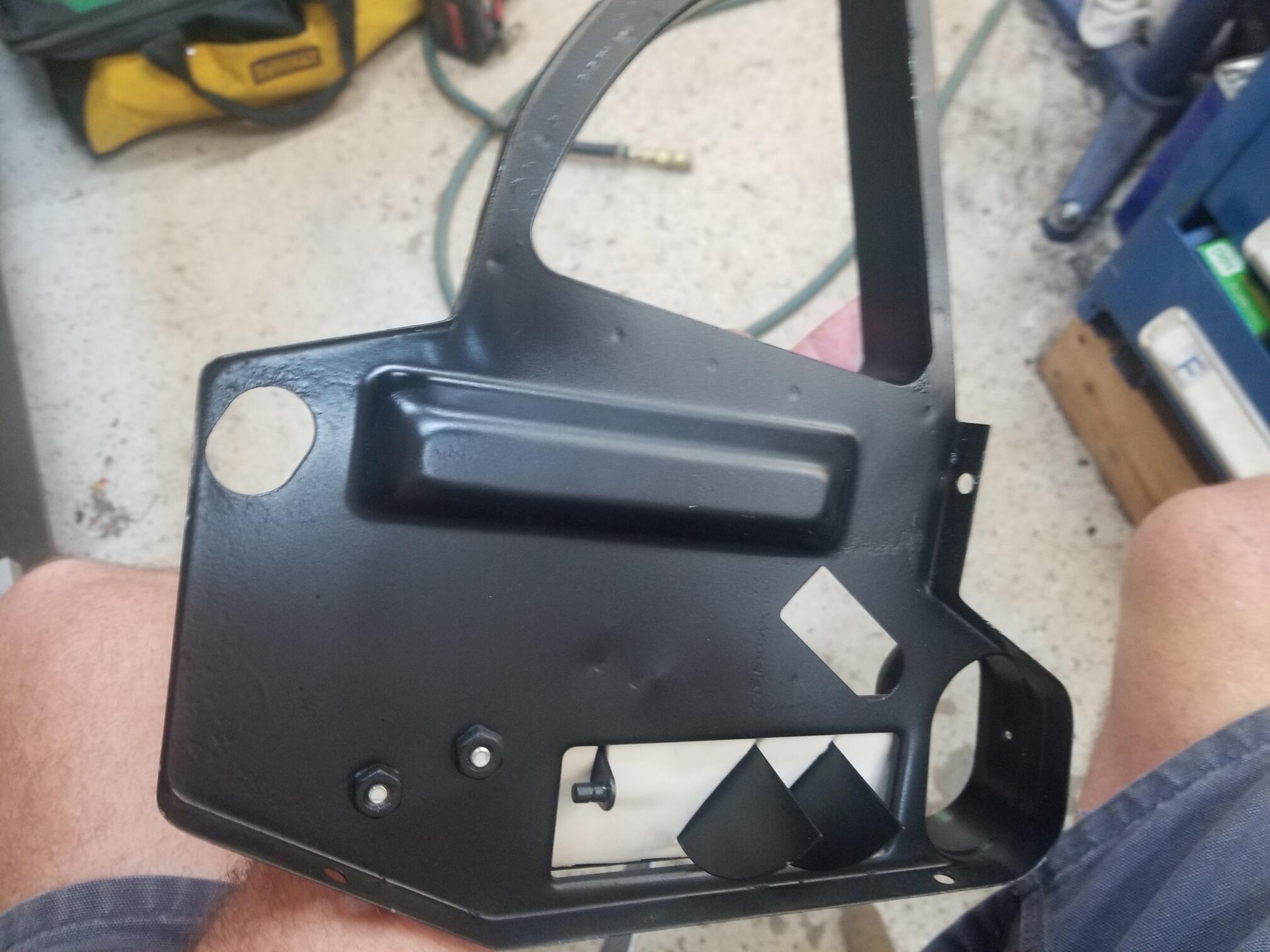

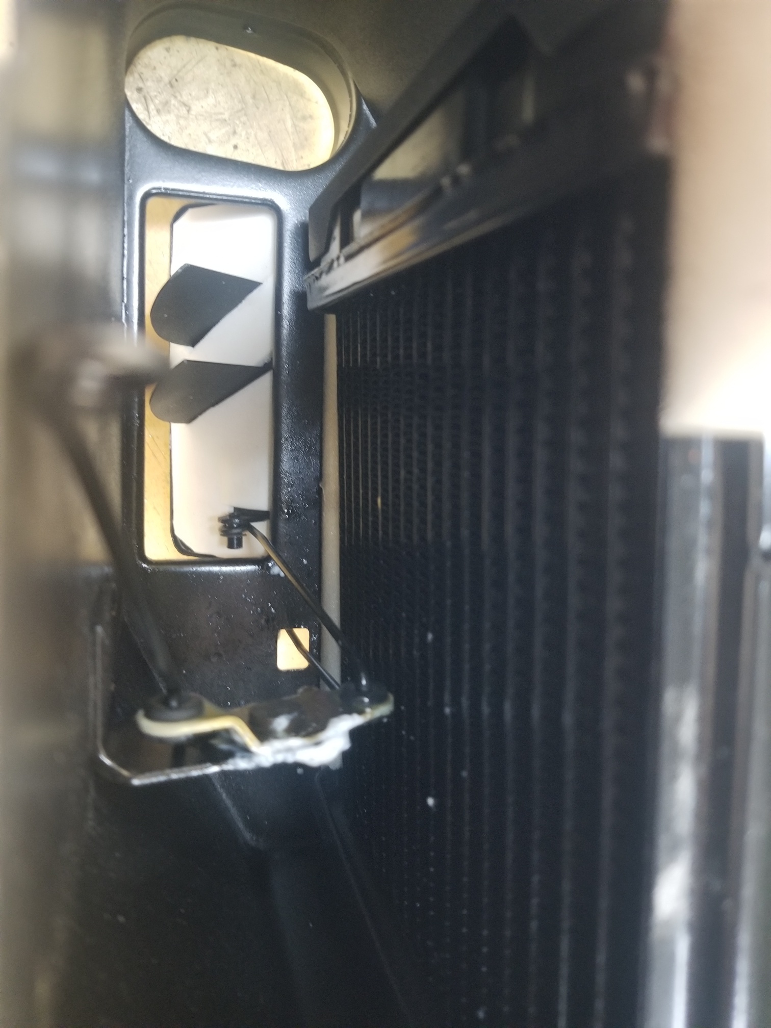

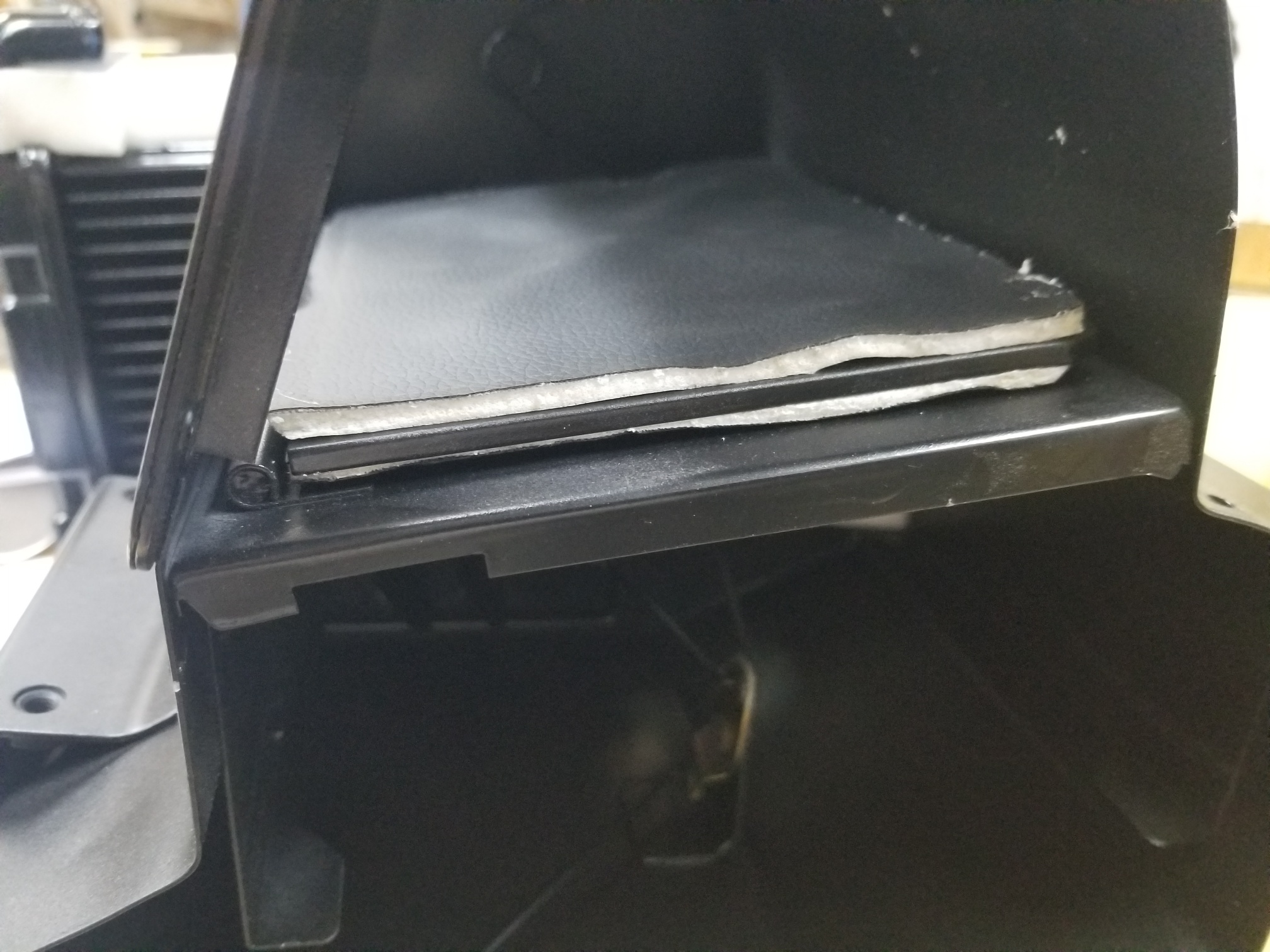

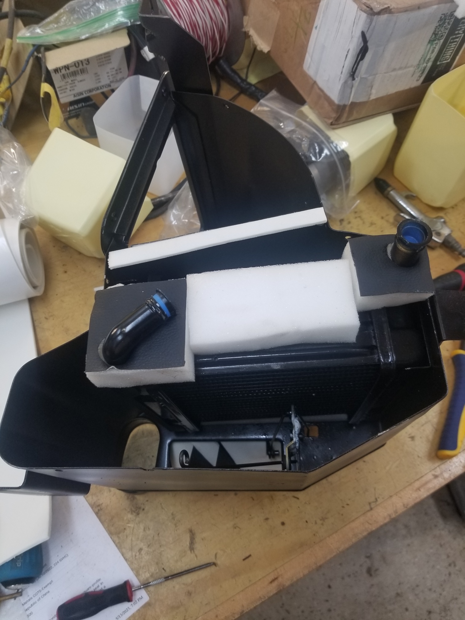

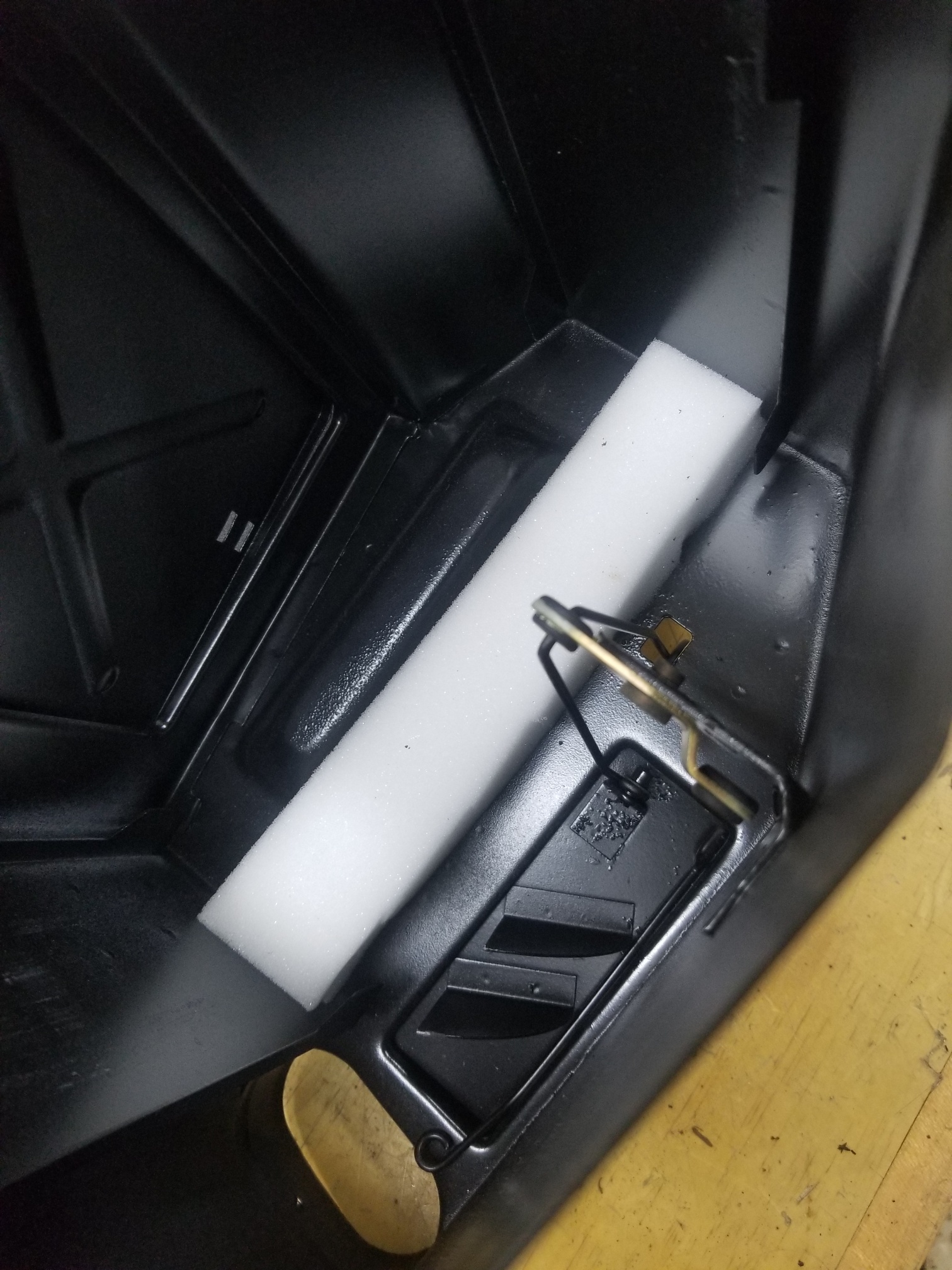

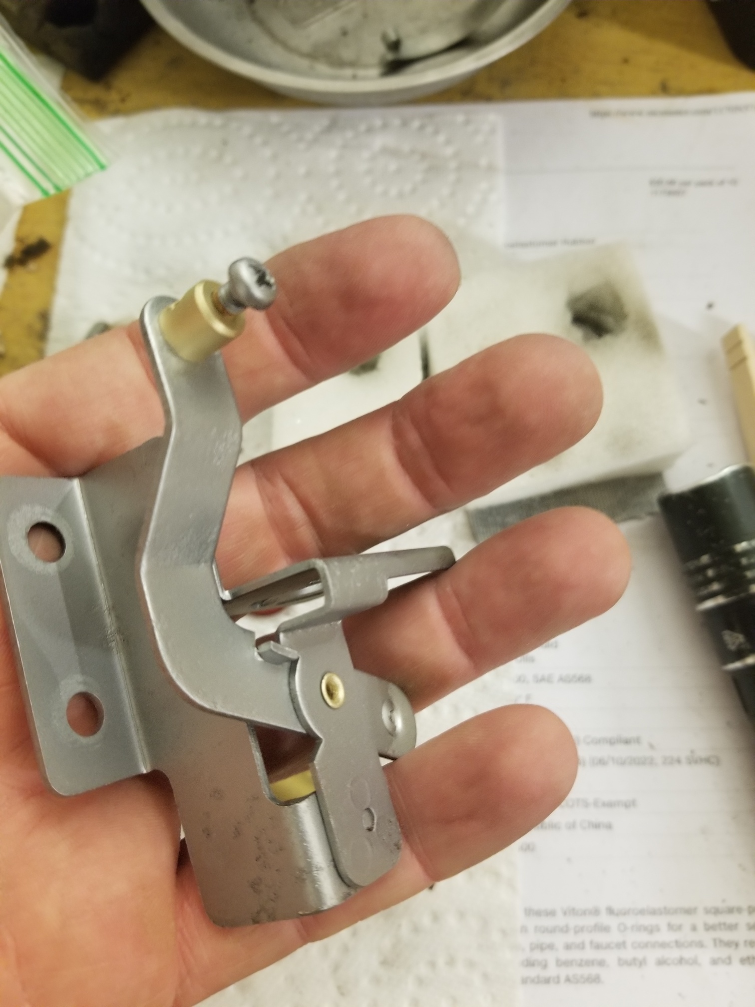

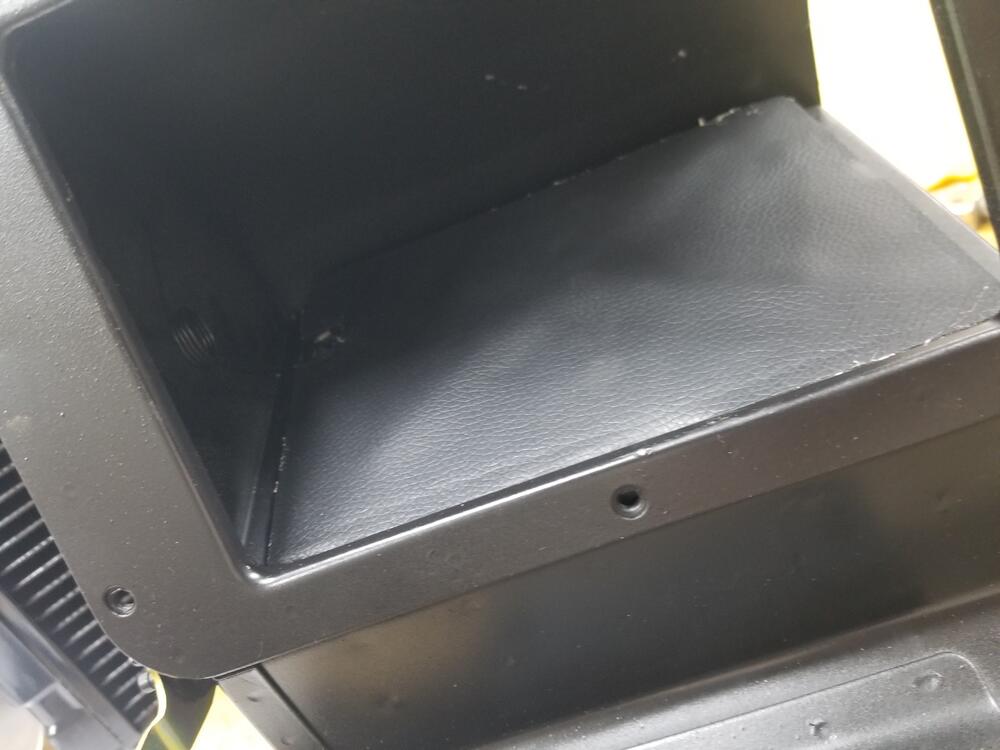

Maybe too late now, but I posted printable templates for all of the heater boxes, flaps and ducts in 'Resources - Knowledge Base'.  Might save you some time.  Don't overlook the foam liner for the centre air outlet duct.  It's there to reduce air rush noise.
Also: Be careful with the edges of the vinyl-faced flap coverings.  They may need some edge profiling or cutting back to keep them from snagging as the flap moves from 'open' to 'closed' position.  You don't want those things coming loose after you've installed everything back under the dash.
Thanks John
I have been using your excellent templates! They are very helpful
Is the "central air duct outlet" the one bolted to the heater box or the thinner one that connects the dash to the heater box?
