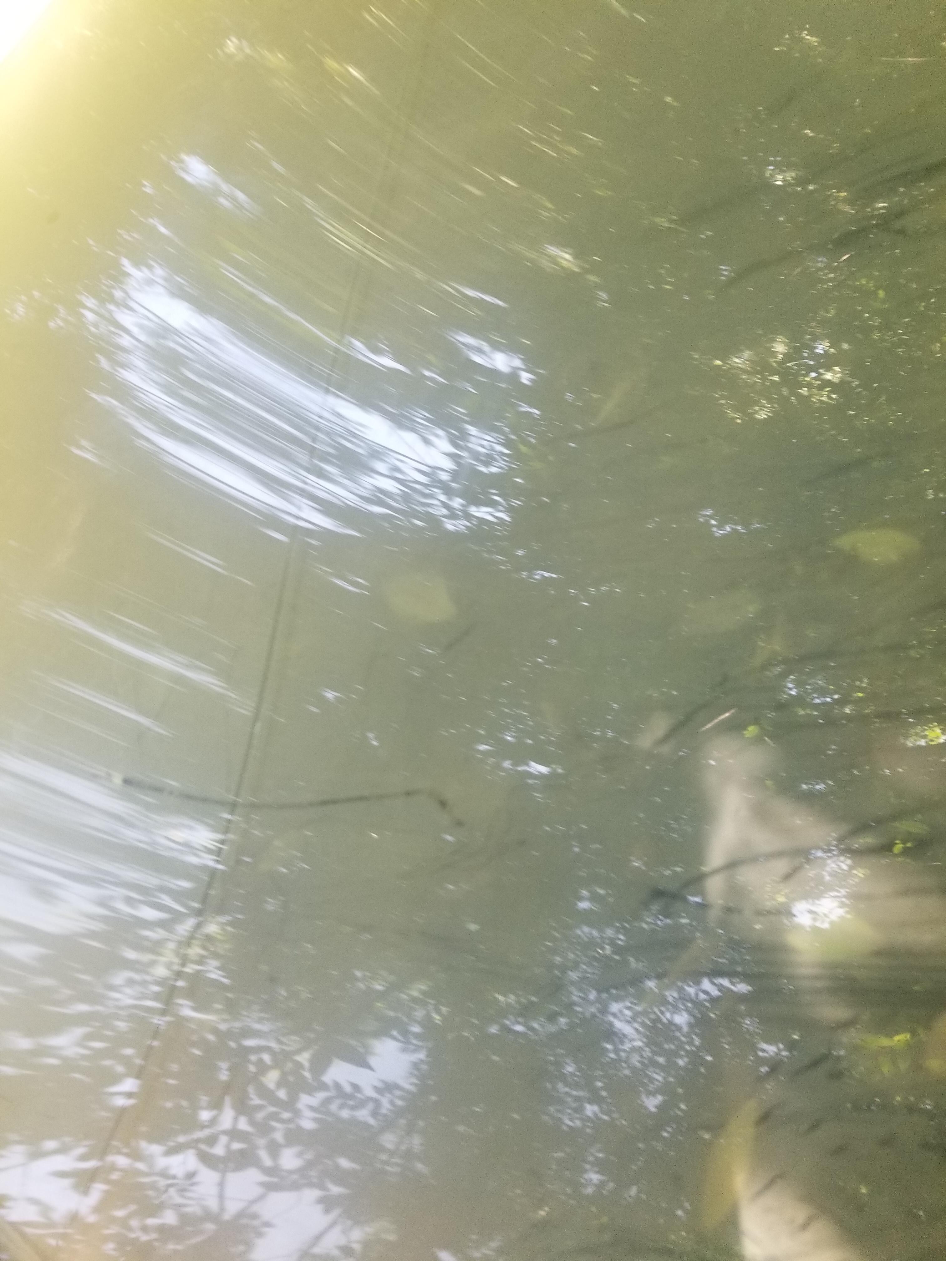

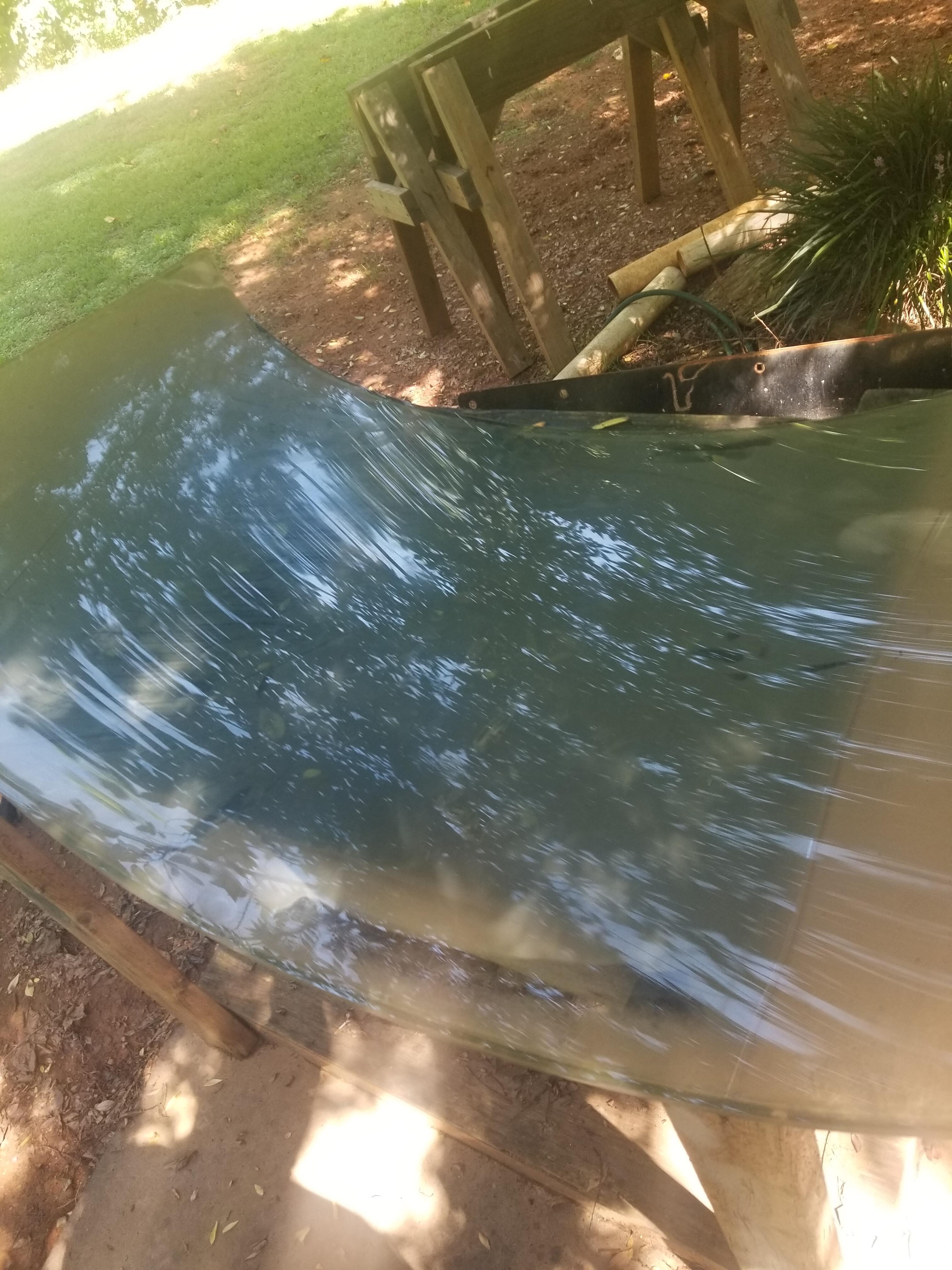

So got the glass down out of the shop ceiling today. Its been above the spray booth since about 2010.
Unfortunately the windshield was broken in two places. 😞
I had it stored on two 2x4s with the curve turned up . Concave side down. The inner sheet of glass broke on both sides just out side the 2x4s. I guess the weight of that inner sheet broke itself
Thankfully I have a spare. Hopefully it will clean up

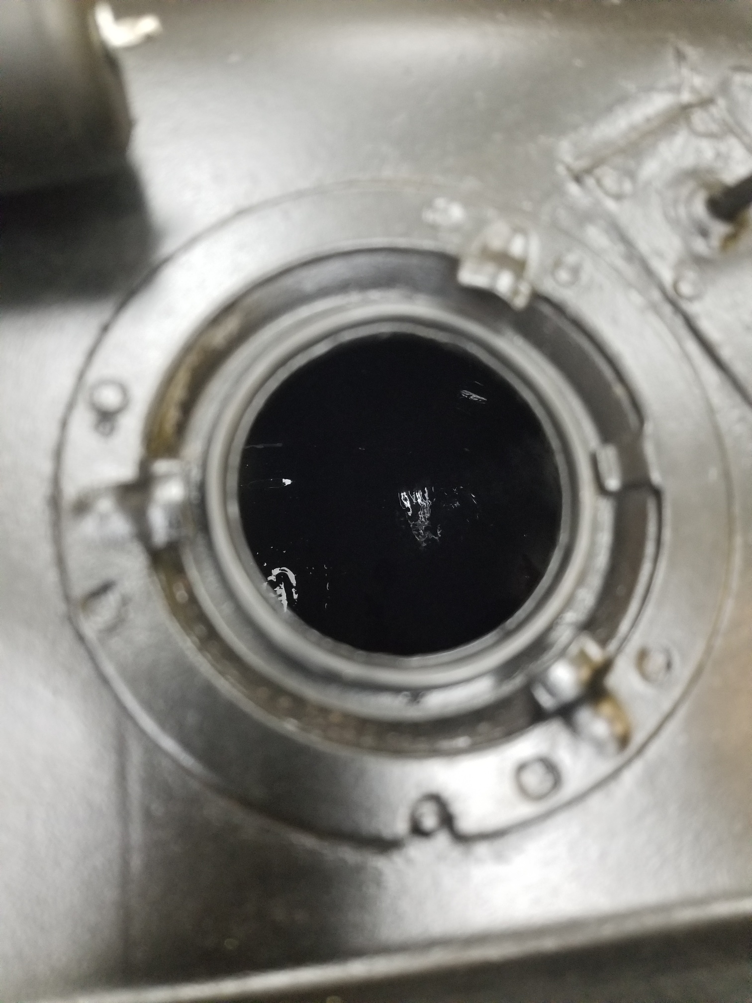

Working on the fuel and vent tanks some more. I believe my fuel sender is bad so I ordered a cheap one off Ebay. We'll see how it looks. I bought a bunch of braided hose for the vent system but I let Cody use some of it for his car and now I don't appear to have enough. Trying to sort that out
Where does the upper port on the left hand side (maybe 8mm hose) of the vapor tank go?? Does it just go through the floor and vent to the outside? Or does it connect to the vent line that goes to the front of the car? I think I know where the other lines go. I am looking for springs to work on the one molded hose. I may try to heat that in the oven to thermoset it...
On the diagrams I have seen it seems to go through the floor and vent but if it connects to the vapor line to front of the car, it isn't shown right...

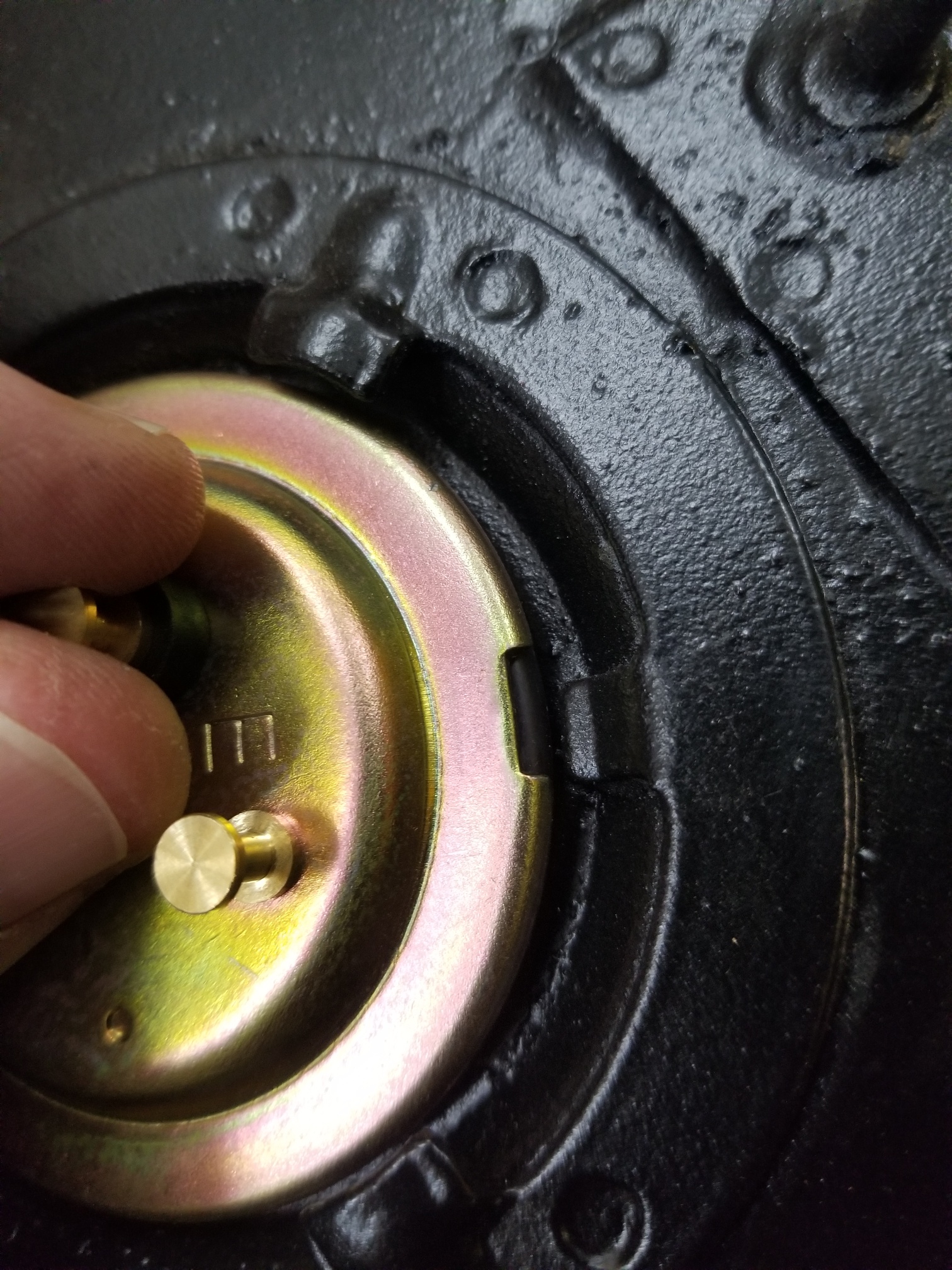

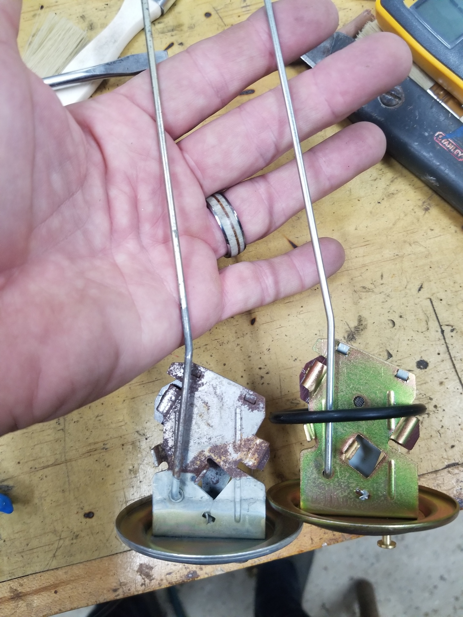

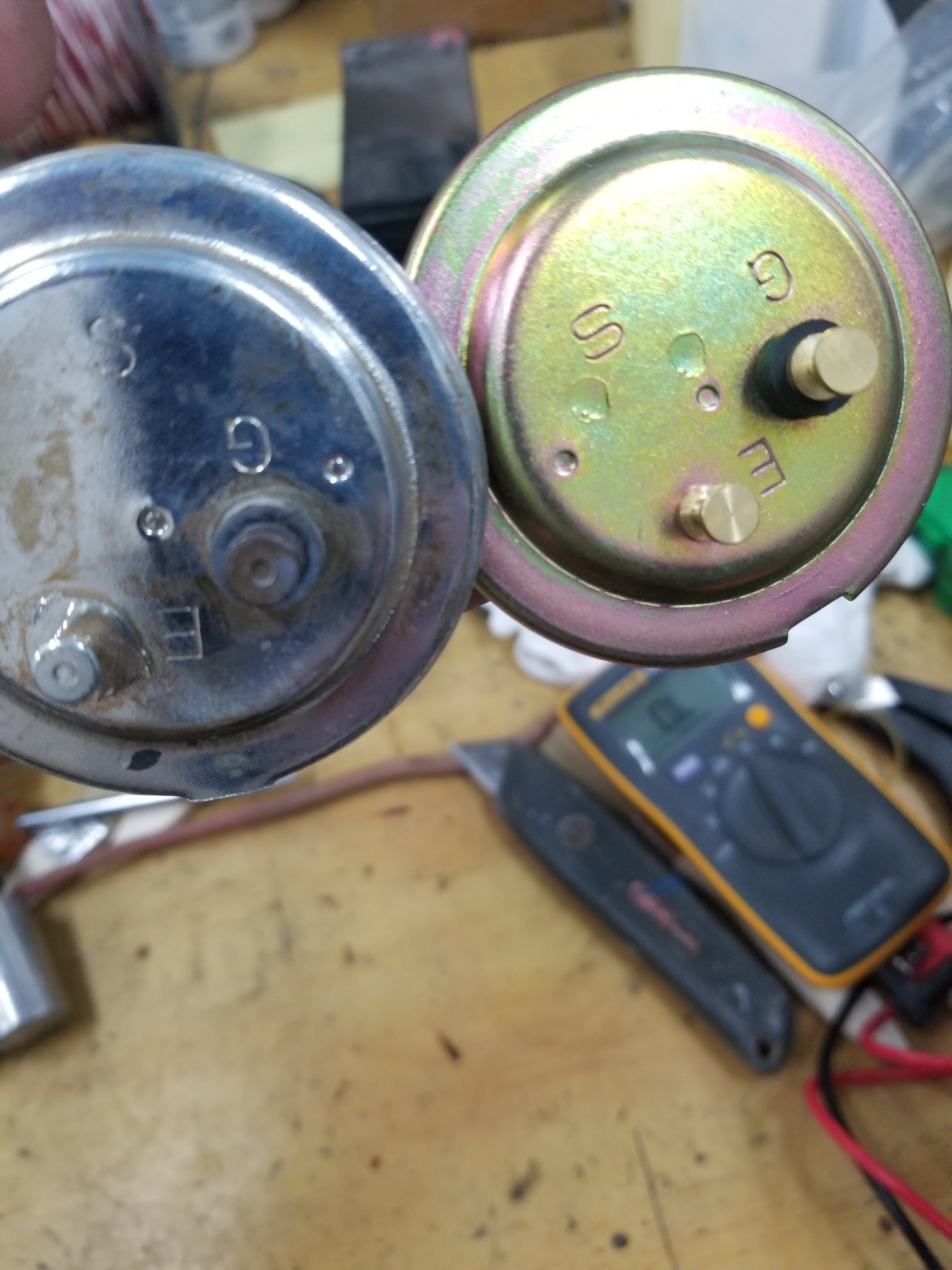

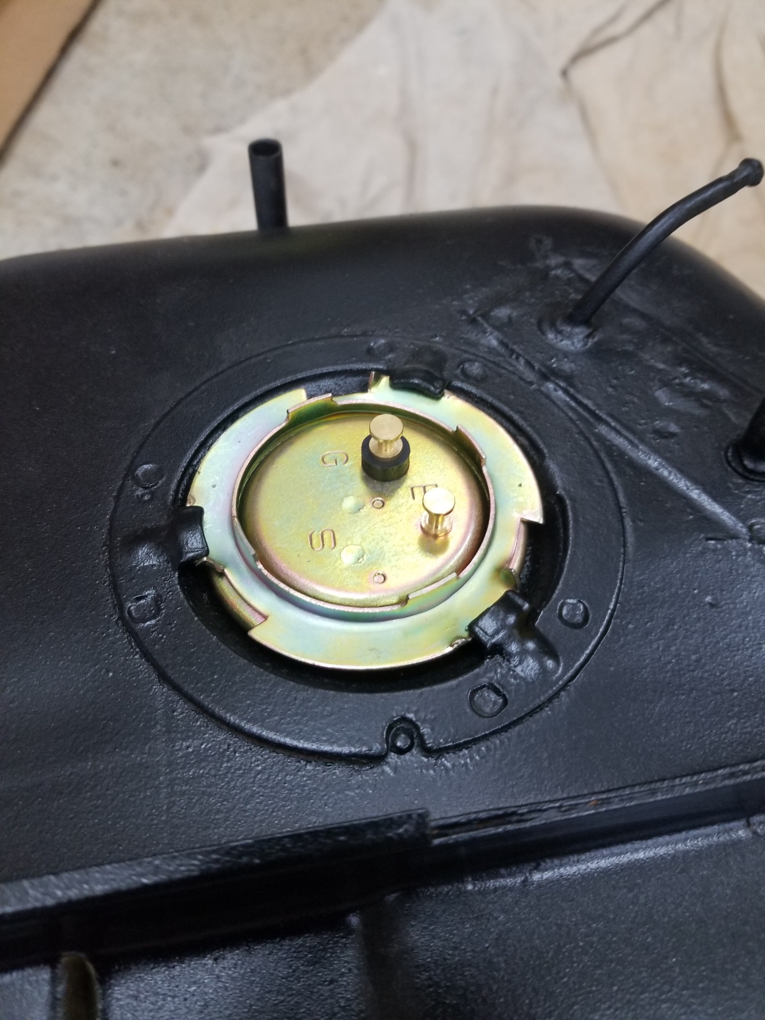

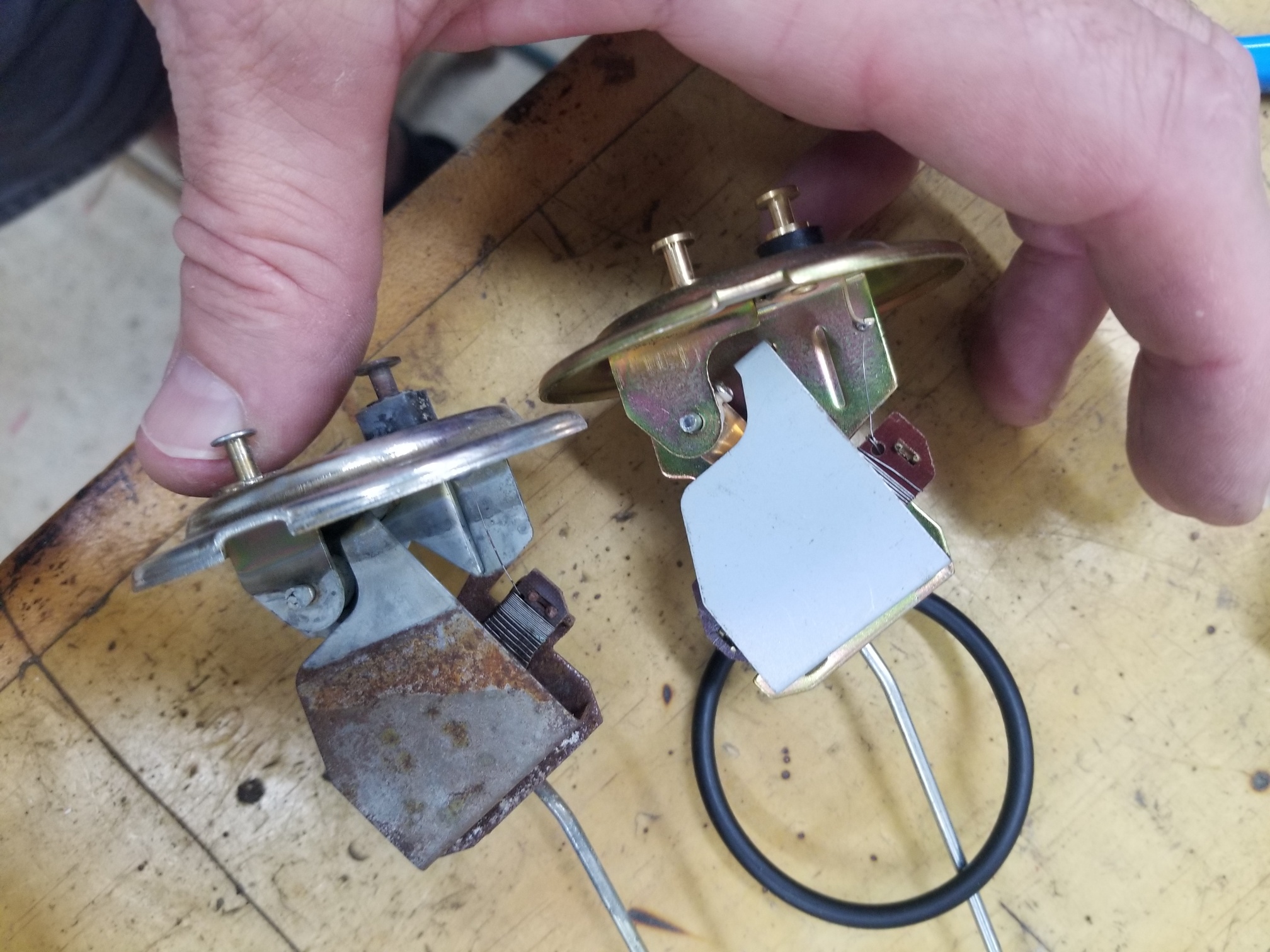

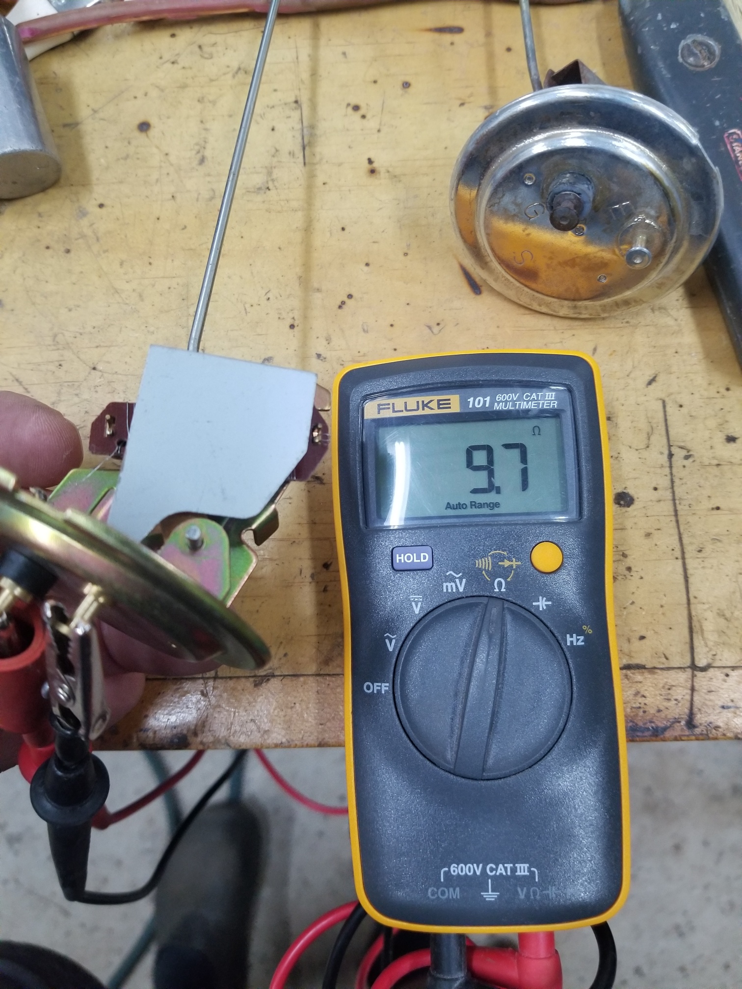

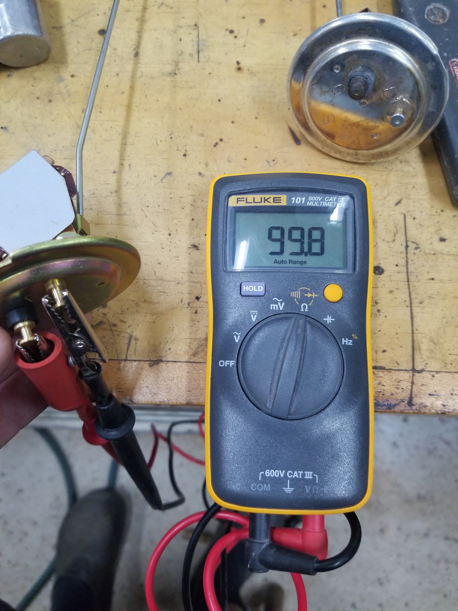

I got the new fuel tank sender in. It was about $15 total, which I thought was pretty cheap.
Matches really well and the resistance seems to be pretty close
New O ring
Sender set and indexed
I had 2 O rings to choose from. I used the one I had from Zcardepot versus the one that came with the sender. The one from Zcardepot fit perfect. The other one was on the small side

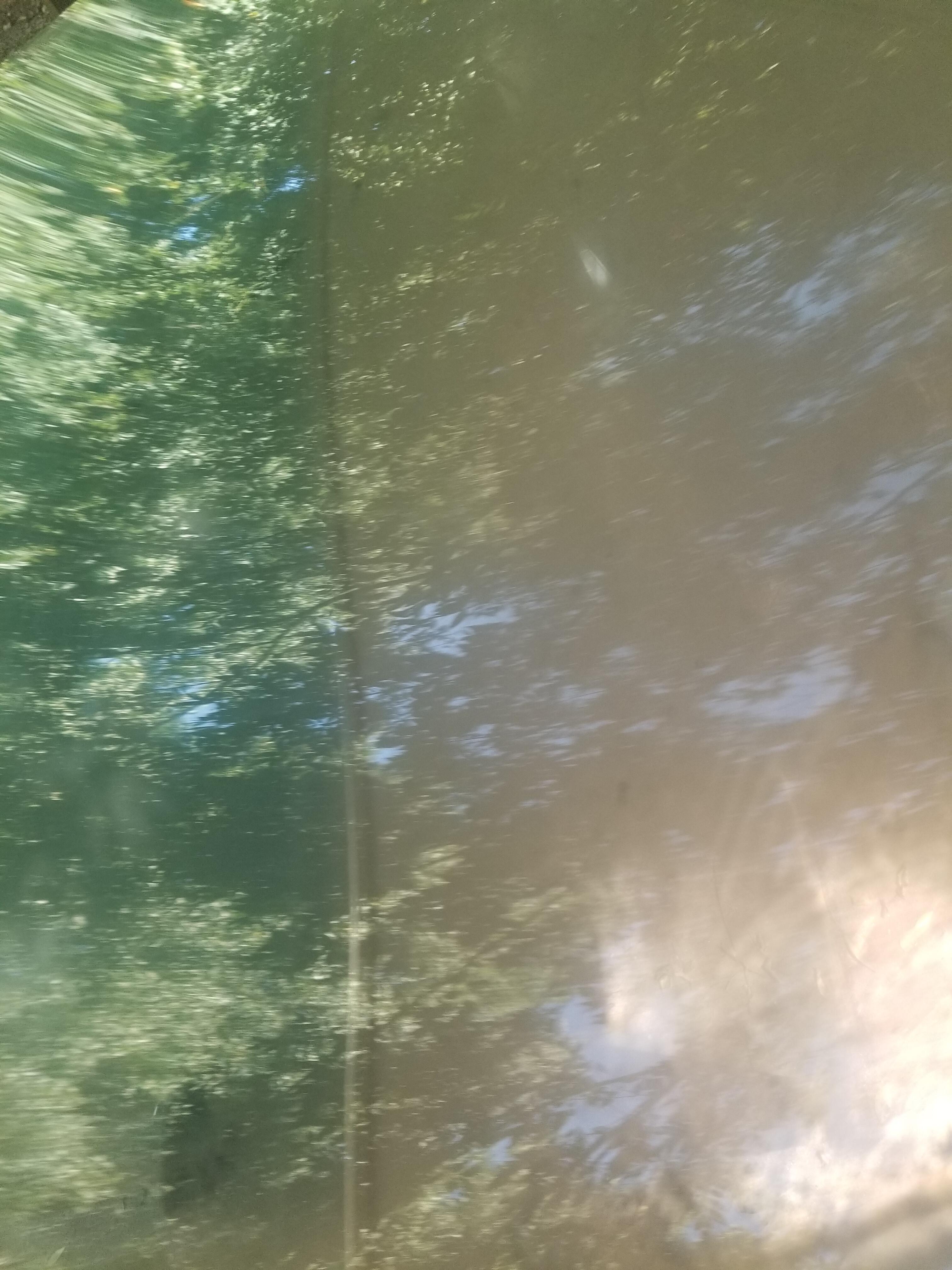

Worked on some glass today too
Rear hatch decals @cgsheen1 Do you recognize these?
Rear hatch etching
Windshield etching. No tint strip

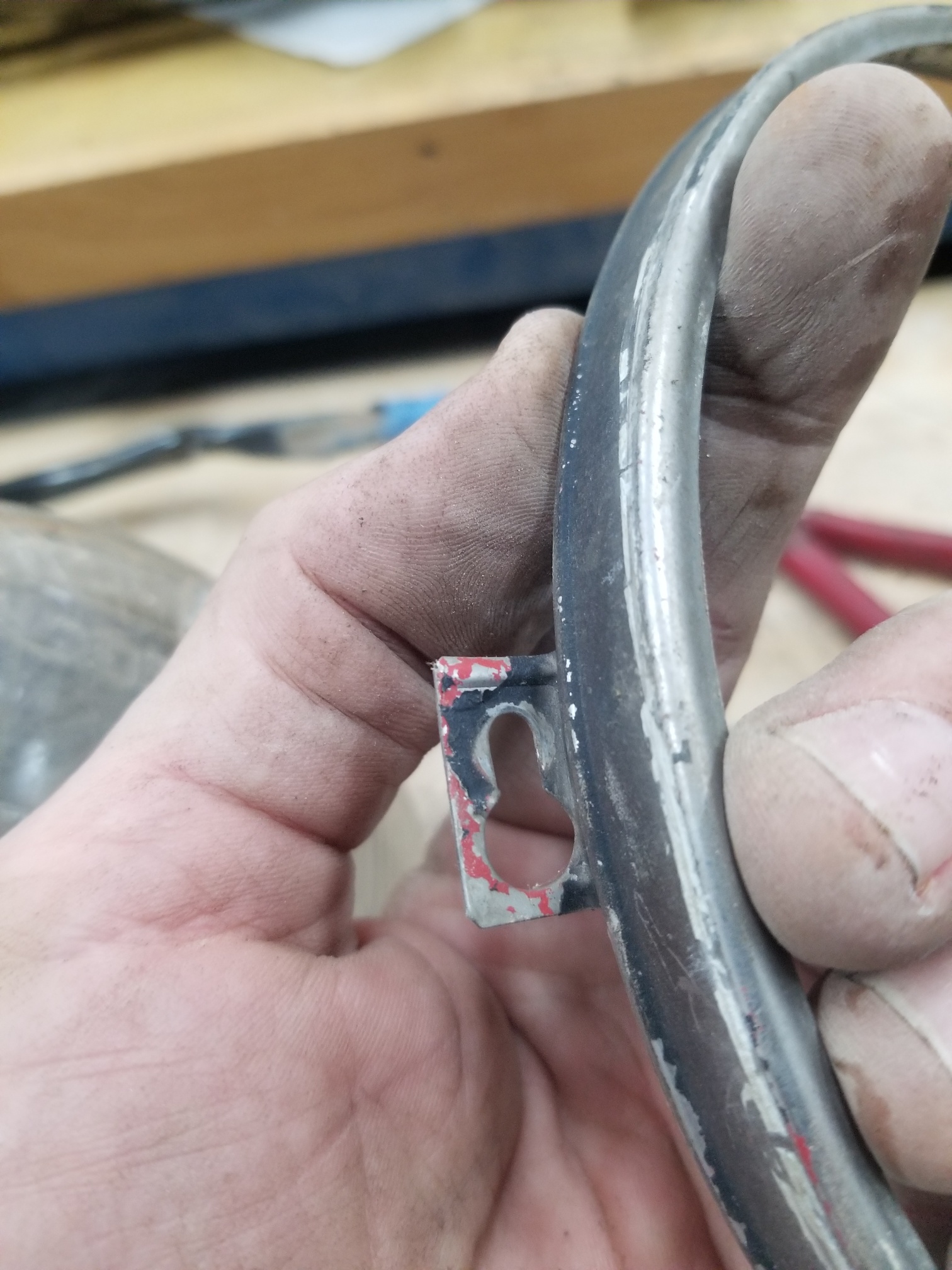

Stripped the metal brackets off the door glass. I am going to send a load to the platers
There are small white plastic washer sunder the bolts and washers to prevent over tightening to the glass
