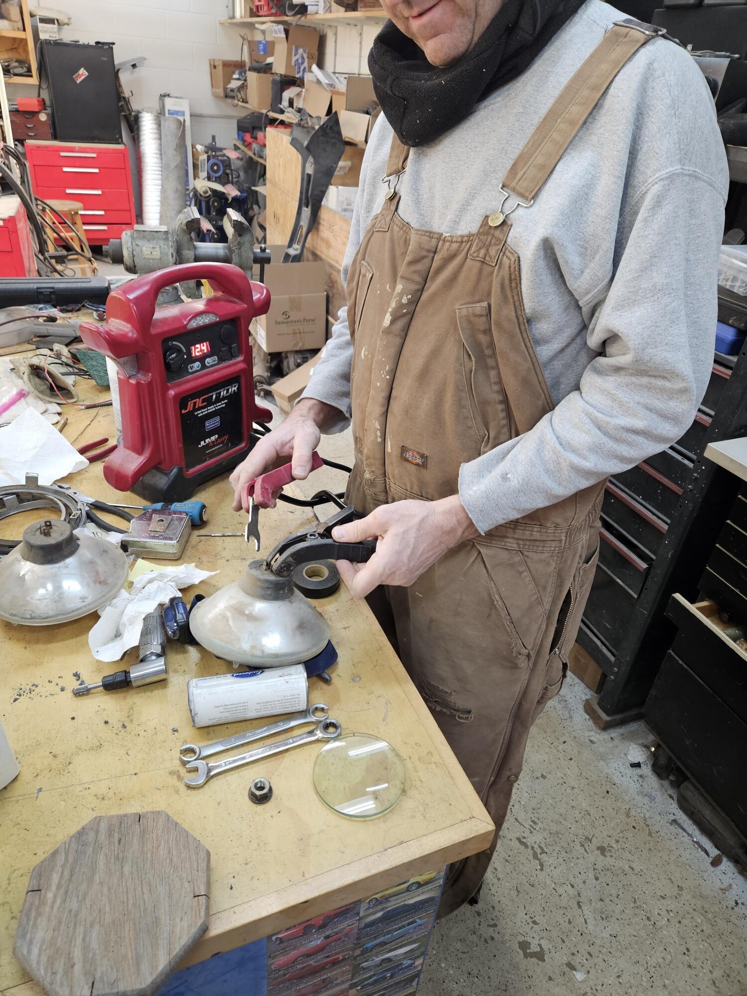

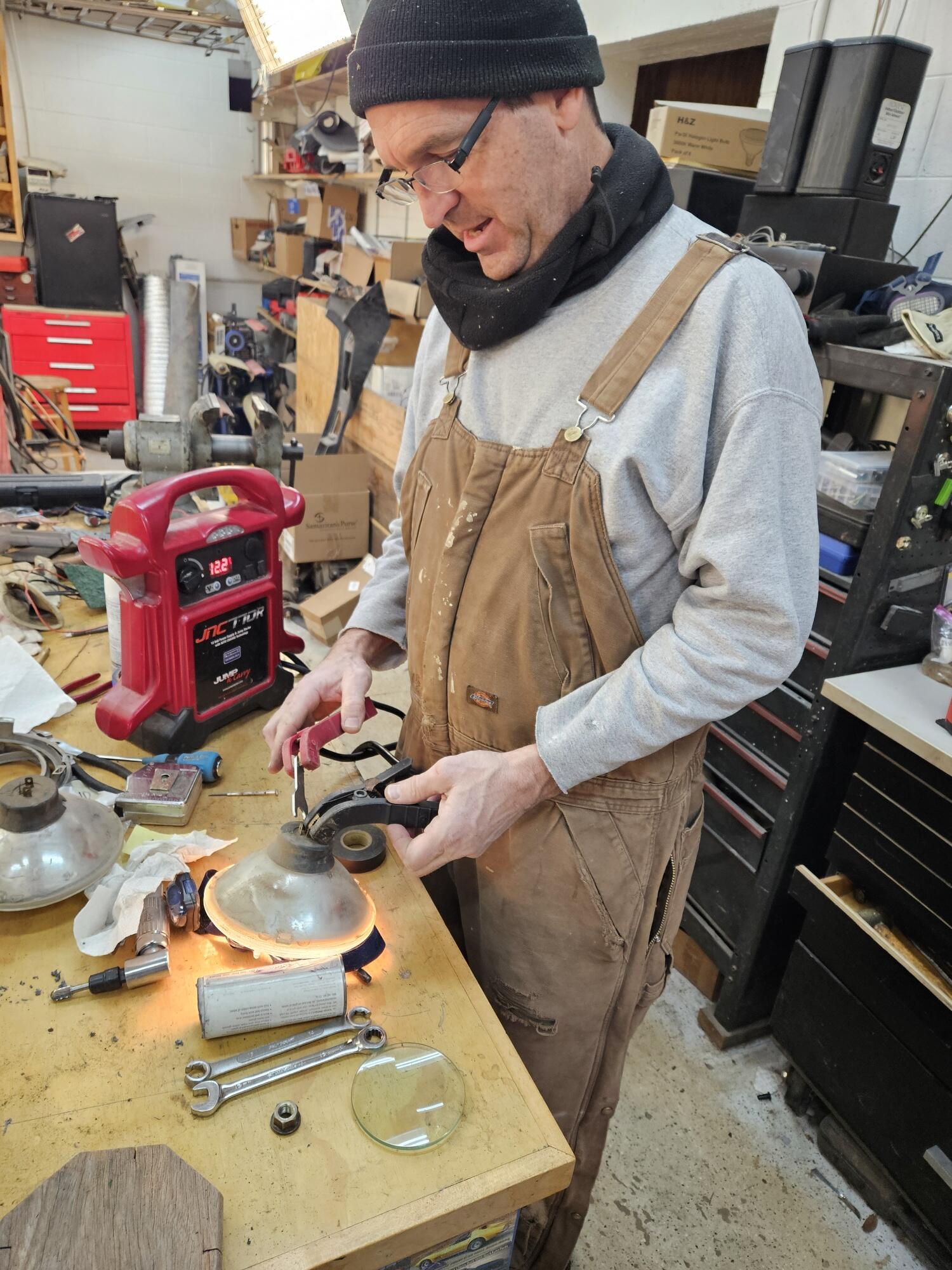

January 21, 20241 yr Author comment_661269 Testing headlamp bulbs in the shop the other day. Another use for the jump box. I have an LED kit that SteveJ recommended but I figured I would start this way and then add the LED's in later  Link to comment https://www.classiczcars.com/forums/topic/55369-1971-hls30-14938-lily-build/?&page=73#findComment-661269 Share on other sites More sharing options...
January 21, 20241 yr comment_661271 Nice glow. Does Cody need me to find H4 housings and bulbs for the Goon? Link to comment https://www.classiczcars.com/forums/topic/55369-1971-hls30-14938-lily-build/?&page=73#findComment-661271 Share on other sites More sharing options...
January 22, 20241 yr Author comment_661276 2 hours ago, SteveJ said: Nice glow. Does Cody need me to find H4 housings and bulbs for the Goon? That might be nice! Link to comment https://www.classiczcars.com/forums/topic/55369-1971-hls30-14938-lily-build/?&page=73#findComment-661276 Share on other sites More sharing options...

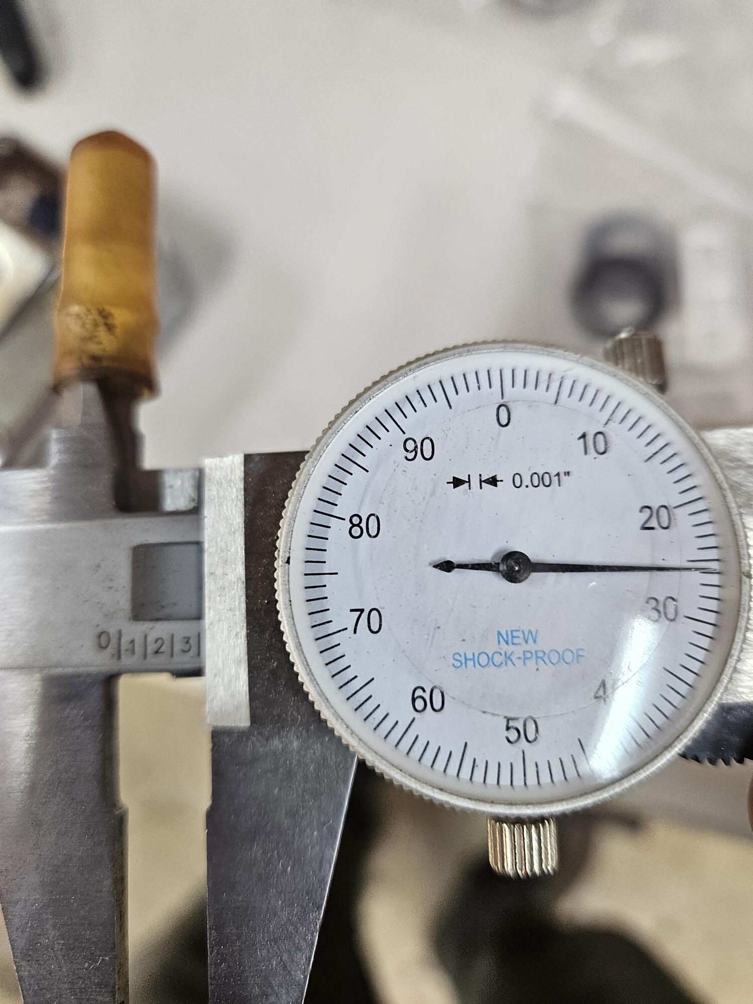

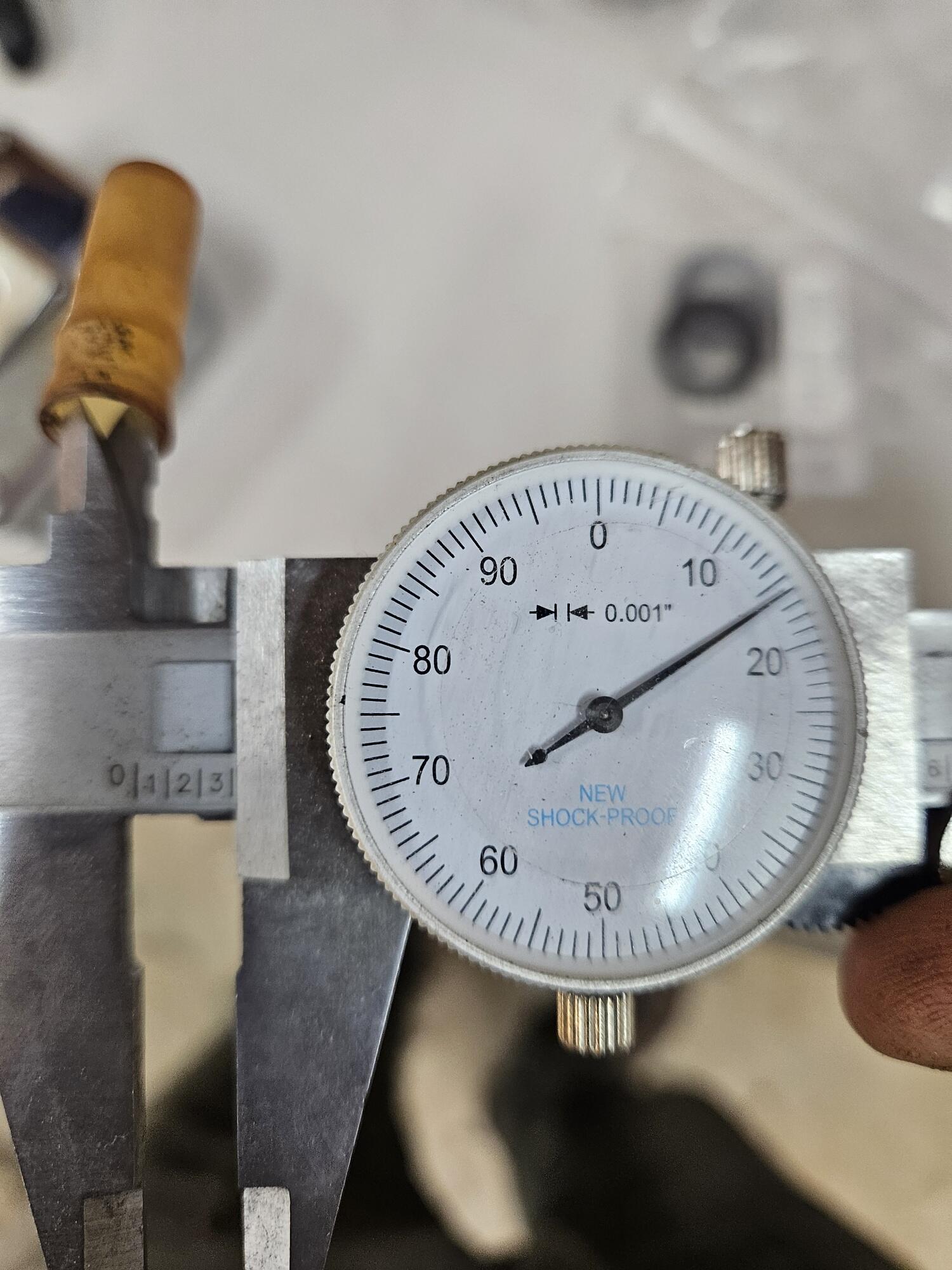

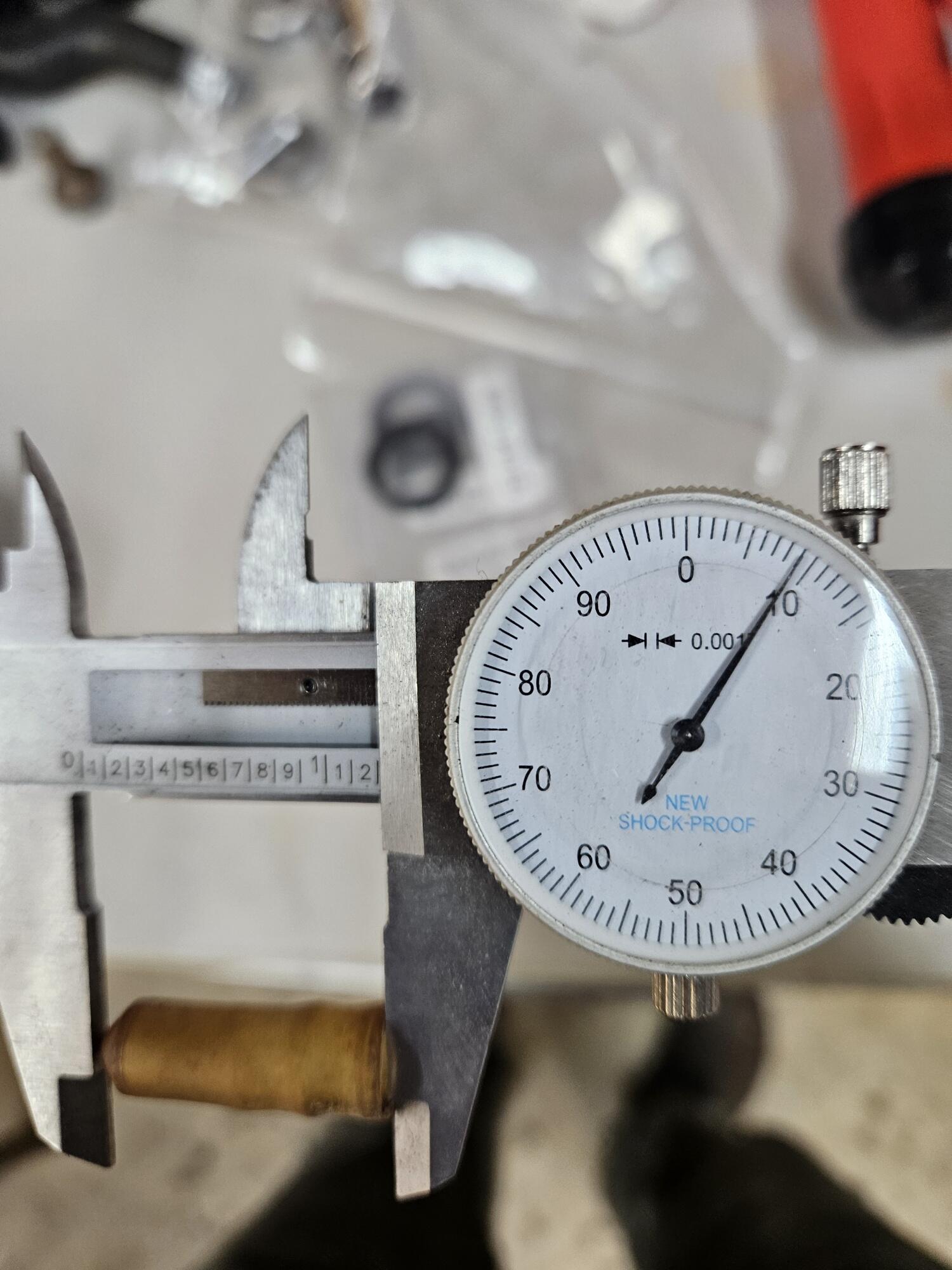

January 28, 20241 yr Author comment_661467 The dimensions of the caps for the headlight screws. I have found some 8mm caps but they're not long Link to comment https://www.classiczcars.com/forums/topic/55369-1971-hls30-14938-lily-build/?&page=73#findComment-661467 Share on other sites More sharing options...
