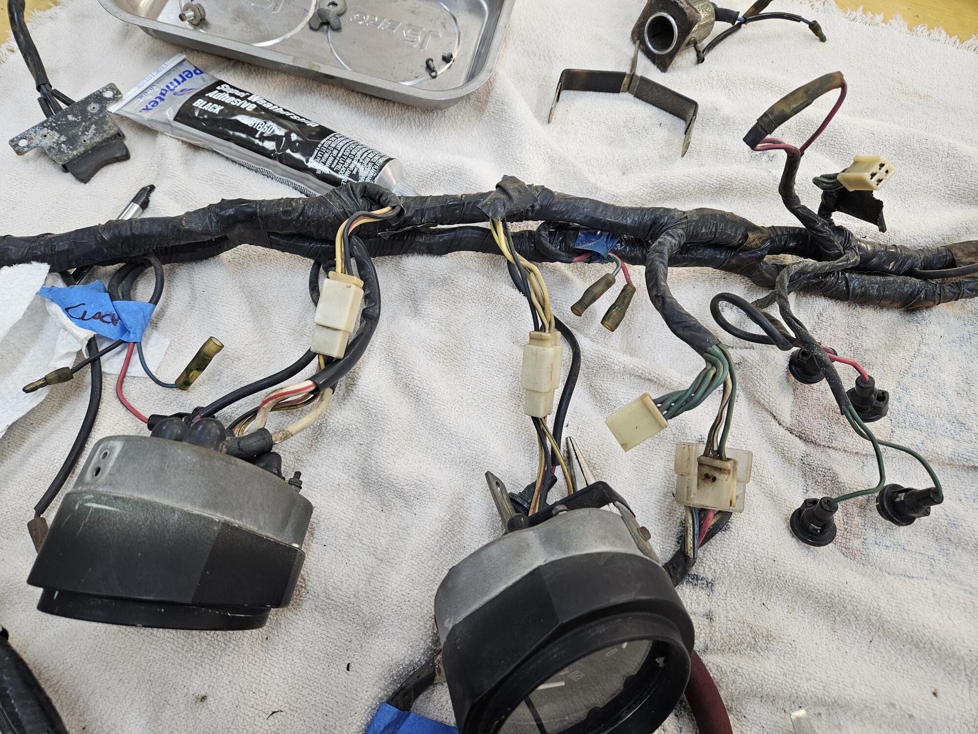

Posted (edited)
That is a later dash board for sure.  If the early oil pressure gauge was swapped in (looks to be the case) than I would think the dash portion of the harness would be original to the car as well.

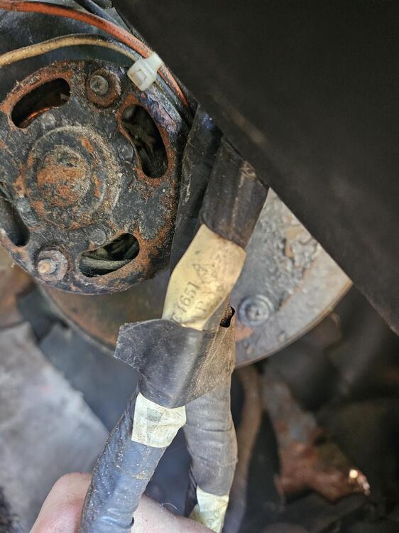

There are part number tags attached to the harness on the right side corner, several inches before the connectors.

When assessing the dash wiring harness options, watch out for the Combination Switch.  According to my records, the design was changed starting in Oct-1971 to accommodate Nissan's parallel decision to change the headlight switching strategy from ground-switched to positive-switched.
Note also that the fuse block's wiring harness changed from from 'long pigtail' to 'short pigtail' at the end of Jan-1971.  I expect that the dash wiring harness would need to have been changed to match.

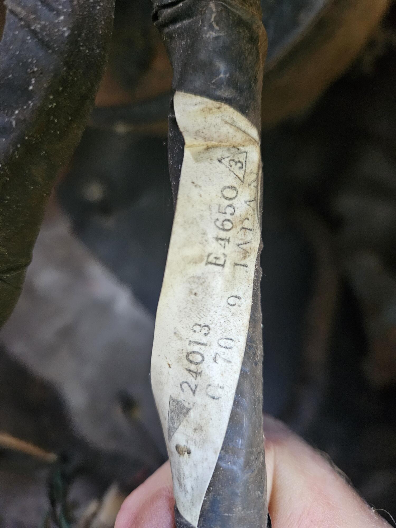

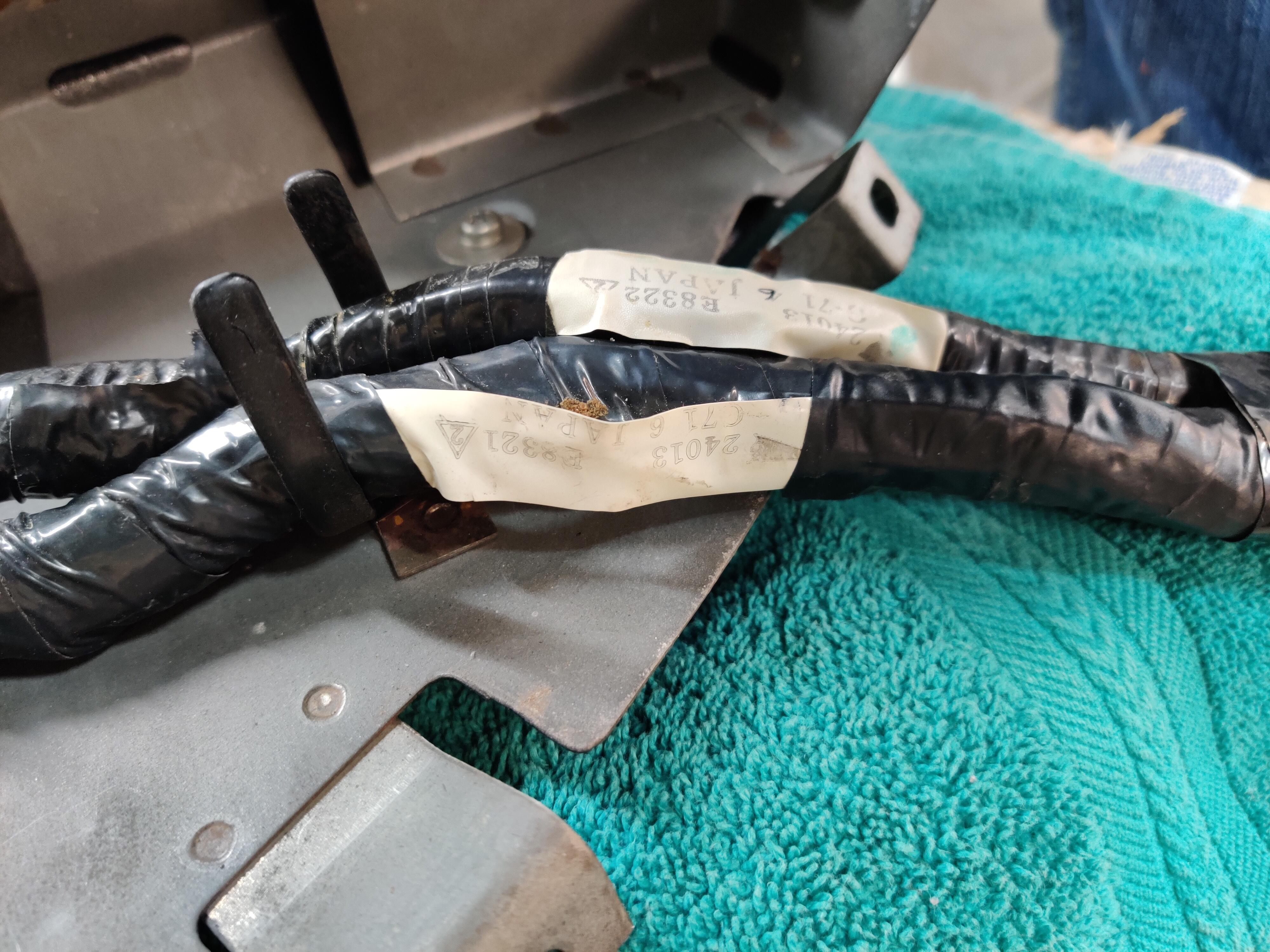

So I need someone with the factory parts book to check something for me.
I looked on car parts manual but they don't show a corresponding number for these dash harnesses. They are close to the early car dash numbers but not exactly the same.
24013-E4650 & 24013-4651

Charles,
I just pulled out my hardcopy of the parts fische that I bought in 1999. There is no reference to either of these P/N's for the '69-73 cars. For manual transmissions thru 12/70 it was E4600 and E4601; thru 08/71 it was E8300; thru 12/71 it was E8800; thru 06/72 it was E8802; thru 09/72 it was N3300; for the remaining '73's it was N3325 for "A" (?) and N3326 for "B" (?).. Similar changes for cars with the auto transmission.
Jim
1 hour ago, jfa.series1 said:
Charles,
Jim
Fascinating, it looks like it's got a 9/70 manufacture date. The Exx50 makes me wonder if it was a small revision somehow?
Any chance they were from a non-US spec car, i.e. Canada? The 4650 and 4651 might reflect the same changes as 4600 and 4601. Just a WAG!
I don't know. Maybe somebody with a more complete parts database will chime in. It would be nice to know but for now it appears to be an original harness in a car a month earlier than Lily. The brown z was my daily driver 30 years ago, so I should be able to get Lily going with the donations

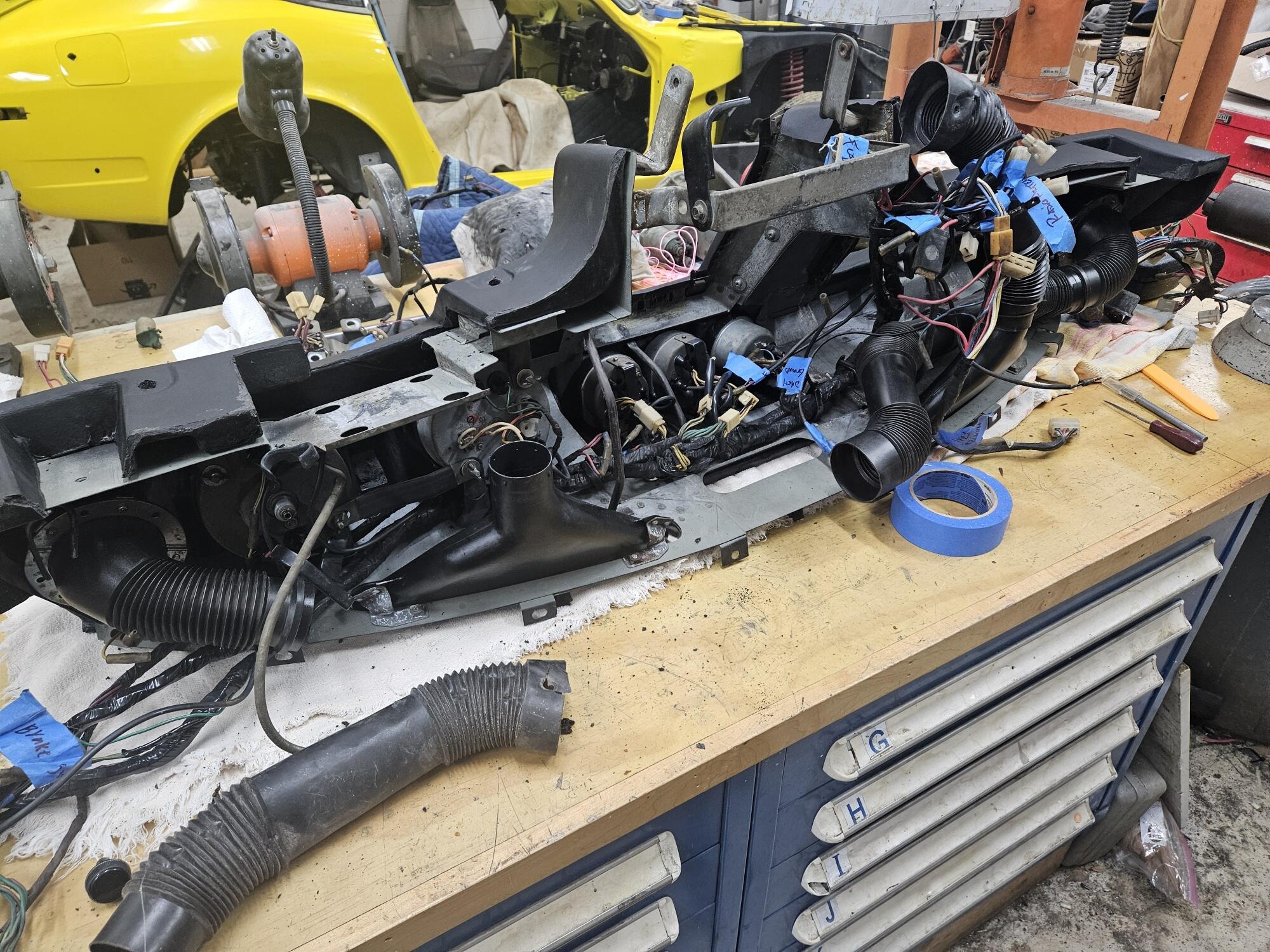

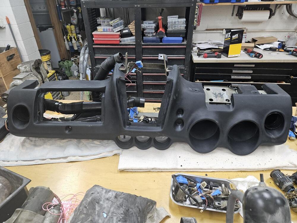

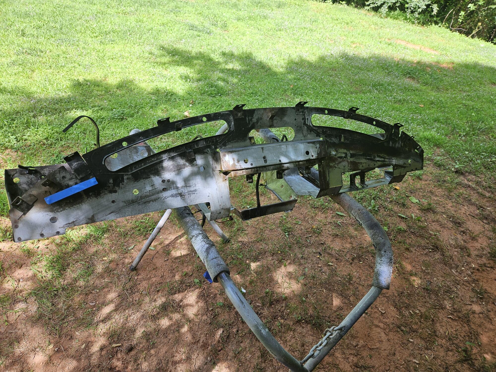

So here is the frame stripped down. Later I shot some rust converter and then some black around the defrost area

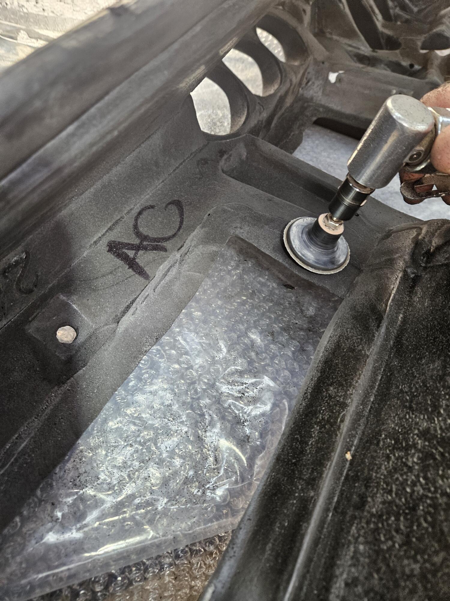

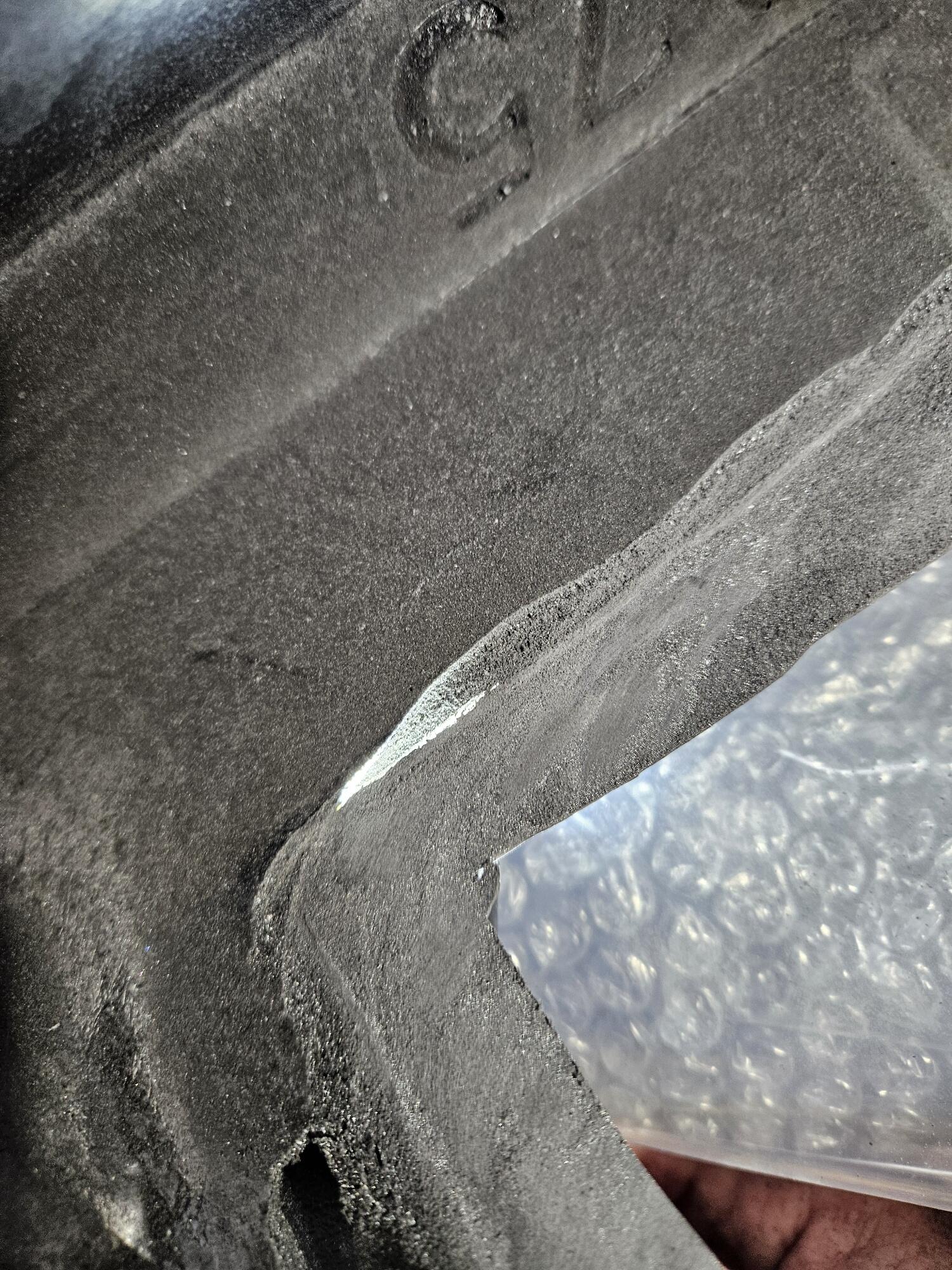

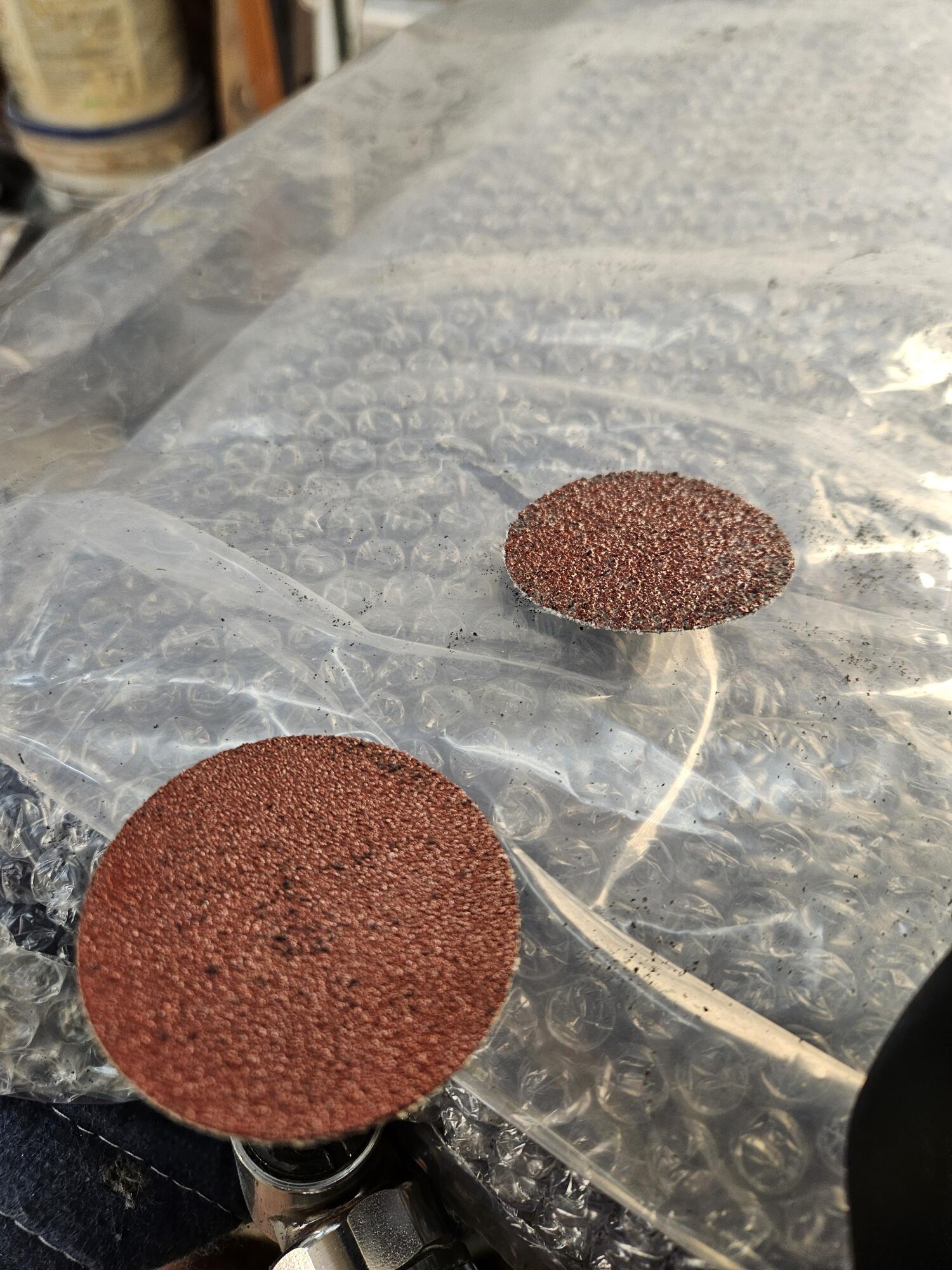

So to thin down around the glove box area. I used a Rolok instead of a razor blade. Makes a mess but very quick
Be careful when working behind the indentions that mark the glovebox outline. It's easy to cut through. Backlit...

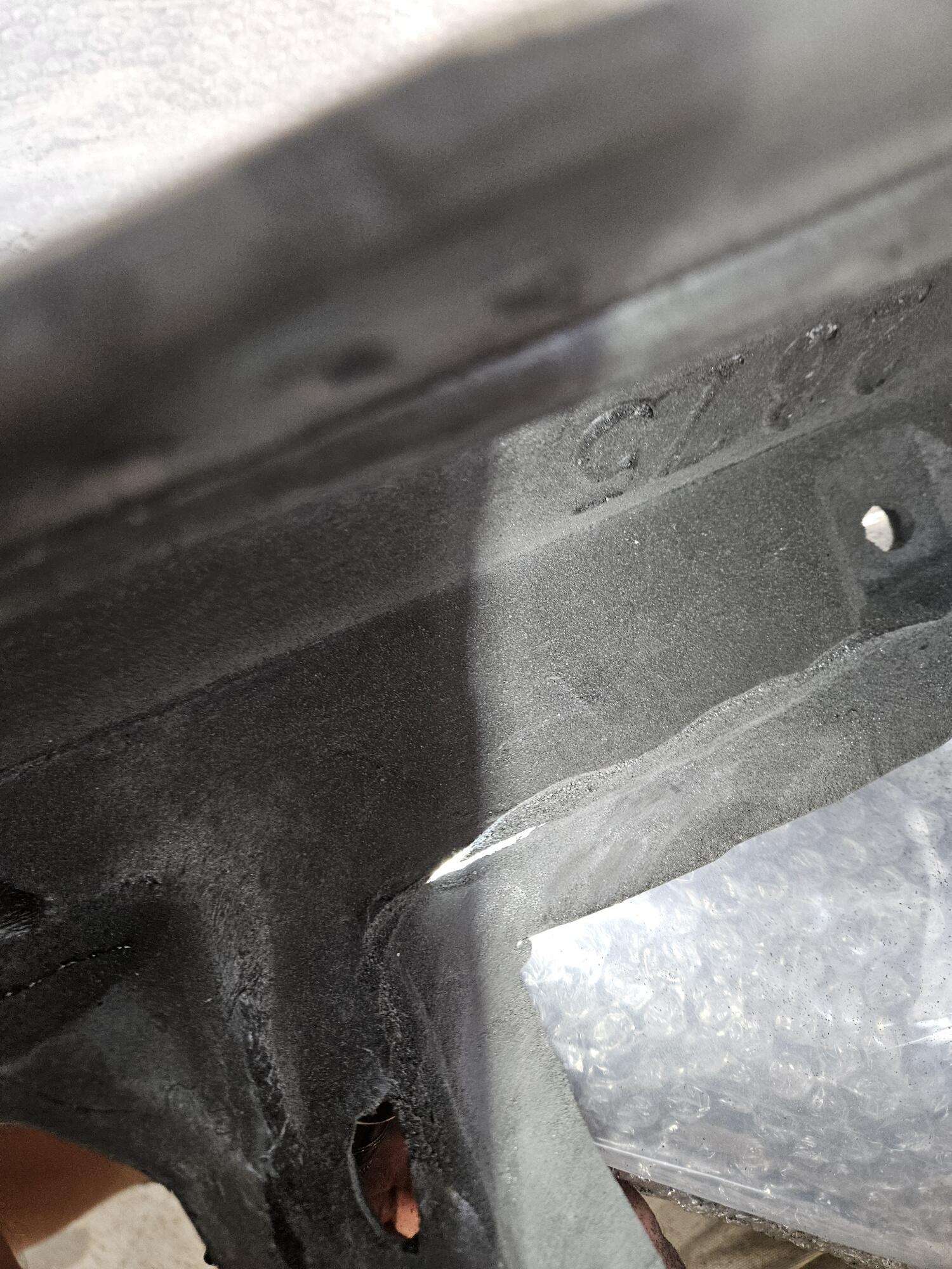

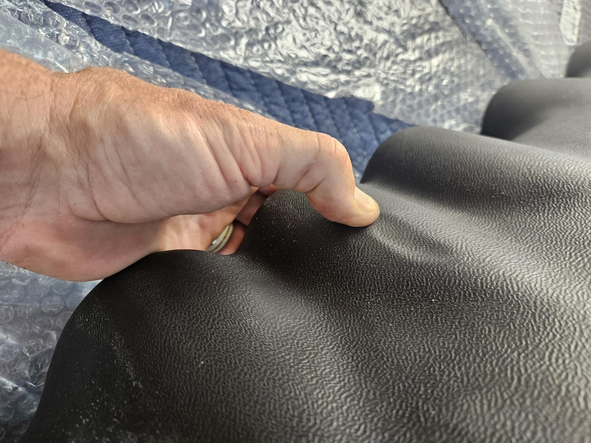

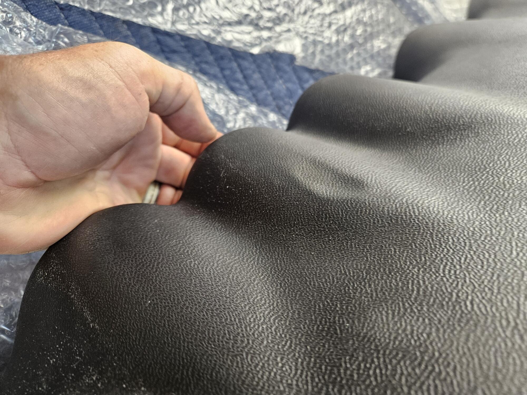

The replacement dash pad itself has been a great disappointment!
For starters, I had started working on the dash and had the pad mounted to the frame when I noticed a little wavyness in the top of one of the pods. When I messed with it, I realized it was hollow!
I contacted JDM-CAR-PARTS and was cited their policy of 14 day return window. It had been well more than 14 days. I was also told it looked like I'd had it leaning up against something. In actuality, I pulled it out of the box when I got it. Gave it a quick look over and put it back in the bag and original packaging until I got ready to tackle it. I made it clear in a follow up email that I didn't want to return it but I would like the "blemished" price because that's what it is, but I got radio silence. I also don't like how much room is around the gauges. They don't fit super snug and I found out yesterday the glovebox lock doesn't center in the dash hole. I will have to clearance the lock mounting holes to shift it over, but the glovebox latch might not work if I do that. Overall, not impressed!!!
I'll make do for now and it's better than what I had. If I were doing it over I would buy the more expensive dash. You would think these are all made at the same place in Asia, but maybe not. I don't recall other members that have used reproduction pads having these kinds of issues.
Here is it's current state of reassembly
