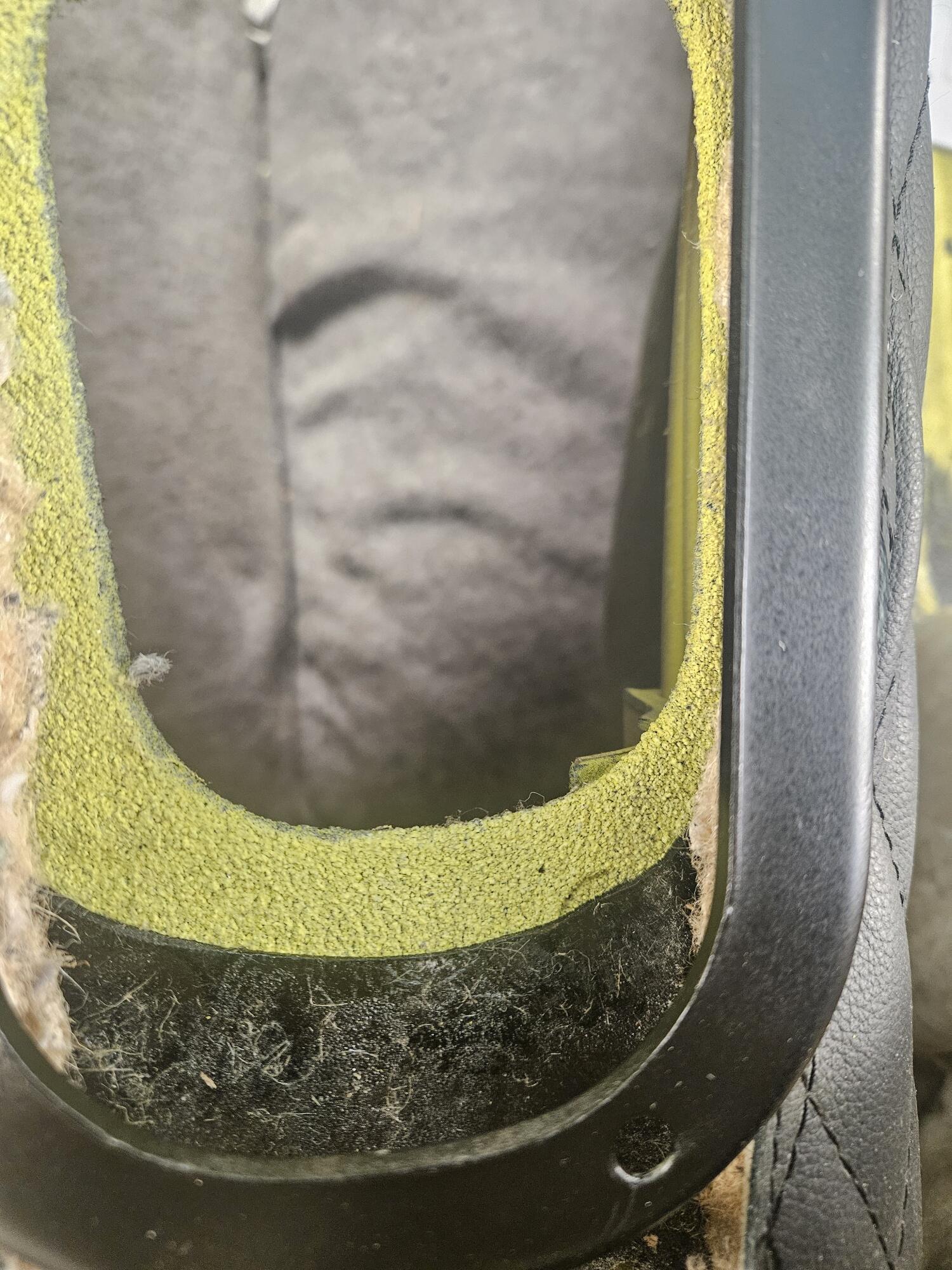

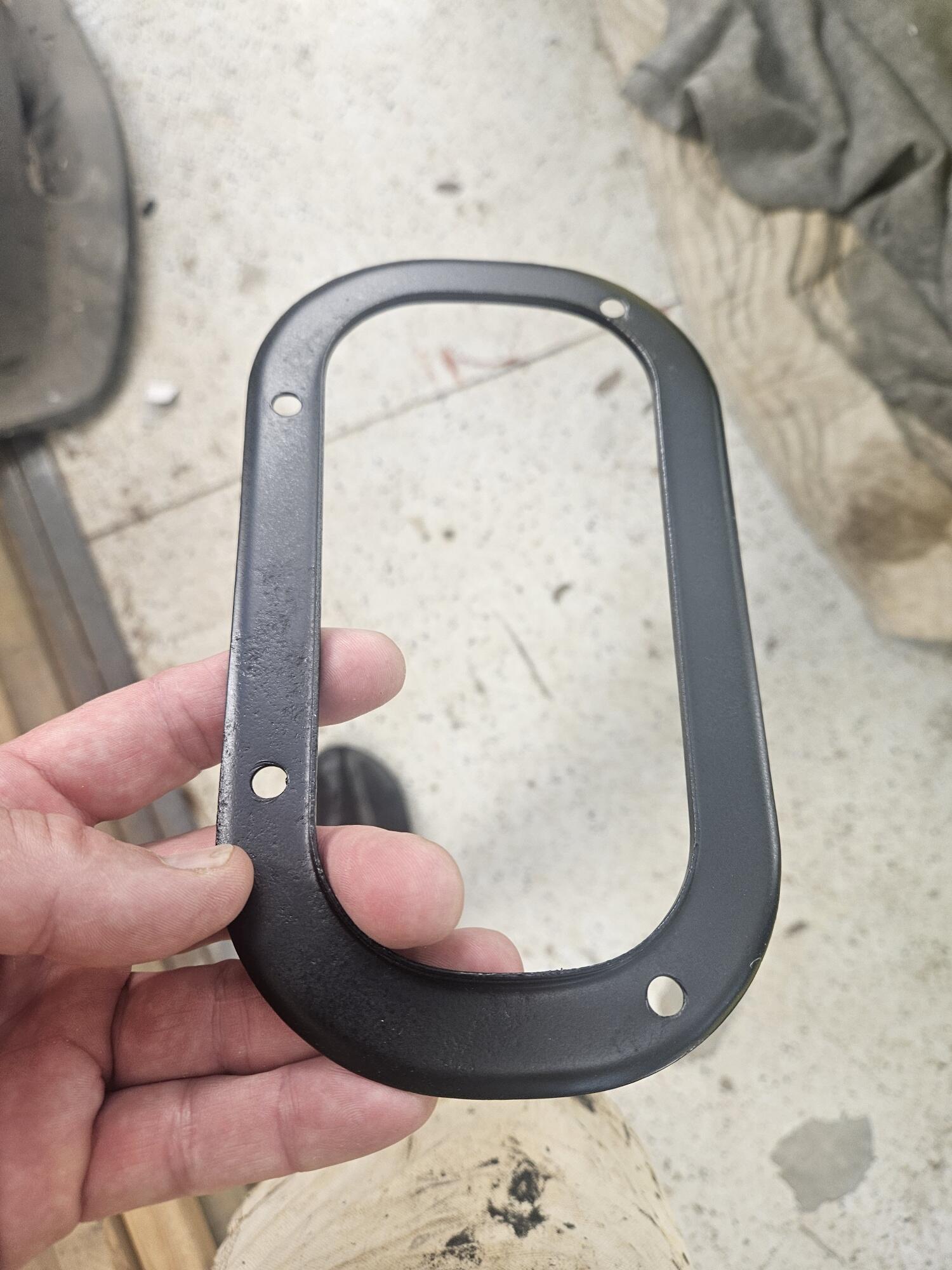

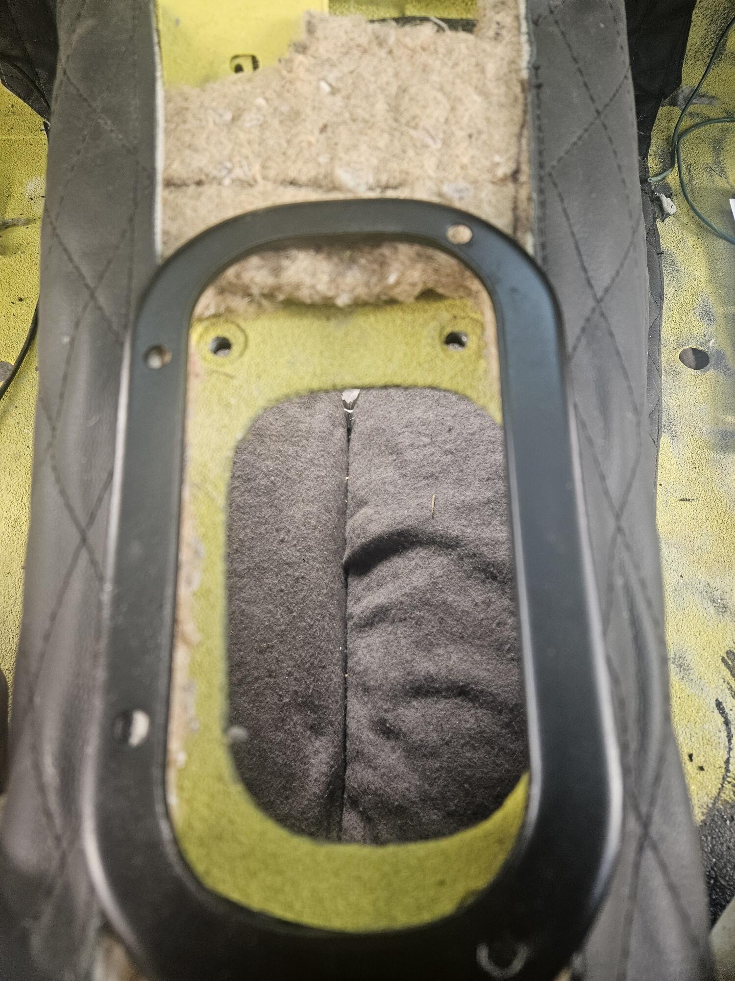

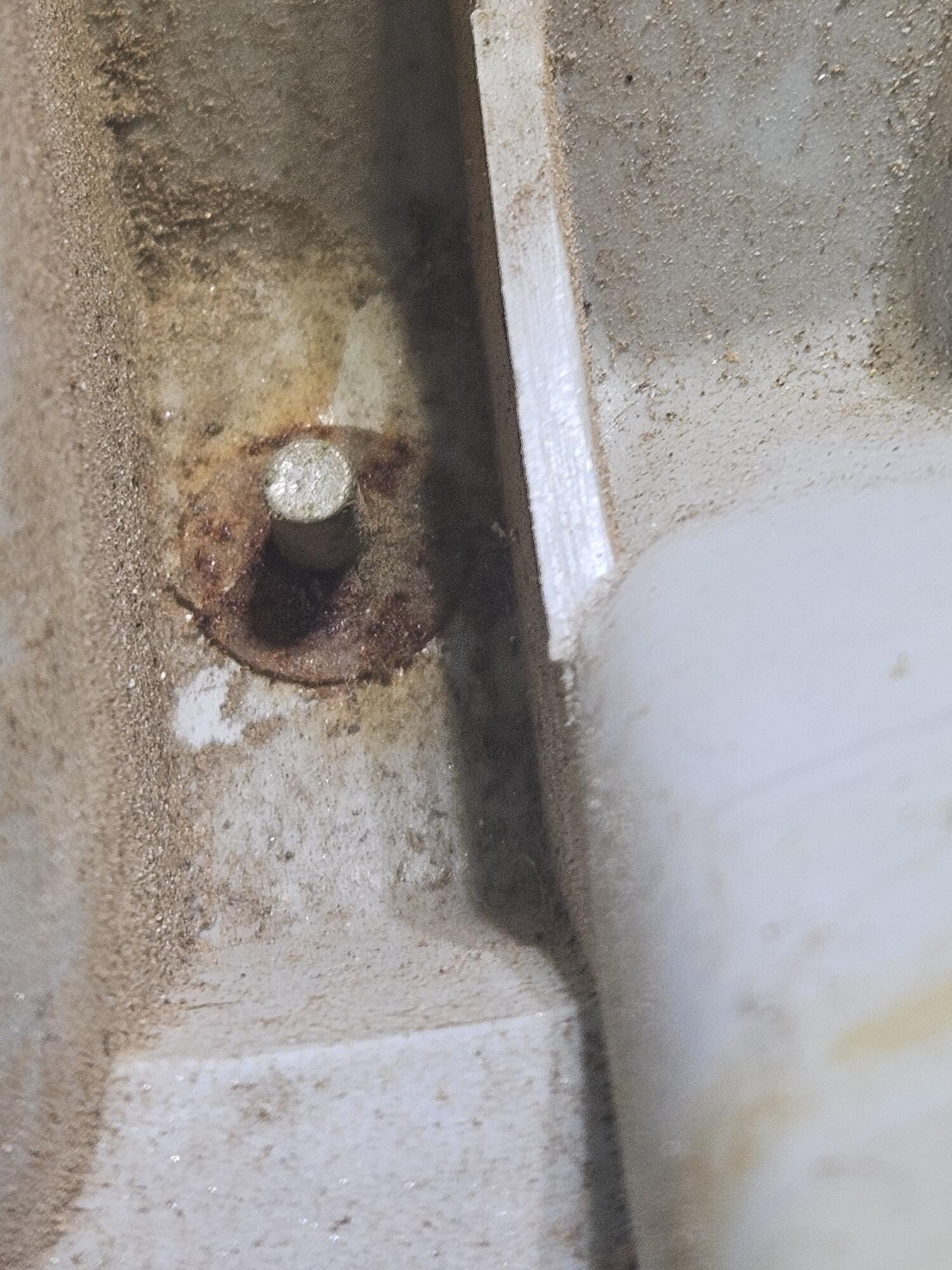

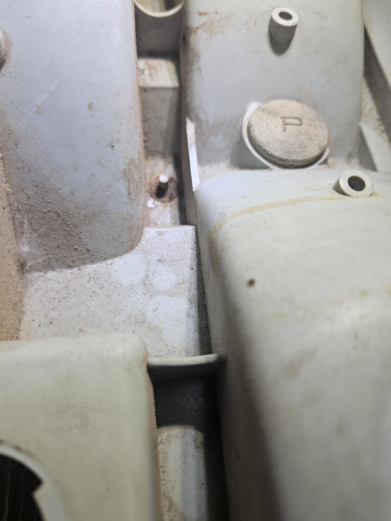

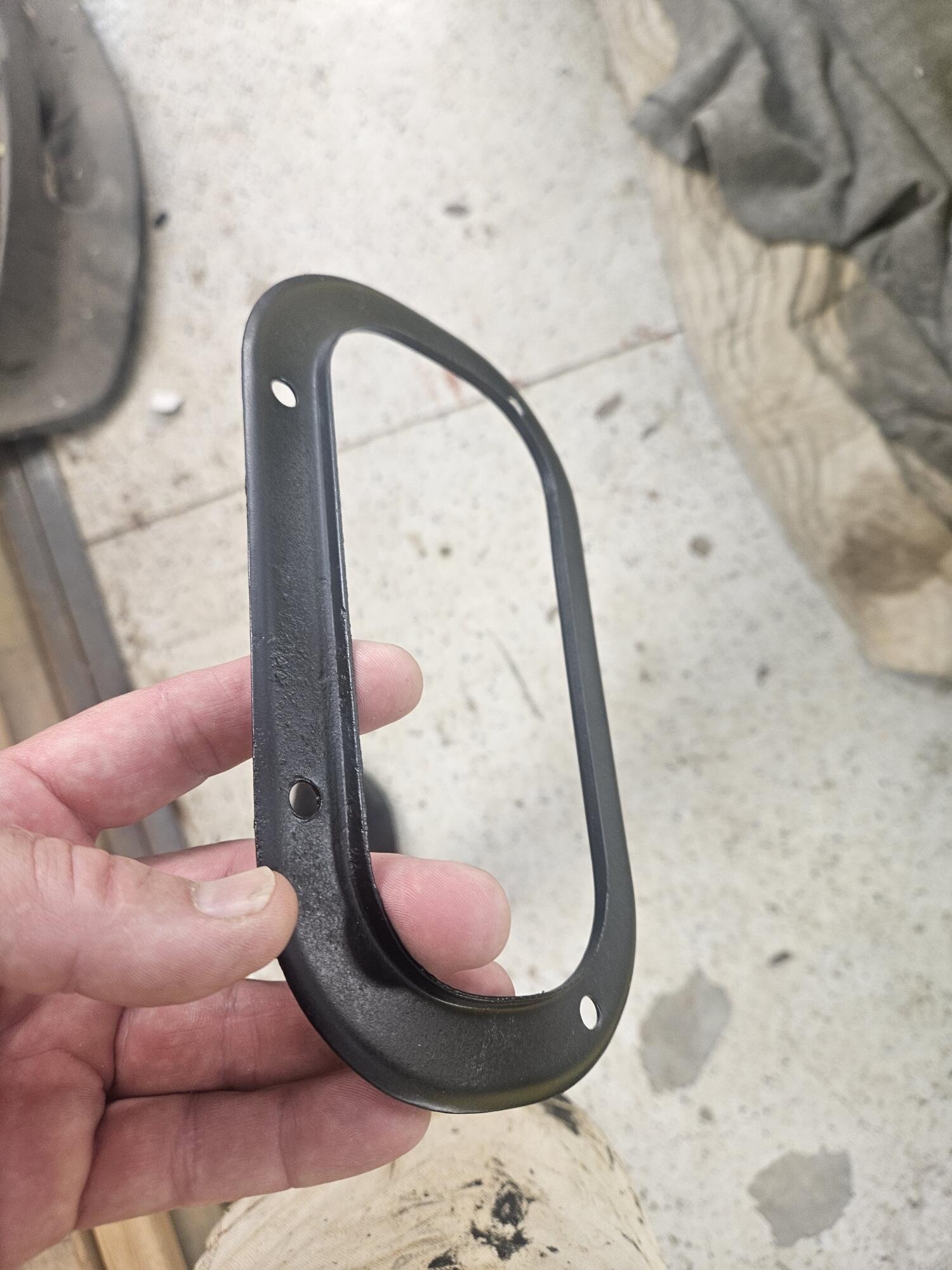

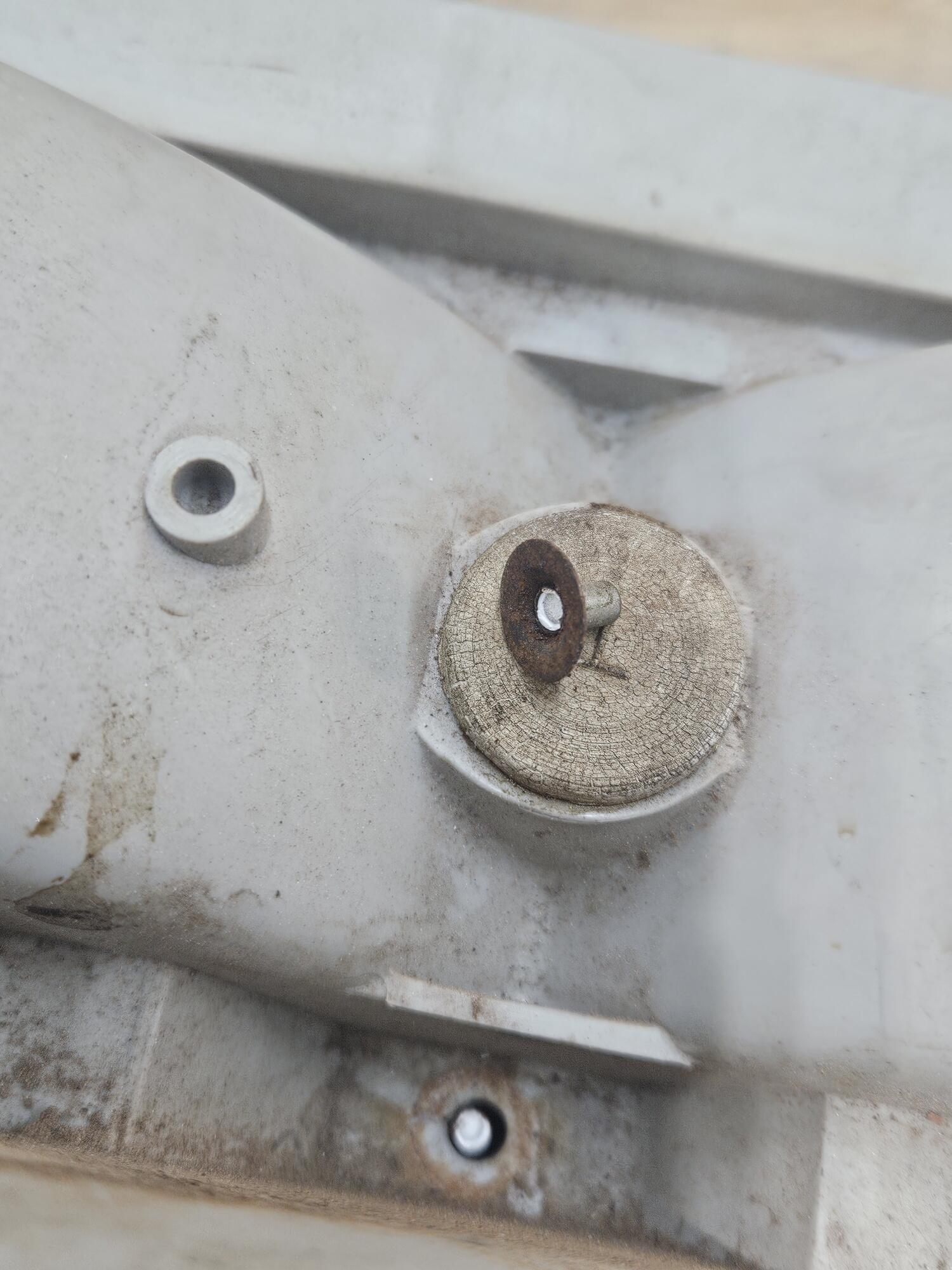

June 30, 2024Jun 30 Author comment_666940 Can someone confirm this the factory 240z shifter boot ring? Lily is an automatic car and this ring doesn't line up at all with any of the four bolts welded to the tunnel Also what fasteners are used to hold the ring down. Bolts or sheet metal screws??? Link to comment https://www.classiczcars.com/forums/topic/55369-1971-hls30-14938-lily-build/?&page=85#findComment-666940 Share on other sites More sharing options...

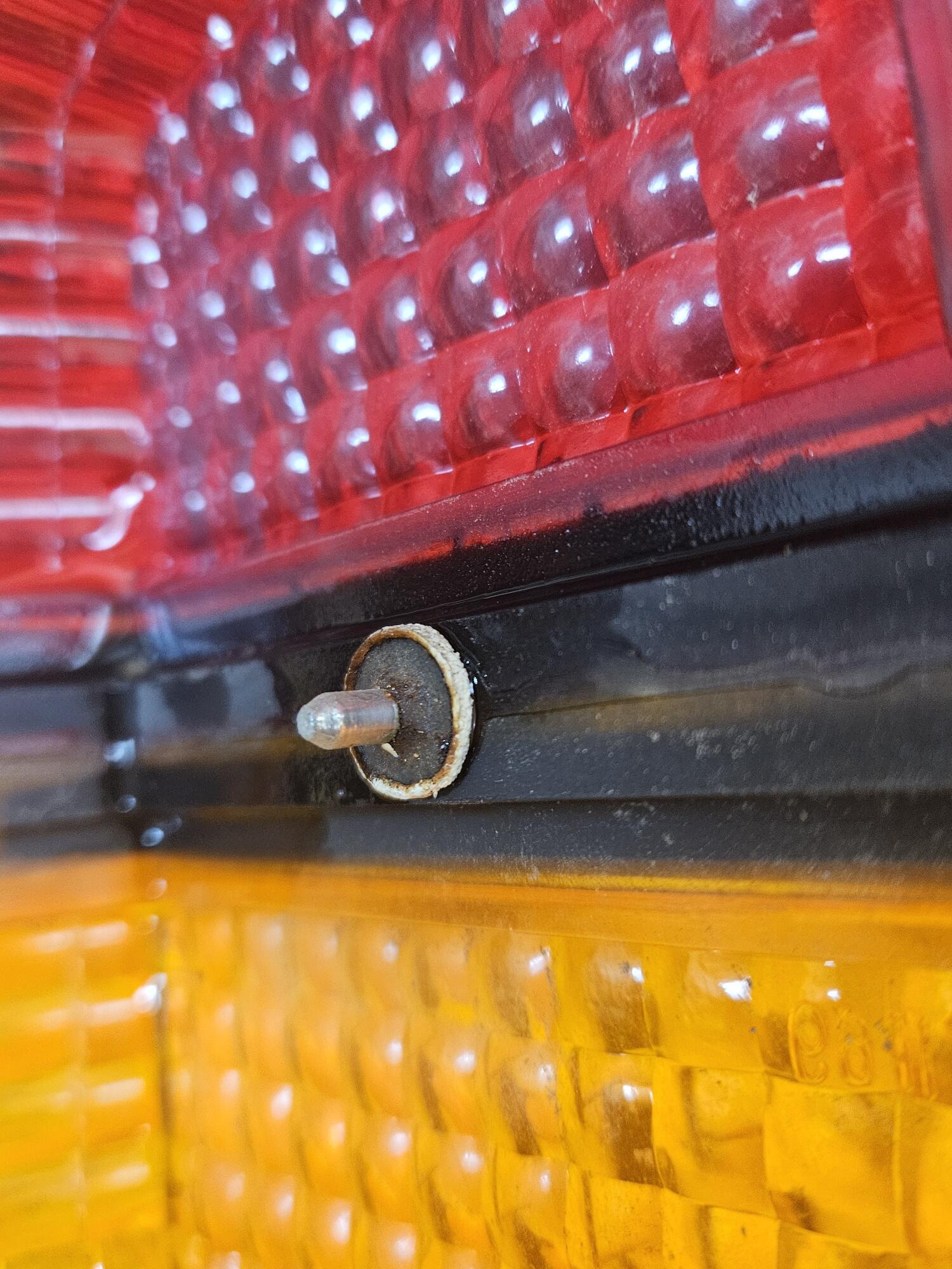

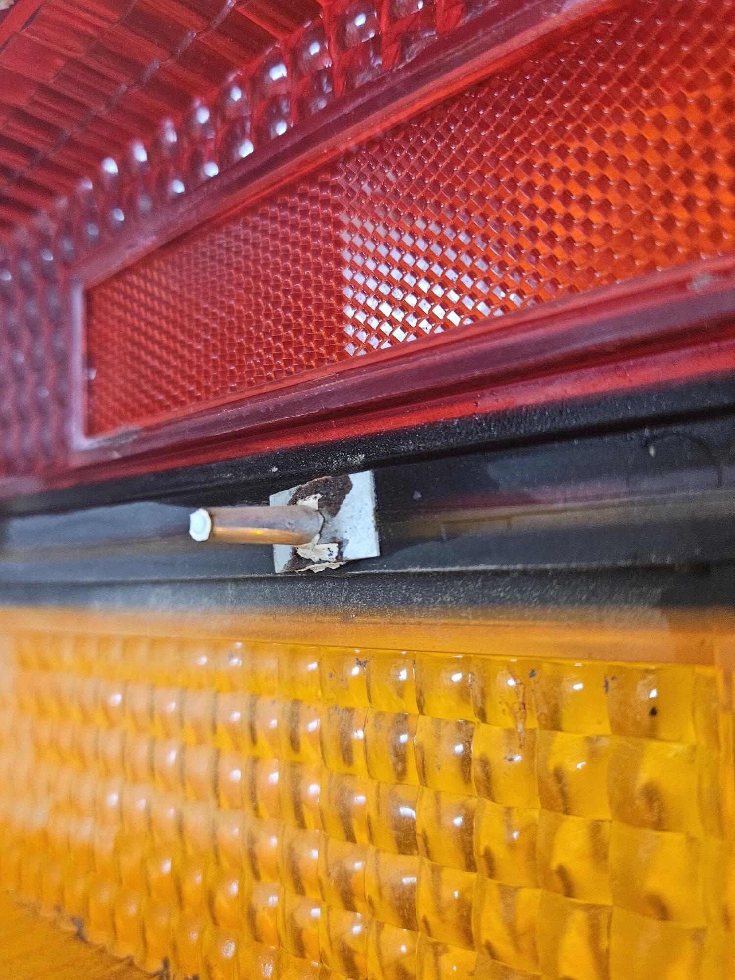

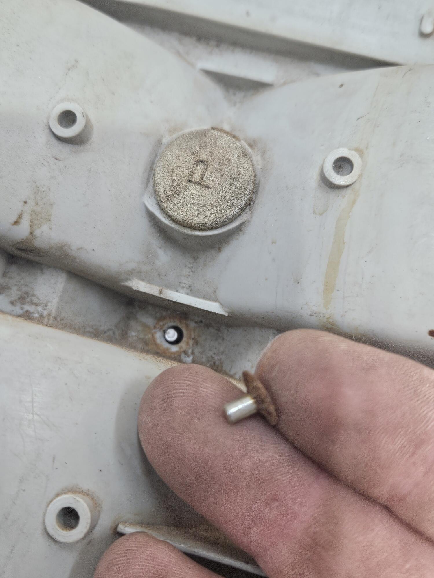

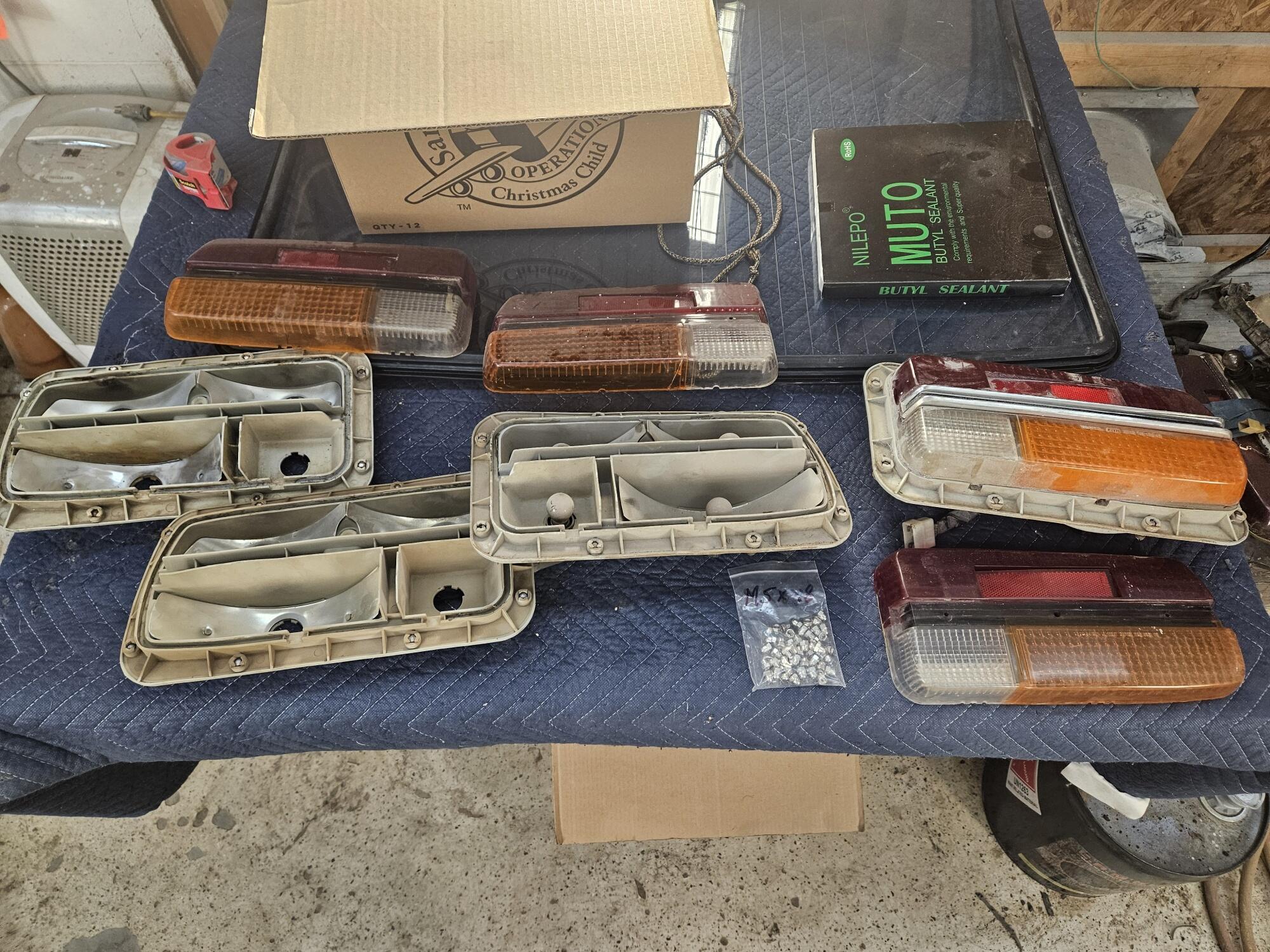

June 30, 2024Jun 30 Author comment_666941 I worked on the tail lights some more. Selected the better used parts I have Disassembly requires removing this little locking disc off the plastic prong on the middle of the light trim I have never removed one successfully These are the retainers on the inside of the lens holding the trim on Edited June 30, 2024Jun 30 by Patcon Link to comment https://www.classiczcars.com/forums/topic/55369-1971-hls30-14938-lily-build/?&page=85#findComment-666941 Share on other sites More sharing options...

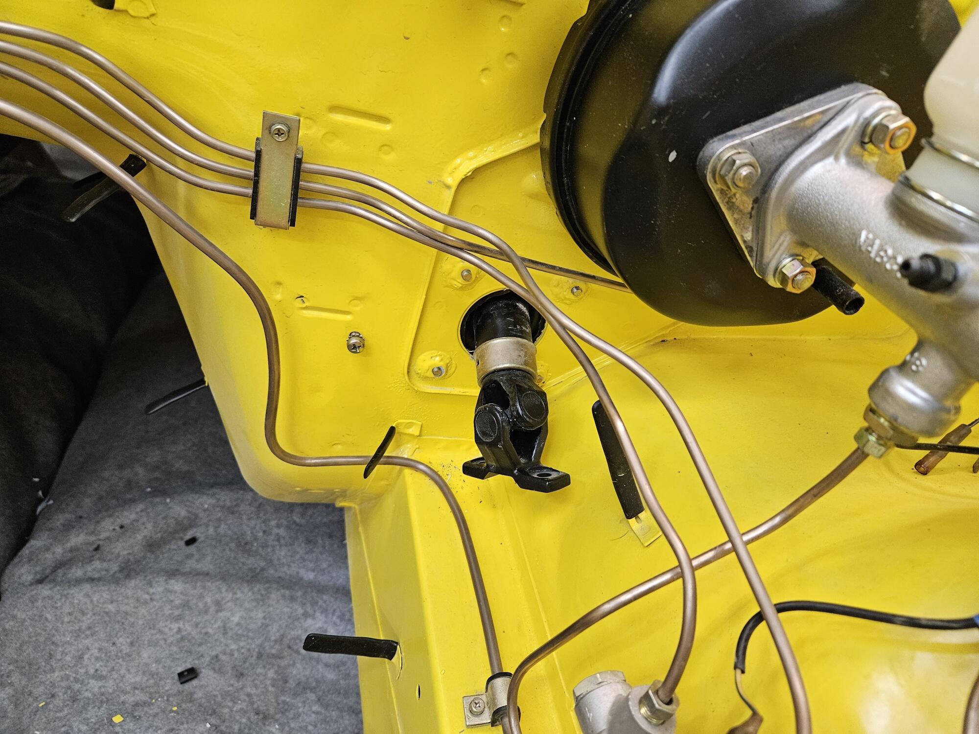

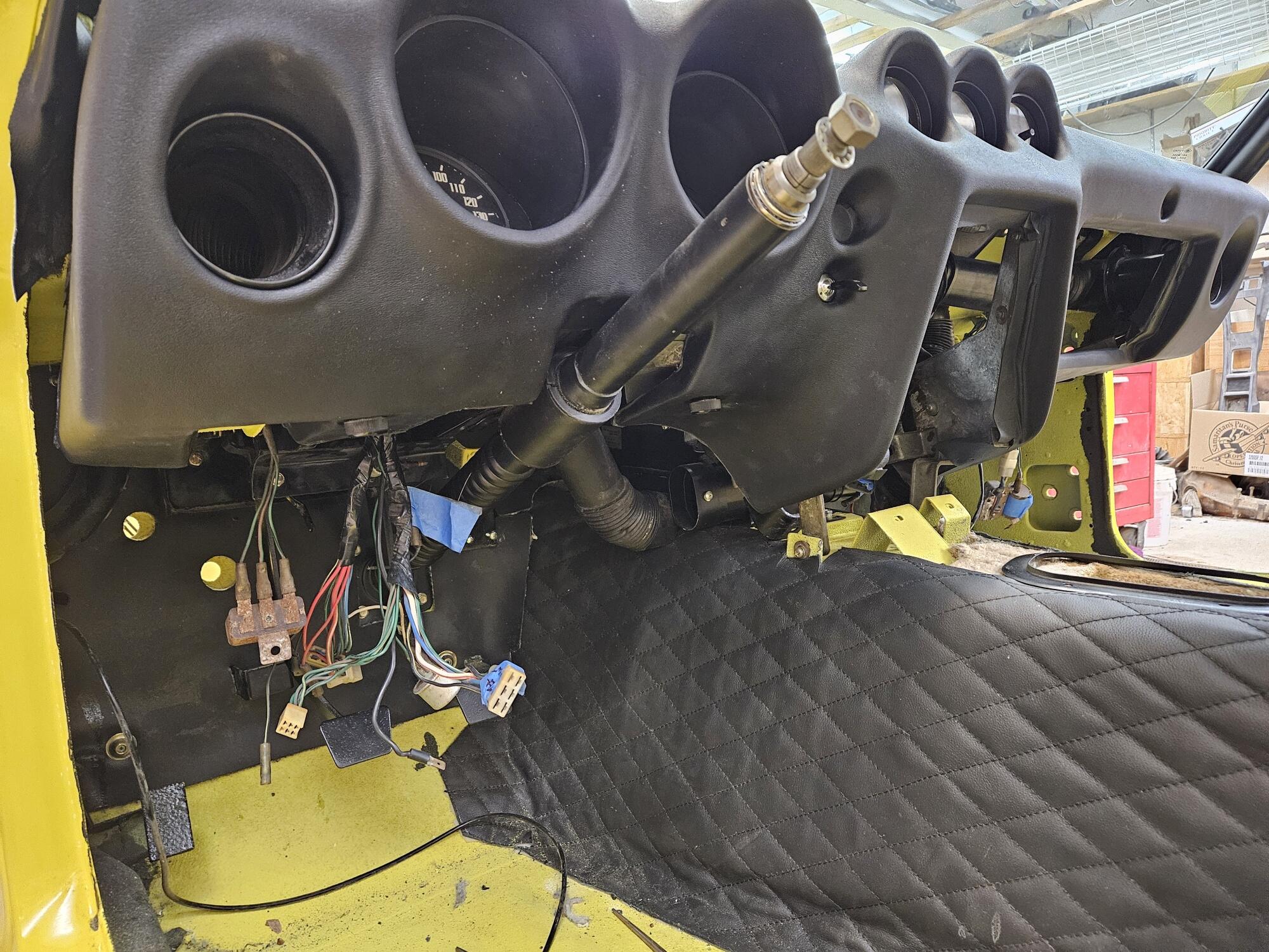

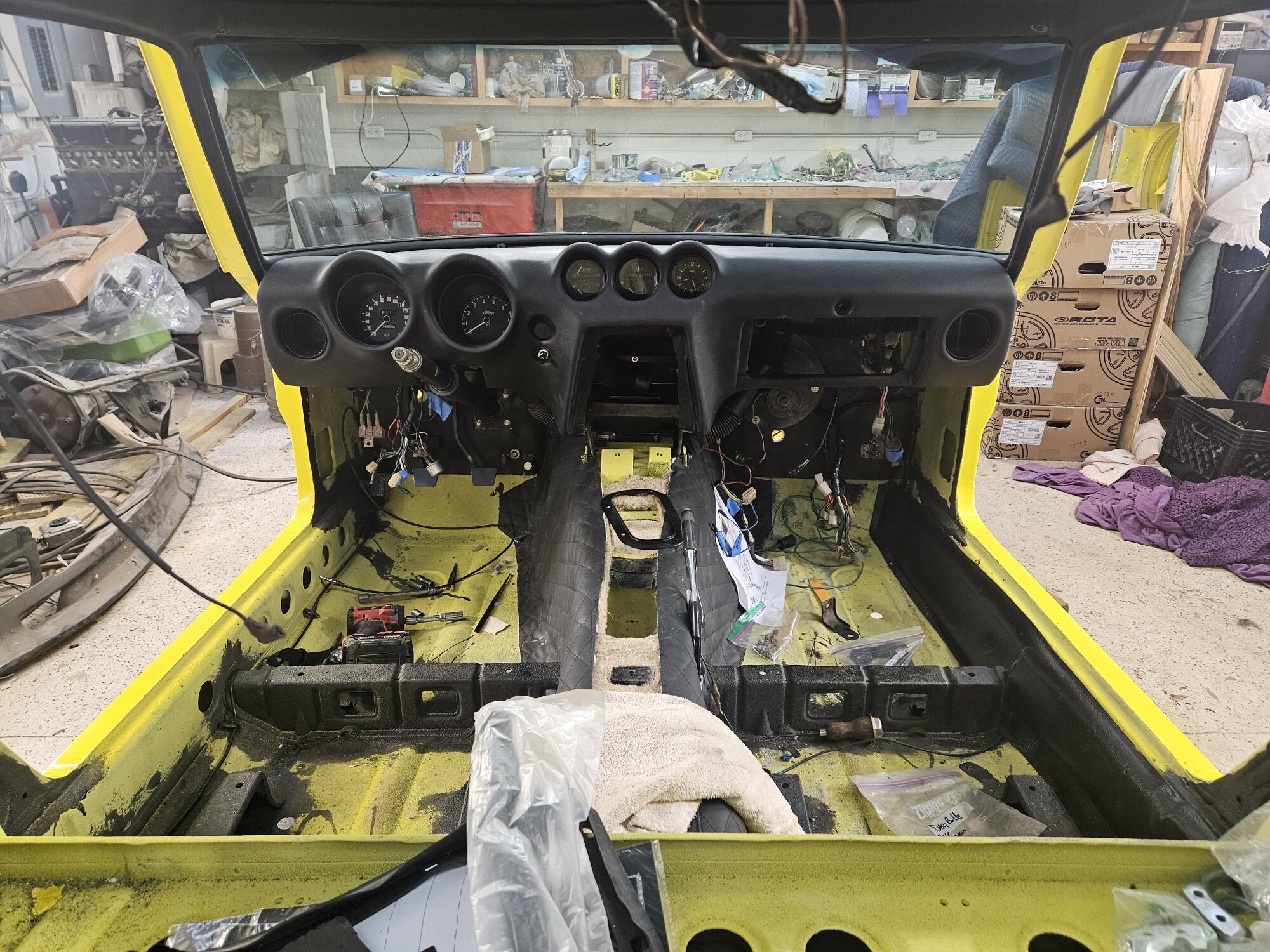

June 30, 2024Jun 30 Author comment_666942 I finished the dash up this week. At least enough to go in... Got the steering column in too. waiting on bolts for the steering coupler Link to comment https://www.classiczcars.com/forums/topic/55369-1971-hls30-14938-lily-build/?&page=85#findComment-666942 Share on other sites More sharing options...

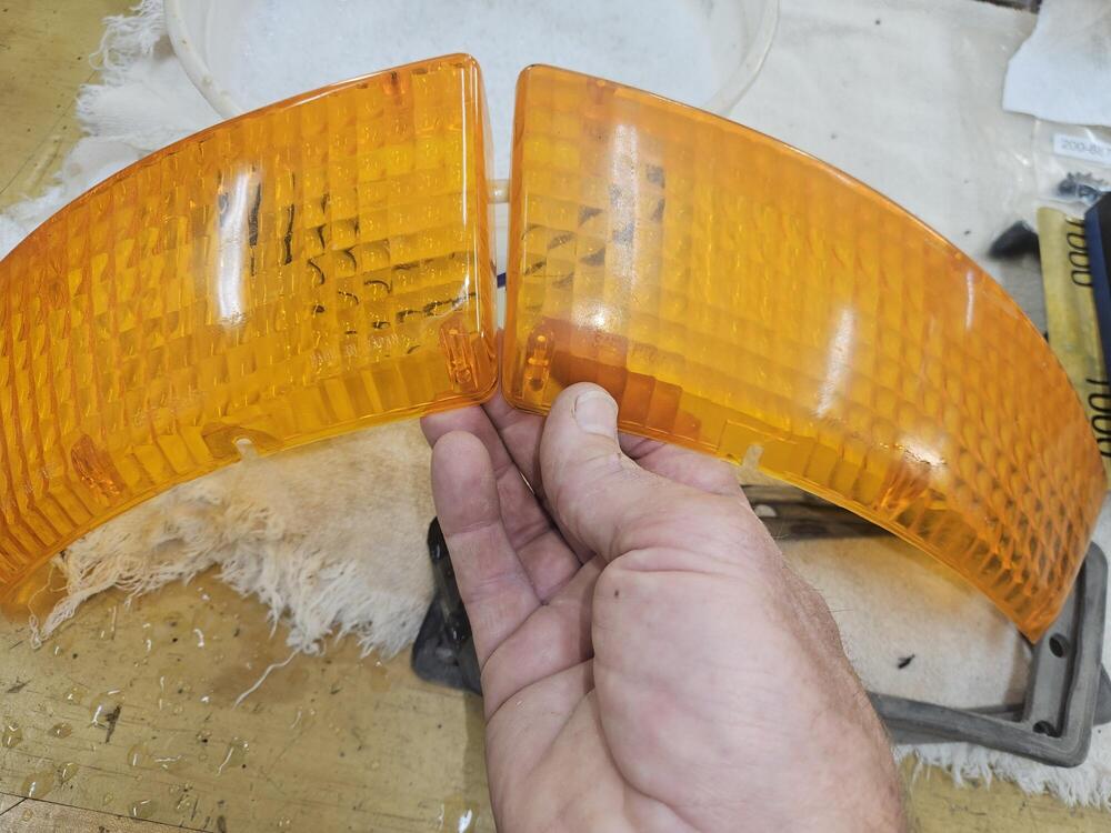

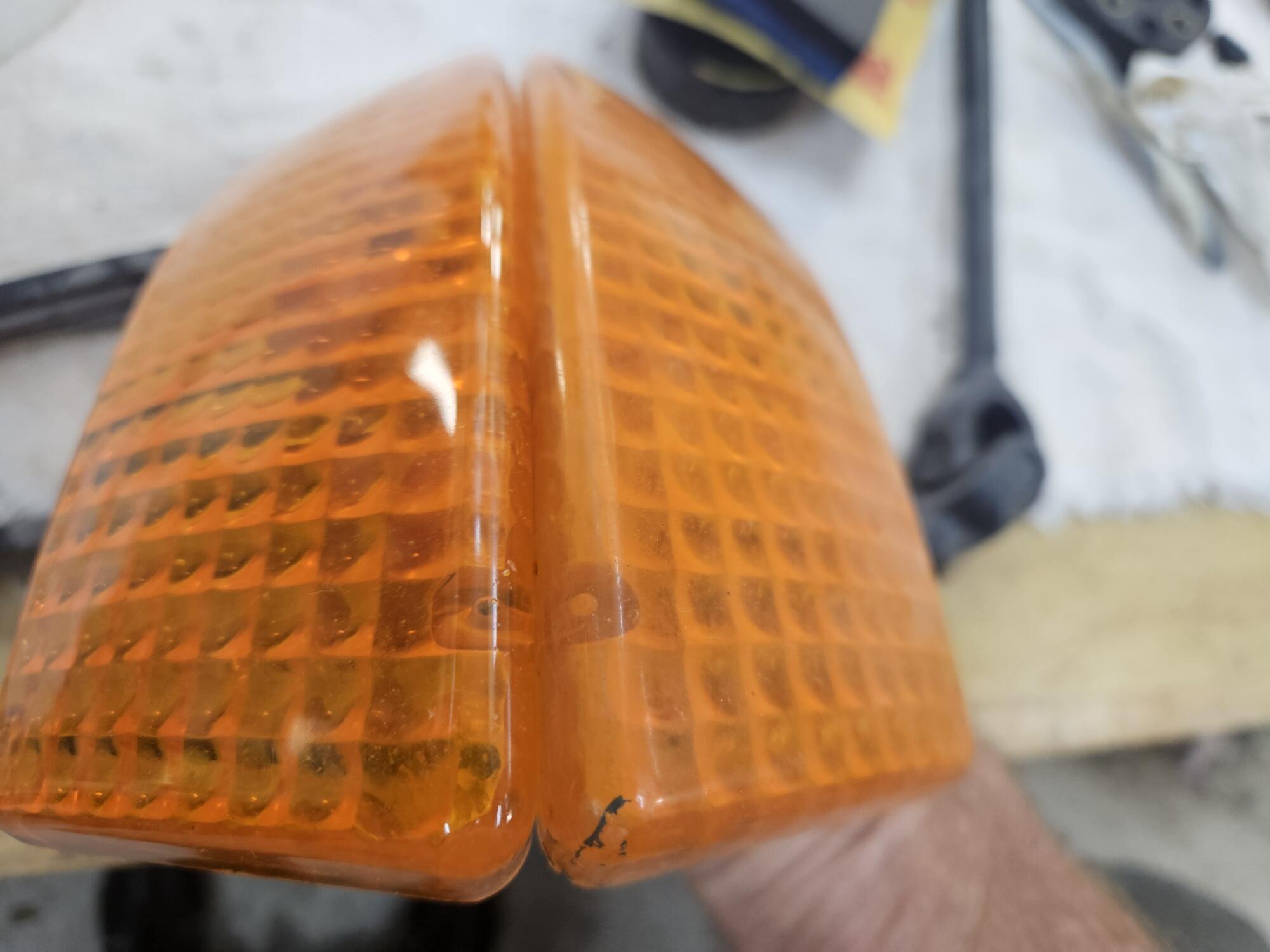

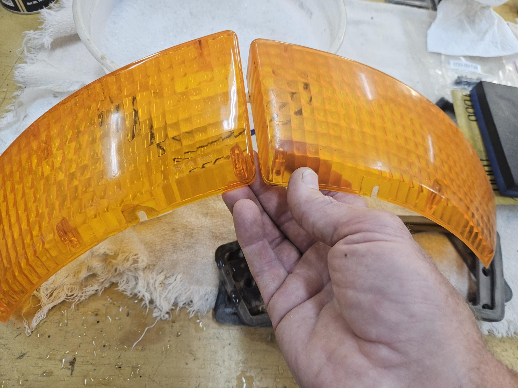

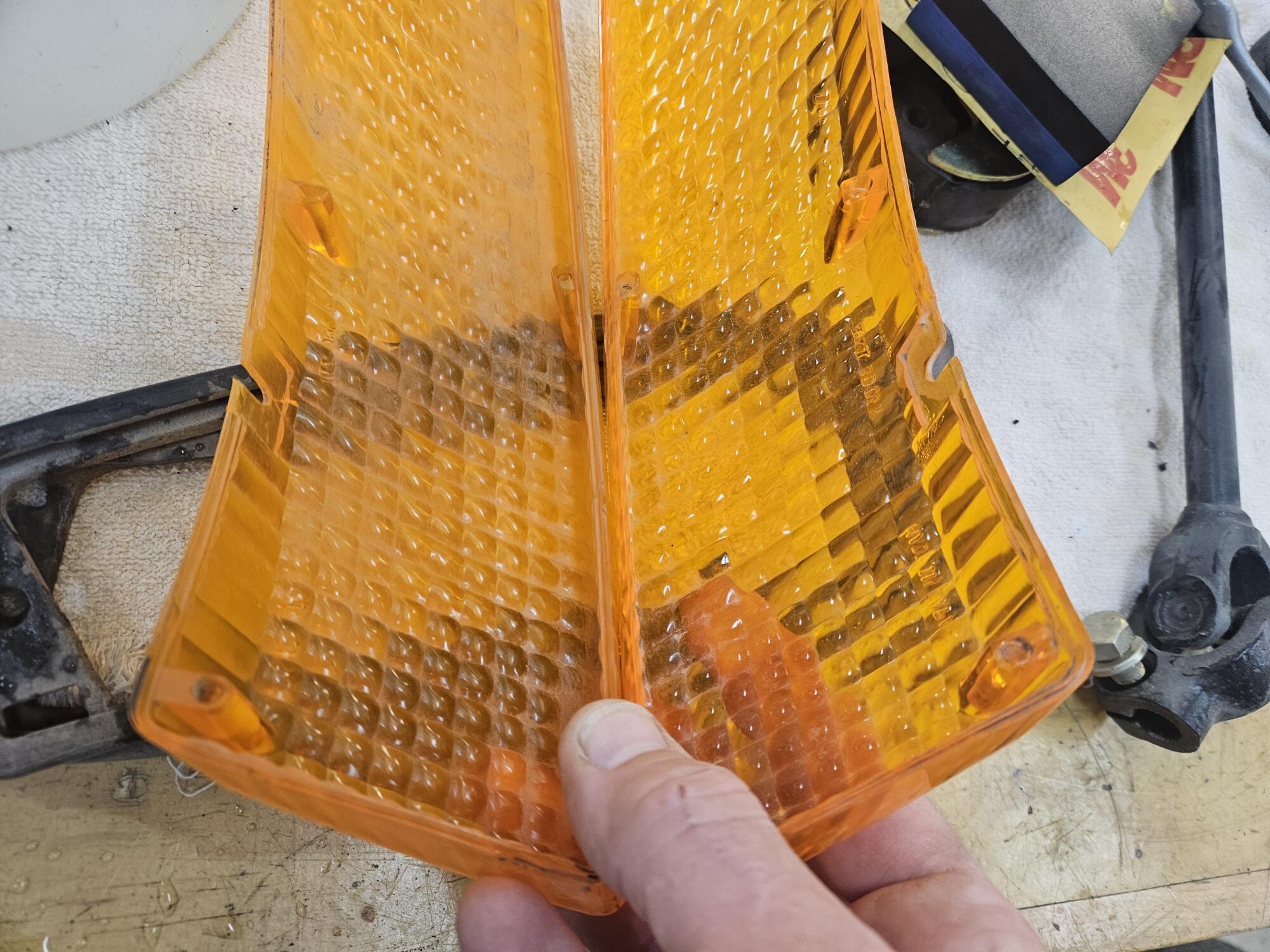

June 30, 2024Jun 30 Author comment_666943 I polished a set of lenses for the front turn signals. I also found a set of front turn gaskets to clean up Link to comment https://www.classiczcars.com/forums/topic/55369-1971-hls30-14938-lily-build/?&page=85#findComment-666943 Share on other sites More sharing options...

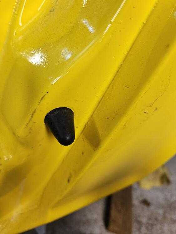

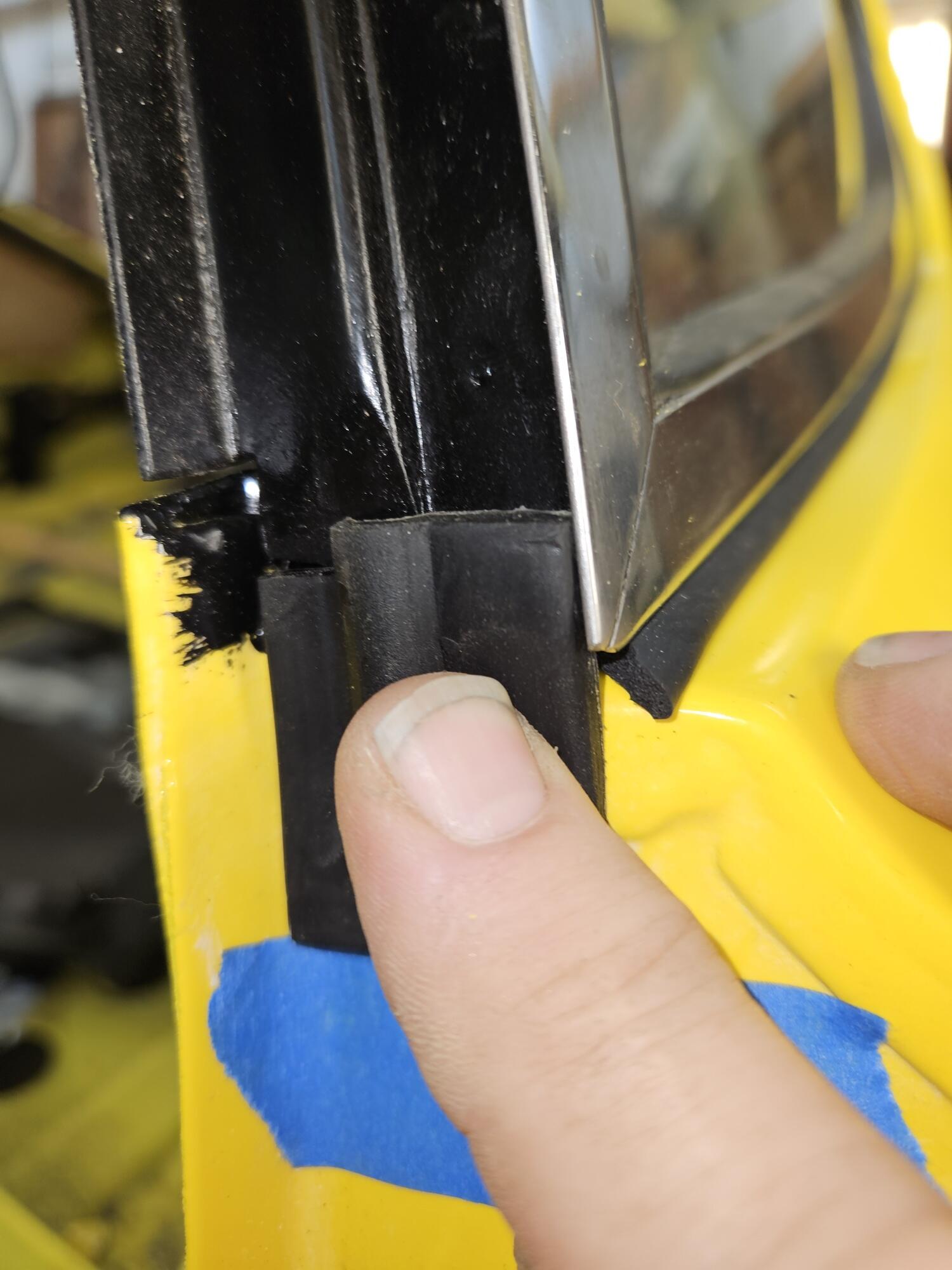

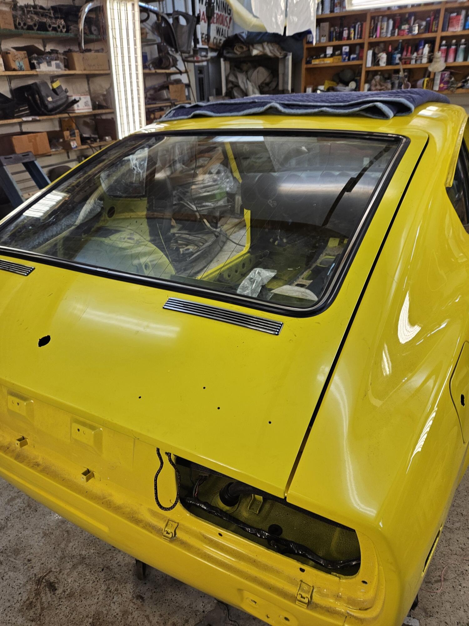

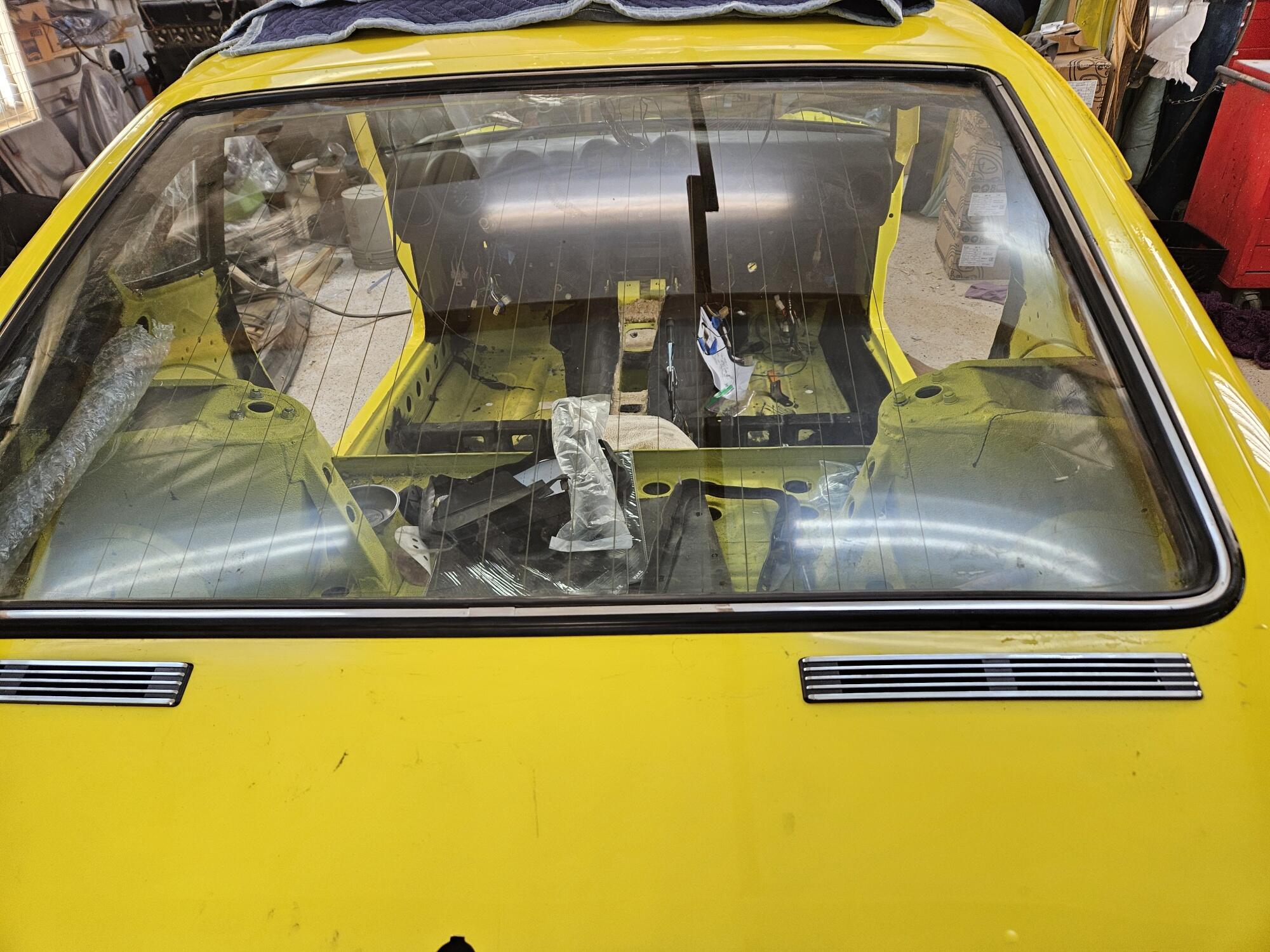

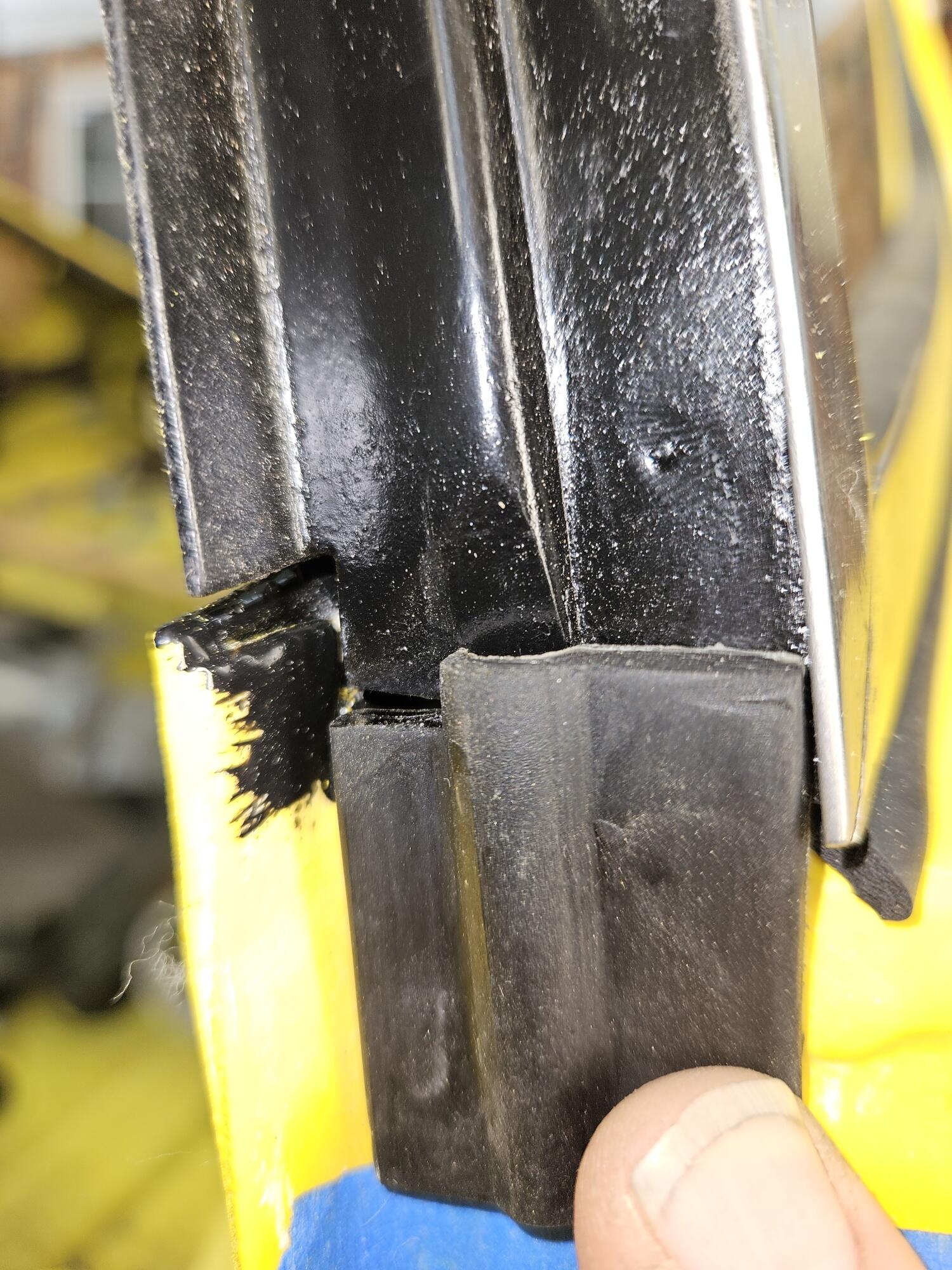

June 30, 2024Jun 30 Author comment_666944 Even though I may take the quarter glass out sometime in the future, I went ahead and put the lower seals on. I lined the notch up pretty close to the inner lower edge of the quarter window I got the hatch glass in. I started but Cody had to help me get it the rest of the way in. My hands were cramping bad by the end trying to keep the glass squeezed down so the seal would lip over. Actually it is a little lower in the hatch then I would want. I started the string at the top edge. It might be better to start it at the bottom edge I also got the door bumpers in. I trimmed the excess paint out of the holes first and then I put them in. Soapy water on the first one and a small flat blade screwdriver. I used silicone grease on the second one and that seemed easier overall. Link to comment https://www.classiczcars.com/forums/topic/55369-1971-hls30-14938-lily-build/?&page=85#findComment-666944 Share on other sites More sharing options...

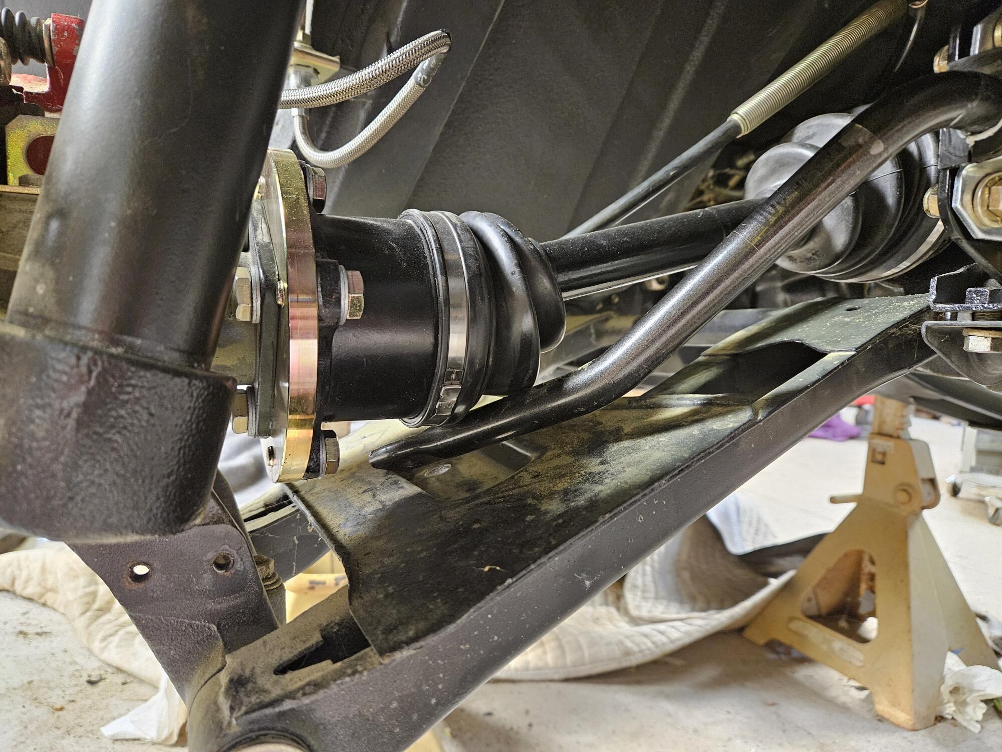

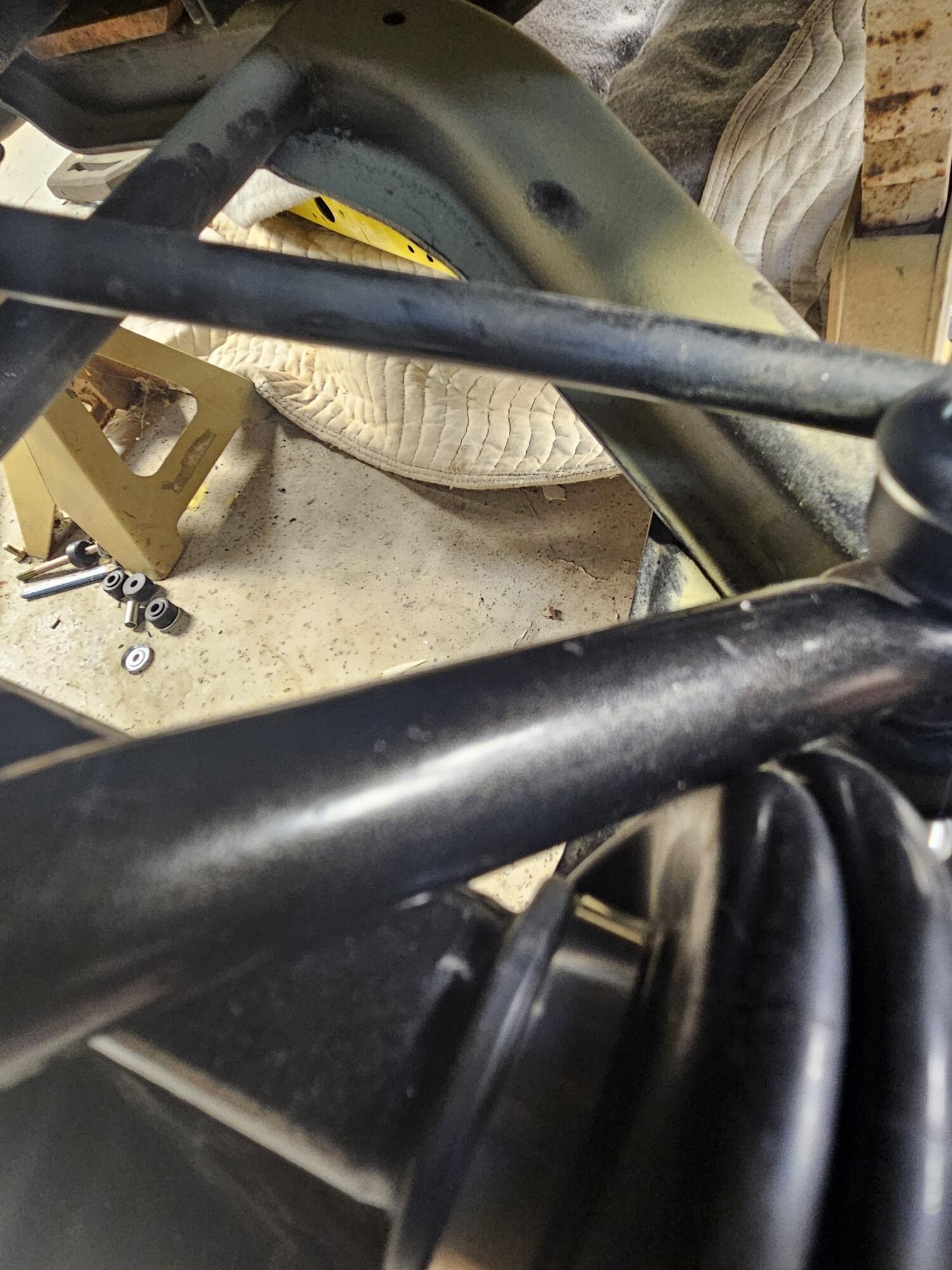

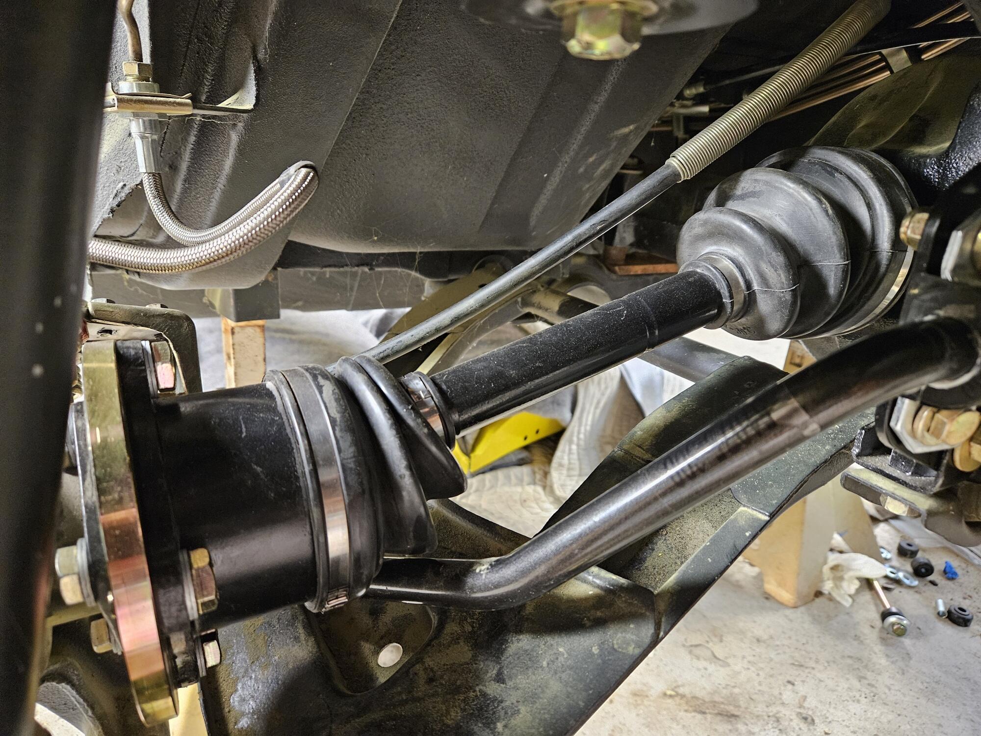

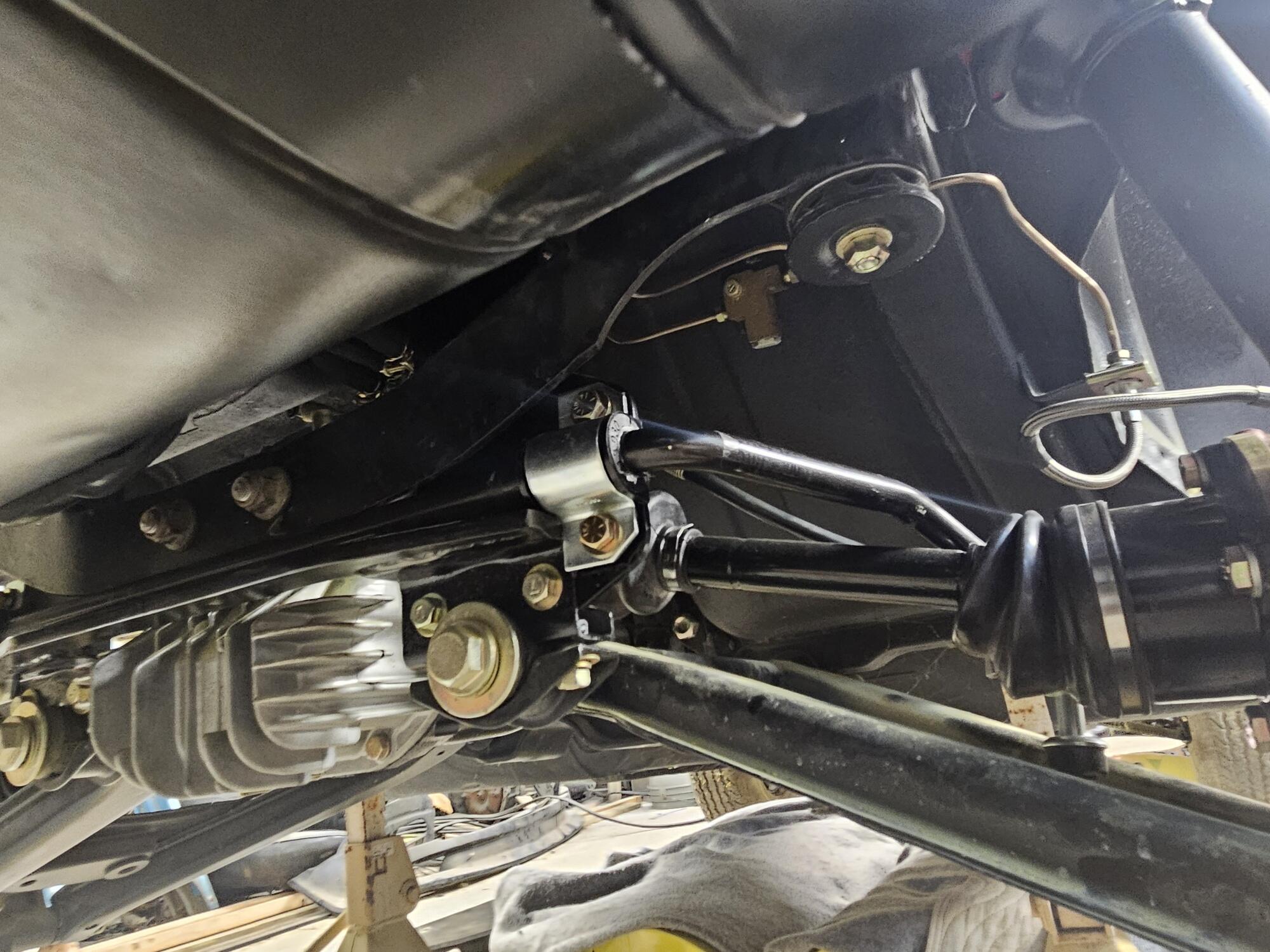

June 30, 2024Jun 30 Author comment_666945 Working on sorting the ST sway bar end links. I thought I would put the bars underneath the axles but that won't work. Going over the top will require longer links Over The links will have to be about 2 inches longer. The hardware is SAE but I might try to convert it all to metric Link to comment https://www.classiczcars.com/forums/topic/55369-1971-hls30-14938-lily-build/?&page=85#findComment-666945 Share on other sites More sharing options...
June 30, 2024Jun 30 comment_666946 I think the metal (on the trans tunnel) is dimpled and marked to cut out the area for a manual. Peel back the insulation and look closely. That trim ring looks right and its held in with phillips sheet metal screws. You are getting there! Link to comment https://www.classiczcars.com/forums/topic/55369-1971-hls30-14938-lily-build/?&page=85#findComment-666946 Share on other sites More sharing options...
