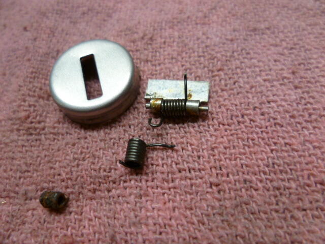

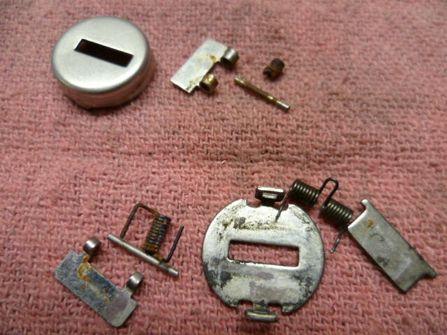

July 12, 2024Jul 12 comment_667318 And about the spring... My spring was a little rusty nugget. Pretty much nothing left. I got a couple locks from junkers and adapted one of them to fit my lock. Unfortunately, I don't remember what the donor car was, which makes the suggestion mostly useless. But, here's a pic. My rusty nugget of what's left of my original spring is at the top, and two donor springs in the foreground: I ended up cutting the "double" spring into two pieces and using half of that one. Again, my original nugget in the lower left: Link to comment https://www.classiczcars.com/forums/topic/55369-1971-hls30-14938-lily-build/?&page=89#findComment-667318 Share on other sites More sharing options...

July 12, 2024Jul 12 comment_667349 11 hours ago, Patcon said: What's the possibility I could make these in a reasonable amount of time?? Fabricating coil springs is pretty easy. Find a drill bit of the appropriate diameter and use that as your former. Chuck it in your bench vise -- horizontally or vertically, whichever makes the wire-winding process easiest. You can use ordinary, hardware-store wire for the job (stainless steel preferably). Wrap the required number of coils around your former. Make sure you leave enough extra at the starting end to be able to form the bent-over tang afterwards. There's a bit of trial and error involved in finding the right drill bit diameter so that you end up with the desired coil diameter after you complete the wrap. It may help to temper the wire after you've got it fully formed -- but I suspect that it won't be necessary for the lock springs. As an example, the spring that I fabbed for the lid of my 70 Z's ashtray didn't need tempering. Link to comment https://www.classiczcars.com/forums/topic/55369-1971-hls30-14938-lily-build/?&page=89#findComment-667349 Share on other sites More sharing options...

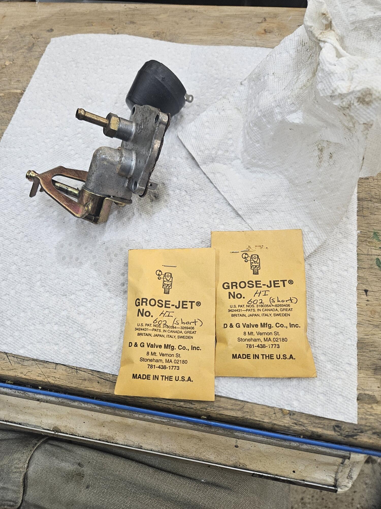

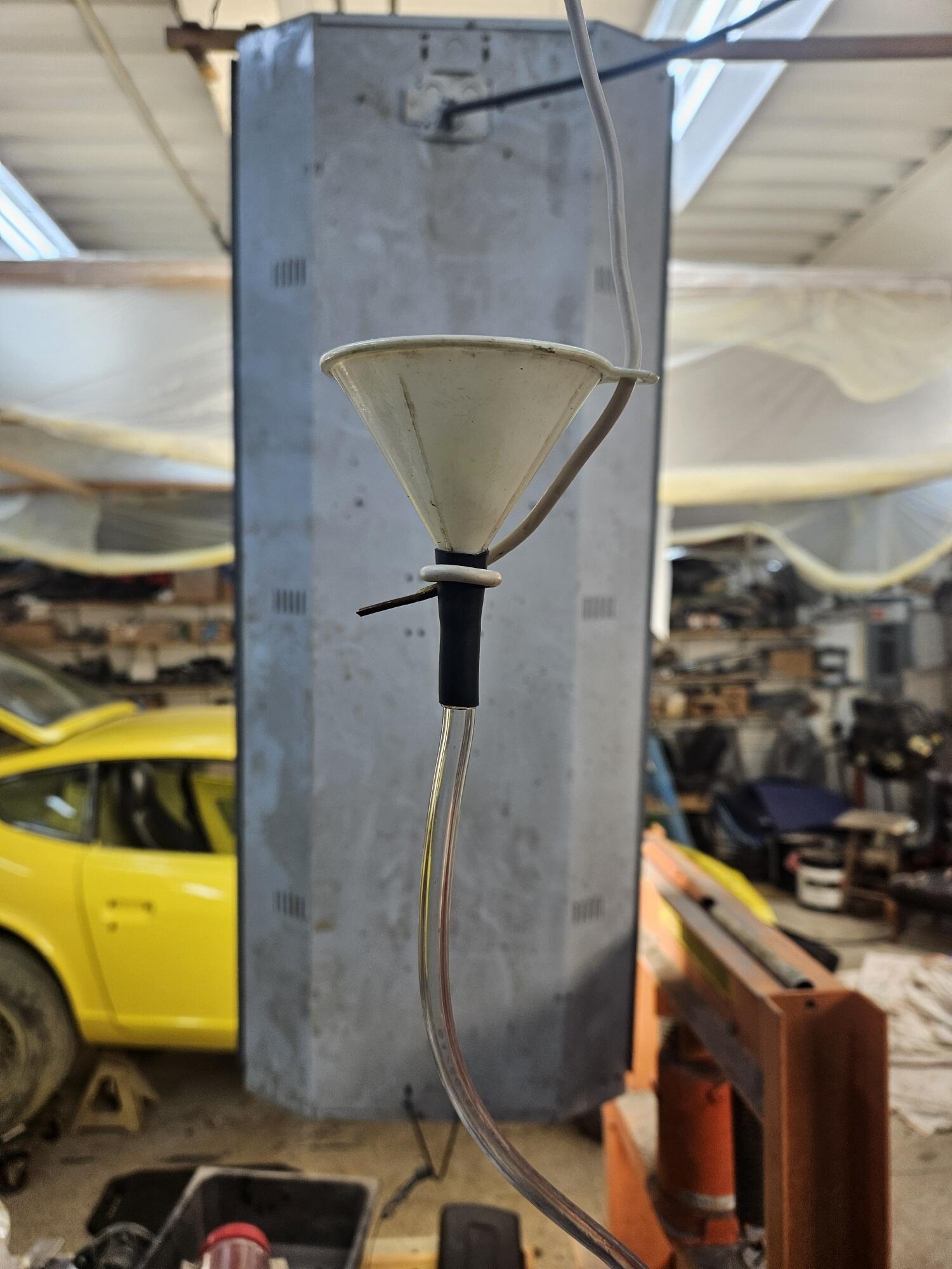

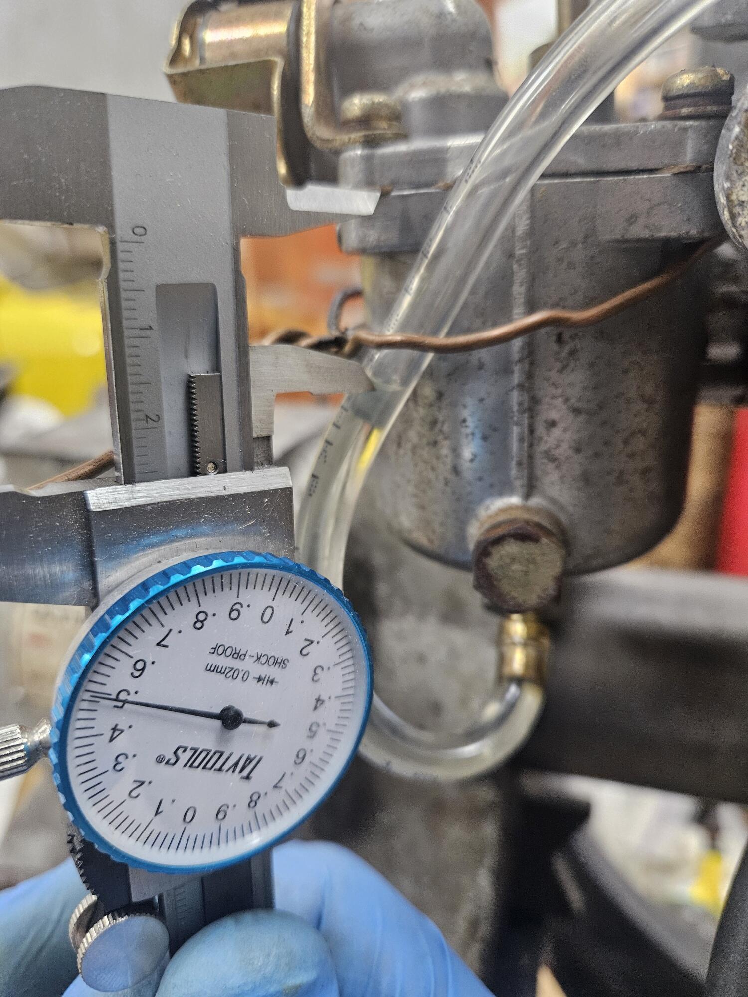

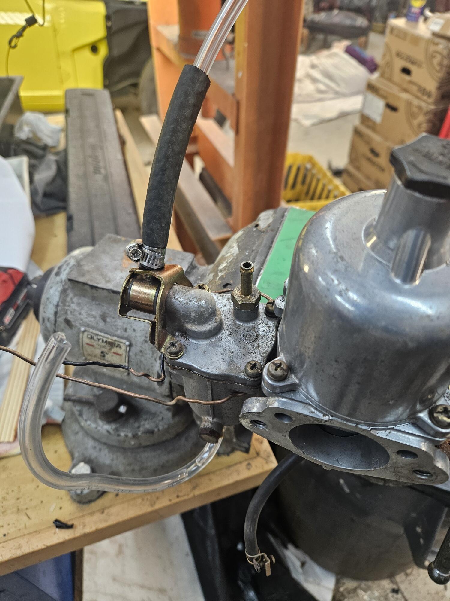

July 13, 2024Jul 13 Author comment_667401 Work on float bowls today. I've been procrastinating on this for a couple of days I tried to use an electric pump I have but it overwhelmed the needle valve. So I rigged up this Mounted the carb to the vise. I found out late the esiest way to do this is to chuck a piece of all thread up in the vise and bolt the carb body to the vise using the all thread like an intake manifold stud. Pulled the feed line off the bottom of the bowl and added a short section of clear line turned up by the bowl. Then this funnel I connected to the clear line with some heat shrink I was having problems with the needle valves not sealing well. Turns out I had some new Grose jets on the shelf. Bought them 5 years ago... Both set about 25mm down from the gasket line After testing the clear line can be lowered to drain everything into a container. I used gasoline to try to be accurate Link to comment https://www.classiczcars.com/forums/topic/55369-1971-hls30-14938-lily-build/?&page=89#findComment-667401 Share on other sites More sharing options...
July 14, 2024Jul 14 comment_667408 25 will run, but it's a little low. I believe the float level for those carbs should be 20 mm down from the bottom of the lid. I draw line on the side of the carb body: Link to comment https://www.classiczcars.com/forums/topic/55369-1971-hls30-14938-lily-build/?&page=89#findComment-667408 Share on other sites More sharing options...
July 14, 2024Jul 14 Author comment_667412 I can adjust it if it turns out lean. The big SUs are a pain to do. Cody's are next to impossible to accurately adjust. Will probably go EFI on both of them eventually Link to comment https://www.classiczcars.com/forums/topic/55369-1971-hls30-14938-lily-build/?&page=89#findComment-667412 Share on other sites More sharing options...
July 14, 2024Jul 14 comment_667419 I suspect you're having the same "gas seems to have gotten less dense over the years" kind of level adjustment issue that has affected several owners. Link to comment https://www.classiczcars.com/forums/topic/55369-1971-hls30-14938-lily-build/?&page=89#findComment-667419 Share on other sites More sharing options...
