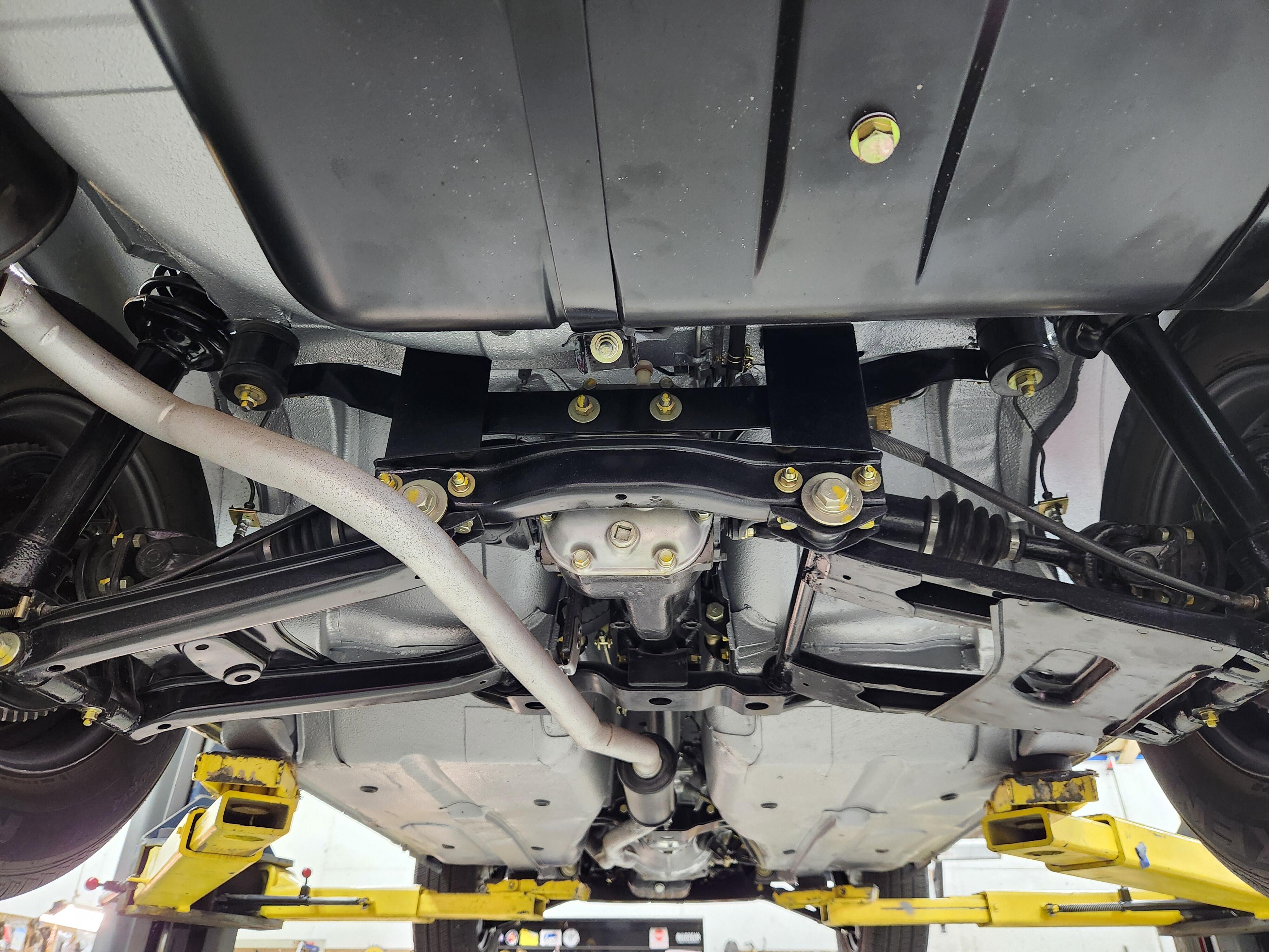

I also bought a new rear diff mount. I suspect these are available straight from Nissan
If your Z is early 71, cause i think so seeing your vin, you originally had the early insulator, those are different, but not obtainable anymore. I made a topic on that once.
The later model was changed, because vibrations the differential was moved a little forward i believe it was

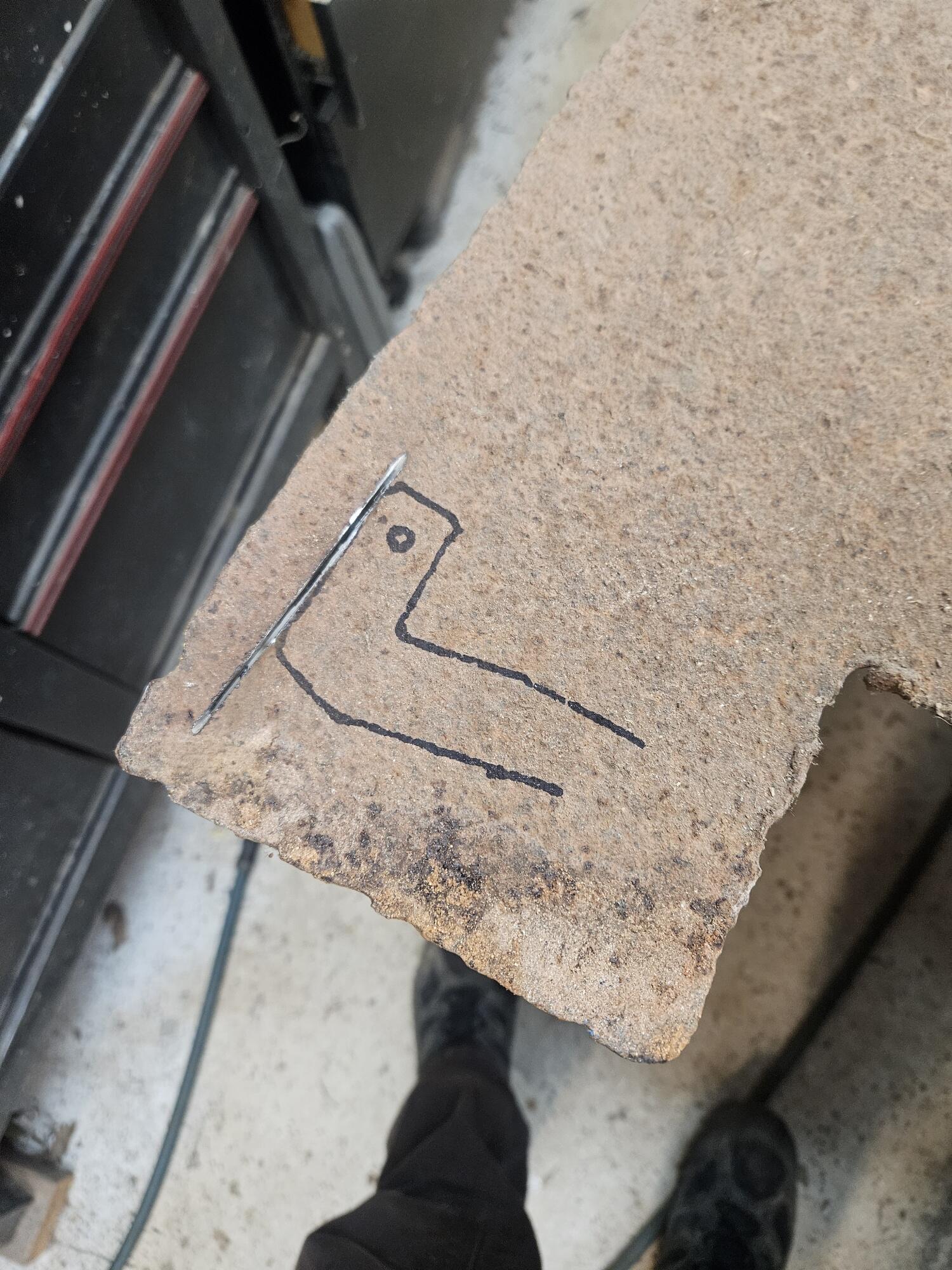

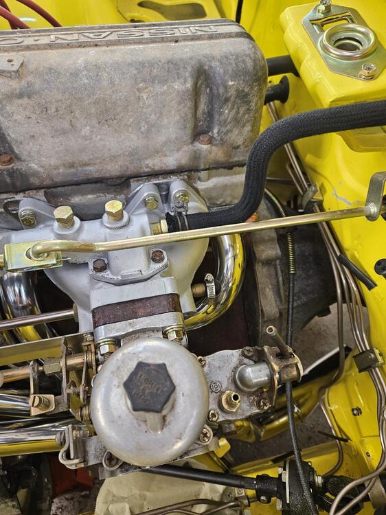

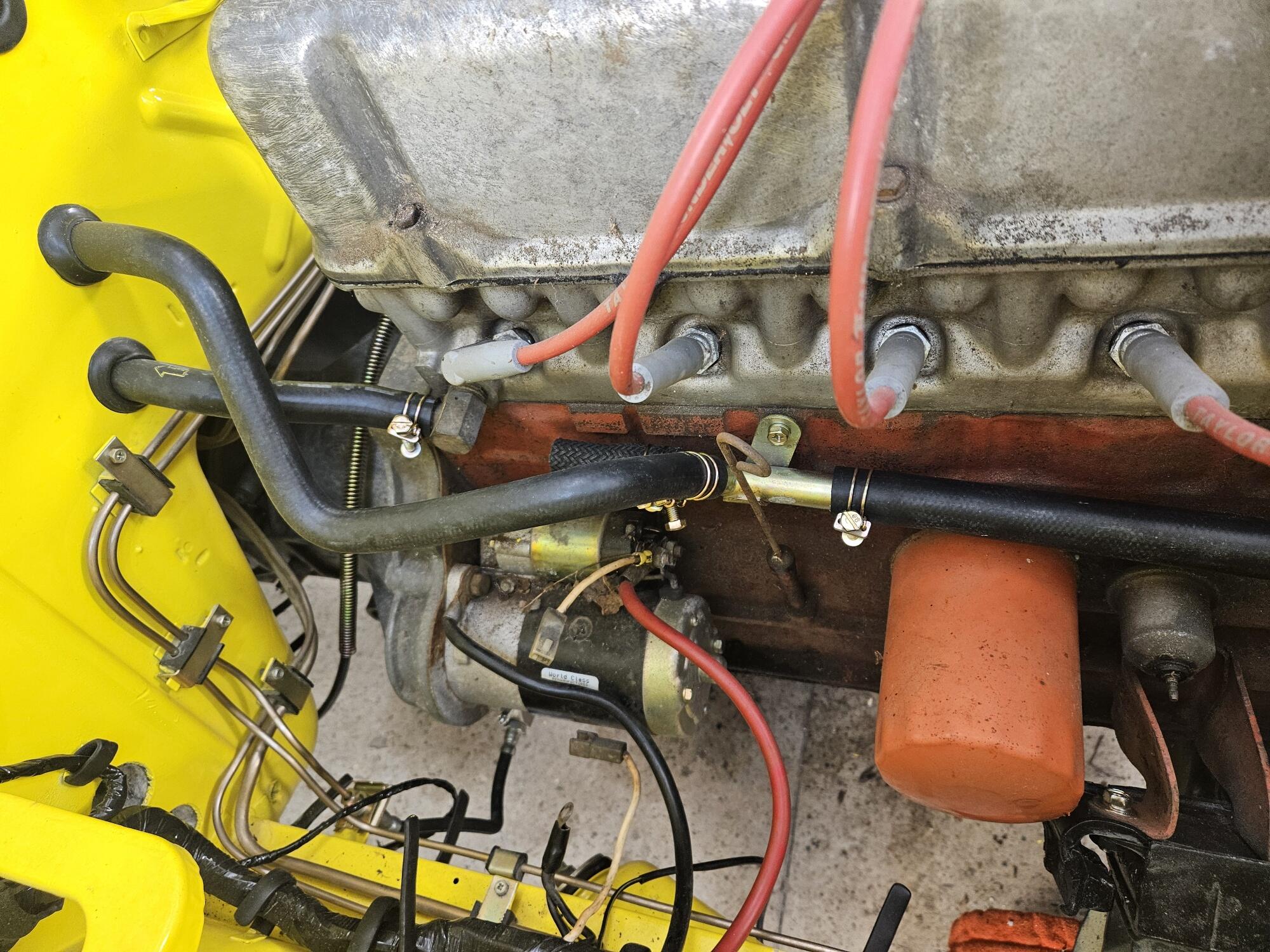

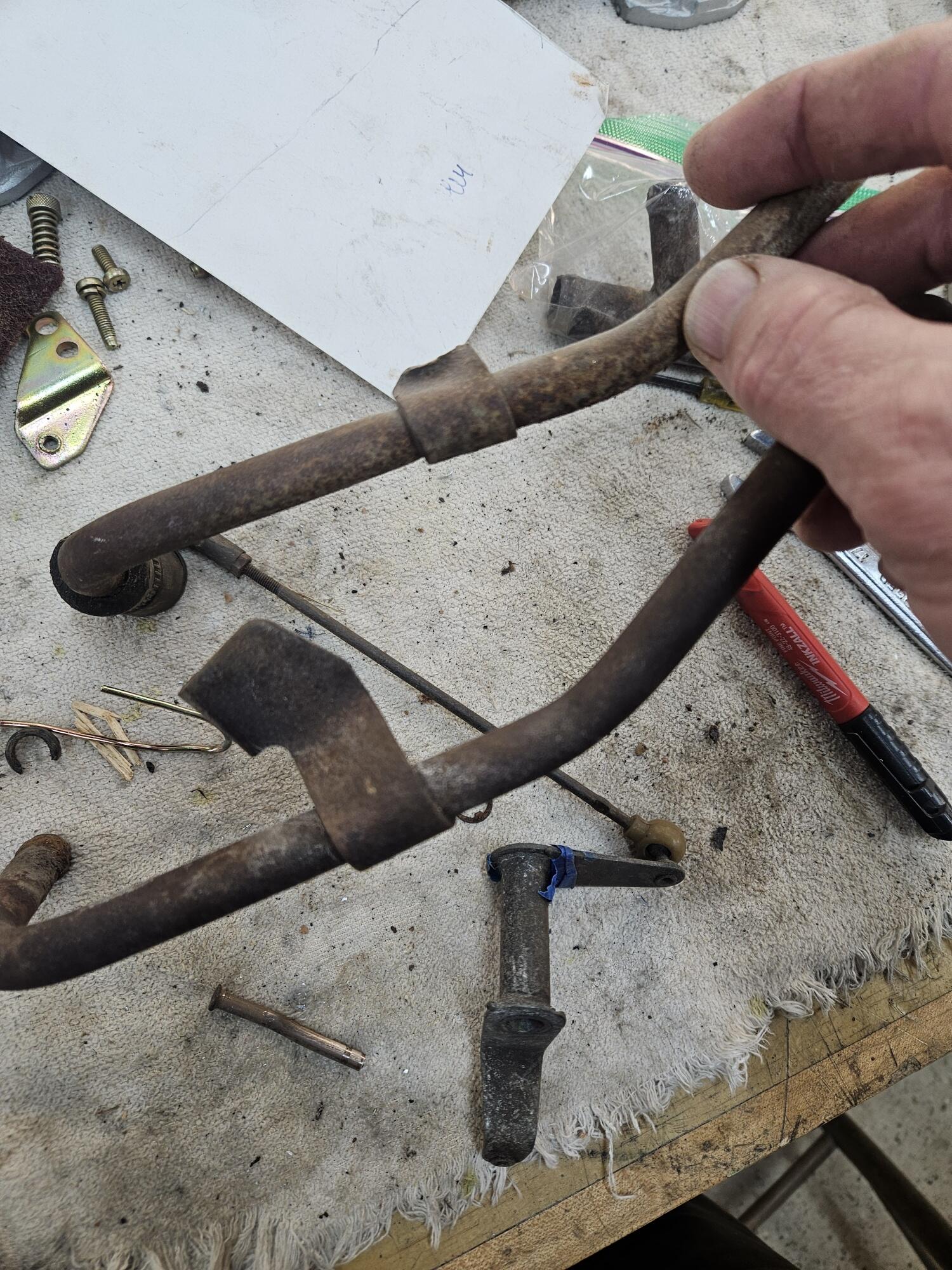

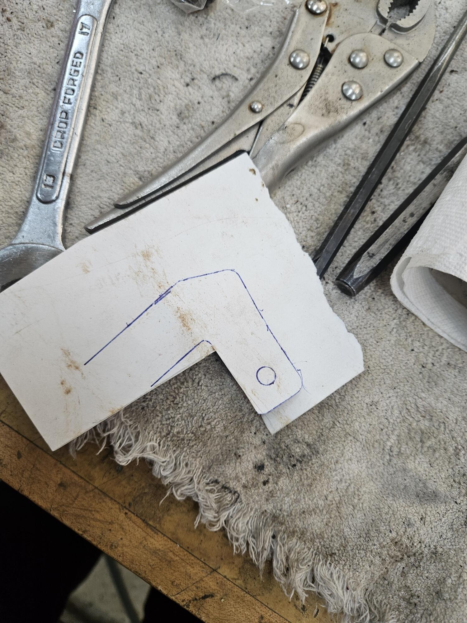

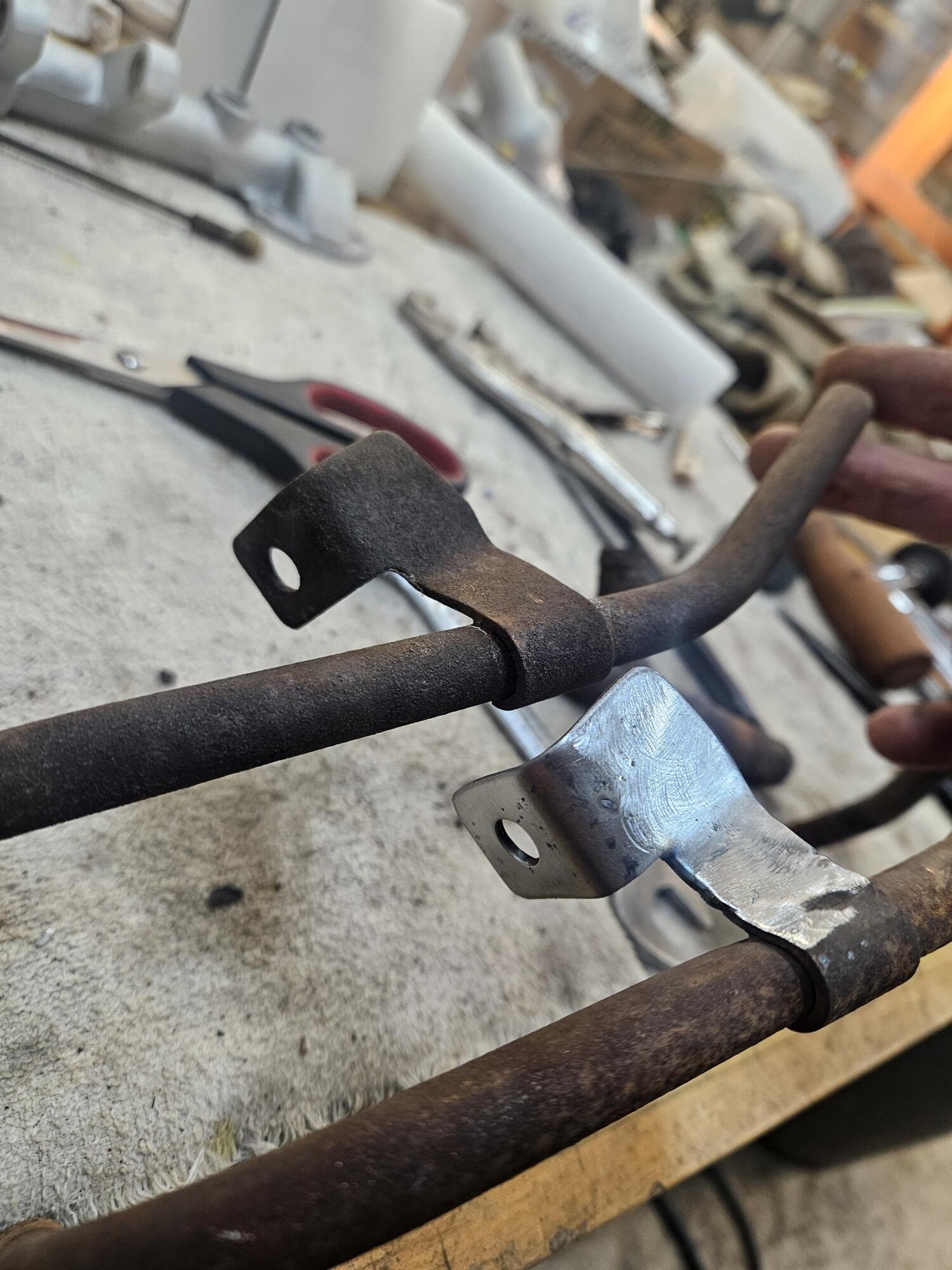

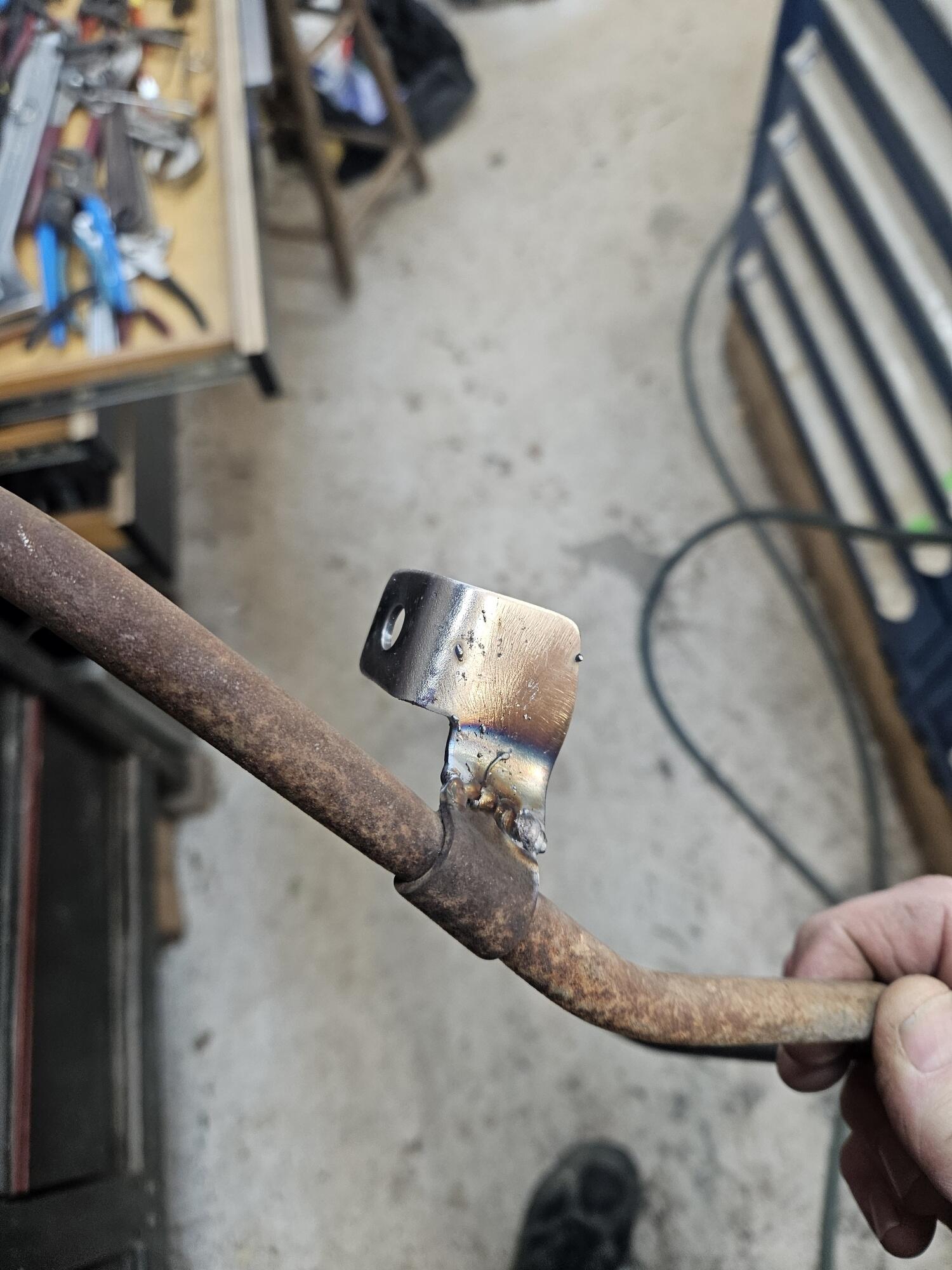

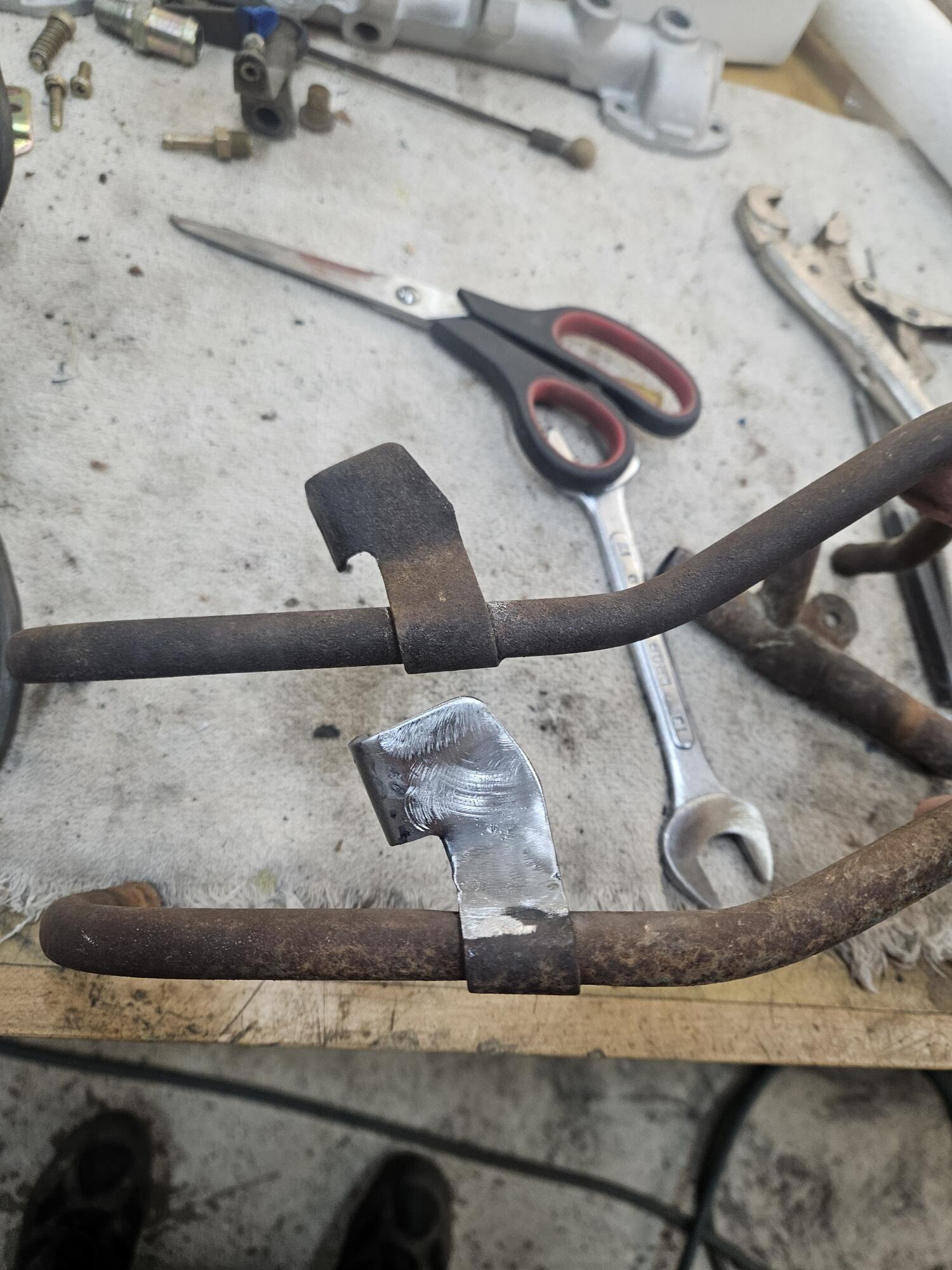

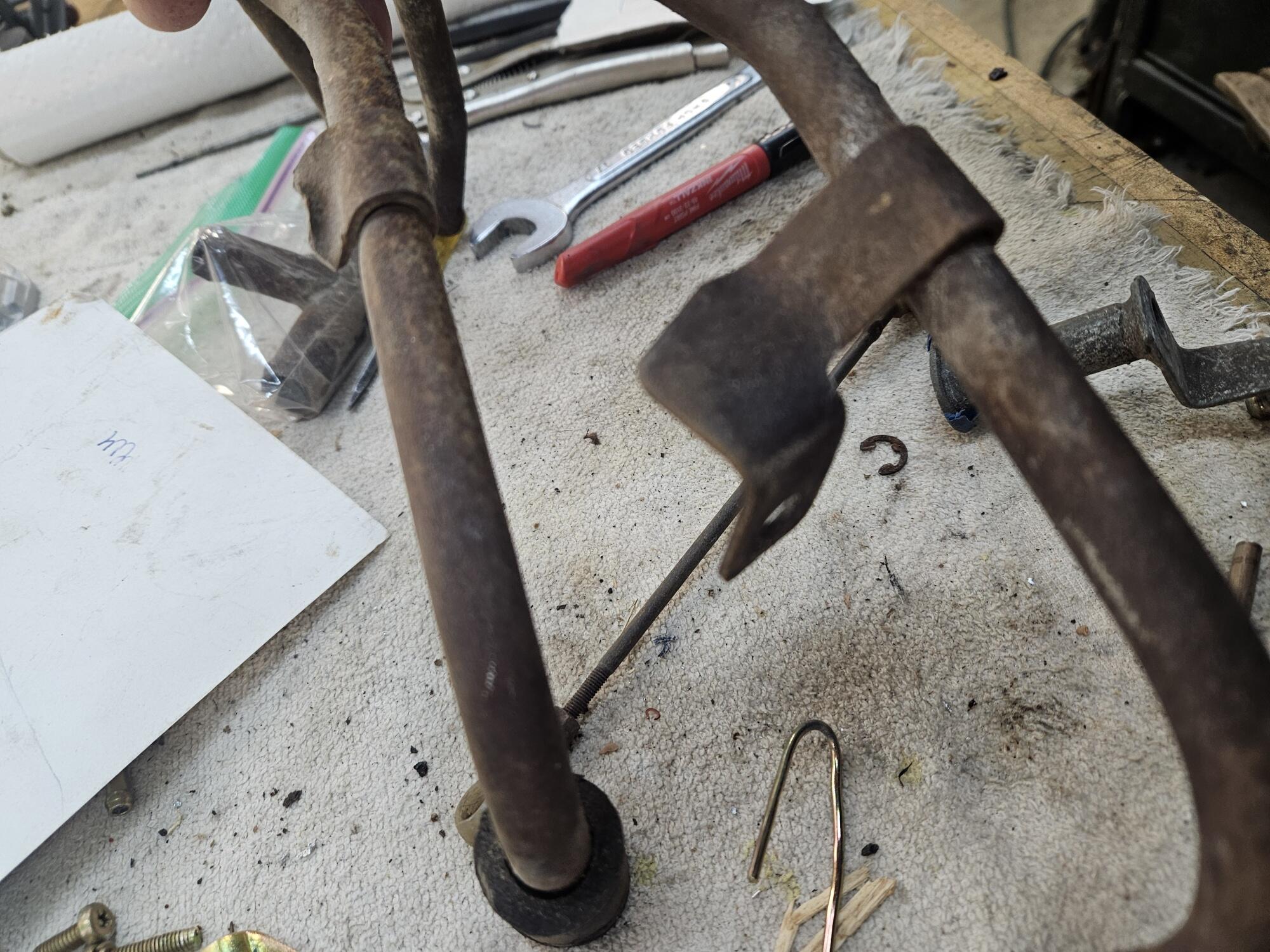

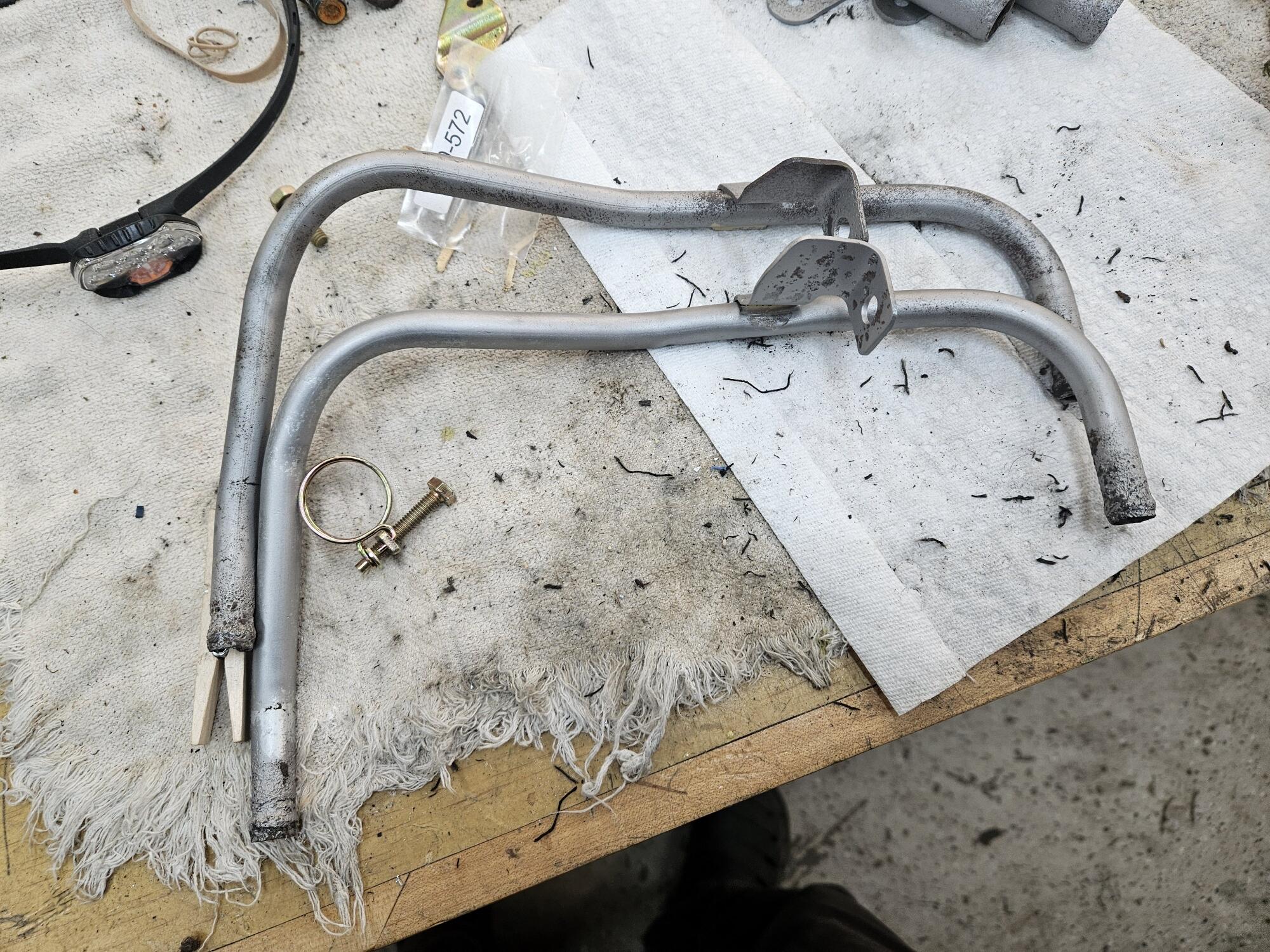

Last weekend I worked on the carb heater tubes. I have one with a decent bracket but it's got a hole in it. I have another that has a damaged bracket. So I worked on fixing the bracket. Made a template and then cut it out and dressed it.
I'm going to try to plate them but I'm not sure I can get a good plate on them. It's a shame there are no reproduction sources available

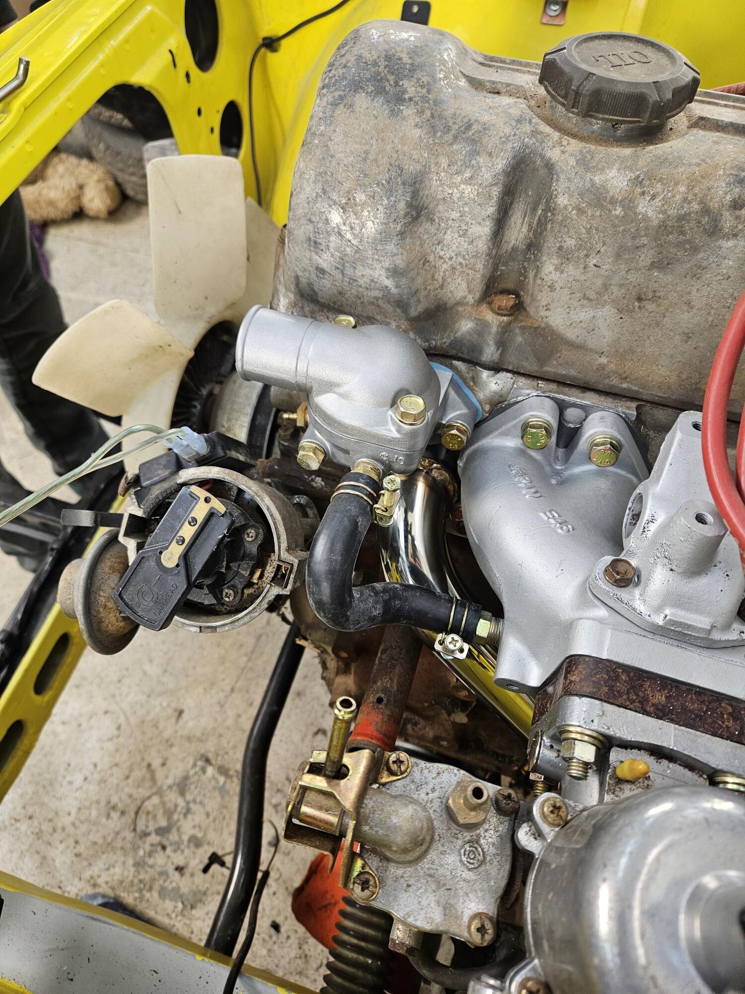

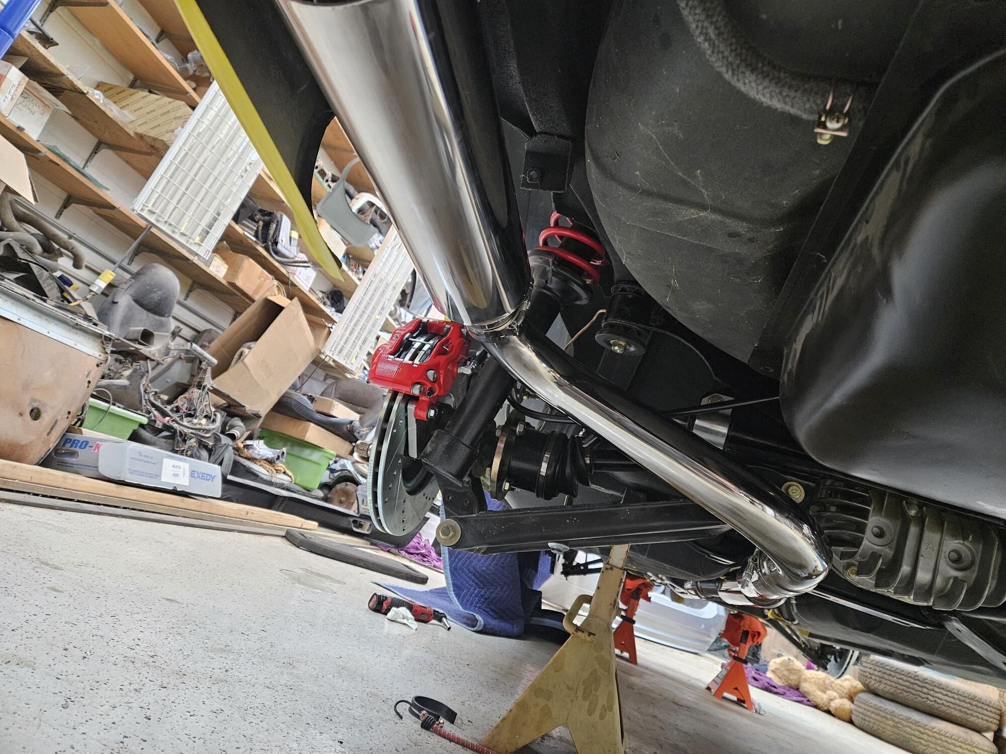

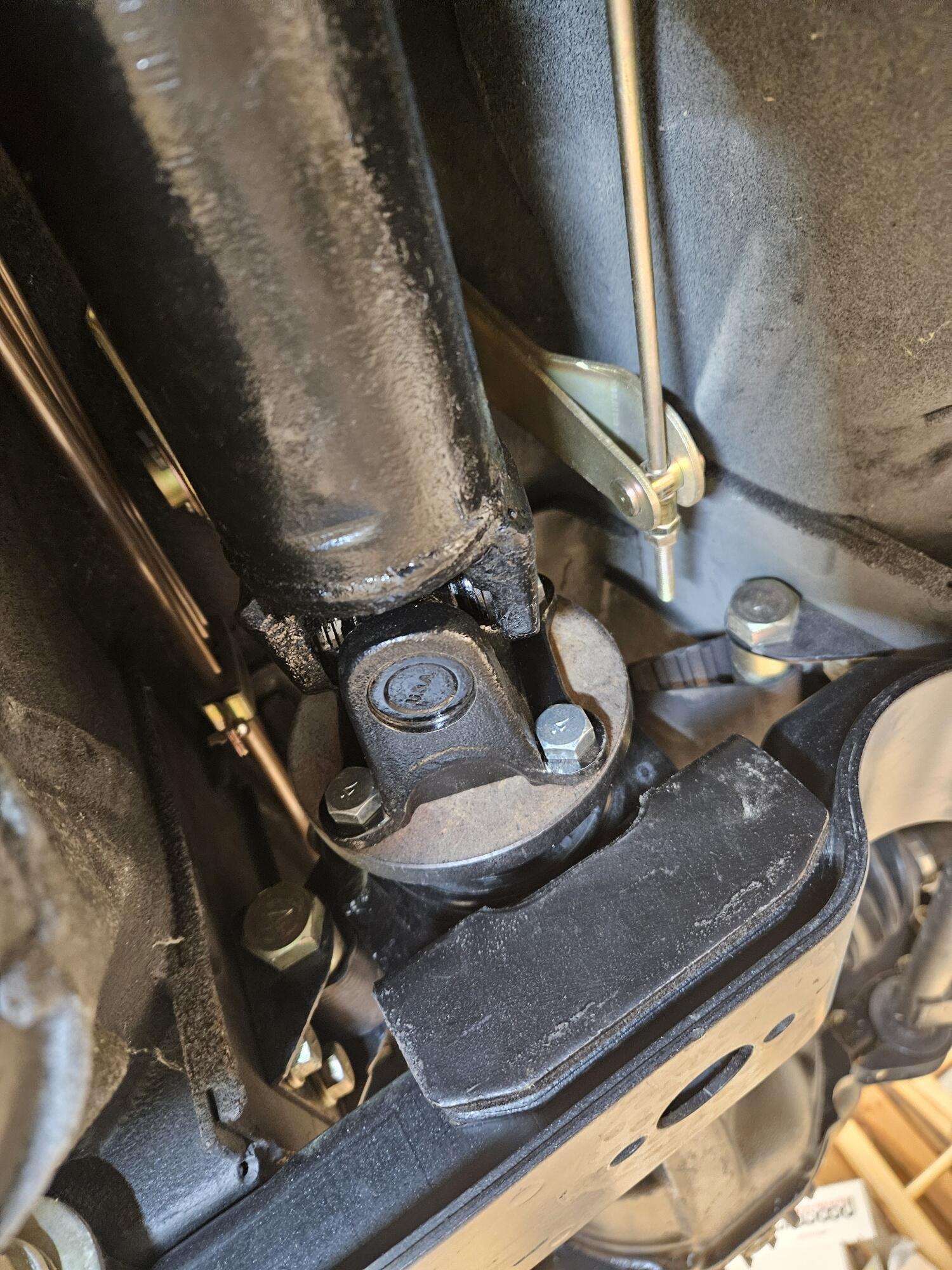

I got the driveshaft in and mated up to the R200 with the Zcardepot flange

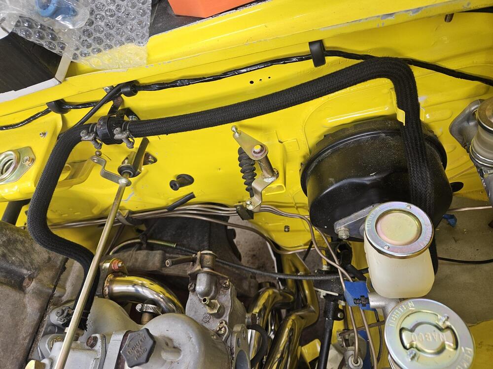

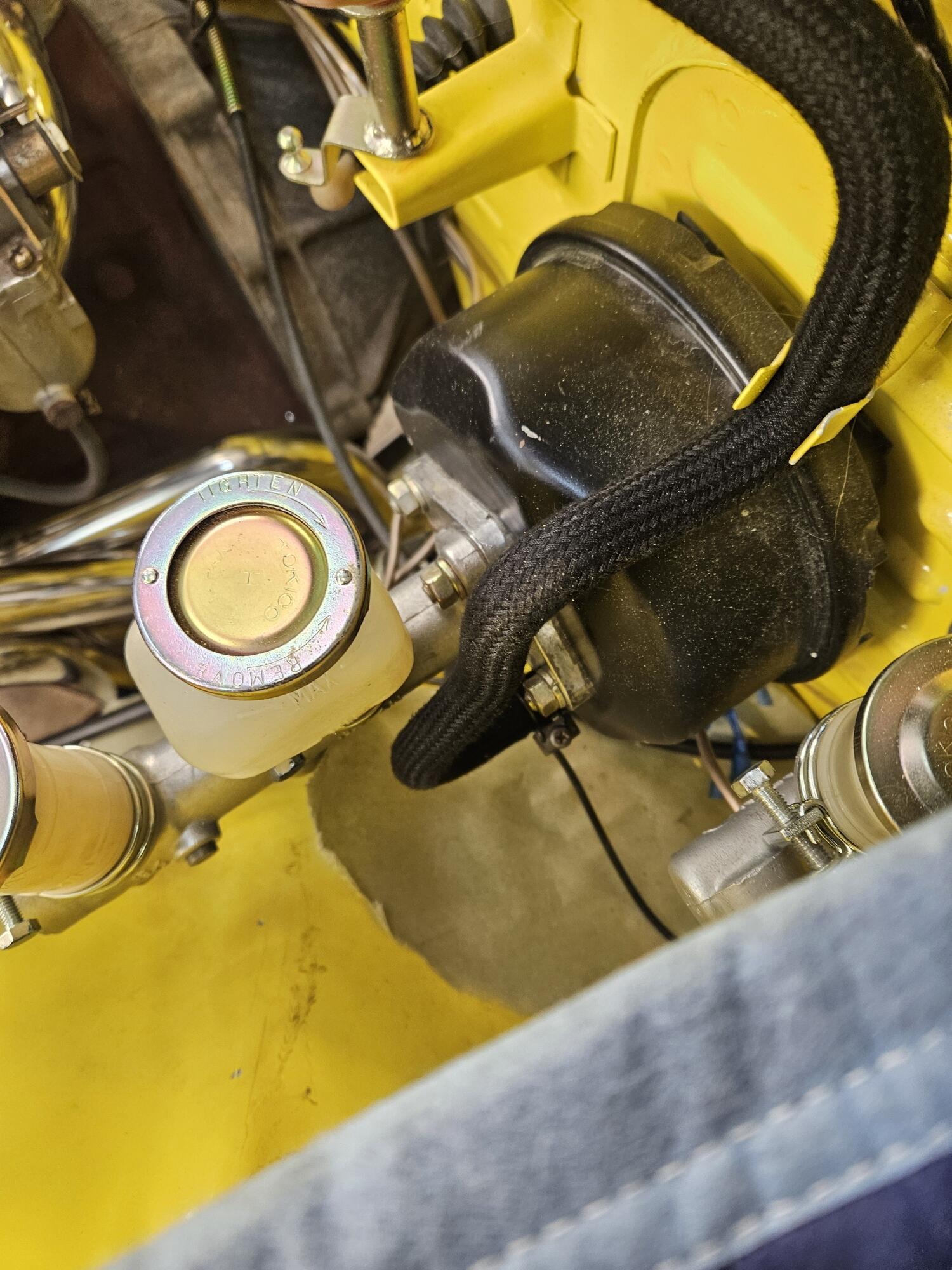

Brake booster lines and check valve installed

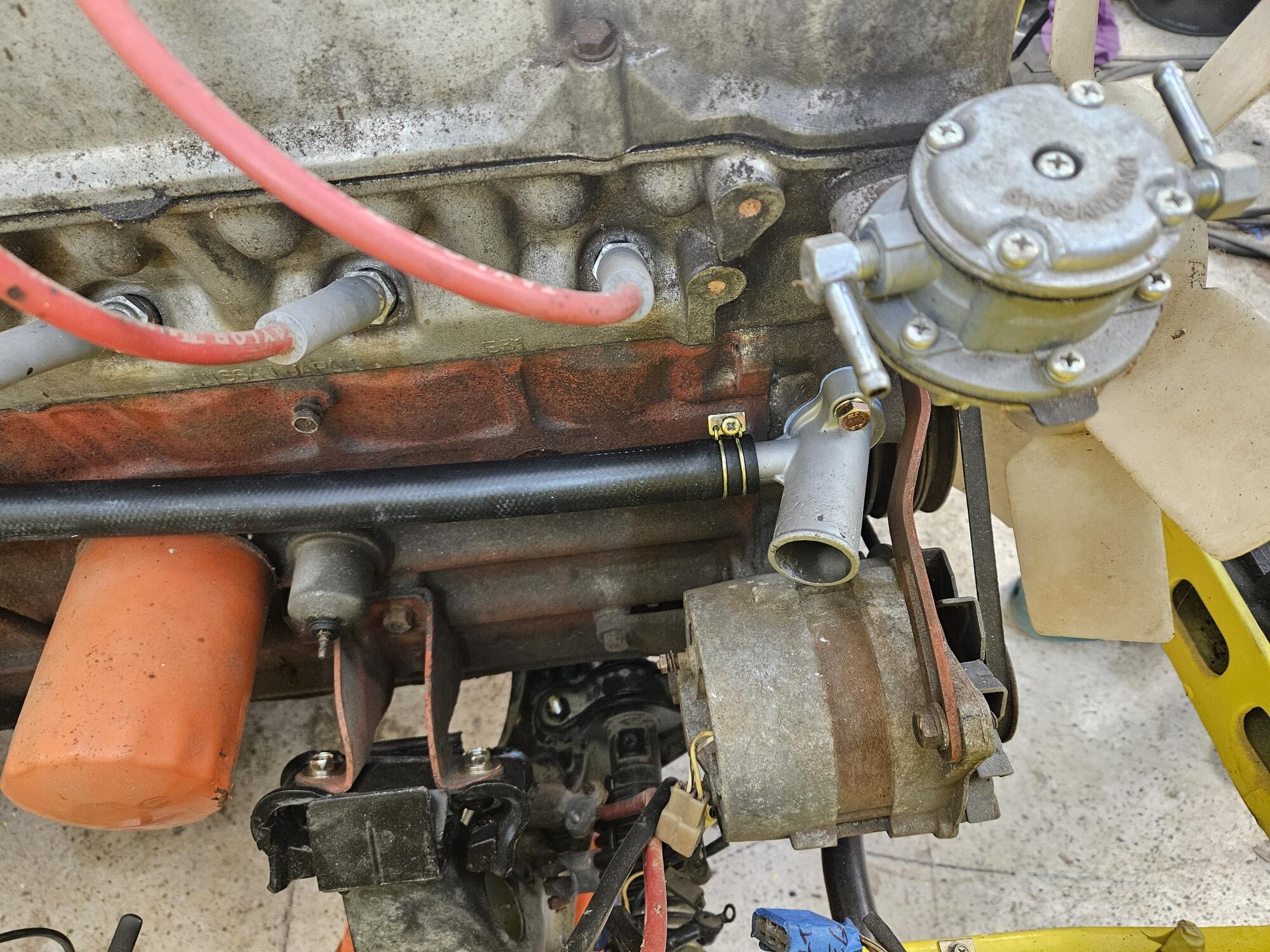

Water necks and thermostat housing installed
Heater hoses hooked up

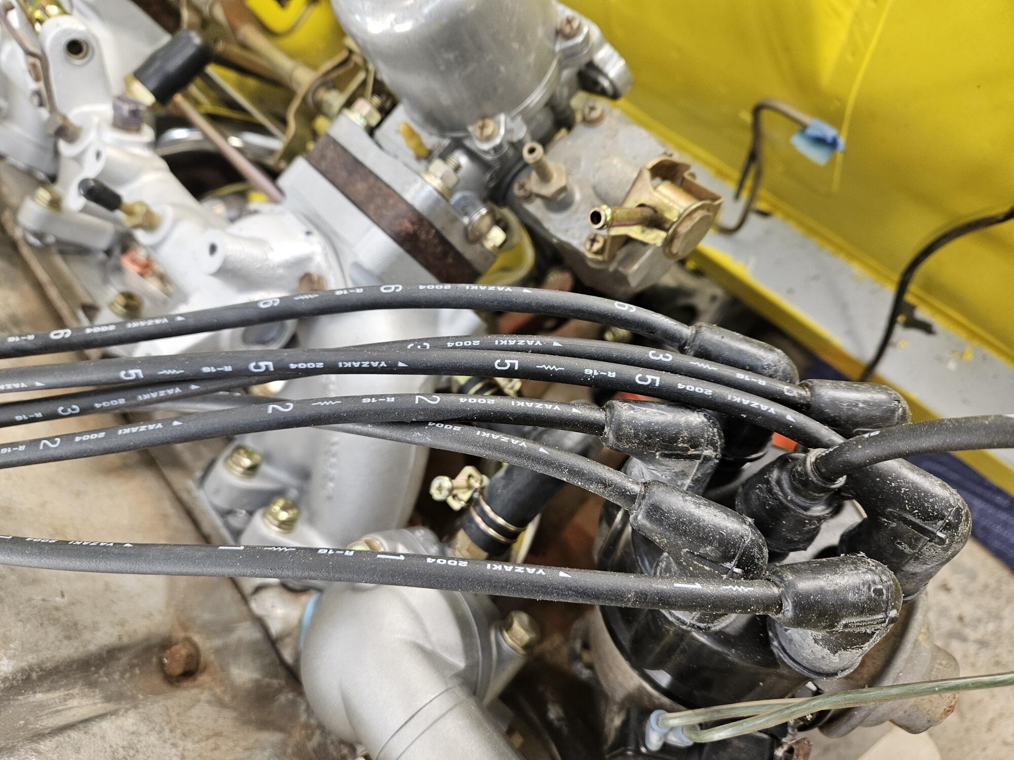

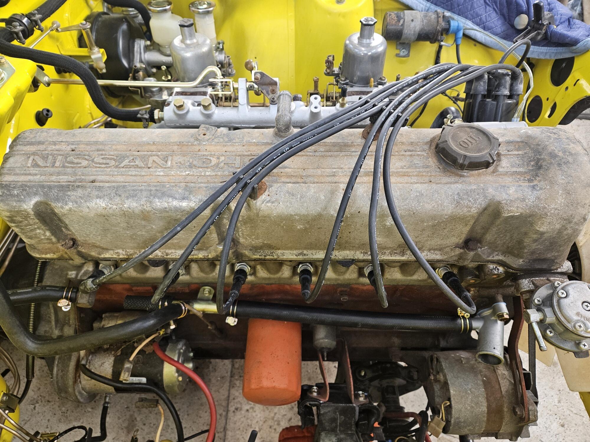

I replaced the red plug wires with a set of factory wires. They are absolutely beautiful!!

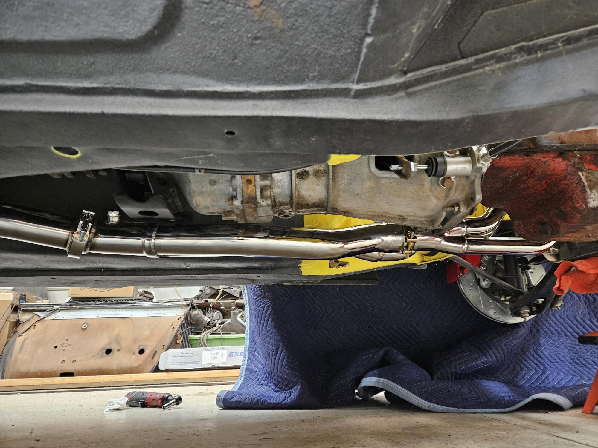

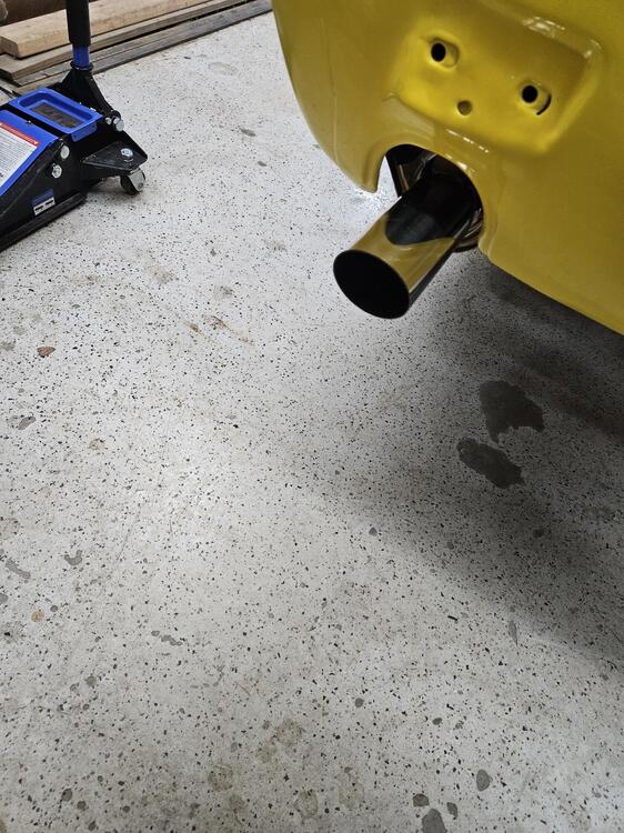

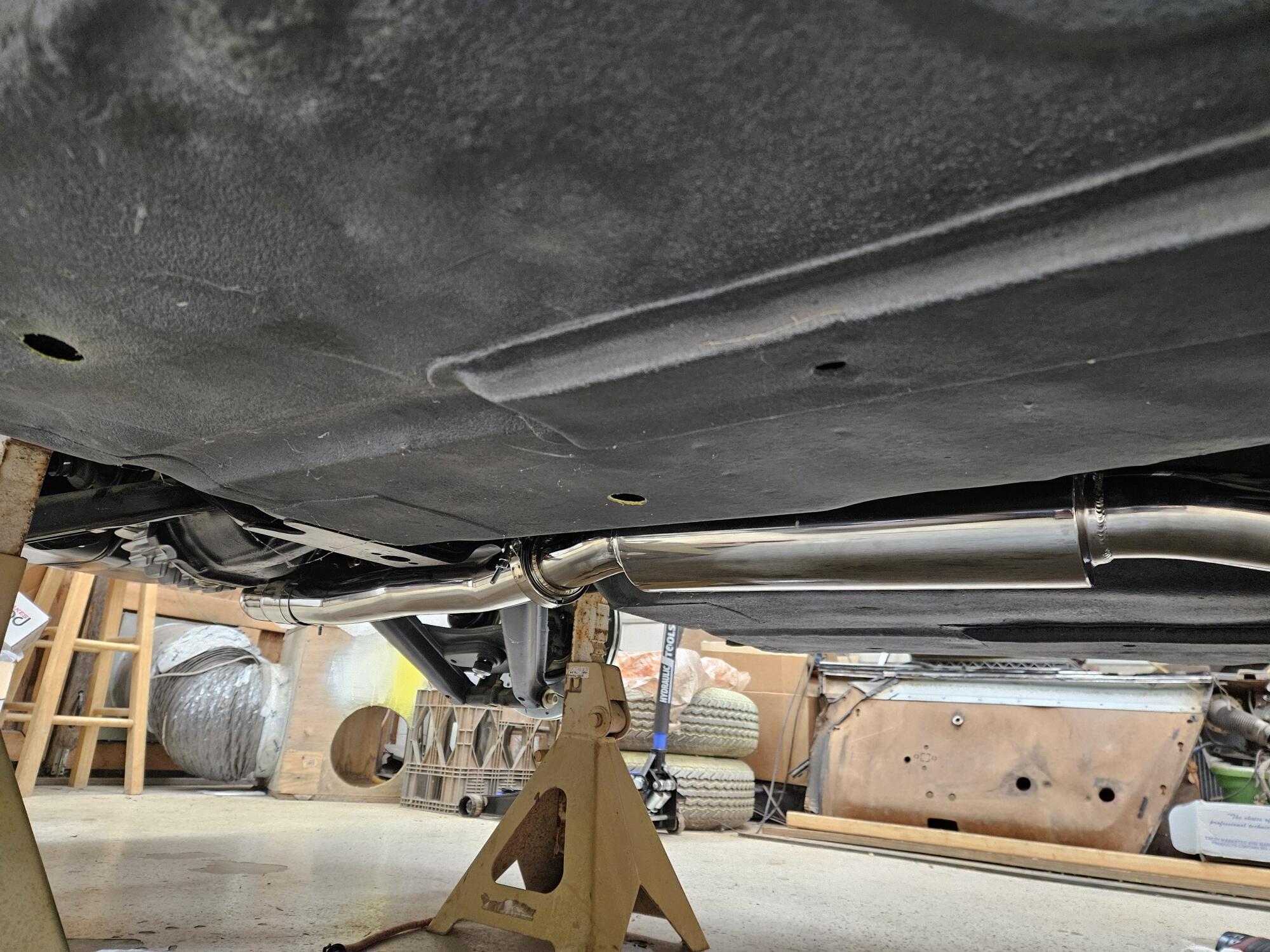

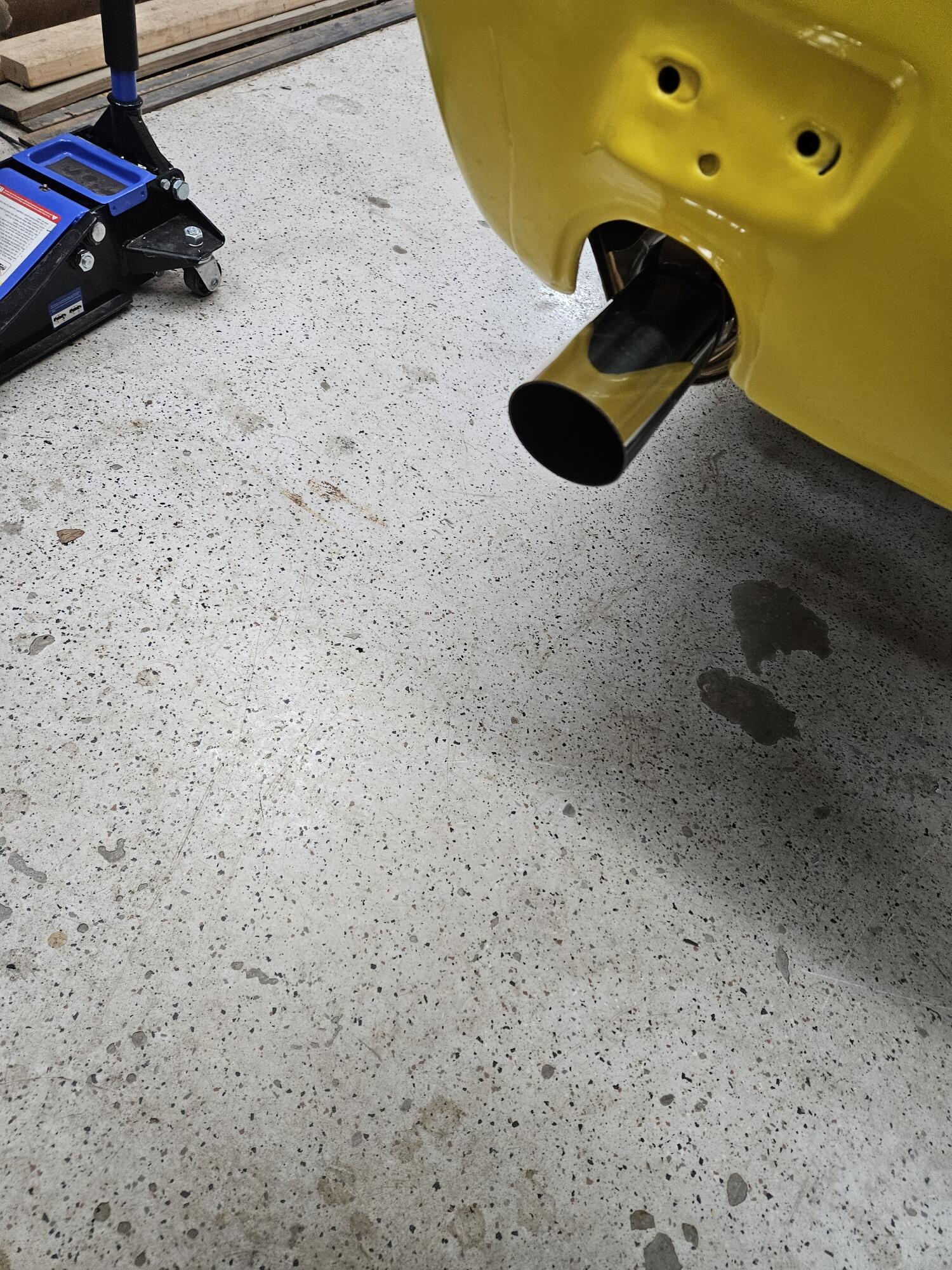

Also got Sean's exhaust hung under the car. It needs a few details to finish

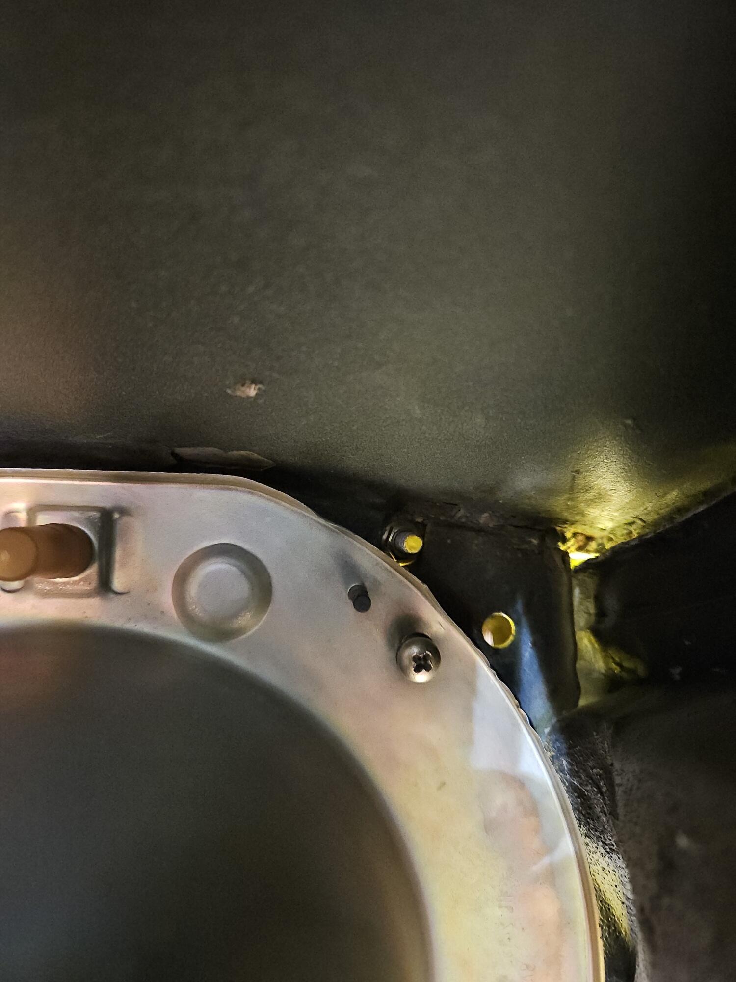

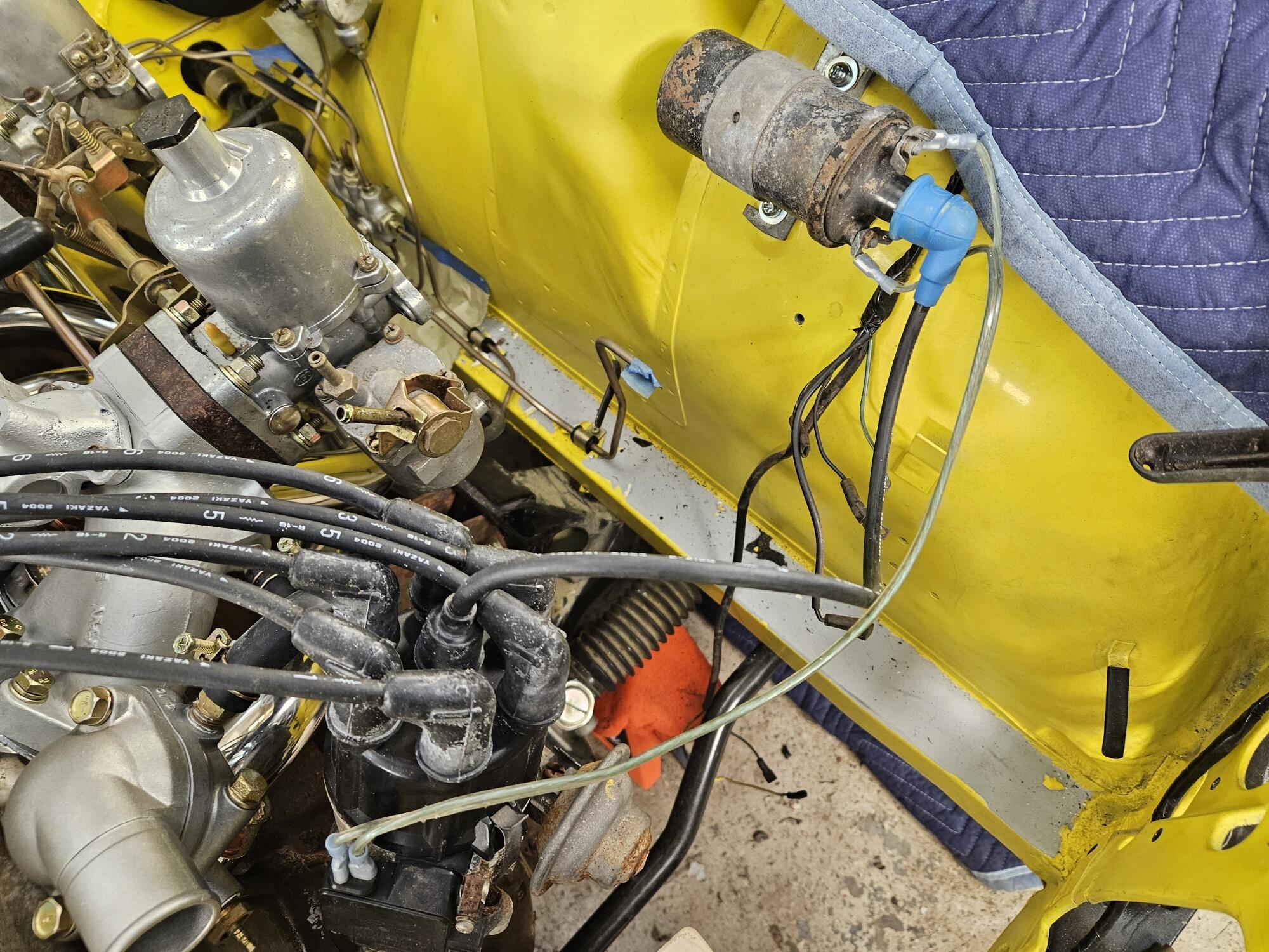

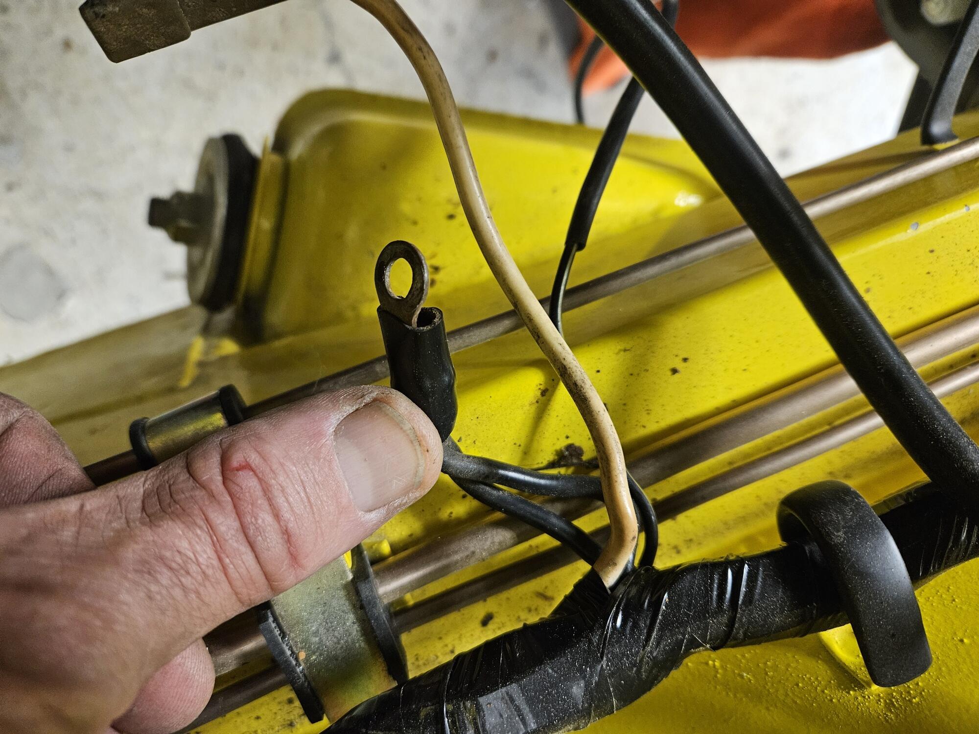

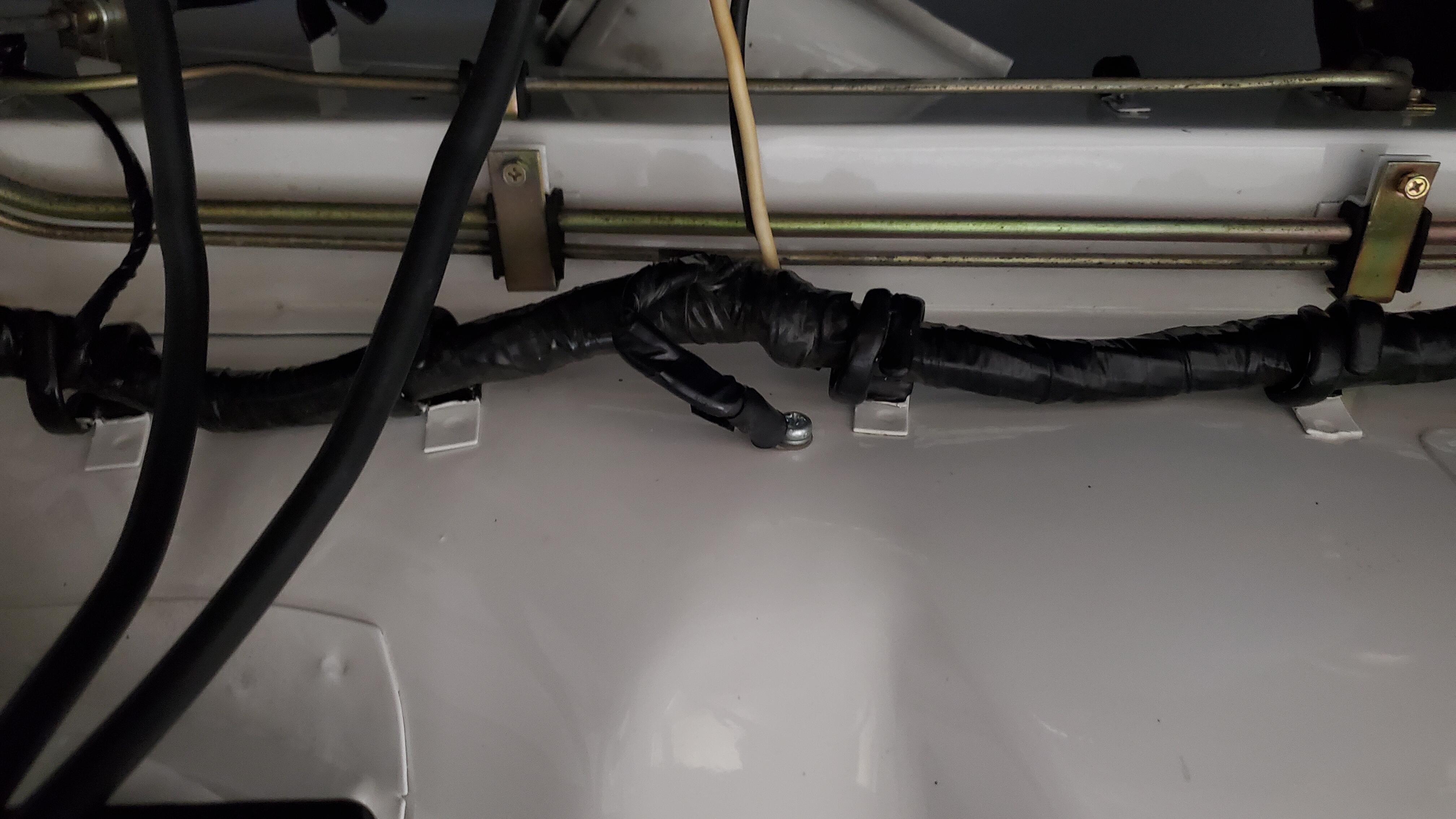

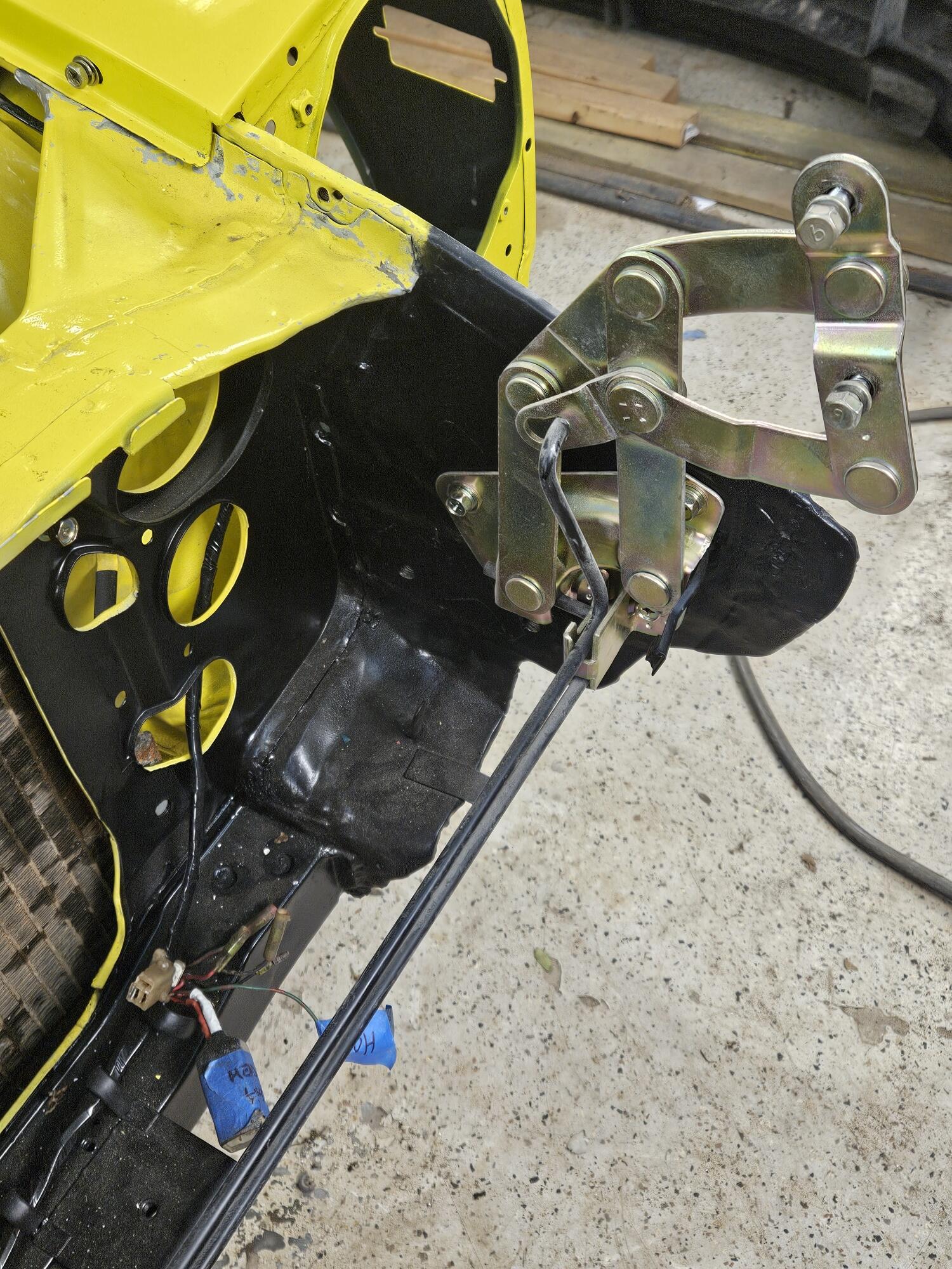

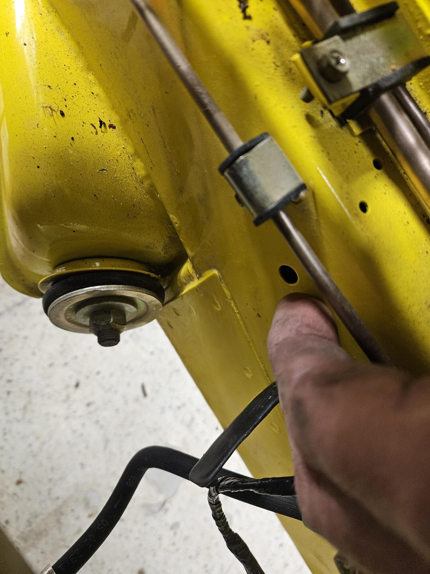

I assume this ground
is supposed to attach to the frame rail here??

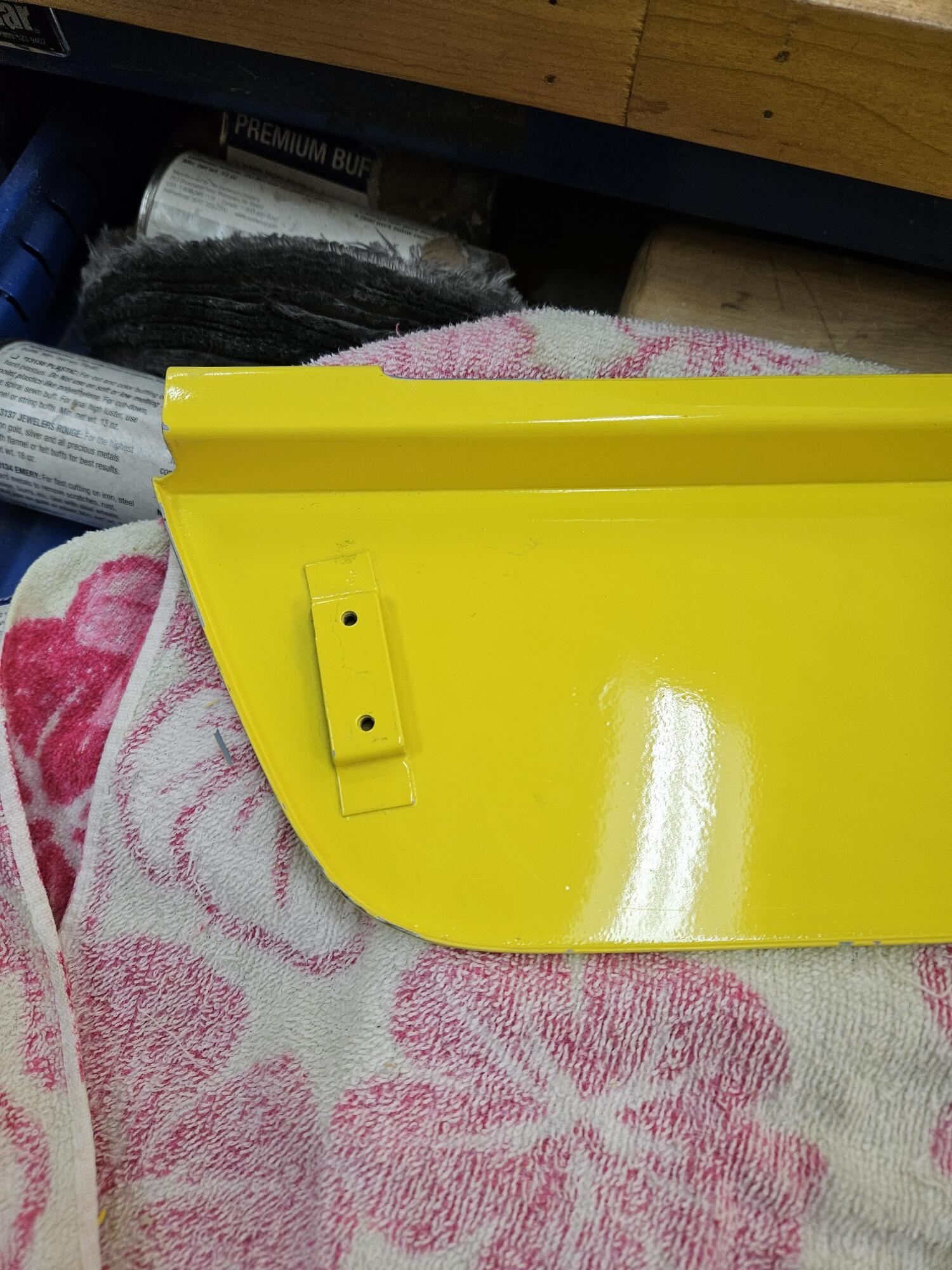

I still have painting the bolts with yellow on my list as well.  And interested to know what others have used.  I noted that the original was gloss, not matte, as in this picture of a fastener for my anti-roll bar bracket:
Perhaps this would be a good option, but want to see what others have used.

This is what the one I posted looks like. I didnt do it for authenticity as much as knowing what was finished. The applicator is nice, as you just shake it and dab it on like a marker.

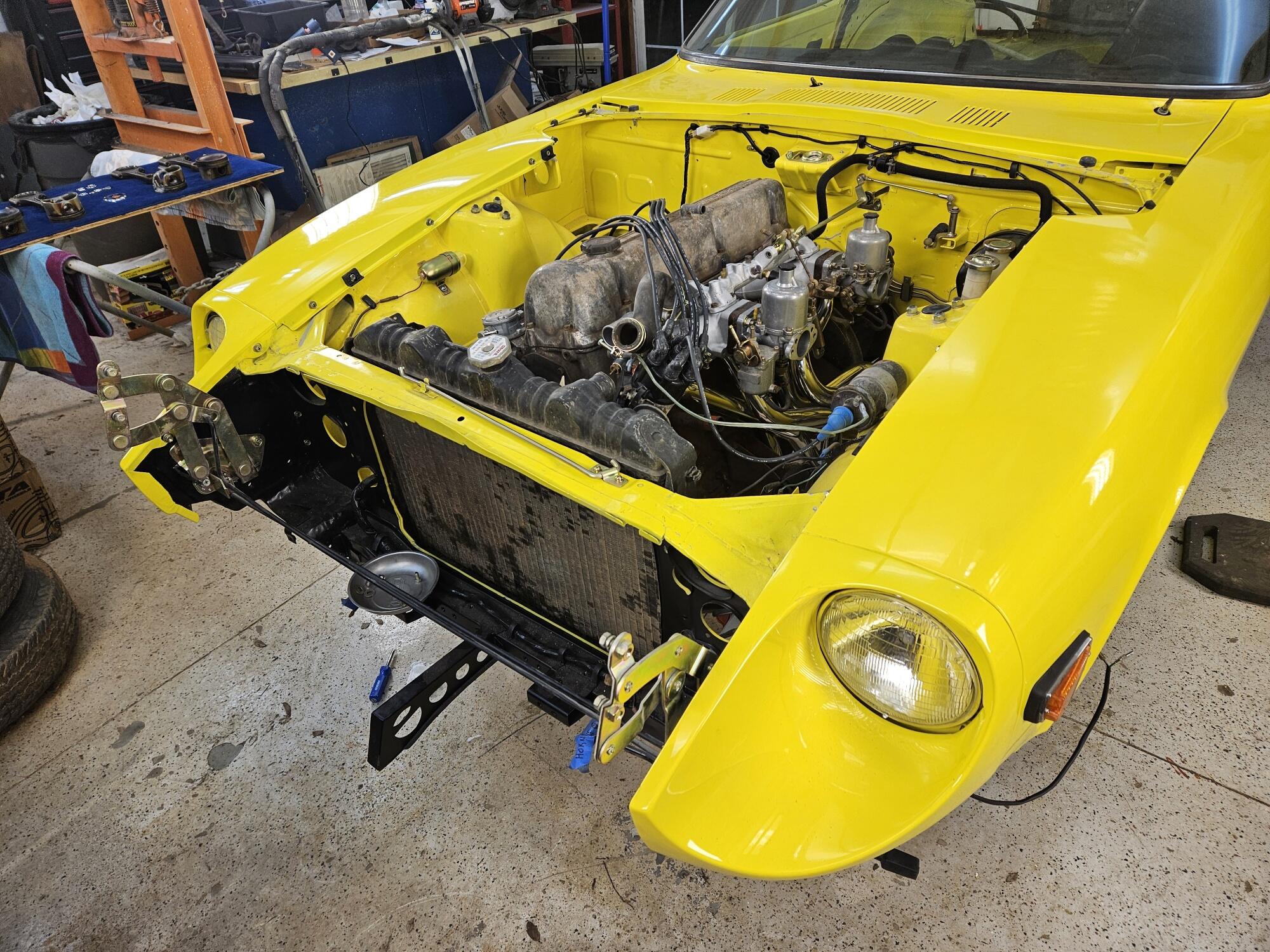

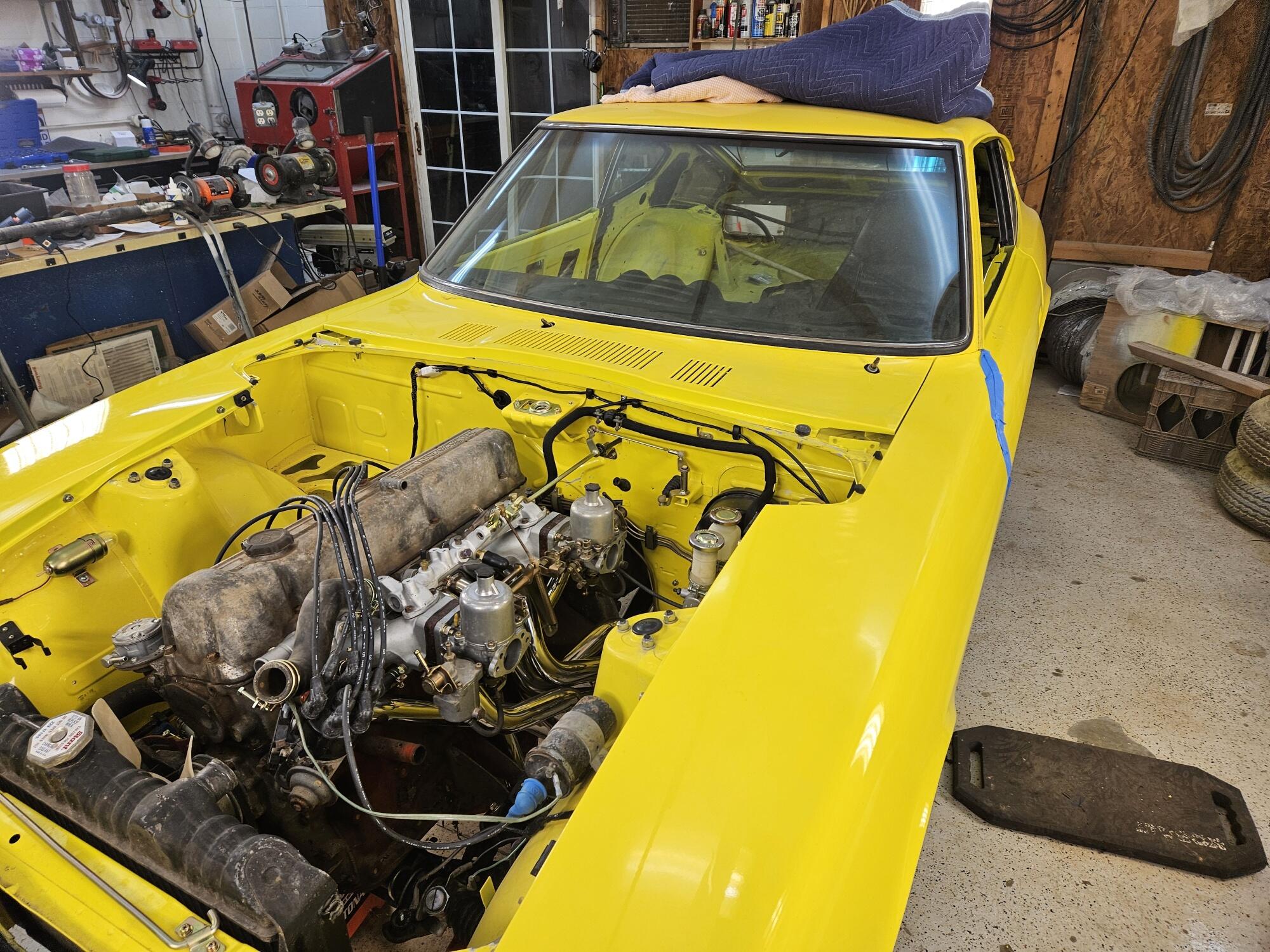

So I worked on the car some more today. I made progress but it was still frustrating!

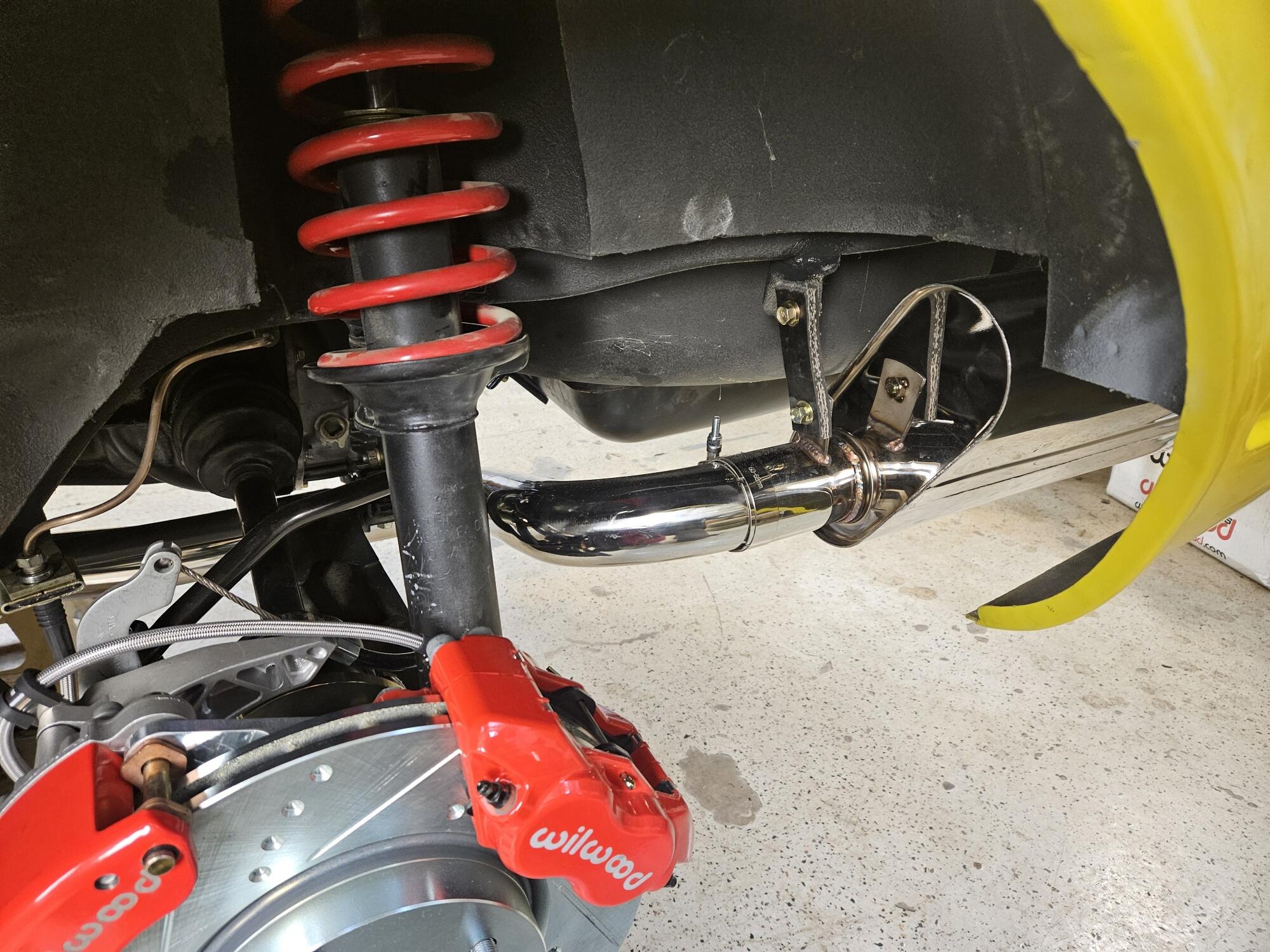

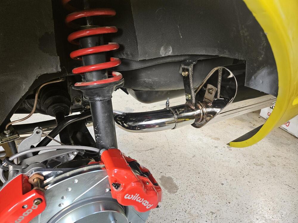

I worked on the exhaust a little more. Added this mounting strap on the tire side of the muffler. I need to add a hanger strap near the differential but I will have to fab a bracket to do that.

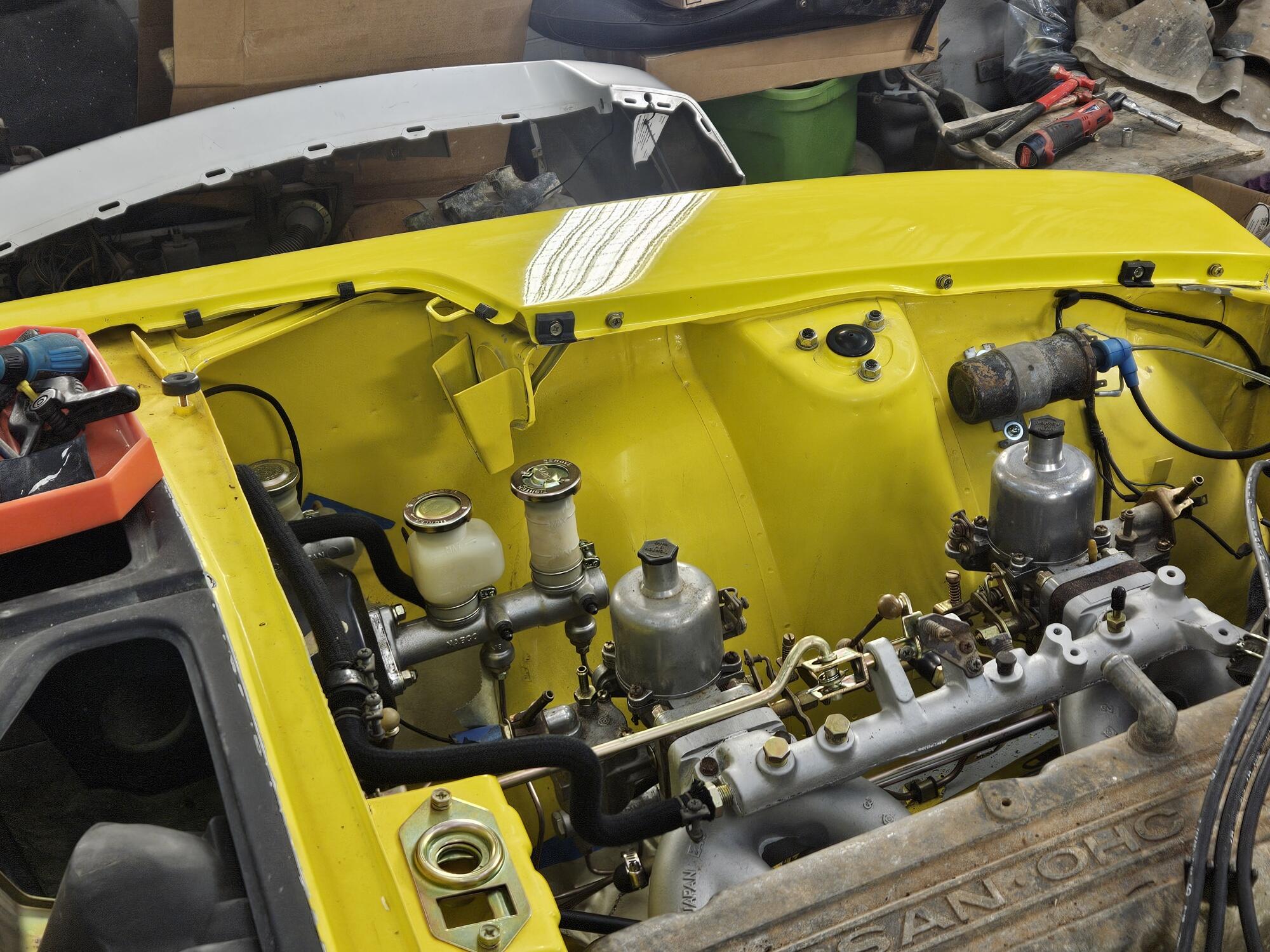

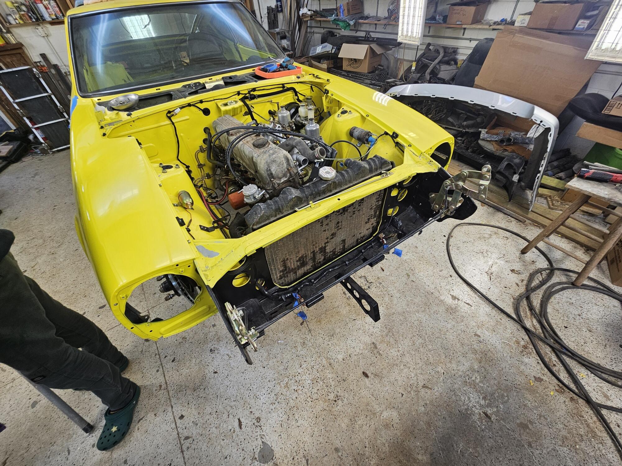

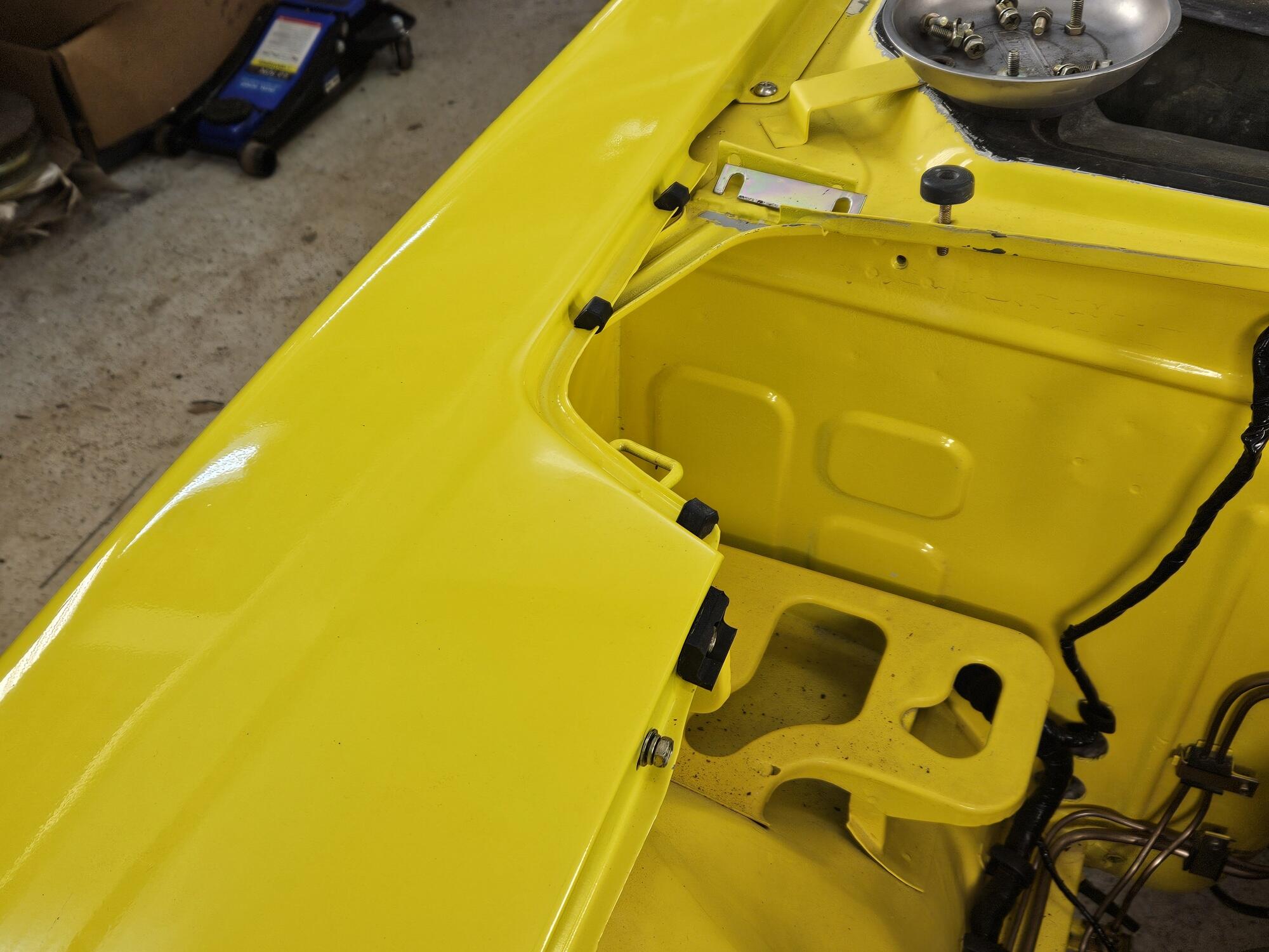

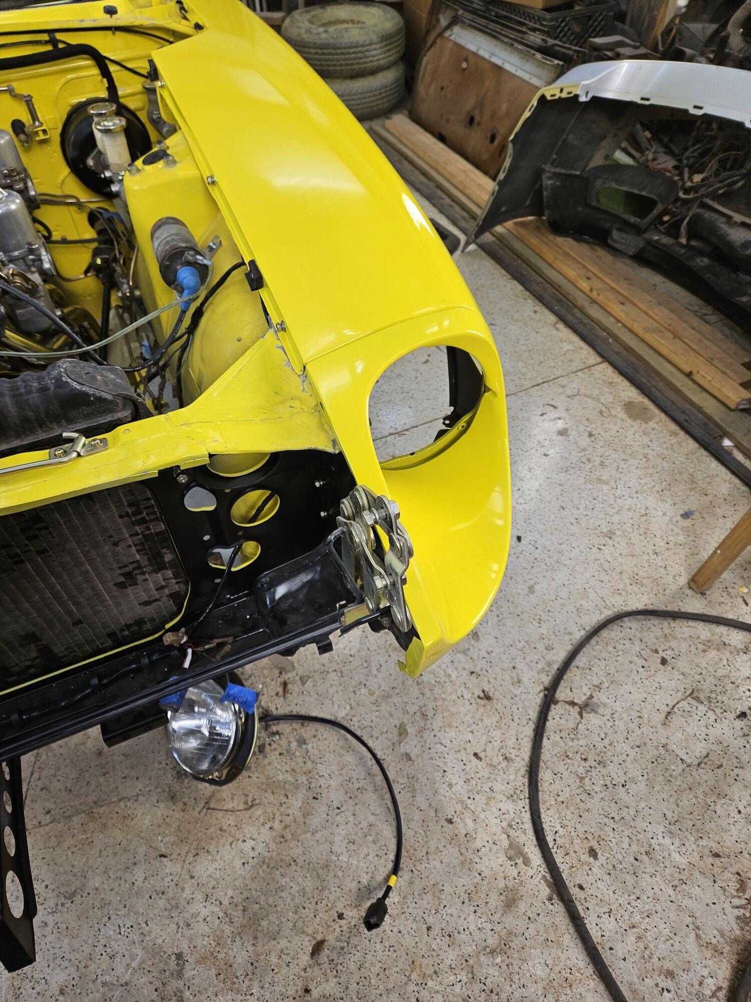

Worked on mounting fenders and adding bumpers to the fenders
Installed the hood hinges

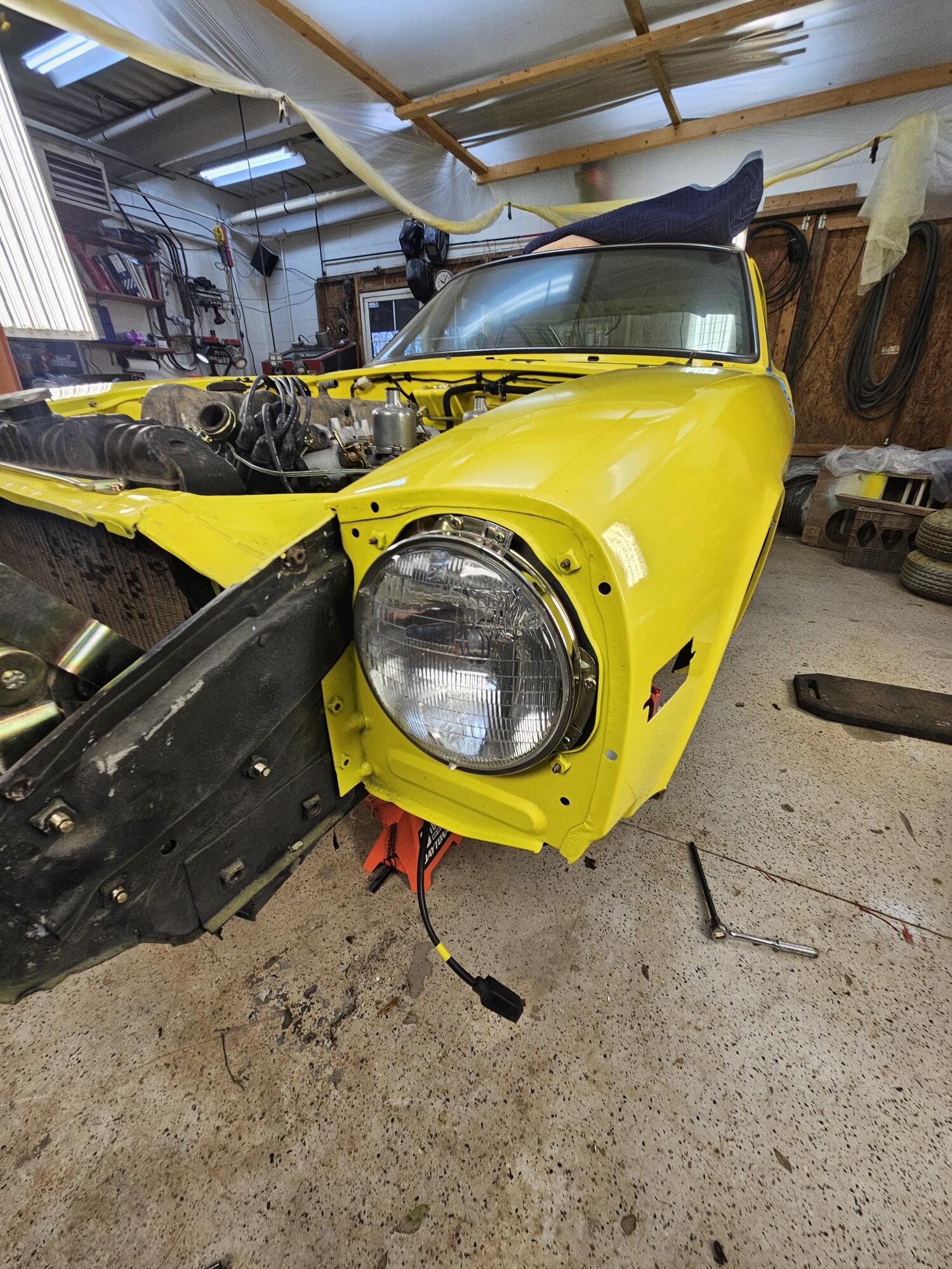

Put in the headlights

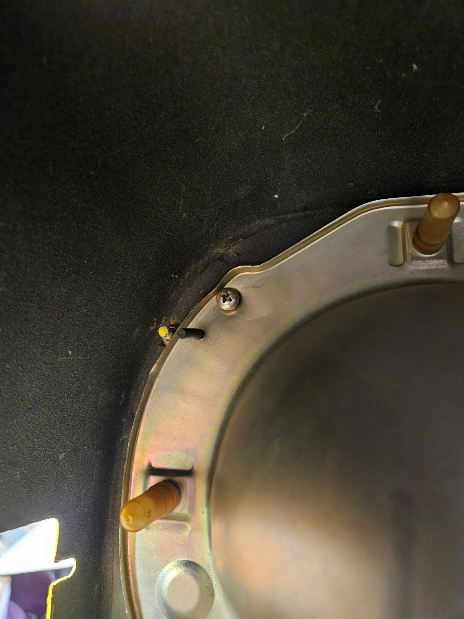

Then realized that you can't put the sugar scoops on with the headlights in place!
The studs are blocked by the headlight frame
I put the windshield cowl on four or five times. Had to adjust fenders multiple times and every time I took it on or off I chipped the paint somewhere new. Really irritating!!

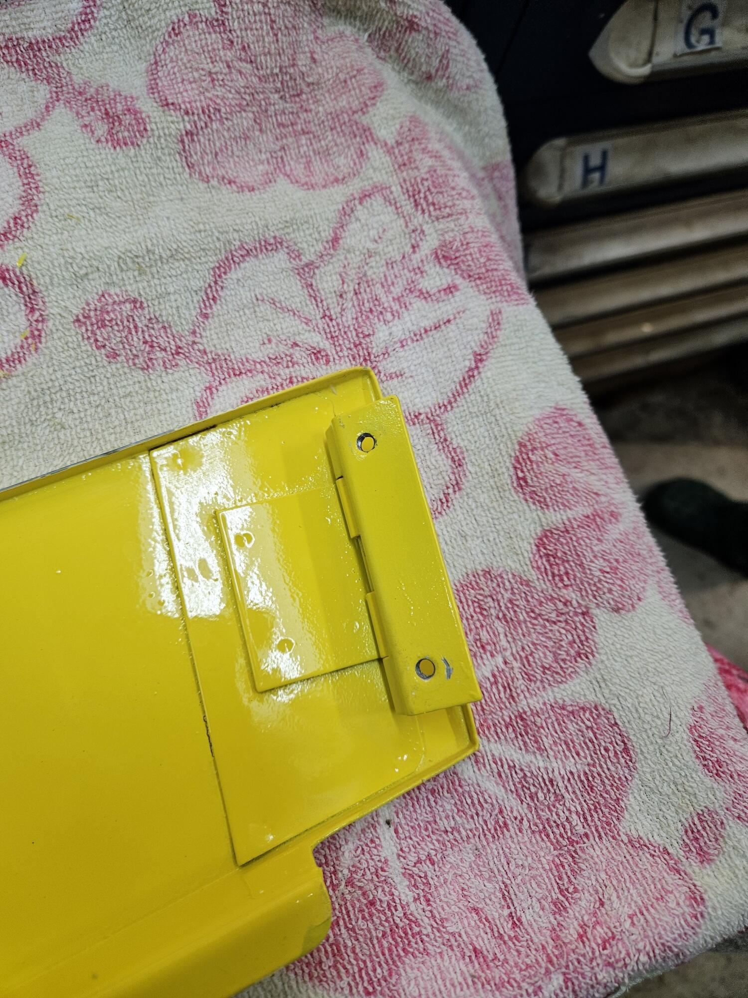

I have to take it off again, maybe tomorrow to adjust the passenger side fender. The inspection cover won't fit in the gap I have currently on the passenger side.
I also can't find the hardware for the inspection lids. I know I have it and it's been plated but I can't find it. Really irritating. Luckily, I'm a packrat and had some other lids with the hardware but it will have to be plated.
