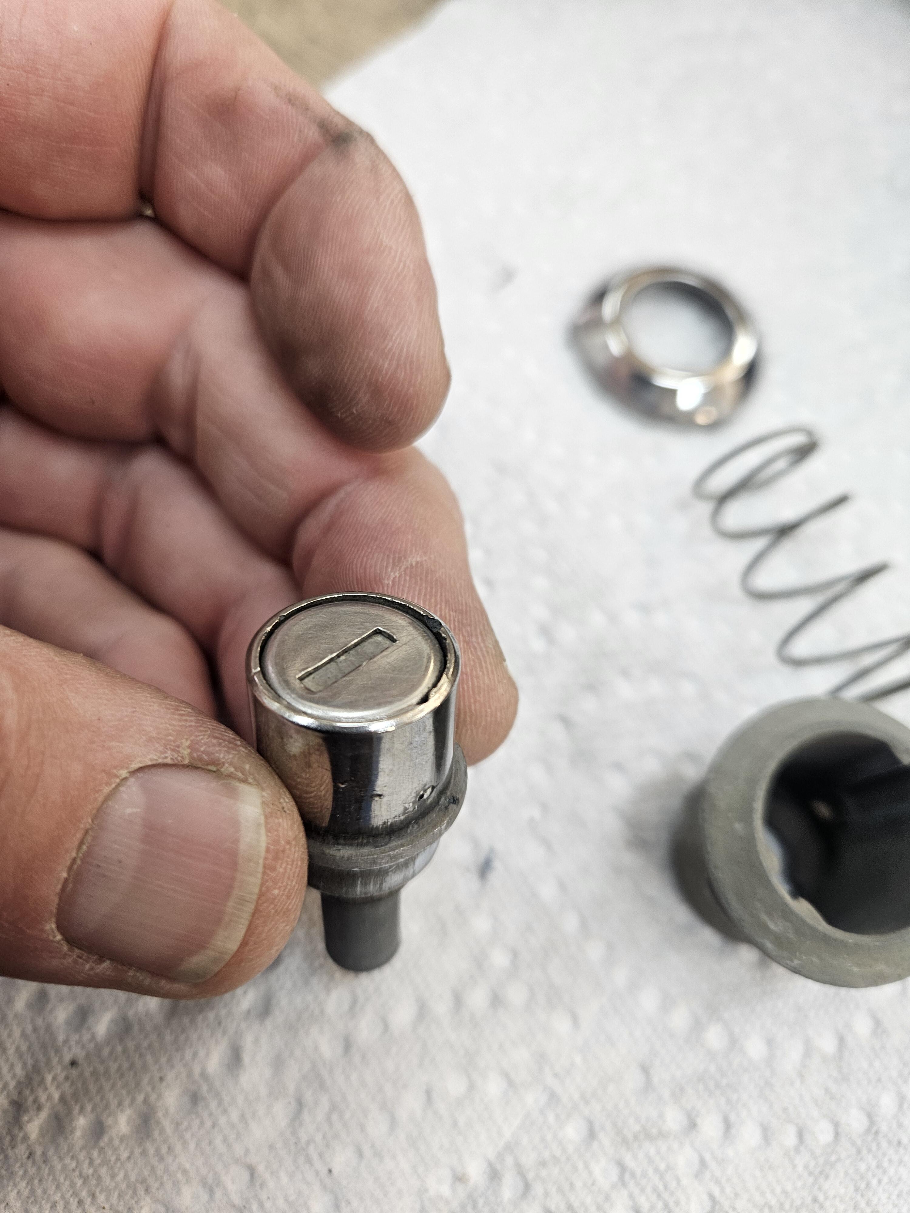

I also worked on rekeying some door locks today. I have an ignition key I like and I want one key for the whole car
So I played at making tiny springs!! :blink: @emccallum
He are the assorted's. Spare locks, replacement parts, lockset pliers, seals, etc
Here is a first attempt. It was actually one of the best attempts
I am using some orthodontic wire. There was some that was about 0.015" dia and some that was more like 0.010" dia.. It's difficult to get the coils to wrap close to each other.
I used a small drill bit as an arbor, like 0.063" dia
I found that the thicker wire was a little too heavy for the key door. It installs ok but the door has too much resistance. The thinner wire worked better was more difficult to make neat looking springs

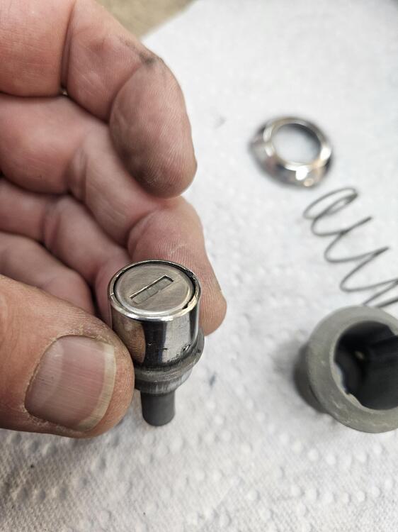

Disassembled the lock
Lightly blasted the lock case and the inside of the cap. Polished the cap with the buffing wheel. A piece of wire helps keep it from getting away from you

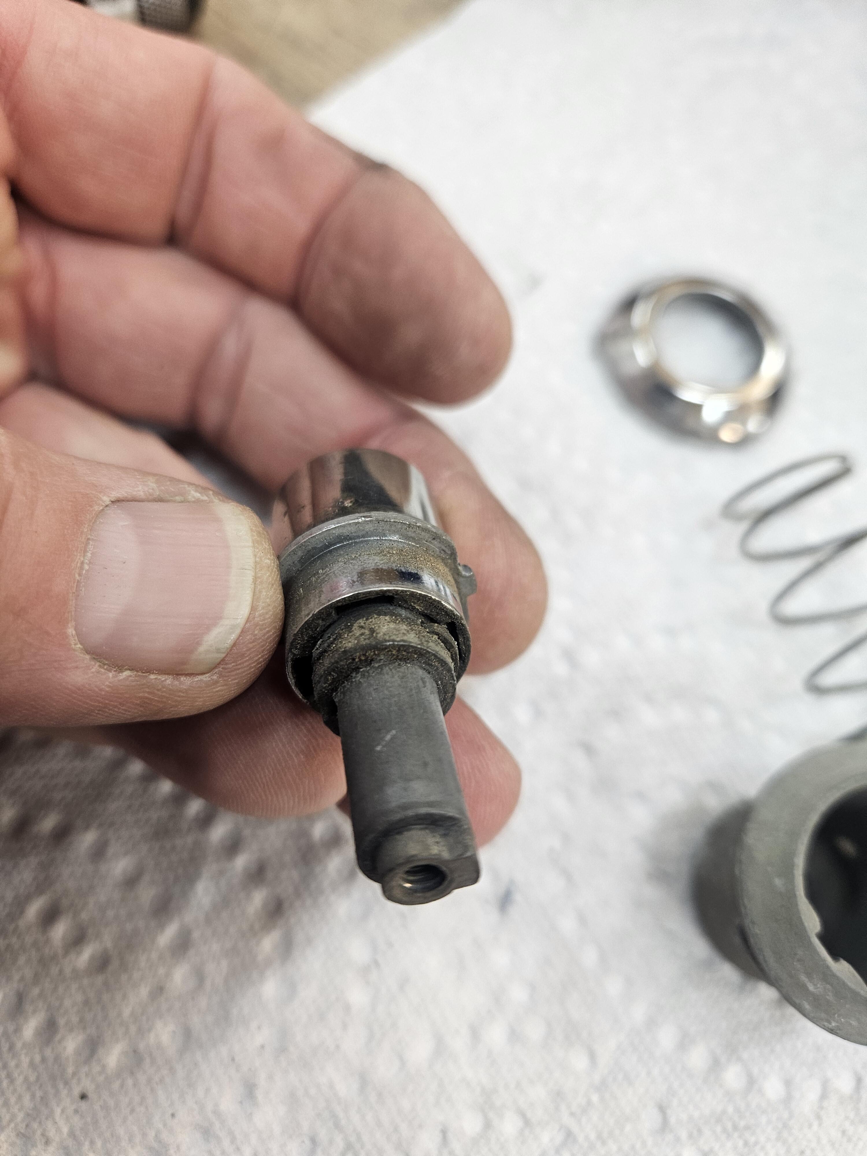

Repinned the lockset. I only have 4 different wafers and it seemed like I needed another size. I reworked one with a buffing wheel to make it work for now. Also my replacement wafers don't have the little tab on the side that lock them into the tumbler like the factory ones do. So reassemble is a little trickier.
One finished lockset

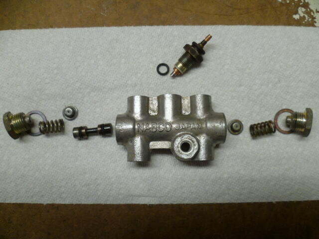

But I suspect the problem in inside the brake switch. Something like your little slidey piston is all gummed up and stuck on the "fail" position:
Or maybe one of your tiny metering orifice holes is gummed shut with 50 years of gelatinized brake fluid and deteriorated rubber:

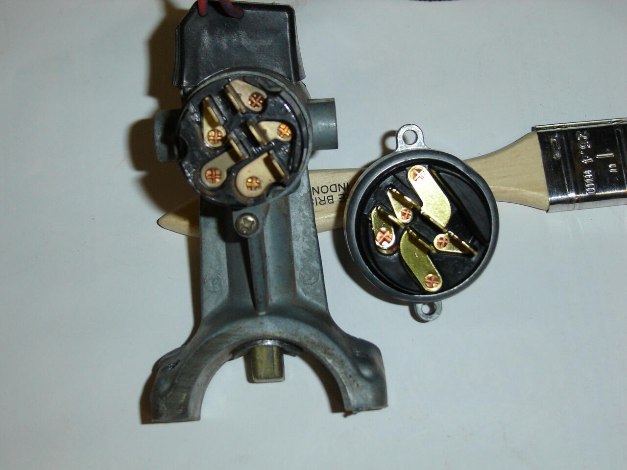

So the unusual nature of this issue has me intrigued. I know you said you were going to have the combo switch thing rebuilt, but in the meantime, I had a question.
Are you running an old style single screw mount ignition switch, or has the whole assy been replaced sometime over the years with the newer two screw style? Here's a hoovered pic of the difference. Older single screw mount on the left, newer two screw mount on the right:
