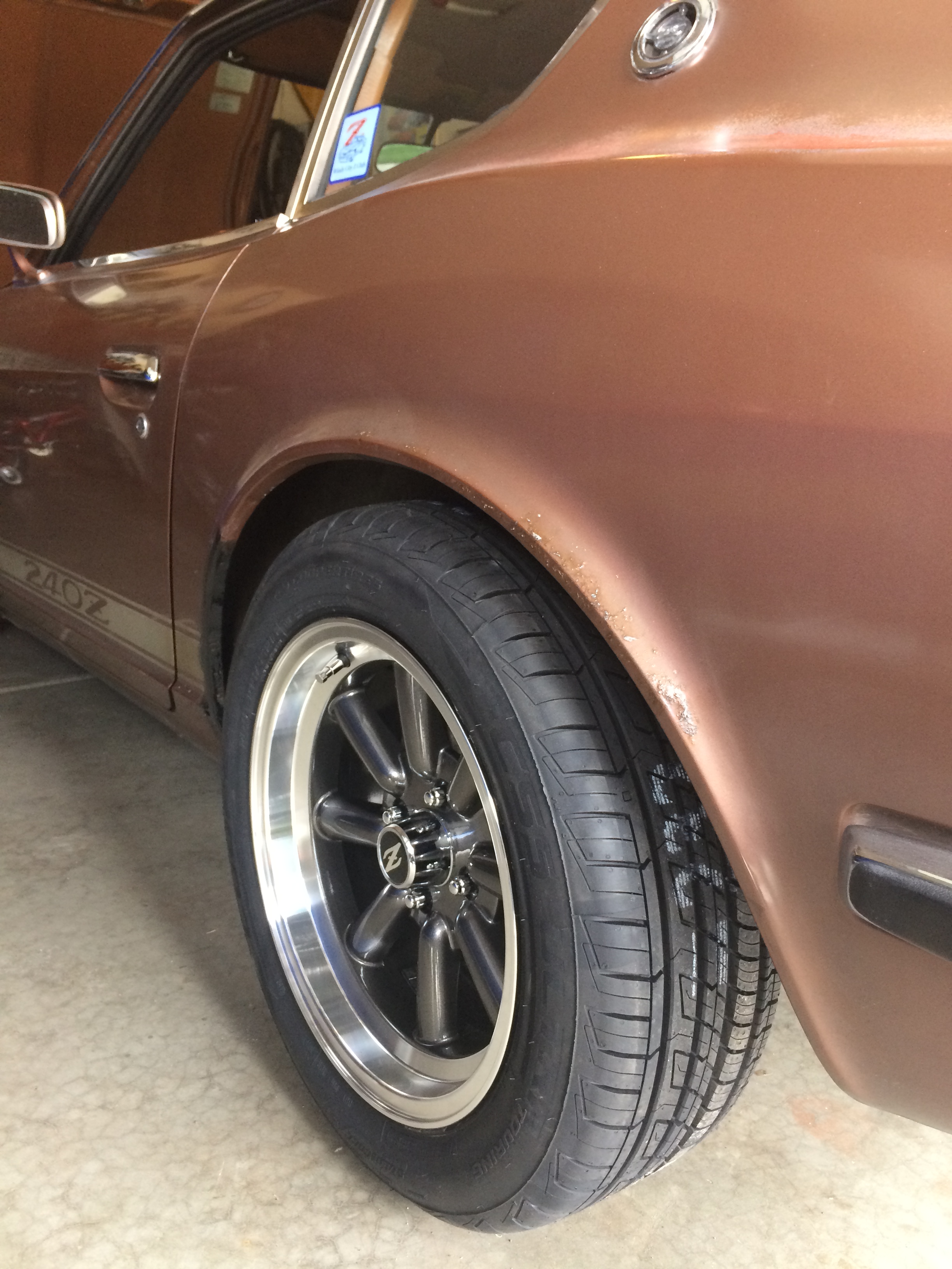

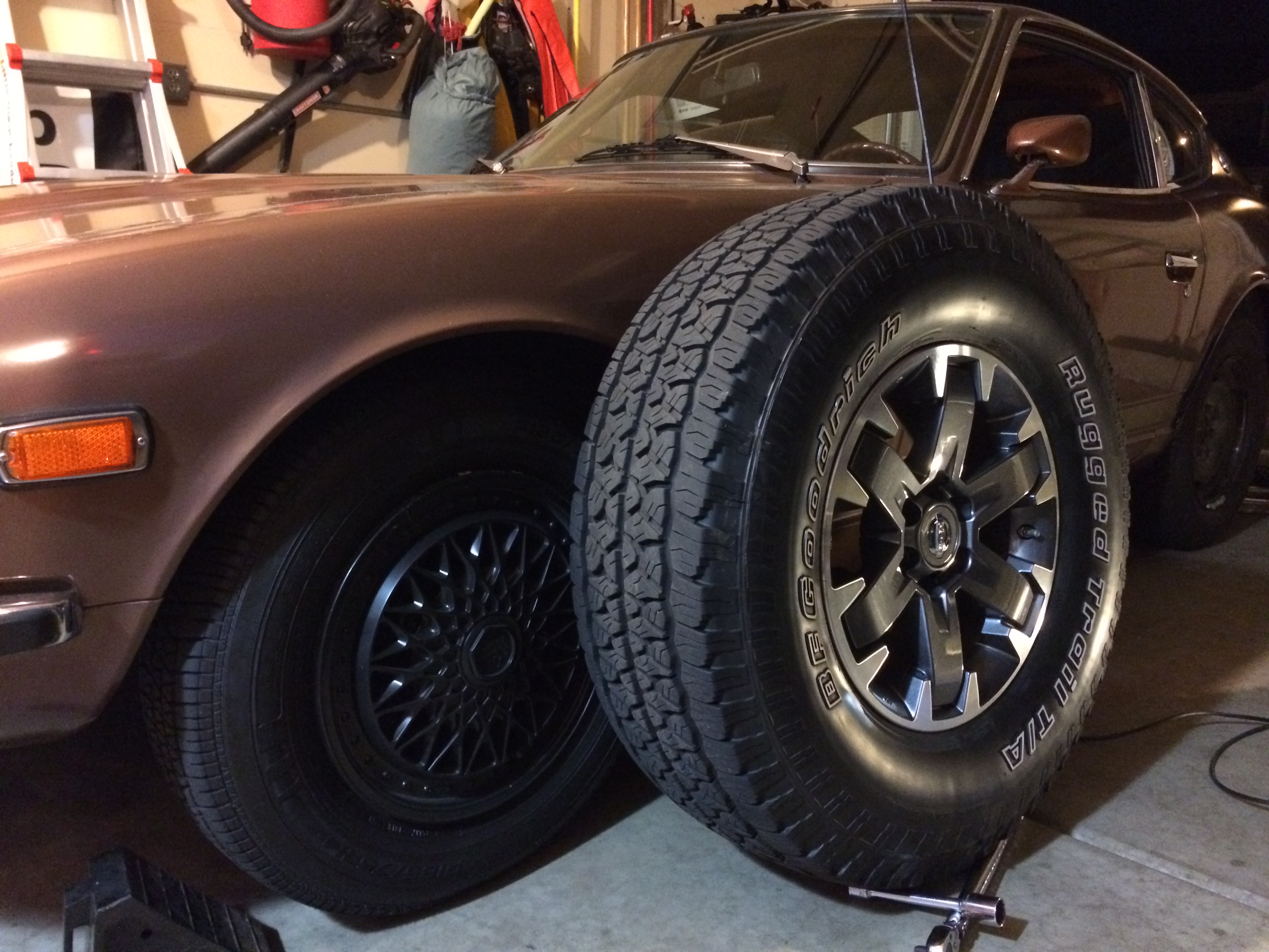

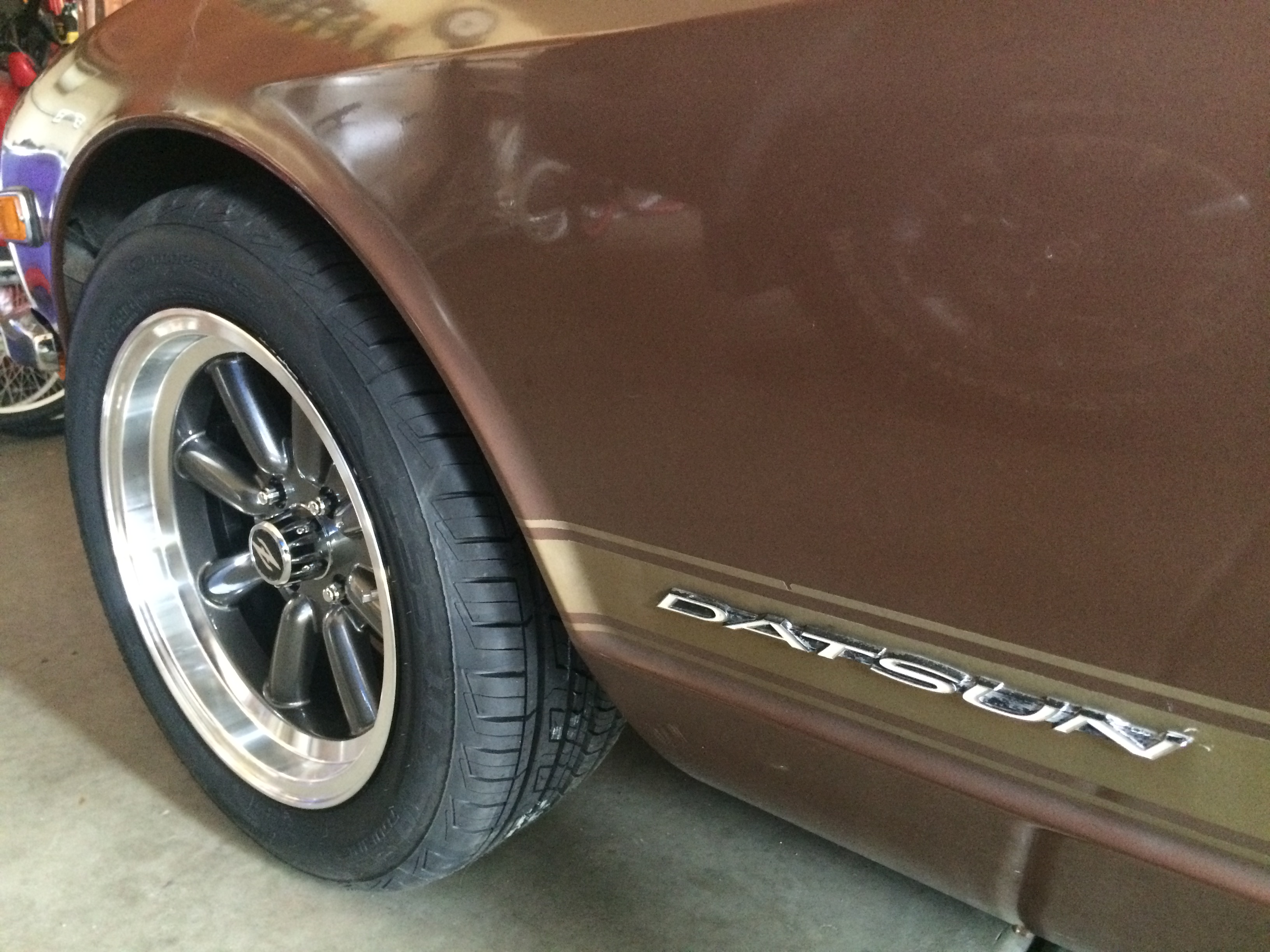

May 5, 20168 yr comment_494316 Yes, you'll need bigger wheels to fit the larger calipers. I just put a set of 16x7, zero offset Konig Rewind wheels on my '72 240z with 205/55R16 Cooper tires on it. Next to no rub and the combination looks real good (in my opinion). I ordered them from DiscountTireDirect.com and due to a system glitch got a super deal for around $600 that they decided to honor. They fit a lot better than my Xterra 32's that I put next to the car for comparison with the original 14" steelies. Link to comment https://www.classiczcars.com/forums/topic/55407-wheel-size/#findComment-494316 Share on other sites More sharing options...
