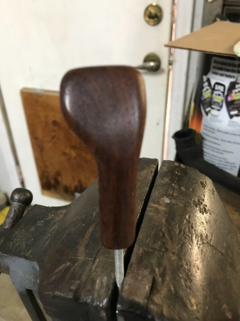

November 27, 20177 yr comment_535904 On 11/21/2017 at 6:04 PM, 70 Fairlady Z said: Anyone have two of the fine thread screws for the early knob (70-71)? Lowes carries 3mm M3- .50 x 6 that worked to replace the fine threaded screw on my 70. You may have to either drill the recess larger or grind down the head to fit the knob.Once the poly dries the broken/missing knob will be replaced this home custom walnut knob.Sent from my iPhone using Classic Zcar Club mobile Link to comment https://www.classiczcars.com/forums/topic/55430-modifying-a-70-71-choke-knob-to-fit-a-72/?&page=3#findComment-535904 Share on other sites More sharing options...

November 27, 20177 yr comment_535966 Nice. I'd thought about the possibility of carving a control knob (I need a mirror-image version for the hand-throttle lever on my car). Thanks for demonstrating that it can be done. With a finish coat of gloss black epoxy paint, it might be pretty much indistinguishable from the real thing made of plastic. Probably stronger, too . Not so sure that I have the engraving skills to carve in a logo, though. Winter project. Link to comment https://www.classiczcars.com/forums/topic/55430-modifying-a-70-71-choke-knob-to-fit-a-72/?&page=3#findComment-535966 Share on other sites More sharing options...

November 30, 20177 yr comment_536261 On 11/27/2017 at 1:54 PM, 70 Fairlady Z said: Ordered - thanks!Thanks for the comments guys. A PO switched out the Series 1 console and fitted what I believe to be Series 2. It is not in great shape with damaged fuse block cover and missing ashtray/cover. So I am planning to use the same walnut to fabricate new pieces to match the choke lever knob. Just a little custom wood bling to a non original console. Will post some finished photos.Sent from my iPhone using Classic Zcar Club mobile Link to comment https://www.classiczcars.com/forums/topic/55430-modifying-a-70-71-choke-knob-to-fit-a-72/?&page=3#findComment-536261 Share on other sites More sharing options...
