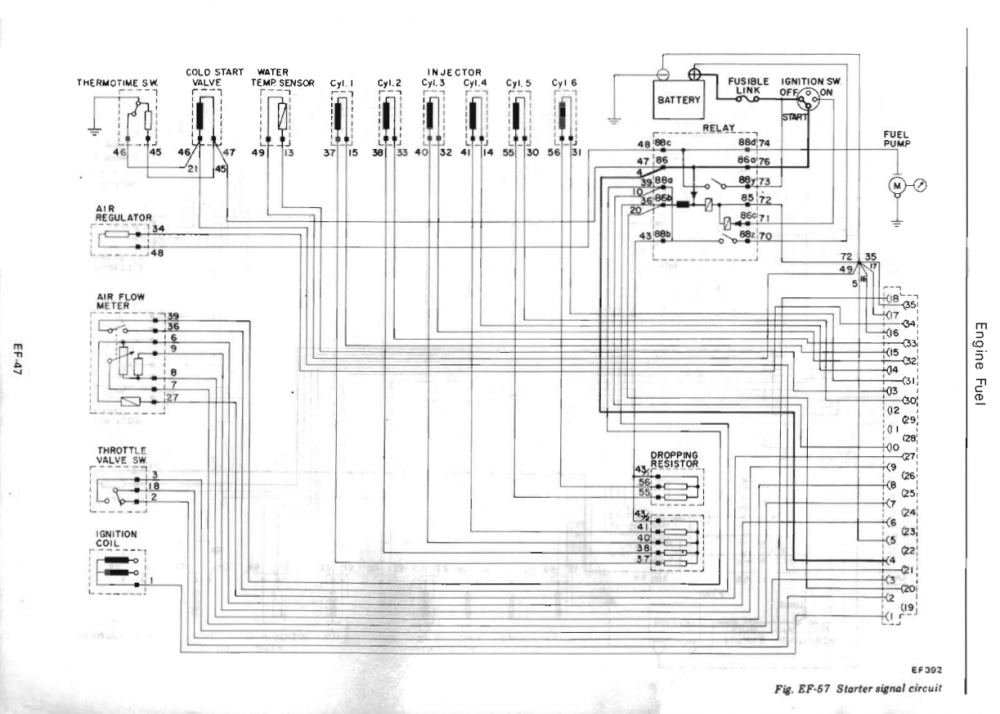

May 14, 20168 yr comment_494963 They don't usually stick open because there's a spring inside that shuts them. Could still happen but could also be an electrical problem, a short to ground on the ECU side. Unplug it and check that the terminals in the plug aren't grounded. The Engine Fuel chapter in the FSM has an excellent description of how things work, with diagrams. Link to comment https://www.classiczcars.com/forums/topic/55448-need-a-miracle/?&page=3#findComment-494963 Share on other sites More sharing options...
