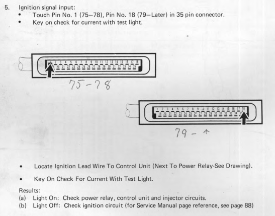

With the key off, you can connect a jumper wire from the coil negative to ground,  Then check Pin 1's continuity to ground.  If Pin 1 shows continuity, then there's a complete circuit.
Or, you can just check for voltage at Pin 1 with the key On.  Power will pass from the battery through the coil to the negative terminal and down the circuit to Pin 1.
Use the Fuel Injection Guide to make sure you're measuring Pin 1.
