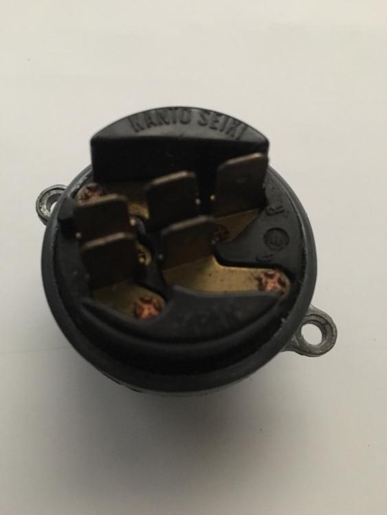

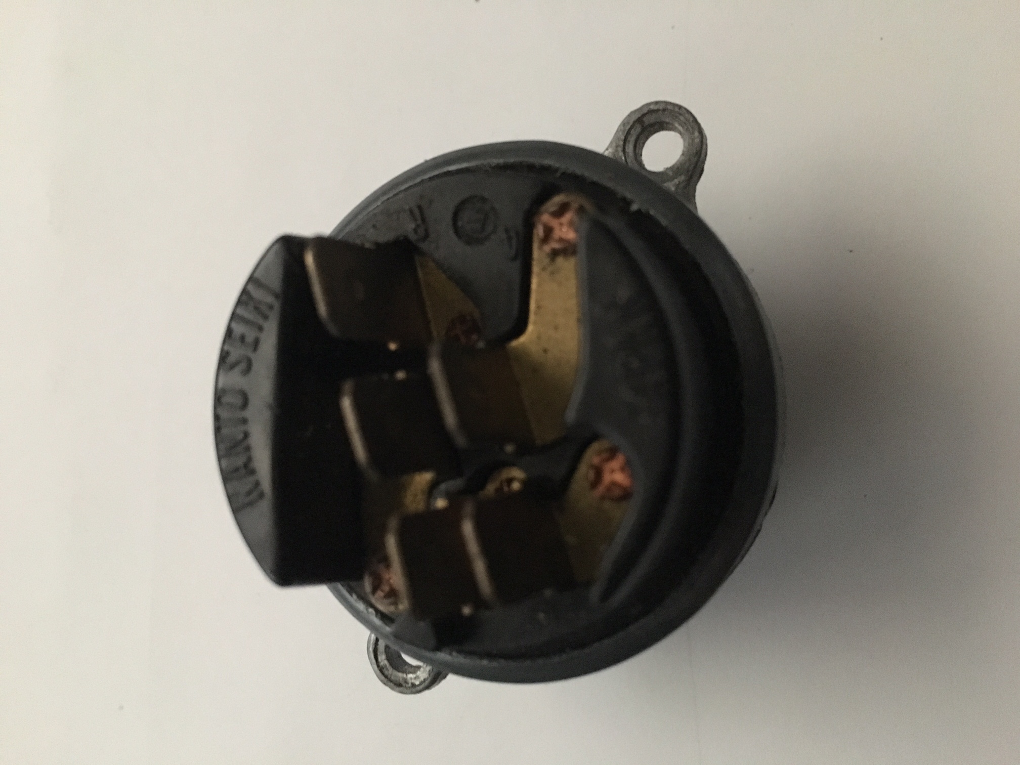

Captain Obvious Posted May 18, 2016 Share #4 Posted May 18, 2016 Not trying to take business away from anybody, but an ignition switch isn't something I would buy used. Datsun didn't use a relay to handle the current for the starter solenoid and this is what happens inside: Link to comment Share on other sites More sharing options...
Terrapin Z Posted May 18, 2016 Share #5 Posted May 18, 2016 Well, the Ignition switch is one of those that you can't take apart, clean up and reassemble. So it is hit or miss if they will work or not. To each their own on new or used I suppose. In opposition to Capitan Obvious, My 45 year old Ignition switch works just fine. Not all of them will end up like the one above. perhaps there was another issue with the starter and/or solenoid / wiring / misuse that caused this? Not trying to plug my part for sale, I really don't care about that. I am with Patcon and would prefer a used original over a Chinese replacement. They can't all be burnt, Just saying. Link to comment Share on other sites More sharing options...
