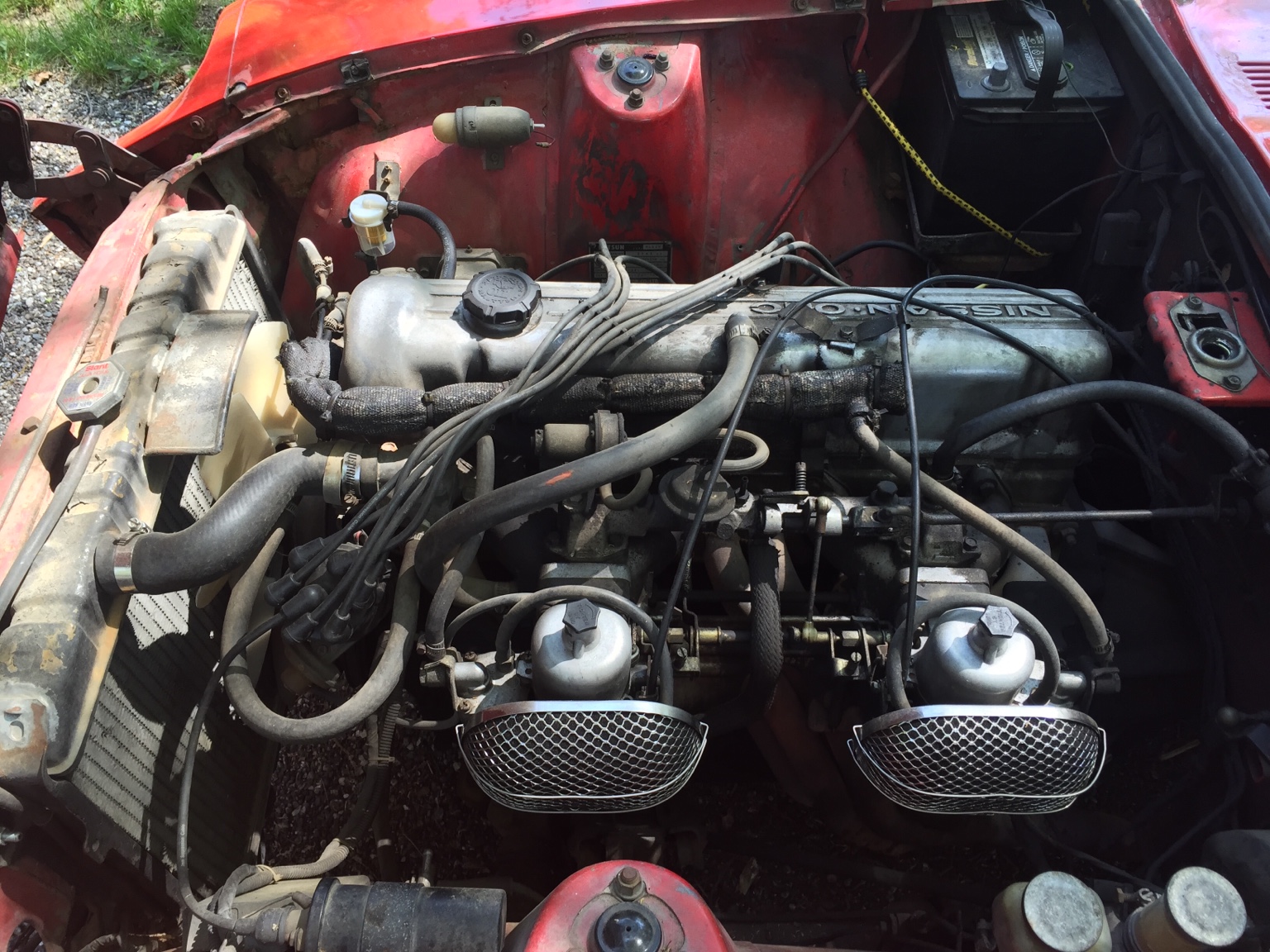

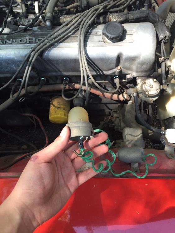

May 25, 20168 yr comment_495645 Cool car! That rubber shift boot is out of a ZX I believe, you may have a short throw 5 speed. Ā If the inspection light works, you'll have good luck with the car.Ā Curious about the hose running around the distributor. Ā It looks like the intake coolant line from the thermostat housing but where does it terminate? Ā The valve cover hose looks like it connects to where the coolant hose should be connected on the intake. Ā I just got through plugging all that off. Looks like it has a period friend across the street, maybe a Buick or an Oldsmobile or is it a Cataract? Ā It still has the fender skirts.Ā Ā Link to comment https://www.classiczcars.com/forums/topic/55510-1971-240z-rebuild/#findComment-495645 Share on other sites More sharing options...
May 25, 20168 yr comment_495650 What coincidence! Ā Here's your filters and shows where the valve cover hose should be connected. Ā Link to comment https://www.classiczcars.com/forums/topic/55510-1971-240z-rebuild/#findComment-495650 Share on other sites More sharing options...

May 25, 20168 yr Author comment_495662 3 hours ago, siteunseen said: Cool car! That rubber shift boot is out of a ZX I believe, you may have a short throw 5 speed. Ā If the inspection light works, you'll have good luck with the car.Ā Curious about the hose running around the distributor. Ā It looks like the intake coolant line from the thermostat housing but where does it terminate? Ā The valve cover hose looks like it connects to where the coolant hose should be connected on the intake. Ā I just got through plugging all that off. Looks like it has a period friend across the street, maybe a Buick or an Oldsmobile or is it a Cataract? Ā It still has the fender skirts.Ā Ā Thank you! PO said it's a 4-speed and it feels like one too. For the inspection light, I will check on those as soon as I got home today! I'm not sure about the hose you mentioned, I will check it out sometime. The car across the street looks like a Buick, But nobody has done any work so it's been sitting there for a lone time. Link to comment https://www.classiczcars.com/forums/topic/55510-1971-240z-rebuild/#findComment-495662 Share on other sites More sharing options...
May 25, 20168 yr Author comment_495663 2 hours ago, siteunseen said: What coincidence! Ā Here's your filters and shows where the valve cover hose should be connected. Ā Thanks man. I saw this thread a little while before.Ā Link to comment https://www.classiczcars.com/forums/topic/55510-1971-240z-rebuild/#findComment-495663 Share on other sites More sharing options...

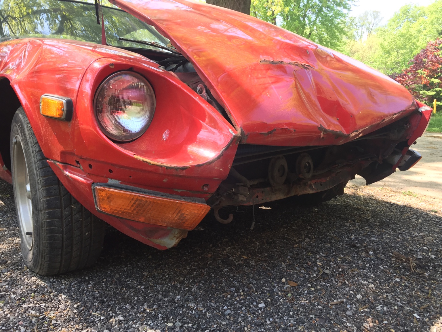

May 25, 20168 yr Author comment_495664 I think I missed some photos...the front seems pretty bad but the frame is in decent shape. May need some metal work to get it straight. Sent from my iPhone using Classic Zcar Club Link to comment https://www.classiczcars.com/forums/topic/55510-1971-240z-rebuild/#findComment-495664 Share on other sites More sharing options...

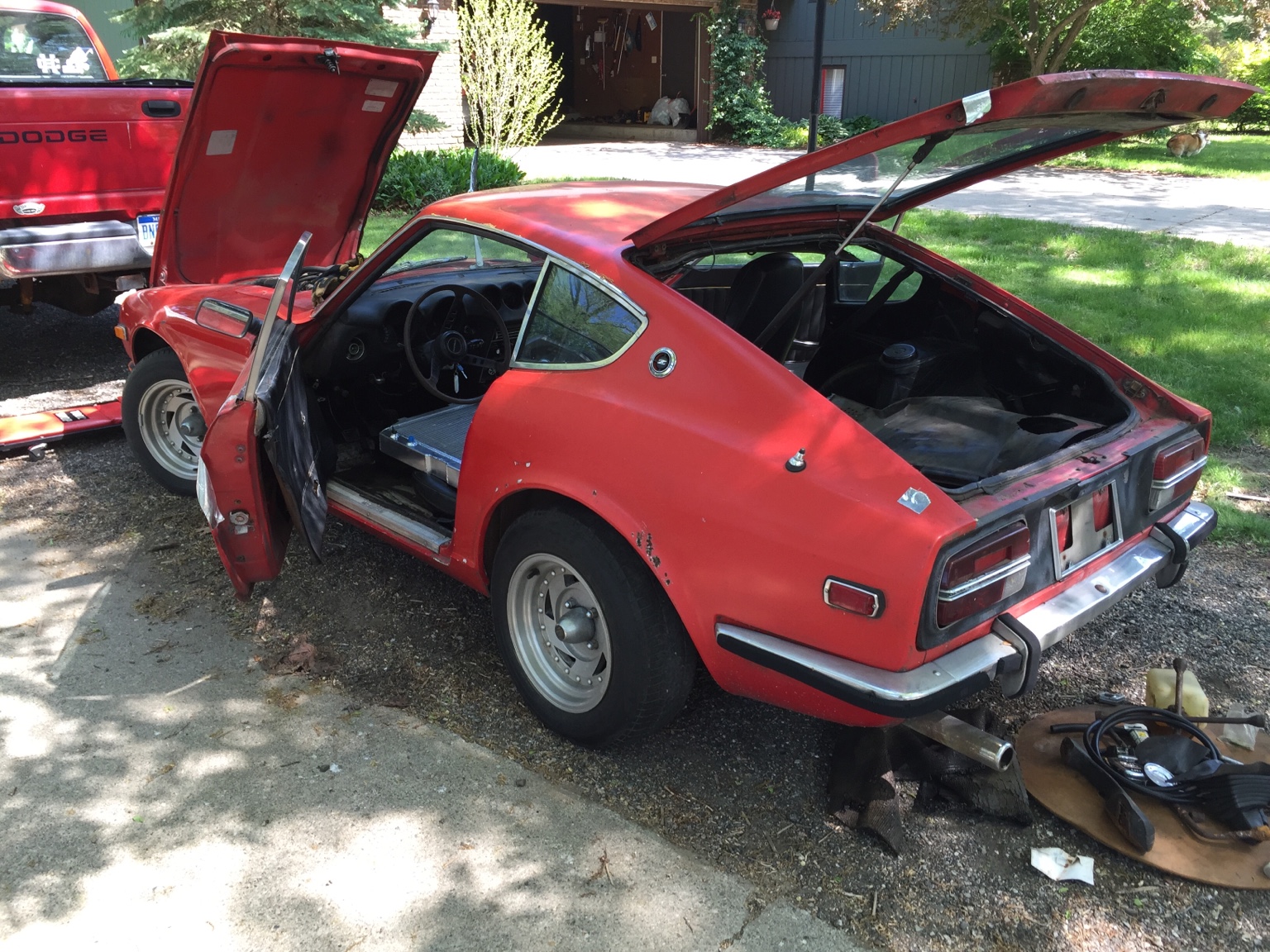

May 25, 20168 yr comment_495681 Well that's a plusĀ if it has flat topped pistons. Dished are fine though as you are just starting out. Beat that hood out and get the driver's door to close. We don't want to hear a fixable tragedy. The motor is an easy fix, you getting flung out is not. Link to comment https://www.classiczcars.com/forums/topic/55510-1971-240z-rebuild/#findComment-495681 Share on other sites More sharing options...
