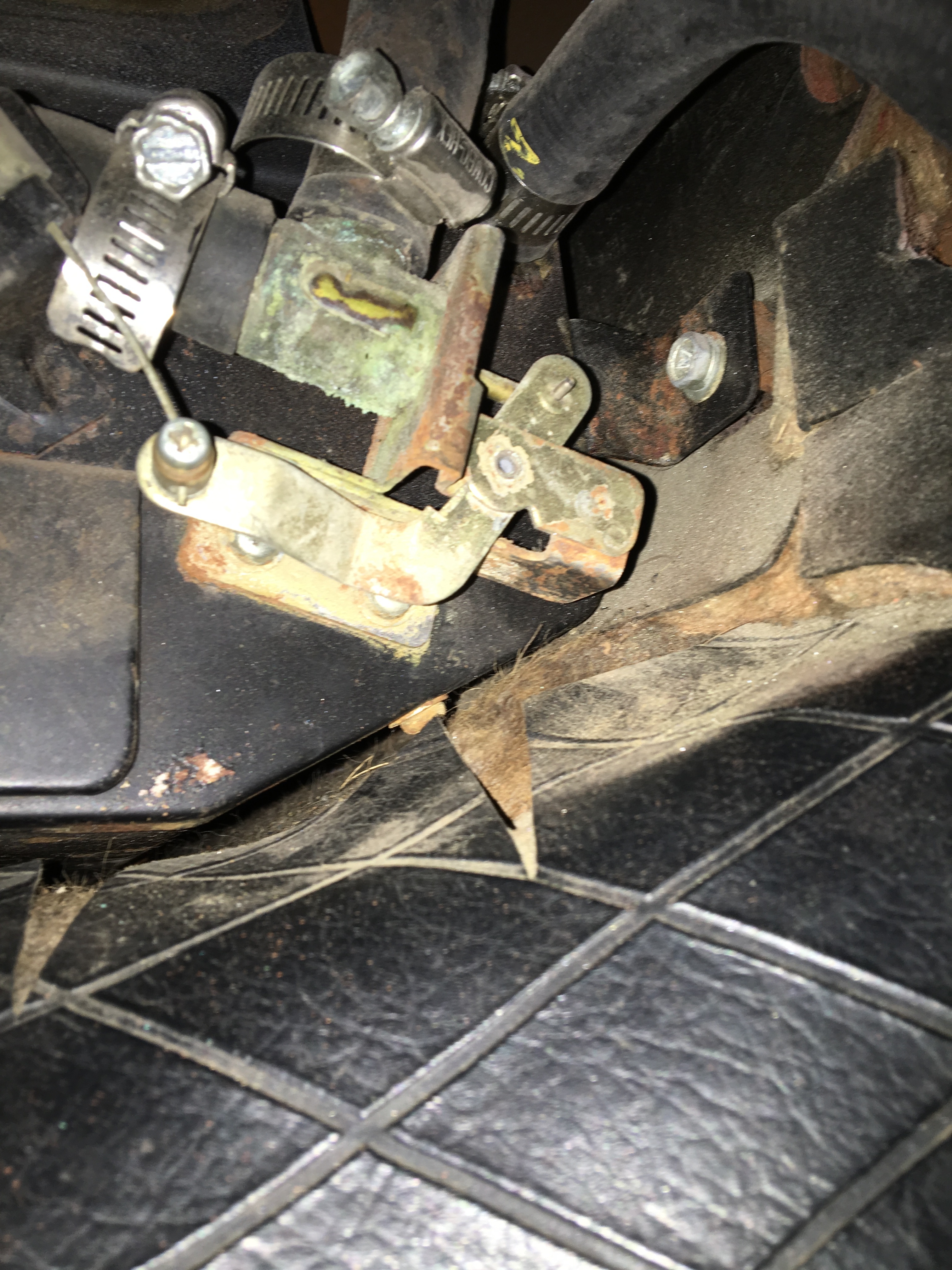

The heater appears to be broken, so any tips with where to start looking would be much appreciated as with winter on the way it will become an essential piece for continued use for the front screen as well as comfort.

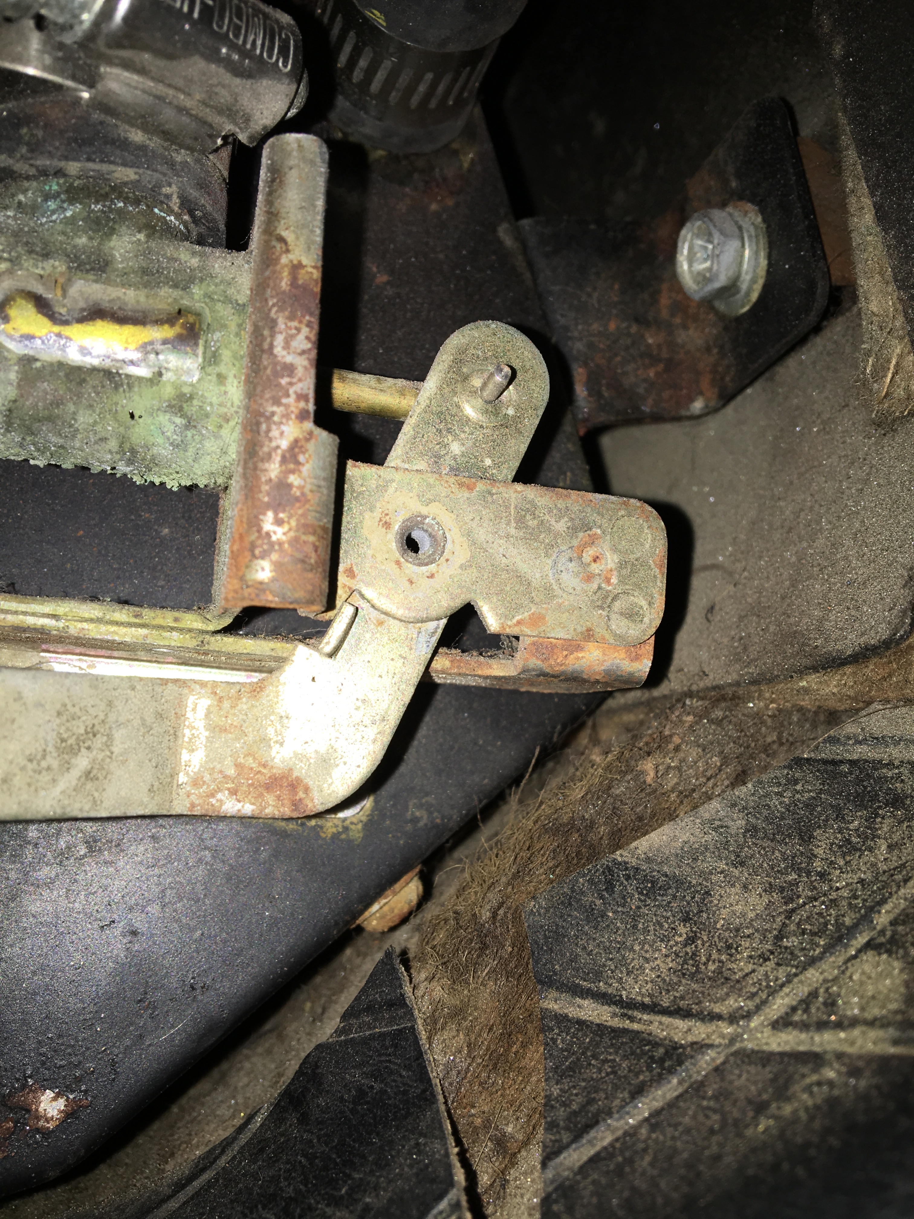

The heater in a friend's 240Z didn't work because the stiff control wire going from the control lever on the dash to the heater valve popped off on the end that was attached to the dash control lever.  For temporary heat until the control wire could be fixed I just turned the heater valve above the passenger's left foot with my hand.

I would start at the heater valve also. Are the lines attached under the hood? I would assume so since it just came from the shop. Are the controls attached to the heater valve? Will the heater valve move? They sometimes corrode in position and won't move...you should be able to see this from the passenger foot well
You can see the end of the actuating cable and what it's supposed to be moving if you stick your head up under the dash and look behind the glove box.  Do that and move the lever, and you'll know which end of the cable has the problem.  That's how I discovered that mine was bent, behind the face plate.  Somebody got angry and forced it.
Edit - also, not uncommon to find that people have blocked or bypassed the hoses because the core leaks.  Sometimes they do it in the engine bay, sometimes in the cabin.
Thank you all for the advice! This is a really helpful starting point :D Lets hope its this simple. Next time I get to the car from the lockup I'll have a look and see if at least the heater valve won't manually open, Interestingly we think we were getting heat when we collected the car and its since failed, I also had one of the vent control handles fly off on one journey. This could very well explain how matters have evolved and we have no heat.

Well update on the heater, its still not working! Freezing to say the least when you take the car out in below zero, particularly when you have nothing to de-ice the screen except a credit card! takes away from an otherwise awesome experience. So it turns out that the temperature slider control (middle) isn't connected up to anything following investigation which would explain why that's not being of any assistance, however the top slider control does engage towards the right which implies heat. Having traced the mechanism back I reached a control valve under the dash (pics attached) which looked pretty horrible however with some persuasion it operated. Unfortunately this did not do anything as far as we could tell. Is this the heater control valve?
The only other investigation I've done is check the pipework in the engine bay, it is quite apparent that there are hot water pipes passing through into the cabin (feel very warm to the touch once the cars warmed up) which I imagine are linked to the heater matrix. I can therefore only assume the issue lie's in the cabin. Any suggestions as to how to proceed?
