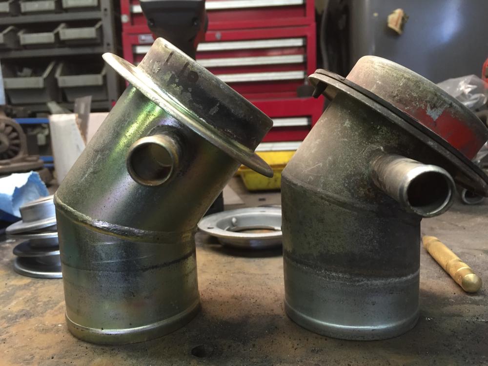

I've just realized there is a considerable fly in the ointment about my little locking cap solution.
Only the 240's have that external filler neck ring that is so easy to remove and apply a weld bead to.. 260 and up has a much larger filler neck like this. There is a unique filler neck for the 2+2 according to the fiche, and the 77-78 models are different again, with the smaller cap and no chance at all of a locking cap.
Dang.
No way to get in from the end and place that weld bead.
However there is a way to make this work, I think a screw/bolt in from the side at the right spot at just the right length would accomplish the same task of providing a stopper for the locking caps tang to hit, just like the weld bead. You'd have to seal that bolt in that hole as well to prevent leaks. Little welding for that, or JB weld....
Getting this sucker out of your car is perhaps the most challenging thing.
So long story short, if you have a 260/280 and want me to do the mod, you're going to have to send me the whole filler neck. I only have a couple of these, so cores will be required. You lucky 240 folks can just get a modded filler ring off me.
Questions?
Steve, after three statements of fact, I'm inclinded to believe you, but take a closer look. Are there three or four bolts holding the filler neck to the body? Four is the larger from the backside later filler neck style. The bolts thread through the body and thread into the flange in the filler neck.  Yes the fill cap and opening in the filler neck are the same up to end of 76, and look very similar.
Can you post a picture of your filler area? I gotta see this.
Here is a pair of 2+2 and coupe  260/280 filler necks for later reference. the longer below the body 2+2 one is even marked "2/2"
