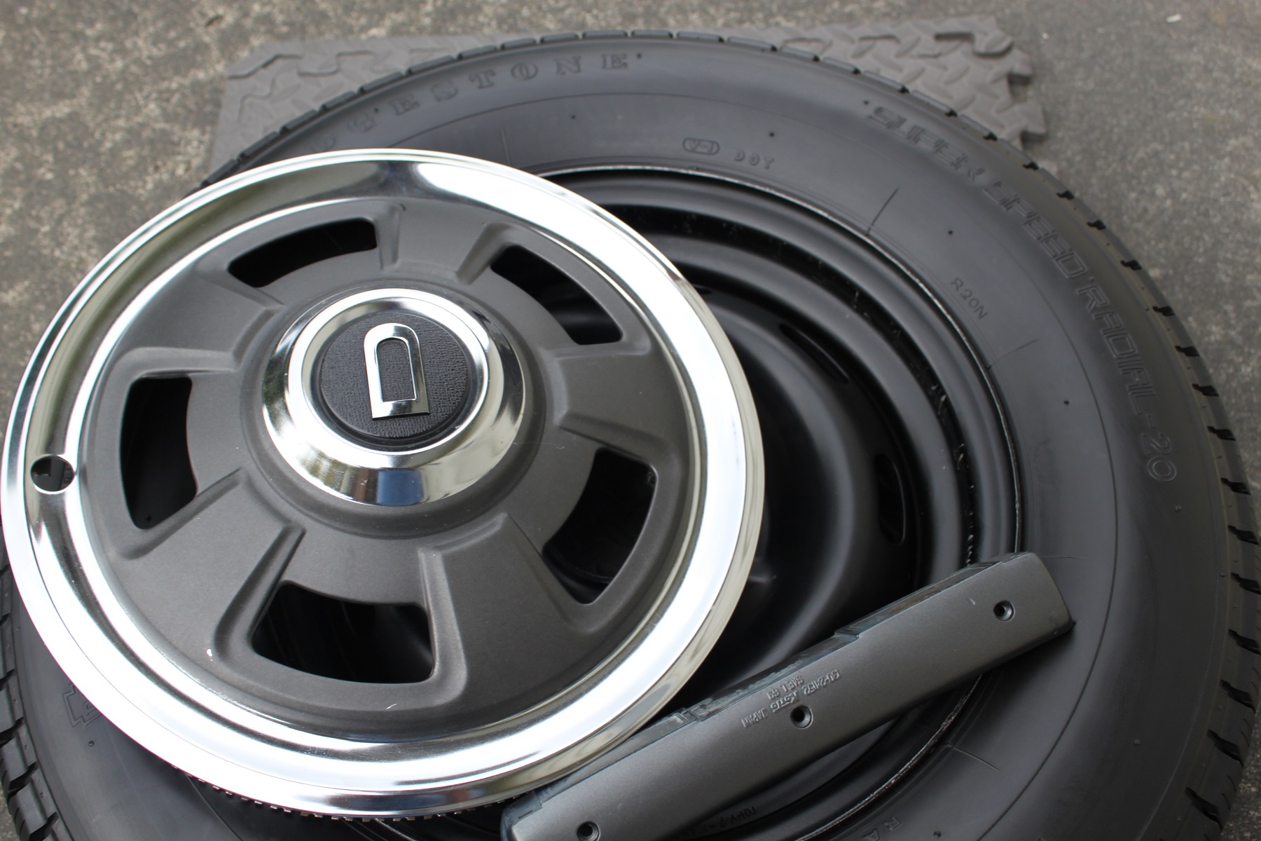

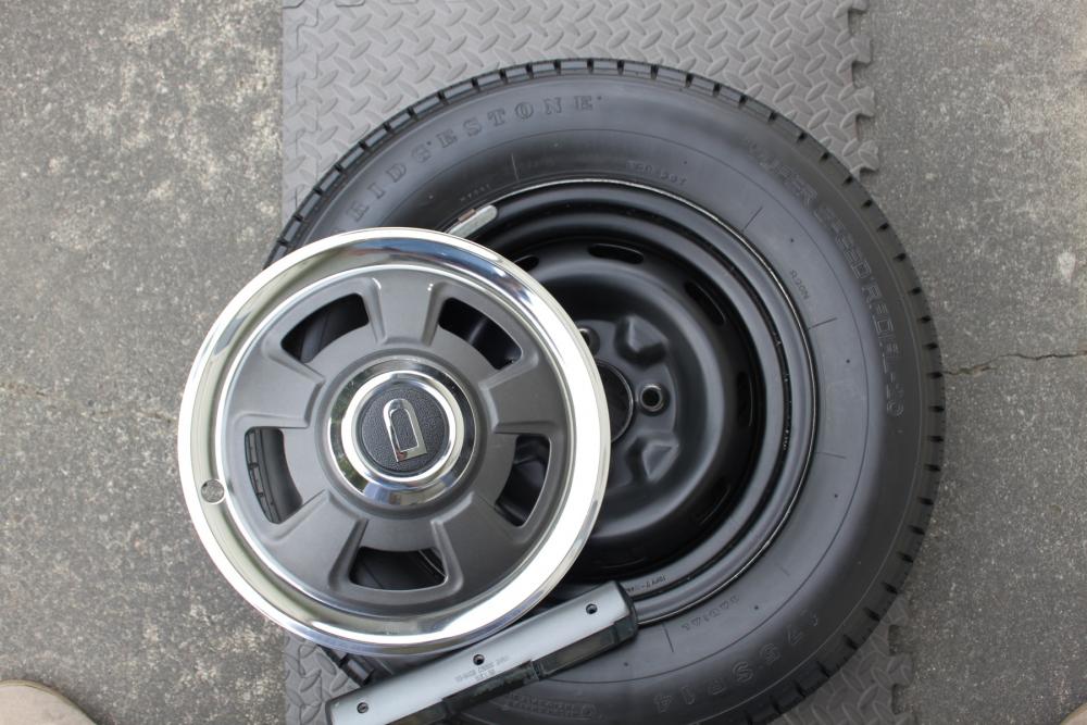

 For comparision to your results here are a couple of pics of one of my unrestored original hubcaps and my unrestored original spare tire/rim both dated coded early 1970.  Also in the pics is a license plate light that I recently repainted in duplicolor Dark Shadow Gray + DC matte clearcoat.  My wheel is definitely a semi-gloss black like the suspension componets etc.
HTH
Mike
Thanks for the contribution, Mike.
I guess what I'll do is get all the suspension bits and pieces and wheels done all at the same time. Should reduce cost significantly, but it looks like I have quite a bit of bead blasting ahead of me.
Though I question the "NOS"ness of the spare I have there. The 07214 spare is a bit "darker" and closer to a low gloss black than it is to a satin black like the NOS spare.
The last time I had something bead blasted or acid dipped- I wasn't particularly happy with the results- so I'm going to do most of the work myself this time.
So i'm going to presume that the license plate light housing is a lighter shade than the tail light panels on the cars I have. Or at least that's how it's going to look on these cars. Not sure if that's odd, or whatever. But it is what it is.
