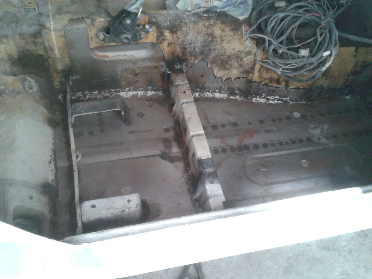

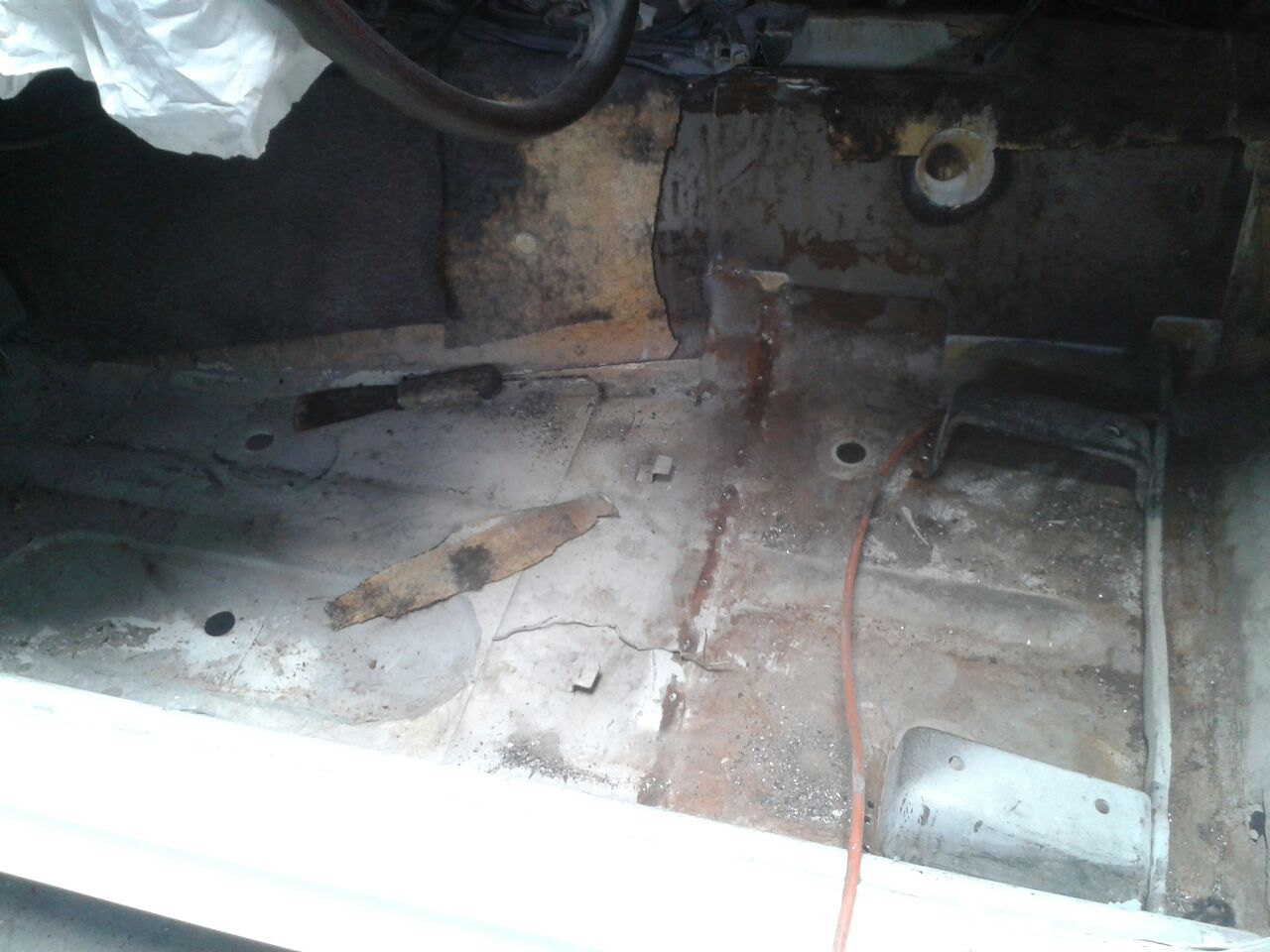

June 6, 20168 yr Author comment_496391 Okay i will go with a gallon of Lizard Sking Sound Barrier: http://www.eastwood.com/lizard-skin-sound-control-formula-1-gal-pail.html and then over it Jute Padding! Is the spray order the following: NEW FLOOR PANELS + POR 15 + LIZARD SKIN SOUND BARRIER + PPG 904 Paint and then the Jute Padding once dried? Does this apply to the doors, roof and quarterts, replacement Wheel área, etc? Link to comment https://www.classiczcars.com/forums/topic/55569-has-anyone-use-lizard-sound-control-as-tar-replacement/#findComment-496391 Share on other sites More sharing options...
June 7, 20168 yr Author comment_496463 On 06/06/2016 at 9:12 AM, Patcon said: I used both lizard skin products in the car I am doing the insulator and the heat shield. I sprayed the whole interior of the car, quarters, door interior s and the roof skin. the sound transmission is much better. I may still add some sound mat on top of this. The additional weight is not of concern for me... The paint shop is removing all the tar in the tunnel? Will POR 15 suffice as antirust and sound barrier? or is it better to pour por 15 plus a layer of lizard King sound barrier? Link to comment https://www.classiczcars.com/forums/topic/55569-has-anyone-use-lizard-sound-control-as-tar-replacement/#findComment-496463 Share on other sites More sharing options...
