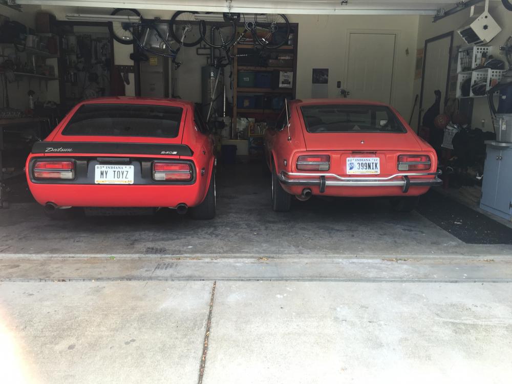

Posted June 8, 20168 yr comment_496489 Took on a client for some Z work- didn't have enough to do- 1972 Auto from out west- very rust free and original. Going to try and bring her back to glory Link to comment https://www.classiczcars.com/forums/topic/55592-new-project-72/ Share on other sites More sharing options...
June 8, 20168 yr comment_496510 Weird seeing the rear finisher body color. Is it 110 red with black interior? Did y'all load it onto a railroad car? Link to comment https://www.classiczcars.com/forums/topic/55592-new-project-72/#findComment-496510 Share on other sites More sharing options...
June 8, 20168 yr Author comment_496516 110 with originally white interior. Now just a ugly interior that has morphed black. Bad paint job that oozed onto finisher Link to comment https://www.classiczcars.com/forums/topic/55592-new-project-72/#findComment-496516 Share on other sites More sharing options...

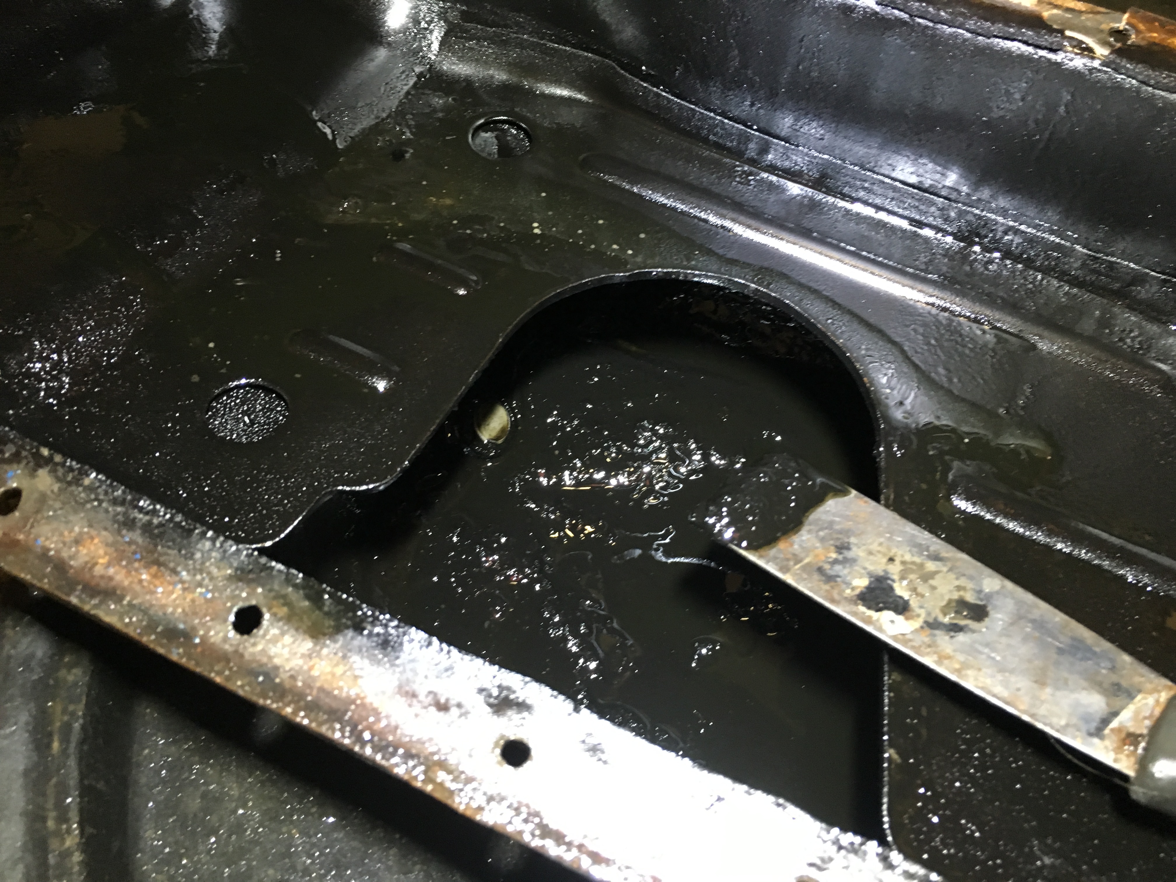

June 22, 20168 yr Author comment_497320 Well the owner came by yesterday to see the progress. I got lucky and found an owner that is realistic about this type of endeavor . An initial parts list of over 1k didn't buckle his knees or anything . Showing him all the damage from abuse he could understand . I said the abuse warranted me to drop the oil pan to see if it needed to be cleaned and... we we will really see how tough these motors are. I feel a little bad for Bo, but this is what you can get with an old car. I am going to tank the valve cover and oil pan and probably consider the oil pump at this time. Now if we run a detergent of some kind in the oil it won't stir up this sh!t Link to comment https://www.classiczcars.com/forums/topic/55592-new-project-72/#findComment-497320 Share on other sites More sharing options...
