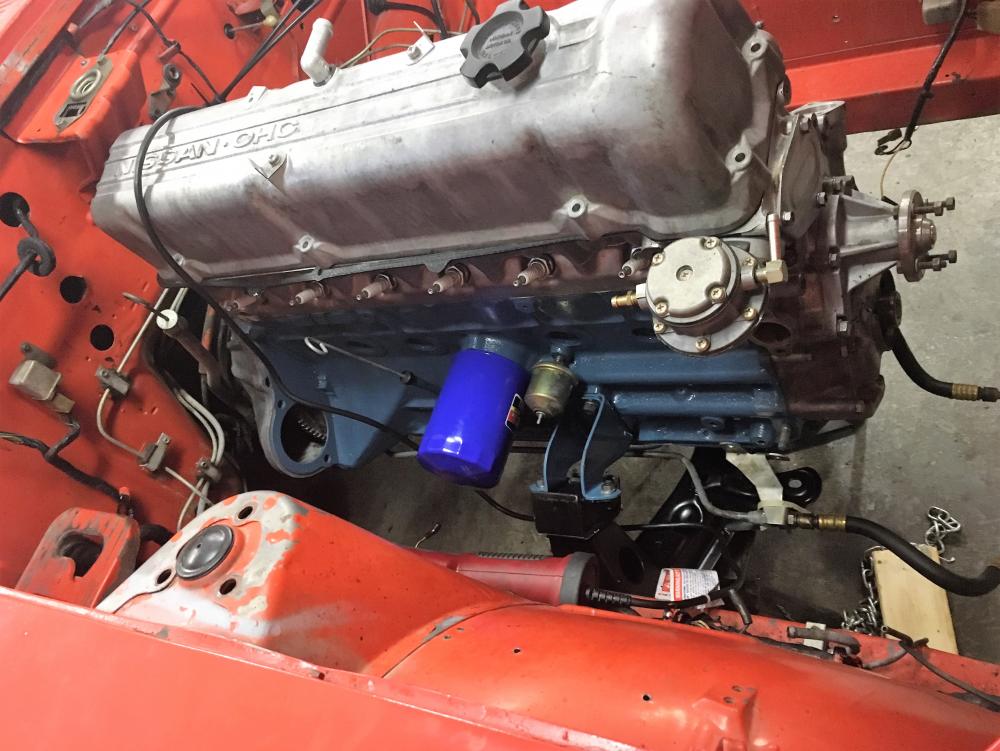

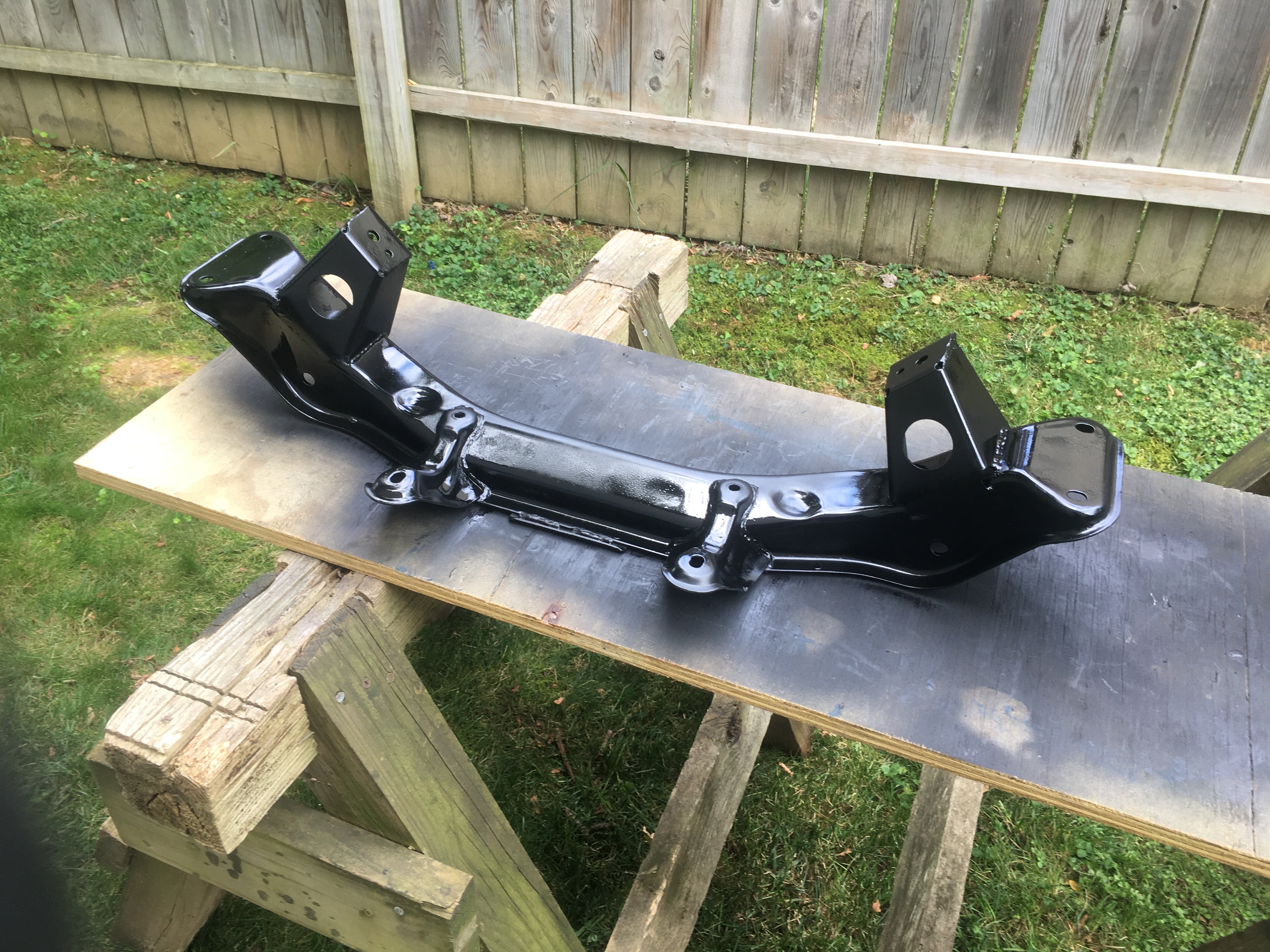

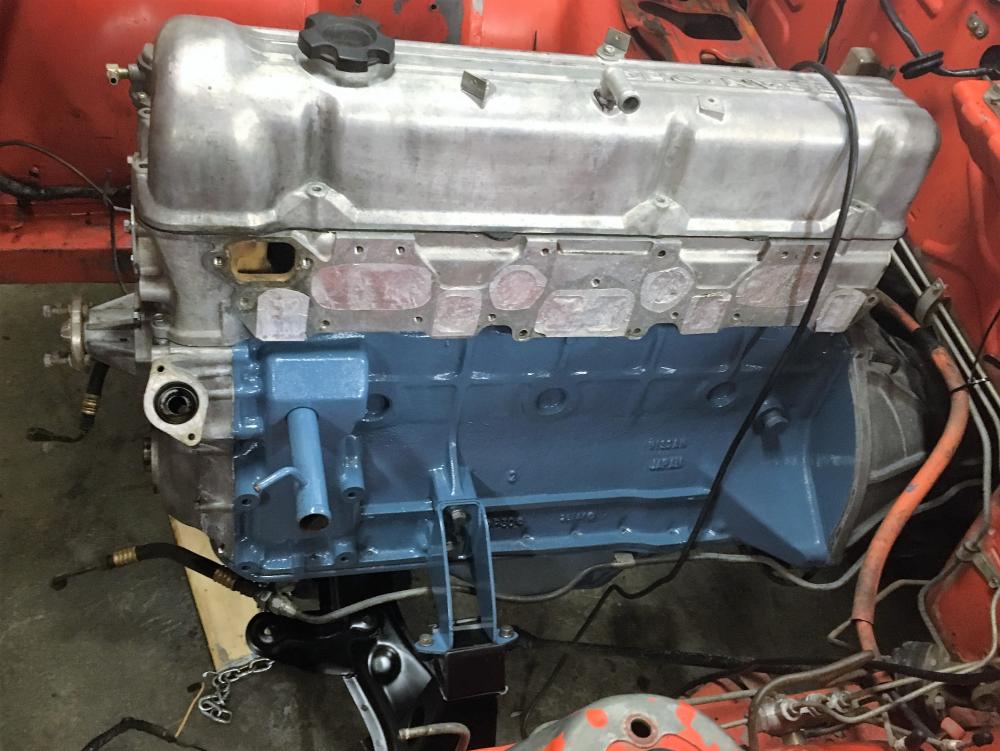

July 3, 20168 yr Author comment_498020 Well I got about half of my pictures to load. Haven't been sharing much because I have been truly frustrated with posting on the site. Maybe I'm just getting old and cranky but I can't seem to get around on the new format as easily as the old CZCC. I am glad Mike makes all his efforts and glad go have the site available. Most of the time I can't get the I-phone to load pics and even off of my laptop I have issues. As you can see I have been full tilt on this project the last week. We considered powder coating all this stuff, but the weather was really good for painting and I had the time to get it done. The other important factor is that stuff was mostly just dirty-very dirty. The rust was negligible , so a good cleaning, sanding, por-15 and paint at it all looks pretty again. Another reason to spend more $$ and buy a car out west and have it shipped if you are considering a project. Even the hardware cleaned up on this car to the point that you would swear I replaced it. I had the oil pan and valve cover tanked at a local machine shop so they are spotless. Now I feel comfortable running some high detergents and it will all drain out. The engine was brushed on Por-15 . I think the engine kit is well worth it when you see how well the paint covers. They give you too much color - a pint is enough for 3 engines. I tried some rattle can Por-15 chassis paint it is also $$, but it covers great and the chassis coat looks superb! I have thousands of dollars worth of new parts to install--- now that the dirty work is done. This will be much more enjoyable. Damper Doc refurbished the balancer and its ready to go on. The crossmember went on with new Nissan motor mounts and soon will have a refurbished rack attached. I need to press in the control arm bushings and assemble the front end. I removed the strut inserts to find some Monroe inserts , so obviously some one updated this. The inserts seem to be in working order and we will run with that for now. New ball joints, tie rod ends, bushings, tension rod rubber bushings, new calipers and rotors should make her stop and go much better. Link to comment https://www.classiczcars.com/forums/topic/55592-new-project-72/?&page=2#findComment-498020 Share on other sites More sharing options...
