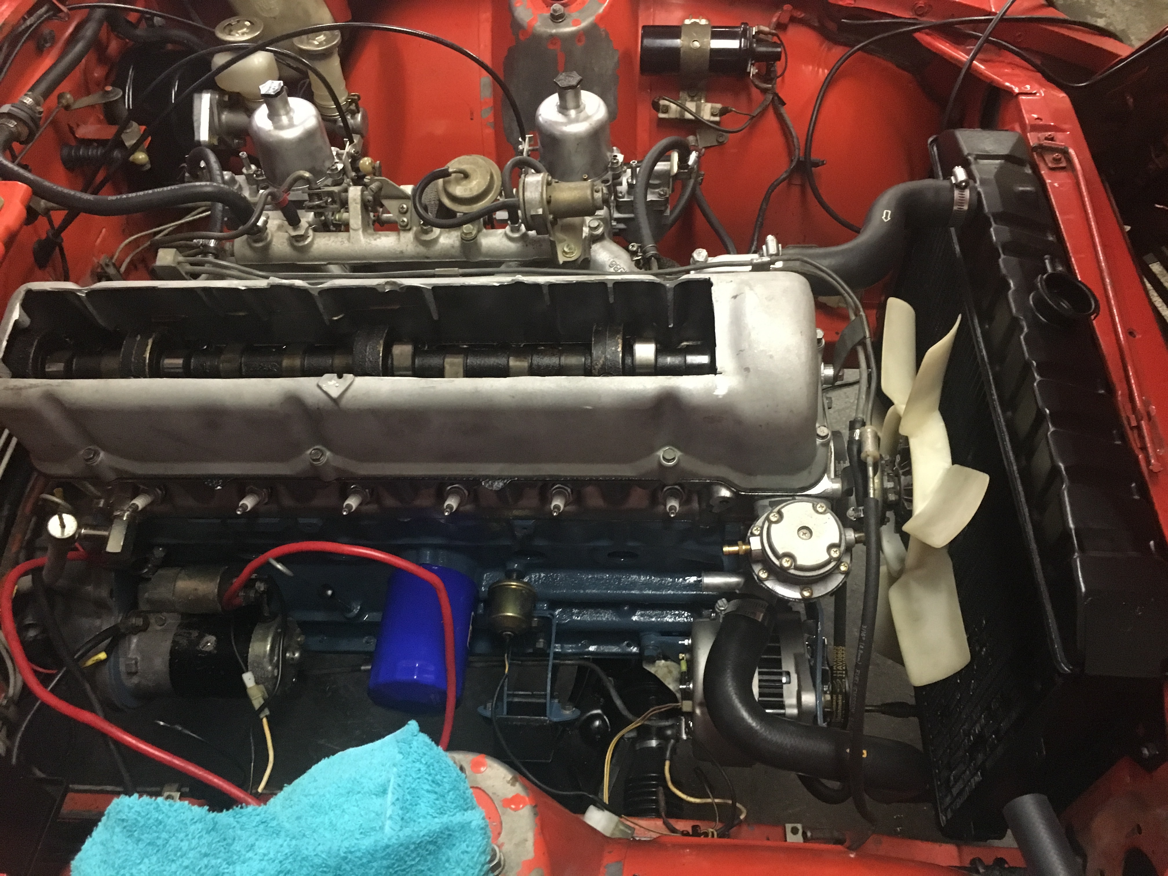

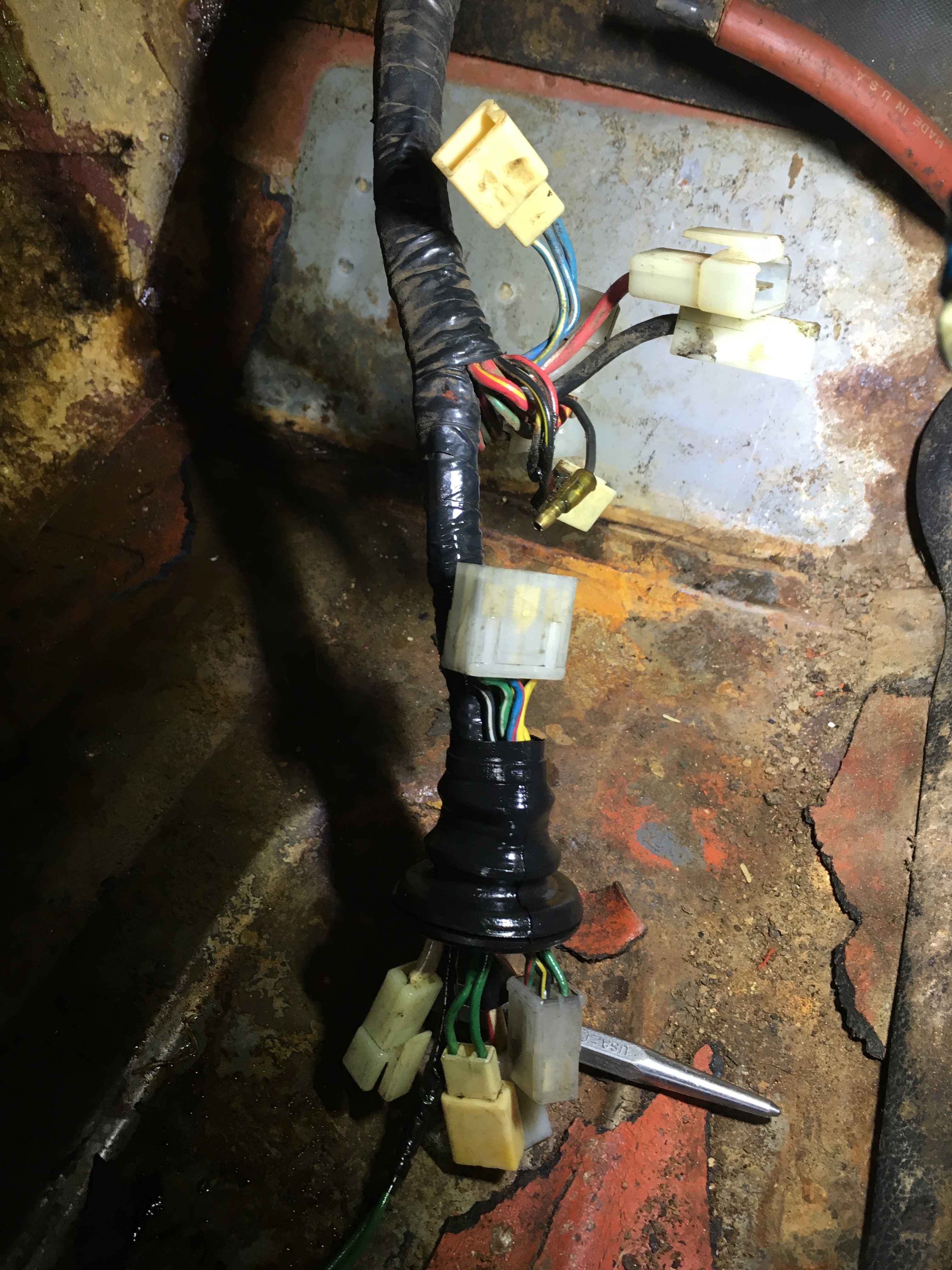

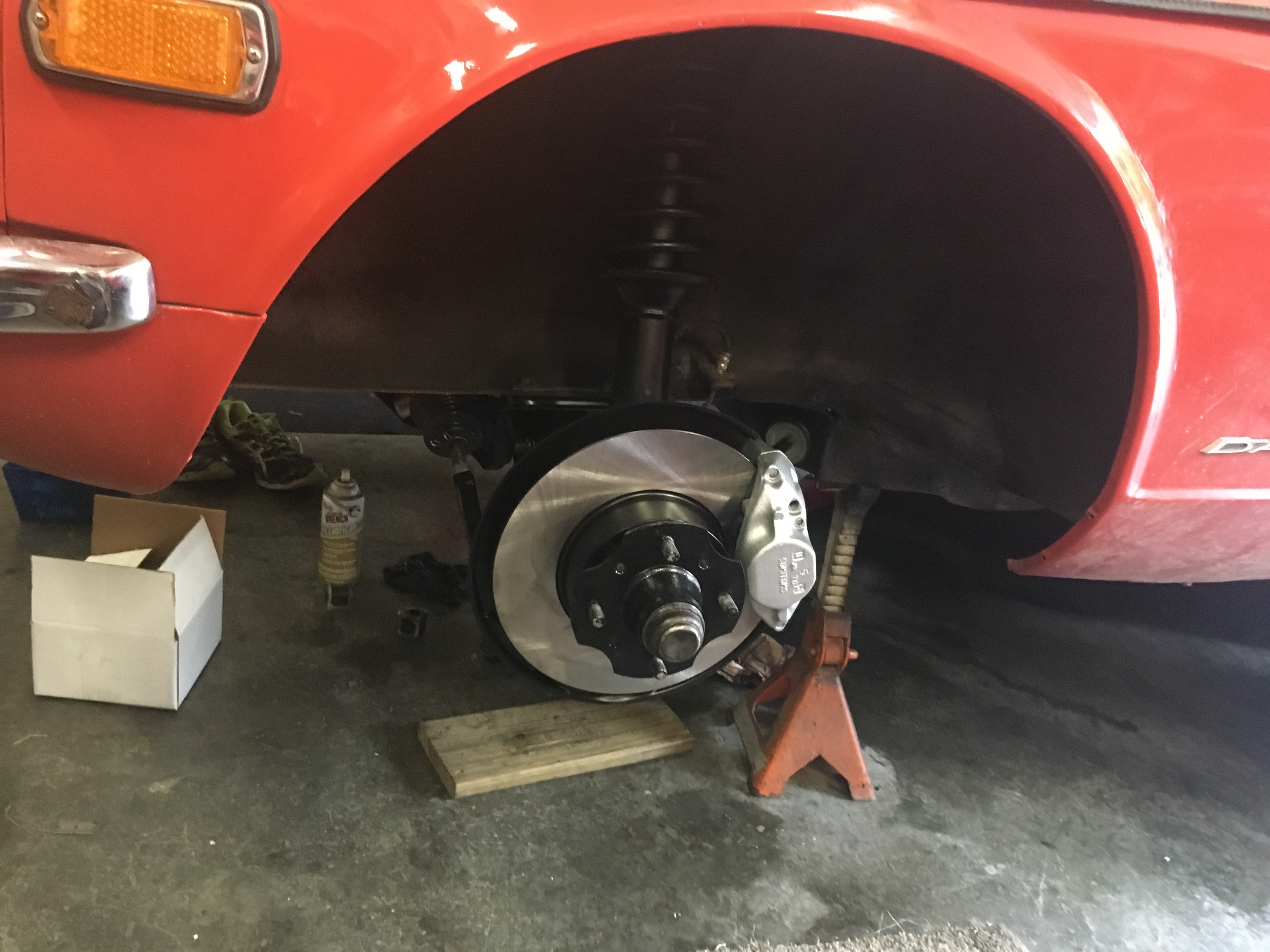

July 23, 20168 yr Author comment_499353 Thanks so much for the inside tip! Ordered several sets and they were just as you stated! Thank you Mike for getting the pic uploader fixed I'm about read to restart this thing , but the fuel pump had a different idea. PO had installed the pump without the phenolic spacer and I think it did the diaphragm in. It doesn't seem to suck hard enough to draw the fuel. Still amazed me that the owner drive it here and it made it. Still waiting on new cam spray bar anyway. I was hoping to set floats up with my new float sync tool, but got everything else ready to go- I think. Plenty of other stuff to do . Front suspension is about done and brakes are bled . Put the new wire harness boot on. It reminds me of those nature vids of a snake swallowing something huge. Drained the diff fluid to change it out to only find that I couldn't budge the fill plug. So now I have an empty diff . I am redoing the bushings on the rear suspension so I guess I will just drop the diff out at the same time Link to comment https://www.classiczcars.com/forums/topic/55592-new-project-72/?&page=3#findComment-499353 Share on other sites More sharing options...
