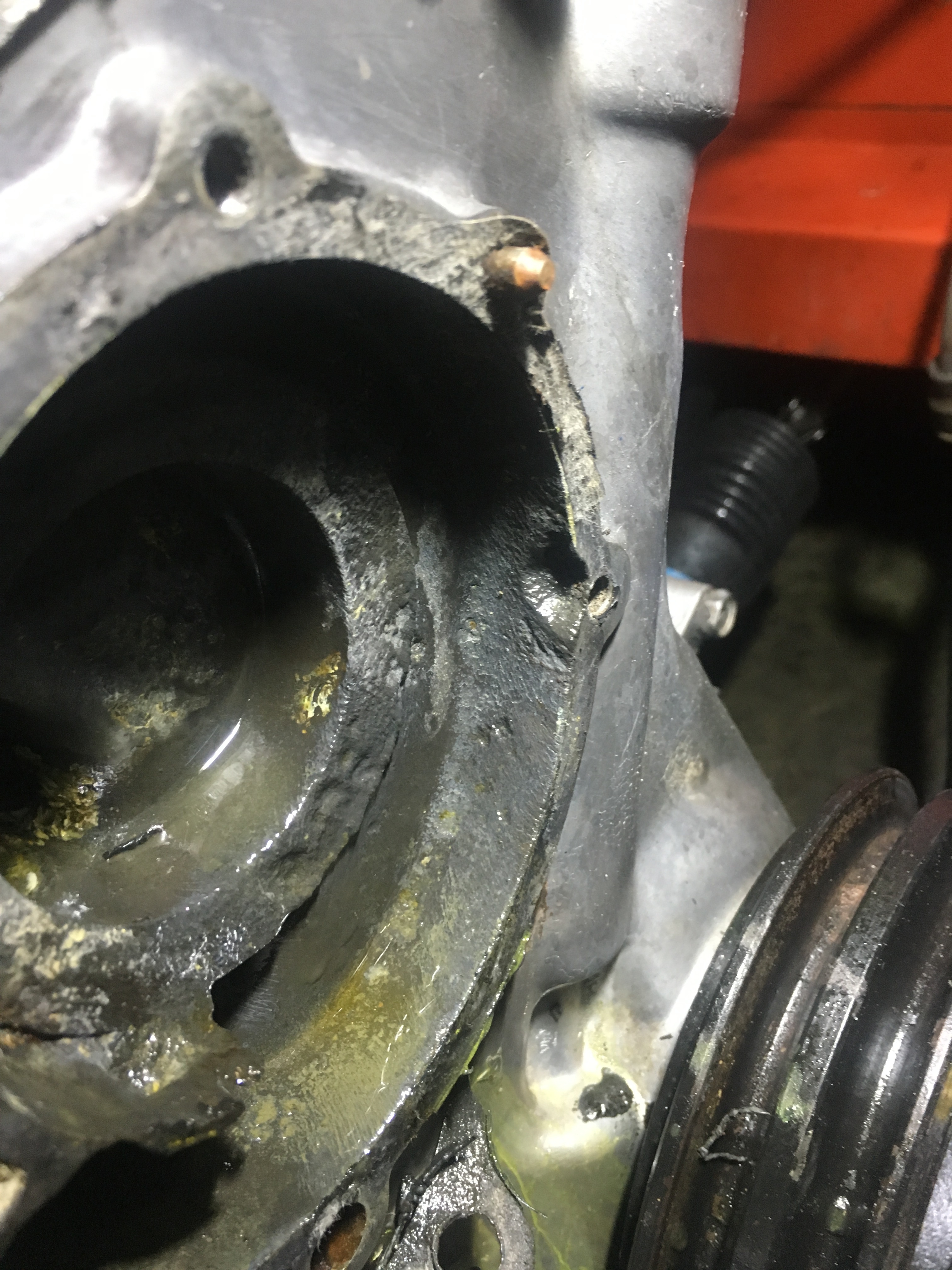

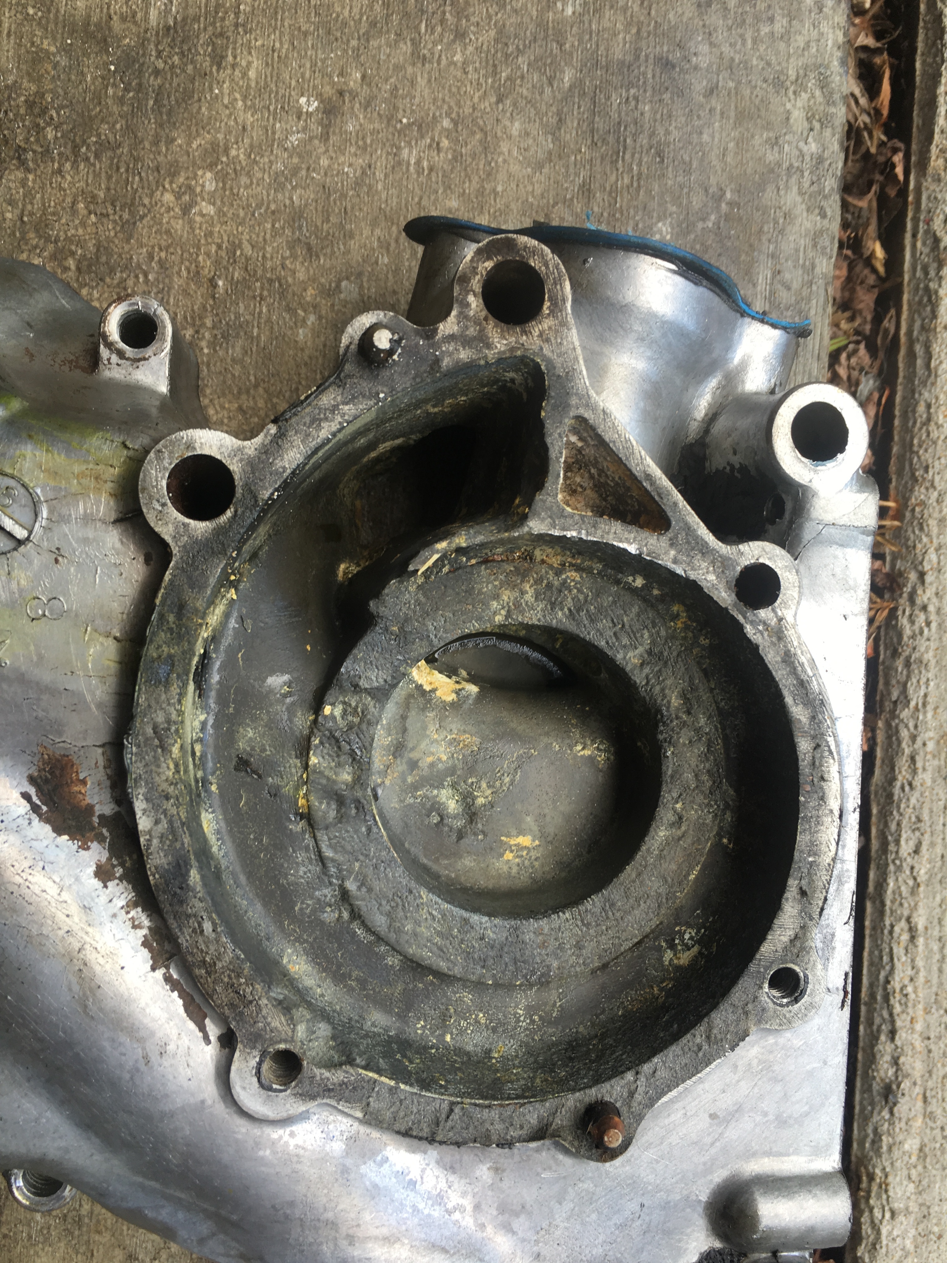

Well not a great day for Bo's ride. It started out innocent enough to replace the water pump that have out. Rust bolts were expected , but the corrosion on the timing cover wasn't so much. When I pulled the pump off I could see that the years of water had ate away at the pump cavity. Almost ate all the way thru near a bolt hole . It was a matter of time before it leaked or worse. I told Bo I was pulling it since I already had everything drained.

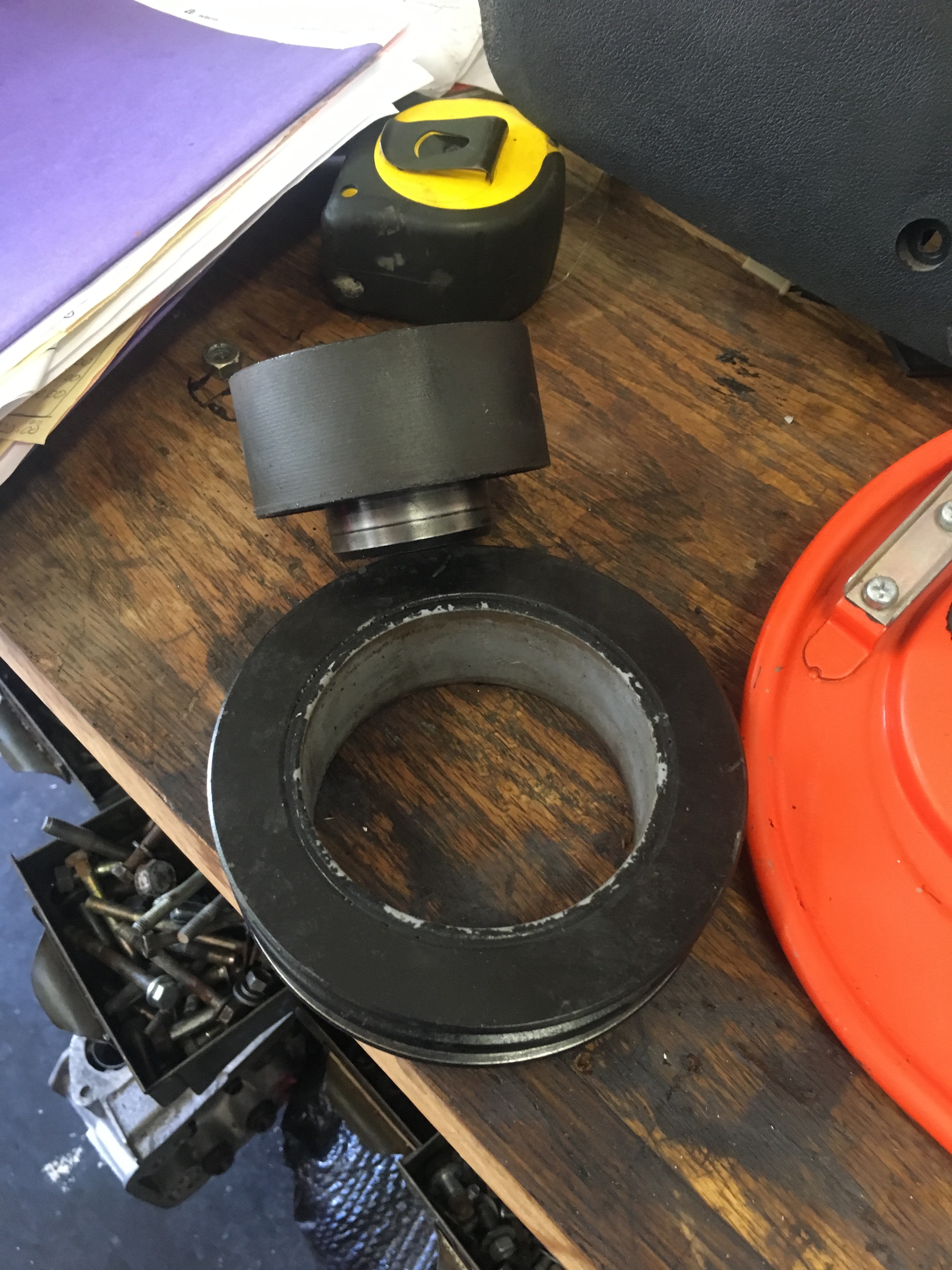

Went to pull of the harmonic balancer and it came off in 2 pieces. This is the one Damper Doctor just rebuilt.

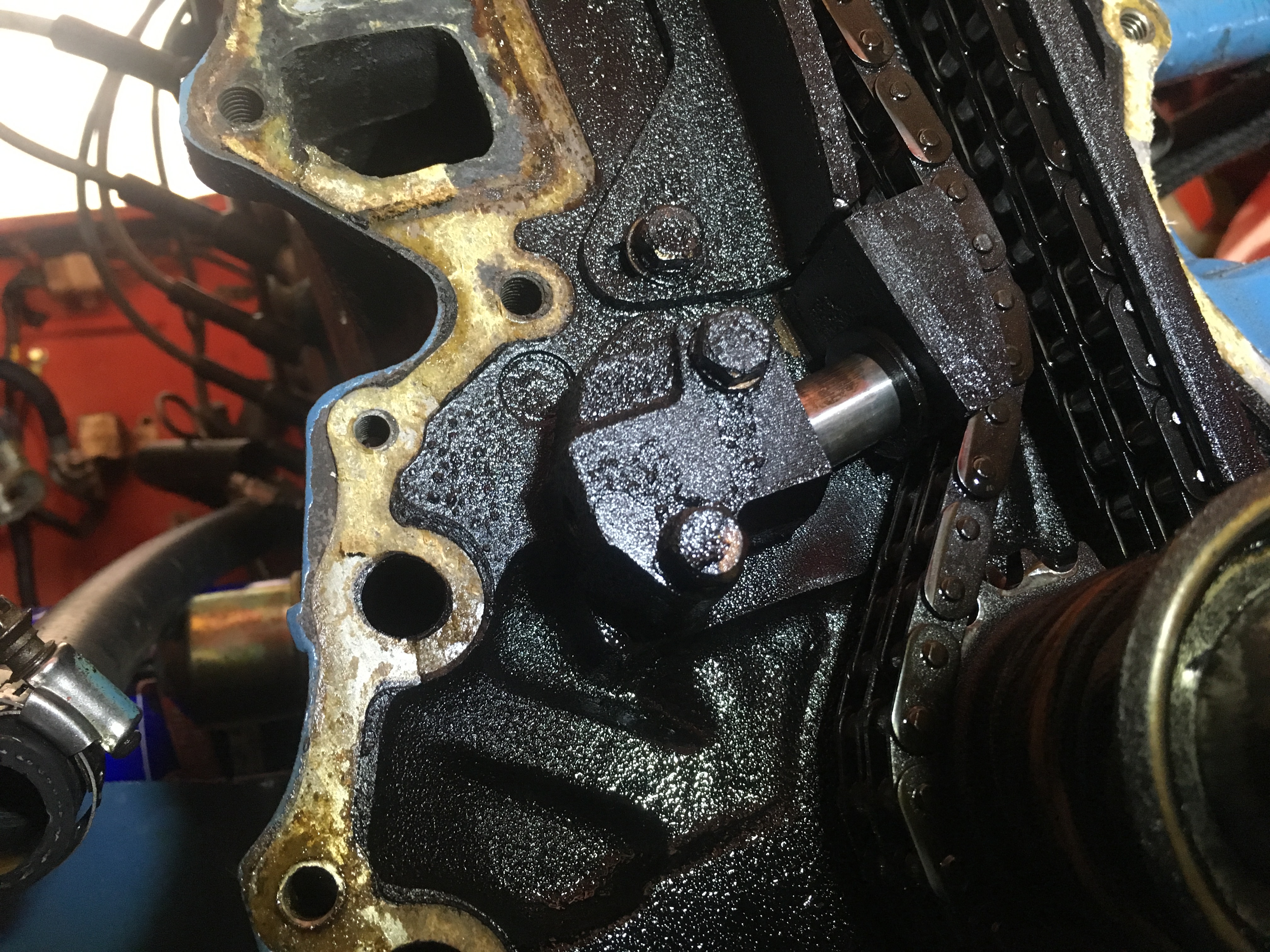

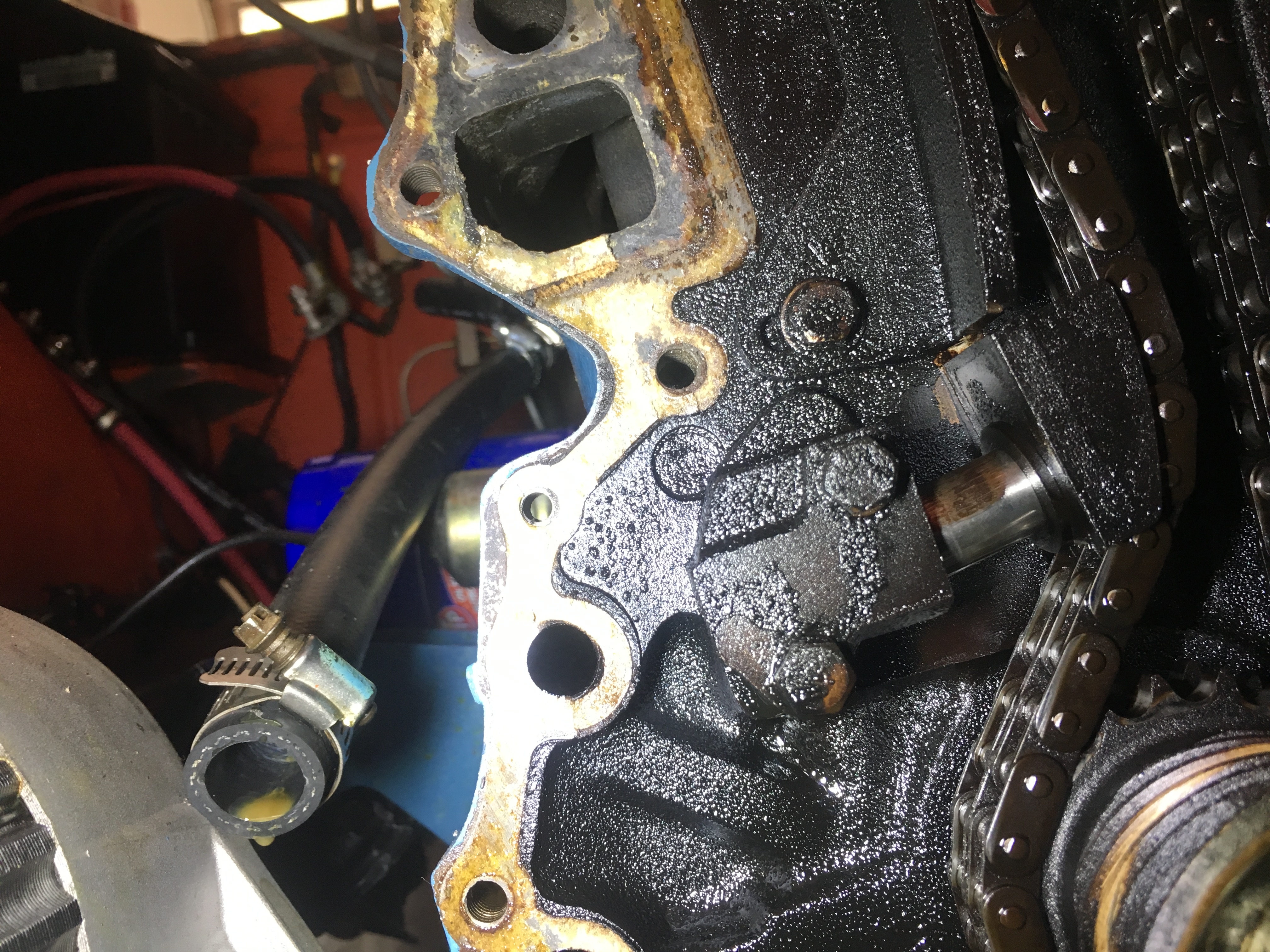

I actually got the cover off without much fuss and didn't tear up any gaskets . Only to find the timing chain issue.
In the end though, if the pump hadn't gave out I wouldn't have found these other issues that would have detonated at 60mph on a back road leaving him stranded- so a silver lining .
Ordered a new chain kit and damper got sent back to the Doc. He seemed to know exactly what he did wrong when I talked to him briefly. He apologized for the issue

 A while back we ran water pump corrosion up the flag pole. As I recall we didn't come up with a consensus of opinion but the question was posed about the Z alternator being grounded through the adjuster into a water pump bolt. Over many years corrosion in the bolt threads prevents a good connection and it goes looking for an easier path through the water pump. Anyone think a dedicated ground wire for the alternator might alleviate the water pump corrosion? Well, that and regular maintenance to the cooling system. I took a pump off my 260 that had holes eaten into it so big that you could stick your fingertip into them. It must be a fairly common problem. Thoughts?
That's a little worrisome, considering the cost of the original job and the potential damage that could result from an in-service failure.  Hope he's paying for the return shipping costs, if not refunding you for at least part of the original charge.
The 280Z's do have a dedicated ground wire.  I thought all of the Z's did, but maybe not.  People often don't check their ground circuits though.
madkaw, how did the pump impeller look?  Just curious.  And did the Damper Doctor say what he thought he did wrong?  Bad batch of silicone, didn't prime the metal,...?  Kind of concerning.  I wouldn't send him anything until I heard the story.  Just me.
The impeller looked okay. It was not original since it was a stamped steel one.
Damper Doc did the one on my car and it hasn't flown apart yet. Going to give him a chance to see it before I ask why.

Any how, I got the car back together and put her thru her paces out on the road . It's a bit noisy with no door seals but she has new life with a timing chain that isn't ready to fly off.
