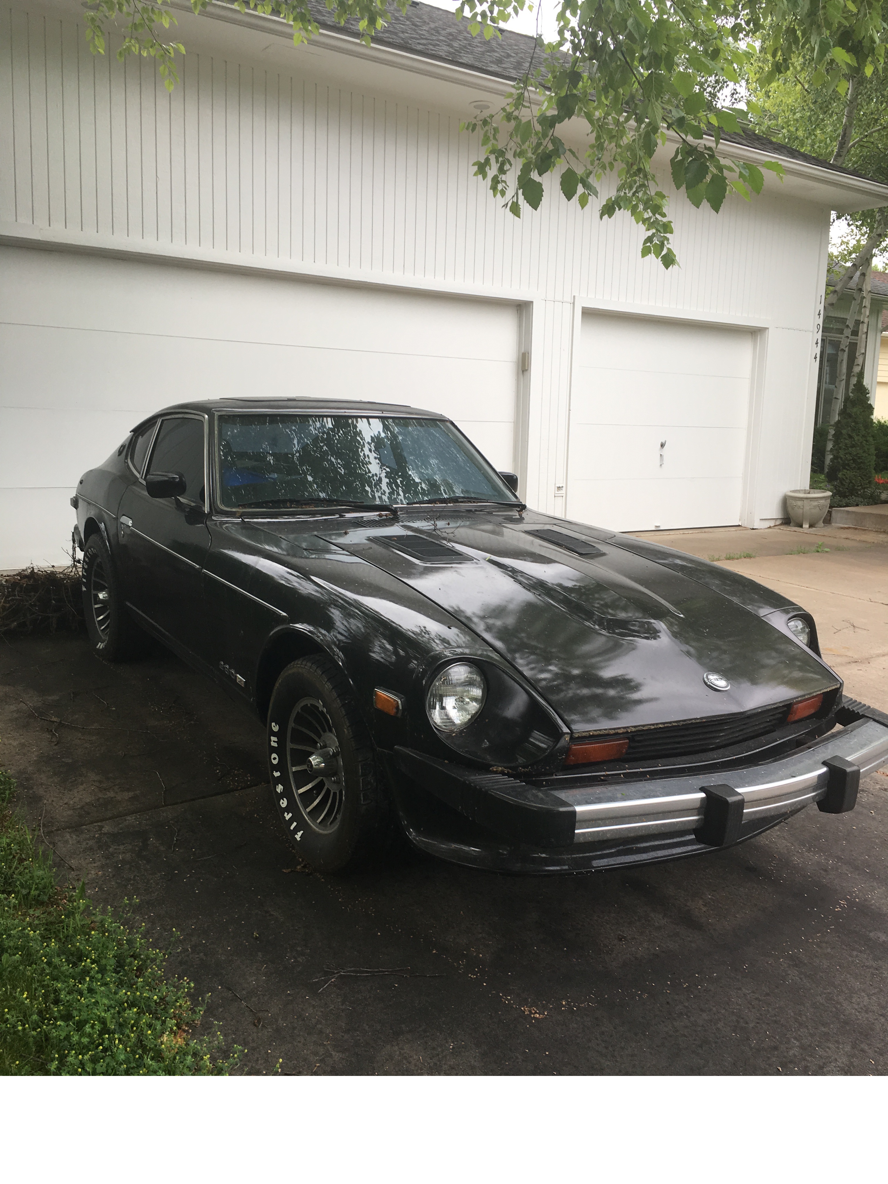

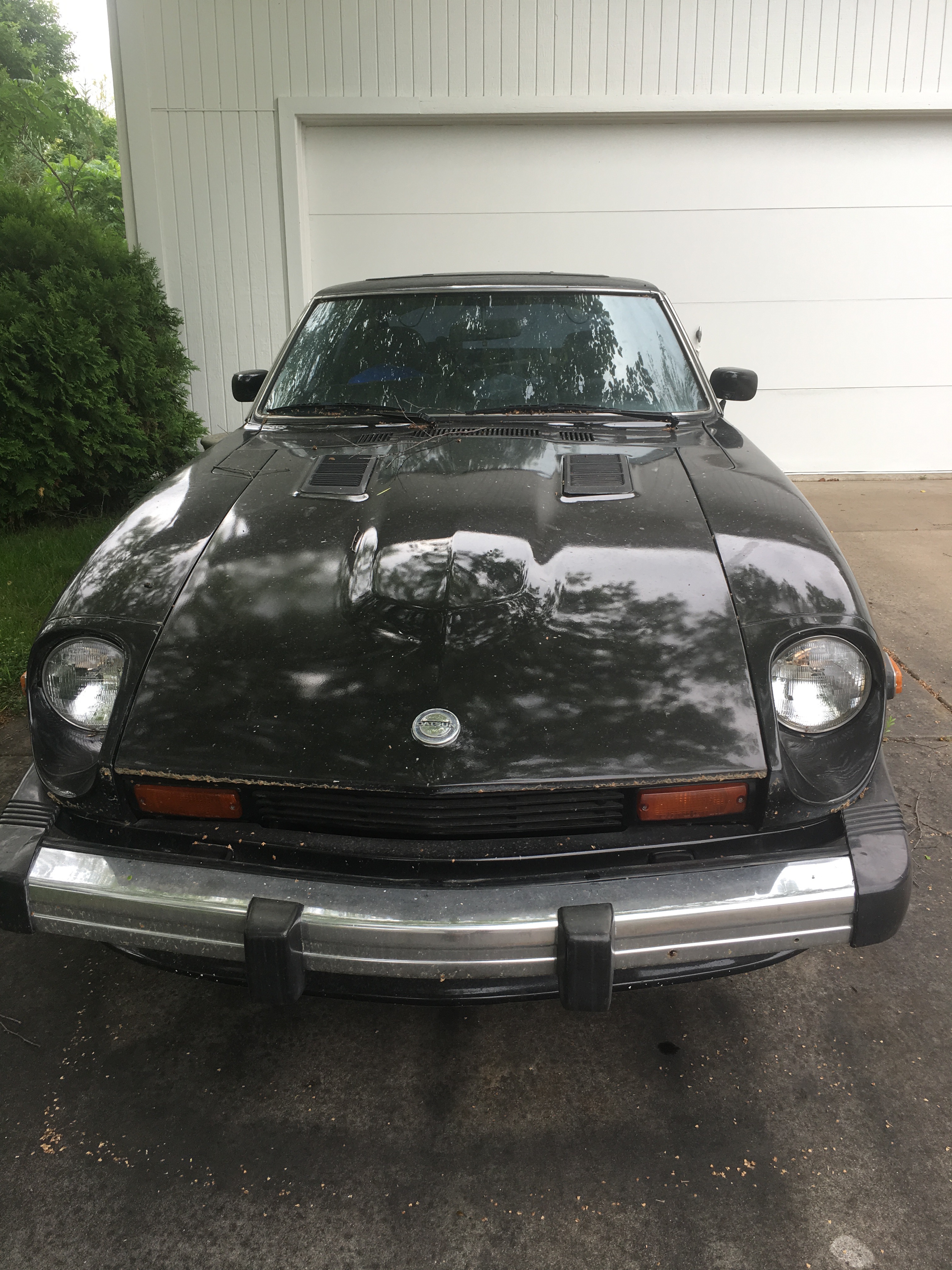

This is my first time on the forum so thanks for helping me out. So I need some advice; my neighbor is selling his Datsun 280Z for $1,500, but obviously it had some major problems. He said the air conditioning and speedometer are broken and the engine stalls often and sometimes makes a popping sound. Is it still worth buying? How much do you think the repairs cost. I don't care that much about the AC but the engine and other problems are concerning.

Pictures would help but a running Z for $1,500 sounds good to me. I paid 1,400 for my '77 five years ago. Pulled the motor and rebuilt it also a new fuel supply, tank pump injectors just about everything. Runs great now after another $2,000. Are you able to spend at least another thousand? If so, buy it.
If it's popping it has a vacuum leak most likely. If it won't stay running it has a fuel delivery problem.

if you consider the amount of things you can learn from working on the car, i think $1.5k is reasonable price... (plus things its going to need to fix it up) was the car sitting outside? you might want to look at www.zhome.com and go to the what to look for sections, and the common rust sections. Might be able to get flexible on the price.

 Mechanical issues are a walk in the park in these cars. Mechanically they are near bullet proof compared to others of this era. Rust and Bondo are the two biggies to watch for. When you find either, do a realistic estimate of your; wallet depth, time frame, your abilities and your desire to undertake the project. That said the price is right unless the body is badly rusted. @heyitsrama is right. Check at zhome.com. A lot of very useful information about what to look for and where to look for body damage when shopping for a Z. The price is great if all else is OK.

its all about the rust and what you want in the end. If the body is sound then its a great deal, its a simple car to work on. If you are going to have a nice one you need a garage IMHO to store it, else the old rust monster will come and take hold. They are a lot of fun to drive. Hope it works out for you.

 The car is in Minnesota? Major rust issues may be lurking on the underside.  Proceed with caution

If it's generally rust free (a big, important if!), then it sure looks like a good deal based on the few photos you've posted.  Cars in worse condition go for 3-4x what he's asking and prices have been going up. Worst case, if you decide the car just isn't your thing, you can sell it and make a few bucks.
What does it look like underneath? How about in in the engine bay, especially around the battery tray and brake master? Is the car usually parked outside with the nose going downhill? If so, watch for rust around the hatch sill.
