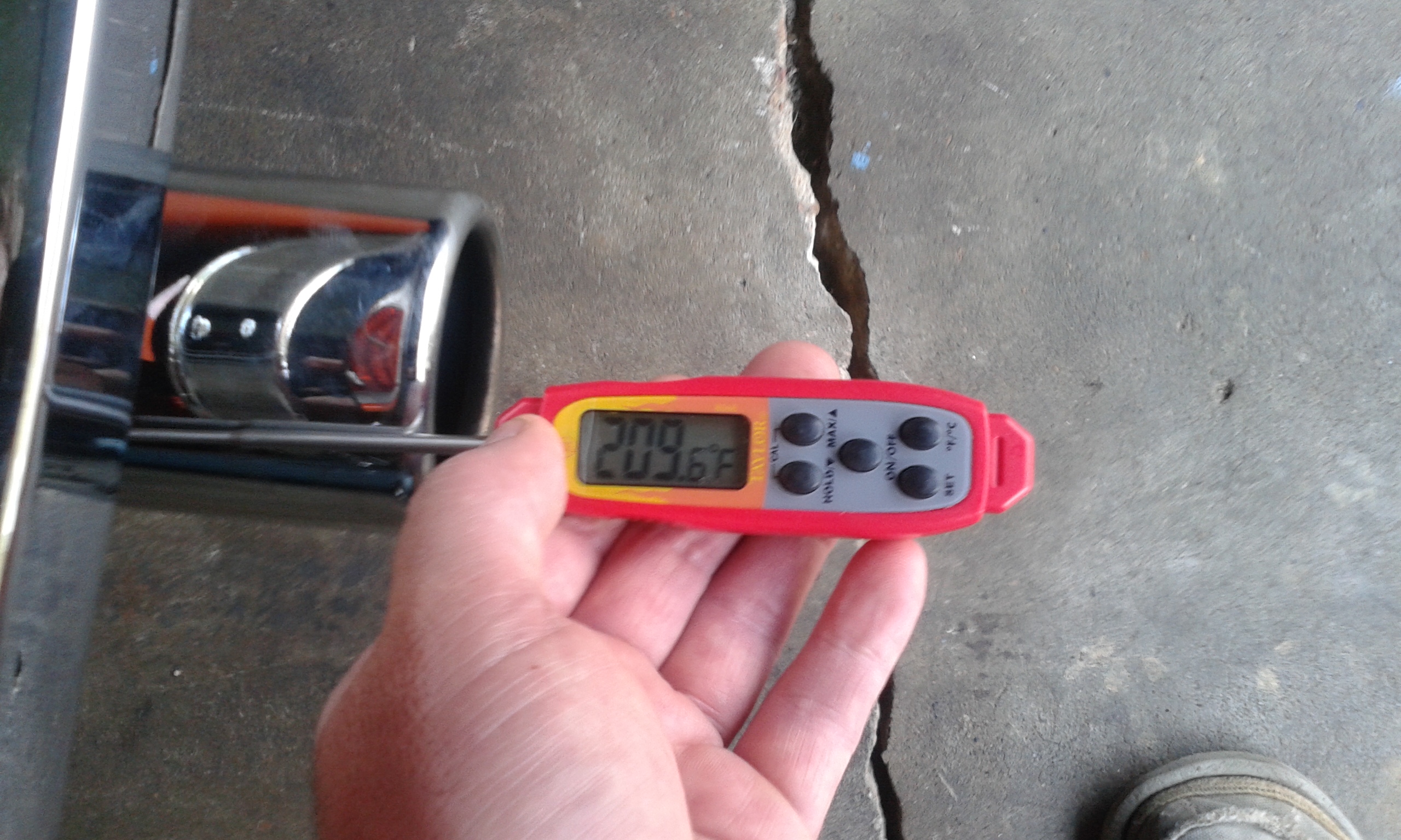

It hasn't ever felt hot enough to cause damage but I've not grabbed it after any long running time. I'll keep check on it now that it's so close to the paint. Thanks for reminding me.  It sticks out kinda goofy far but I don't mind as long as it doesn't soot up the rear.  It does spit out a few drips of moisture, I wonder what causes that?

Condensation, as long as you don't take too many short drives, if the entire exhaust system gets up to temp so that moisture is driven out you'll be fine. It's short trips that rust out exhausts.
Oh okay, I only see it when I'm warming it up in the garage.  Thanks, I'm about to hit the roads this morning and see how my new speedo gear acts.
That thing blows out more air than anything I've ever had, if an engine is a big air pump then mine is working fine.  My air box is still off though?
Boy oh boy was I wrong and that's rare. LOL
That tip was over 200 degrees when I checked it but the painted skirt above it was only 125.
Speedo is much better thank goodness, I would've gotten a speeding ticket had I left the 19 in there. I was turning 3200 rpm at 80 mph.  Now 2500 to get 80 and I was in a pack of cars on the interstate where everyone runs 80 mph.
