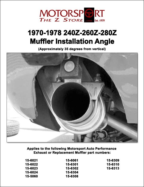

Have you tried flipping that Z shaped pipe at the rear? My outlet right before the muffler is all the way up. Your's looks lower. Good luck, you'll get it I'm positive.
You have the flanged kit. Mine is a slip fit, so the pipes can only go one direction. I have the pipe right against the trimmed diff and the muffler is too far outboard. As I rotate the pipe up, the top of the  muffler is tight to the body, yet still is outboard. The long center pipe is touching the steel NVH damper bolted to the front diff crossmember.
I will put the muffler back on and take pics this morning.
5 minutes ago, siteunseen said:
That's about the angle i tried. My outlet is at least an inch to the left compared to that pic. The left side of the muffler is against the body. If I move it to the center of the cutout, the pipe is below the diff and very low at the front diff crossmember.

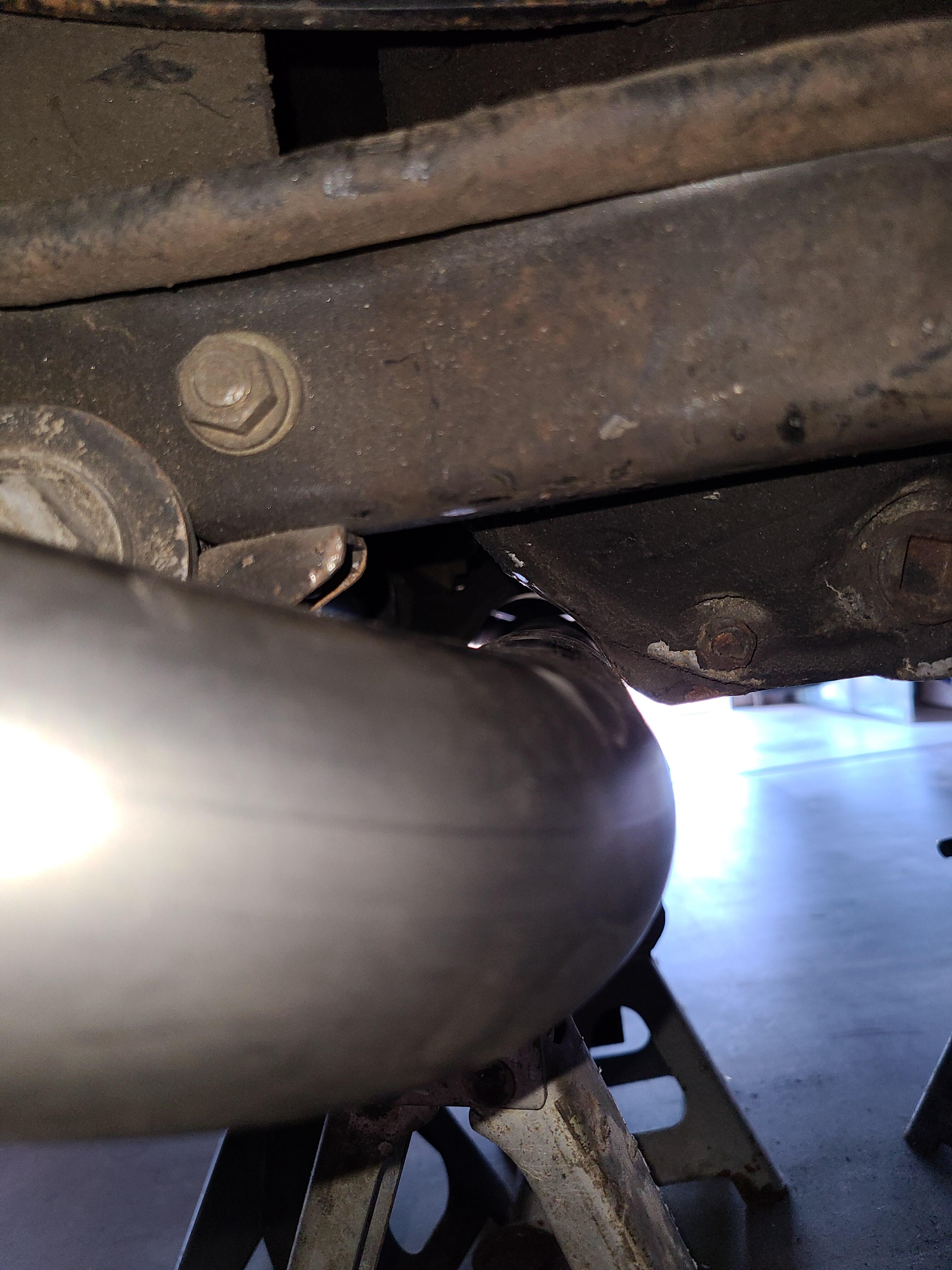

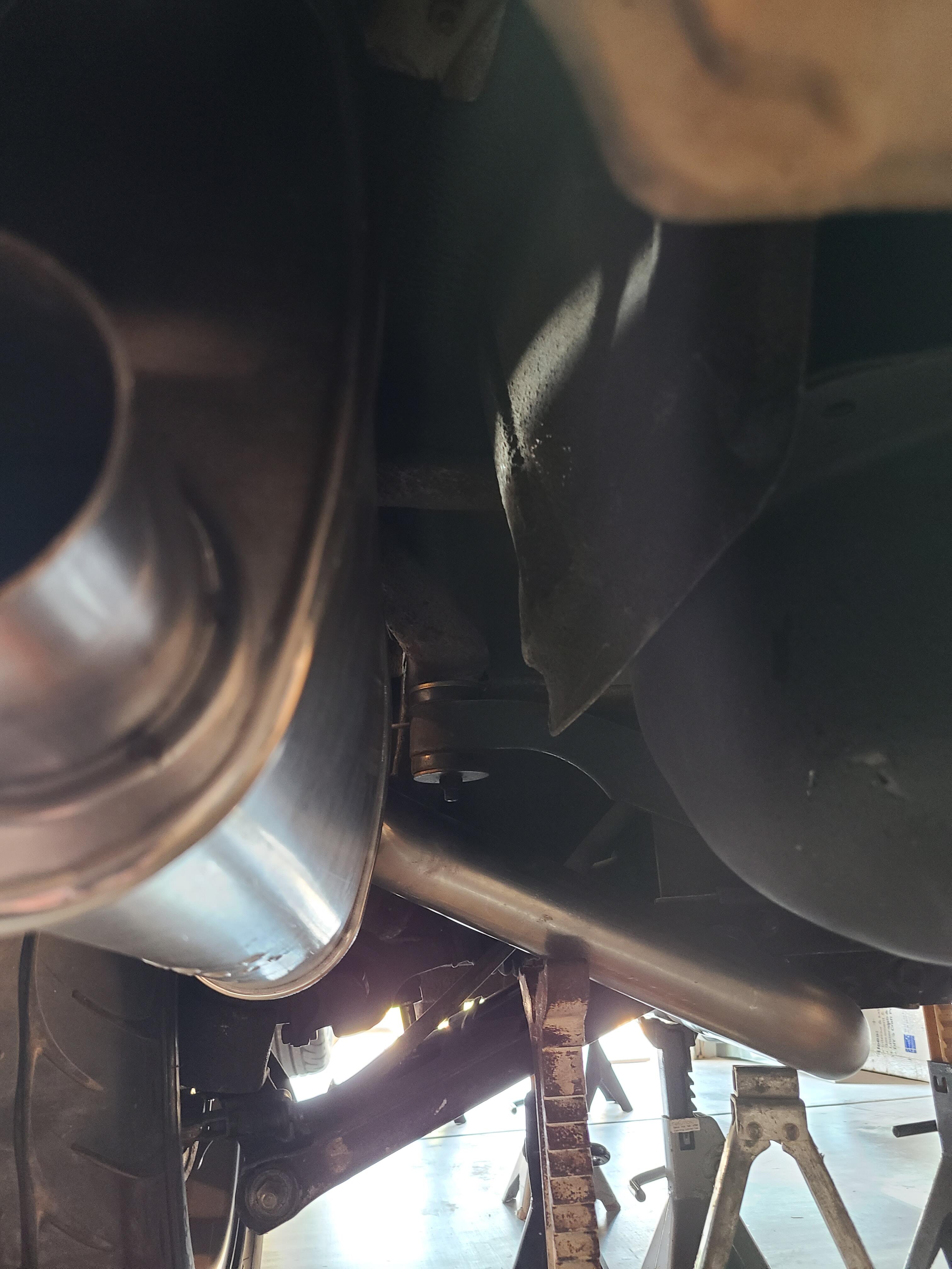

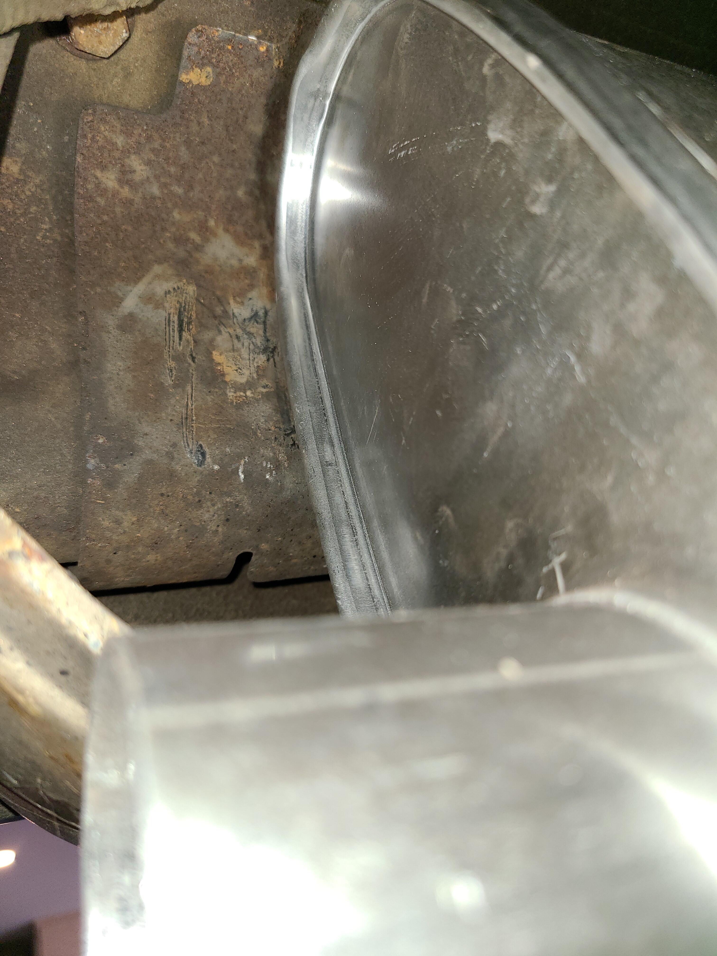

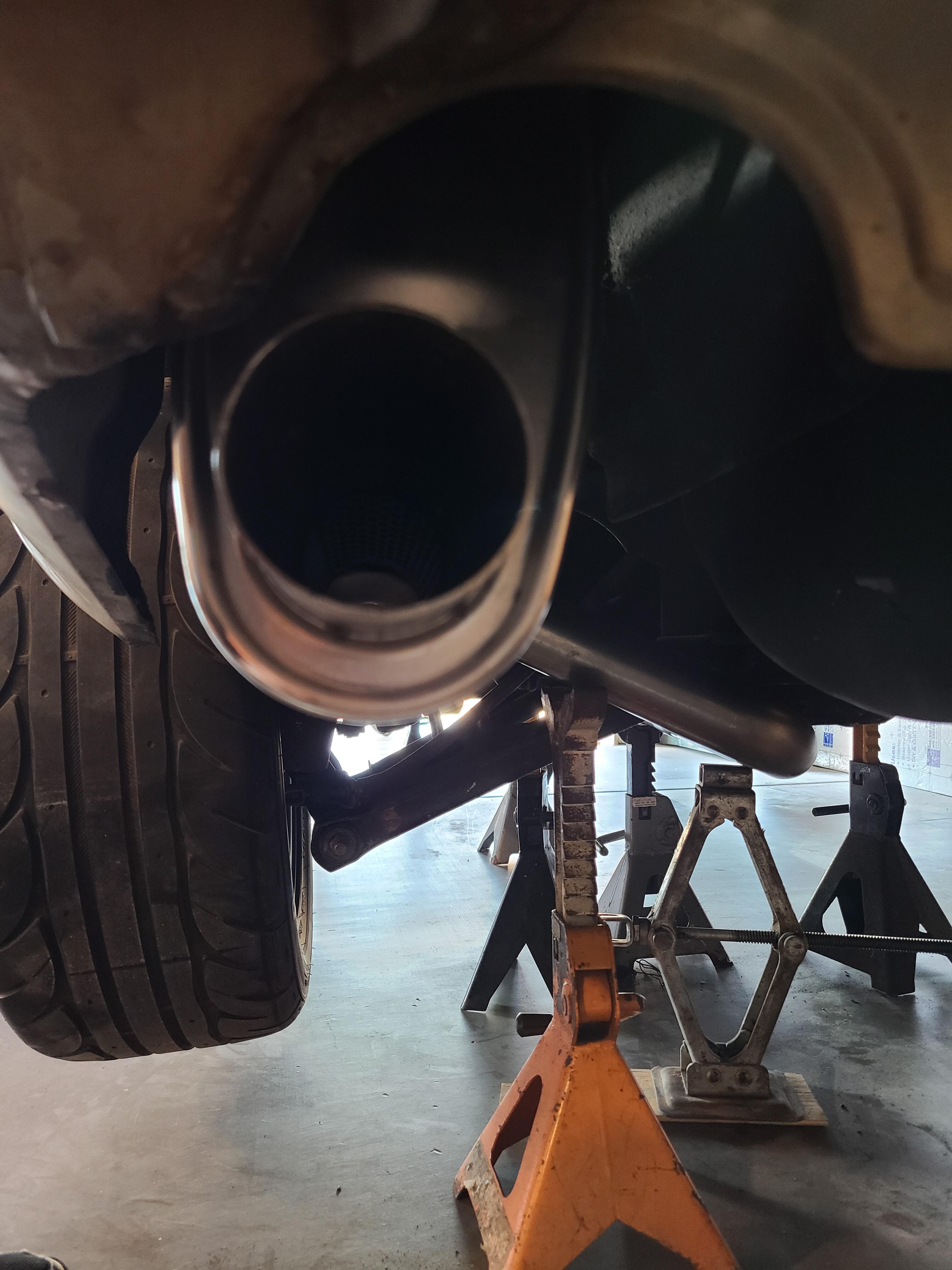

Here are some new pics. With the system installed as directed, the muffler is against the body and will not rotate to the left.
I have no choice but to cut an inch out and reweld the pipe.20230917_073044.jpg20230917_073101.jpg20230917_073148.jpg20230917_073225.jpg
