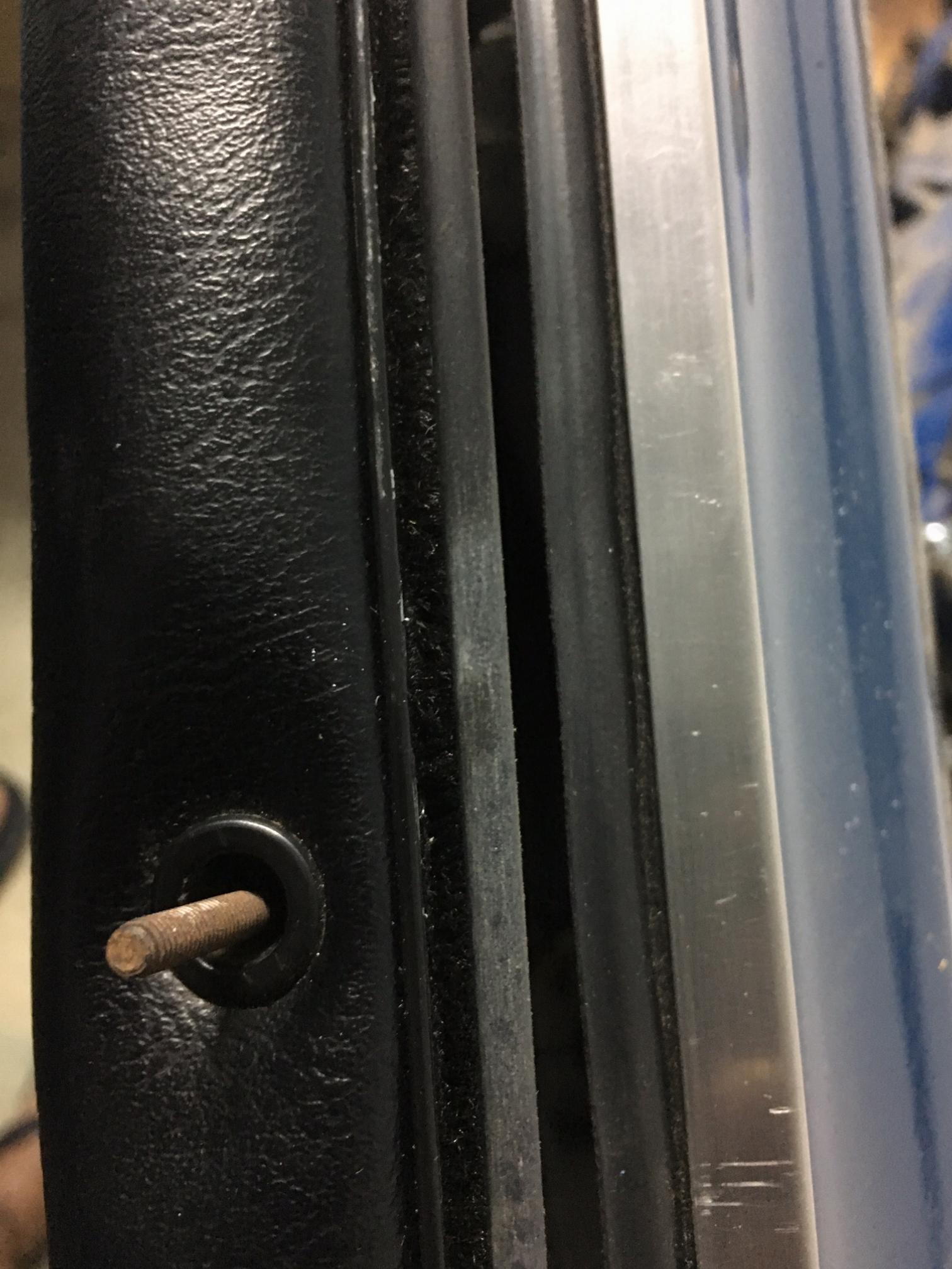

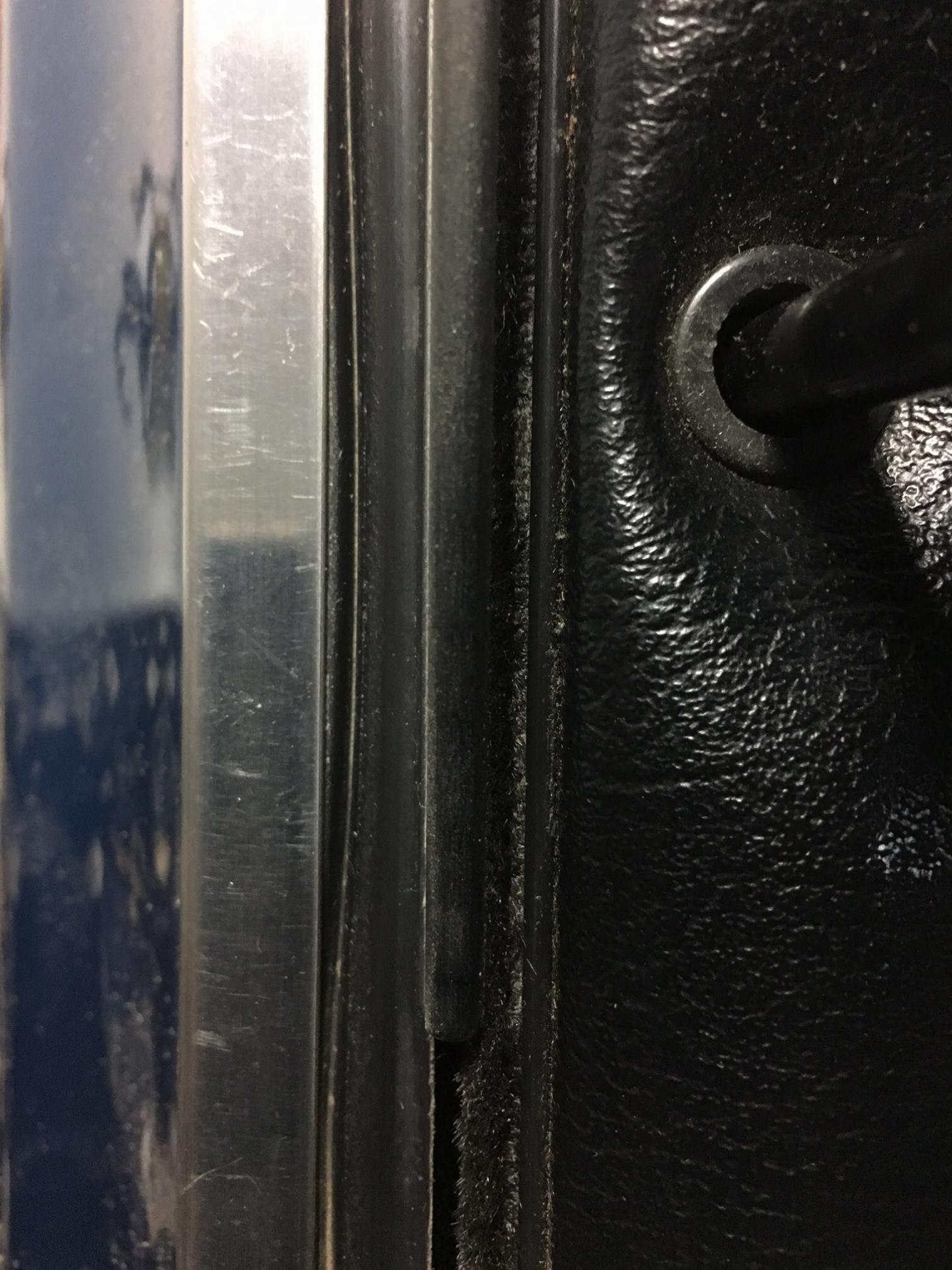

I installed new fuzzy and rubber on the passenger side door. I notice that there is a gap. However the driver side door there is no gap. Does the window frame allow any adjustment?

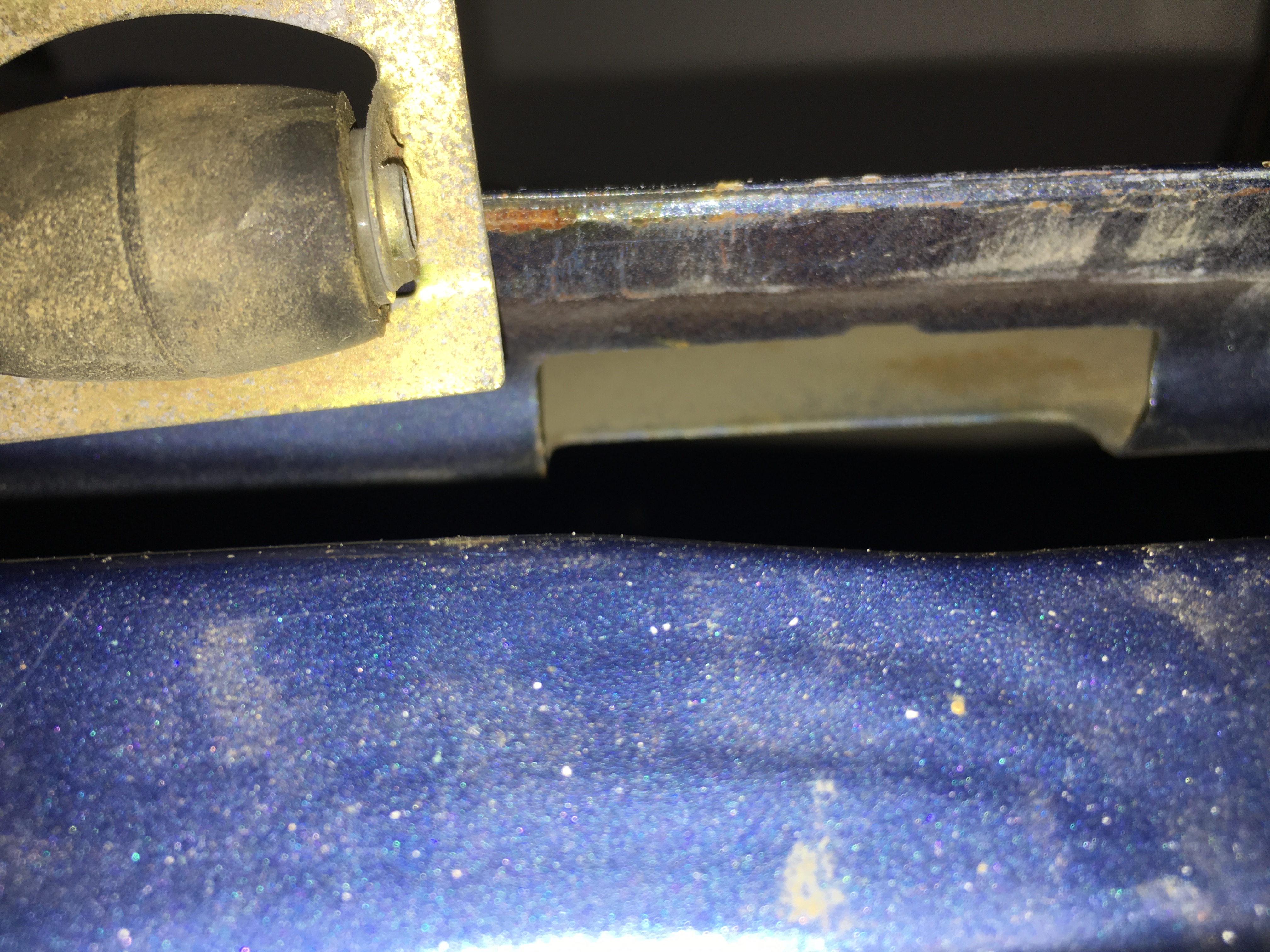

I solved the mystery.  The glass window rollers were attached to the door in the wrong place.
They weren't aligned to those cutouts and because of that they were actually putting pressure on the door glass and pushing it away from the rubber on the stainless steel beltline trim piece.
