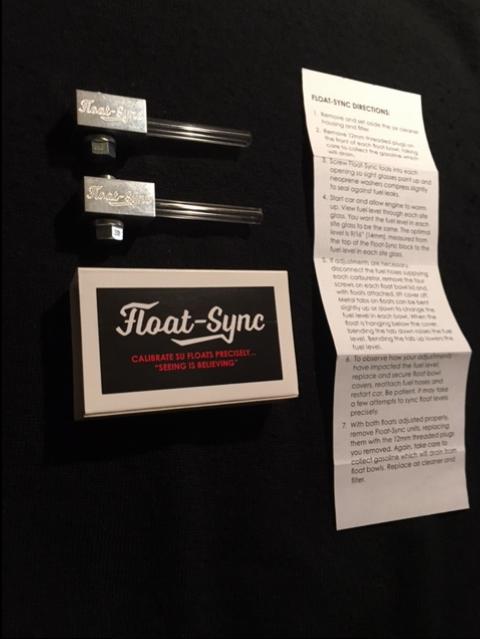

I've been working on a new product for the last six months that I'd love to get some feedback on. I've always known getting the floats in SU's set properly, and knowing for sure they were set the same in both carbs was important, but the method of doing so always seemed imprecise and less than elegant. I developed Float-Sync to know precisely where floats were set and have a visual reference, without removing the float bowl lids. On three screw SU's, there's a threaded plug in the float bowl tha
