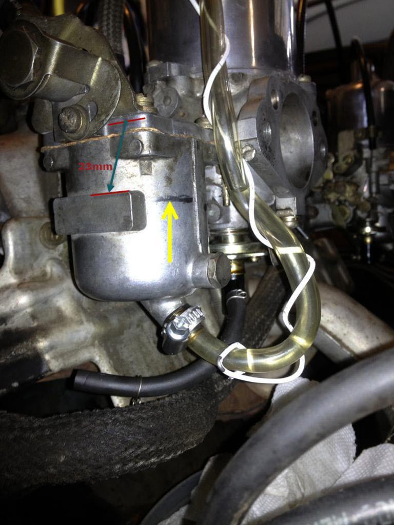

March 10, 20232 yr comment_651197 I made a cheap imitation while waiting for Randalla to build more. Sharing here incase anyone else wants to try, and I also have a question. I bought these polypropelene elbos on amazon and attached clear hose at the barb end. I also used an o-ring at the threads. This material doesn't dissolve in gasoline at room temp but I probably won't use these with engine hot. Anyway, my question is about the ideal level. I read that with float-sync the ideal level is 14mm above the top of the metal base. My question is what is the length from the top edge of the bolt on float-sync to the top of the metal base? Adding that to the 14mm should allow me to get close with these. Any help appreciated. The picture at the end shoes the level my front carb is at now after using the method of 0.55" gap between top of float and lid. I think it's too low. Link to comment https://www.classiczcars.com/forums/topic/55728-float-sync/?&page=6#findComment-651197 Share on other sites More sharing options...
March 10, 20232 yr comment_651207 I couldn't get the .55 dvd on SUs to work. I took the lids off and put them on top of a small glass with the floats moving up and down free. They are finally doing as when new. Here's the measurement I used from @zKars if I remember right. Link to comment https://www.classiczcars.com/forums/topic/55728-float-sync/?&page=6#findComment-651207 Share on other sites More sharing options...

March 15, 20232 yr comment_651442 I wonder if new floats from ztherapy would make the fuel level in the chambers be at the correct 23mm down from the lids? Seems like they would. Has anybody bought these and what were the results if you don't mind sharing? $50 would be a drop in the bucket compared to the year of frustration I dealt with trying to set mine the "easy" way of .55" measurement. Link to comment https://www.classiczcars.com/forums/topic/55728-float-sync/?&page=6#findComment-651442 Share on other sites More sharing options...
