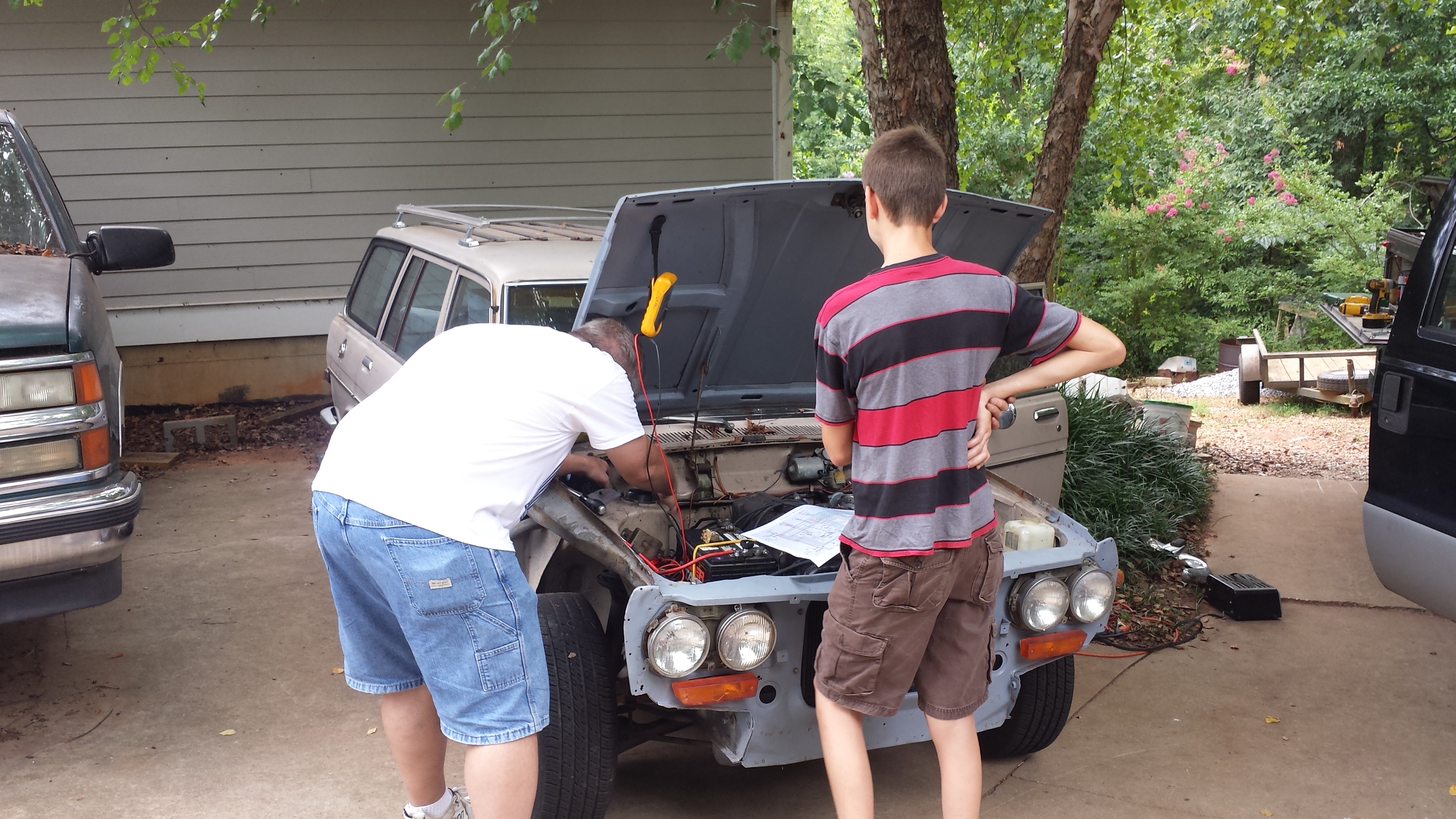

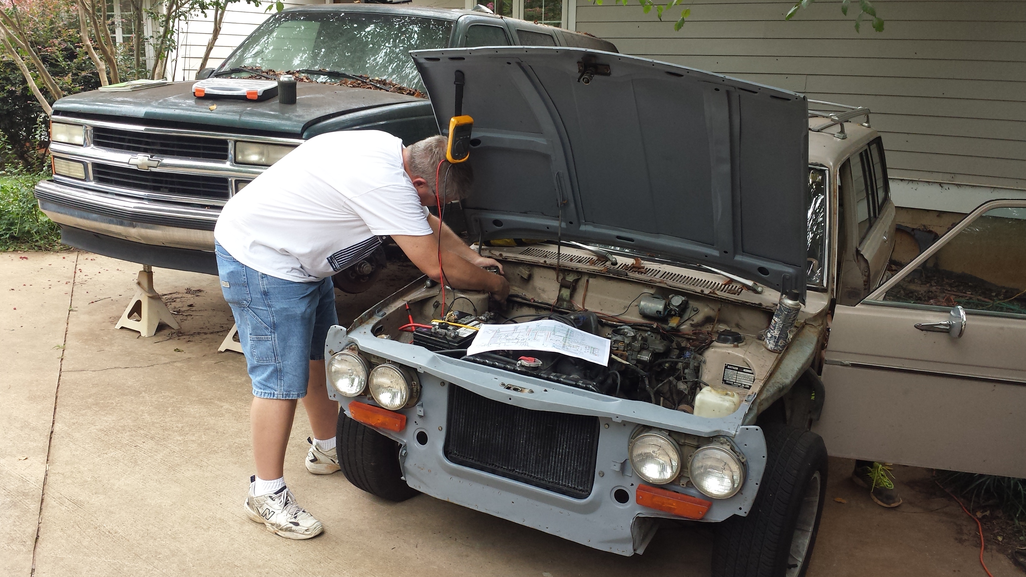

July 30, 20168 yr Author comment_499894 Well SteveJ came up today in the 260 and brought his little bag of magic tools. He was a big help. We narrowed down the headlight issue to a bad headlight relay. He had a replacement and all the vintage connections to make a plug n play fix. We still had an issue on the drivers side with glowing headlights we eliminated a backfeed issue and he narrowed the problem down to corrosion in the fuse box. So under his direction we pulled the fuse box and soaked the whole thing in a container of white vinegar for a couple of hours. After that a neutralization bath of water and baking soda. Blow it dry then use denatured alcohol to get all the water out. Blow it dry again. That brought the drivers side headlight leg up over 2 volts. Headlights are good now. We found 2 bad fuses in the fuse box, after that we had brakes lights and wipers. We got the horns working and I swapped a voltage regulator and got the alternator working. Then we had an erratic turn signal and I pulled the turn signal switch for cleaning... All in all a really productive day, I may have even forgotten something... Really big thanks to @SteveJ for coming up to help Link to comment https://www.classiczcars.com/forums/topic/55748-i-need-some-headlight-help/?&page=2#findComment-499894 Share on other sites More sharing options...
