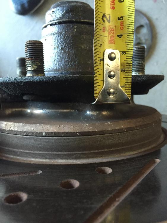

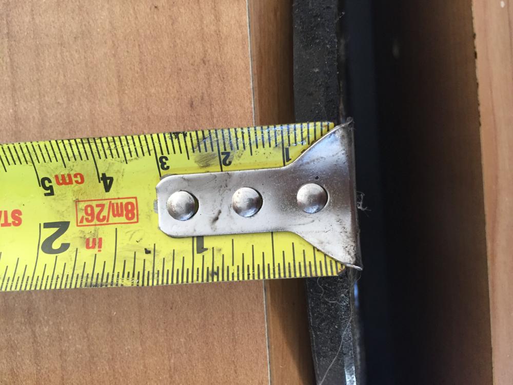

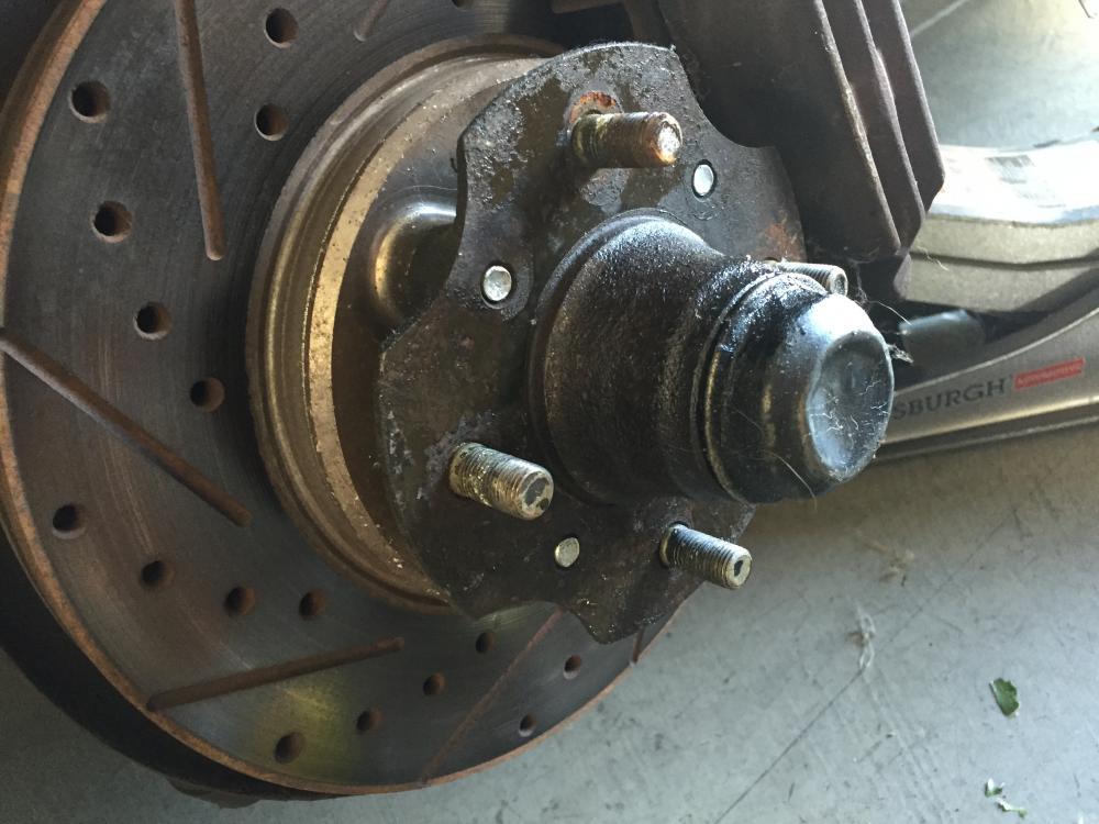

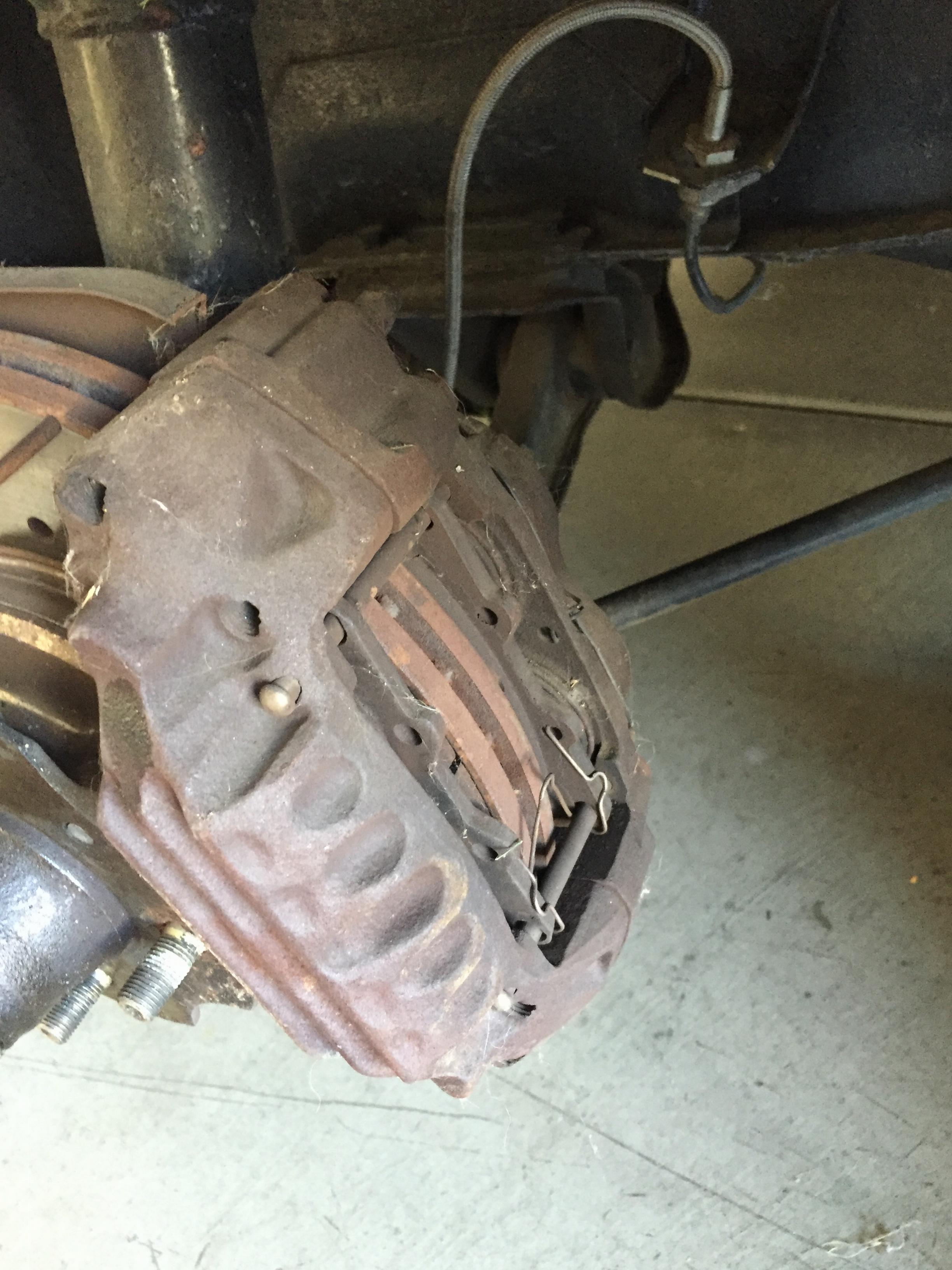

Posted July 6, 20168 yr comment_498227 Hi! Longer time lurker finally digging out! I really enjoyed this forum's community through the years. I learned a lot even though I could not contribute much back. I am really curious about getting a new set of rims. This led me to remove my front wheel and learn what this car has to offer. The previous owner resold the car and did not do any type of modifications, so right off the bat he did not know much about the car. Removing the front left wheel, I noticed a spacer. I measured it to be 8mm (if my math is correct). After removing this plate, I noticed "another spacer"????This spacer seems to be at 16mm. At first, I was like "wut da coochy"??? Then I figure all those spacers (roughly 16 mm) need to accommodate this huge lard - brake calipers . I mean, it is huge! It looks like a turtle shell...I thought-what if i removed the 8mm spacer, would the wheel fit and be okay? Turns out that it would not fit because the brake caliper would rubber vigorously with rims. With this in mind, I asked myself if my rear wheels had spacers... Turned out that my rear wheels did not. So really, how is it that my front wheels have 24 mm off set and not stick out from the stock fenders? My rear tires are completely flush with the back fenders. My other question is the limited choices of rims I have. What kind of rims would help me in this situation being that my front end is an offset while my rear isnt? Link to comment https://www.classiczcars.com/forums/topic/55756-280z-deconstruction/ Share on other sites More sharing options...
July 6, 20168 yr comment_498241 Your front brakes have been "upgraded". I think that Toyota calipers are the common one. Look around for "big brake" kits to see more. Welcome to old Z car world. Link to comment https://www.classiczcars.com/forums/topic/55756-280z-deconstruction/#findComment-498241 Share on other sites More sharing options...
July 6, 20168 yr comment_498274 Those don't look like the Toyota brakes but they could be. The other side would have a number cast into. You could google that to figure it out. You also have vented disc up front which is one of the ways to do toyota brakes. Most people go with thinner rotors and the corresponding thin calipers. The vented disc are much wider than stock, so that is part of the reason for all of the spacers. What size are your wheels/ tires? Link to comment https://www.classiczcars.com/forums/topic/55756-280z-deconstruction/#findComment-498274 Share on other sites More sharing options...
July 6, 20168 yr comment_498280 On 7/6/2016 at 4:36 AM, DoubleYOOHZ said: So really, how is it that my front wheels have 24 mm off set and not stick out from the stock fenders? My rear tires are completely flush with the back fenders. My other question is the limited choices of rims I have. What kind of rims would help me in this situation being that my front end is an offset while my rear isnt? Just noticed your offset question. Your rotor/disc is offset, but your wheels are not. The spacers are behind the wheel mounting surface, moving the rotor inboard. So you're running normal offset wheels, probably. There's a big selection out there. Link to comment https://www.classiczcars.com/forums/topic/55756-280z-deconstruction/#findComment-498280 Share on other sites More sharing options...
July 6, 20168 yr comment_498281 I know it's weird, but those DO look like Toyota brakes...mounted bassackwards. I said it was weird, Cheers, Mike Link to comment https://www.classiczcars.com/forums/topic/55756-280z-deconstruction/#findComment-498281 Share on other sites More sharing options...
July 6, 20168 yr comment_498282 Think I found it. Toyota 4 piston truck calipers with 300ZX rotors. http://forums.hybridz.org/topic/39435-help-what-brake-options-are-available-for-s30-z-cars/ http://www.thezstore.com/page/TZS/PROD/24-5705 Link to comment https://www.classiczcars.com/forums/topic/55756-280z-deconstruction/#findComment-498282 Share on other sites More sharing options...
July 6, 20168 yr comment_498285 The 16 mm "spacer" you show is the factory wheel mounting flange. The 8 mm spacer, as you already found out is to allow the wheels to clear the brakes. The need for the spacer is wheel dependent but not necessarily related to the offset of the wheel. The shape of the "spoke" section of the wheel that connects the hub to the rim is what matters. Larger diameter and width wheels typically will clear the brakes even when they have a zero offset, especially the modern designs. Link to comment https://www.classiczcars.com/forums/topic/55756-280z-deconstruction/#findComment-498285 Share on other sites More sharing options...
July 7, 20168 yr Author comment_498287 @Zed Head - Being that my front wheel is offset, this would be a negative offset-correct? What do you mean by normal offset? I was planning on doing a 15x8 or 15x9 set of rims. Would that work? The link you provided was the photo I was about to upload for you guys because it almost looks identical to mines. @Patcon- The brakes look identical, if not the same, from the ones provided in the link by Zed Head. The rims I am running are factory 6 spoke rims for the 77 year. Tires on the side wall list as P205/70R14. @beermanpete-WIth the factory wheel mounting flange, wouldnt it block certain rim/wheels? (The pointy end of the 16 mm spacer?) With all this, using an offset wheel or not, are there any concerns for the lug nuts? I mean, my lug nuts rotate in maybe ~1 inch? Thanks all for the replys. Edited July 7, 20168 yr by DoubleYOOHZ Link to comment https://www.classiczcars.com/forums/topic/55756-280z-deconstruction/#findComment-498287 Share on other sites More sharing options...
