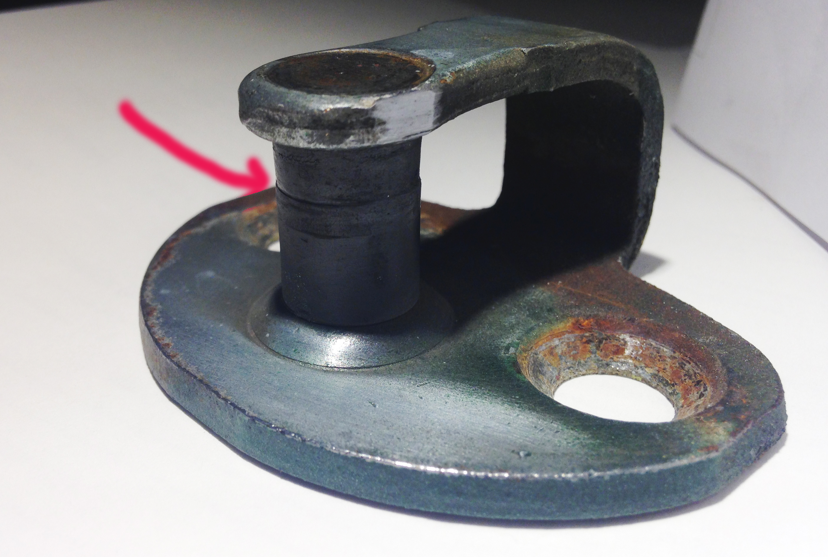

Before you start bending rods, can you post a picture of the door striker? If there is bounce back It could mean the door striker is a little out of adjustment.  You need to visually line it up to the latch for the vertical alignment then do the horizontal, mine was almost to the back corner.  Also,There is a plastic sleeve over the striker post that sometimes wears out and the latch can make a rattle sound if it is worn off. Here is a shot of my old striker that I just replaced. You can see some wear but It worked fine, I just changed it to look better (second picture).

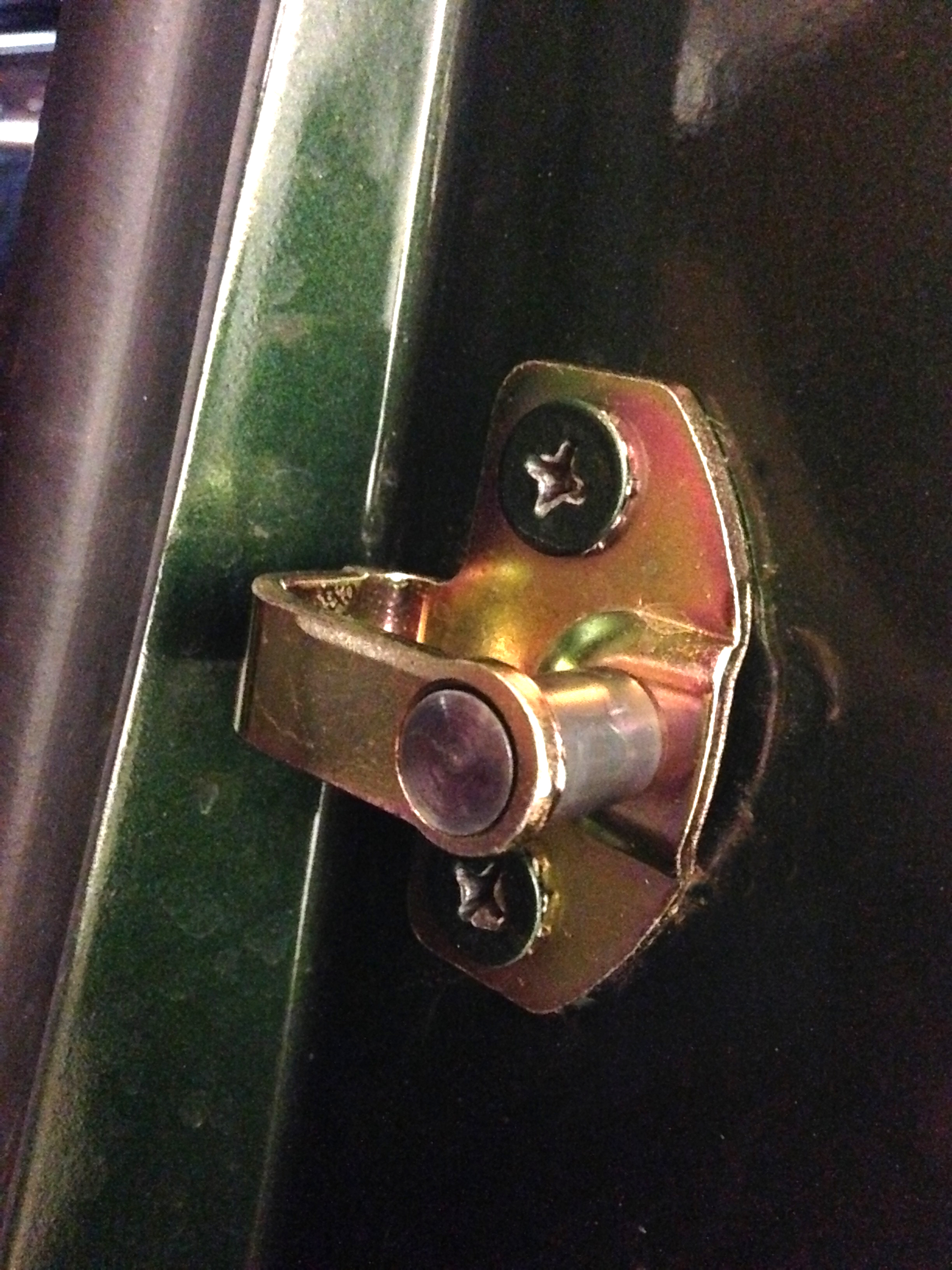

fellas, i feel dumb.  i had not noticed the driver's side(the one with the issue) was missing the plastic sleeve from the body mounted striker.  seeing as everything else is fully functional, i can only assume this is the issue.
can the striker be disassembled to add a bit of plastic, or is it worth it to just buy a whole new one?

It's hard to know your missing something when it's not there to begin with.  Been there many times.
Unfortunately I do not know of a fix for that sleeve.  Maybe somebody here does and they will chime in.  Until then, I know of two places for that part. Not outrageously expensive but not exceptionally cheap either.   Zcar Source for new or used http://www.zcarsource.com/content/p/8/stype/product/?searchVar=door+striker and Z car Depot https://zcardepot.com/interior/door-parts/door-striker-latch-oem-77-78.html.
