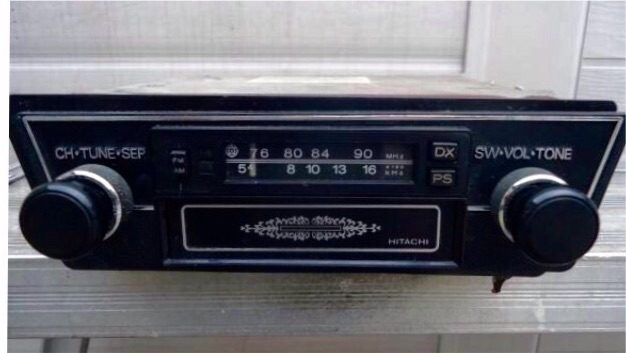

check out the picture i just edited the post and added it. Most of the hitachi's you see are AM only right?

The radio you posted above is a later 74+ year radio.
I tend to not pay much attention to the later stuff myself and look for the earlier stuff. Early Fairlady Z-L radio's. I've come across a few.

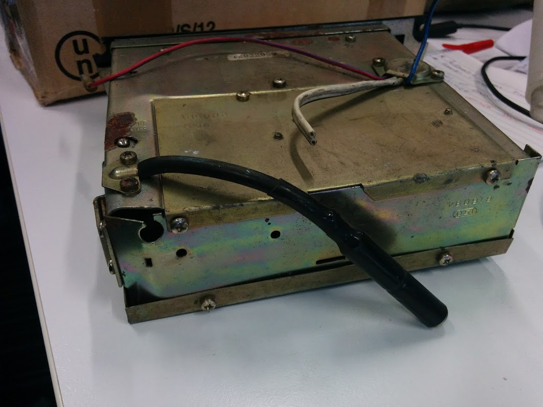

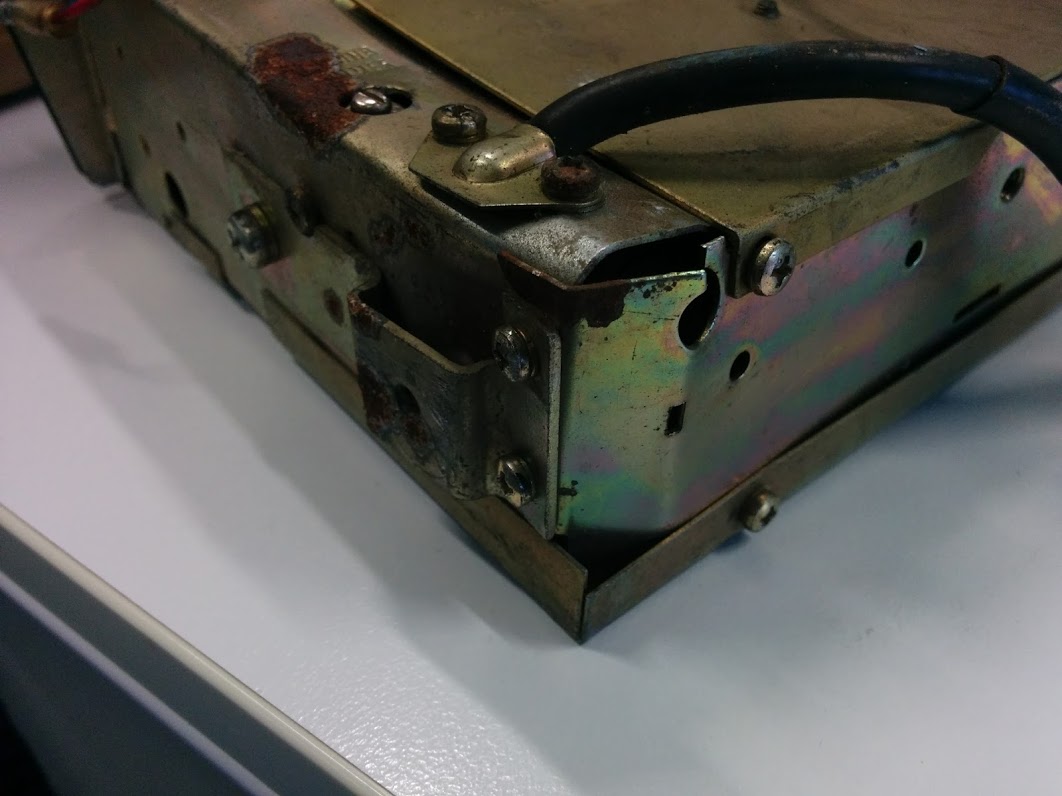

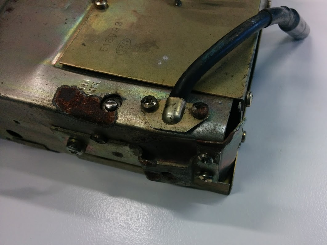

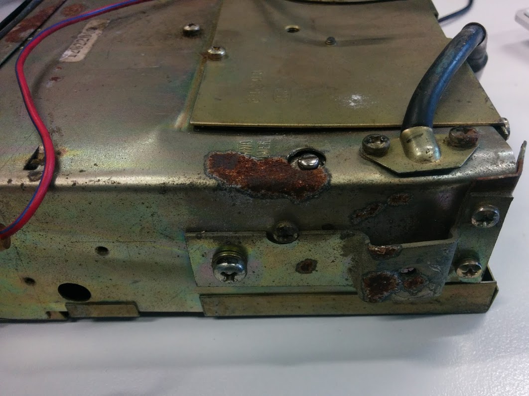

Here is a radio I bought from Europe, seller didn't add any protective packaging and guess what? It looks to have been crushed in 1 corner... I found a bit of PCB which looked like it had some 'circuit' on it. I will have to open it up and assess the damage. Who sends something like this with no packaging? I'm surprised the faceplate wasn't annihilated..
I'll start a new thread for the radio repair work.. So far most of them work, just a couple of niggles like those described. Pretty impressive.
Hope you didn't pay much for that thing. Gonna be alot of work getting it looking good. You can epoxy the circuit board back together if it's broken and fortunately you have a schematic for it.
